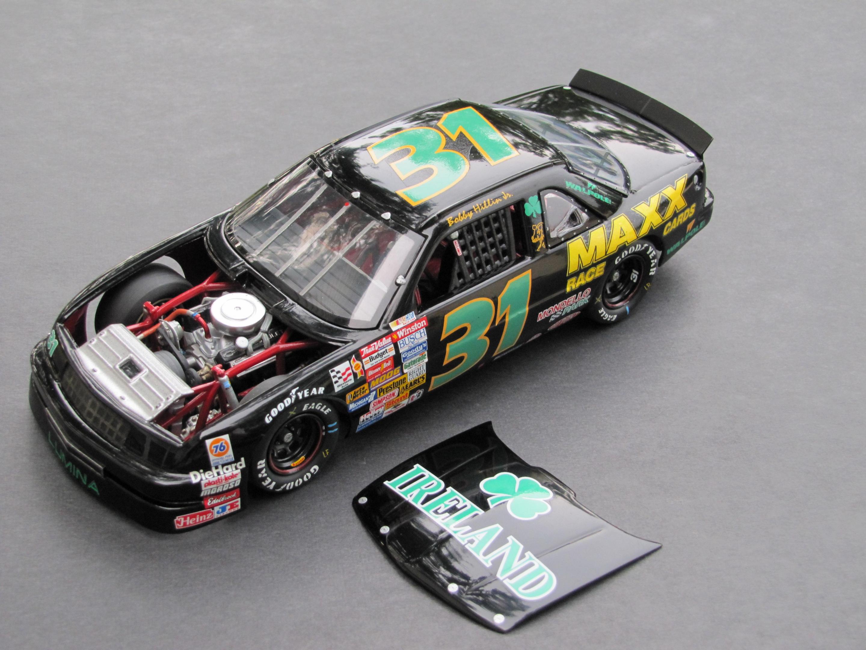

Kmidd65 Posted November 27, 2020 Share Posted November 27, 2020 20 hours ago, Sixties Sam said: What if you want to repaint a model that has been coated with Future? Can you paint over it with decent results, or must it be stripped off with ammonia or some other chemical before painting? Sam Actually, I have had quite a bit of luck painting over Future. I use it as a sealer over areas I have used Bondo spot putty. After sanding, I apply a thin layer with a brush and let it dry at least a day. I have shot over this formula many times with a variety of primers and paint finishes without any trouble. The future keeps the bondo from shrinking or pitting if you allow it to dry a day or two before sanding and future coating. Regarding black model cars with Future, I have only did that once. On this Nascar, I had a mirror like finish with Tamiya clear before decaling. The decals were terrible and split and cracked like crazy during application. To seal them in and prevent future issues, I applied Future over this one with a wide brush. It worked pretty well. From time to time I will refresh the finish as it seems to dull over time. I wipe it down with a coat of ArmorAll and it brings back a deep shine. HTH Quote Link to comment Share on other sites More sharing options...
