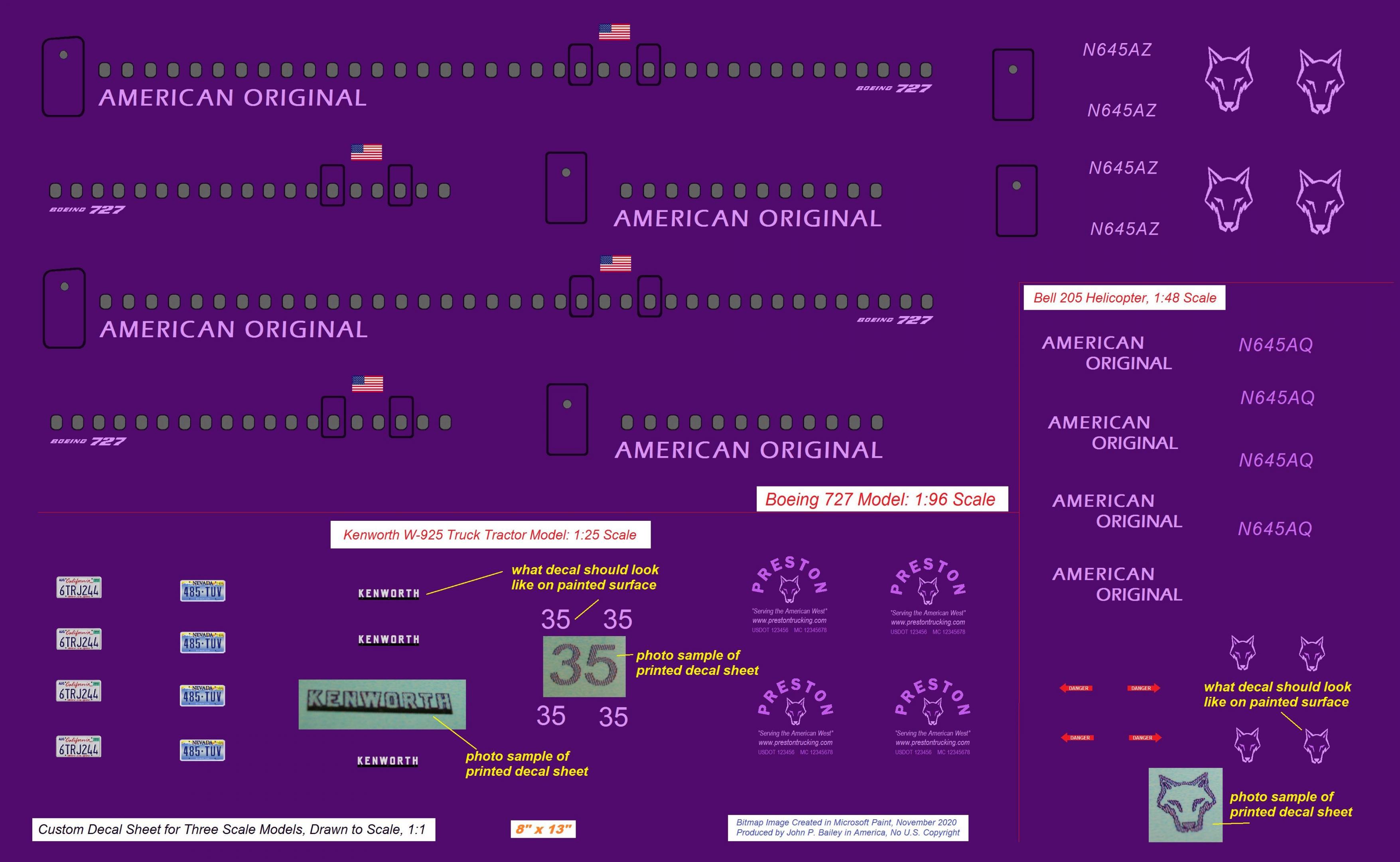

I just received a custom decal sheet from Josh Muma of Bedlam Creations and I yelled ARRGH!! out loud like Charlie Brown. This thing cost me $57. I've attached my original image design with a Plum Crazy background color and a few photo samples taken with my digital camera up close. I emailed Mr. Muma the following message:
12/8/2020
Josh:
I'm sorry to say that the decal sheet appears to be a total flop. I was not expecting a fish-net pattern over my decal objects but rather crisp decals in solid colors. The fish-net pattern is almost as dark if not darker than the purple background which is to be my painted models.I don't think that many of those decals will even show up on my darker-purple-painted models. Even the light-silver KENWORTH decals have some dark purple fish-net over them.
I used my digital camera and photographed parts of the decal sheet and placed them next to my original decal image designs for visual comparison. I've attached a file with my original decal sheet design and a few samples of photos of the actually decal sheet received for visual comparison. Is there another method than thermal ALPS that produces much crisper decals truer to the original image? I have printed much nicer-looking decals with my home HP Officejet on Testors decal paper but I can't print white or light colors, pastels, on that machine, of course. I've only printed black and red decals.
How come decals that come in factory-boxed model kits look so clean and nice? I was expecting "factory" quality.

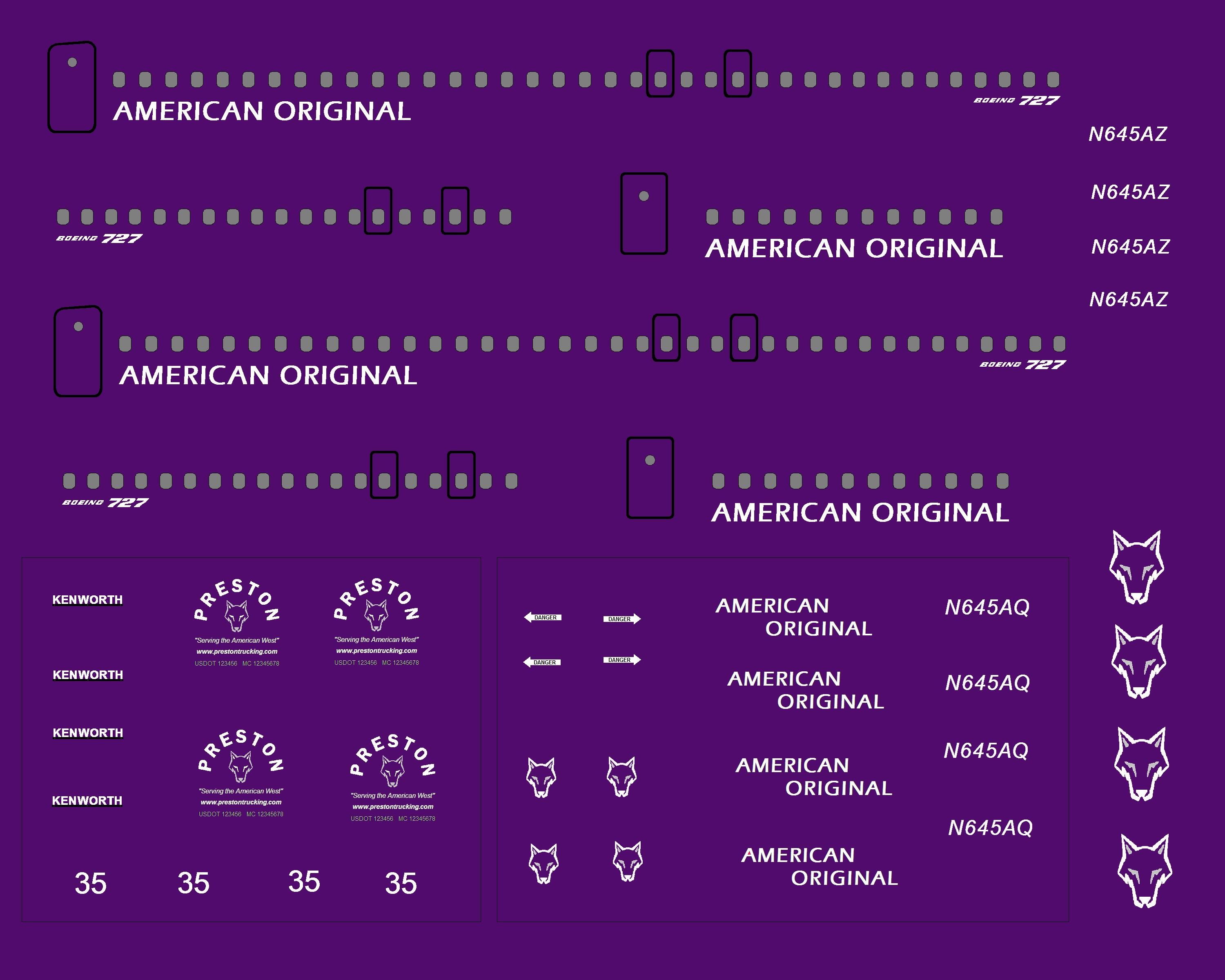

Now my question is, what decal printing company should a fussy serious model builder really be using instead? I authored my image for a decal sheet print job in Microsoft Paint. I don't have Corel/Vector drawing skills or software.
The quality of the custom decals will make or break my model projects.

The image I submitted to Mr. Muma was authored in bitmap 300 dpi. I used two online sites to convert it to a 600 dpi PNG file and make the hot-pink background it had transparent. The JPG image I'm showing here has the purple background which is to approximate the model color the decals are intended to be applied to.

A few points here. What you supplied was a bitmapped file. A bitmap file is made up of dots and not lines. Whenever you change the size of a bitmapped file, there is a real likelihood of the image changing and producing what are called artifacts. The artwork may have worked better as a vector based file. The second issue is that most printers work in some variation of cyan, magenta, yellow and black ink. A purple would have elements of each of those in it. To achieve various colors they print halftone dots with the intent of fooling the eye. If the artwork had been vector based, the halftone dots may have been smaller but still present. The light silver would have printed better with a silver foil which is only available with a handful of printers, the ALPS being the most common.

Text and Numbers are best done in vector. Nothing in your files would be hard to create in vector. Take a skilled person one to two hours depending on what you had to submit for the wolf head. The license plates may best be rendered with the background in bitmap and the numbers in vector.
As a decal manufacture for 40 years I will say decals will only be as good as the artwork AND the print can create.
Artwork MUST be vector art and the printer must be able to print 600 dpi minimum.  'Home' decals can be as good or better than screen printed 'factory' decals in some ways. Screen decals need a screen for each color....13 colors 13 screens......each sheet will be costly. Digital print decals done right can have 3 colors or 100 colors....same cost to print. And at 800 dpi as fine a print as screened decals.  What you showed looks like art that was not vector and a printer not up to very fine printing.  I have 300 decals in my line and as of last month I have gone 100% digital print. The decal custom printers out there charge $10-20 a INCH so a 11 inch page of decals can cost $200. But they will be very nice.

I also concur that top quality decals really should be done as vector graphics.  MS paint is not optimal.
As for the "fishnet" what you seeing is halftoning or dithering.  It is an artifact of the limitations of the type of consumer printer used to print decals.  Those printers only have 4 inks: Cyan, Magenta, Yellow, and Black (K), and they are called CYMK printers.  Those printers use a grid of various size dots of those 4 inks to result in specific shades of colors.  For a technical explanation see  https://en.wikipedia.org/wiki/Halftone  Those dots or grid is the undesirable effect of that type of printing.  Depending on the resolution of the printer and type of halftoning it is capable of, the halftones might be from almost invisible to unacceptable.
As a long time user of Alps MicroDry printers I'm reasonably sure that that those decals were printed on an Alps printer.  It's halftone capability is rather poor (as you can see yourself).  But Alps is also capable of printing really good quality decals, but that requires lots of extra work, and a know-how of the tricks that are needed for Alps to produce excellent results.  Without going into too many details, basically the secret is spot color printing multiple layers of ink and capability to overlay inks.  There now is a wide range of spot color ink cartridges available for Alps. Spot color printing is one of the "special" Alps features not available in other consumer color printers.  Not every color can be printed that way, but there is a wide range of colors that can be printed without that "fishnet" halftonning.
Ink jet printers use different halftonign technique and can print smaller dots than Alps, but unlike Alps they cannot print a base layer of white ink to make the colro images opaque, and their ink is water soluble.
This is just a tip of the Alps iceberg.  It is a hobby in itself.
As for your decal, it looks like the person printing them just directly printed your artwork, as is (with maybe some small corrections). That usually is not good enough, but without vector-based artwork, that is all that can be done.
The commercial printer Dave Van uses likely uses either spot-color printer, or a UV-cured Ink jet printers which have really fine halftones.  But you have to pay for the quality.
