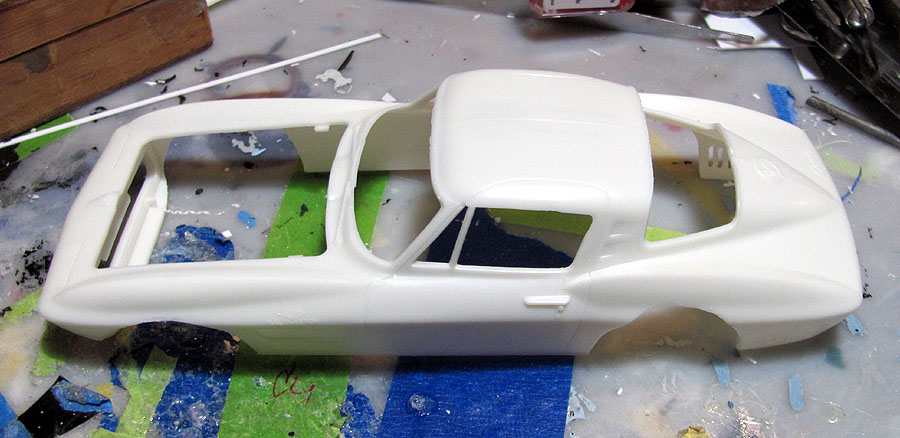

MarkJ Posted January 18, 2021 Posted January 18, 2021 Here is the kit Need to change these wheels to a reasonable facsimile of Halibrand wheels. Need to change this hood .

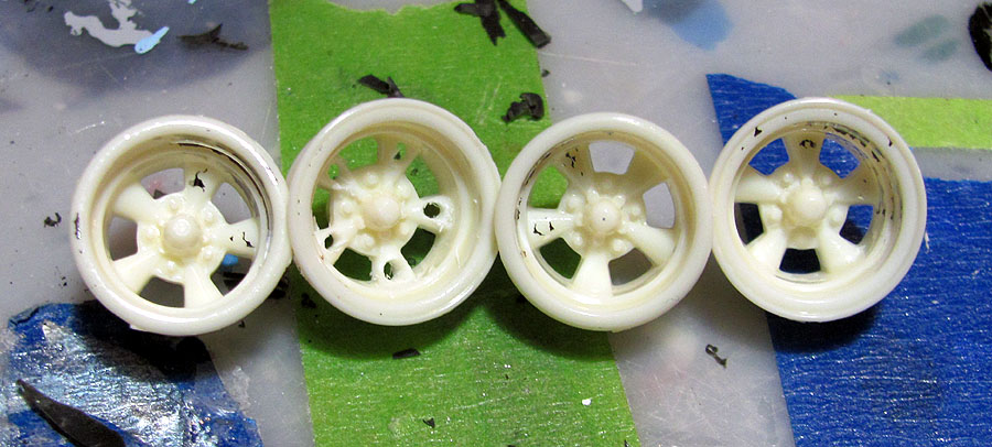

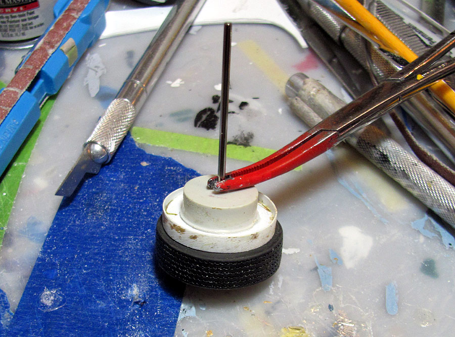

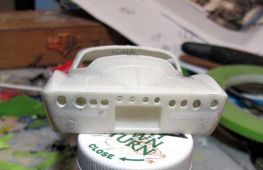

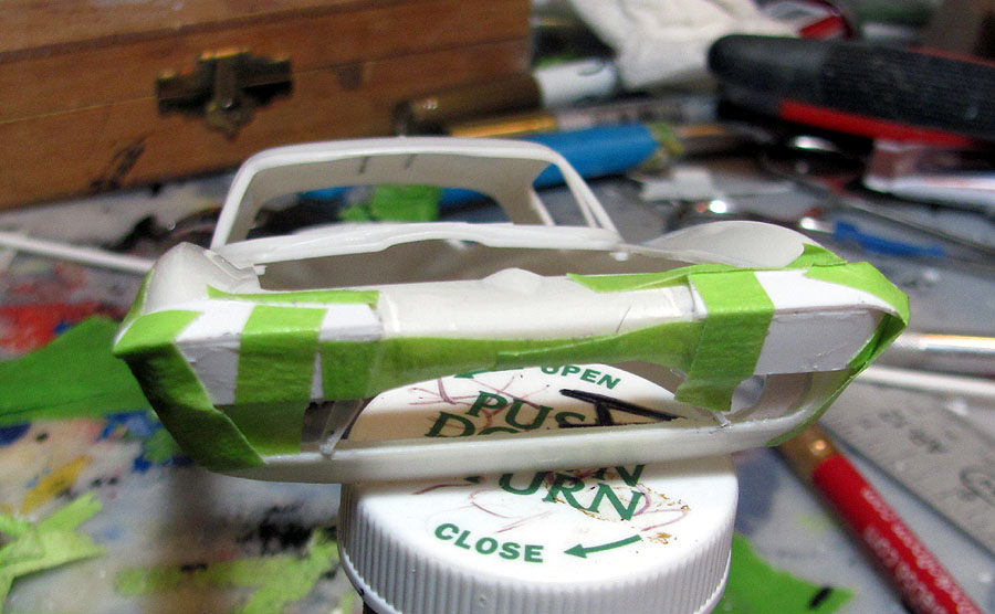

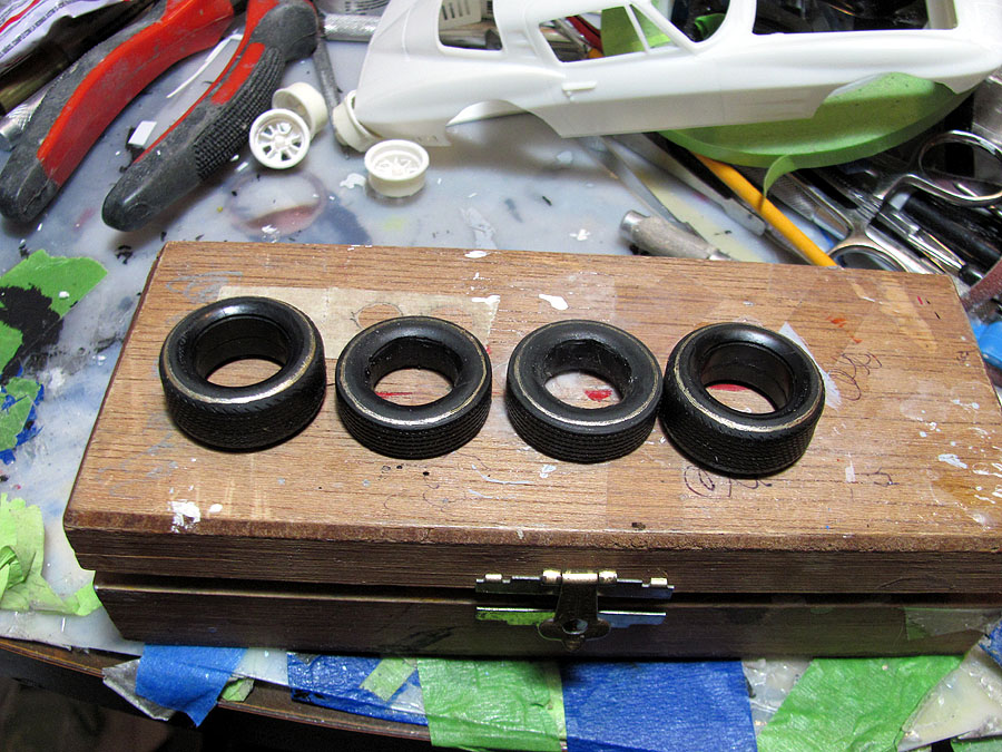

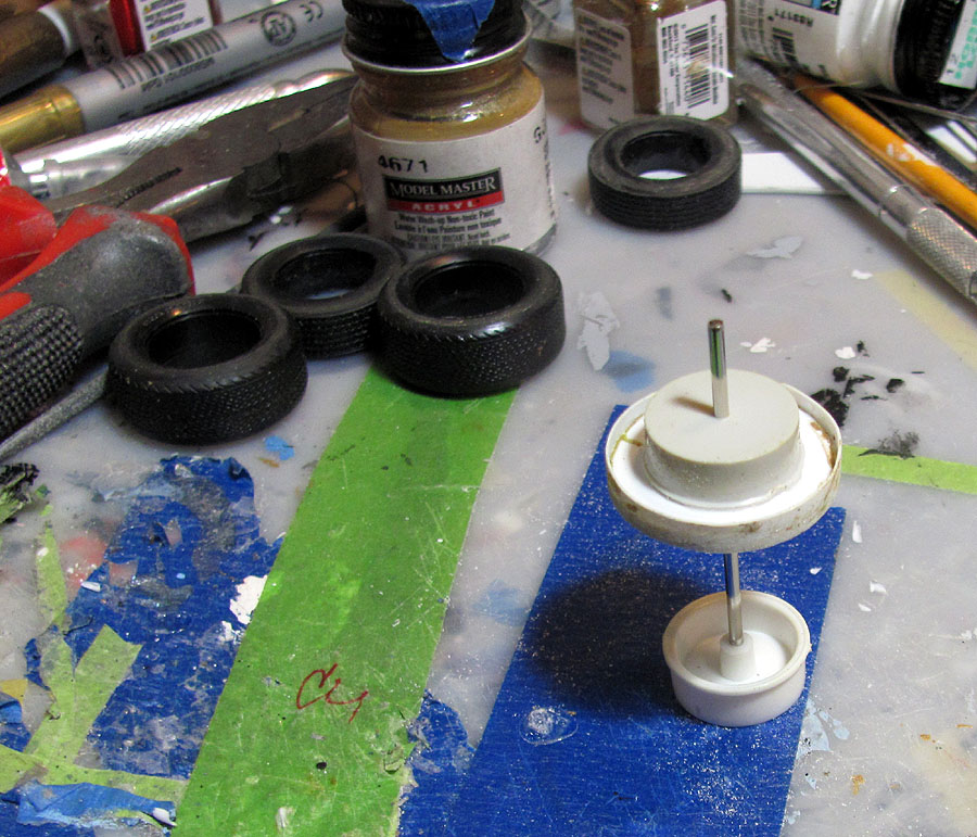

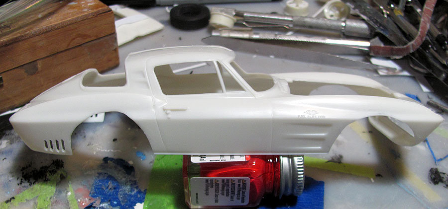

MarkJ Posted January 24, 2021 Author Posted January 24, 2021 I had to put gold stripes on the tires so I knew I couldnt mask them or make decals to do this task so I came up with this deal. i use it as a mask of sorts and use a toothpick to apply the gold acryl paint. they dont make a gold sharpie tiny enough to work that I have found. I know the stripes are too thick but im going to touch them up and narrow them with a #11 exacto blade I modified the wheels to make them look more like halibrands. not that great but I think the metallizer will make them look a lot better This car had a trunk even though real corvettes did not so I created one with #11 blade and scriber. The front of this car is a lot different then a stock corvette. It did not have retractible headlights but they did put removal covers on them when not racing in the dark. Here are the tires . i know they are not right but its the best I could come up with. If any body knows where I can get a very very fine point gold sharpie, let me know.

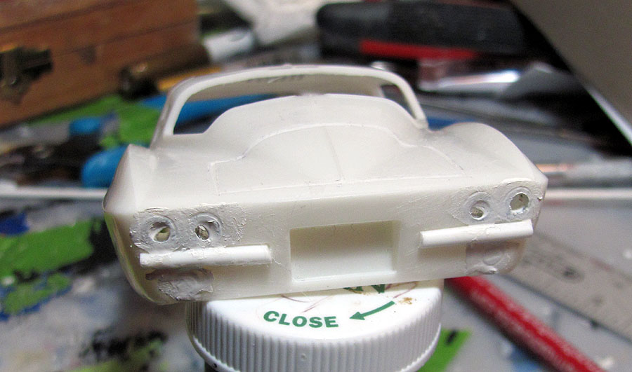

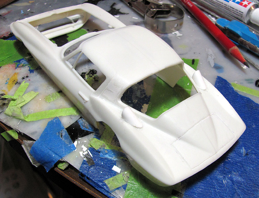

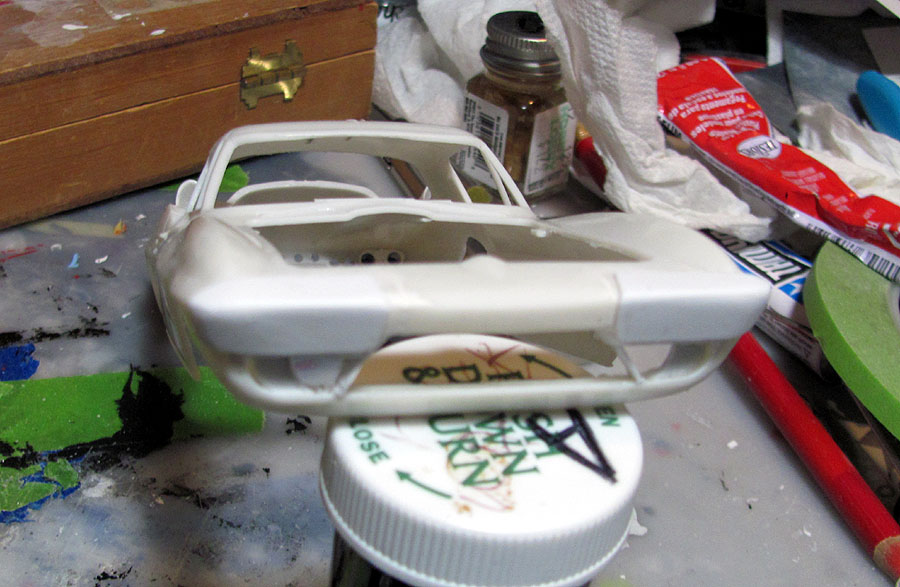

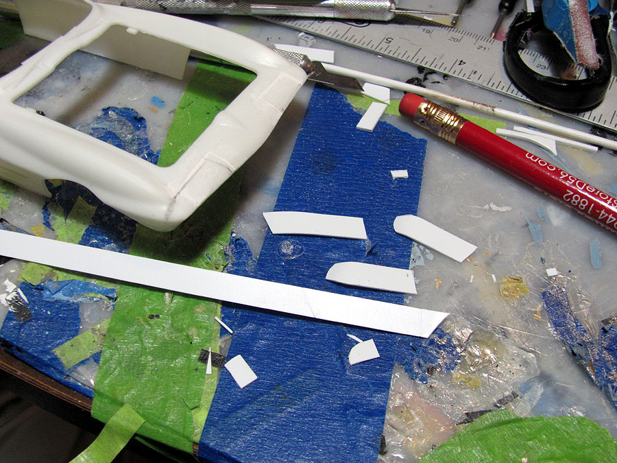

MarkJ Posted January 27, 2021 Author Posted January 27, 2021 Had to make some headlight covers. Had some styrene strips that were just the right width. Had to fill in some holes and voids in the rear panel and also make some extra holes. used styrene to do most of the filling. Just a few small voids will be filled with putty. Needed to open up the front fender behind the tire, like the real car had it done. Also, there are some voids in the b pillar that had to be filled.

Reeves Racing Posted January 28, 2021 Posted January 28, 2021 (edited) 8 hours ago, MarkJ said: Thanks , Mitch. An Accurate miniatures kit would have been awesome but they have been out of production for a while and to get one it would be second hand and if you could find one it would cost a ton of money and might be missing parts when you got it. So I'll just keep on with this deal. That is true but Revell repopped it a few years ago, and I have found several on eBay that were very reasonable. I have a couple that are unstarted and one that I built but recently disassembled to start making it into the roadster version. You did an amazing job converting the wheels into Halibrands by the way. Another way to put the gold or blue stripes on the tires is to use your mask to scribe a groove in the sidewall with the xacto and then later gingerly fill the groove with paint. Its easier to scrape off the excess later too. Edited January 28, 2021 by Reeves Racing
MarkJ Posted January 28, 2021 Author Posted January 28, 2021 11 hours ago, Reeves Racing said: That is true but Revell repopped it a few years ago, and I have found several on eBay that were very reasonable. I have a couple that are unstarted and one that I built but recently disassembled to start making it into the roadster version. You did an amazing job converting the wheels into Halibrands by the way. Another way to put the gold or blue stripes on the tires is to use your mask to scribe a groove in the sidewall with the xacto and then later gingerly fill the groove with paint. Its easier to scrape off the excess later too. Thank you, Mitch . That is an amazing idea that I would have never thought of. I will try it on a spare tire and if it works I will do it to the tires for this build. This should allow for a much better and smaller stripe which is what I need. Thanks again.

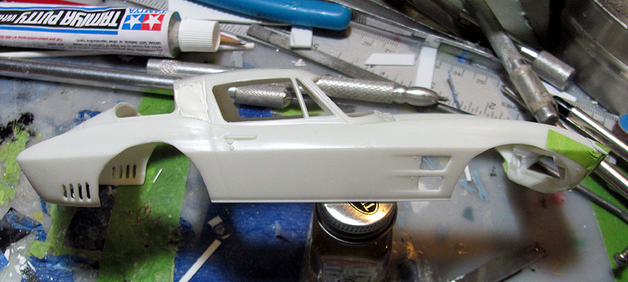

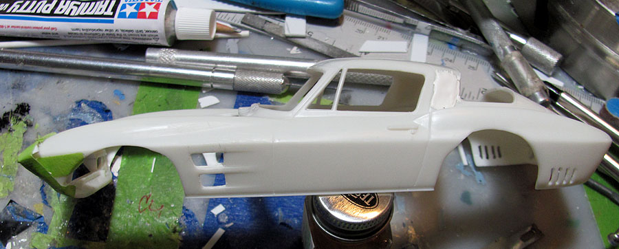

MarkJ Posted January 28, 2021 Author Posted January 28, 2021 Made some scoops from evergreen styrene tubing for the sides of the deck lid area. I guess they cool the rear brakes. Will need to add a little putty to the rear of the scoops. Not quite flush

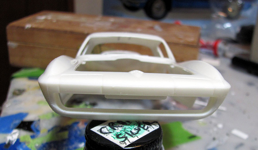

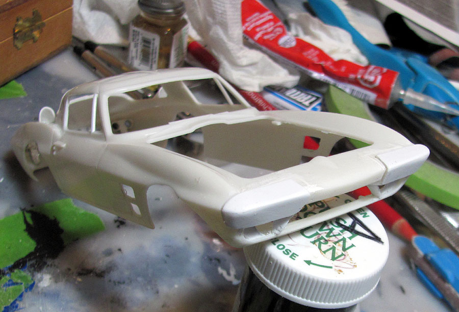

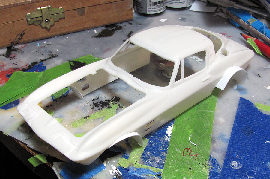

MarkJ Posted January 29, 2021 Author Posted January 29, 2021 Finished the headlight covers. Still need to detail sand them and paint. They will be a different color then the body so I will not install them till the body and the covers are painted. I just have them sitting loose in these pictures. I also added the fender extensions. They still need to be trimmed out and lips added to them and the edges rounded. The rear ones appear to be too big because they are right now.
