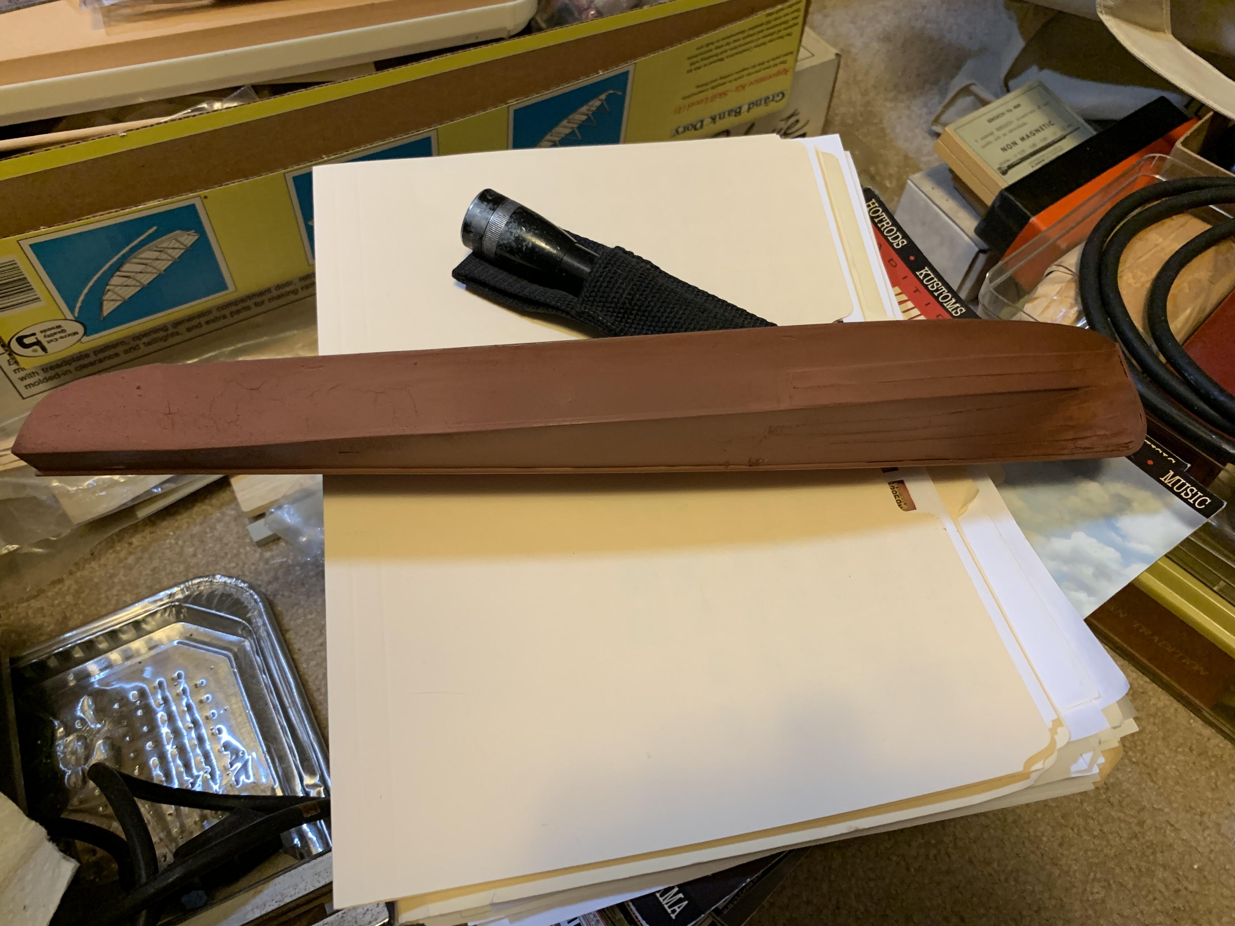

Paul Payne Posted April 26, 2022 Author Share Posted April 26, 2022 Got some primer on the hull- now the lines are clearer than before- will need to be sanded and a second coat applied before planking begins- decided to go with the cedar planking instead of the strip wood. Quote Link to comment Share on other sites More sharing options...

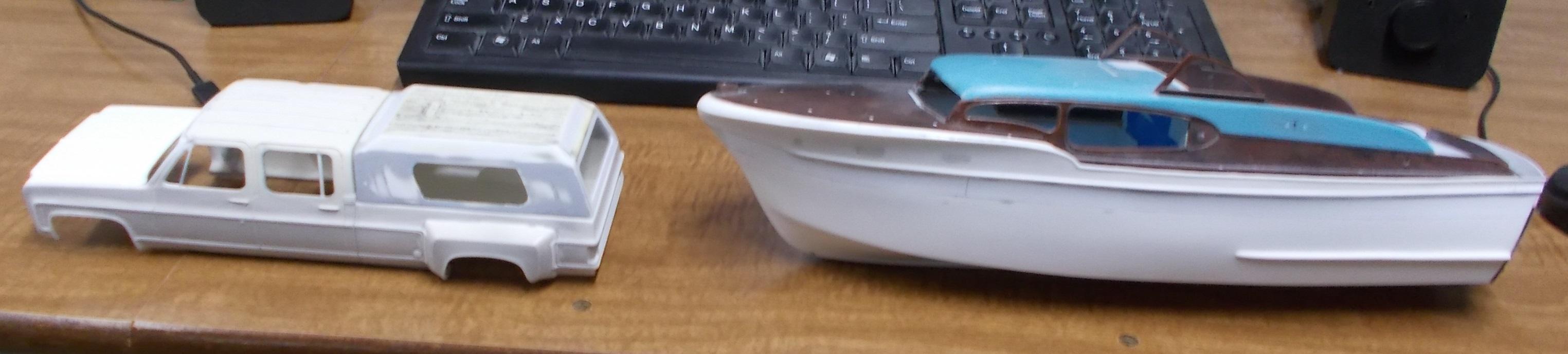

tim boyd Posted May 10, 2022 Share Posted May 10, 2022 On 4/26/2022 at 6:30 PM, Paul Payne said: Got some primer on the hull- now the lines are clearer than before- will need to be sanded and a second coat applied before planking begins- decided to go with the cedar planking instead of the strip wood. Paul....not sure how I missed this thread up to now, but I will be following it with great interest from this point forward. Great concept, and I really like your idea of starting with an old military boat model rather than working from scratch which is pretty much my take after looking at a few Dumas boat kits i bought a few years back. Also, very interested in your Power Wagon as that is a topic I would have sure liked to have seen as a model kit. Also of interest, another one of the top-end builders who posts on this forum from time to time has just embarked on a very impressive big boat/trailer/tow vehicle project. I won't name him as he has given me no indication, he wants to go public just yet, but his ideas are very creative and i think his project would be a great compliment and comparison to yours if it takes off. Best wishes for your project and congrats on your progress to date! TIM Quote Link to comment Share on other sites More sharing options...
Paul Payne Posted May 10, 2022 Author Share Posted May 10, 2022 Tim, thanks for the kind words- a comparison would be a great idea! We met at the Hoosier model contest and I enjoyed visiting with you. The next step on the boat will be building the visible frames in the engine compartment. I am considering a V-16 Duesenberg engine using parts from the Monogram Duesey but also scratch building a lot. I guess small simple projects just don't exist for me any more........................... Quote Link to comment Share on other sites More sharing options...

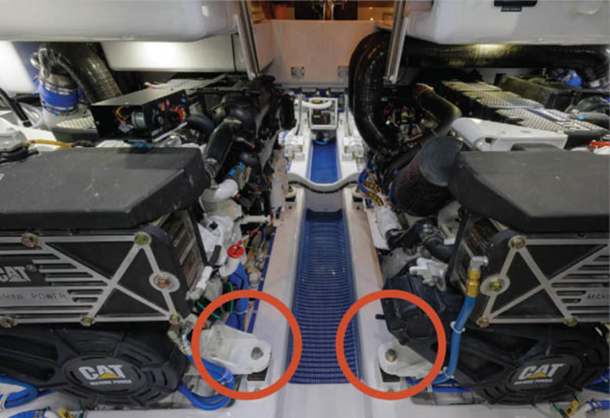

tim boyd Posted May 13, 2022 Share Posted May 13, 2022 22 hours ago, foghorn62 said: Hi Paul, first of all, let me say that I am excited to see your project, and I look forward to following your progress! I think your approach, using an old PT boat hull has a lot of potential, and the selection of a power wagon for a tow vehicle is a great choice! I am most interested to see how you go about setting up the engine for the boat. I have very little experience with boat models, and am forced to follow whatever I can find in pictures on the web. I believe I am probably the guy Tim Boyd was referring to who has just embarked on a boat/trailer/tow project, although I am not too sure about his “top end” reference. I have purchased the Dumas Chris Craft Cobra kit (which I found extremely over priced for a box of sticks and a set of plans, but I digress). I have assembled the hull, and stopped until I decide how I want to proceed. What I have in mind, is sort of an Americanized version of the Riva Aqurama Lamborghini. I have in my possession, three 3D printed Chevy LS3 V-12s. I am planning to use two in the boat, and one in the tow vehicle. For that, I have chosen one of the 47 Chevy kits from Galaxie Limited, but I have ordered a convertible conversion kit for it from Jimmy Flinstone, and I am planning to install wood on the sides and deck on the order of a 48 Ford Sportsman. I haven’t given much thought to the trailer yet, but I imagine I’ll make something out of brass tubing, as I am comfortable working with that material, and it should be quite strong. I’m just in very early stages of this project, still trying to figure out how to mount the engines in the boat, with marine cooling, water intake, exhaust, what the power output to the propeller shaft looks like…. I’d be very interested in seeing what you are planning along those lines. I’m adding two pics of my current project status, and also one of the Riva Aqurama Lambo engines installed. TS Yep Tim....I plead guilty. Yours' and Paul's project have some really cool parallels and contrasts. Can't wait to see them both take shape. TIM Quote Link to comment Share on other sites More sharing options...
foghorn62 Posted May 14, 2022 Share Posted May 14, 2022 On 5/12/2022 at 7:28 PM, Paul Payne said: Sounds like a plan, Tim. I have learned so much from other members sharing ideas and techniques. BTW, I used fishing lure spinner propellers for my 4 blade props, since I could not find props small enough on line. Hi Paul, I’ve been searching around for information on how to set up plumbing for a marine cooling system, and came upon this diagram, that helped me understand how the sea water pickup feeds a pump, which circulates sea water through a heat exchanger, and then dumps the sea water through the exhaust system. The water pump on the engine receives the cooled water from the heat exchanger and pumps it through the engine block, then out through the exhaust manifolds, and back through the heat exchanger in a closed loop. I’m also including a pic of the Lamborghini engines in the Riva in early stages of installation so you can see what such a system looks like. Hope this helps. TS Quote Link to comment Share on other sites More sharing options...
Paul Payne Posted May 14, 2022 Author Share Posted May 14, 2022 Wow, somewhat complex! It appears that additional heavy timber next to the keel and between the ribs is used as an engine mounting bed. The engine is then bolted to these using a mounting pad bolted to the wood and in turn the engine mount plates are bolted to these. Quote Link to comment Share on other sites More sharing options...

foghorn62 Posted May 14, 2022 Share Posted May 14, 2022 40 minutes ago, Paul Payne said: Wow, somewhat complex! It appears that additional heavy timber next to the keel and between the ribs is used as an engine mounting bed. The engine is then bolted to these using a mounting pad bolted to the wood and in turn the engine mount plates are bolted to these. Some great stuff here Paul! The cooling system may seem daunting, but it’s really not that bad. Your third and fourth pics with the blue engine show really clear pics of the trans, shaft coupling, and mounts. On the blue engine, that little cylinder tank on top toward the front of the engine is the heat exchanger. Other than that, most of a marine cooling system would be hoses. As you pointed out, the engine appears to be mounded to a beefy cradle which is mounted to the hull. Our friend Tim Boyd has built quite a few boat models, and has an extensive Fotki file of pics. If you want to spend a little time studying them, you may find some helpful hints. About half way through the first page, you will find several pics taken during the builds. https://public.fotki.com/funman1712/tim-boyds-124th--12/boyd-model-boats/boyd-boats-/ This is getting fun! TS Quote Link to comment Share on other sites More sharing options...

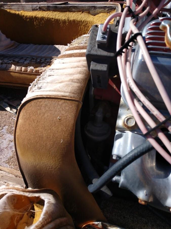

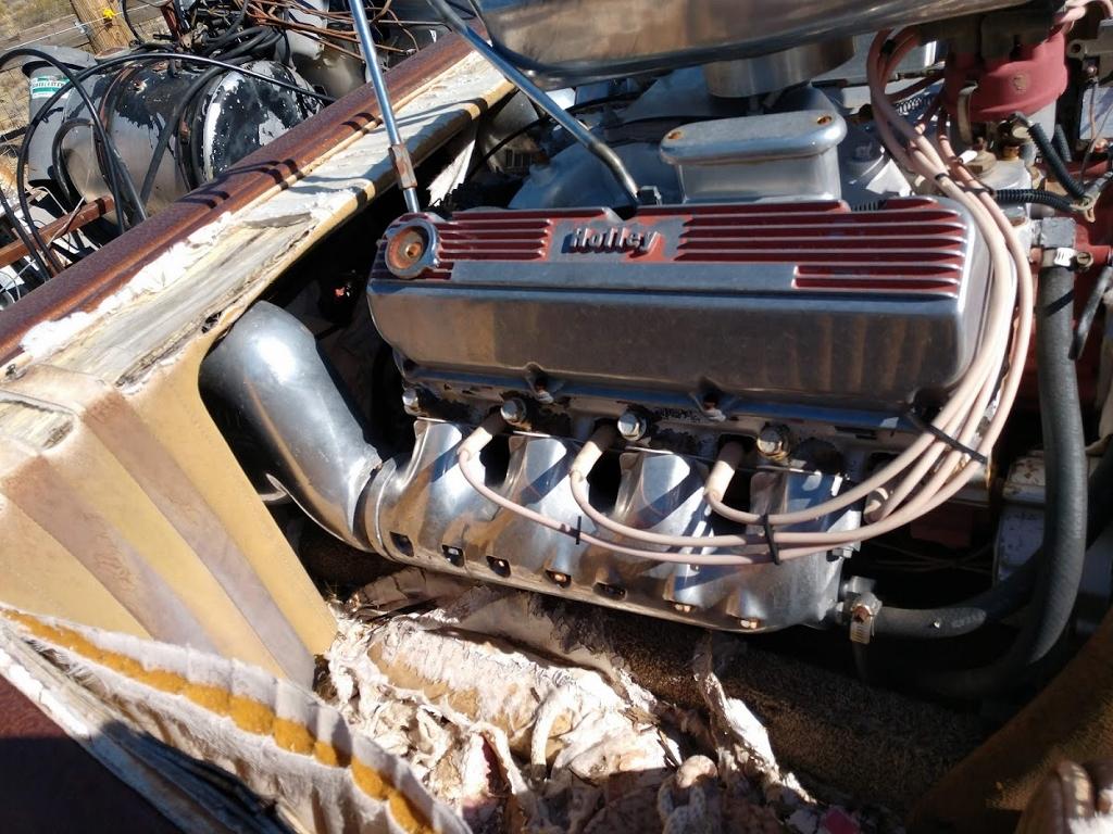

kermn8r Posted May 17, 2022 Share Posted May 17, 2022 Paul, I hope I can add to the topic of cooling. The attached photos show a friend's old jet boat. On the view of the starboard exhaust manifold, you can see a hose running from the bottom of the boat to the intake manifold. I didn't get a photo of under the engine, but I believe this is a water intake. You can also see a hose going into the end of the exhaust manifold. It doesn't show in the photo, but it comes from the water pump. I also included some other photos of this boat, which show some of the cooling system if you look hard. As this boat was run in fresh water, it did not use a heat exchanger as there was no concern getting salt water into the engine internals. The boat's transom, where the boat ends, is at the brown line. The rest of the stuff in the background of the photo with a tank and hoses is something else from his yard. Being a jet board, the engine is mounted with the front of the engine facing the front of the boat and the rear connected directly to the jet pump.Notice that the exhaust manifolds are oriented in the same way as in a wheeled vehicle. Also, he was using exhaust manifolds that were routed out the back of the transom, rather than the more common header like wet stacks. In the photo of the blue engine above, the manifolds are mounted backwards, which leads me to believe this engine was set up for an inboard V-drive, with the rear of the engine facing to the front with a shaft going forward to a V-drive. Another shaft would come out of the bottom of the V-drive and run rearward to the prop. The engine in the photo below that is also set up for a V-drive, as you can see the housing for the shaft to the pop below the shaft coming from the engine. BTW, I am really digging that Power Wagon. Quote Link to comment Share on other sites More sharing options...
Paul Payne Posted May 17, 2022 Author Share Posted May 17, 2022 Walt, thanks for sharing! More great reference photos! Thanks also for the comments on the Power Wagon- wait until I post it in Under Glass- it's almost done................... Plan on taking it to the Hoosier Model Club show and flea market. Quote Link to comment Share on other sites More sharing options...
