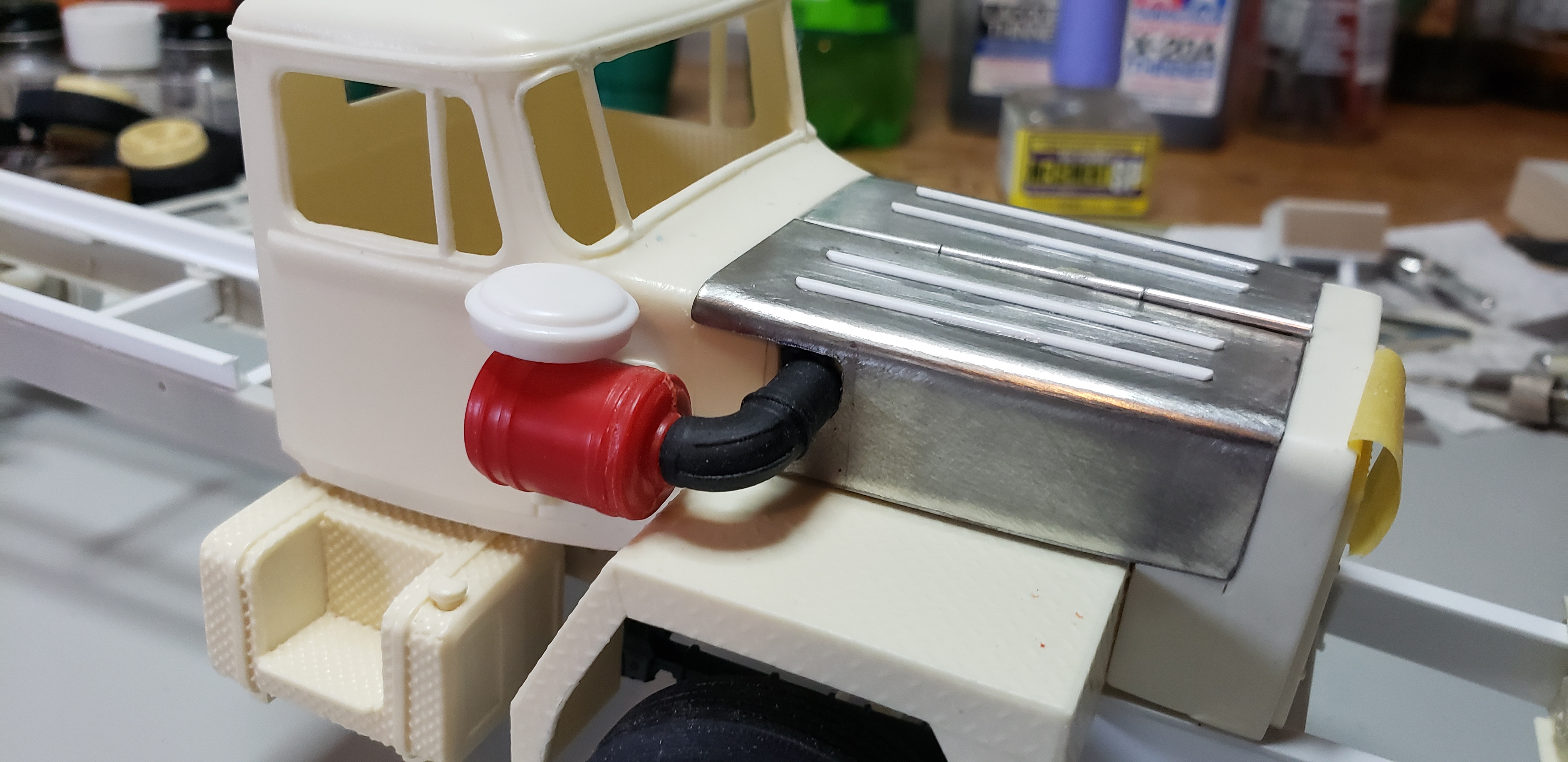

I went back and forth about which air cleaner this truck would have. The cab comes with the Farr square dry filter, but plenty of photos showed a round canister type w a domed intake top. Scrounging thru my depleted parts box yielded some MacK dm 800 parts I fashioned into a round  filter. the intake piping wanted to run into the hood, so an access cut was made . Next up is the exhaust pipes, then move onto the mixer portion again !!! hooray progress

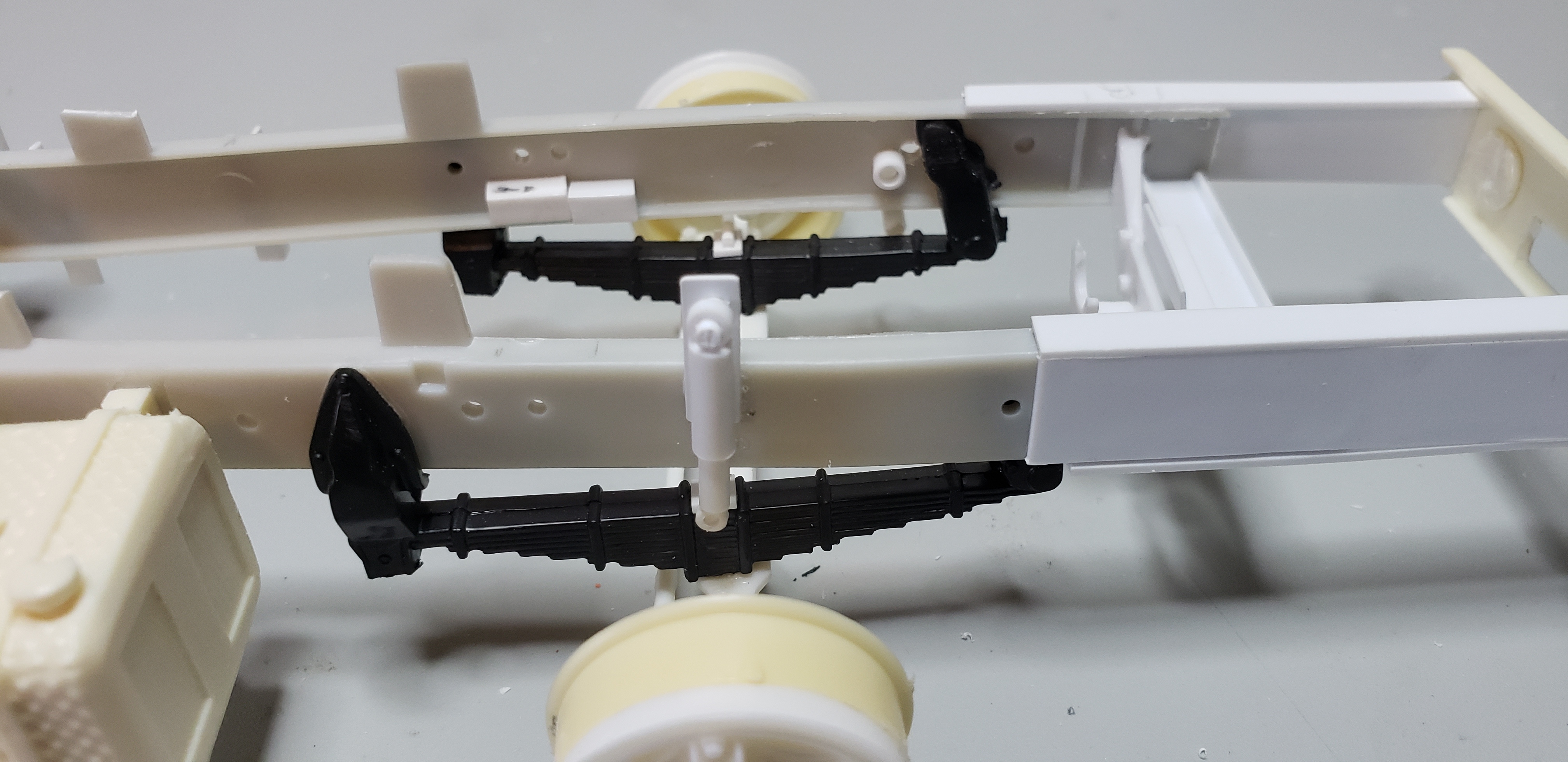

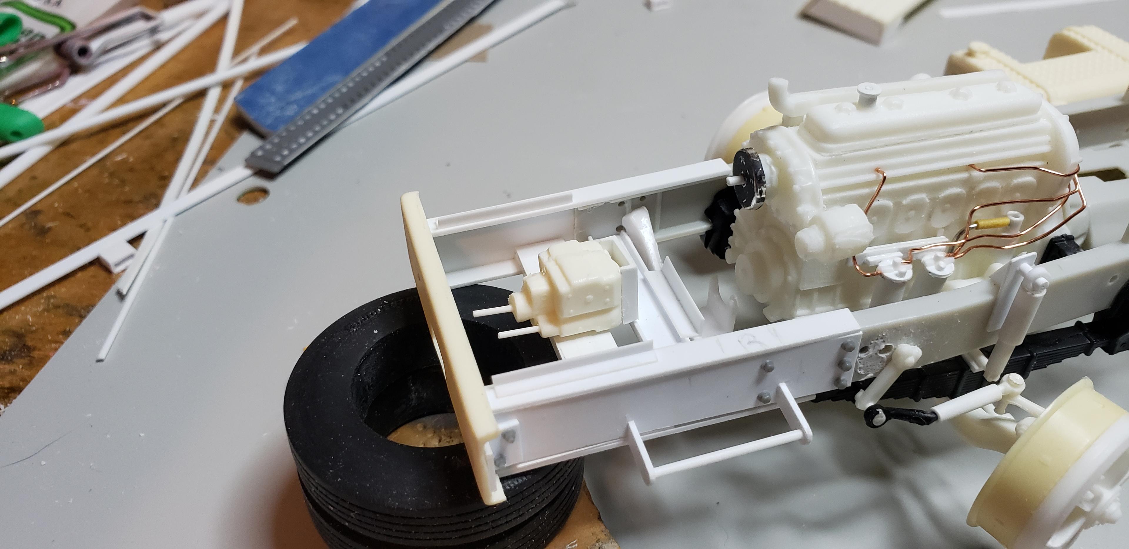

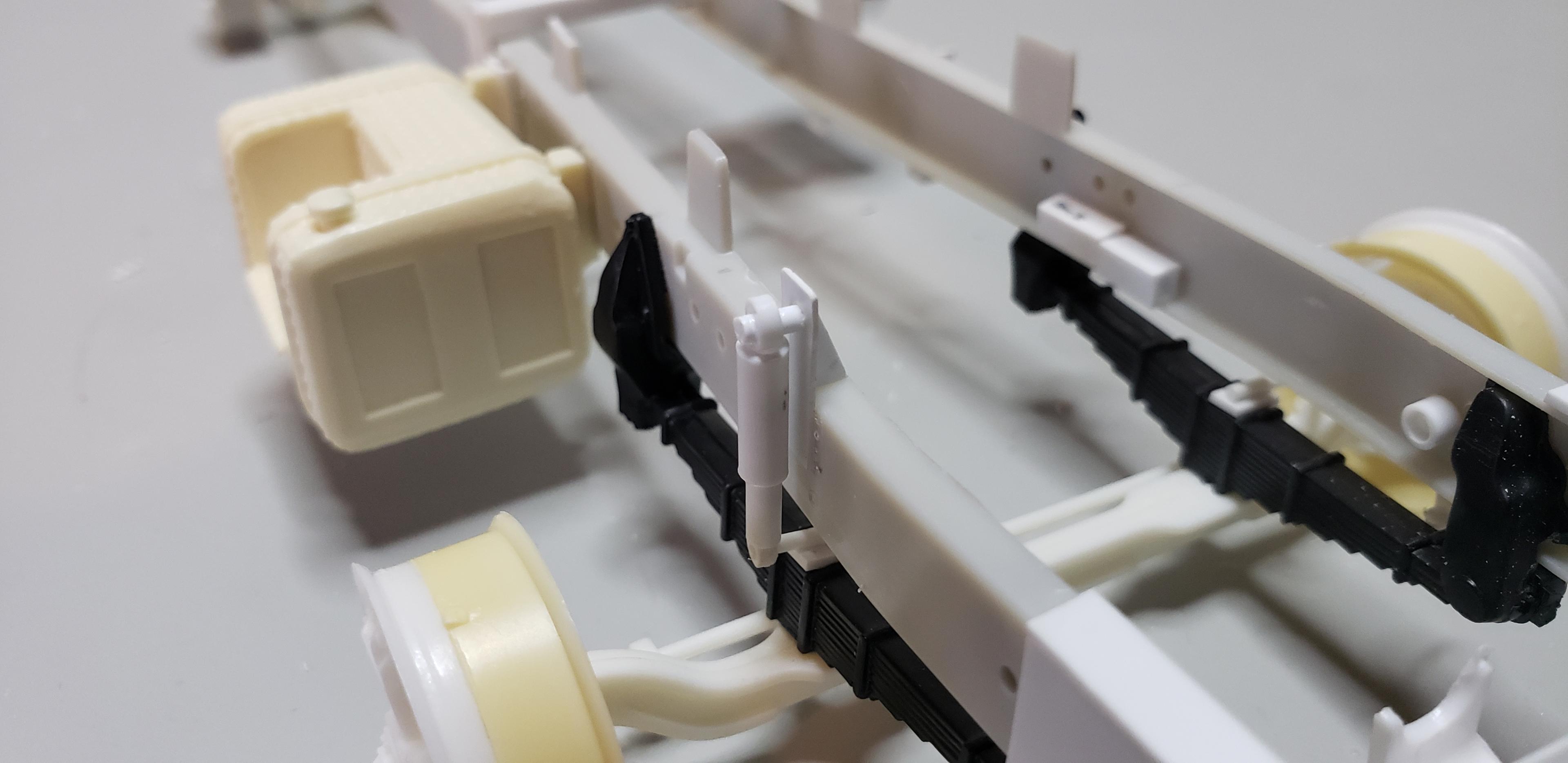

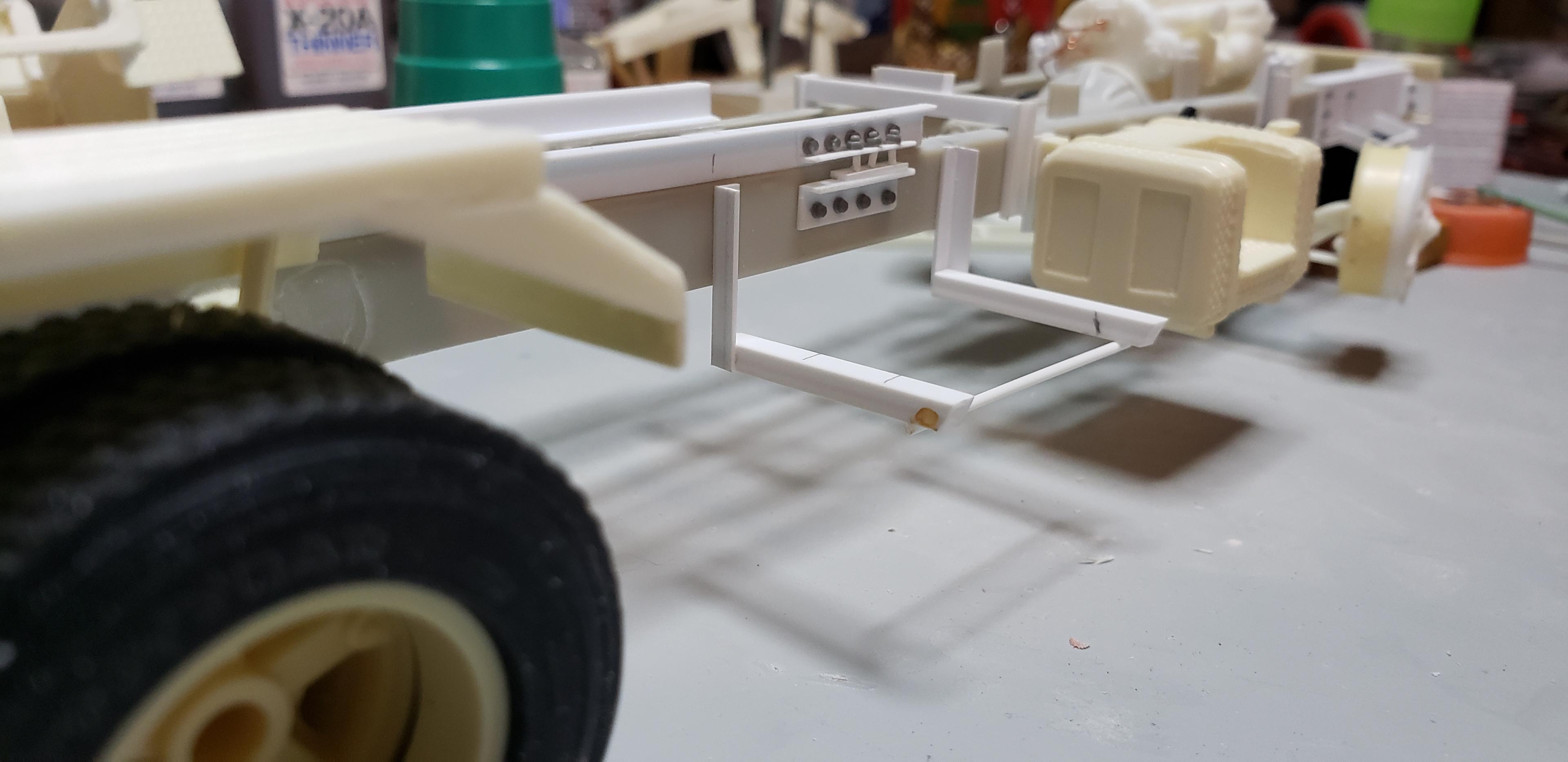

Small update for Friday !!! One part I neglected to build on my 1st Barney truck was the prominent front shocks . I hadn't finished the pitman arm anyway, so off I went . Couple sections of hollow tube, some hacked eyelets and quick mounts and their done !
I mentioned earlier making a new air cleaner body..ill drop them here ! You can see the hood cut out I added for the rubber plumbing.  The red plastic is a dead give away to where I stole the parts lol

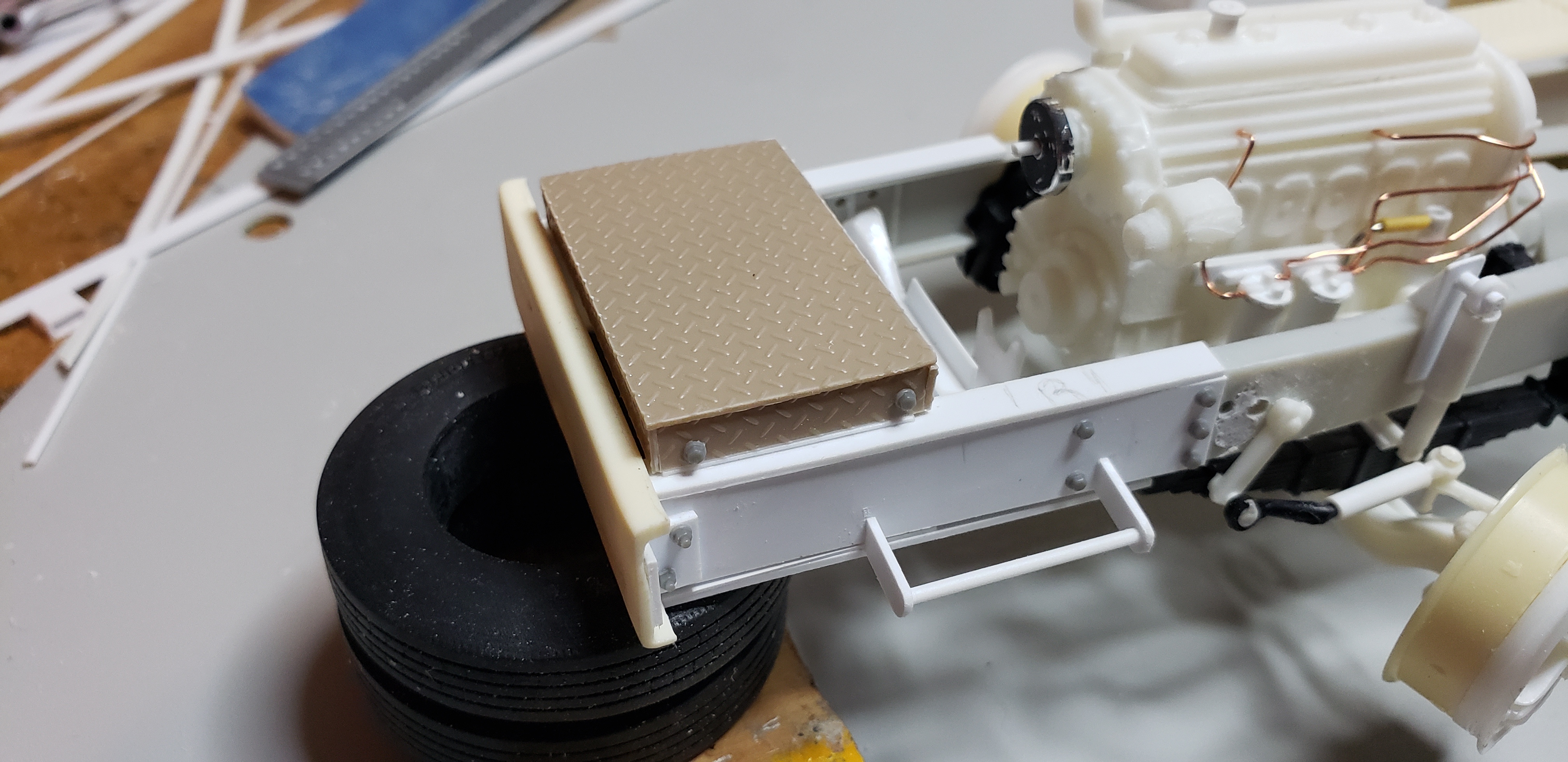

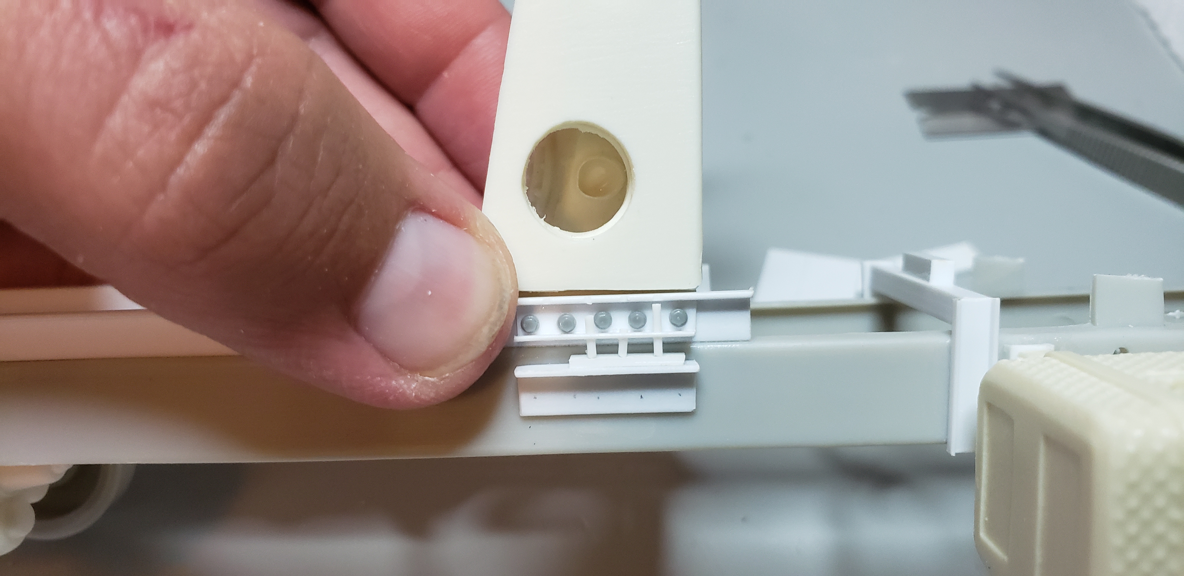

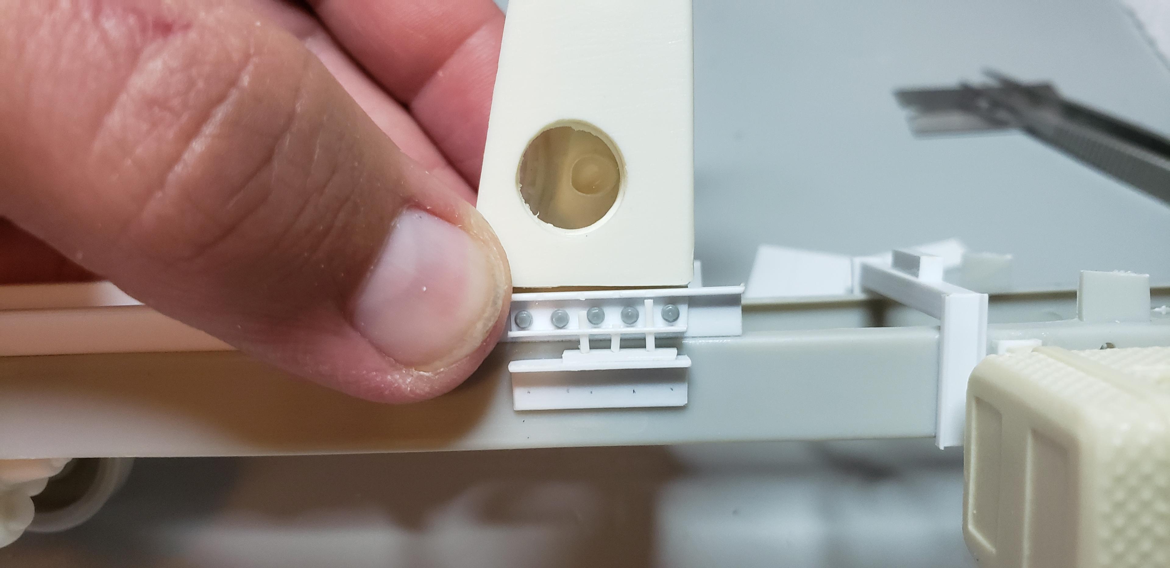

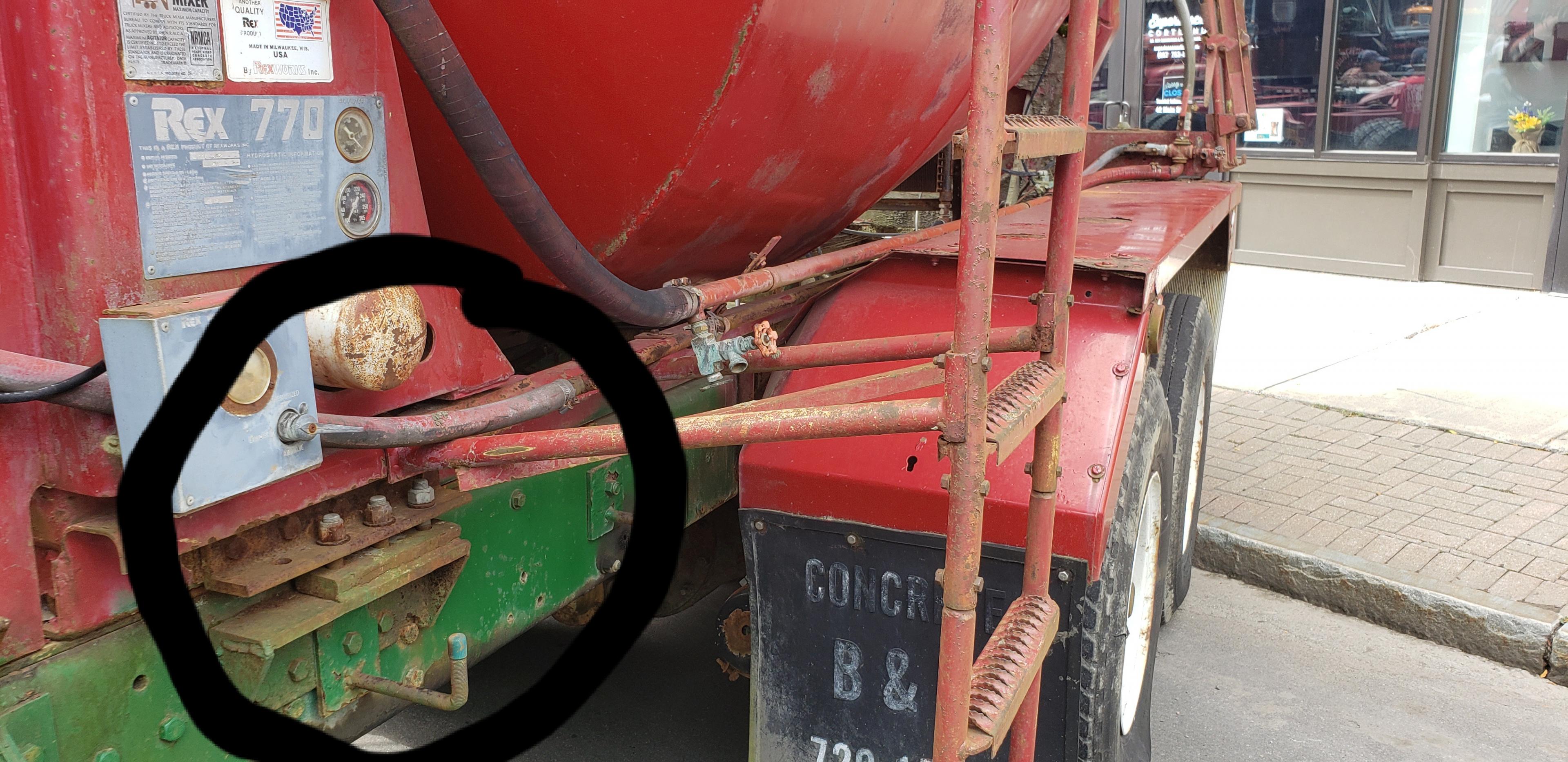

One other glaring  bare spot I kept noticing , the shim support  blocks below the front pedestal mount . A few bits of angle, strip and rod gave a satisfactory part
Here's the part I attempted ..those small hooks are too interesting to leave off , thats next on the list
I'll detail them out w more meng hardware, check that off list

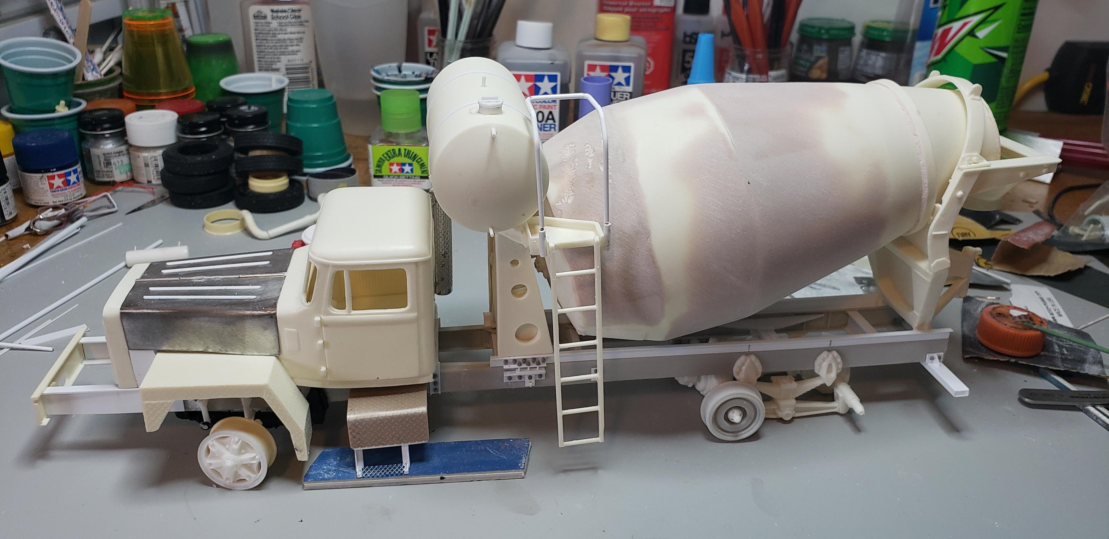

Mock up day ! I started detailing out the water tank, and bent up the guard rail using my favorite butyl covered wire . Now to finish the body work on the drum and get some primer on

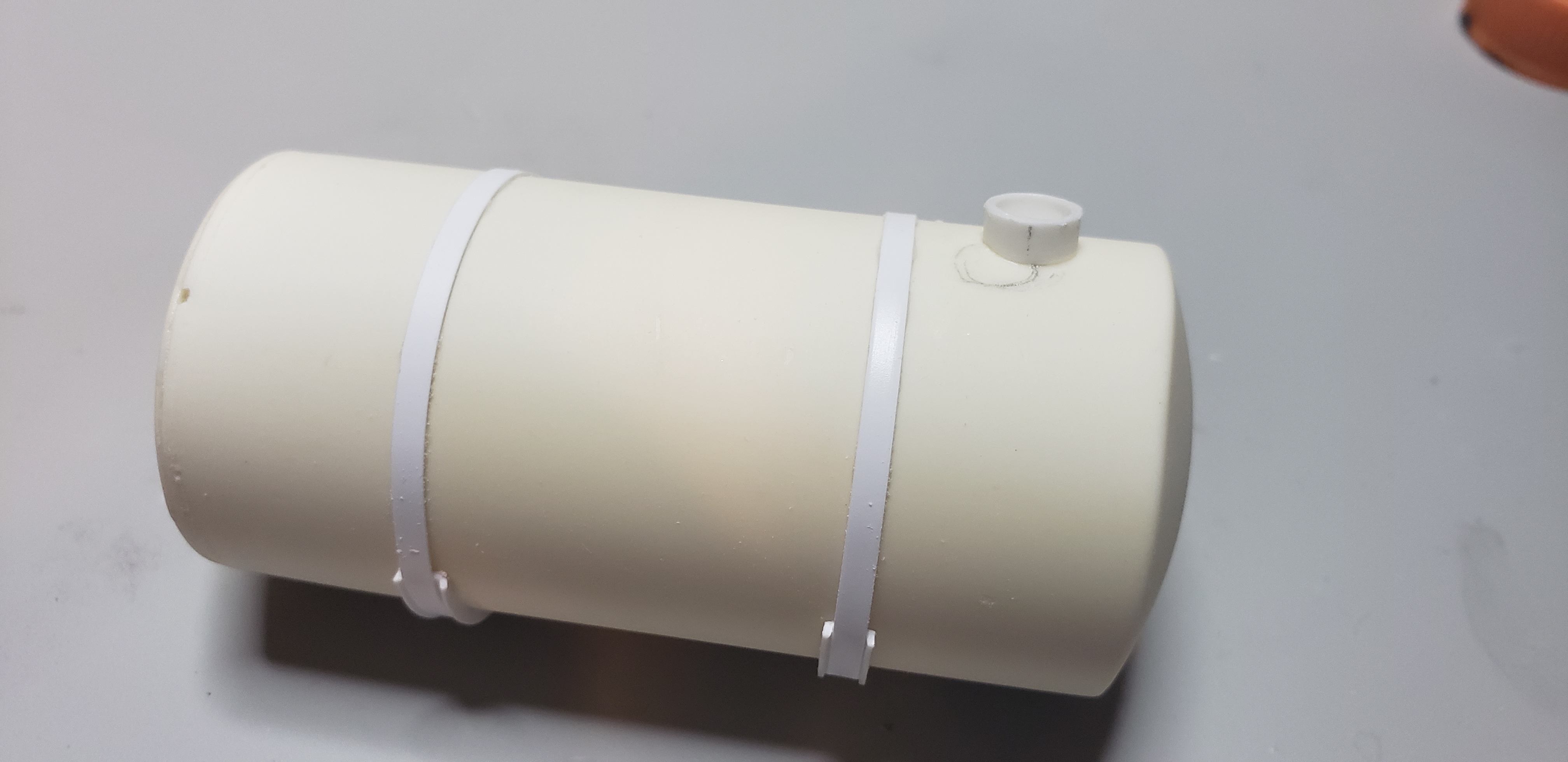

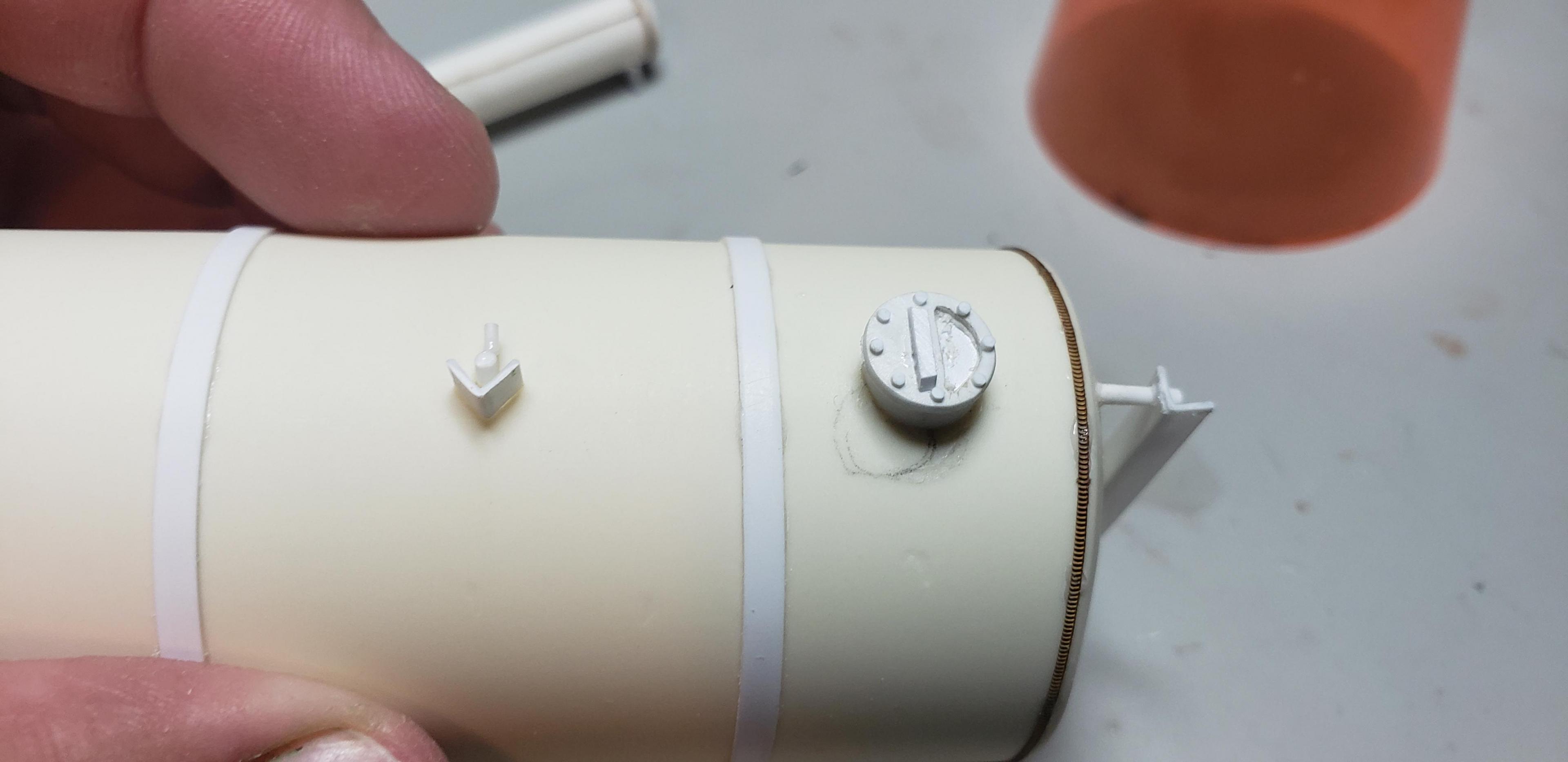

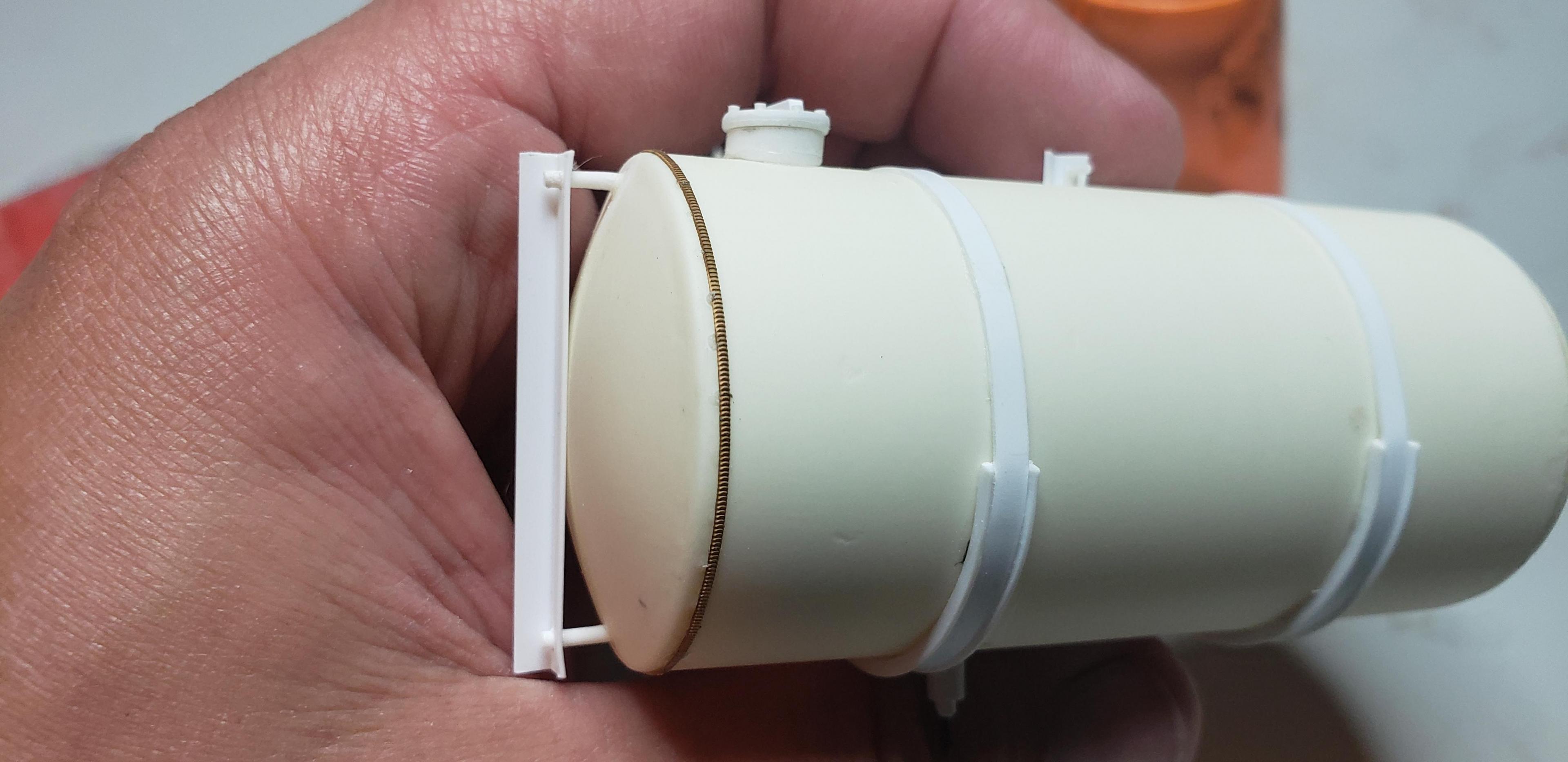

The water tank was a giant focal point hanging on top..studying photos showed straps , water fill port, water drains  plus all the associated air fittings to pressurize the tank . Starting with C channel for the rubber pads..then wrapped .015 strap around the tank . The fill port is some rou d tube w a cap . Later meng bolts will liven it up
Mock up Monday!! The truck really starts to look enormous now ..better recheck the air in the tires

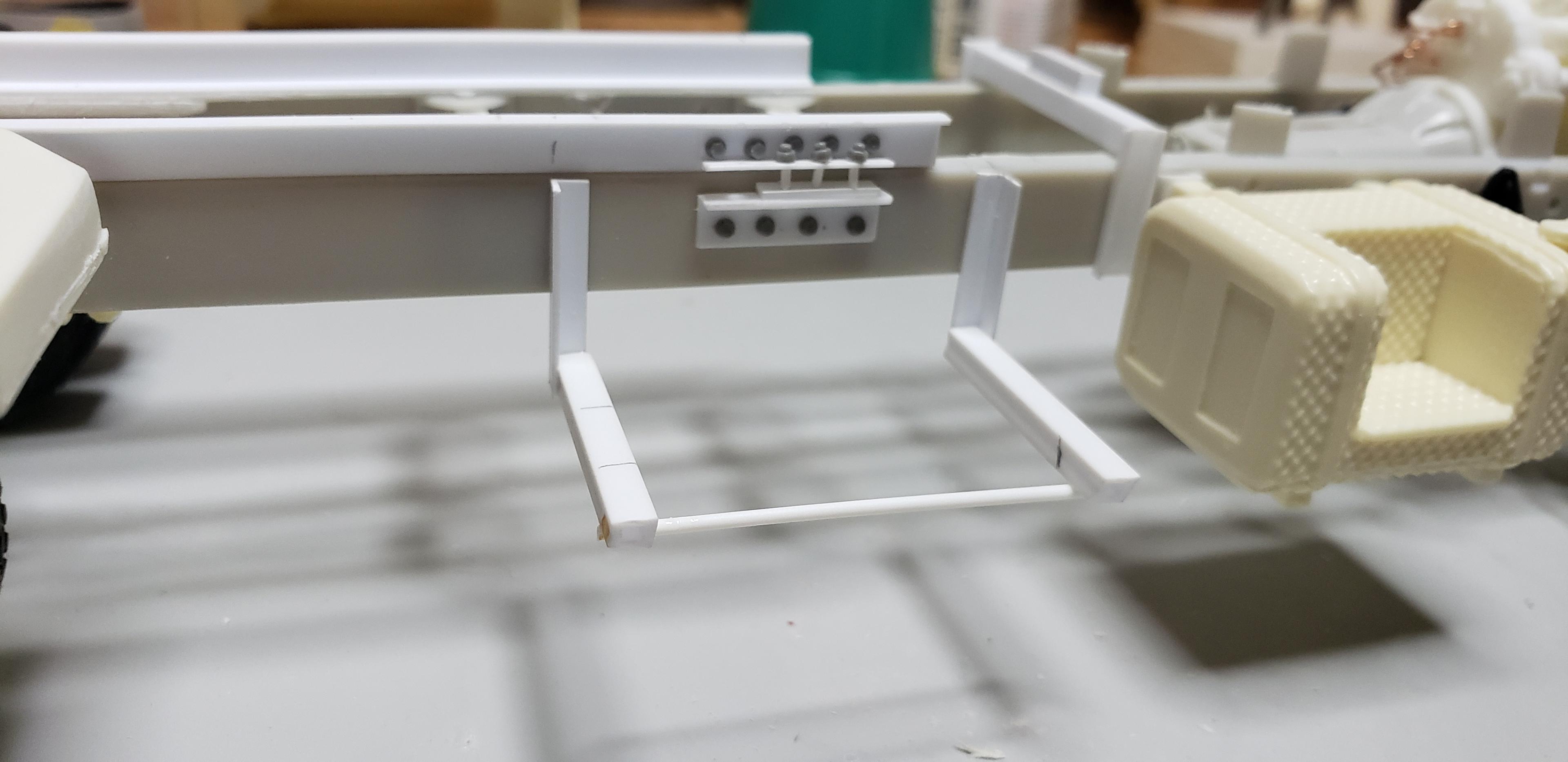

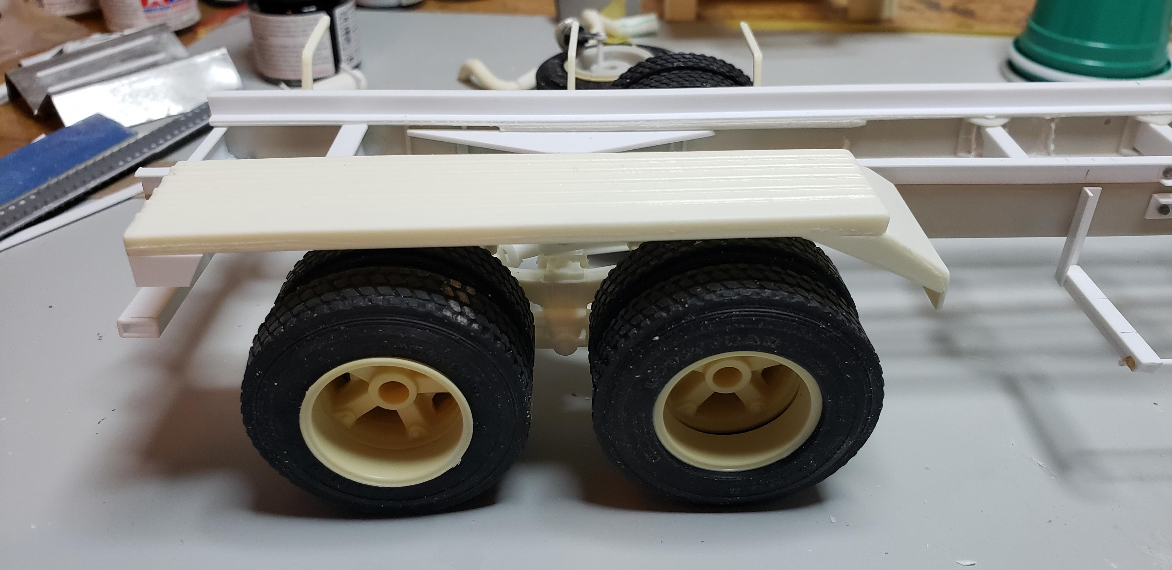

Another update for manic Monday!  I wanted to deal with another issue I recall from the last build . The stock rear fenders are extra long , allowing for tag axles or tri axle set ups..but will need shortened for a tandem. I installed the supplied hangers , mocked up the fenders and eyeballed the desired length.
Barney trucks ran their fenders backwards,  so after cutting around 3/4" inch of them, I just replaced the tail light panel and side marker light plate .

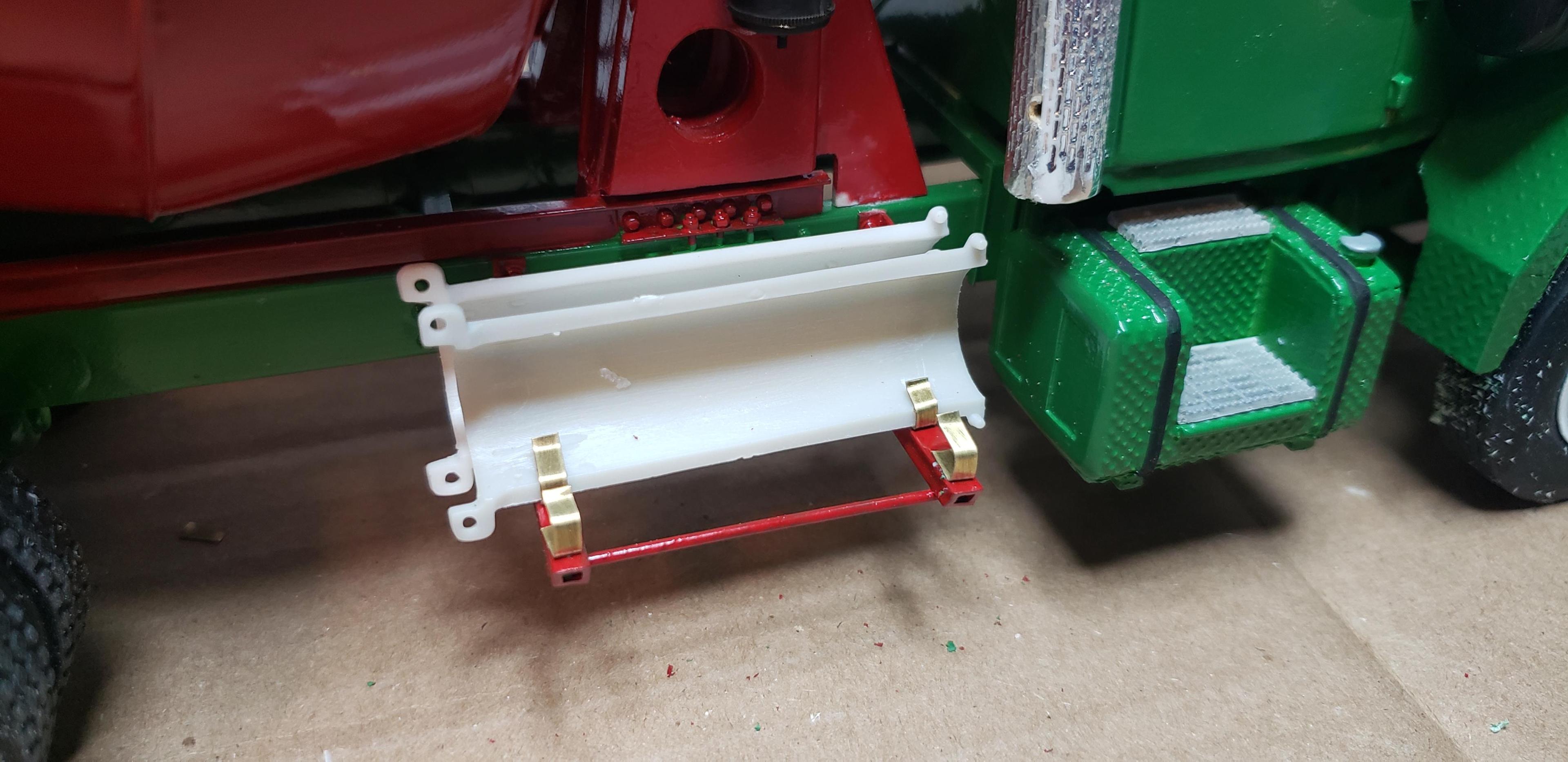

Ref photos showed a cool shop crafted chute rack. A few pieces of angle and square tube later I had a rack . I need to add the cleats still for the individual chutes.

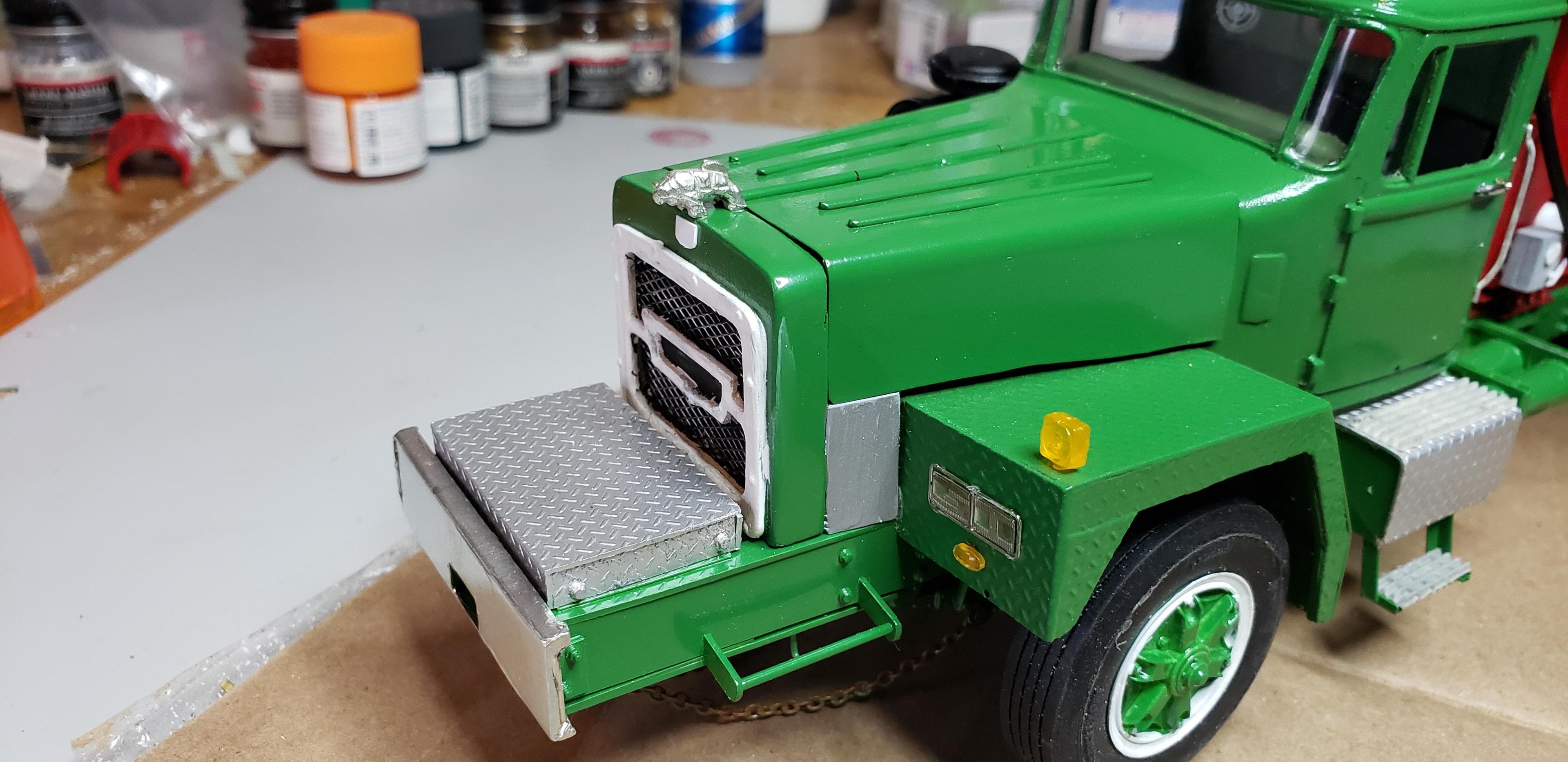

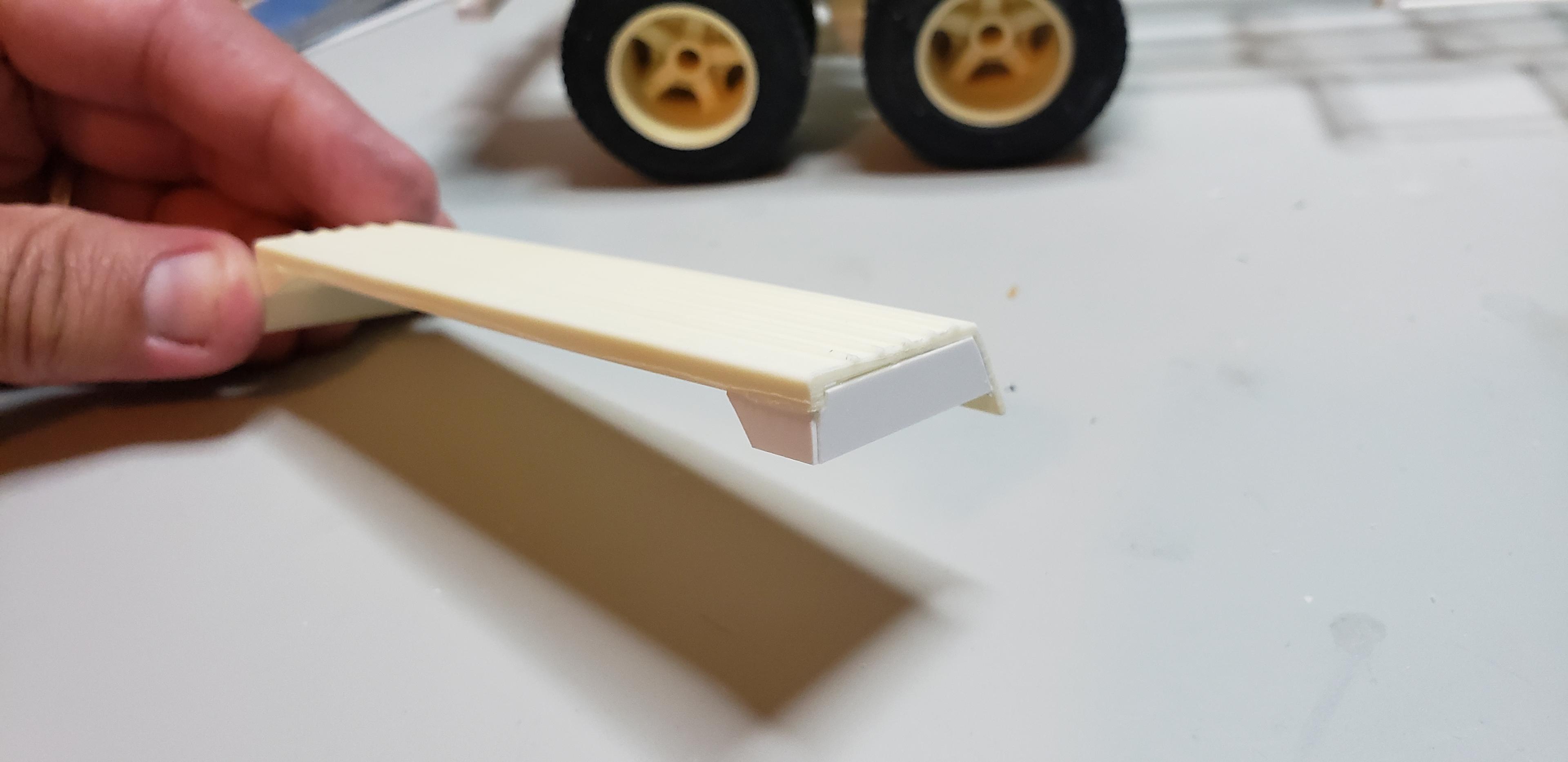

Lastly they commonly had a fabricated cover over their front mounted pto pump. I actually built 2 covers , unable to chose between plastruct  diamond plate / flat stock..the diamond plate cover won out .Visible is the frame mounted grab bars too...another BD shop modification. Just before painting the trademark tow chain hanging under the bumper extension will get added too

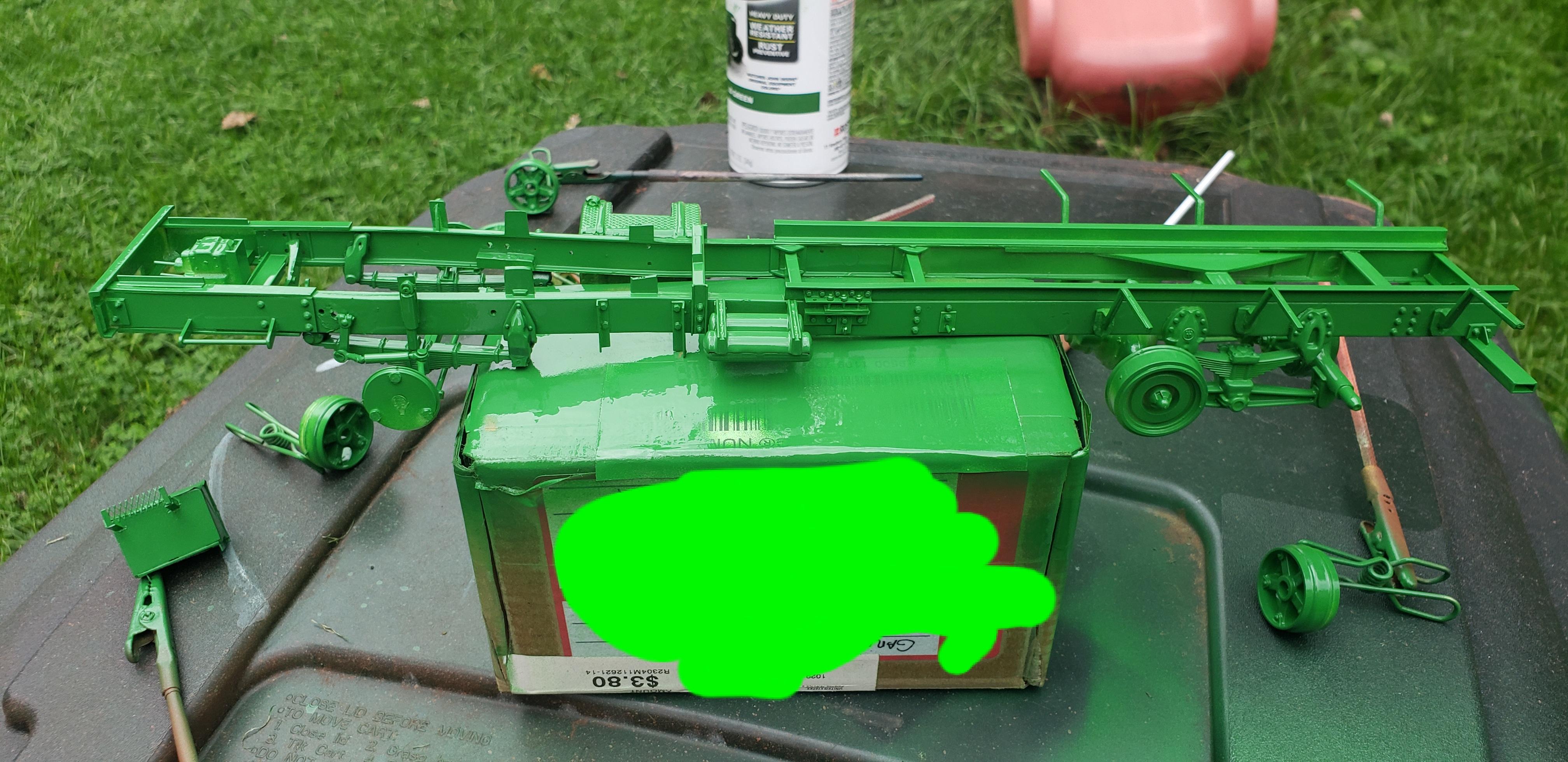

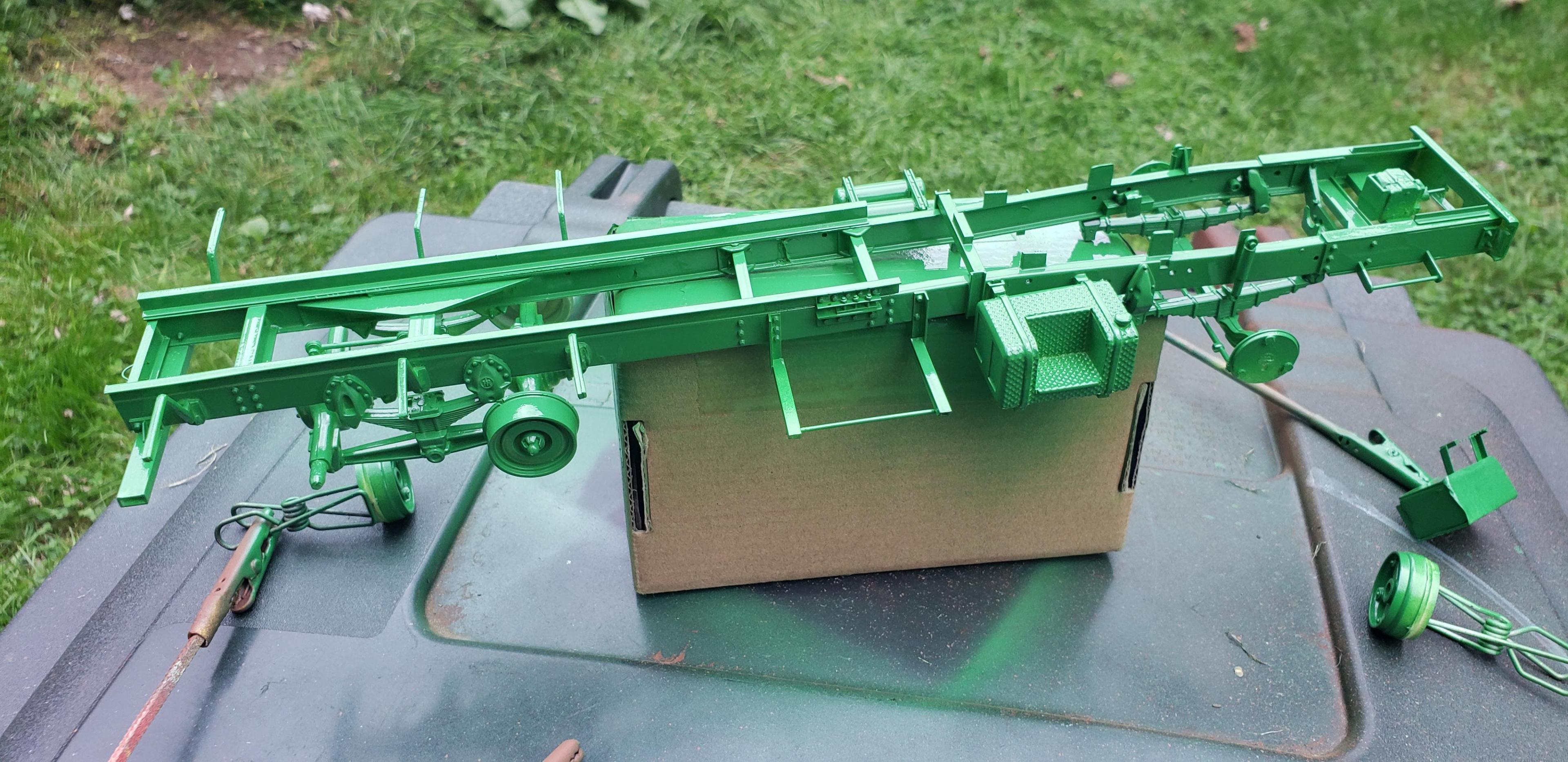

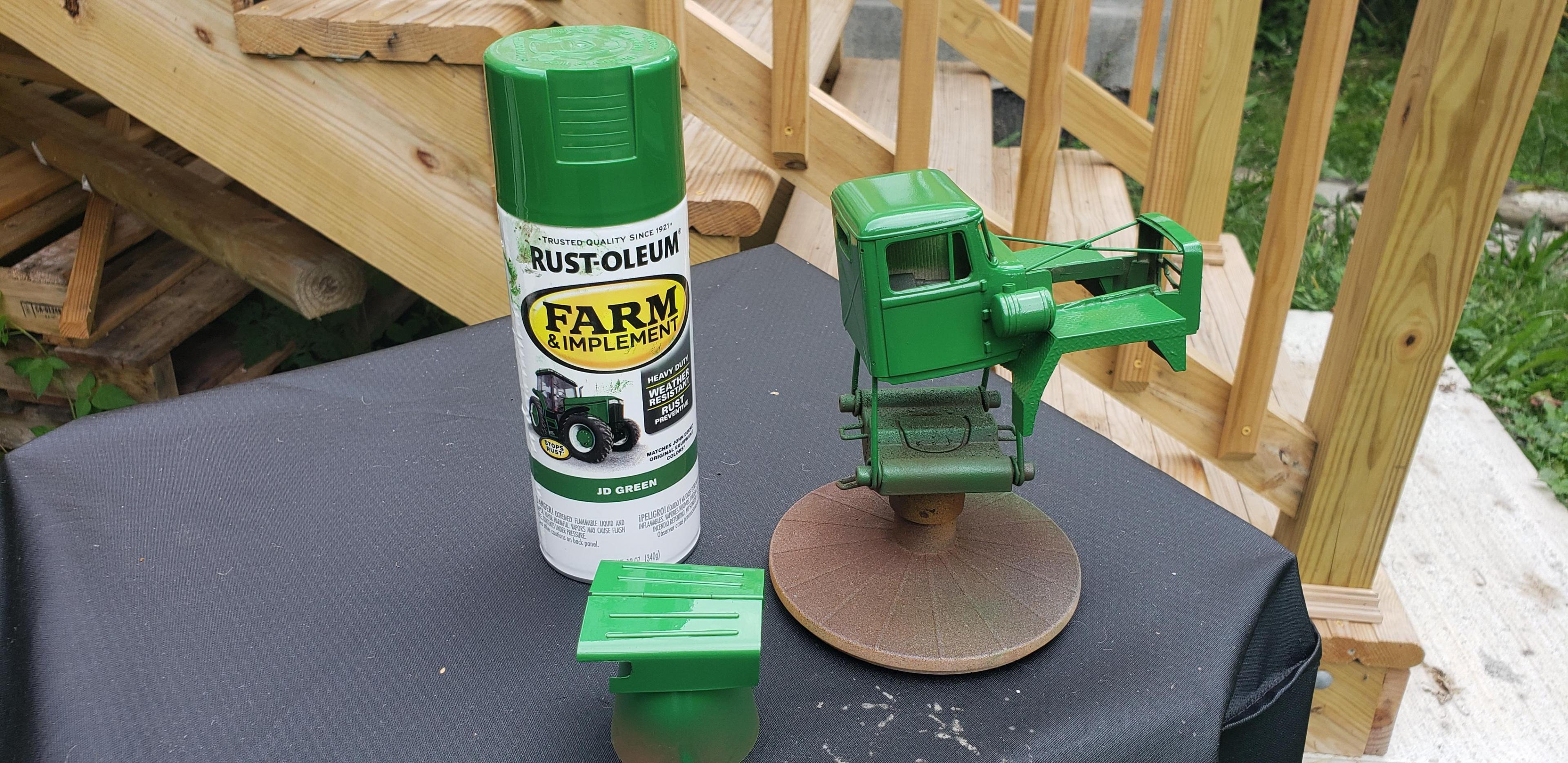

Took daughters 1st school day off...what better to do to pass the time then PAINT!!!
I sprayed the cab, hood , wheels and frame outside.  Using the implement paint over 5 different colors on the frame surprised me with the quick coverage . 2 light coats had everything even and still showed all the details .
The rest will be regal red,  then detail painting will break up the monotony
  • Like 1

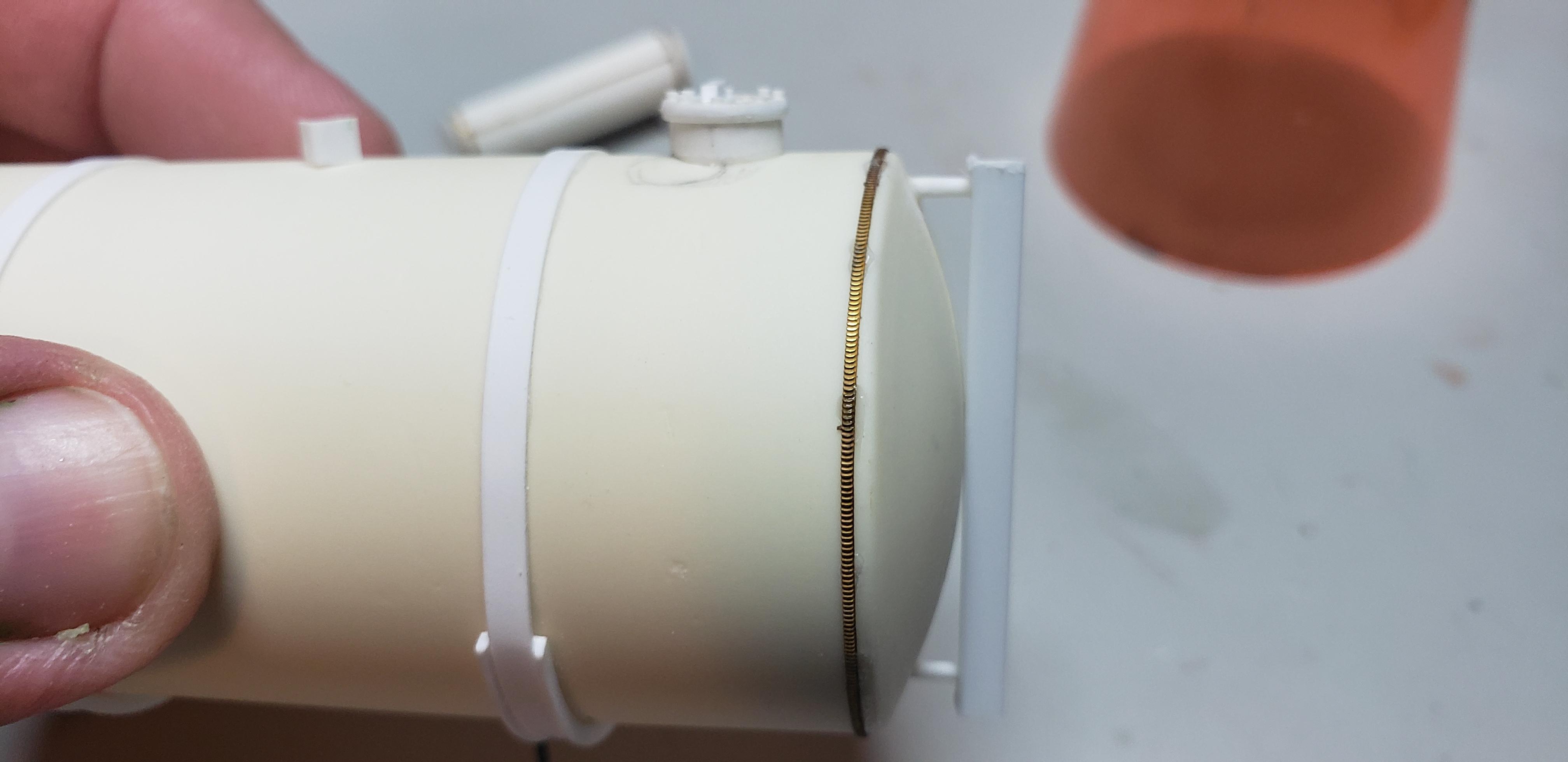

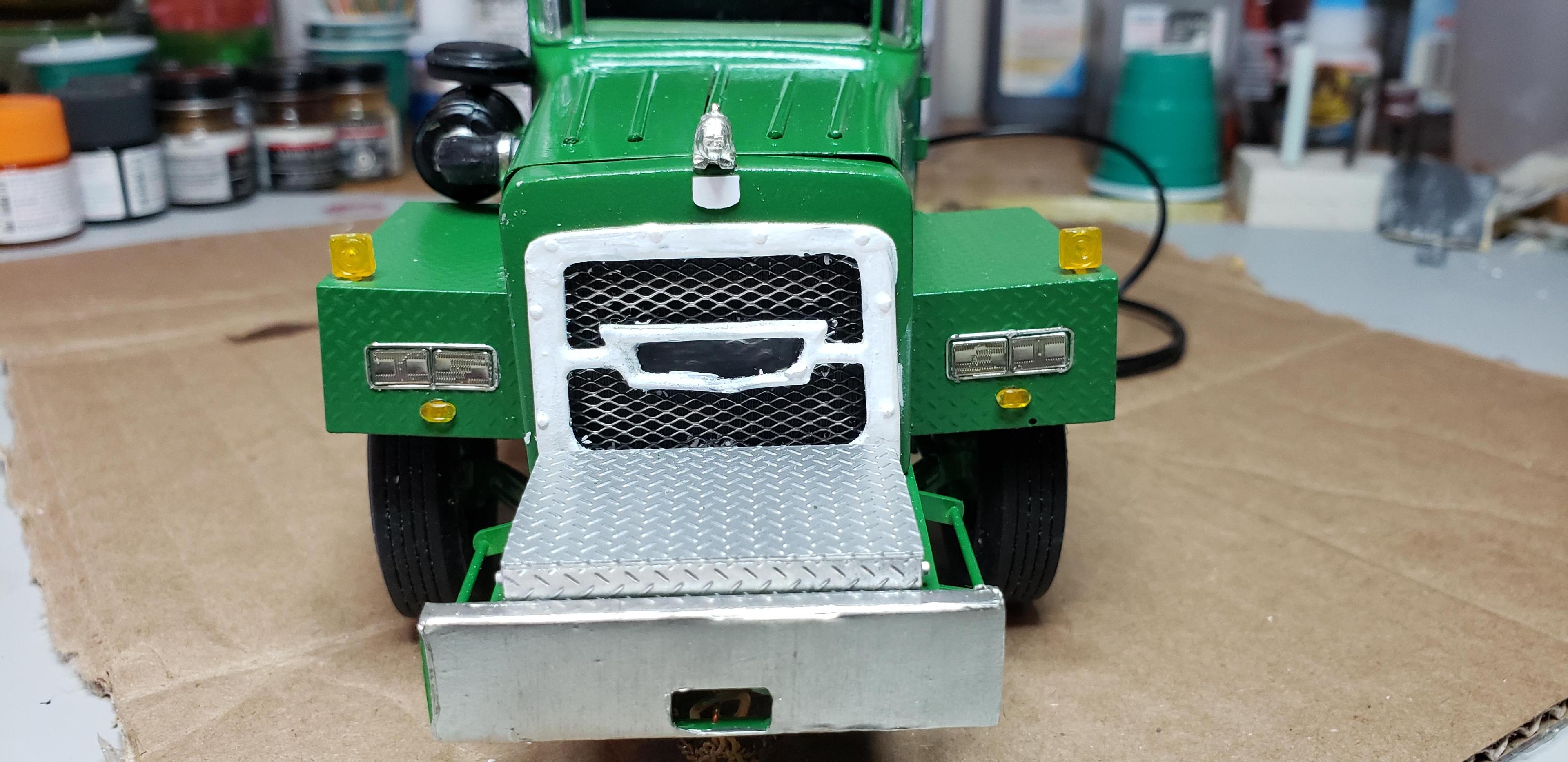

I kept looking at the giant water tank , and decided it needed weld beads. CTM makes fantastic pe weld beads , and fortunately I had a few extra pieces from my Heil trailer.  The water fill port got a few missing bolt heads , and the pressurized air fitting on top now has the brush guard.  I kept looking at the tanks from my photos and realized what that piece of angle was for ..let's add it ! Now its ready for prime time

I like your details on the water tank Jeff. Looks like the angle iron is for a level gauge.
Thanks ! I'm getting a little carried away adding stuff , but I have the time to make it look correct .
Yep thats the water level gage spot . After paint , ill add a clear rod to the fittings

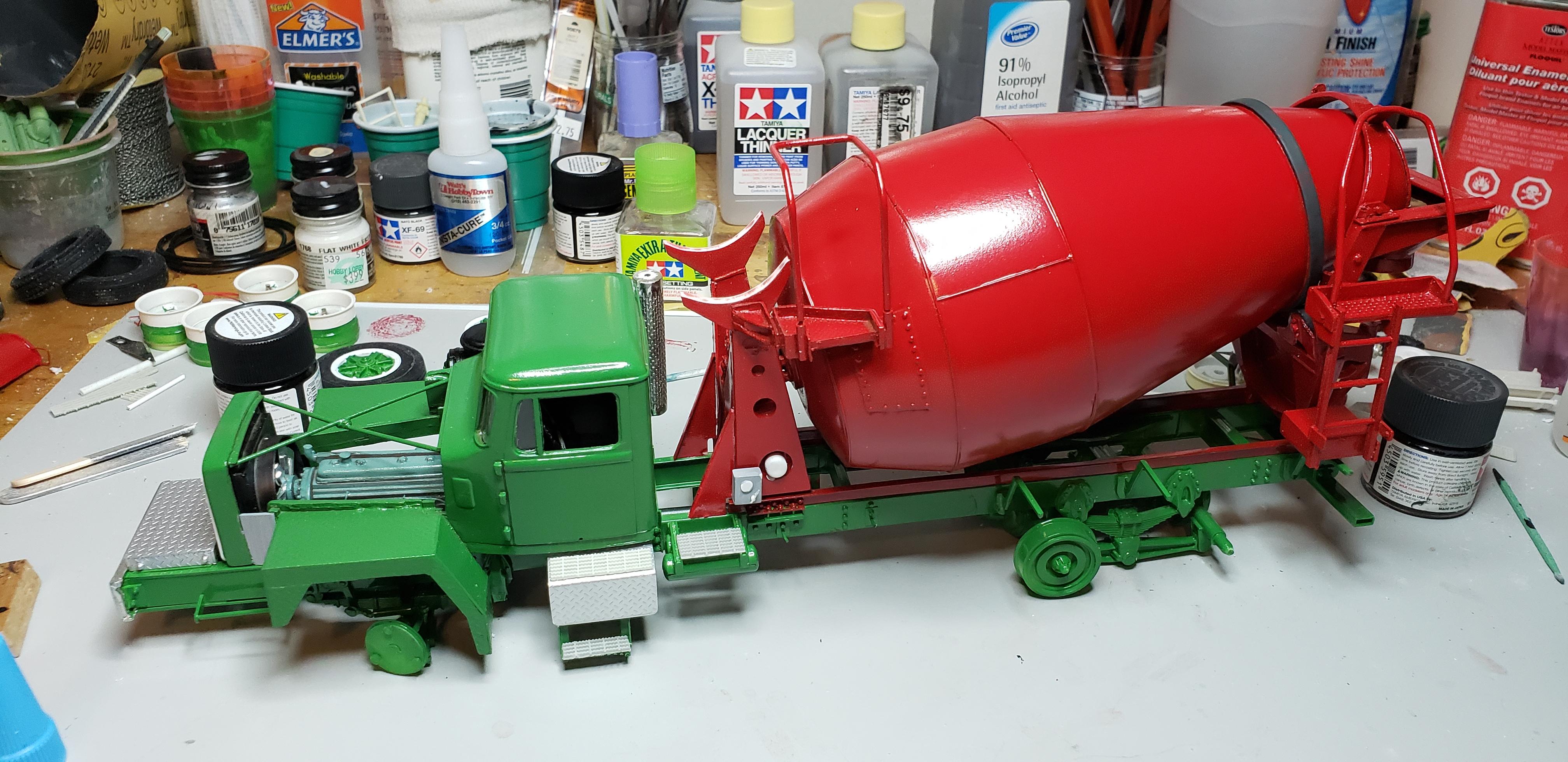

I had a few hrs to putter with the mixer , I ended up installing the cab, main mixer unit and odd details while larger sections dried.

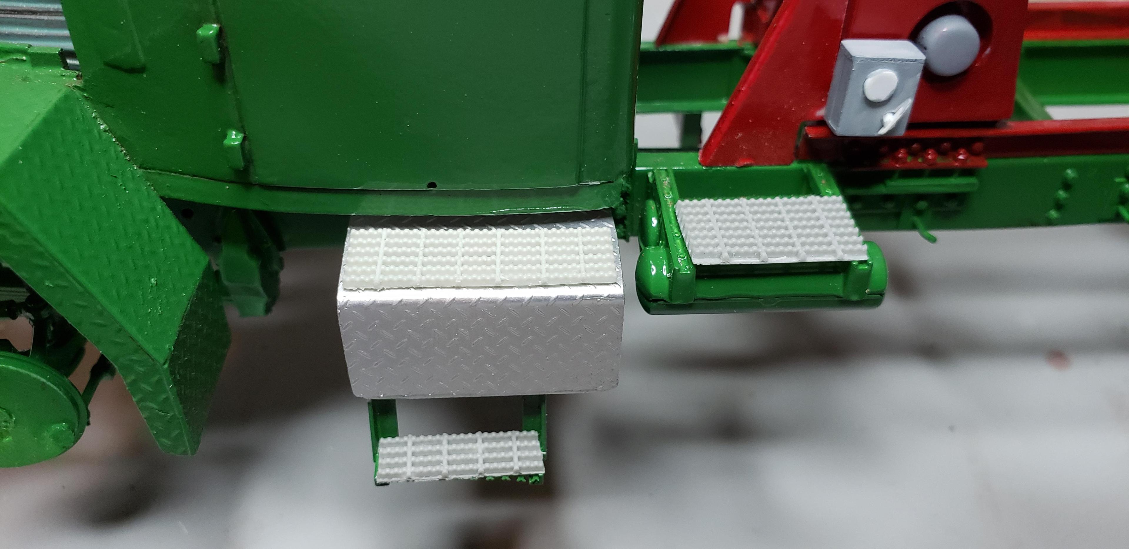

I found a package of deck plates from moluminum id ordered that I'd forgotten about,  and decided the walking areas needed some boot scrapers.  The fuel tank, battery box and the side air tank rack had small pieces attached.
I'm really close to final assembly now that its looking more like a mixer.
Once everything is installed..the fun part begins..this won't be a clean truck .

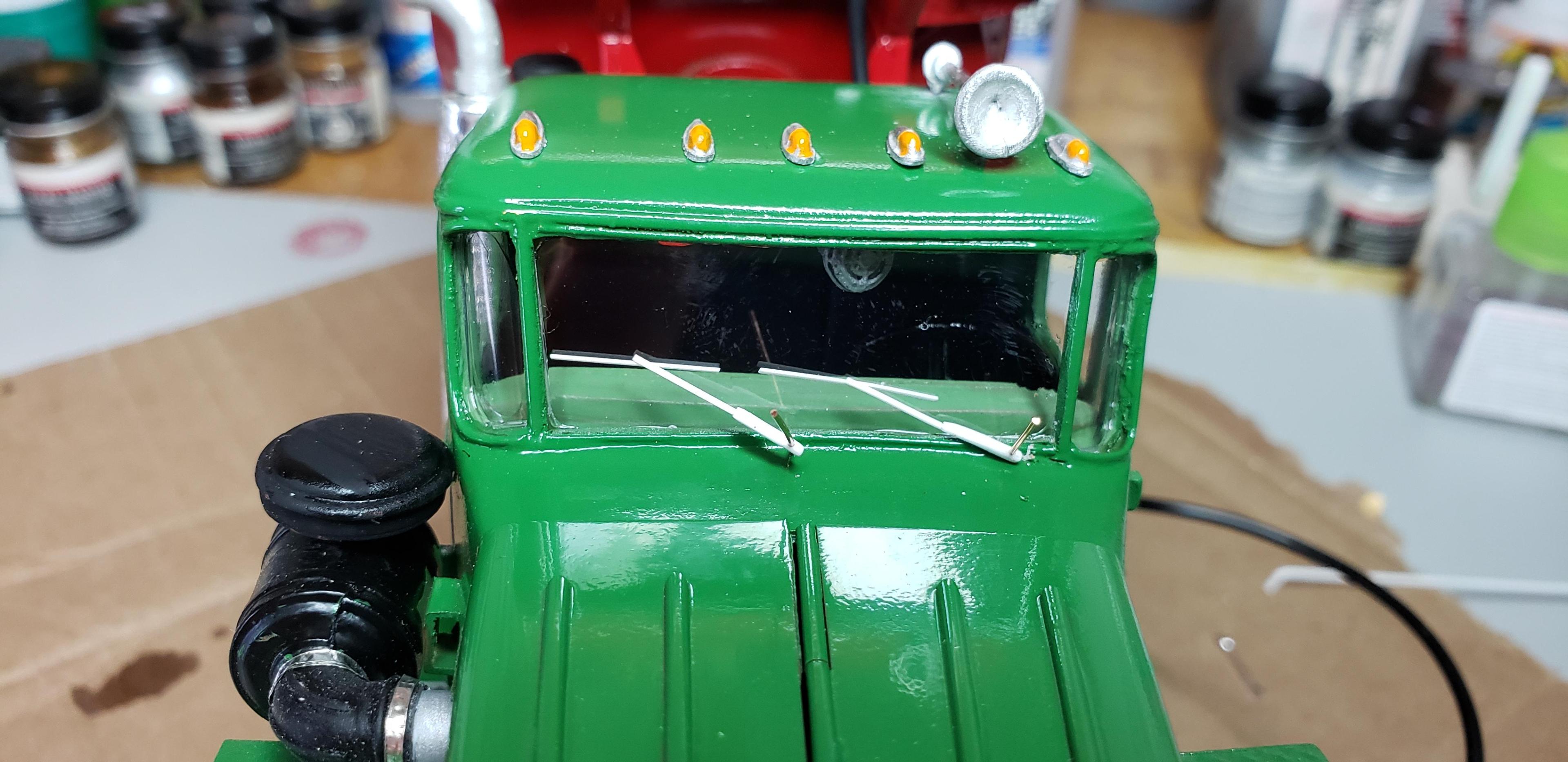

The eyeballs got worked last night fabbing up the windshield wipers . The main arm is 040 rod, w 10x20 strip . The actual wiper blade is also 10x20 glued on edge..kit parts are horribly thick.
Now the wipers ..their just pinned in place right now to check the shape then ill brush some dull metal / black over parts . The rubber seal around glass was ignored too..oops

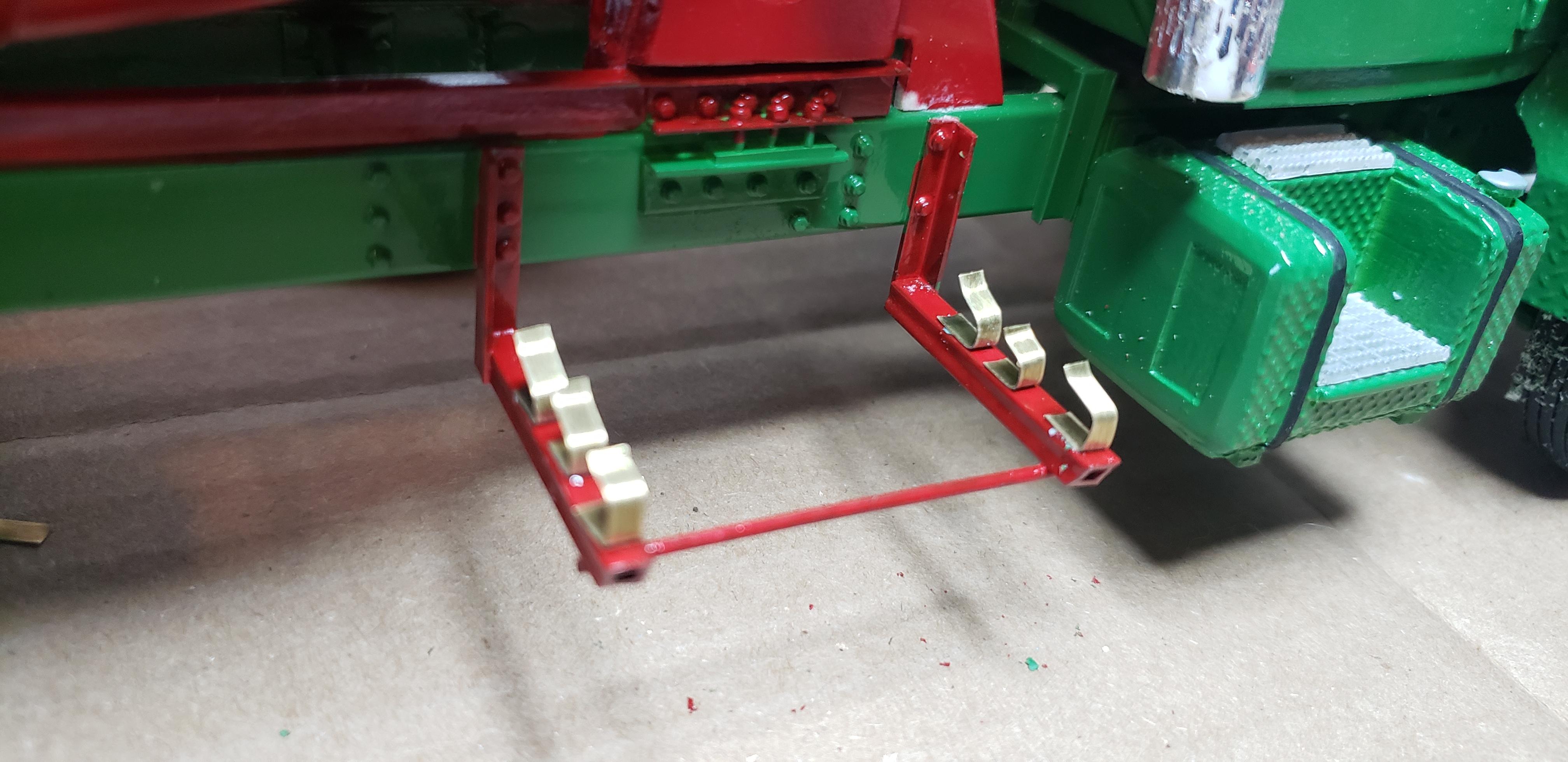

The extra chute rack needed cleats , strips of scrap brass looked to scale. Mocked up w chutes in place .

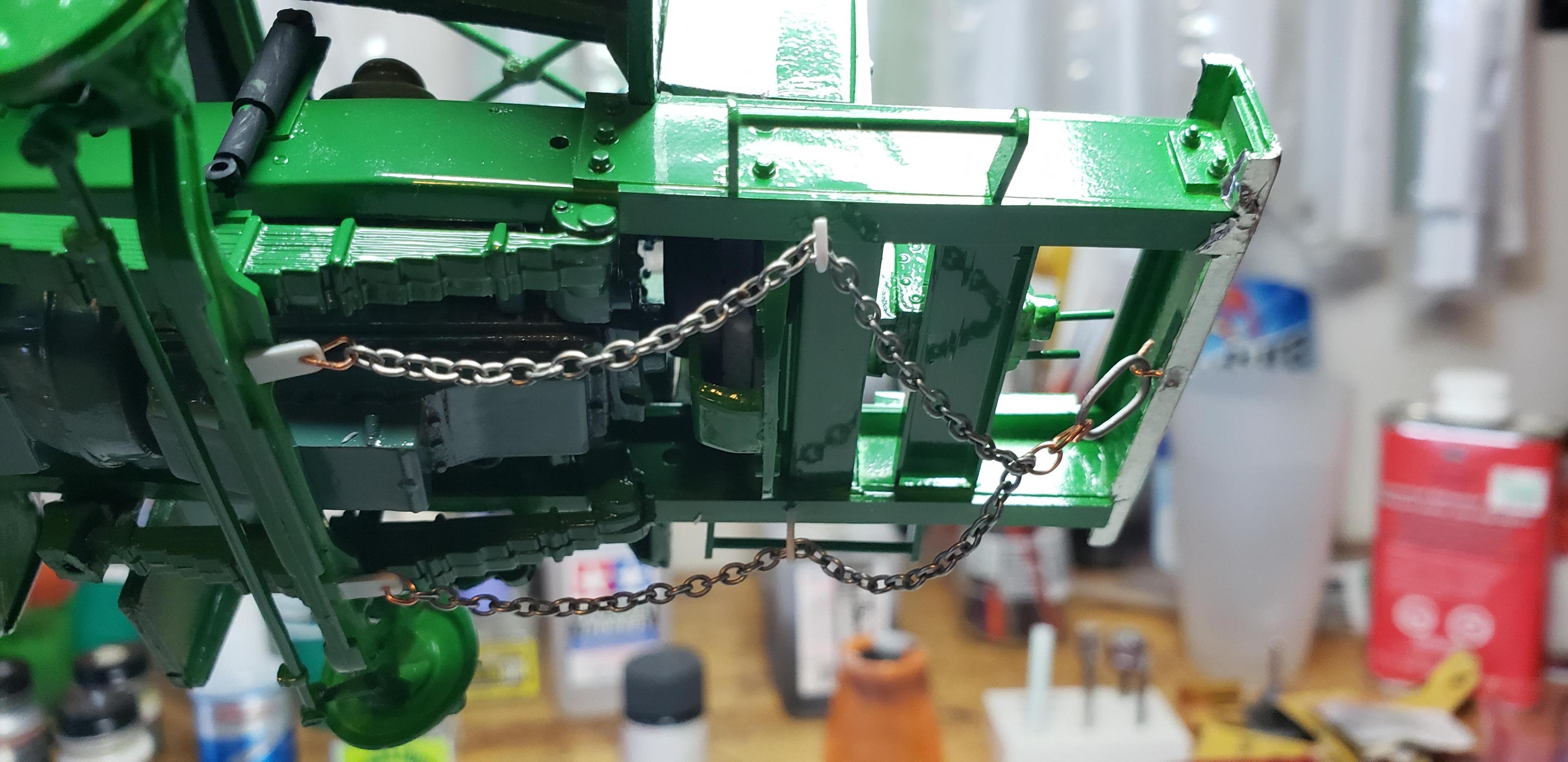

Lastly the Barney mixer would be amiss without its iconic log chains under the truck . Strips of 040 made the brackets , and chain from craft store i picked up doing the snow tire chains looked the best in scale . Ill dust these w rusty paint later

I really like your wipers, care to make me a dozen sets?   LOL!
I borrowed the idea from article in classic truck modeler .  Hardest part was setting the wiper angle without sliding off near the glass . Took a few tries on right side
