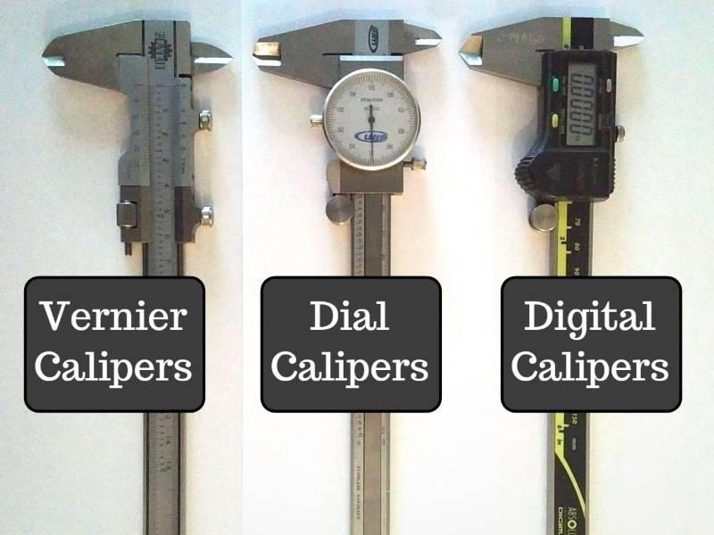

NOBLNG Posted March 23, 2021 Posted March 23, 2021 (edited) This is a link to Evergreen’s website. https://evergreenscalemodels.com/ This is Plastruct’s https://www.plastruct.com/ Invest in a dial caliper (or digital) and measure the frame you have. Then you can go to the website and get the number of the closest match. I find Evergreens website much easier to navigate than Plastruct. Edited March 24, 2021 by NOBLNG
Bainford Posted March 23, 2021 Posted March 23, 2021 (edited) NOBLING has great advice, invest in an inexpensive caliper. Absolutely necessary for good scratchbuilding. My personal preference, both professionally and in my hobby work, is a dial caliper. It would help to know what sizes you need in 1:1, but when working in 1:25 scale, the following Evergreen round stock will get you close; - #211 measures .040", equals 1" in scale - #221 measures 3/64" (.047"), equals just shy of 1.25" in scale - #222 measures 1/16" (.062"), equals 1.5" in scale - #212 measures .080", equals 2" in scale - #213 measures .100", equals 2.5" in scale There are other sizes both smaller and larger available, but these sizes should get you pretty close for most chassis work. If you look at the numbers above, you may notice a very handy conversion for working in 1/25 scale, and in most cases 1/24 scale as well. In 1/25 scale, 1" = .040". That makes the math easy; .020" = 1/2 inch, .060 + 1.5 inches, .080 = 2 inches, etc. Also, as has been pointed out on the forum in the past, 1 mm + .0397" (roughly). .0397" is only .0003" away from .040, a negligible amount in our hobby, so millimeters, for our intents and purposes, equals 1 inch in 1/25 scale. Very handy. Edited March 24, 2021 by Bainford

Mark Posted March 23, 2021 Posted March 23, 2021 If you are looking for rectangular tubing, say 2" x 3" in 1/25 scale, just do some math...it would work out to .08" x .12". Then just select the styrene stock closest to the desired size. If there is no exact match, go slightly undersize as the paint thickness will be out of scale. As for calipers, I like digital, even the cheap ones can switch between inch and metric. The calipers are indispensable, you will find all sorts of things to measure like scrap wire, tubing, and sheet plastic you round up from non-hobby sources. The battery will last much longer if you take it out between uses. I've had one for five or six years, still on the first battery.
