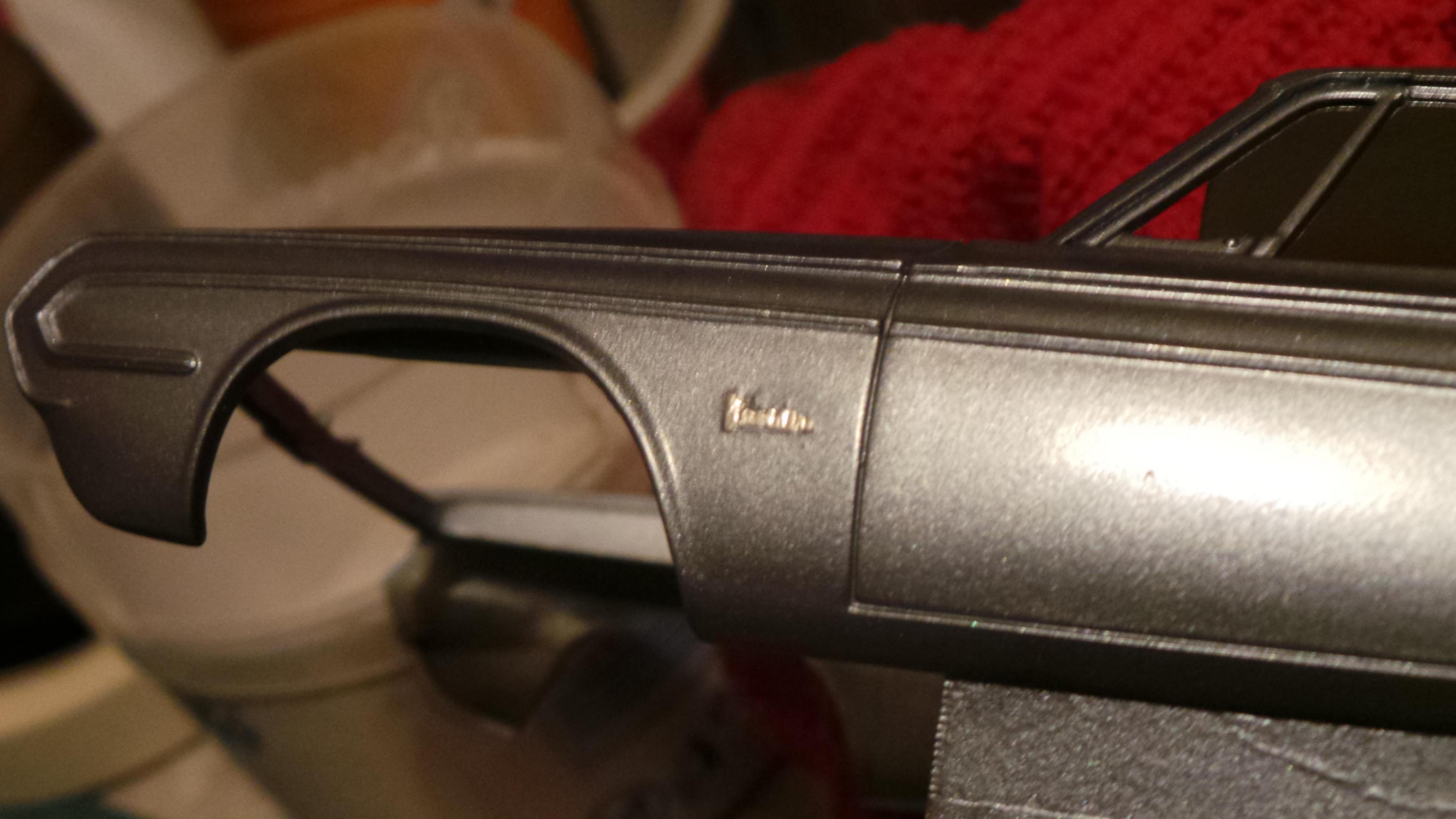

doorsovdoon Posted April 11, 2021 Author Posted April 11, 2021 I give the car about three coats of paint, I haven't put lacquer on as it'll polish up ok. The rear panel came out better than the front fenders which are pretty much unreadable, but they look far better than the blobs of Molotow I usually end up doing! After the paint had dried, and cured for at least a few days, I carefully rubbed over the script with 1000 grit and then polished over the whole fender with Autoglym polish.
Snake45 Posted April 11, 2021 Posted April 11, 2021 Looks good! A little more polishing should clean the fender emblems up perfectly. Drive on!
StevenGuthmiller Posted April 11, 2021 Posted April 11, 2021 Or use a conical swab dampened with a little bit of lacquer thinner to clean up the remainder on the fender script. Just use a lighted magnifier and a light touch and you’ll be golden. Steve
doorsovdoon Posted April 11, 2021 Author Posted April 11, 2021 (edited) It's not too bad for my first effort, well, I did try fup on my '62 Electra a few months back but it was a disaster. It turned black and eventually rubbed it clean off! I know what not to do now at least. Loads of recommendations here I'll be trying, thanks guys. I just need to practice some more and find which tools and method I'm most comfortable with. The fenders not coming out too good on this one is I think because I primed first, then laid the foil down, then removed the foil and primer (as recommended due to the primer filling in the small crevices of the script) which lead to lightly wearing down the script from all the cleaning. The rear light panel is almost perfect, though my camera doesn't show it too well. Regarding the rear light panel, I foiled over bare styrene, primer was then laid and later carefully removed from script before three coats of paint. After a few days, I lightly rubbed the paint off using (an extremely small piece!) of 1000 grit and then polish. As Snake mentioned it could do with some more polishing, but I'm worried it'll start turning black if I rub the script any more. Still lots to learn and I'm pretty chuffed with the results, so definitely on the right track here! Edited April 11, 2021 by doorsovdoon

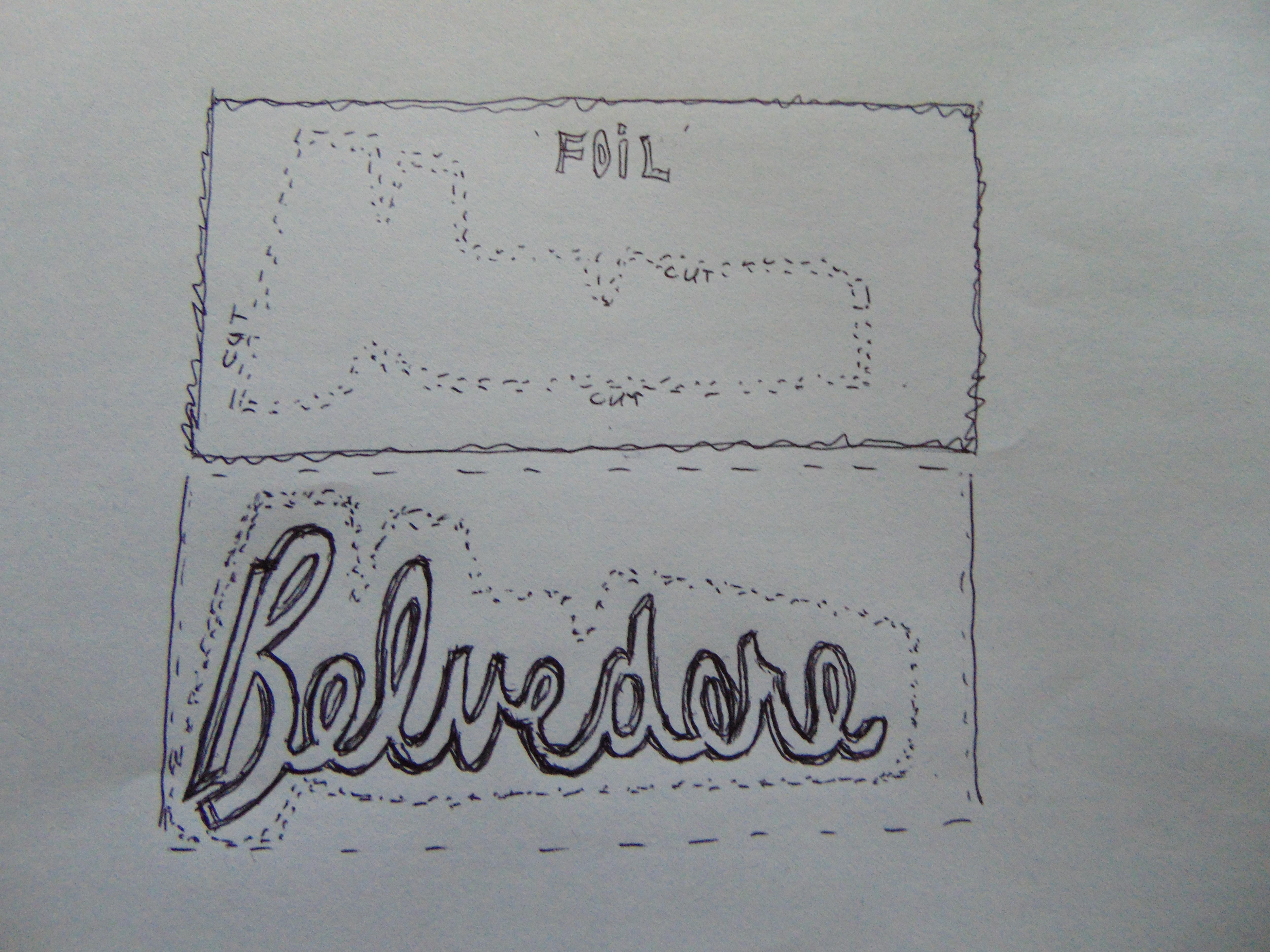

Zippi Posted April 12, 2021 Posted April 12, 2021 Gareth, Your script turned out pretty good. I'm just now resarching this method and found a lot of vidos on the BMF method but nothing on appliing it over script. I can barely make out the script on my amt 1967 Chevelle Pro Street so I know there is no way I can cut the foil around each letter. Can you explain a little more on how you applied the BMF and just how you cut it off the script?
Snake45 Posted April 12, 2021 Posted April 12, 2021 On 4/12/2021 at 11:56 AM, Zippi said: I know there is no way I can cut the foil around each letter. Can you explain a little more on how you applied the BMF and just how you cut it off the script? Expand Apply the foil and cut it to the general outline/perimeter of the emblem as close as you can. Then apply your primer and paint. The primer and paint will hide the edges of the foil. This is a bit cruder than Steve G's method, but most of us are nowhere near as skilled as he is, or as experienced with foil. As you can see from my '68 Vette above, it works fine. (One piece of foil was applied around the whole word CORVETTE, I made no attempt to cut it out around/between the letters.)

doorsovdoon Posted April 13, 2021 Author Posted April 13, 2021 On 4/12/2021 at 11:56 AM, Zippi said: Gareth, Your script turned out pretty good. I'm just now resarching this method and found a lot of vidos on the BMF method but nothing on appliing it over script. I can barely make out the script on my amt 1967 Chevelle Pro Street so I know there is no way I can cut the foil around each letter. Can you explain a little more on how you applied the BMF and just how you cut it off the script? Expand I just placed a square piece of foil over the script, pressed it in, then trimmed the foil some more to remove the excess. The paint will cover the outline of the foil edge. This crude sketch I did might explain it better than I can type it! Lol
Zippi Posted April 13, 2021 Posted April 13, 2021 On 4/13/2021 at 4:08 PM, doorsovdoon said: I just placed a square piece of foil over the script, pressed it in, then trimmed the foil some more to remove the excess. The paint will cover the outline of the foil edge. This crude sketch I did might explain it better than I can type it! Lol Expand Gotta ya dude. Thanks.
StevenGuthmiller Posted April 13, 2021 Posted April 13, 2021 On 4/13/2021 at 4:08 PM, doorsovdoon said: I just placed a square piece of foil over the script, pressed it in, then trimmed the foil some more to remove the excess. The paint will cover the outline of the foil edge. This crude sketch I did might explain it better than I can type it! Lol Expand That’s exactly how I do it. just trim as close to the script as possible. Steve
