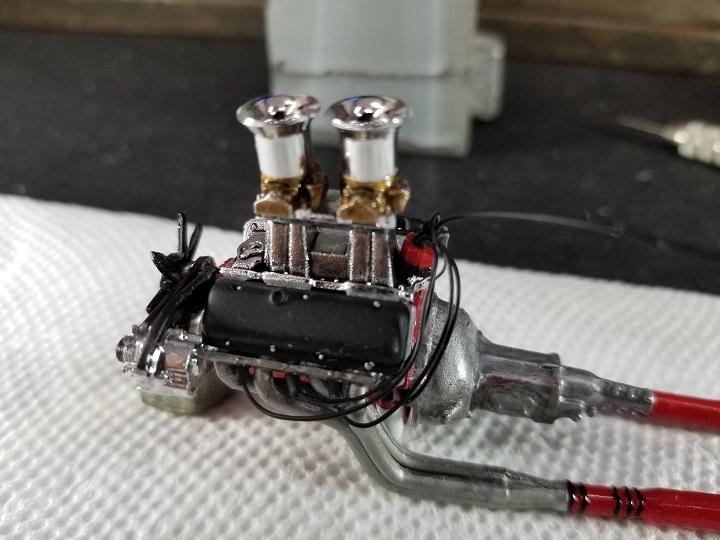

Zippi Posted April 16, 2021 Author Posted April 16, 2021 (edited) My plug wire came in last night. I got the engine wired and about 90% done. The rest will be done once the engine is installed in the chassis. The velocity stacks are just setting there for the pics. They still need a little work. Edited April 16, 2021 by Zippi

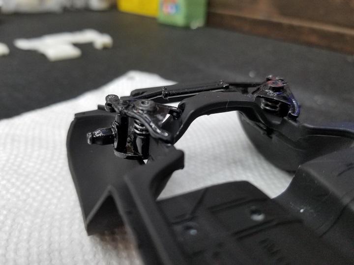

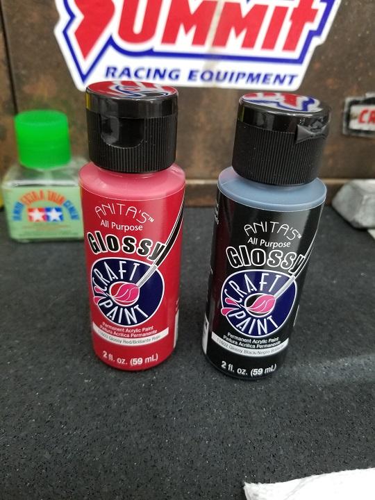

Zippi Posted April 17, 2021 Author Posted April 17, 2021 (edited) Out shopping with the wife most of the day but got a little detail work done on the front and rear suspenion. Went to a new flea market that just opened up called "Cowboy Jim's" and bought a new sign for the garage. Wife says I already have to many. What ever. Also went to my favorte store HL and picked up a couple bottles of Anits's Craft Paint. I noticed a lablel on the back of the bottles and I'm not sure what this means. Anyone know??? One of these could be going on the Chevelle. I'll do some spoon testing tomorrow. While at HL I now notice they have the Molotow Liquid Chrome Markers and in two different location in the store. I was just there the other day and they told me they don't carry that brand. HL needs to train the employees a little better. Edited April 17, 2021 by Zippi Added pic
Zippi Posted April 17, 2021 Author Posted April 17, 2021 (edited) 4 minutes ago, TransAmMike said: Good choice for paint. My latest go to. Mike.....what do you think of that Rust-Oleum/Testors logo? Edited April 17, 2021 by Zippi
TransAmMike Posted April 17, 2021 Posted April 17, 2021 28 minutes ago, Zippi said: Mike.....what do you think of that Rust-Oleum/Testors logo? Ahh, doesn't bother me at all. Since the paint works for me, no problem. But I do like the DecoArt paints too.
Zippi Posted April 17, 2021 Author Posted April 17, 2021 Just now, TransAmMike said: Ahh, doesn't bother me at all. Since the paint works for me, no problem. But I do like the DecoArt paints too. No biggy to me either. Just wondering if all three are in cahoots with one another.

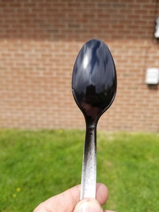

Zippi Posted April 18, 2021 Author Posted April 18, 2021 (edited) I did the spoon test today on the Anita's Glossy Black Arcylic paint I bought the other day at HL. I primed a couple spoons with Rust-Oleum 2X Flat Black primer and let them set for about an hour. I first started out with a couple light coats of the Glossy Black letting the paint flash between coats and worked my way up to 6 coats with the last 2 coats being pretty heavy. I let the spoons set for an hour. I then sprayed the spoons with 5 coats of Rust-Oleum 2X Gloss Clear because I had it on hand and couldn't wait for the Pledge I ordered to come in. I see no reaction to the paint and I think it came out pretty good and it hasn't even been wet sanded yet. That's something else new to me so I'll give it a try tomorrow. I have some 1000 up to 12000 grit. Any tips on wet sanding for the first time? Edited April 18, 2021 by Zippi
TransAmMike Posted April 18, 2021 Posted April 18, 2021 4 minutes ago, Zippi said: I did the spoon test today on the Anita's Glossy Black Arcylic paint I bought the other day at HL. I primed a couple spoons with Rust-Oleum 2X Flat Black primer and let them set for about an hour. I first started out with a couple light coats of the Glossy Black letting the paint flash between coats and worked my way up to 6 coats with the last 2 coats being pretty heavy. I let the spoons set for an hour. I then sprayed the spoons with Rust-Oleum 2X Gloss Clear because I had it on hand and couldn't wait for the Pledge I ordered to come in. I see no reaction to the paint and I think it came out pretty good and it hasn't even been wet sanded yet. That's something else new to me so I'll give it a try tomorrow. I have some 1000 up to 12000 grit. Any tips on wet sanding for the first time? Looks good to me Bob. It's the same system I will be using on my '55 Sedan. How many clear coats tho??
Zippi Posted April 18, 2021 Author Posted April 18, 2021 (edited) 6 minutes ago, TransAmMike said: Looks good to me Bob. It's the same system I will be using on my '55 Sedan. How many clear coats tho?? I think I put 3 light coats and let it flash 2 or 3 min then the last 2 coats I sprayed one after the other pretty heavy. It looks pretty slick with not much orange peel. Edited April 18, 2021 by Zippi
TransAmMike Posted April 18, 2021 Posted April 18, 2021 Just now, Zippi said: I think I put 3 light coats and let it flash 2 or 3 min then the last 2 coats I sprayed one after the other pretty heavy. It looks pretty slick with not much orange peel. Sounds about right. It will polish out nicely. So far I have never sanded a finish. I just use a high quality medium polishing compound to level it then liquid finish polish, but that just me.
Zippi Posted April 18, 2021 Author Posted April 18, 2021 4 minutes ago, TransAmMike said: Sounds about right. It will polish out nicely. So far I have never sanded a finish. I just use a high quality medium polishing compound to level it then liquid finish polish, but that just me. So that Black Willys of yours was not wet sanded??? Man it looks good for just a polish job. Can't see any orange peel. I have some NOVUS 2 I was going to try after wet sanding then polish is with Meguiar's Ultimate liquid wax.
TransAmMike Posted April 18, 2021 Posted April 18, 2021 3 hours ago, Zippi said: So that Black Willys of yours was not wet sanded??? Man it looks good for just a polish job. Can't see any orange peel. I have some NOVUS 2 I was going to try after wet sanding then polish is with Meguiar's Ultimate liquid wax. Actually Bob, since it was one of my early builds after returning to the hobby, it was painted with Krylon rattle can gloss black and not even clear coated. I too use the Meguires Ultimate.
