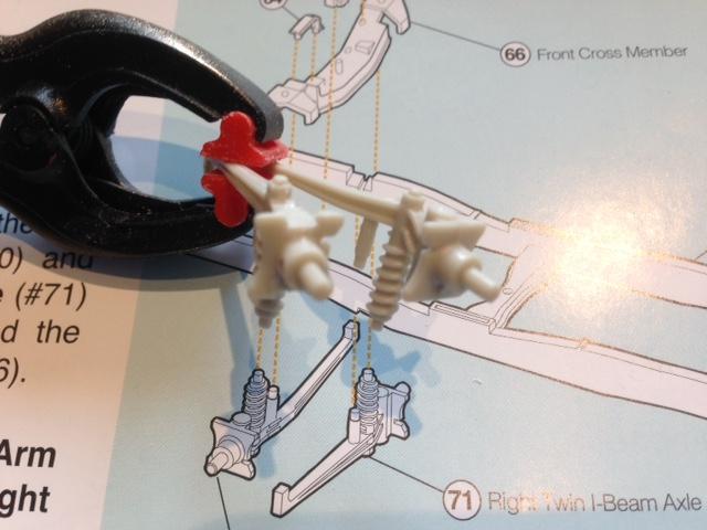

hct728(Bob) Posted April 20, 2021 Posted April 20, 2021 (edited) Finally started one of the Moebius Ford pickups that I've been acquiring over the last few years, as I now have 7 of the 11 issued (how did that happen)! May have picked out the wrong one, as the '67 sure looks more like a '68 in everything but the lack of side markers! I was hoping to do a stripped-down basic model, but the dash, door panels etc. all seem to be from the Custom Cab or from the '68! Anyway, soon as I started I had to make the front wheels posable, so off I went making a simple build much more complicated! Pictures show what I did Trimming away part of the hub top and bottom to accept tabs to attach to the spindle After adding the tabs, and little nuts to the pins to give it a more authentic look. More pics to come as I trim down the tabs and clip the pins once I'm happy with the look. Still have to figure out what to do with the tie rod... Edited April 21, 2021 by hct728(Bob)

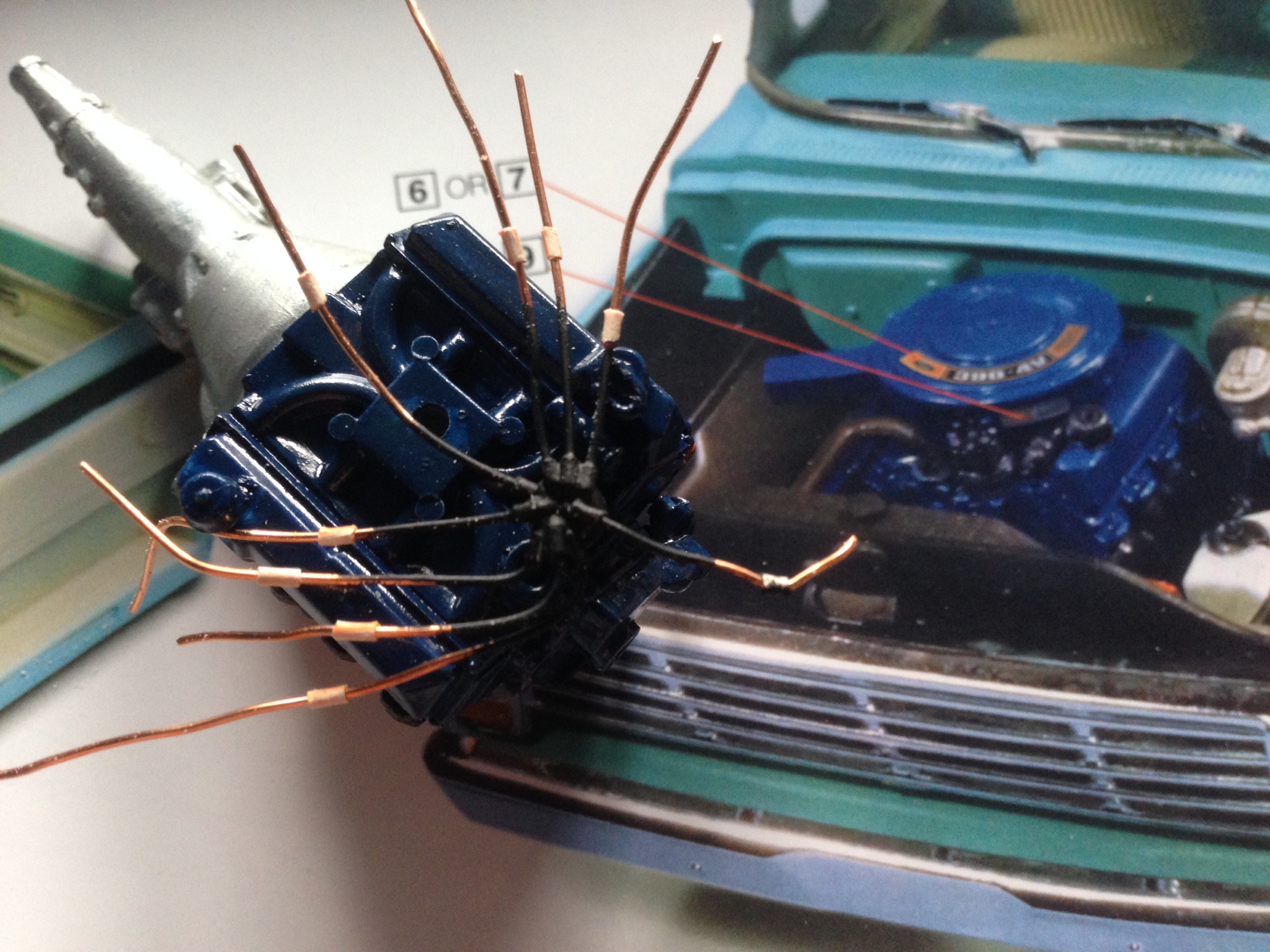

hct728(Bob) Posted April 26, 2021 Author Posted April 26, 2021 (edited) I have an in-progress engine picture too, as I made my own distributor with bare telephone wire, 24 gauge copper, with bits of insulation used as boots. Fortunatly Acrylic paint seems to work okay for finishing off the copper. Too late I noticed the overall blue paint colour is too dark, I’ll get it right in the next one Tried to assemble the drivetrain and found the auto transmission pan interferes with the middle crossmember! I had to cut out the middle of the crossmember to clear the pan and will be adding a strip below the pan. Then I found the engine contacts the steering gear so it mounts tilted, so I had to do some trimming. Is it me or what? Edited April 28, 2021 by hct728(Bob)

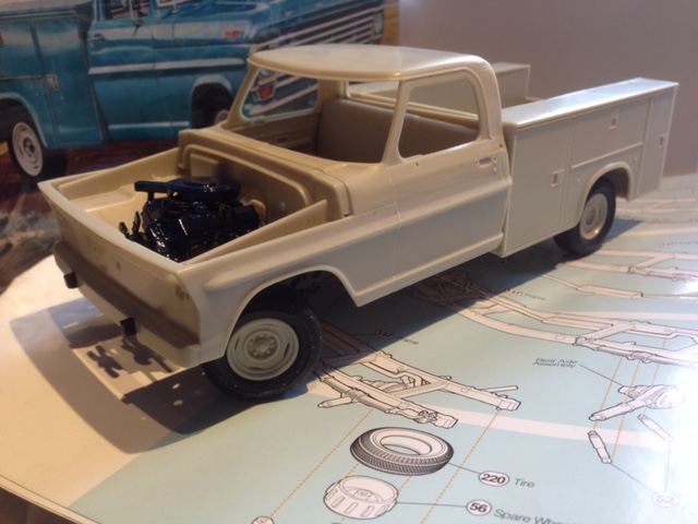

hct728(Bob) Posted April 28, 2021 Author Posted April 28, 2021 (edited) Body mounting mocked up, seems kinda low on the chassis to me. You can see where I removed the side moulding and rocker panel trim, a primer coat will reveal all mistakes. Also practicing posting from an iPad instead of my ancient computer, good to learn new tricks! Found I can just copy and paste the picture from an email, couldn’t be easier! Edited April 28, 2021 by hct728(Bob)

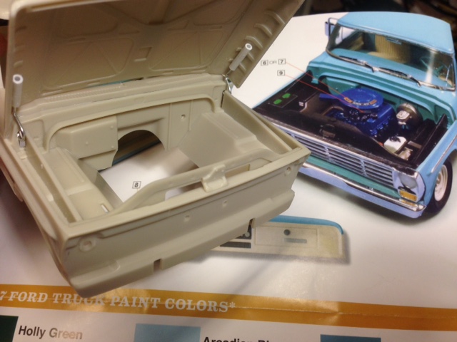

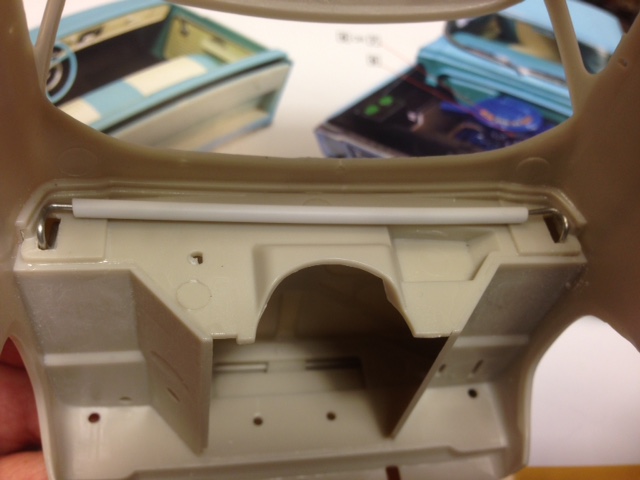

hct728(Bob) Posted May 2, 2021 Author Posted May 2, 2021 Got the hood hinged today, this simple hinge seems to work okay, bent so a bit of drag on the underhood ridges make it stray open by itself, though I need to add some trim or something to make it look more realistic, maybe glue some plastic shapes onto the wire to hide it
