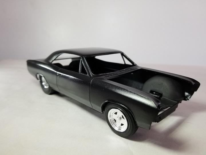

TransAmMike Posted April 23, 2021 Posted April 23, 2021 Looks like a smooth finish on the P/U body "Zip". As for the'67, in your WIP thread on it, you seem to have given up on it. I really think you should work on redoing the paint job if you're not happy with it. Just me Bob.?

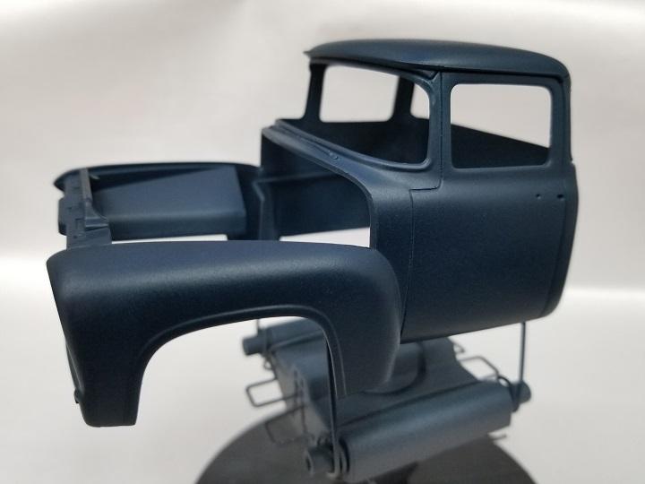

Zippi Posted April 23, 2021 Author Posted April 23, 2021 (edited) On 4/23/2021 at 12:46 AM, TransAmMike said: Looks like a smooth finish on the P/U body "Zip". As for the'67, in your WIP thread on it, you seem to have given up on it. I really think you should work on redoing the paint job if you're not happy with it. Just me Bob.? Expand Mike, I"m going to keep that one on the shelf to remind me of my early on builds and what not to do. I have figured one thing out.....the Revell kits seem to be better quality over the amt kits. Here is a pic of the finished 56 Foose truck. Edited April 23, 2021 by Zippi

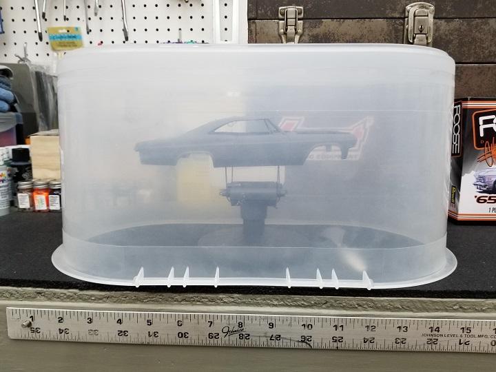

Zippi Posted April 23, 2021 Author Posted April 23, 2021 The rain held off so I went ahead and sanded the test body of the Foose 1965 Impala and got it primed. I really like the Rush-Oleum paint. It lays down so smooth and drys fast.
peteski Posted April 23, 2021 Posted April 23, 2021 On 4/23/2021 at 3:21 PM, Zippi said: I really like the Rush-Oleum paint. It lays down so smooth and drys fast. Expand Do you mean you like the "primer", or is this the final "paint" coat?

Zippi Posted April 23, 2021 Author Posted April 23, 2021 On 4/23/2021 at 3:30 PM, peteski said: Do you mean you like the "primer", or is this the final "paint" coat? Expand Primer
