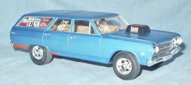

Art Anderson Posted October 29, 2014 Posted October 29, 2014 On 10/29/2014 at 2:08 PM, oldr-n-drt said: do they make a white sharpie?? i have some drag cars i need to make class markings on the windshields... thanks oldr-n-drt Why not investigate white Gel roller pens? Art
John Pol Posted October 30, 2014 Posted October 30, 2014 I think you can also get a white eye liner pencil to do the lettering on the windows or tires
Snake45 Posted November 3, 2014 Posted November 3, 2014 On 10/29/2014 at 2:08 PM, oldr-n-drt said: do they make a white sharpie?? i have some drag cars i need to make class markings on the windshields... thanks oldr-n-drt Nothing wrong with flat white paint and a fine brush for that.
DrGlueblob Posted November 3, 2014 Posted November 3, 2014 Just bought "Craftsmart" white paint pen to replace my old Pentel. It's Michael's store brand. Fine tip and works good, so far.
