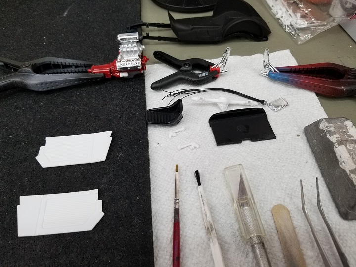

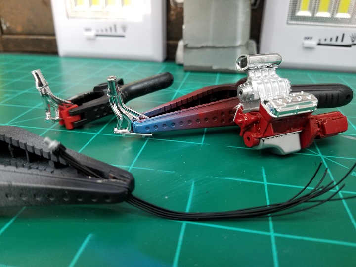

Zippi Posted July 27, 2021 Author Posted July 27, 2021 Not much going on today. Got the headers cleaned up and the collectors glued on. I got the distributor painted and a few more parts glued on the engine. The chrome has more flash than I thought so after cleaning it all up I'm gong over the raw area's with my Molotow chrome Pen. Also got all 8 holes drilled in the valve covers to except the plug wires.

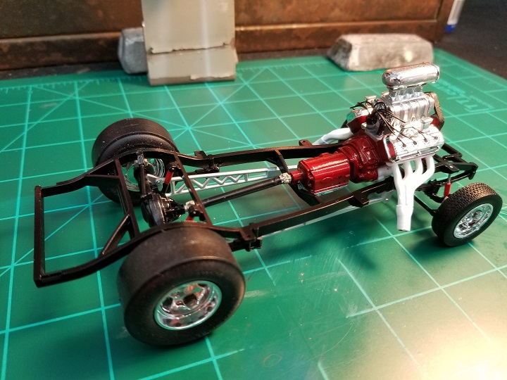

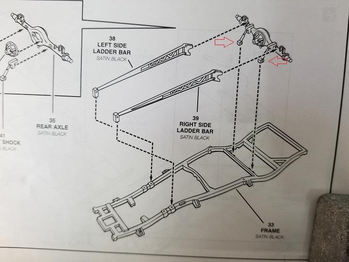

Zippi Posted July 28, 2021 Author Posted July 28, 2021 Getting ready to glue the rear suspension in and I've noticed something. Where the rear shocks attach to the rear end on the brackets, I can slide the shocks up and down a pretty good ways. Depending on where the shocks are glued in it's going to set the height between the tire and the rear fender opening. For those of you that have built this kit, do you remember just where you placed the rear shocks in the brackets to get a good looking gap between the tire and rear fender? 1

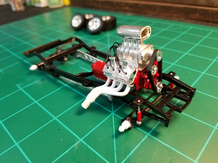

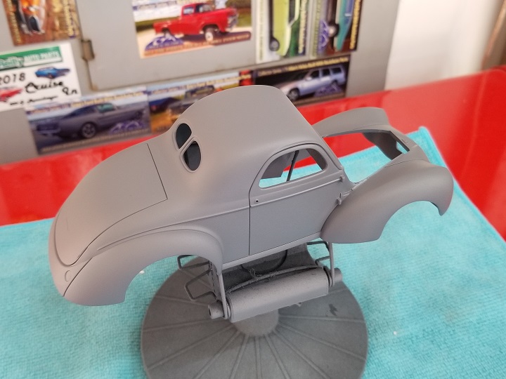

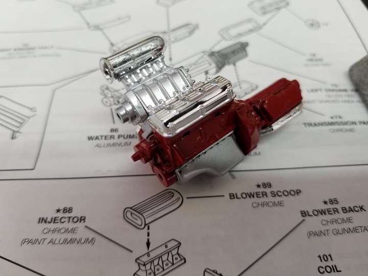

Zippi Posted July 28, 2021 Author Posted July 28, 2021 I got most of the engine completed today. Just need to paint and wire the coil and paint a few bolt heads. Also had a good day with low humidity to get the body in primer. 2
TransAmMike Posted July 28, 2021 Posted July 28, 2021 1 hour ago, Zippi said: I got most of the engine completed today. Just need to paint and wire the coil and paint a few bolt heads. Also had a good day with low humidity to get the body in primer. Looks good in primer Bob.
Zippi Posted July 28, 2021 Author Posted July 28, 2021 2 minutes ago, TransAmMike said: Looks good in primer Bob. Thank's ole buddy.
slusher Posted July 30, 2021 Posted July 30, 2021 Real nice progress Bob, I hope you get low humidity to paint the body. Humidity is murder here in the south right now..

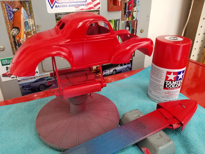

Zippi Posted August 2, 2021 Author Posted August 2, 2021 Still here Mike. Had to take a step back and think about the quality of work I'm doing or maybe not doing. Just not satisfied with what I'm seeing. I did get a little chassis work done. I first primed the body in flat gray as I do all my models but the Tamiya Italian red came out to dark. I re-sprayed the body with a white basecoat hoping the red will turn out a little brighter. Temperature around noon today should be around 75 degrees with the humidity around 50% so conditions are ideal. Paint seems to never turn out right for me so I'm hoping for the best and expecting the worst.

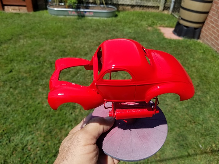

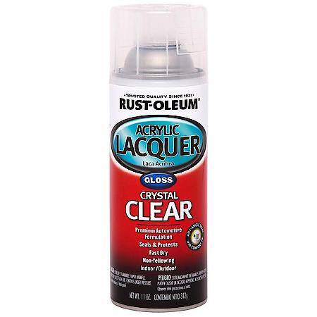

Zippi Posted August 2, 2021 Author Posted August 2, 2021 I got the body re-painted. With the white basecoat the color came out pretty close to the color on the cap. It has some orange peel but not bad. This time around I sat the can in some warm water as others have suggested. I'll let the body set for a couple days before spraying it will clear. Trying a new clear coat this time around.
TransAmMike Posted August 2, 2021 Posted August 2, 2021 Looks good my Friend! Maybe a light sanding for the orange peel before clearing??

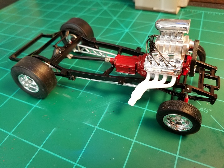

Zippi Posted August 2, 2021 Author Posted August 2, 2021 I have a rolling chassis. Can't seem to get the front wheels to snap on like the rear did. I thought I had broken it once so I stopped. I may have to cut a portion of the axle off and glue the front wheels on.
slusher Posted August 3, 2021 Posted August 3, 2021 Red looks great Bob. Tamiya makes a pink primer for reds. Everything looks great Bob, keep up the good work.
Zippi Posted August 3, 2021 Author Posted August 3, 2021 26 minutes ago, slusher said: Red looks great Bob. Tamiya makes a pink primer for reds. Everything looks great Bob, keep up the good work. Thanks Carl. All I saw at the local hobby shop was white primer and white basecoat but I will keep that in mind.

papajohn97 Posted August 4, 2021 Posted August 4, 2021 (edited) I’d use the PE grill, the plastic grill screams “toy” IMO. You can easily bend the PE to match the body contour at the opening. Your build is coming along nicely so far. I agree with TransAMMike on the base coat red, light sand and re-spray if necessary to smooth out, I’ve never had luck fixing a bumpy base coat with clear coat. Edited August 4, 2021 by papajohn97 Added second sentence

Zippi Posted August 4, 2021 Author Posted August 4, 2021 Just clearcoated the body and hood. Two light coats, one medium coat, and one wet coat with 20 min flash time on each coat. Came out pretty good. I'm going to let this cure until this weekend to make sure it's good and dry before I wet sand it.
