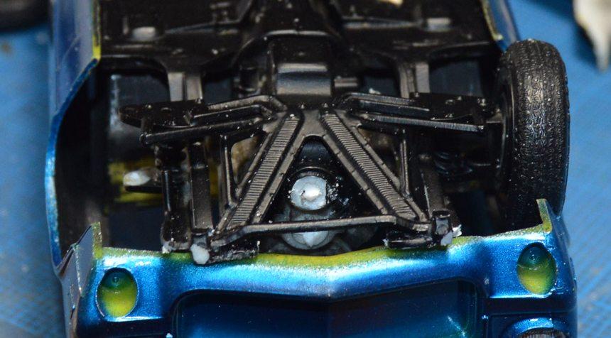

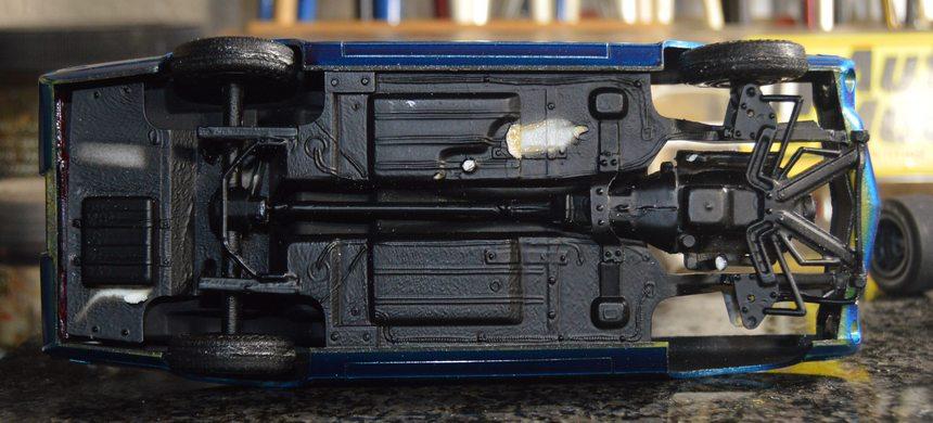

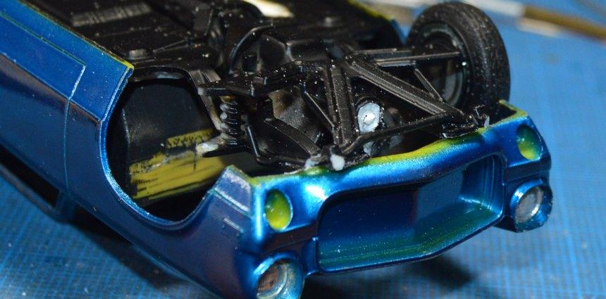

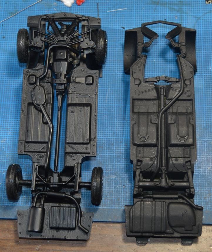

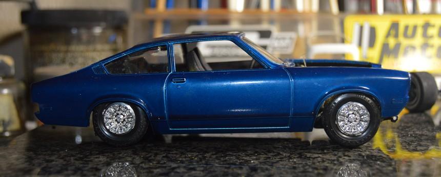

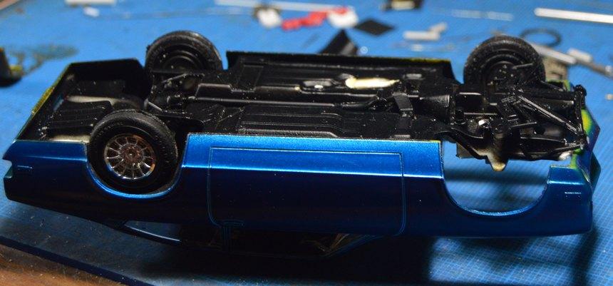

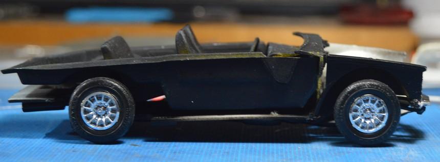

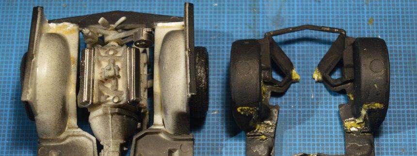

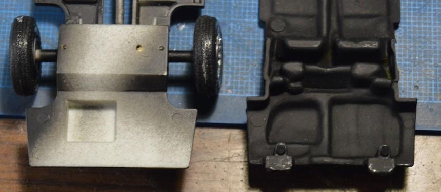

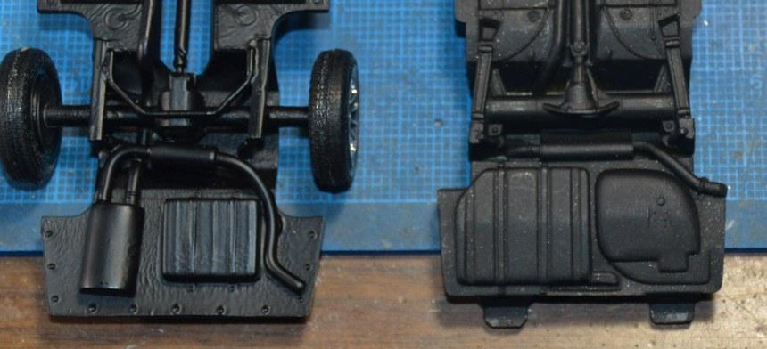

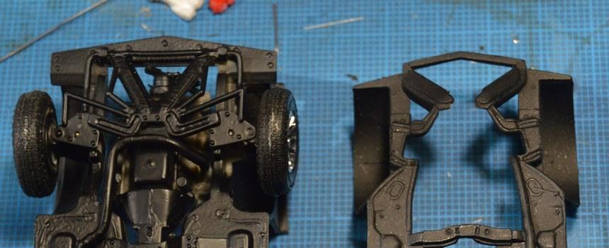

Straightliner59 Posted September 27, 2021 Share Posted September 27, 2021 I got the AMT Monza built-up, today. I took a look at what it takes to make it fit an MPC '71 Vega. The first five photos are a comparison of the two "chassis", AMT on the right. Now, the Vega's interior tub, atop the AMT chassis. The last group of photos shows the two assemblies, together. The length of the Monza's front suspension/k-member will need to be addressed, but shouldn't cause major concern. I removed the inner fenderwells from the Monza, because they interfered with inserting the chassis. I don't believe it would be too difficult to rework them to fit, however. I removed all the skirting, at the front of the chassis, and I removed about 1/8", from the rear. In this instance, I also cut about 1/8" from the bottom of the Vega's firewall. The Monza's rear axle is too long, but, that's not any sort of issue. There's plenty of room for a set of AMT Polyglas tires, back there! Can you say "V-8 Vega"?! Yes, please! Finally, the car, as it sits with only the basic (and crude, in my case!) modifications noted above. Fixing the front suspension will drop the nose to exactly where it should be, it looks to me! I hope this is helpful. Comments and questions are, of course,welcome! Quote Link to comment Share on other sites More sharing options...
ManiacModeler Posted September 28, 2021 Author Share Posted September 28, 2021 (edited) Straightliner that's a good comparison, do you know what AMT kit that Monza is from my grumpys lump has a cell dead center of the rear pan and a tubbed out rear interior pan, your Vega chassis looks like a stocker too. Thanks for the photos. This is the MPC lump I'm looking to replace with the Monza chassis so the info your sharing is quite appreciated. Edited September 28, 2021 by ManiacModeler Spelling Quote Link to comment Share on other sites More sharing options...
Straightliner59 Posted September 28, 2021 Share Posted September 28, 2021 1 hour ago, ManiacModeler said: Straightliner that's a good comparison, do you know what AMT kit that Monza is from my grumpys lump has a cell dead center of the rear pan and a tubbed out rear interior pan, your Vega chassis looks like a stocker too. Thanks for the photos. This is the MPC lump I'm looking to replace with the Monza chassis so the info your sharing is quite appreciated. I have two chassis from AMT Monzas. Both are the same . I would guess that the AMT Monzas are all the same? Glad this turned out to be helpful! Quote Link to comment Share on other sites More sharing options...
