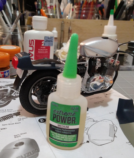

DanR Posted September 10, 2021 Posted September 10, 2021 My apologies to anyone who also visits the FSM forum, I'm duplicate posting here and there lately. In regards to this type of super glue, which I get at Hobby Lobby: I'm sure that others have had issues with the glue drying up long before the bottle is empty, or with glue amassing at the tip, causing the lid to not go back on properly, or with the tip itself getting clogged, etc. Well, I have been doing the following basic things to prevent this and they're working for me: 1) After every use (EVERY use, each time you squeeze a dollop out), wipe the tip with a paper towel and stick the cap back on. If you go back later and the tip is clogged, 2) Use a pin vise to drill through the clog. Repeat 1 and 2 over and over again. I have had zero issues with the bottle shown so far. The last one I used was a disaster. Hope this helps!
