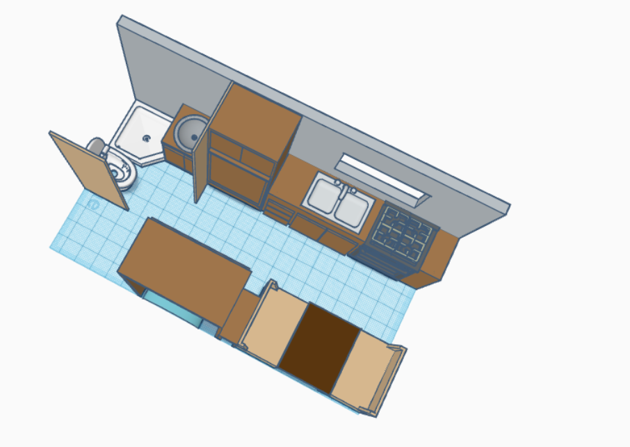

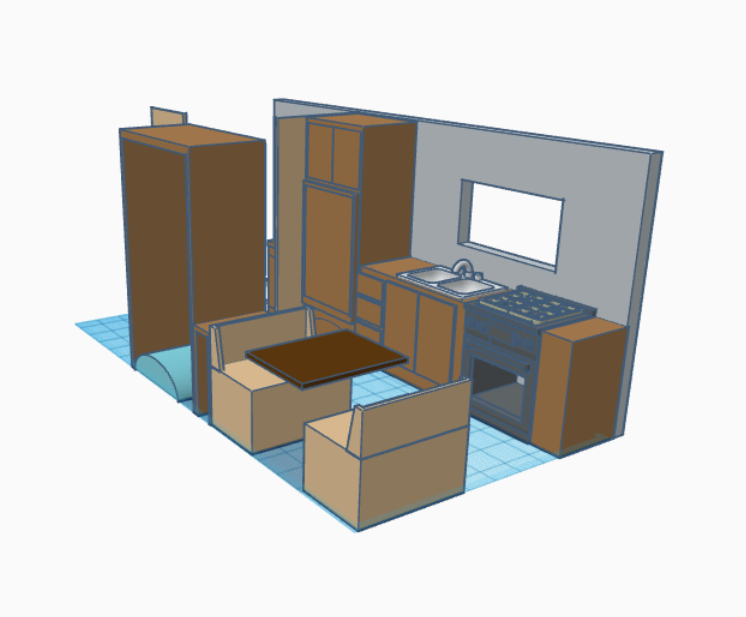

Oldmopars Posted April 7, 2022 Author Posted April 7, 2022 This project has been put on the back burner for a few months. I got to a point that I needed to start on the interior of the "home". This became a challenge I was putting off. In the following months I have been teaching myself TinkerCad and now Fusion 360. I have also purchased a medium format Resin 3D printer. Now the solution is much easier. I designed everything in the following pictures in TinkerCad except the Stove, that I cut apart from a 6 burner to make a 4 burner, hollowed it out and I will be adding the "Glass" to the front. The original stove I got from Thingiverse as well as the Toilet. Both were modified from their original design. Everything else was my design. I will add "Glass" or a shower curtain to the shower, a tube to the table for a leg, and a few more scratch built items. The interior walls will be styrene sheet, not printed. What would have taken me weeks to scratch build, I designed in one day and will print in one more. There are a lot of separate parts that in the pictures are together, and they will all print grey, no colors. This Motorhome is moving closer to being a reality.
