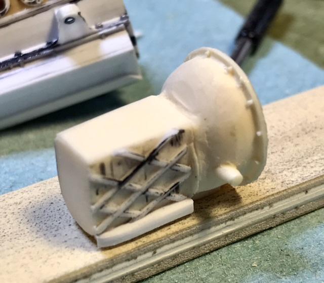

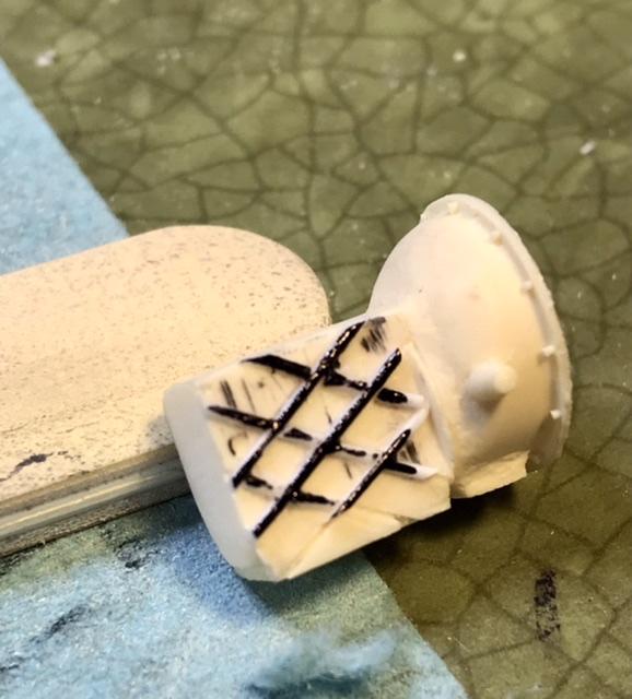

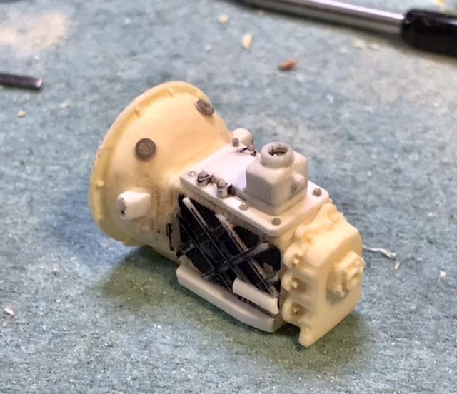

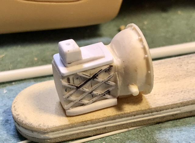

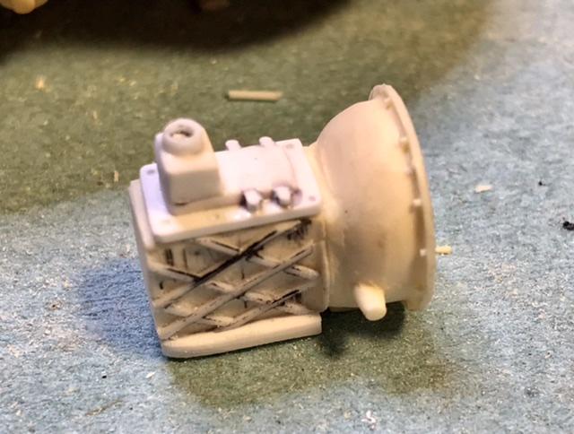

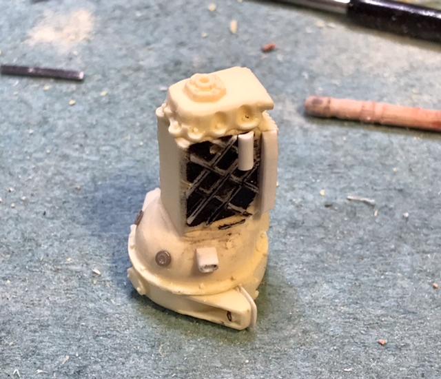

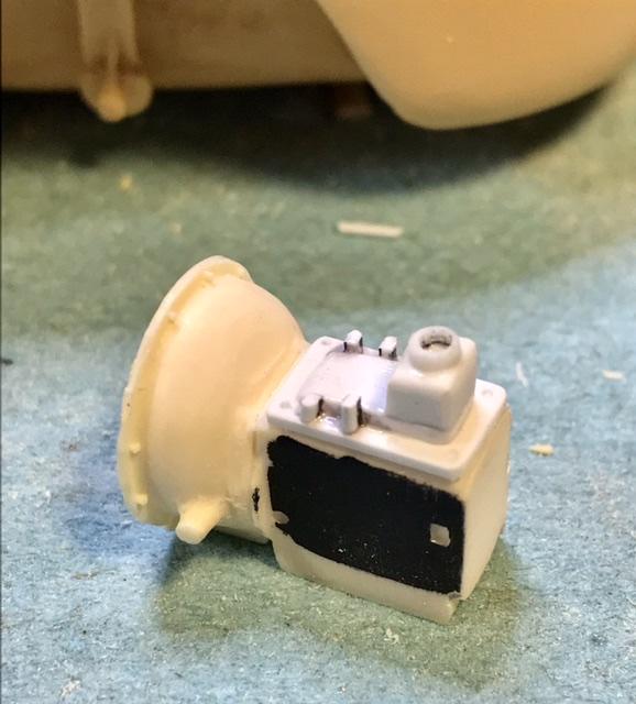

The reinforcement on the side plates are made w .020 evergreen rod - actually - .015 would be a bit more scale accurate …

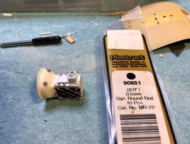

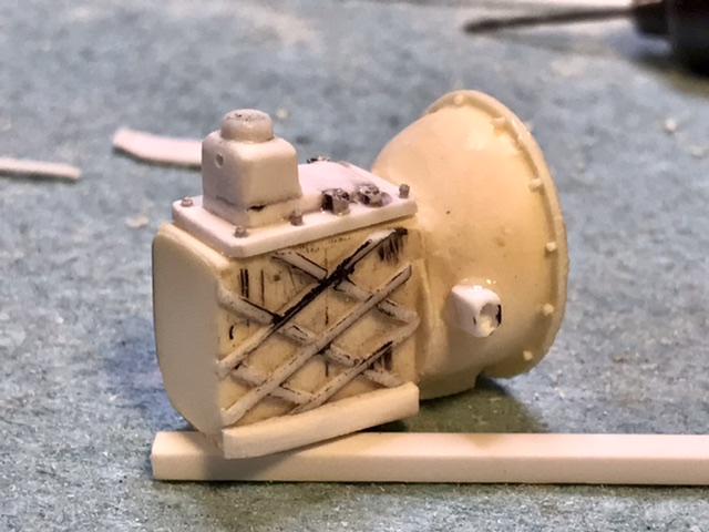

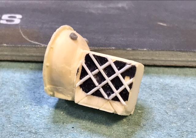

I realized that Evergreen rod is not always accurately sized  - the .020 rod is actually .0225 - Plastruct’s .020 rod is dead on accurate and has a truer shape - its actually …. Round !  So im using the good stuff for the left facing trans side-plate …

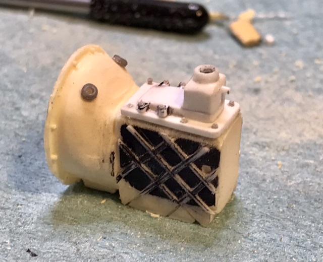

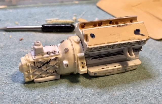

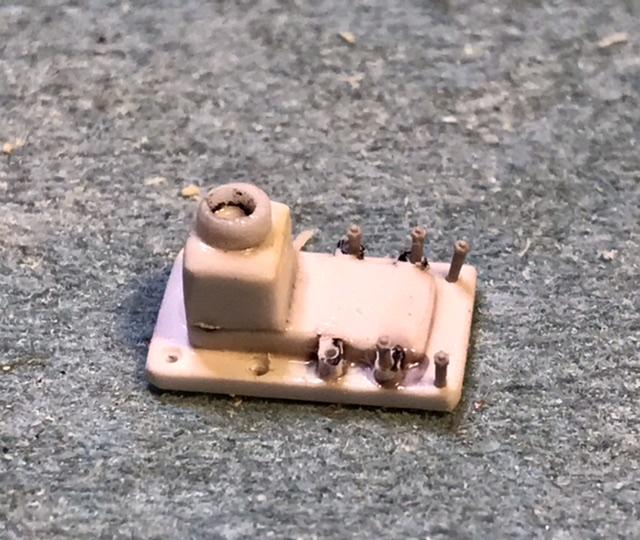

Tranny almost finished - will leave the cover plate w the shifter housing as a seperate part - because Ferrari designed a seperate shifter housing to use on the early spyder corsas and GP cars … the white parts poking out of the sides of the clutch housing are interesting - the clutch arm/fork connects to the pedal through the opening in the housing - all of the earliest Ferraris were right hand drive - but Enzo was thinking ahead - he had Colombo - or whoever designed the transmission  - design the trans with left and right openings in the housing - for a clutch assembly in left hand drive cars … Gramps and Andy Martin’s photos tell all …
  • Like 2
Your work on the transmission is outstanding  especially the netting, so precise. I just used some .030 evergreen rod for a switch panel and I agree with you on the shape. I wish someone here would step up and stock more Plastruct.  Just one model railroad shop has any kind of significant  selection.

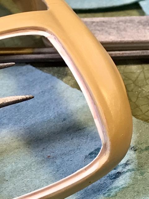

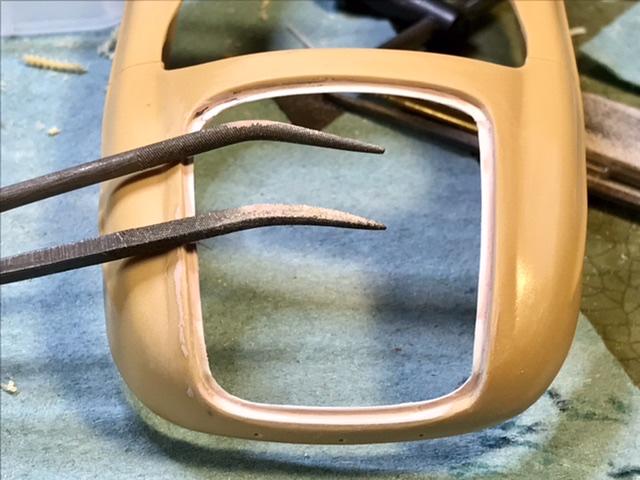

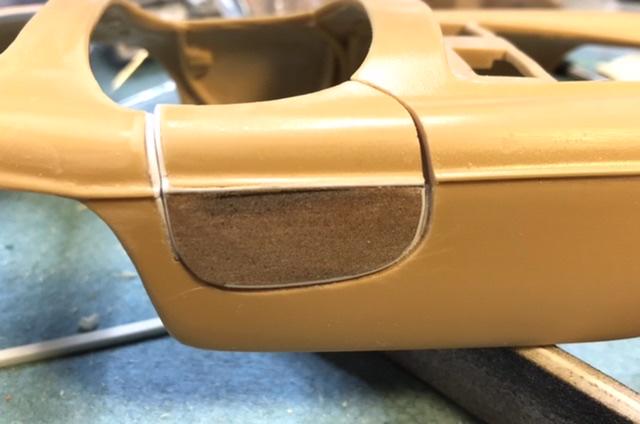

Putty, filing and sanding - to improve the appearance of the  drip rails … with 2 of the files in the rescesses of my tool chest - you never need them - until you need them …

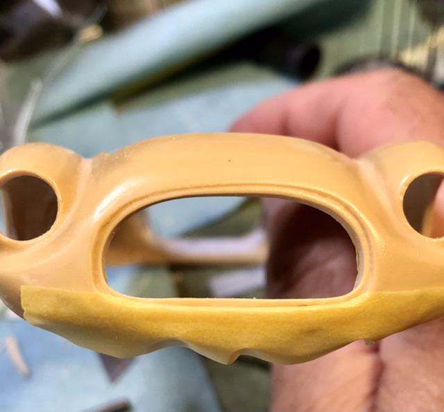

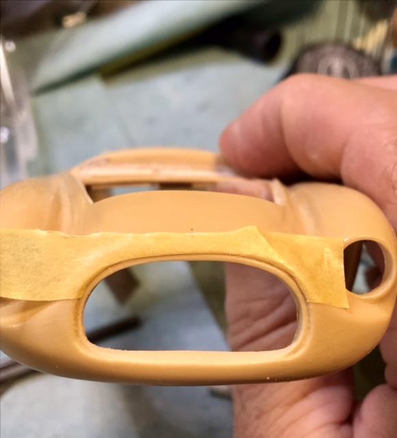

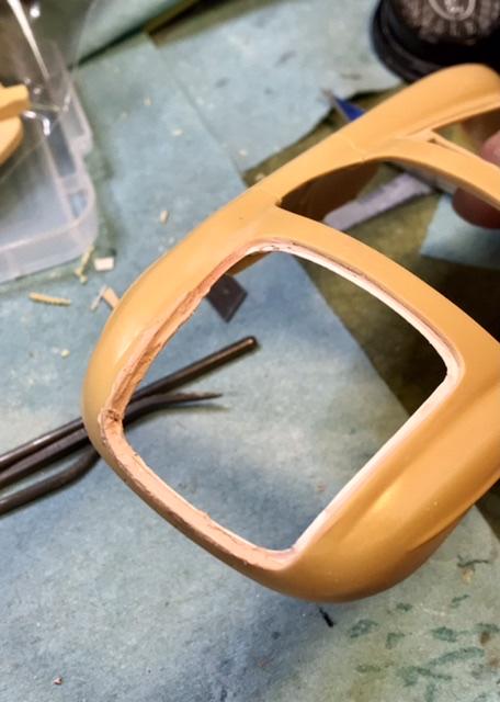

The grill trim is removed so I can reshape the opening just a little - the shape was not quite symmetric - now it is …

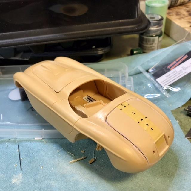

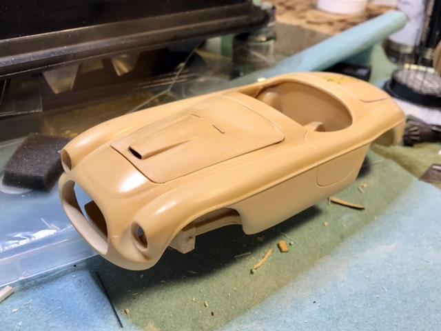

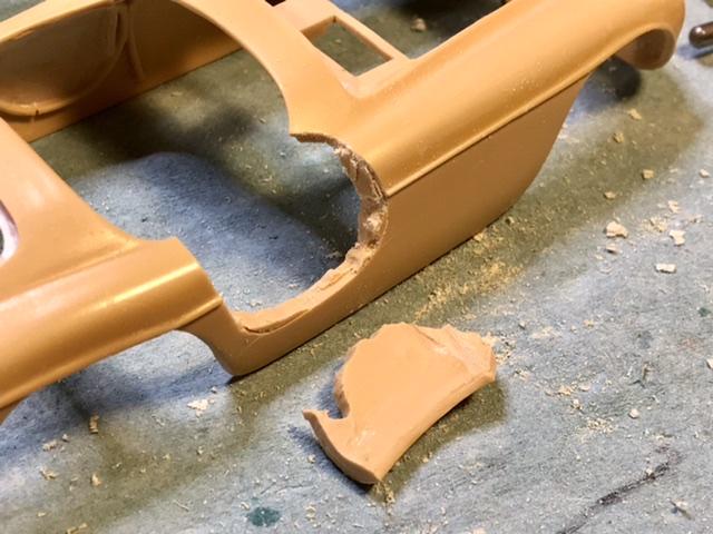

Open the doors ? Can’t decide …

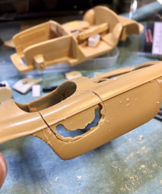

CAUTION   When I tried to open the doors and replace with brass doors on my scratchbuilt Barchetta disaster struck.  If you open the doors, I recommend you reinforce the body with brass wire in the week areas.  Or put in a floor pan tied to the rear buckhead.  Or solidly attach the interior bucket to the body.
Edited by Gramps46

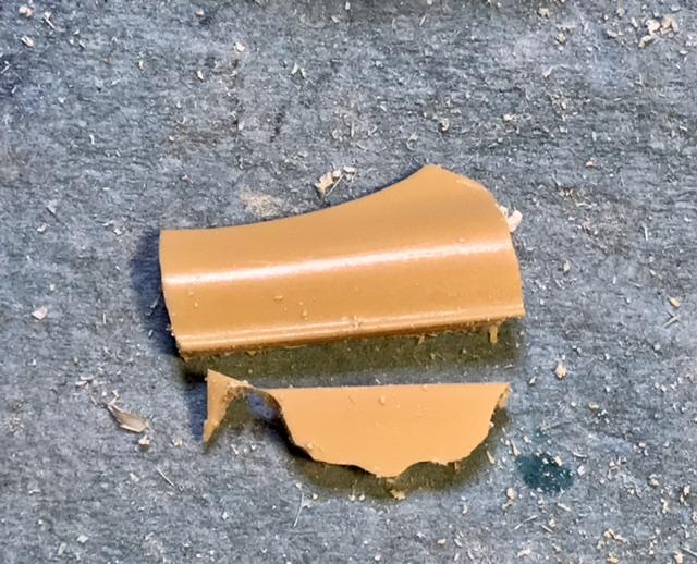

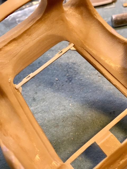

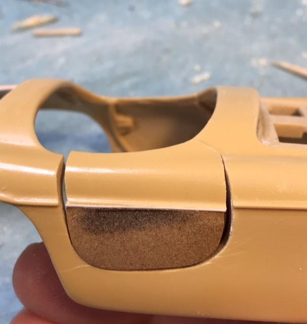

Blew the doors off
well - just the driver’s side door - the casting is very thick - it ate my UMM saw - so i removed the lower half of the door but managed to remove the top half w some excitement - the bottom half of the door was made fr some renshape  - glued bits and peices of Evergreen along the door jam and slowly recovered a reasonable door gap …
  • Like 1
More to do - maybe a coat of primer to finish the edge profile - will do something to replace the tube structure on the inside - and figure something out for the door hinge …
Edited by absmiami

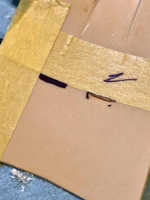

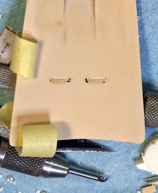

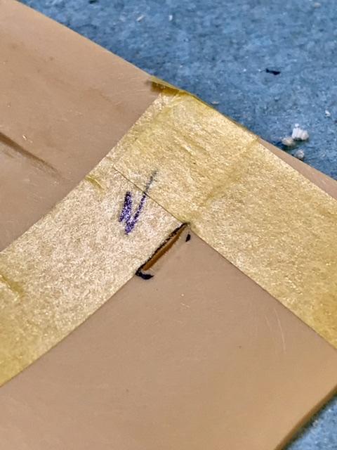

To the bonnett

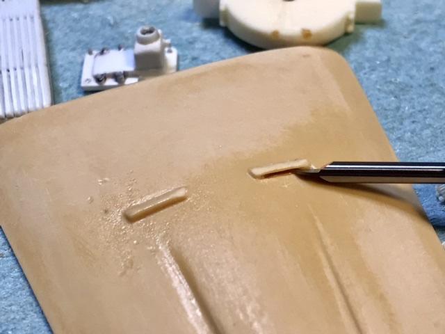

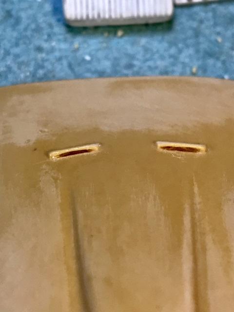

the two louvers are just tall enough to allow me to scribe openings - but then you need to mark and scribe the corresponding openings on the underside …

The leading edge ot the bonnet hinges below the trailing edge of the nose - like this - the bonnett is attached by hinges that are bolted to a cross-brace that is welded across the fenders - like this …
