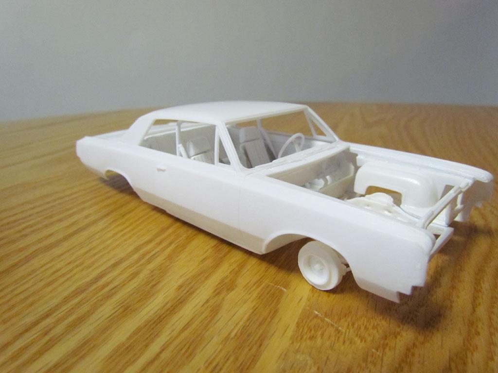

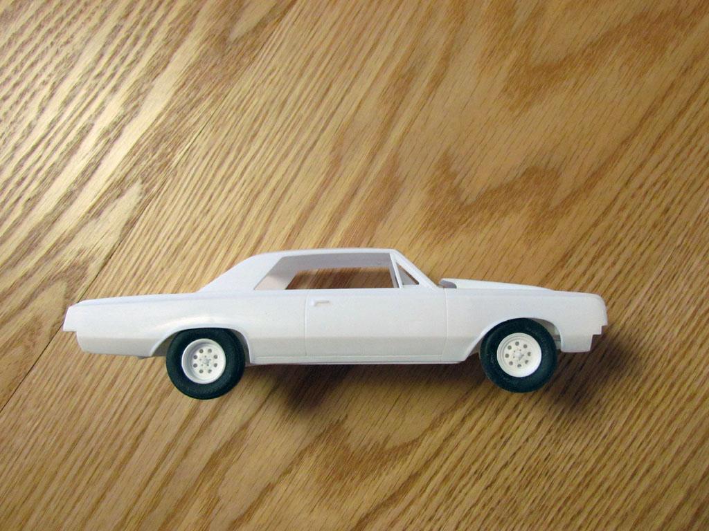

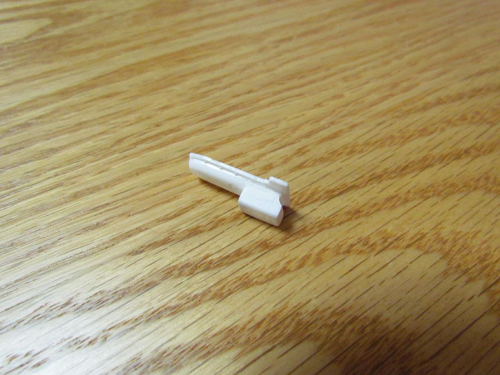

crowe-t Posted December 18, 2021 Author Posted December 18, 2021 (edited) I did some work on the interior's door panels. I used 1 mm and 1.5 mm Evergreen half round rods for the pleats. I also scratch built a steering column. I started making a new package tray. The stance is just about right. My friend sent me measurements. He measured from the rims to the fender/quarter panel wheel openings. I just have to move the rear end slightly forward. Edited December 18, 2021 by crowe-t 3

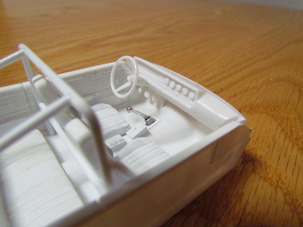

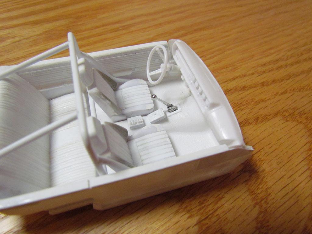

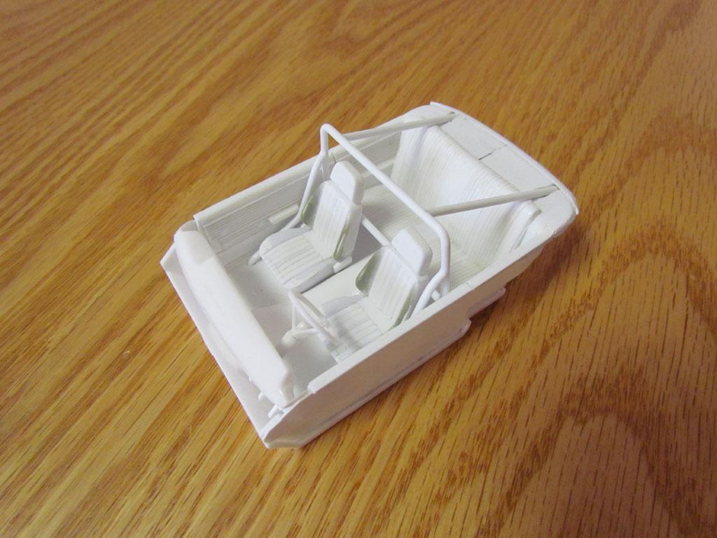

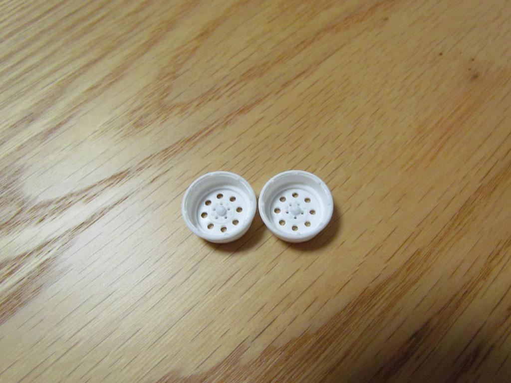

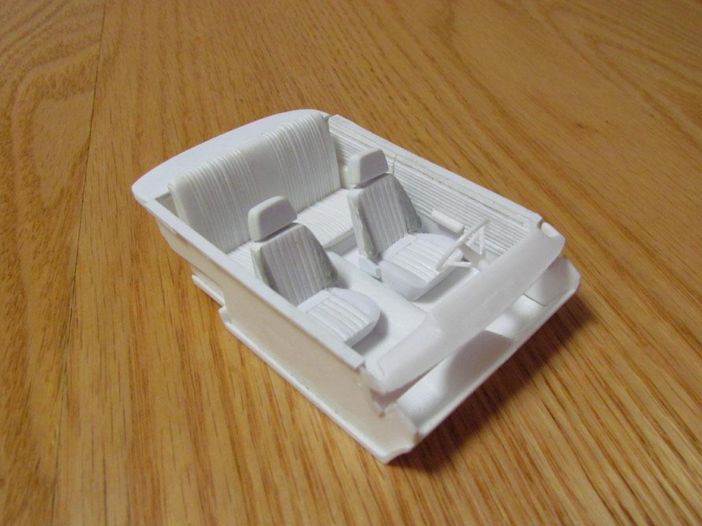

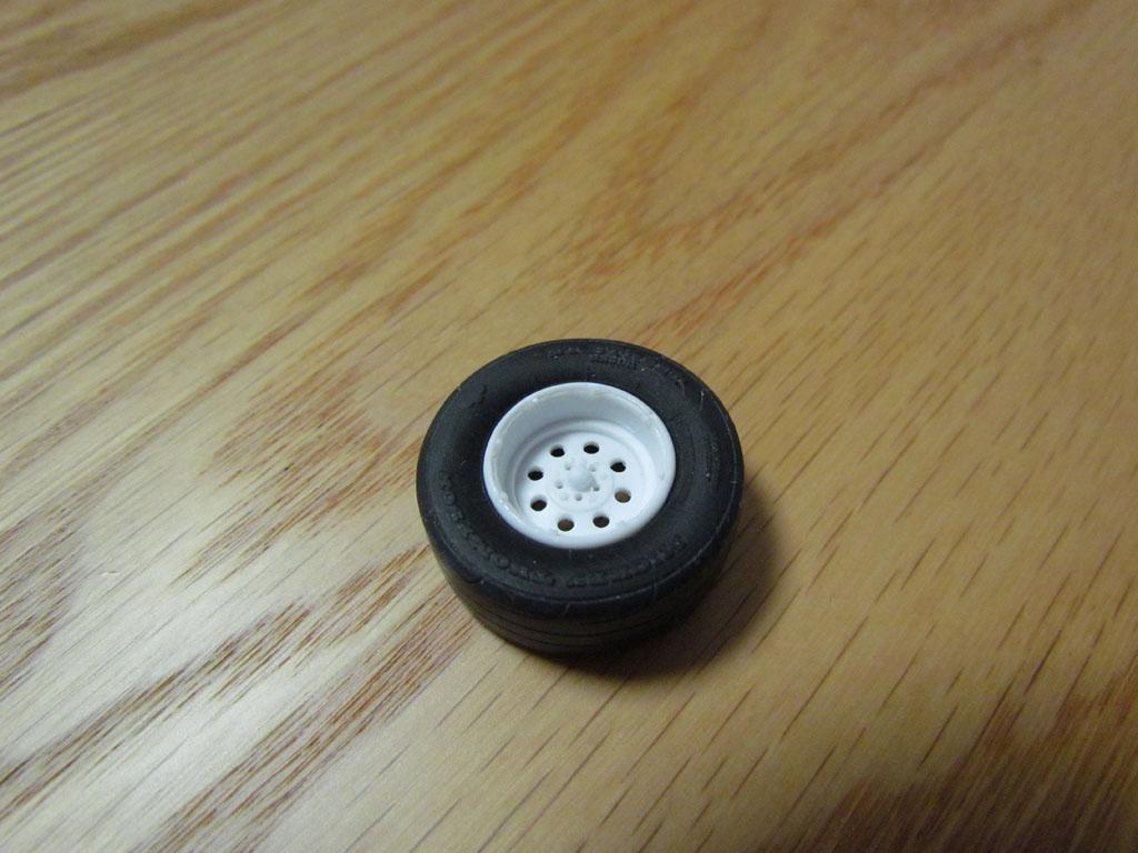

crowe-t Posted December 24, 2021 Author Posted December 24, 2021 I added the screws around the perimeter of the rear wheels that hold the tires in place. The interior is now glued together. The rear seat gave me problems. The back of the seat initially sat too straight up and down. I had to pull the seat out and file the back and bottom to angle it. It now sits the way it should. The steering wheel was slightly too far to the right by about a mm so I filled in the hole on the dash board and drilled a new hole. I also slightly widened the rear arm rests and added speakers to the front kick panels. 1

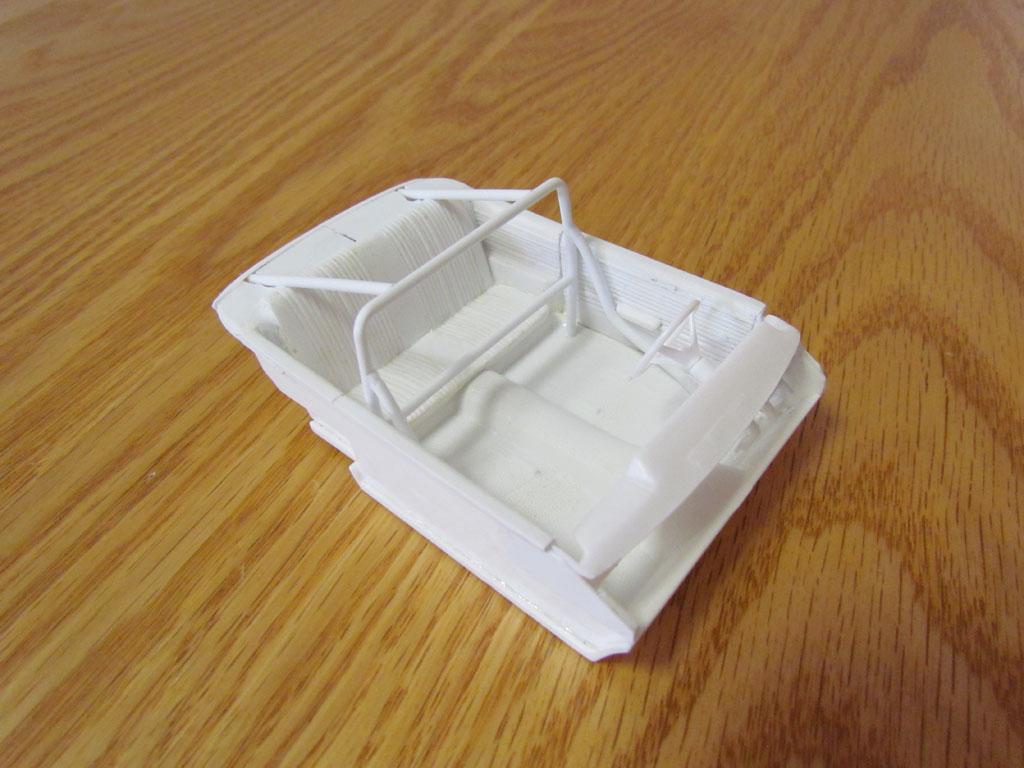

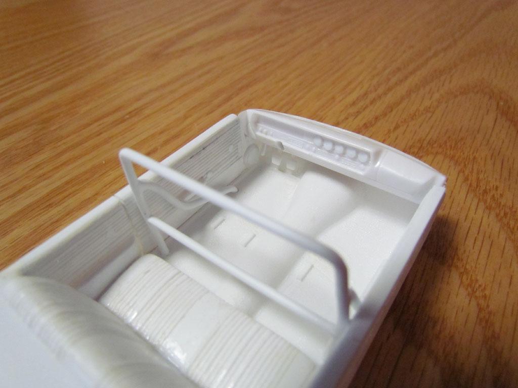

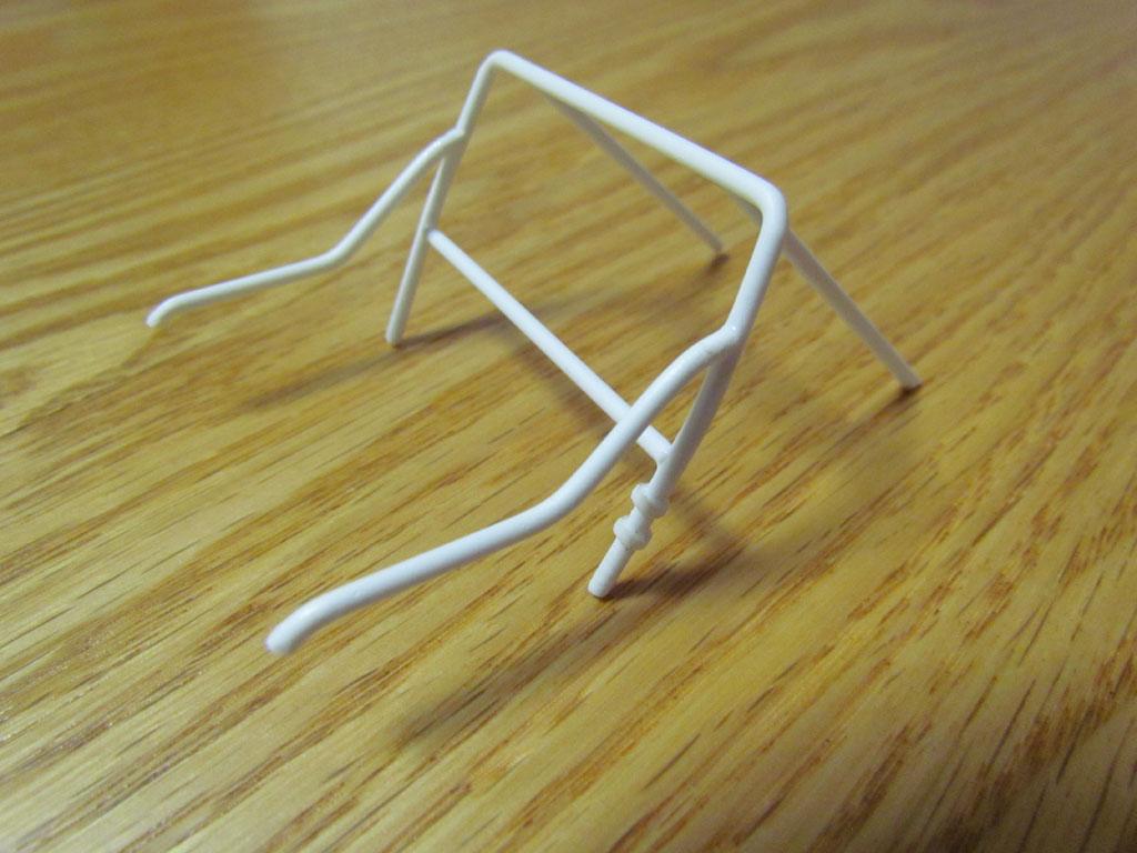

crowe-t Posted January 6, 2022 Author Posted January 6, 2022 Here's a small update. I started building the roll bar. I'm using 2 mm rods. I also started adding the pedals and the gauges on the dash board. 2

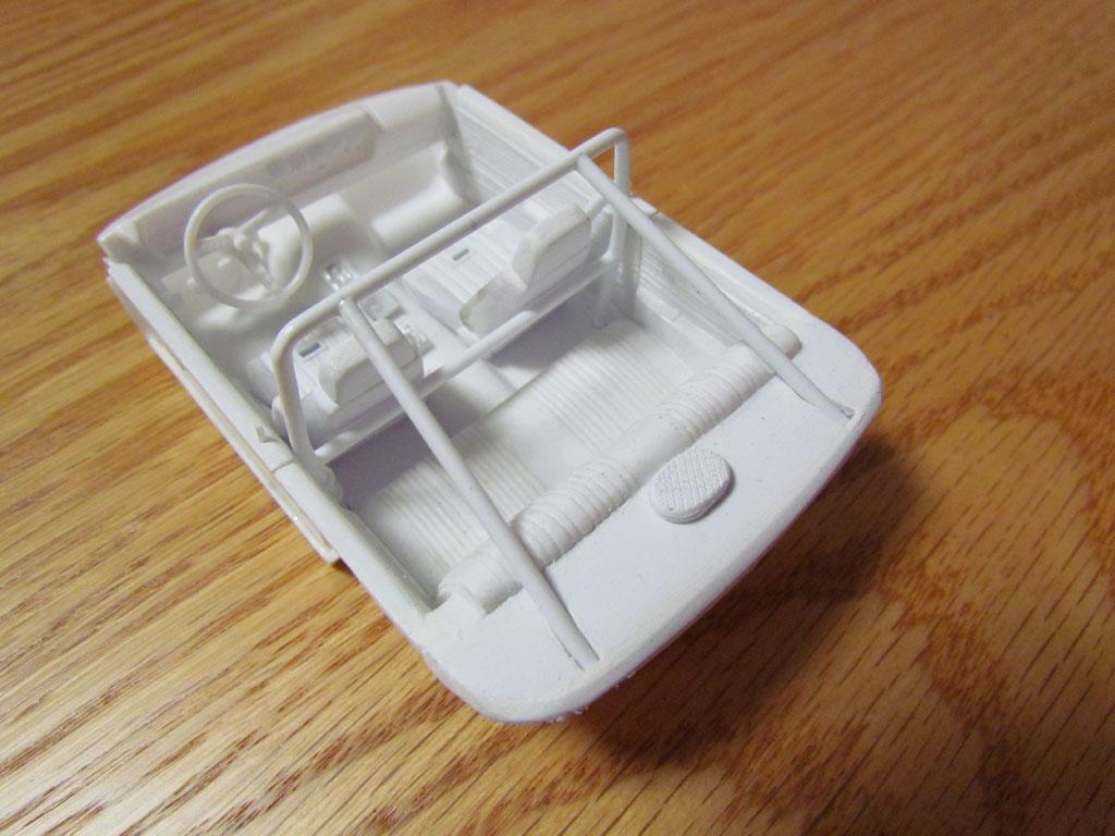

crowe-t Posted January 7, 2022 Author Posted January 7, 2022 Here's more progress on the roll bar. I had to extend the package tray but that will all be cleaned up. A few more details and the interior will be done. 2

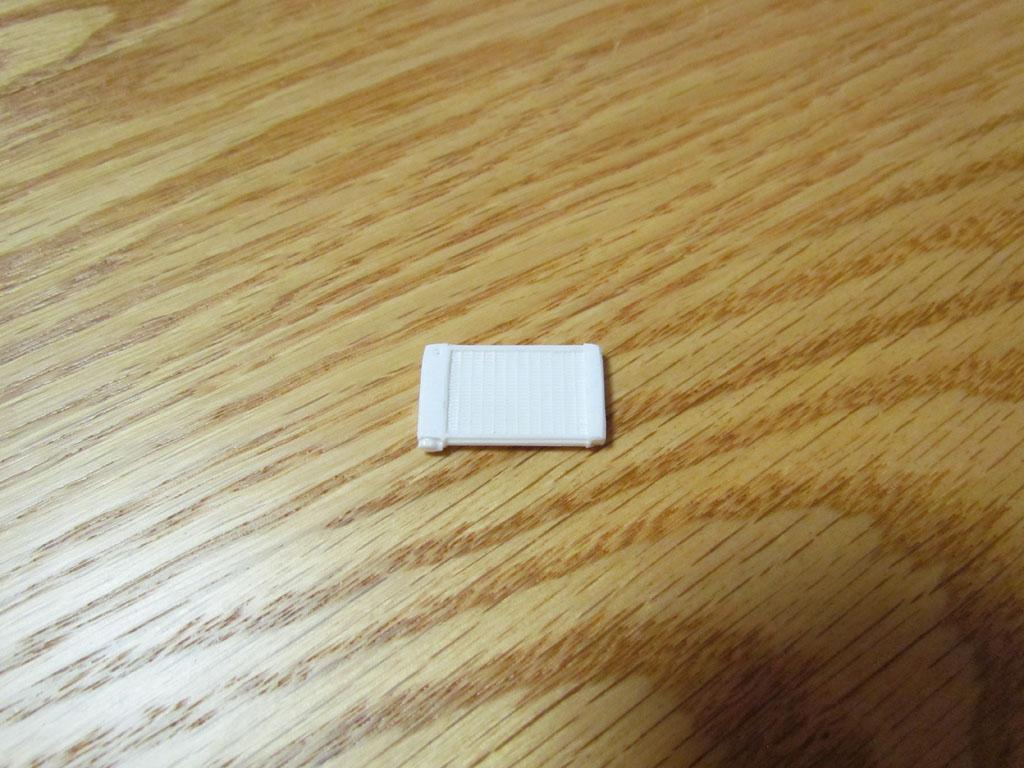

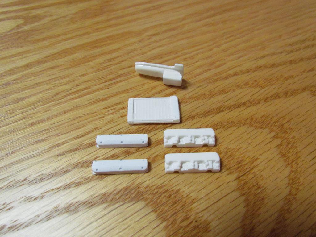

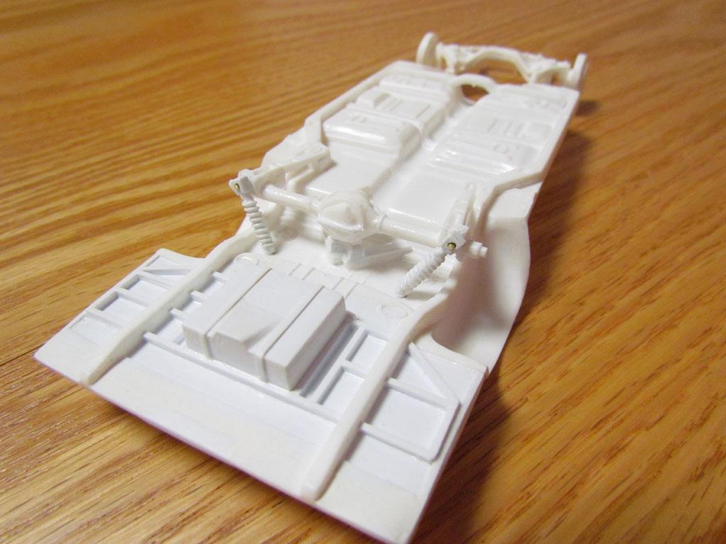

crowe-t Posted January 19, 2022 Author Posted January 19, 2022 (edited) Here's some work I did on the heads to make them look like Edelbrock heads. I started scratch building the valve covers and modified the sump on the oil pan to make it resemble a Milodon pan. I have to scribe the lines in the sump but since a good portion of the front of the pan is hidden under the cross member I won't have to re-shape that area. I scratch built the rear coil overs. I installed 1mm round brass rods on the rear end and the tops of the shocks to make installation easier after it's all painted. I also started adding the details to the rear end cover. I added some styrene to smooth out the side tanks on the stock radiator. I'll add some small bolts in the holes of the valve covers. Thanks for looking in. Edited January 19, 2022 by crowe-t 1

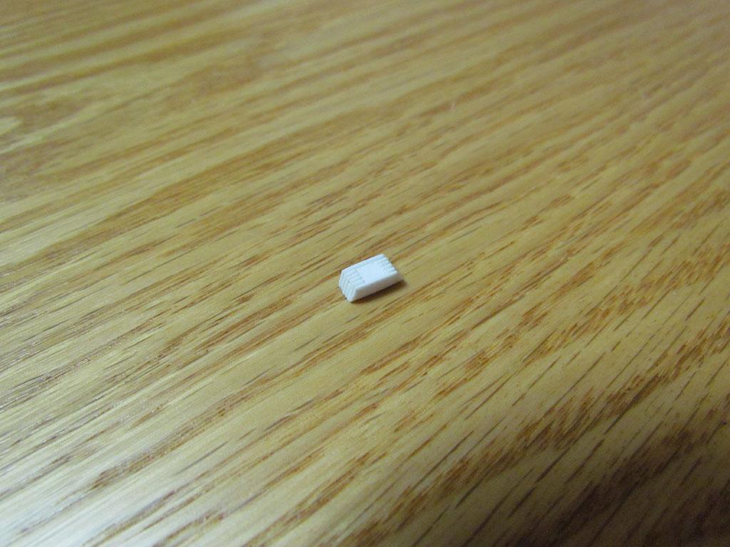

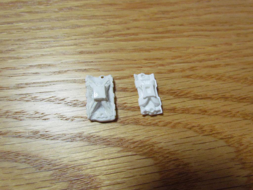

crowe-t Posted January 20, 2022 Author Posted January 20, 2022 Here's some more work I did today. I added the raised details and bolts to the rear end cover. The details look better in person. They are very small and hard to photograph. I made the 2 boxes between the seats and put the 'chrome' base of the shifter boot on the floor. The shifter is temporarily glued in for the picture. The picture without the dash shows the gas pedal. I added the emergency brake release lever under the dash. 1

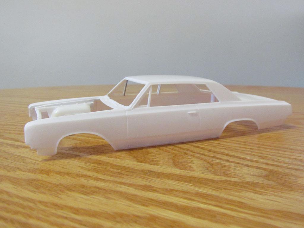

crowe-t Posted February 23, 2022 Author Posted February 23, 2022 (edited) Here's some progress pictures of the body. I started adding the window frames and post to the passenger side. I also modified the shape of the vent window. The vent window's vertical post is now straighter. Edited February 23, 2022 by crowe-t 1

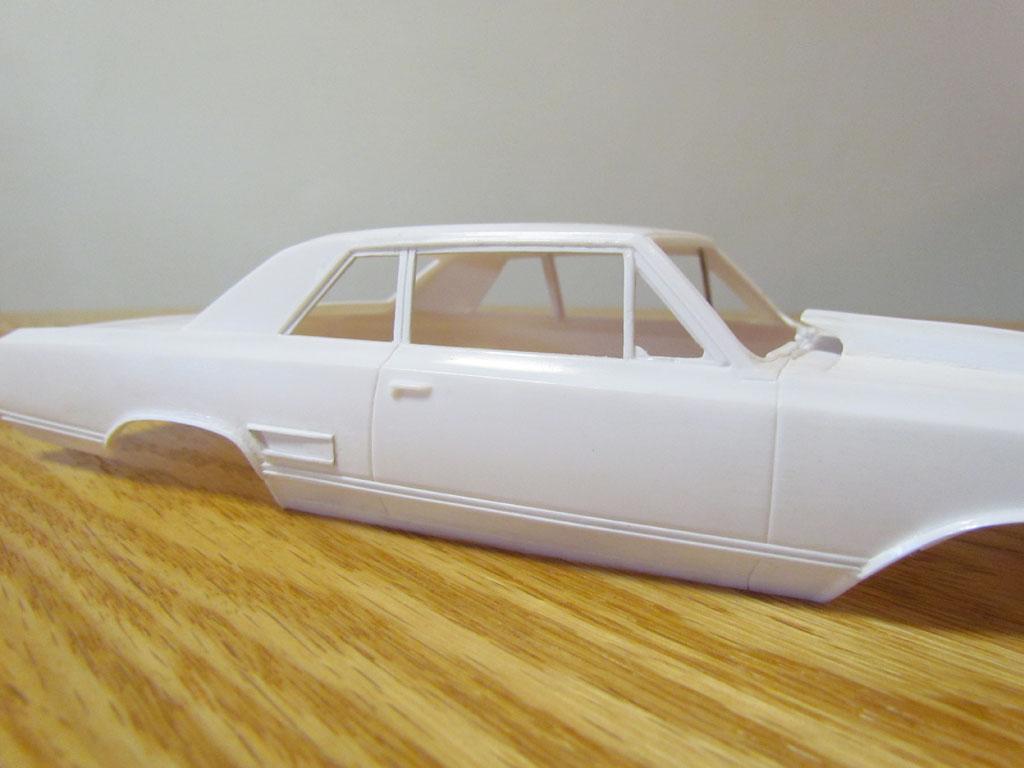

crowe-t Posted March 2, 2022 Author Posted March 2, 2022 (edited) I added the rest of the details to the body. I put the molding on and made the side scoops on the quarter panels. After it all cures I'll scribe the door lines in the molding. Edited March 2, 2022 by crowe-t
