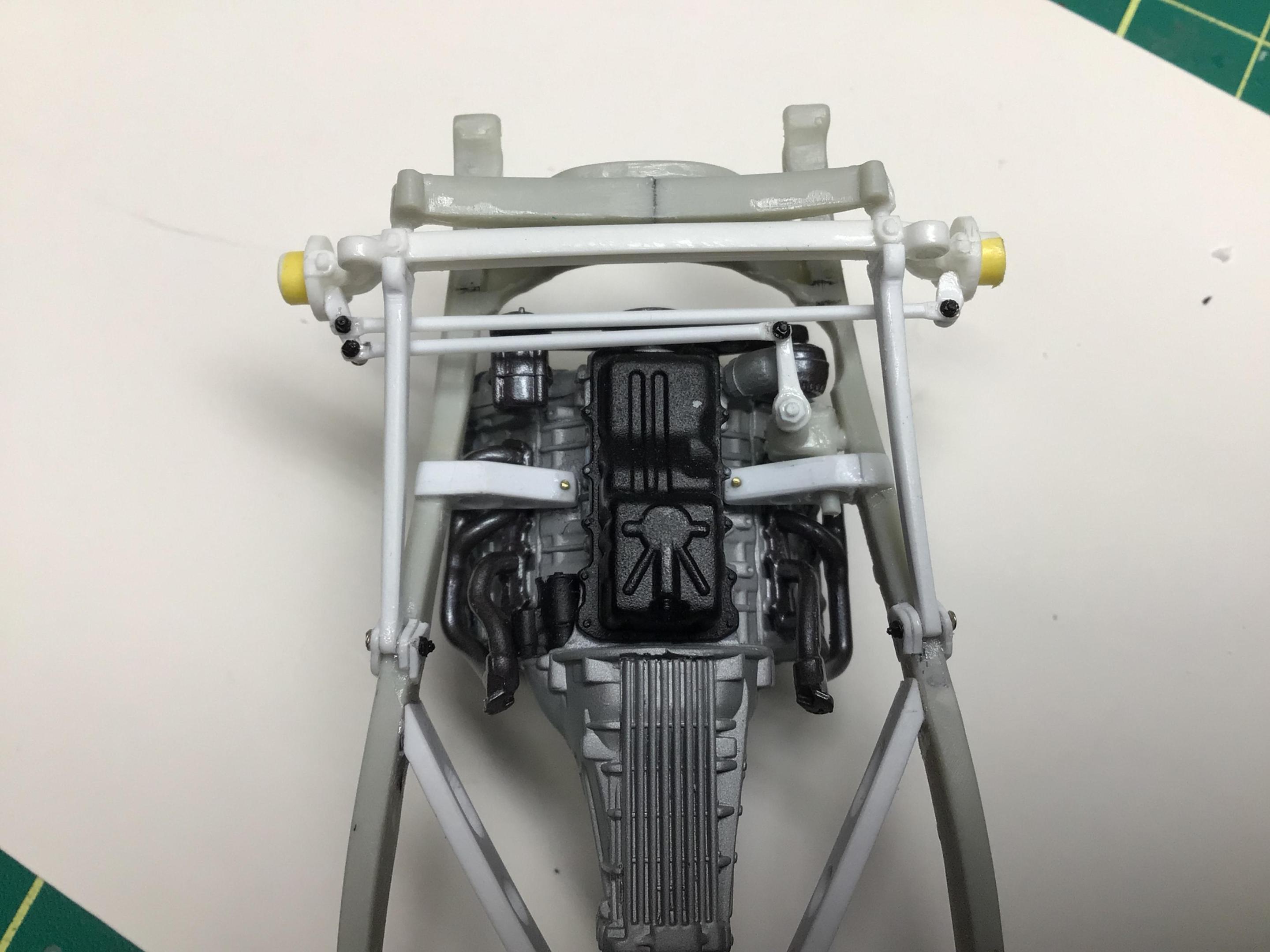

NOBLNG Posted January 22 Author Posted January 22 I modified and relocated the steering box and got some linkages made. Still have to run a shaft up to the firewall. And I need to fab up some front and rear shocks and that should be about it for the suspension. 4

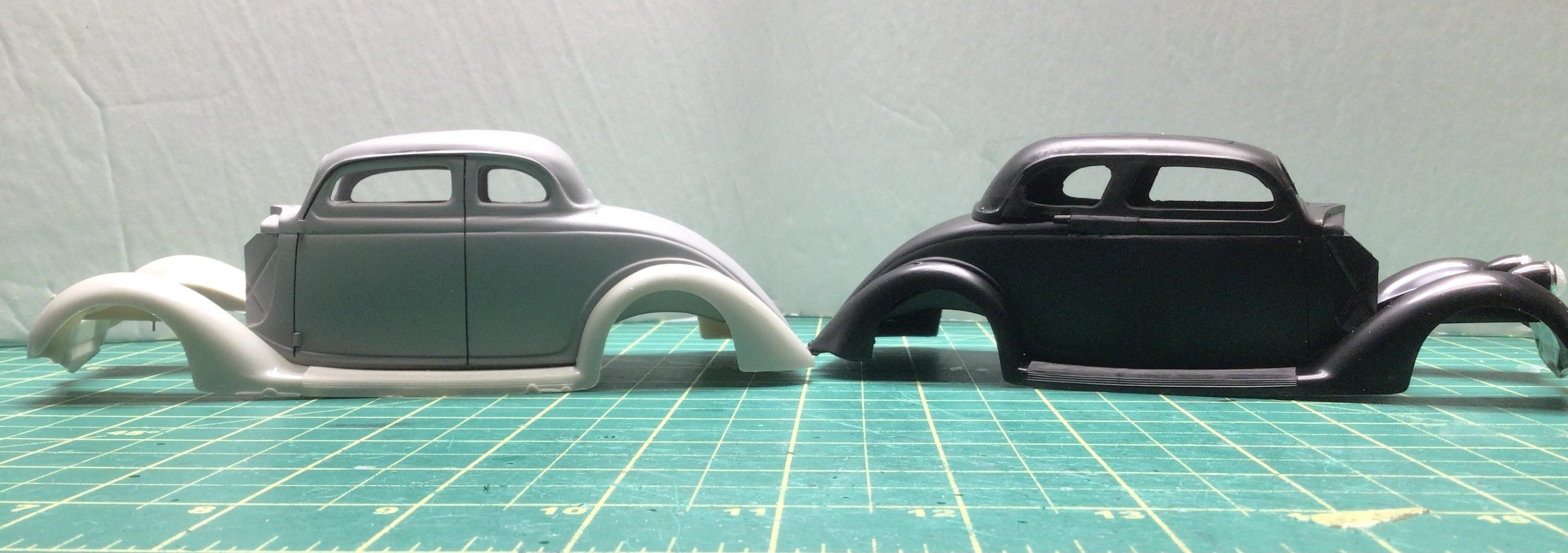

milo1303s Posted January 22 Posted January 22 On 1/12/2025 at 6:25 PM, NOBLNG said: The black body give great 36 ford Humpback vibes I like it !!!

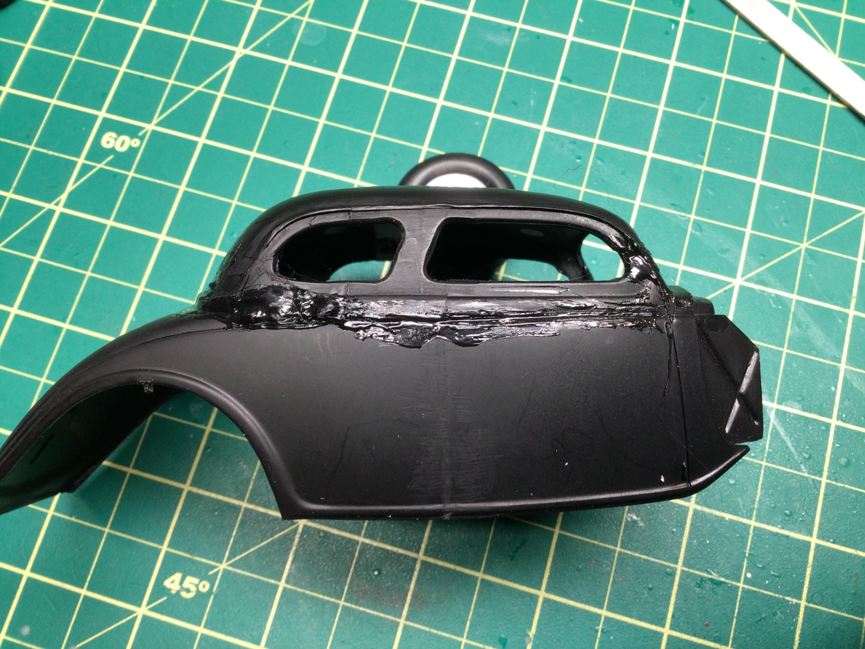

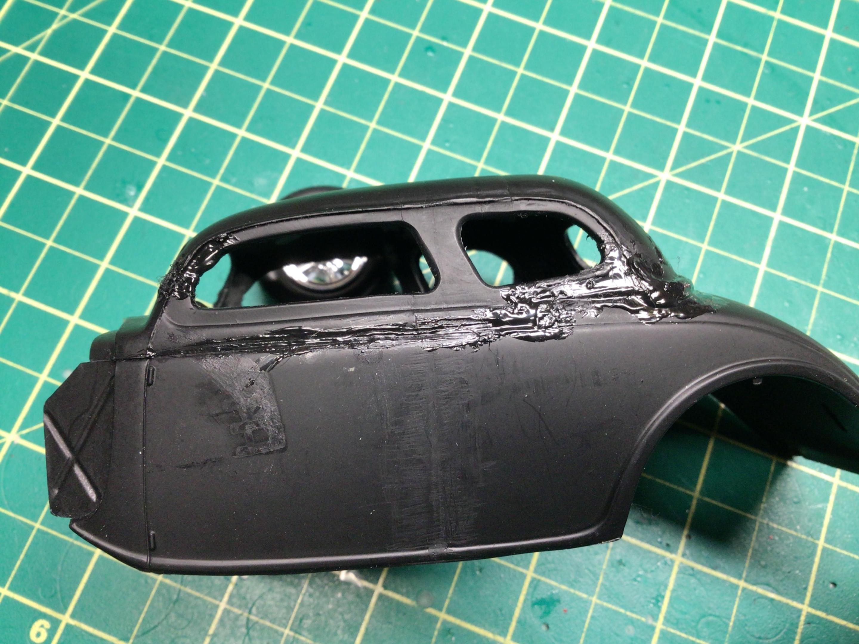

NOBLNG Posted January 22 Author Posted January 22 (edited) 4 minutes ago, milo1303s said: The black body give great 36 ford Humpback vibes I like it !!! Well I have it gooped up with some sprue goo, so we’ll see if I can get that roof blended in nicely….someday. Edited January 22 by NOBLNG
Zippi Posted January 23 Posted January 23 Looking good Greg. I had trouble with both the 36's I build getting the sprue goo sanded down nicely. Yours should turn out better than mine did. 1
customline Posted January 23 Posted January 23 Greg, the black body looks like you could put jump-seats in the back. A sort of phantom, maybe? It kinda reminds me of the '39 Chevy coupe. Sanding it into shape should be fun 🙂. 1

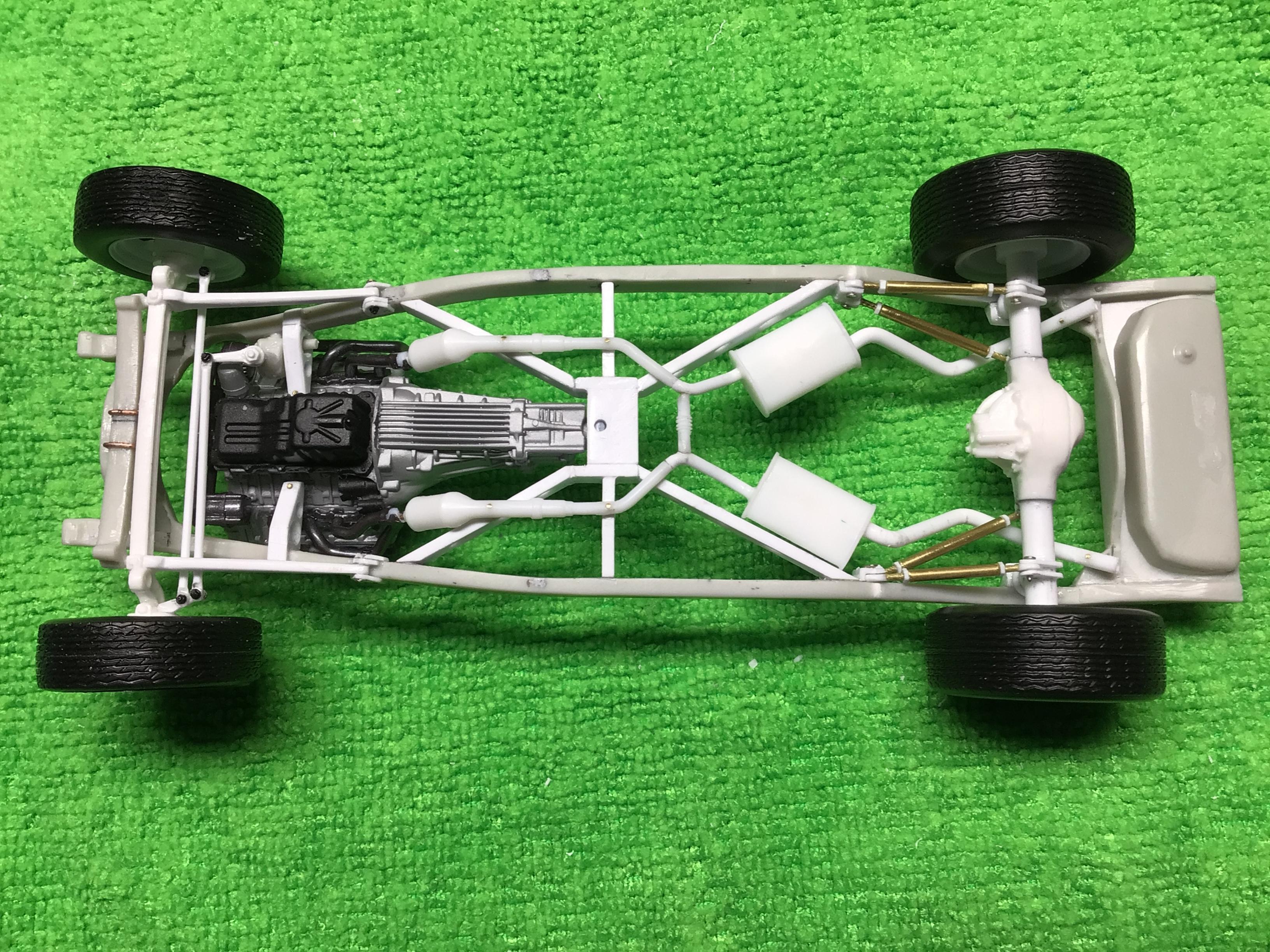

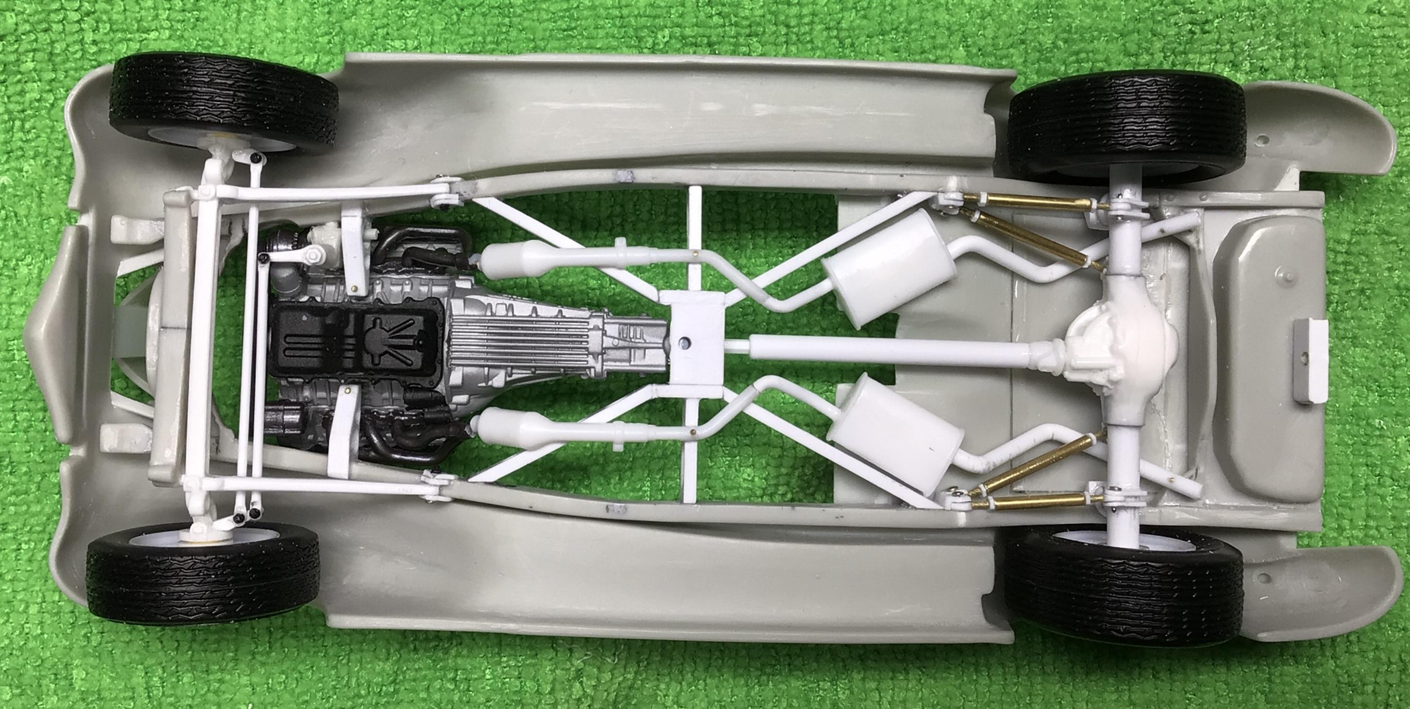

NOBLNG Posted January 26 Author Posted January 26 I am actually using the Boss 302 engine from the Revell 2013 Mustang kit. So I decided to scavenge the exhaust system for parts. I used the catalytic converters, then a short pipe made from 1/16” Evergreen to connect to the mufflers. The mufflers I narrowed to get room for a driveshaft and then made the rear pipes from .080” Evergreen. I’m not sure if I will dump them there or fab up some tailpipes yet. I also made a driveshaft using the Mustang ends, some 1/8” tube and .060” hex. 7

NOBLNG Posted January 27 Author Posted January 27 I added the cross-over pipe and that’s it for today…I’m exhausted.🥴 4 1

slusher Posted January 27 Posted January 27 7 hours ago, NOBLNG said: I am actually using the Boss 302 engine from the Revell 2013 Mustang kit. So I decided to scavenge the exhaust system for parts. I used the catalytic converters, then a short pipe made from 1/16” Evergreen to connect to the mufflers. The mufflers I narrowed to get room for a driveshaft and then made the rear pipes from .080” Evergreen. I’m not sure if I will dump them there or fab up some tailpipes yet. I also made a driveshaft using the Mustang ends, some 1/8” tube and .060” hex. Did you scratch your converters ant the beginning of your exhaust or is that something else?
NOBLNG Posted January 27 Author Posted January 27 7 hours ago, slusher said: Did you scratch your converters ant the beginning of your exhaust or is that something else? The converters and pipes until just past the first bend are from the Mustang Carl. 1
BK9300 Posted January 27 Posted January 27 Very impressive modifications to your frame, right down to the pins for your engine mounts - very nice! 1
