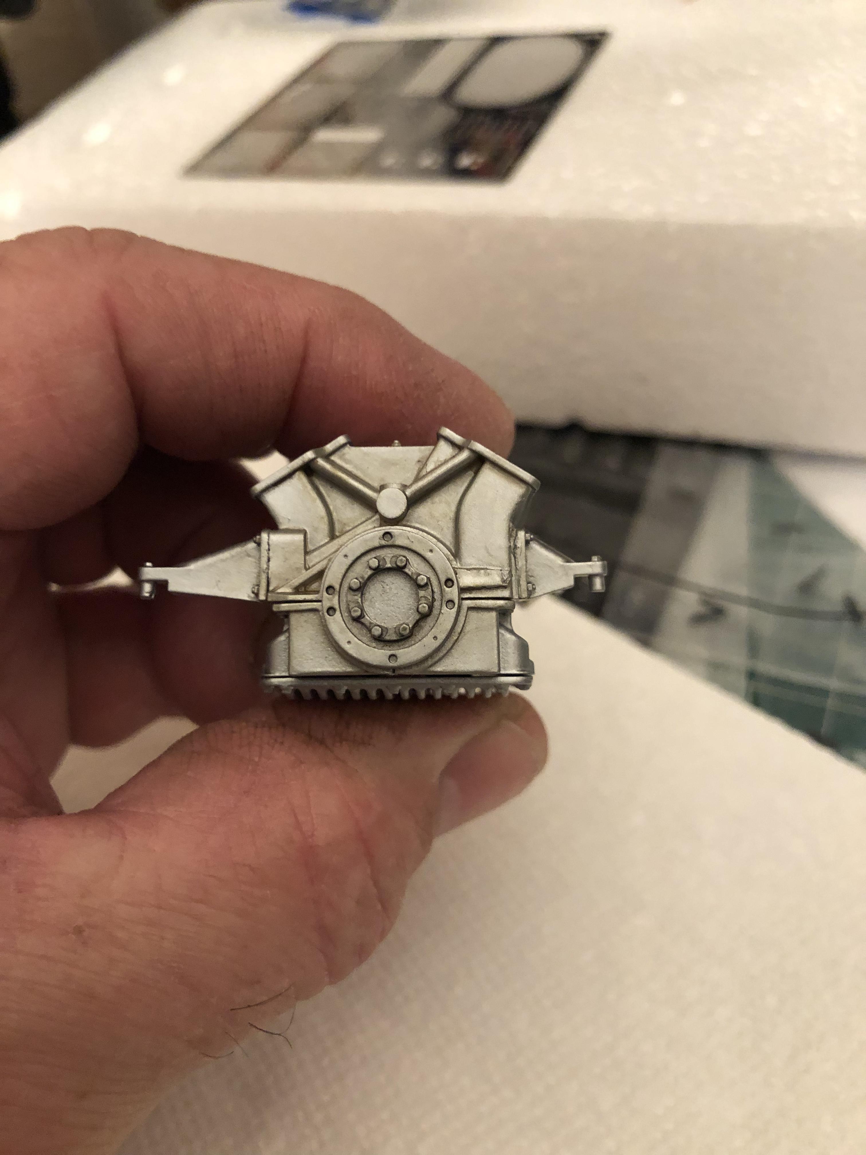

Chris Smith Posted December 29, 2021 Posted December 29, 2021 This is the 1960 Ferrari 256F1 in 1/12 scale by Model Factory Hiro. Its almost a new year, time for a new build. I have been chomping at the bit to start this one. I do appreciate the positive feedback and constructive criticism. Thanks for checking this out Chris

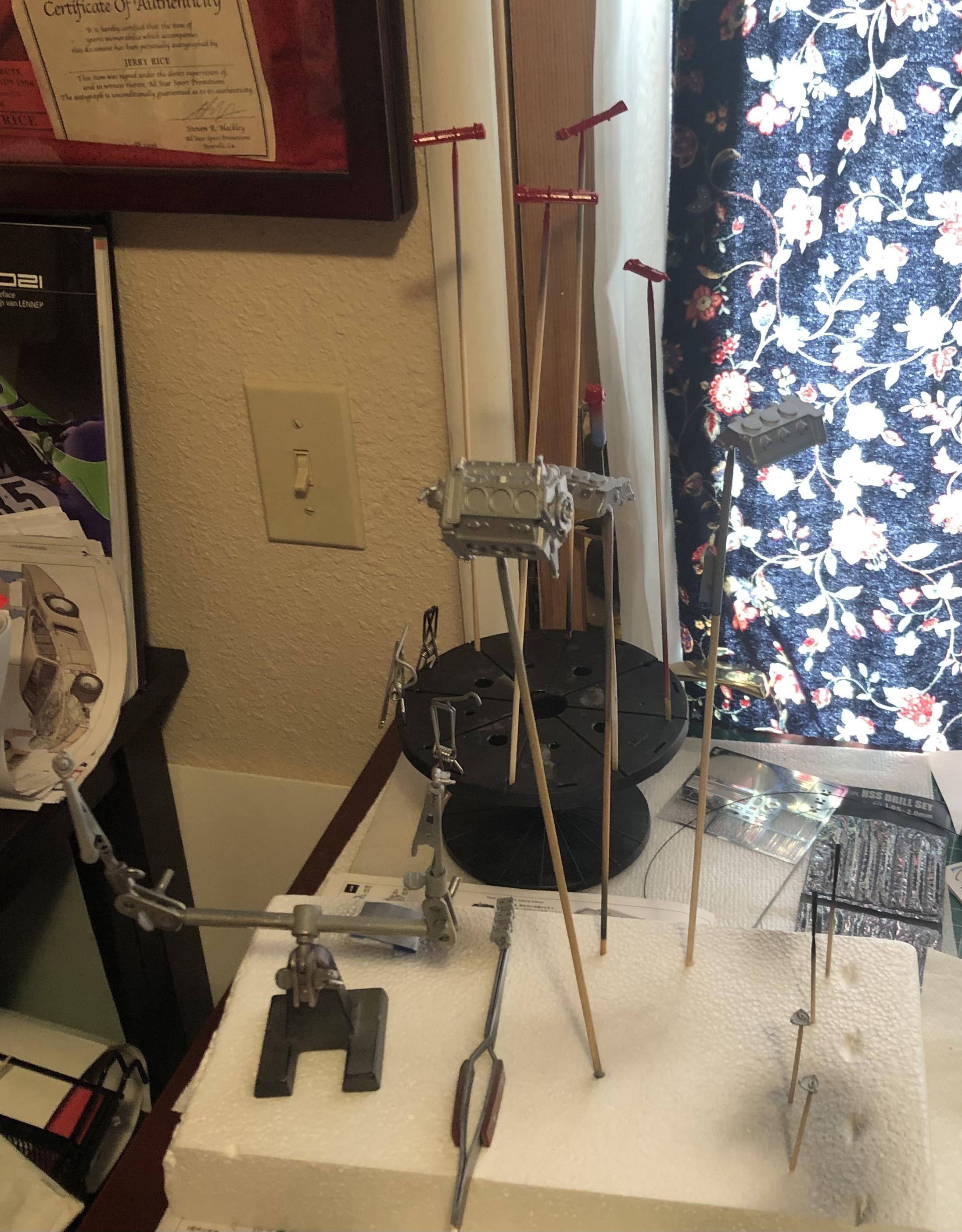

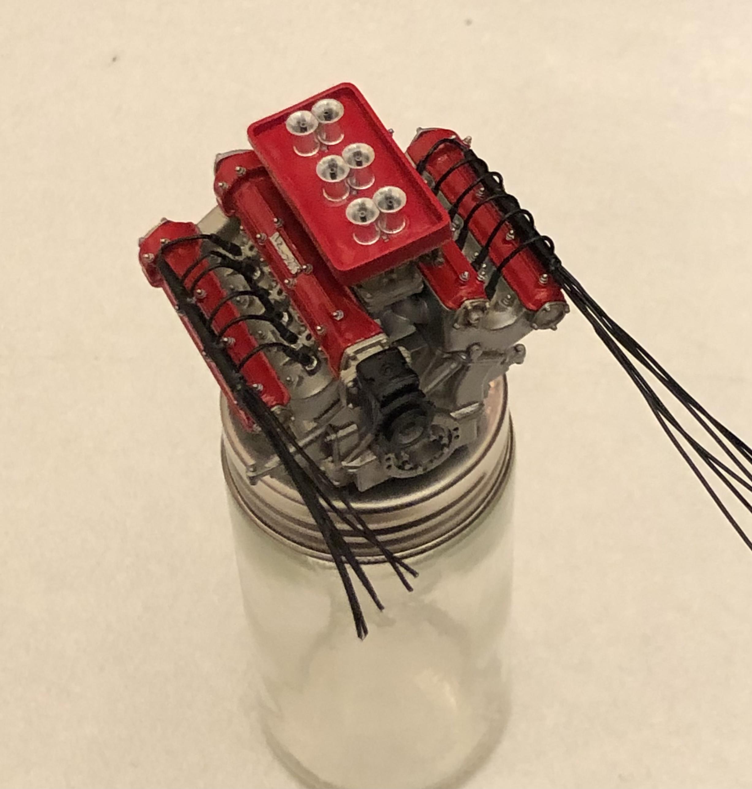

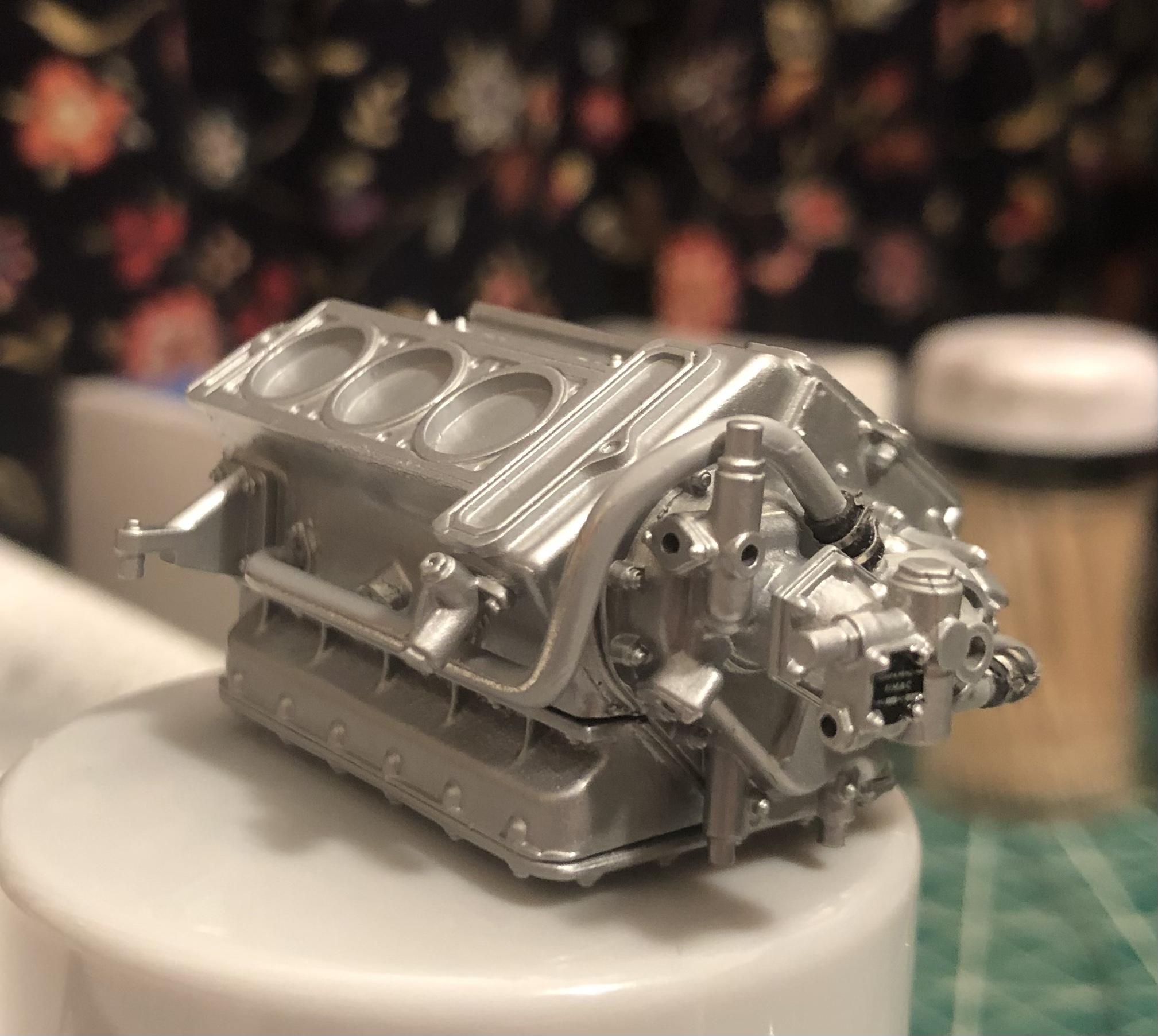

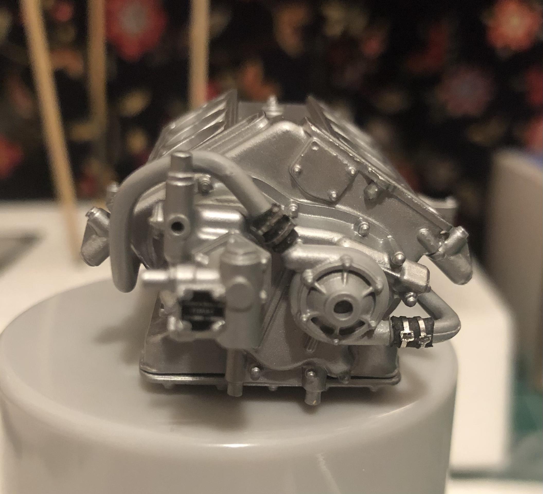

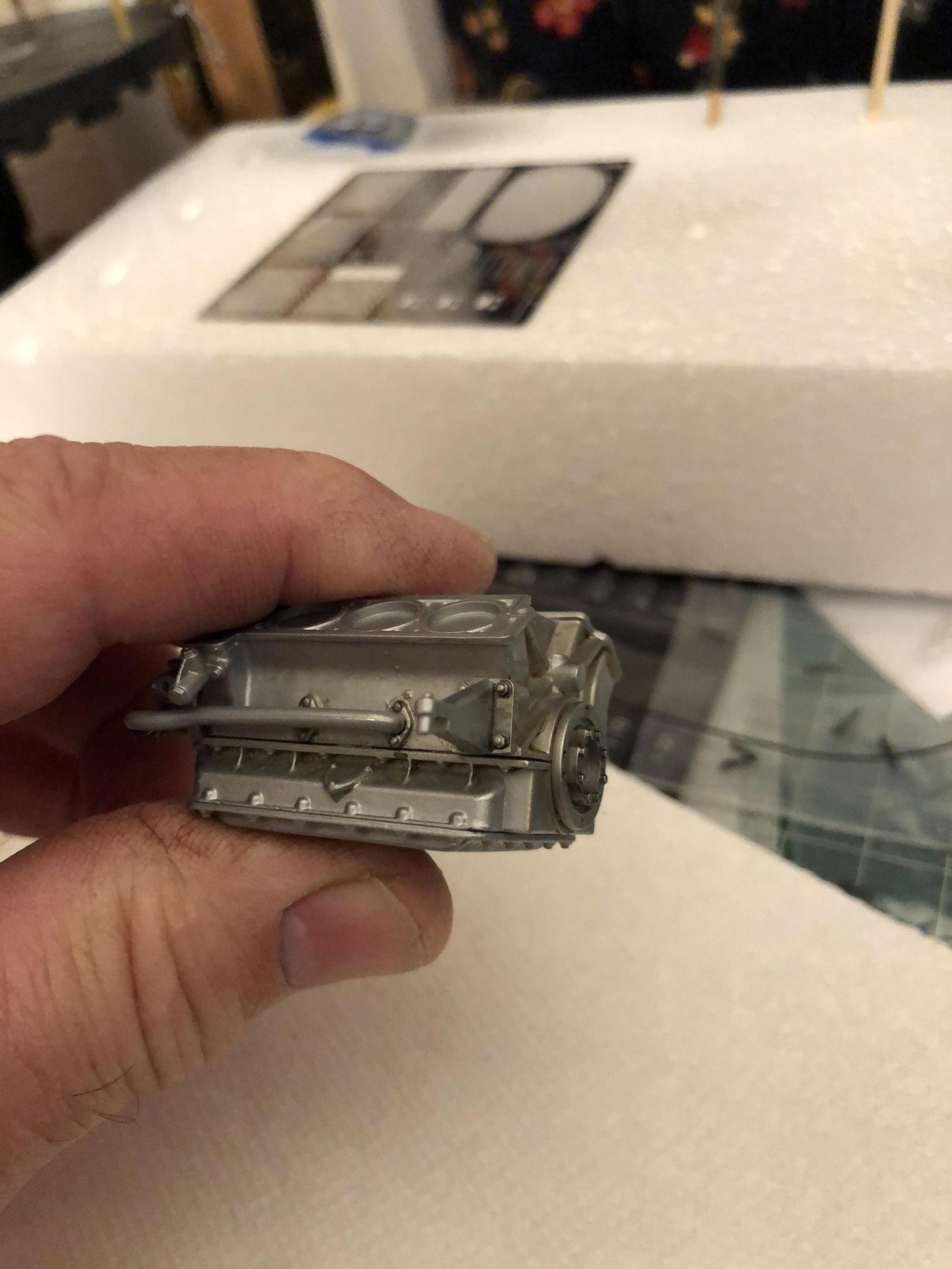

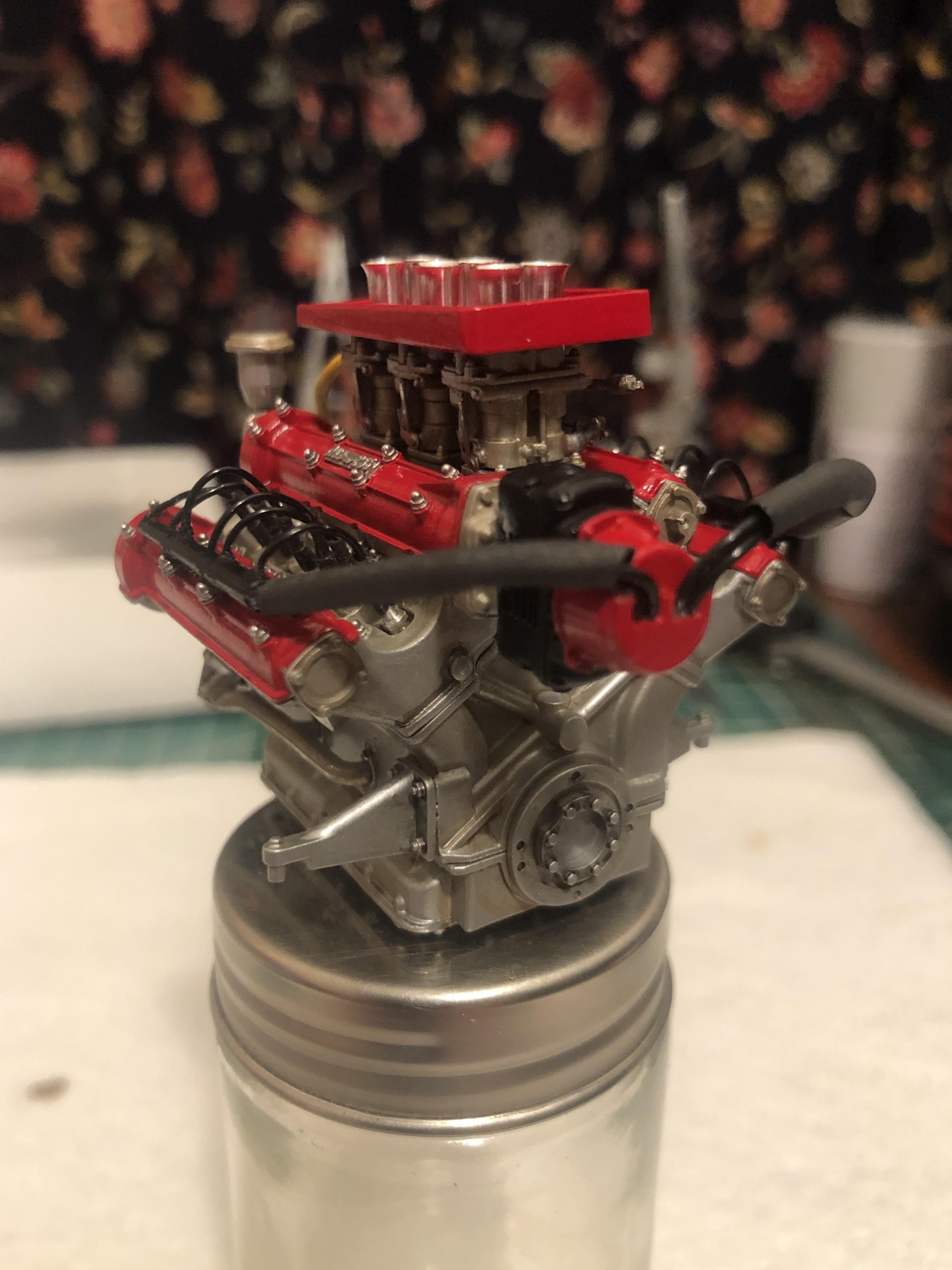

Chris Smith Posted January 3, 2022 Author Posted January 3, 2022 Weather was a good enough to get some parts painted today. I did spend a bit of time pre drilling and test fitting before I got some color on the engine. The hose clamps where a bit tricky, but I am happy the way they came out.

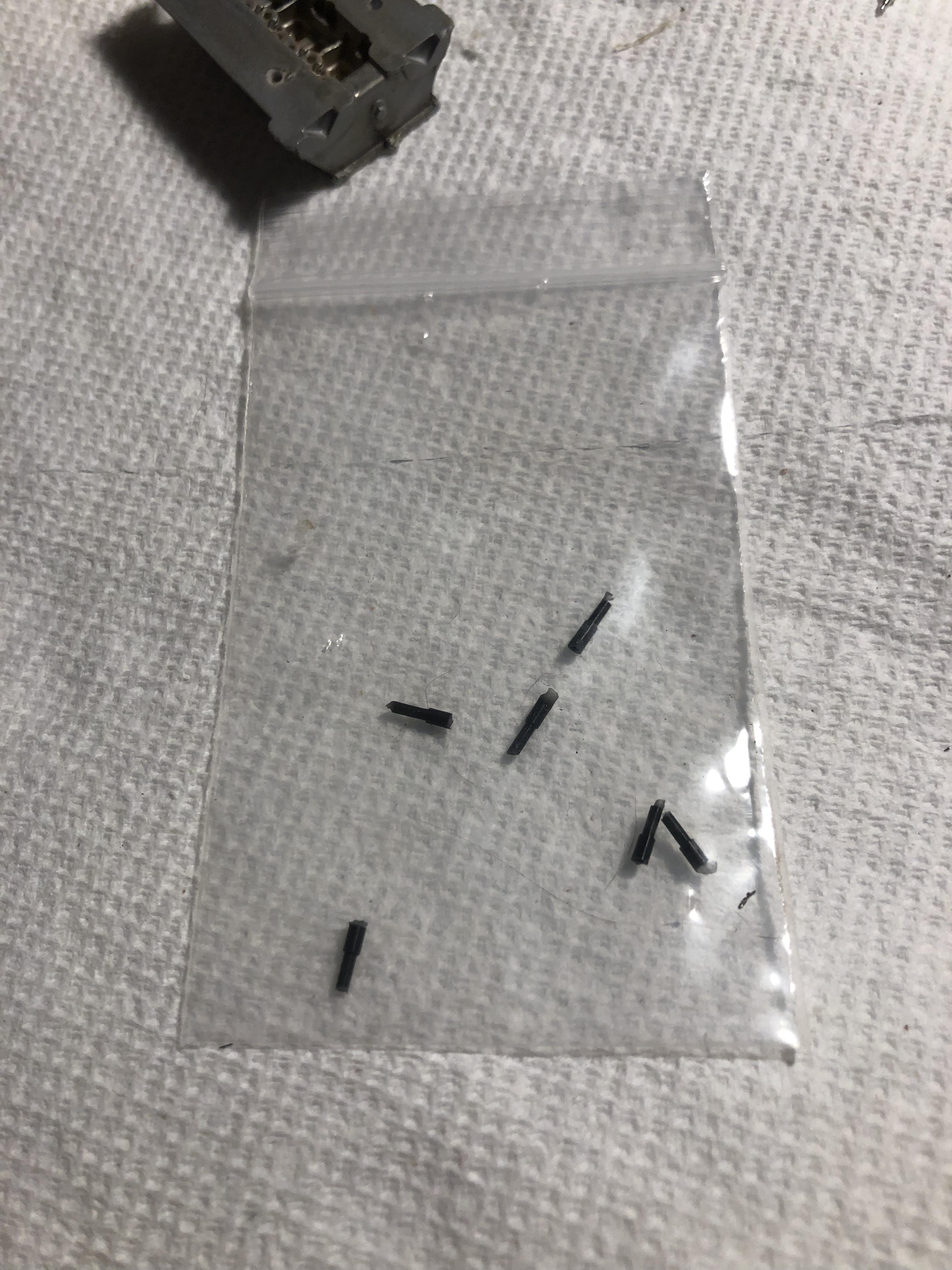

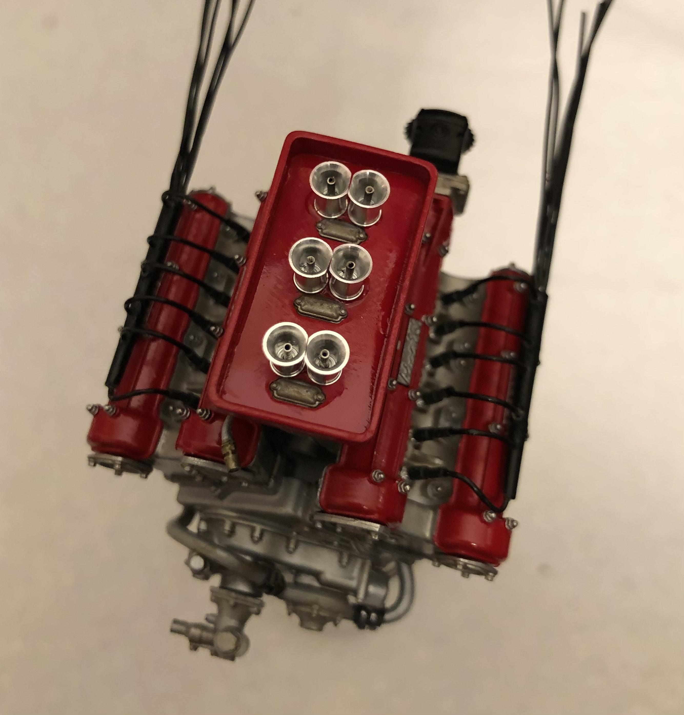

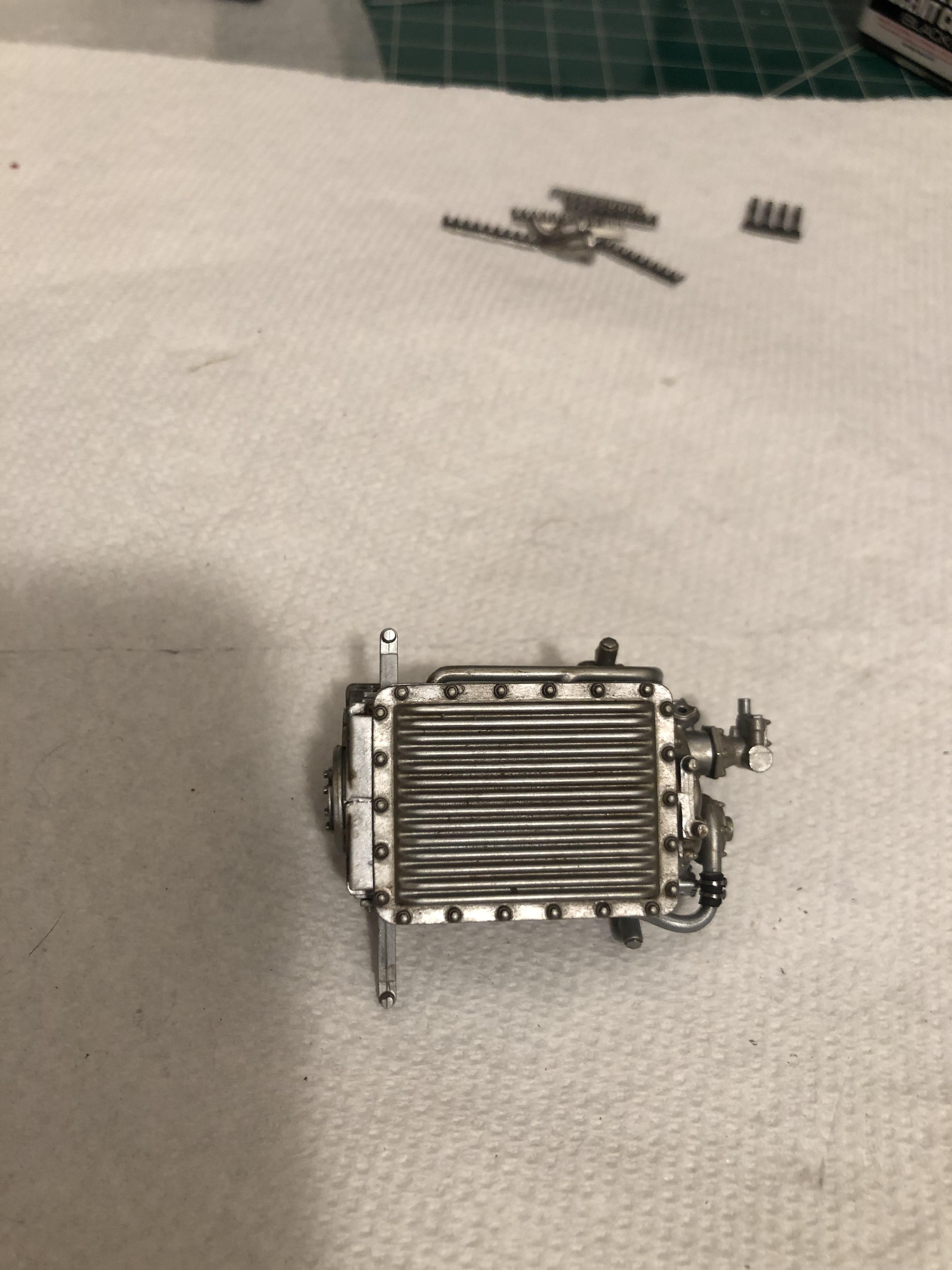

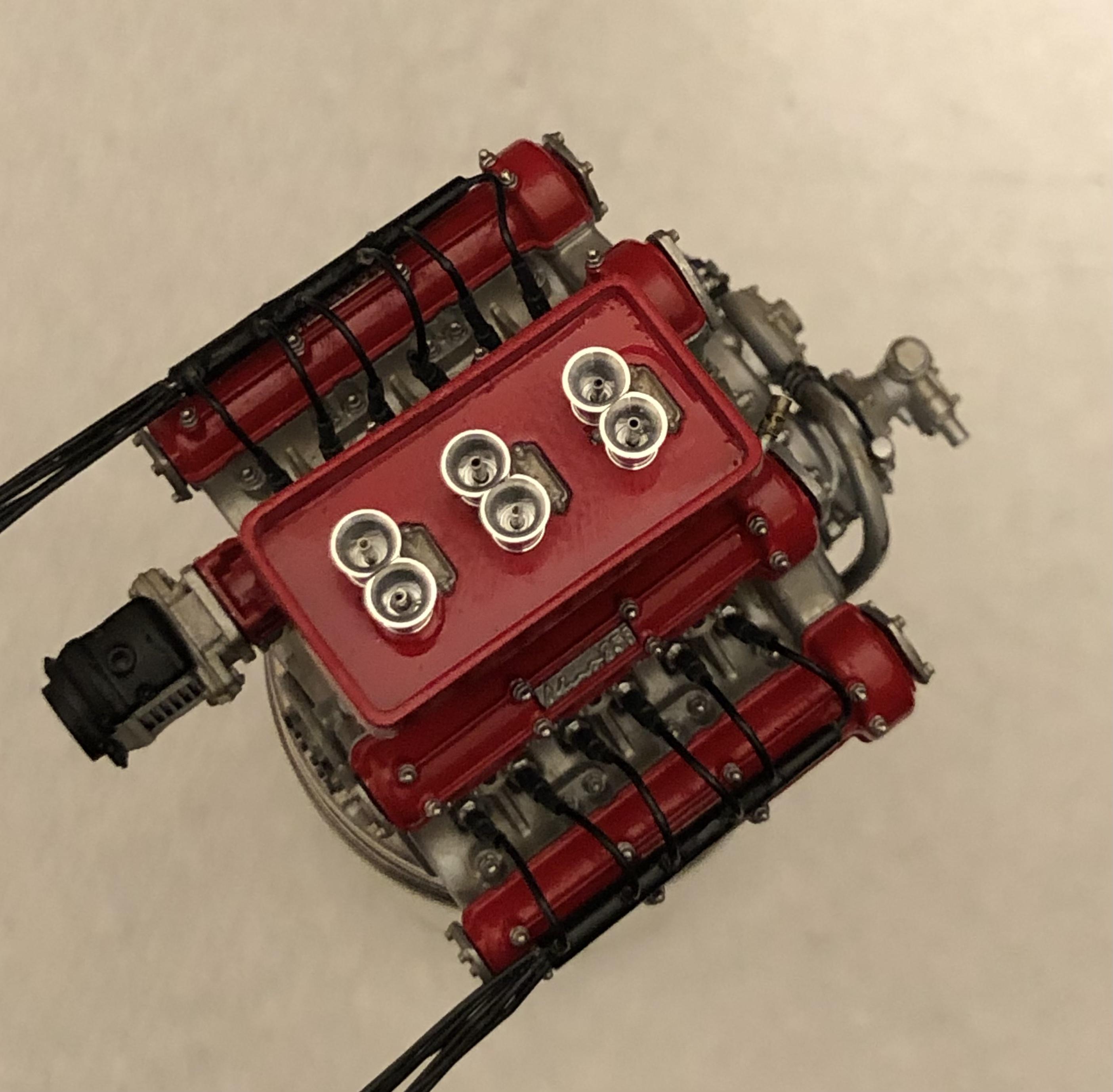

Chris Smith Posted January 5, 2022 Author Posted January 5, 2022 Last night I did a little weathering to add some depth to the engine, I’m happy with it. I will be using RB motions spark plugs and boots instead of the kit plugs. I like the look ?

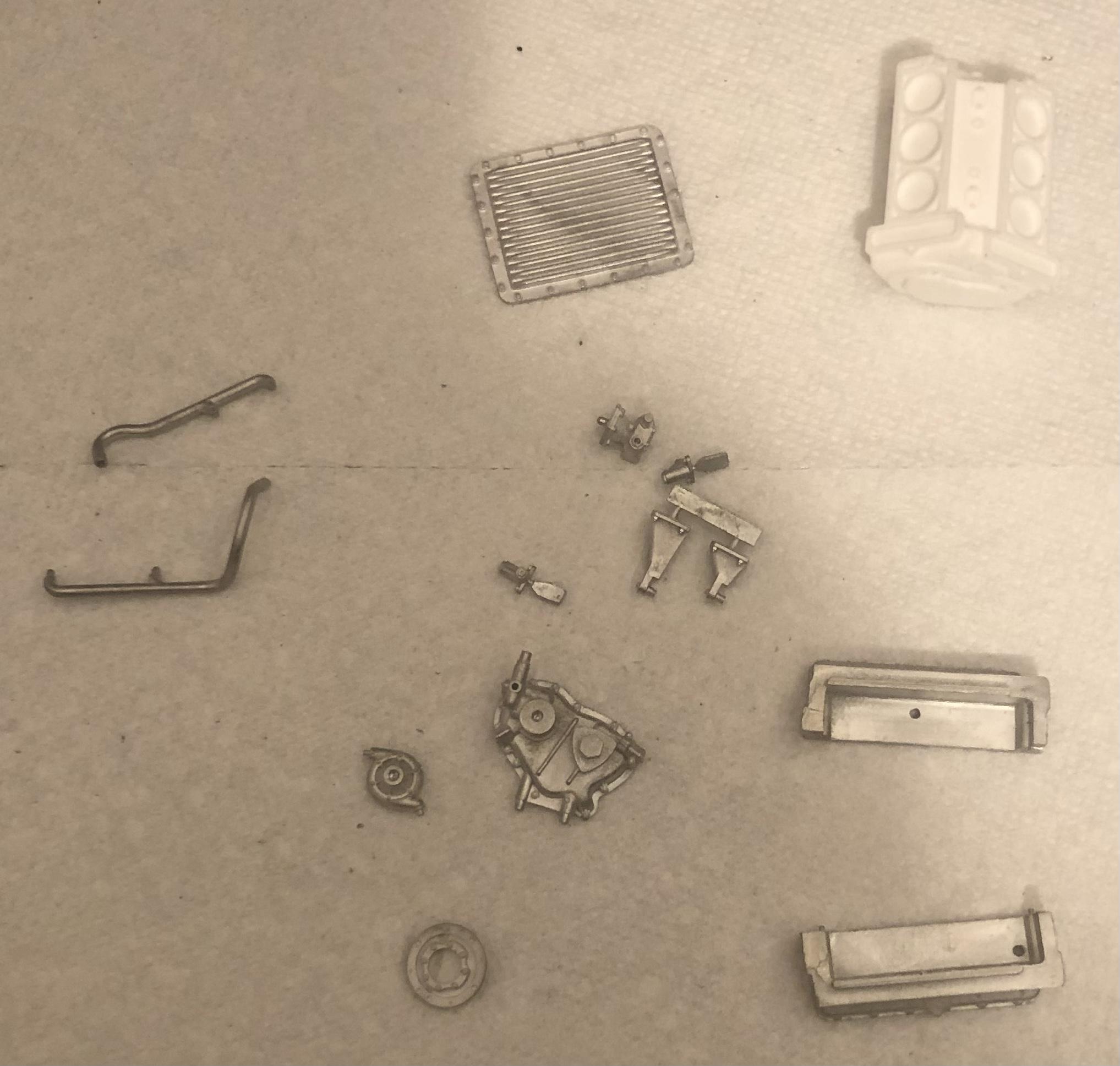

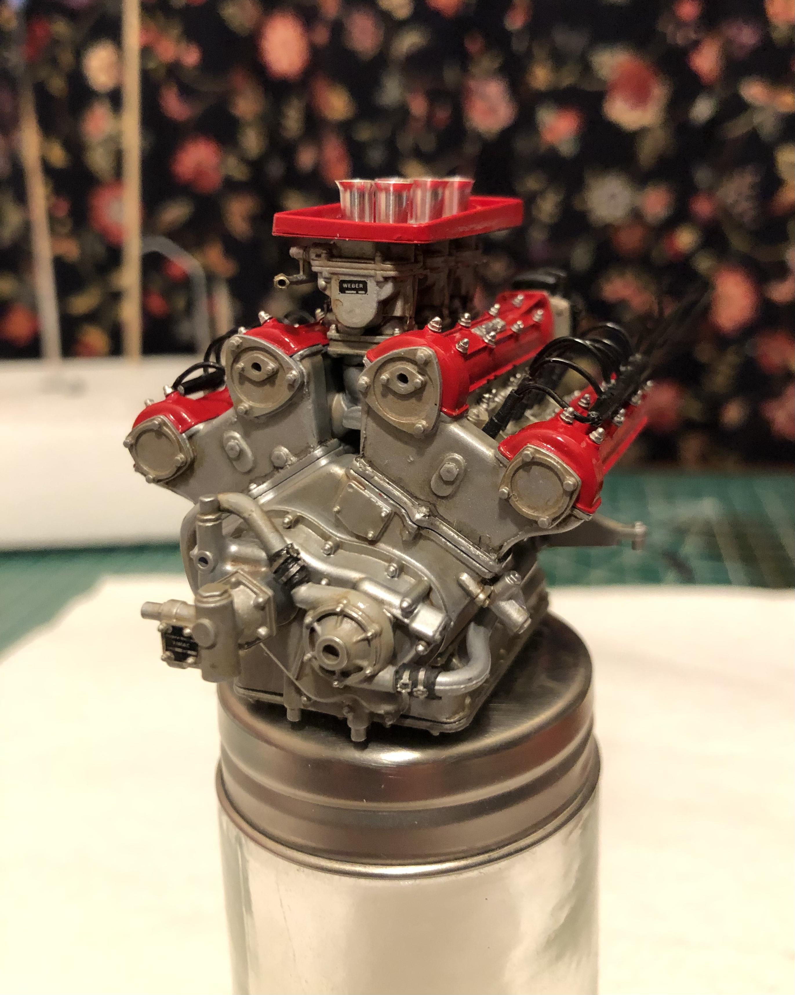

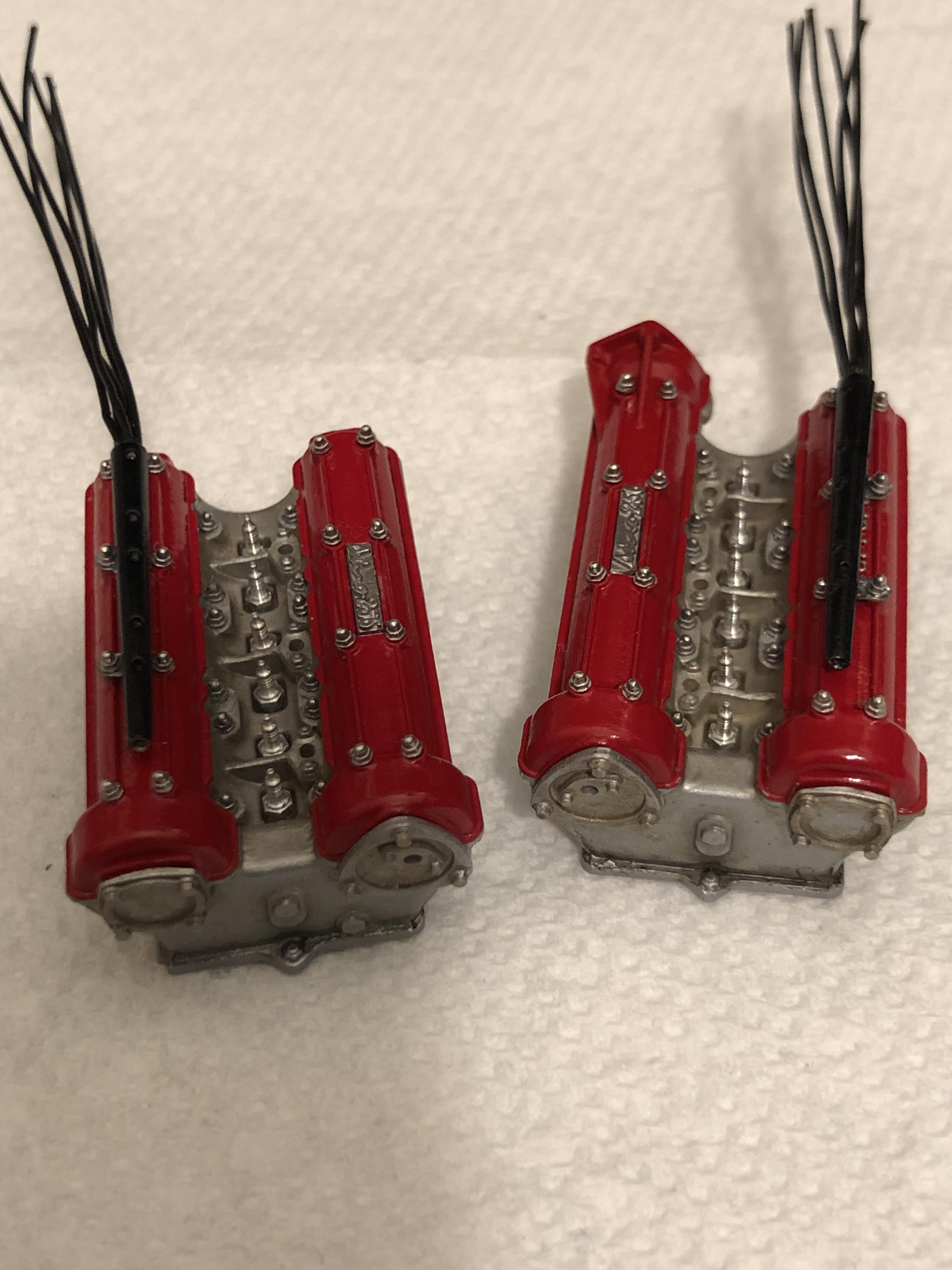

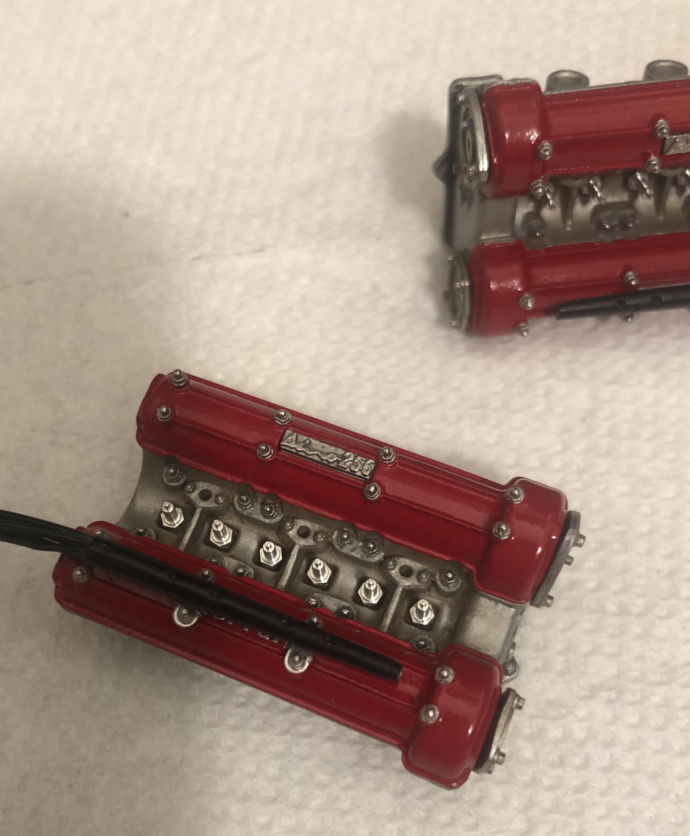

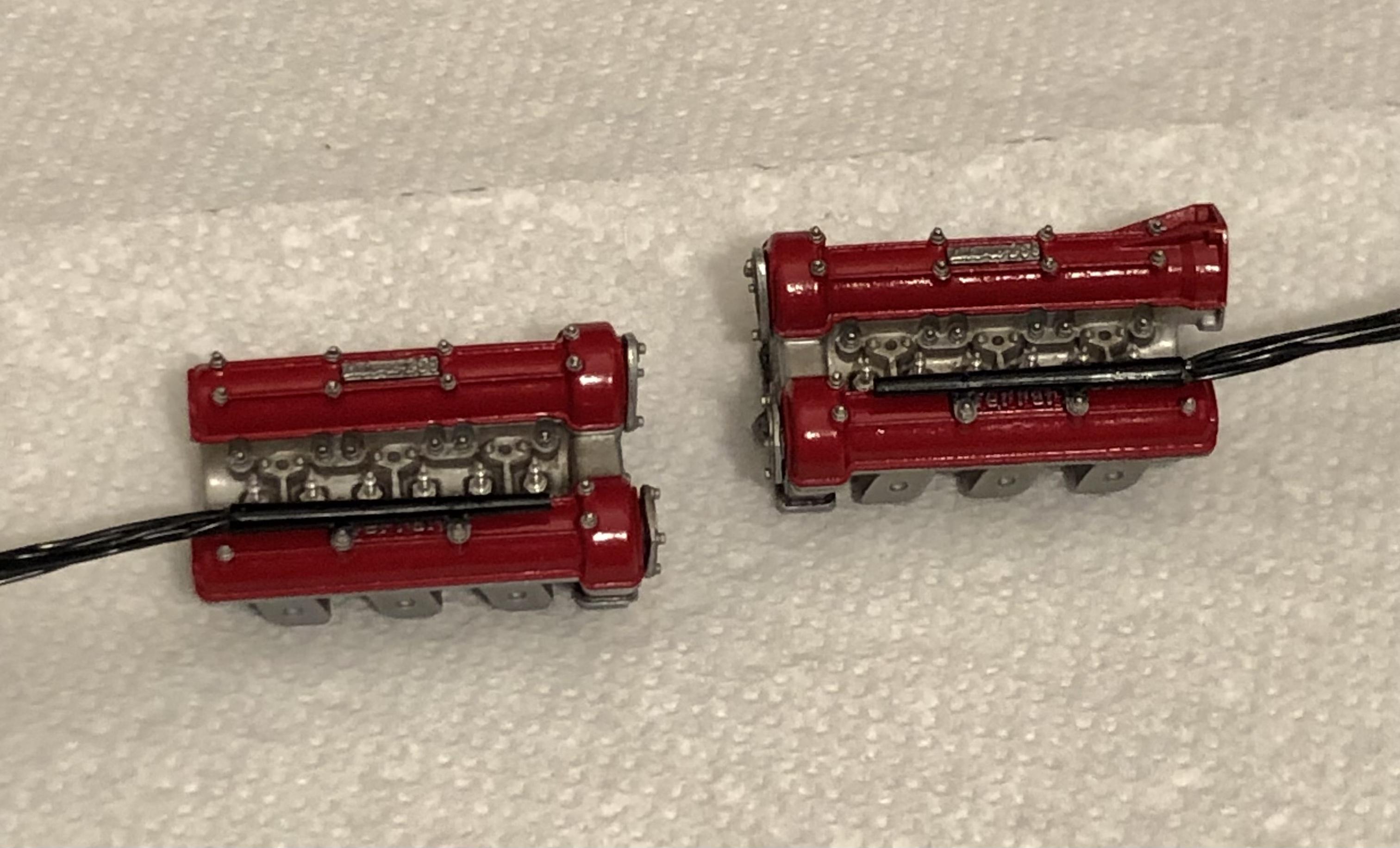

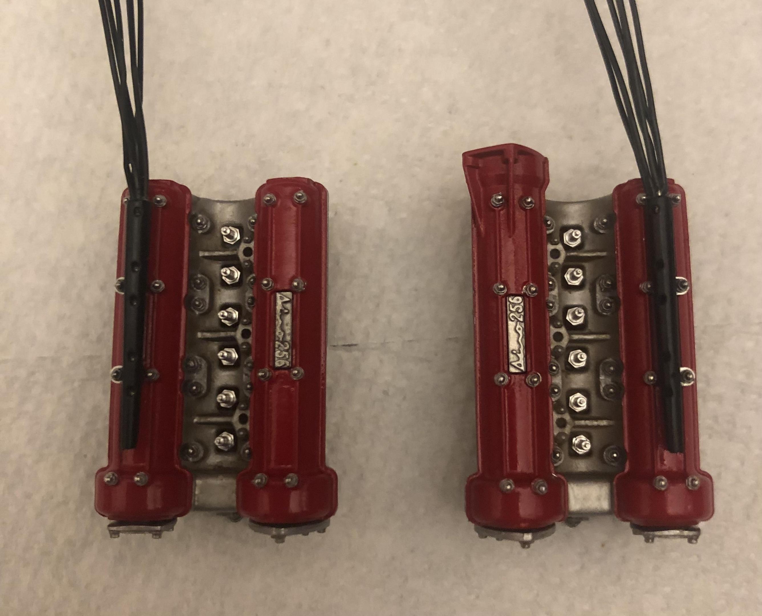

Chris Smith Posted January 9, 2022 Author Posted January 9, 2022 Working on the cylinder heads. Getting there…
Pierre Rivard Posted January 9, 2022 Posted January 9, 2022 Wow, beautiful work. What products do you use for weathering the engine parts? It looks so realistic.
Chris Smith Posted January 9, 2022 Author Posted January 9, 2022 48 minutes ago, Pierre Rivard said: Wow, beautiful work. What products do you use for weathering the engine parts? It looks so realistic. Thank you! I use Tamiya brown panel liner and a cotton bud

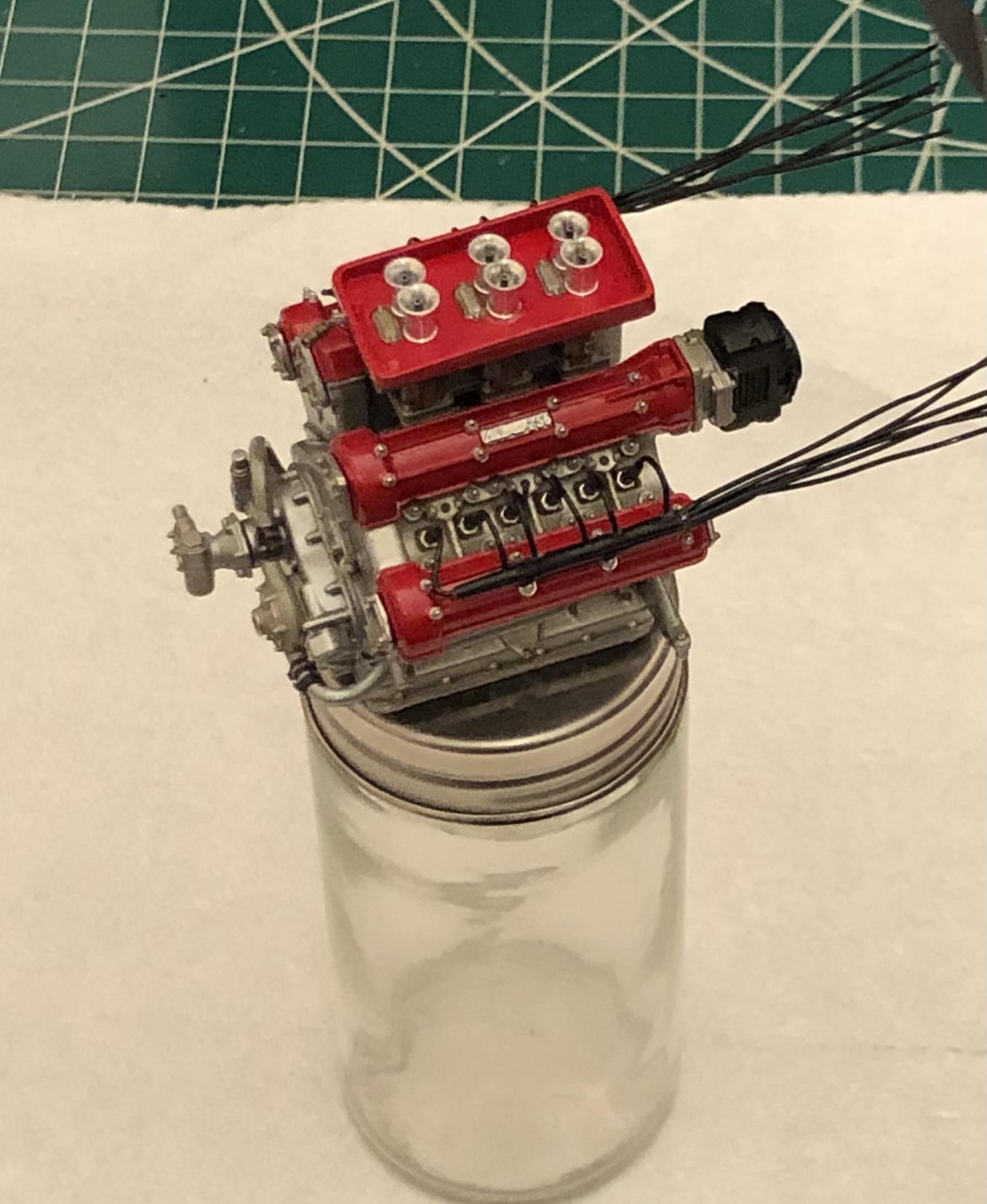

showrods Posted January 12, 2022 Posted January 12, 2022 (edited) Could you please tell us what brand and colour of paints that you're using as you show us each segment? Excellent work thus far! Edited January 12, 2022 by showrods

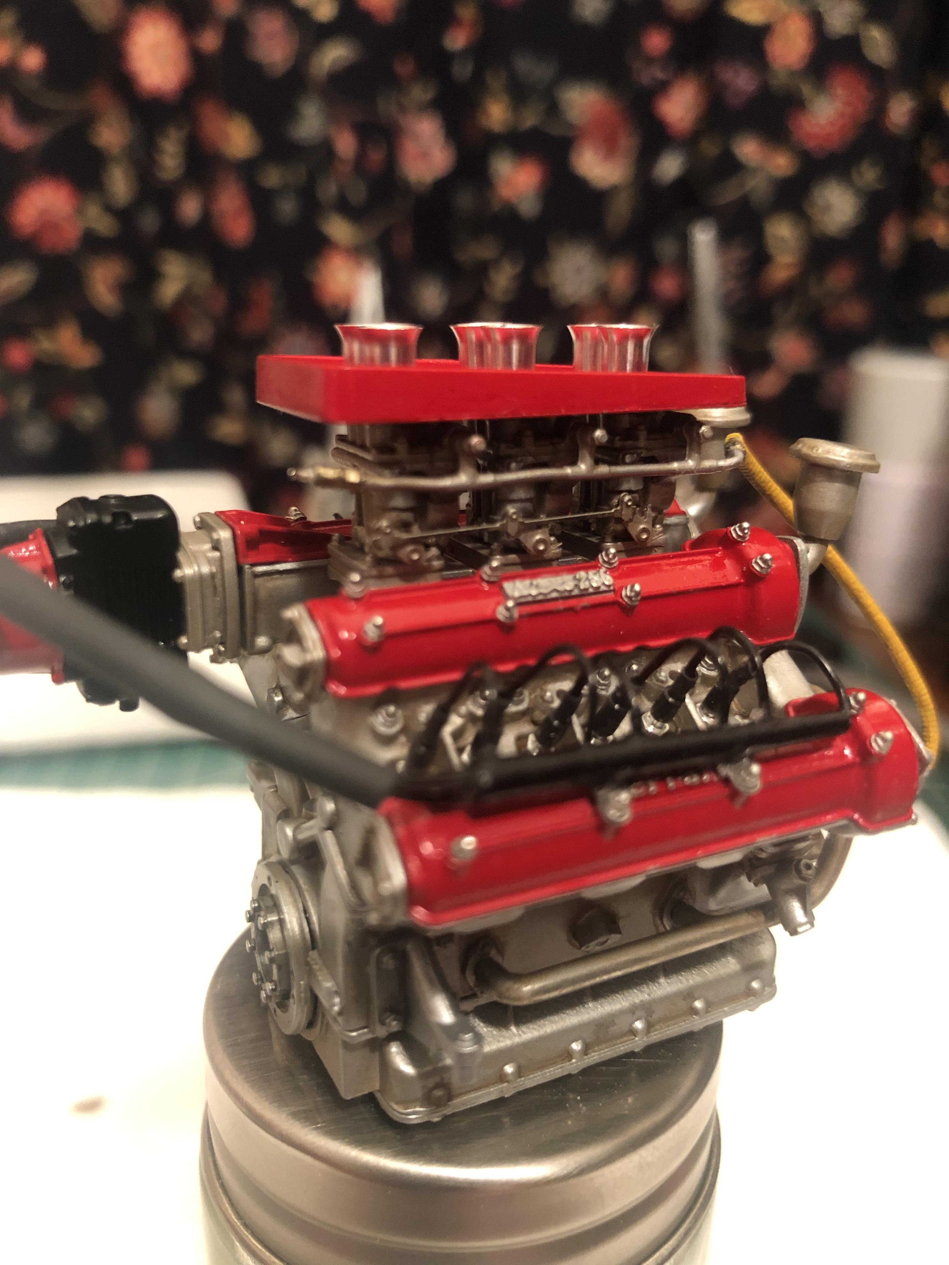

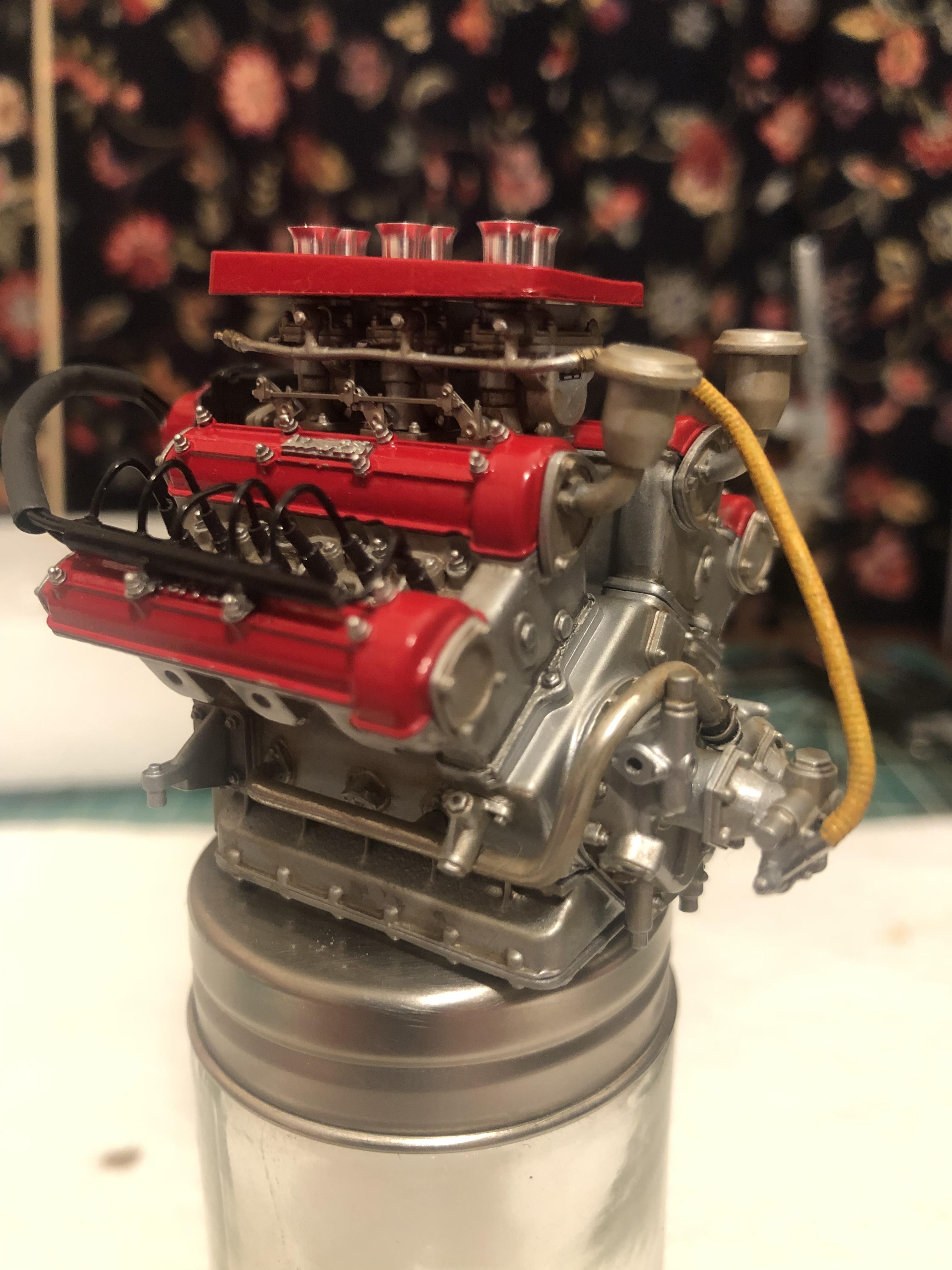

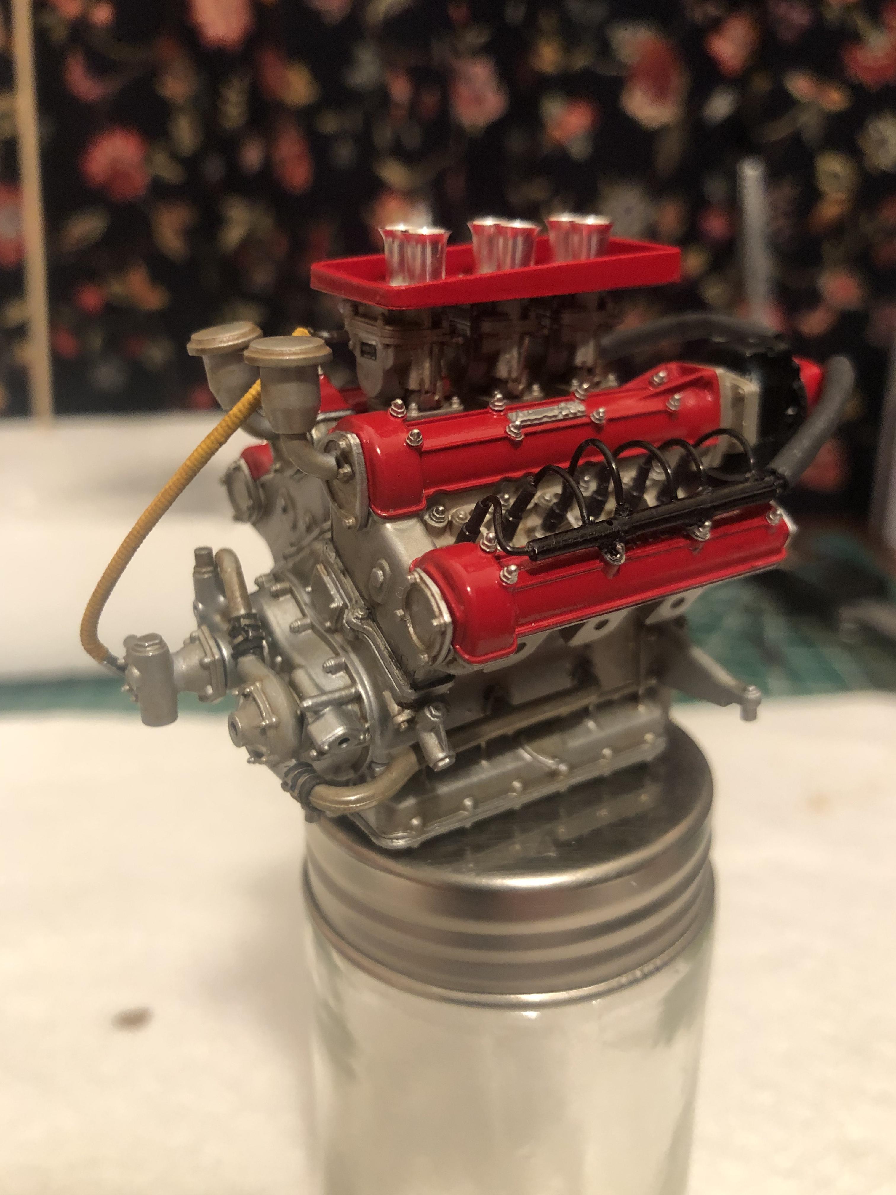

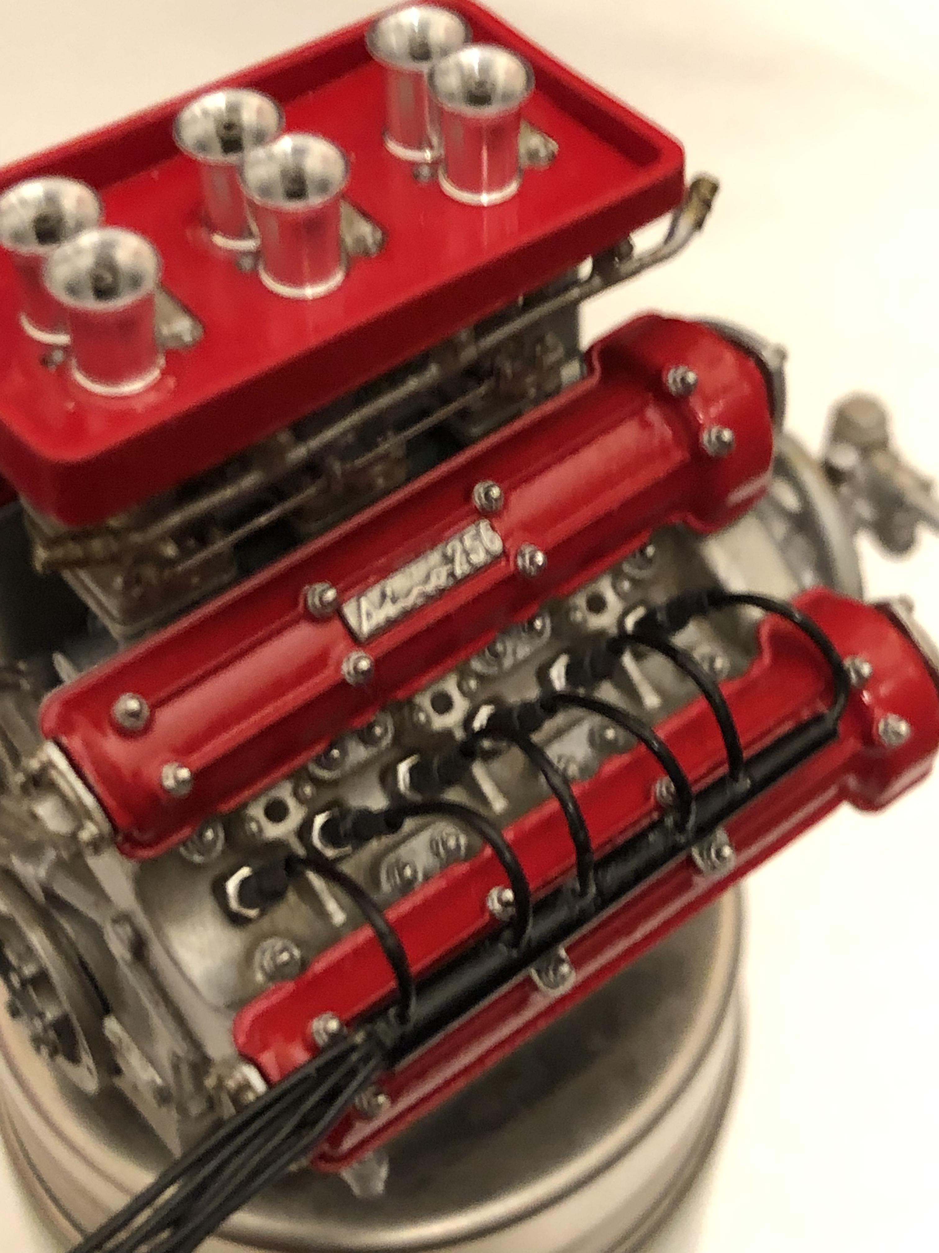

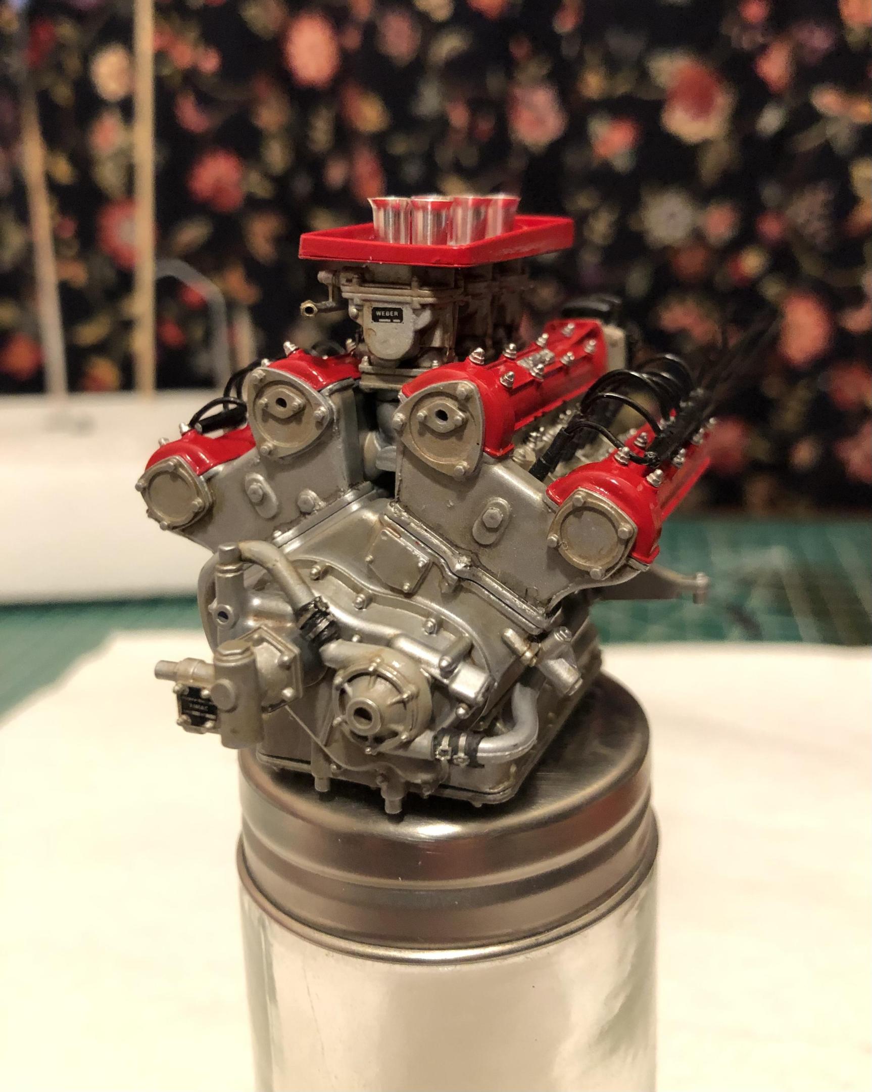

Chris Smith Posted January 12, 2022 Author Posted January 12, 2022 (edited) 6 hours ago, showrods said: Could you please tell us what brand and colour of paints that you're using as you show us each segment? Excellent work thus far! I’ll try? I am using Alclad aluminum over Tamiya grey primer the other paints are Tamiya red and semi gloss black I have been using Tamiya brown panel liner for a quick wash to give it depth. Okay, here is what I have completed so far. I still need to finish wiring the ignition, then I can move onto the frame Edited January 12, 2022 by Chris Smith

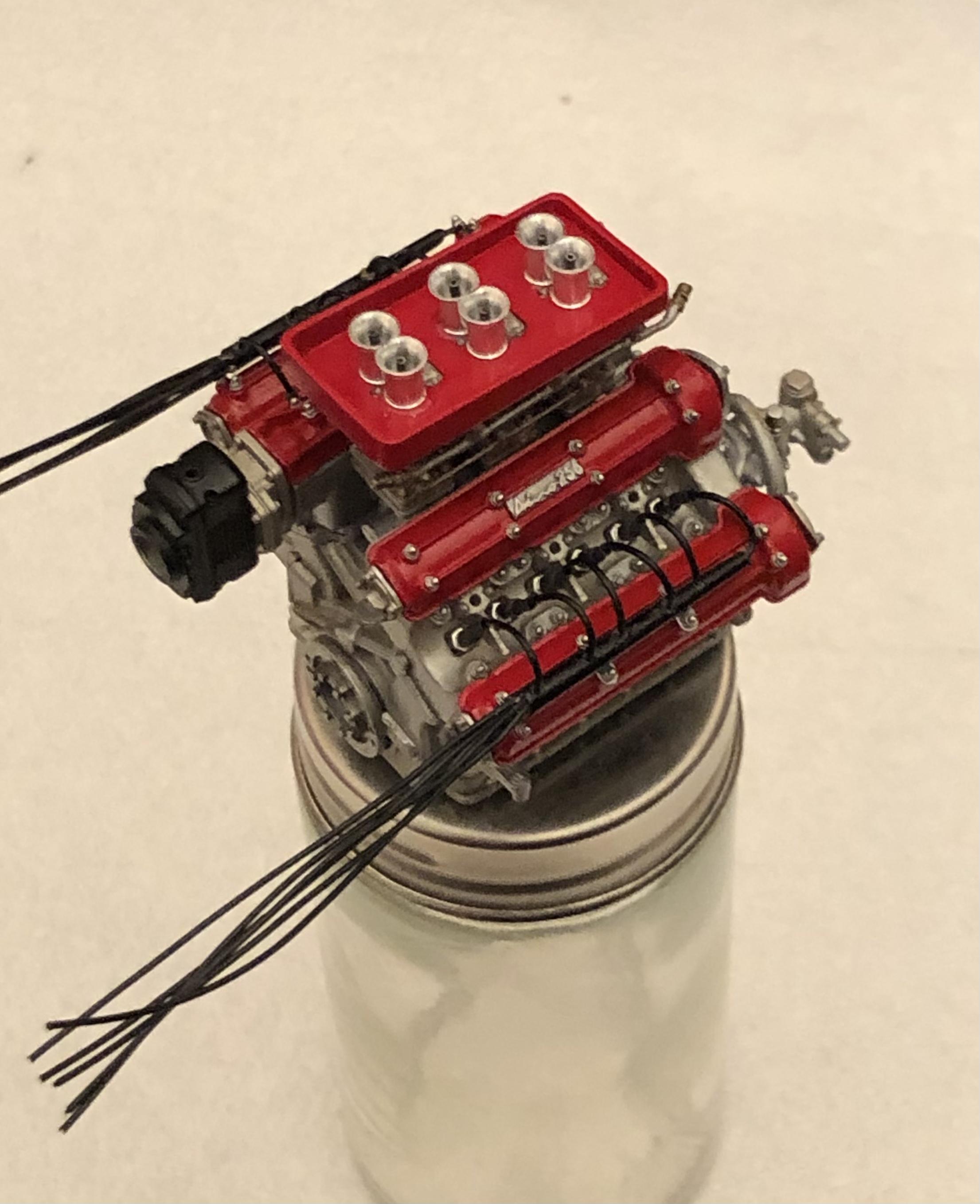

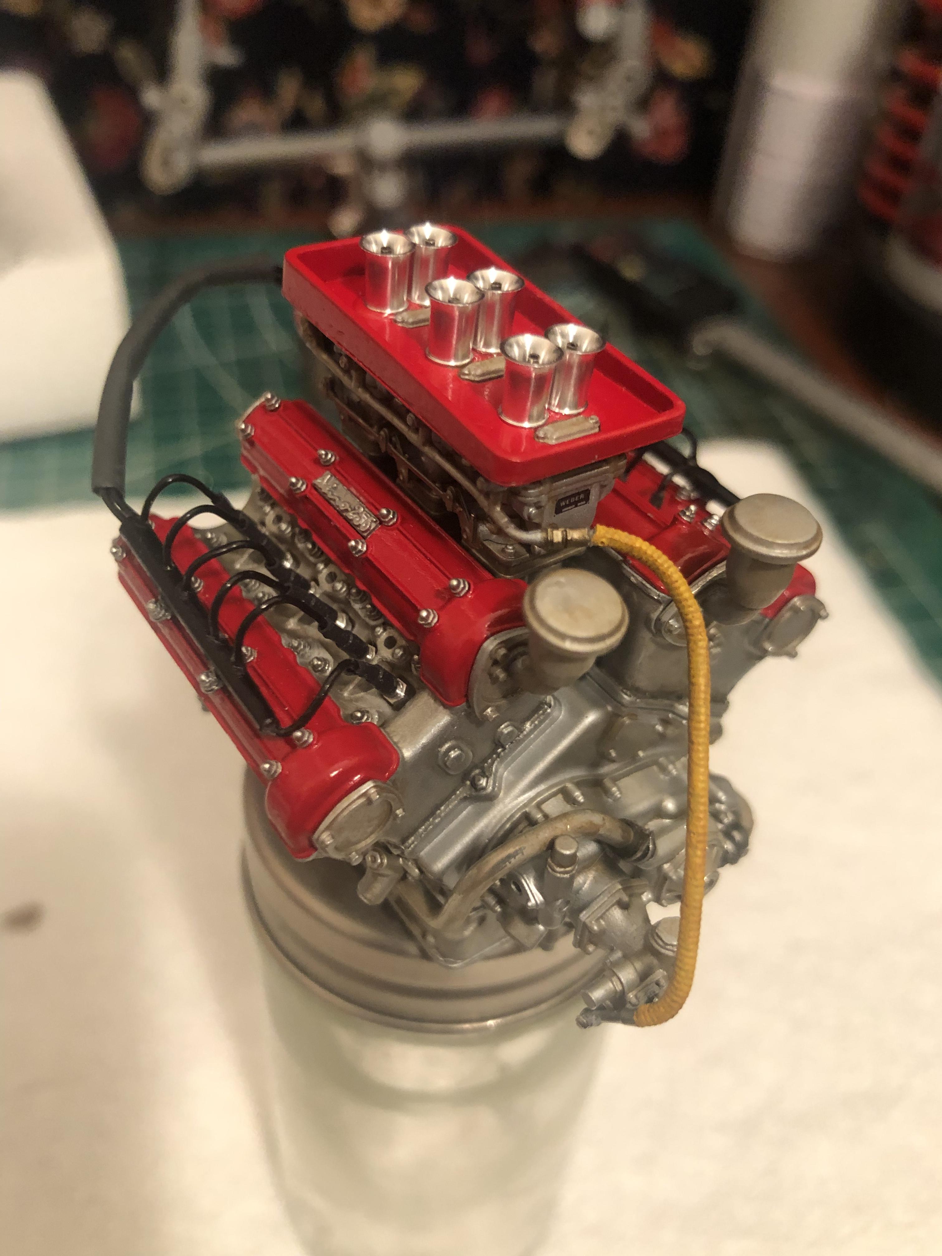

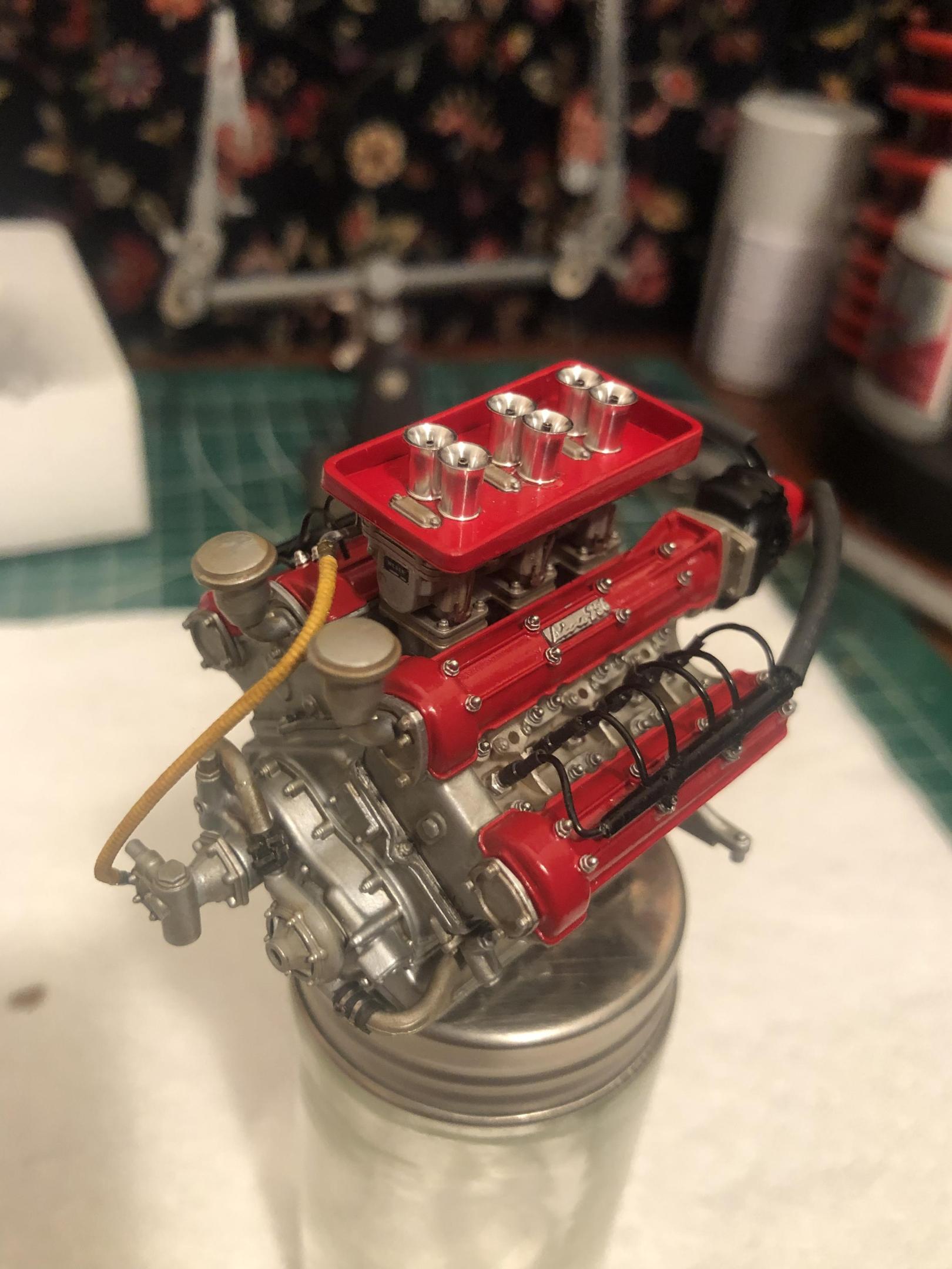

Chris Smith Posted January 14, 2022 Author Posted January 14, 2022 I’m on a roll? I did paint the fuel line with a Tamiya flat yellow and a few small drops of hull red, then a light wash of brown panel liner
