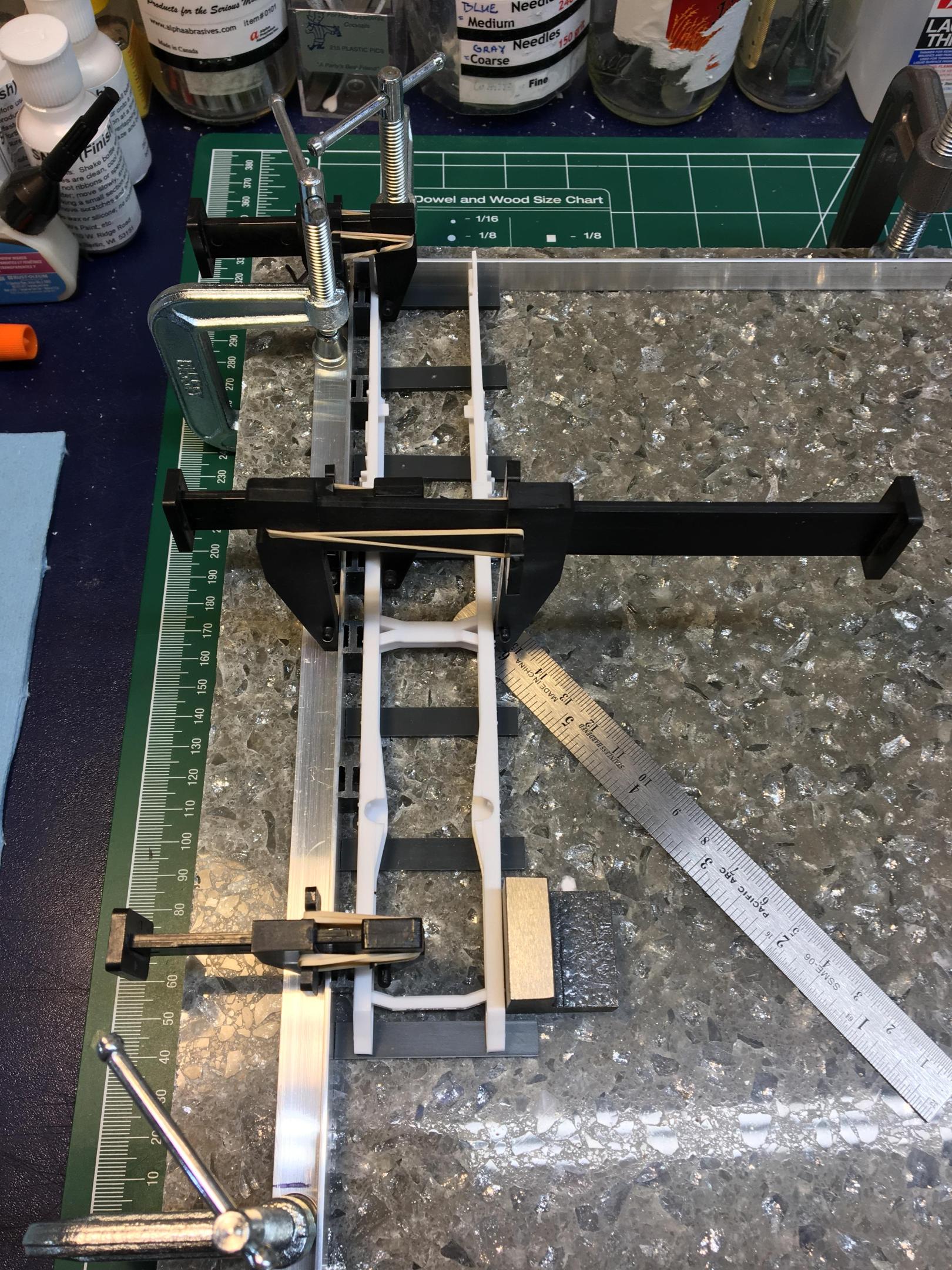

Finally working on getting the frame glued.   Made a "frame jig" to make sure I get it square, flat, and true.  The frame always makes me nervous because I've had some where one rail "leads" the other and then I ended up with rear axles that "dog tracked" or the cab tilting and not landing square on the rear supports, etc.    I needed something to help me get 'em square and true.
23 hours ago, Mopar - D said:
That’s a nice frame jig. I sure could use one like that.
Thanks.   I got tired of ending up with hoods that didn't close "square" and axles that "dogtrack".  I had to do something!

That frame jig ist really nice. I just use rubber bands, clothes pins and weights to be sure the frame turns out straight.
