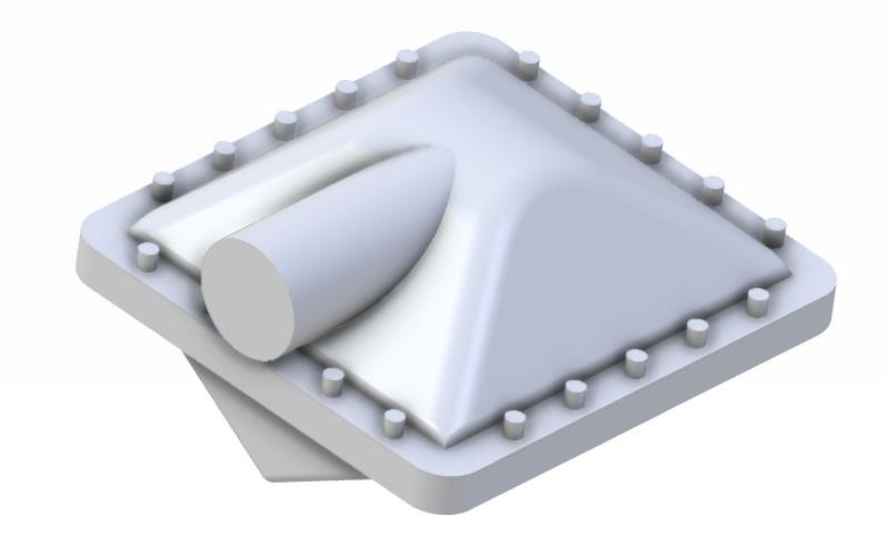

Switching to CAD design has allowed me to indulge my love of automobiles during times when I'm having trouble with a build like I am now with my Club DeMer.
Here is a prototype of a Y-block engine I'm working on. I like to use my FDM printer to print parts until I get them finalized, as its cheaper and cleaner than resin. My wife bought me the FDM when I first started talking about getting one and I still use it even though I have a small resin printer.
You can see that the oil pan is just a tad too long, so I'll tweak the design and shorten it up.
The supercharger is just glued there for effect, but it was tough to draw, and while it doesn't exactly match a 1:1, I'm happy with it. Thanks Sledsel for the link of the design for the intake hat. I changed it to front intake to work with the Paxton.
The front cover was no picnic either, and I really modeled it to be closer to an AMT kit front cover than the complex 1:1 cover.
Since these aren't primo designs, I may make the files available no cost.

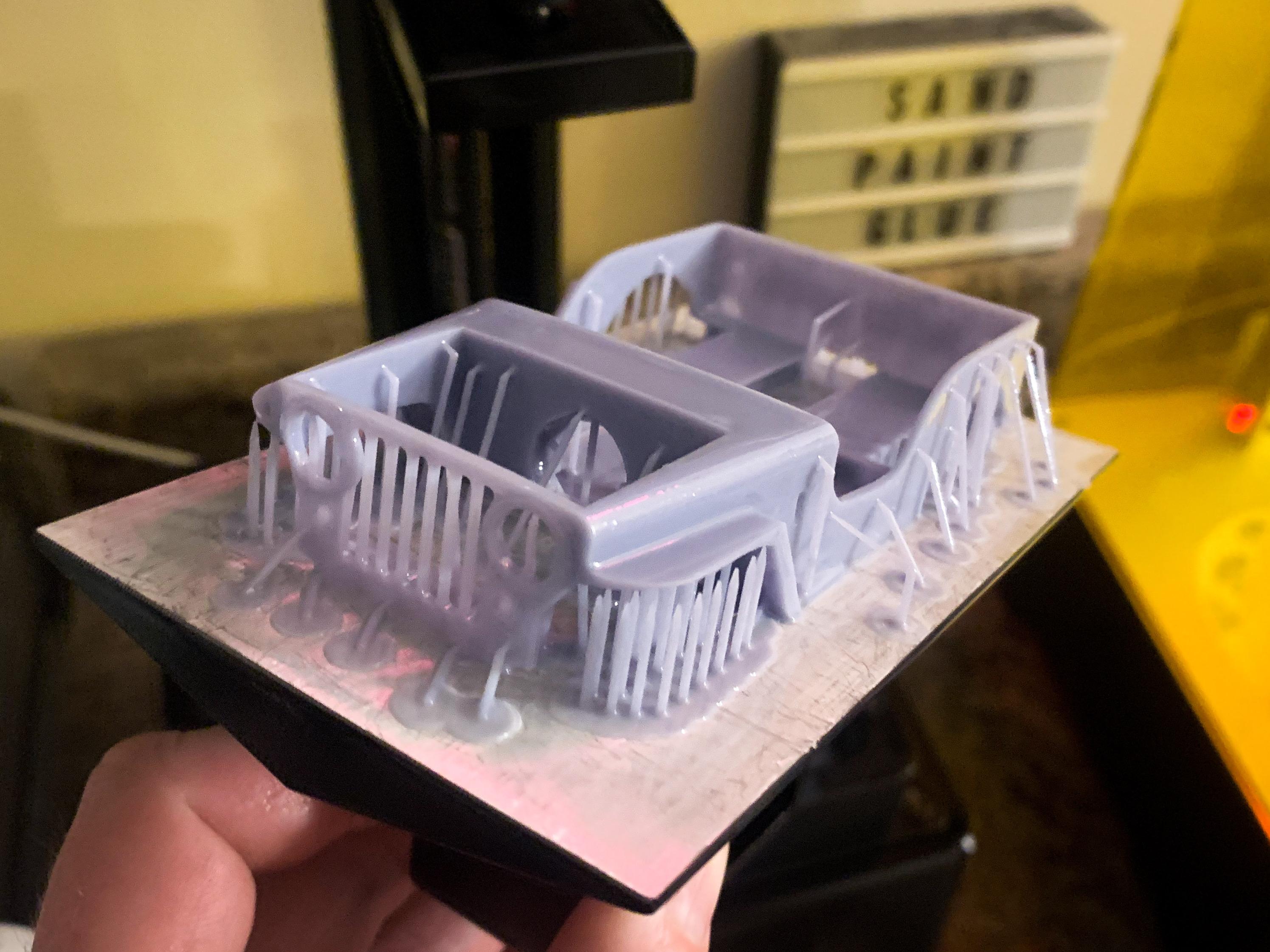

On 3/12/2022 at 12:38 AM, CabDriver said:
I’ve been playing with Adobe Dimension lately for 3D design - I have it as part the suite of software I (have to) subscribe to and it does a nice job of doing some simple 3D modelling and modifying of existing parts.  Messed with this Jeep design on my lunch break yesterday…
…and then printed one this evening:
Need to tweak the some of the supports under the front fenders there to stop them disconnecting, but it’s definitely a usable first attempt.
I added a few thin sacrificial planes under the back of the body to help support it when printing - just some little 0.5mm thick strips to stop the back sagging that can be easily removed when I take it off the bed…worked out great!  You can see a little of what I’m talking about under the rear of the body here:
I don't have a printer but I'm still trying to learn things.
I'm curious why you need so many supports on the outside of the rear part of the body? If those are really needed, couldn't they be placed on the inside?
Also, like you mentioned, the support under the front fender did not do their job, but the horizontal part of the fender still partially printed.  Are *ALL* those supports really needed?
Good questions dude!  Honestly? I’m kinda feeling my way through this stuff myself…
So, the upper side of the front fenders printed just great, but there was some waviness on the undersides where the material was sagging under it’s own weight.  That’s what I was hoping to avoid with those supports under there, and the tips where they connect to the body are so tiny that cleaning them up is really quick and easy so I added plenty.
On the rear of the body. I was concerned about the same thing happening, or the thing getting wobbly or wavy not printing right…but there’s only so much space INSIDE the body because there’s a floor there.  I COULD have connected some braces to the floor and to the inside of the body, but I figured I’d rather just level out the outside in this case because it’ll be easier to get to.  Those little nubs where the braces attach are REALLY small, and a shape X-acto blade removes them really quickly.
All that said, yeah, it might not need that many, but I’d rather do a minute of clean-up on an extra brace than spend three hours waiting for the thing to print and it’s not usable.  Was just trying to give the machine the best shot at getting it right first time!

Thanks for the explanation Jim.  I know that some 3D printing setups come with software that automatically generates supports for the 3D object being printed. Have you ever tried that feature?  I also realize that there is a lot of experimentation required.  It is not exact science.  BTW, did you check that "Why 3D prints fail" video I posted while ago? I thought it was very informative (even for an armchair 3D guy like me)..

I did watch that vid, yeah!  It was really helpful, thanks buddy!
The automatic supports feature is great in a LOT of cases, but not always.  For example, if you’re printing a tire, the software doesn’t know that it’d be easier to clear up a support nub from the sidewall or the middle, compared to putting them on the tread or right on the “FIRESTONE” lettering on the side or whatever.  It’s not smart enough to know which detail is really important and which part is going to be hidden, or easier to clean up.  So, sometimes you’ve got to outsmart the software and just line them up yourself
That said, I thought of you this evening when I was playing with the files for a Kei truck print I’m going to be working on.  I let the software figure out the best spots for the supports and this is what it came up with:
In this case, it worked pretty well!  Didn’t put any of them anywhere TOO awful, supported that front end (which would likely sag during printing) and a bunch of interconnected ones running up the A-pillars and to the roof.
It actually put a BUNCH more in there than I did for my Jeep (although this has a roof, obviously) so it spotted the fact that this roof is relatively high with not enough ‘meat’ in the roof pillars to let it print perfectly on it’s own.  It’s clever stuff, even if it does need some human brainpower to produce actual useful parts sometimes

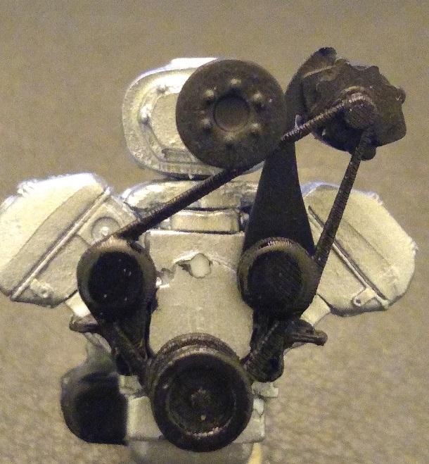

Info for those using water washable resin. I had been using what was locally available from Microcenter which is eSun and Inland. The results were brittle parts that limited me to what I could print, so I decided to try something else, and while searching I came across a result for Phrozen water washable model gray resin. It was touted as non-brittle so I bought a bottle.
The result was great. I was finally able to print a pulley and belt setup that I designed for my Ardun head flathead engine and finally had success. the thin belt section was pliable enough that I was able to cut the support from it and not break the belt. I could see the flex in the part, but it didn't break as it had before. The pic below shows the Sun and Inland resin usually resulted. The pic is in white resin but I also tried grey but I didn't save any for pics. The second pic shows the assembly on the engine.
So although water washable resin is overall more brittle than alcohol washable resin, there are differences between water washable products.

I've been using the Elegoo Water Washable resin. I've found the ceramic grey to be my preference. I tried the semi-transparent green, and that worked well, but was much more brittle. Had to do a few reprints with that. I think it's good for larger pieces, but if you have fine detail or thin parts, go with the non-transparent.

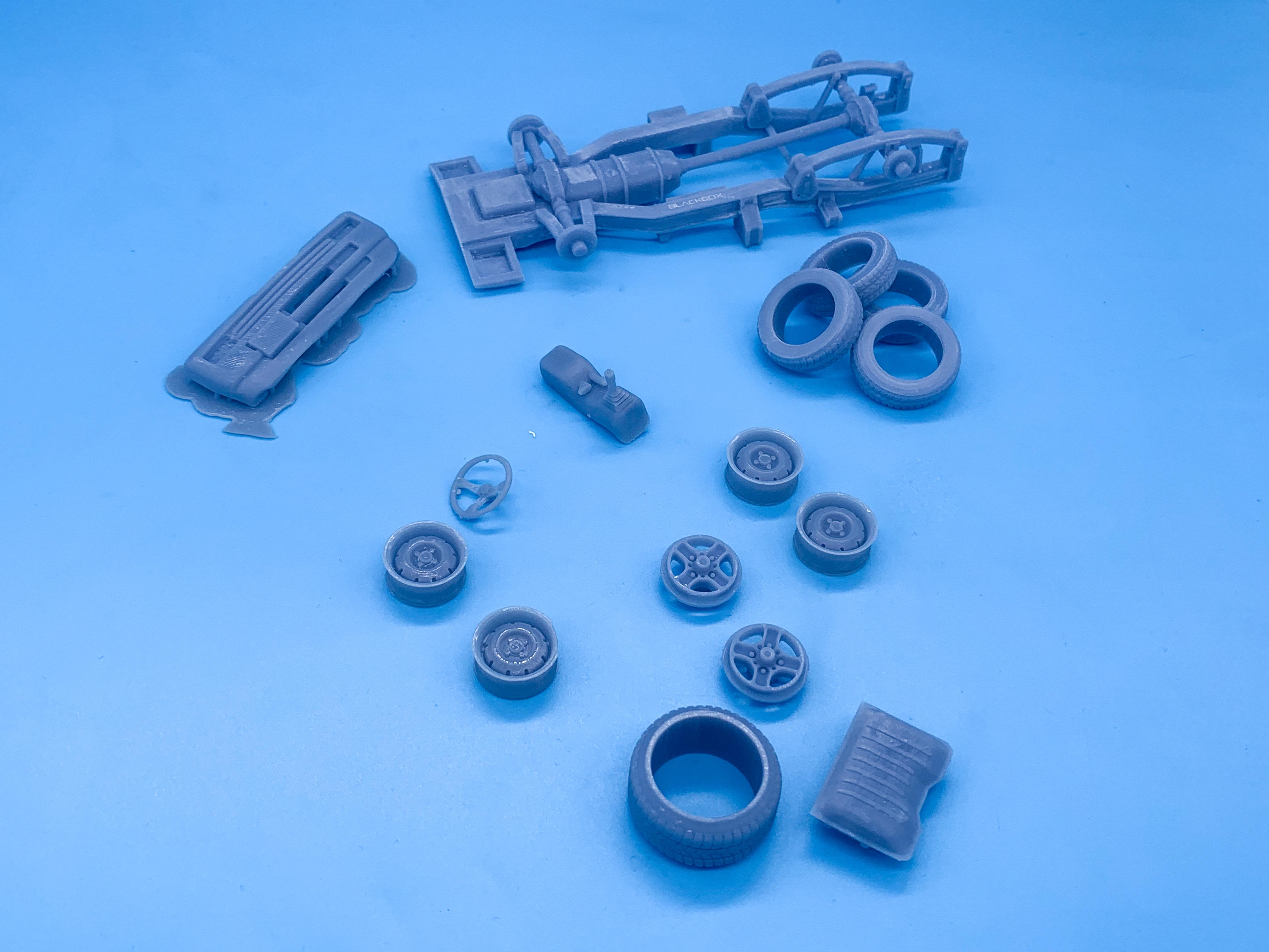

I downloaded my first entire 3D-printable kit this week - there’s a bunch of them out there, but one of these kept catching my eye:
Not in my usual wheelhouse - I just think it’s cute!  Started working through printing the files…body is the biggest part so I’ll do that this weekend, but been plugging away when I’ve had a spare couple of hours at getting the whole kit printed:
