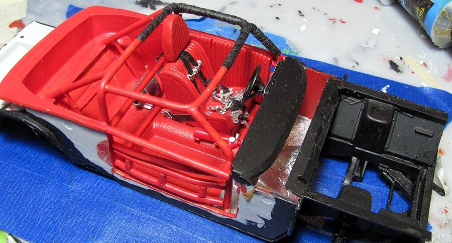

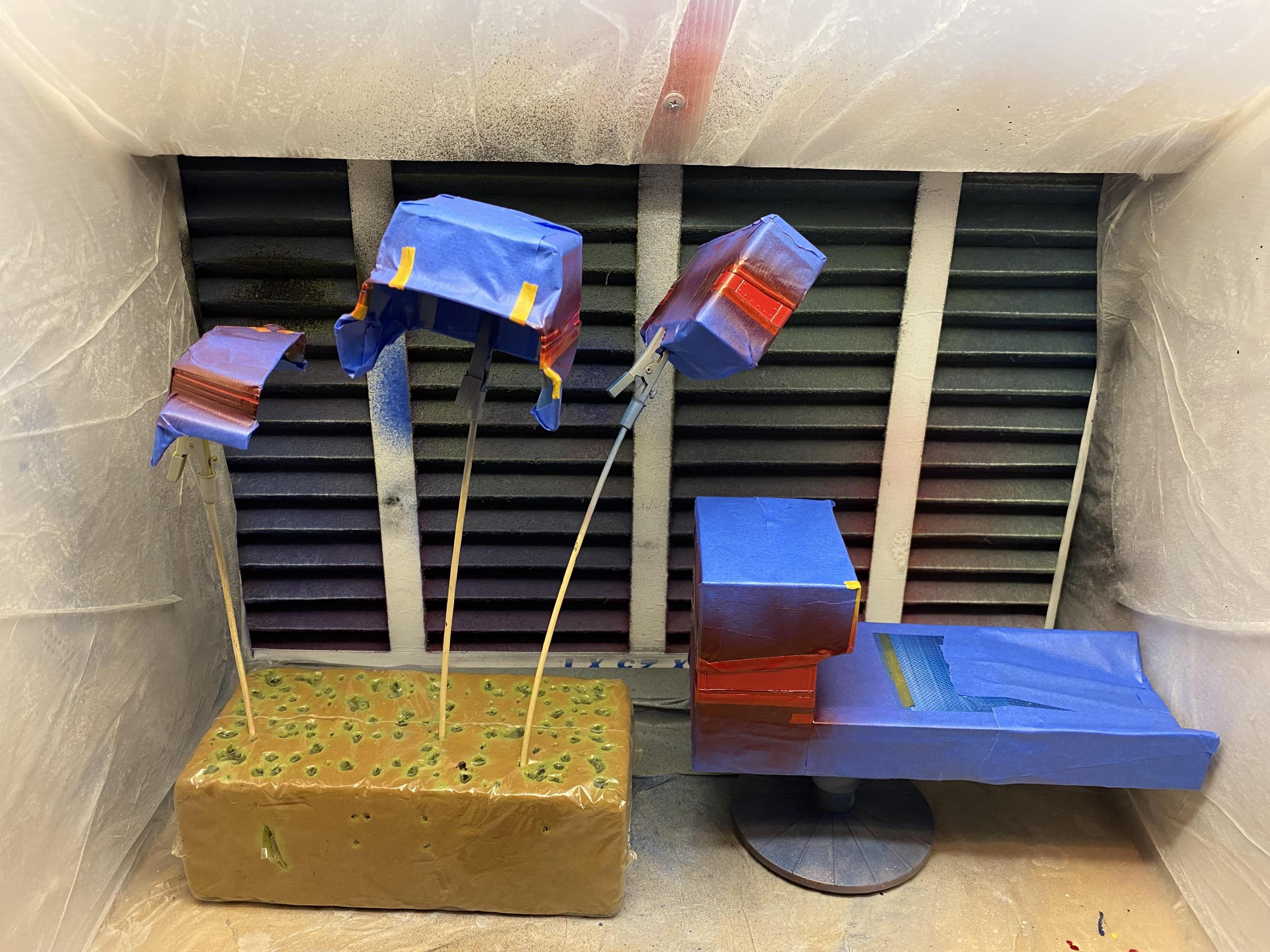

MarkJ Posted June 1, 2022 Author Posted June 1, 2022 Got the base interior painted. Working on the stuff that goes in it.
Pierre Rivard Posted June 2, 2022 Posted June 2, 2022 Looking good. This red matches well the real car's interior.

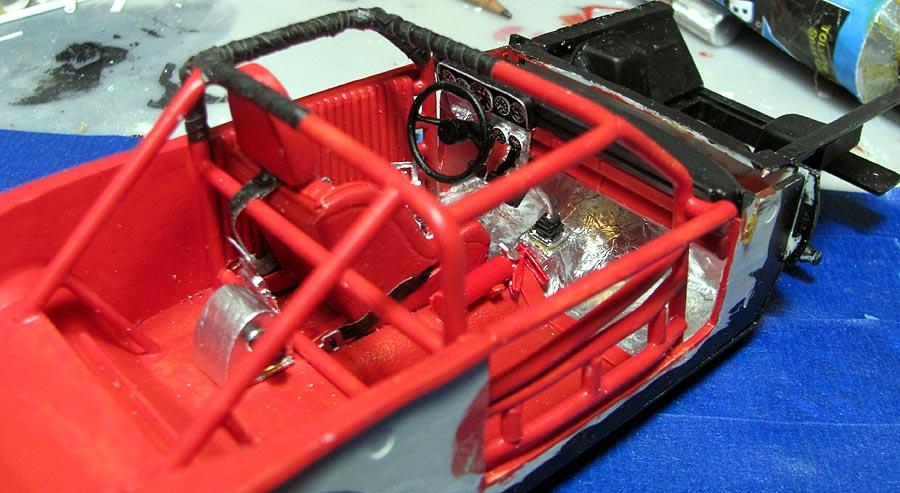

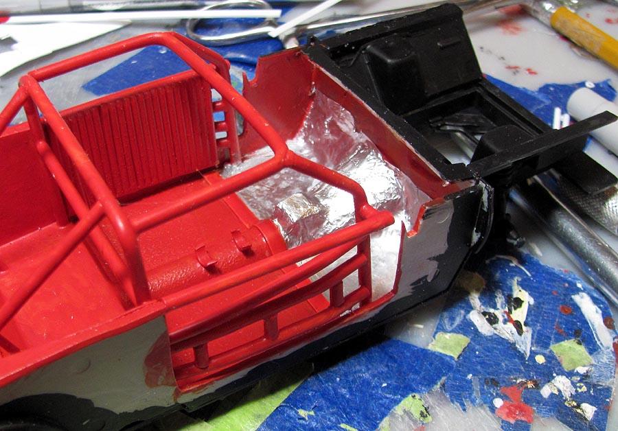

MarkJ Posted June 2, 2022 Author Posted June 2, 2022 Pierre, that's the thing. I'm using the photos of a car that is presented as being the real car in a Hot Rod magazine article. So it is a close match to that car, but if its like the real car from 1966 that won the Southern 500, I don't really know. I'm hoping its close. I finished the seat and almost through with the axle cooler. still need to paint the motor that sticks out the side of the cooler. Also got the dash mostly done. I just need to add the guages before I reveal it. It turned out pretty rough. Thats what's good about dashes. when they're installed in the model, its really hard to see them.
MarkJ Posted June 3, 2022 Author Posted June 3, 2022 Finished the dash, steering wheel and rear axle cooler. 1

Bills72sj Posted June 30, 2022 Posted June 30, 2022 (edited) I have enjoyed watching all the fabrication you have made on this model. The seat turned out AMAZING. If I had been paying attention when you were struggling to mask your multi colored paint job, I would have strongly suggested Parafilm. It is made to seal medical test tubes. You cut a strip, stretch it to activate it, then lay it along the edge of area to be masked. If you want a clean smooth line you just lay thin 1/8" tape onto the over the top. You then cut your line based on the parting line between colors. The side that is to be painted peels off without leaving any residue. It is also malleable so you can push it around a bit with a toothpick. This is particularly handy to prevent bleed under at scribed panel lines. It never hardens or gets gooey. It is kind of like the adhesive on Post-it notes but without the paper. You can leave it on for YEARS with no ill effects. To cover the masked areas inside panels you can simply lay regular blue masking tape. Removal after painting takes no special solvents, water or technique. Simple peel or rub it off in little balls as it loves to stick to itself. Parafilm is not transparent but not opaque either. Below is a recent project. You can see the thin white line tape by itself would fail miserably over all the ridges and grooves I ran over. It has no issue with overlapping itself either. It just sticks and seals. Edited June 30, 2022 by Bills72sj
MarkJ Posted June 30, 2022 Author Posted June 30, 2022 Wow, Bill. Thanks for the info on parafilm. It did a fine job on your excellent hauler build. Do you have a link or can you tell me where you purchased it. As you can tell I'm yet to find a good masking system.

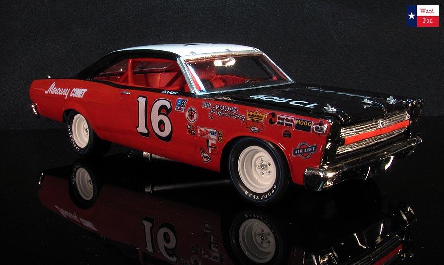

MarkJ Posted July 7, 2022 Author Posted July 7, 2022 Finished and final pictures posted in Nascar under glass forum in this web site.
