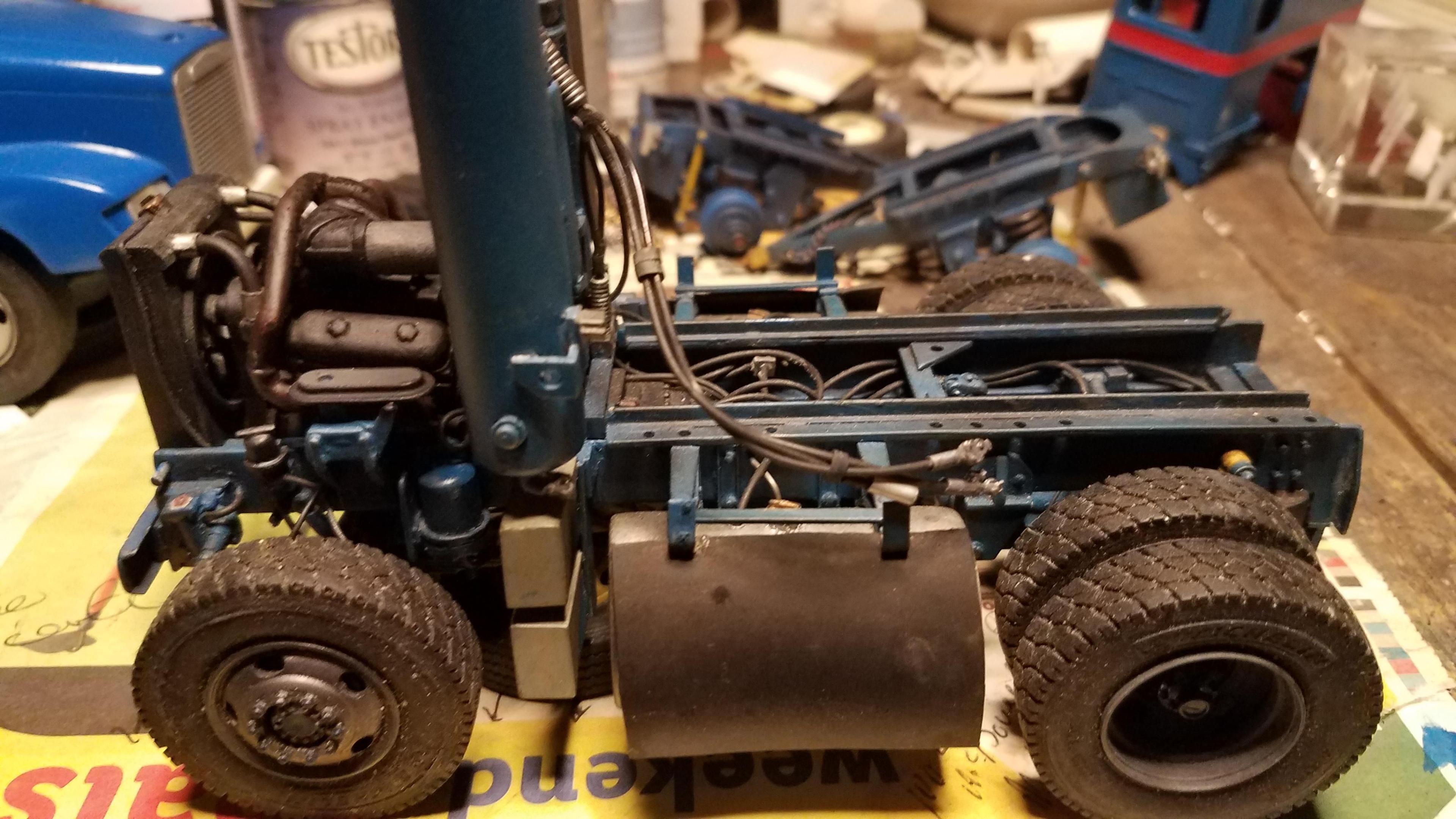

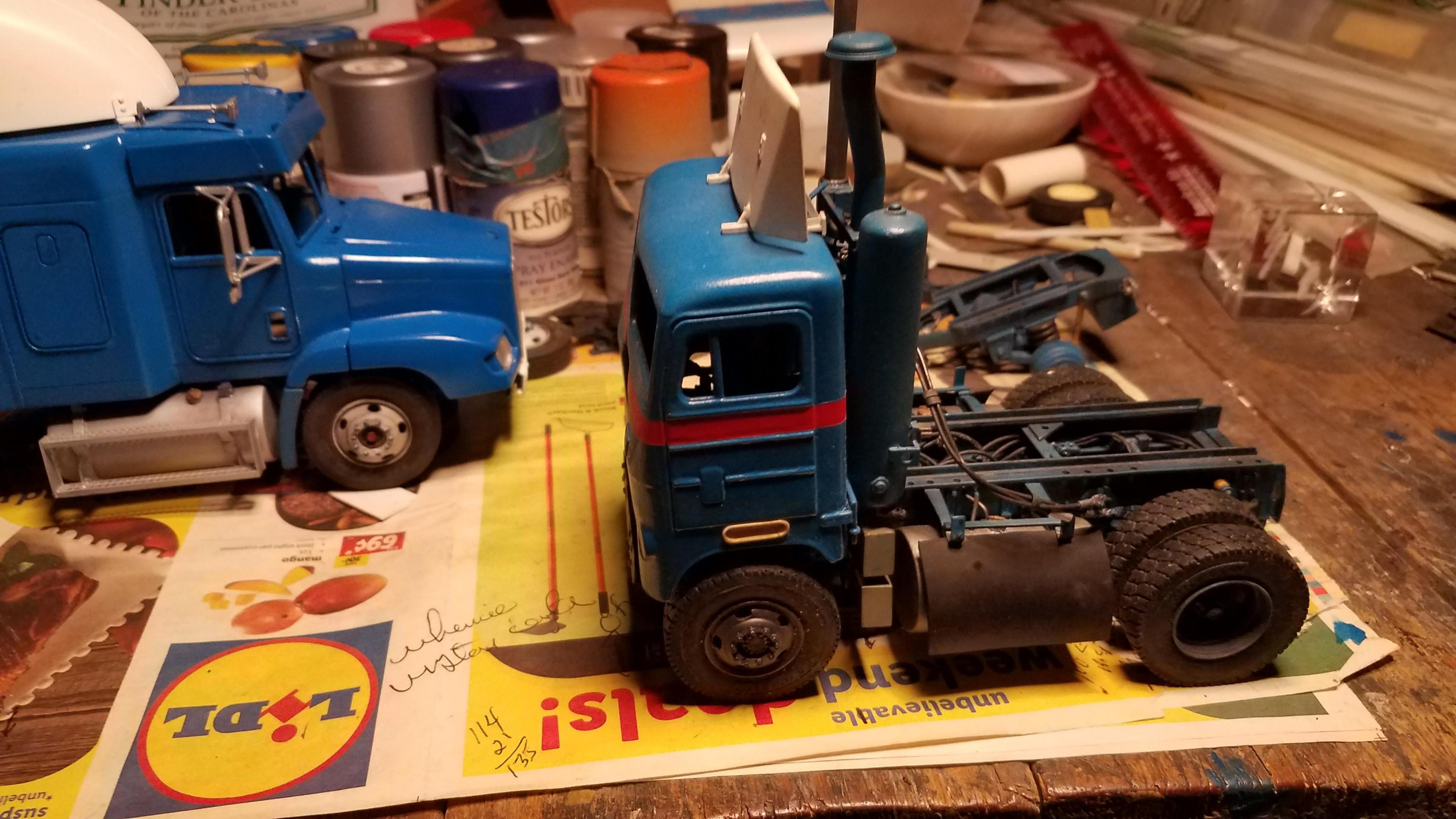

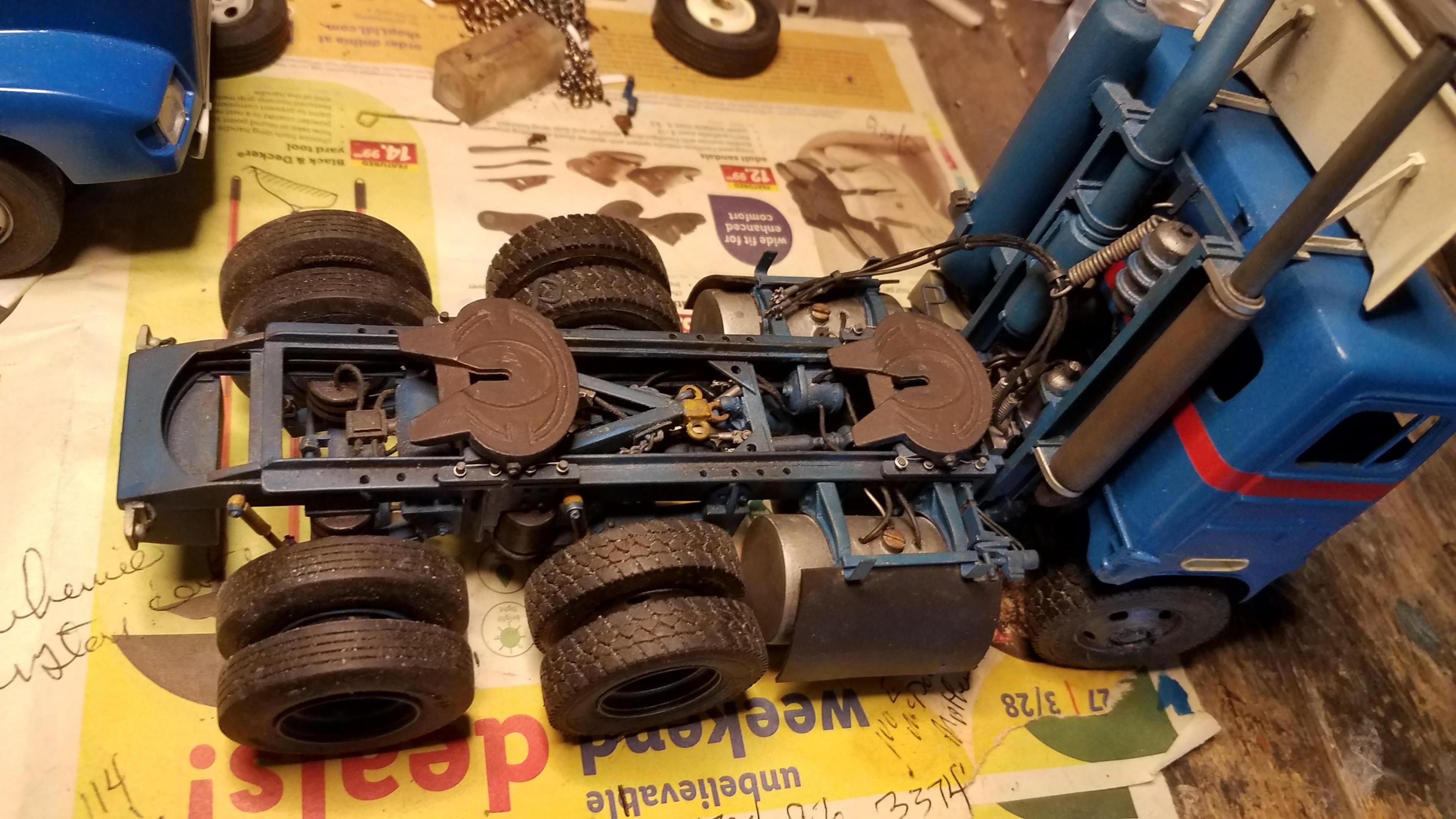

lwwoodss Posted February 25, 2022 Posted February 25, 2022 Late 70's Freightliner cabover. 4x4 mountain pass tractor. 51 inch cab. DD 6V 92T. Jifflox equiped. Build as a companion truck to the FLD 112. Same fleet different time periods. 4

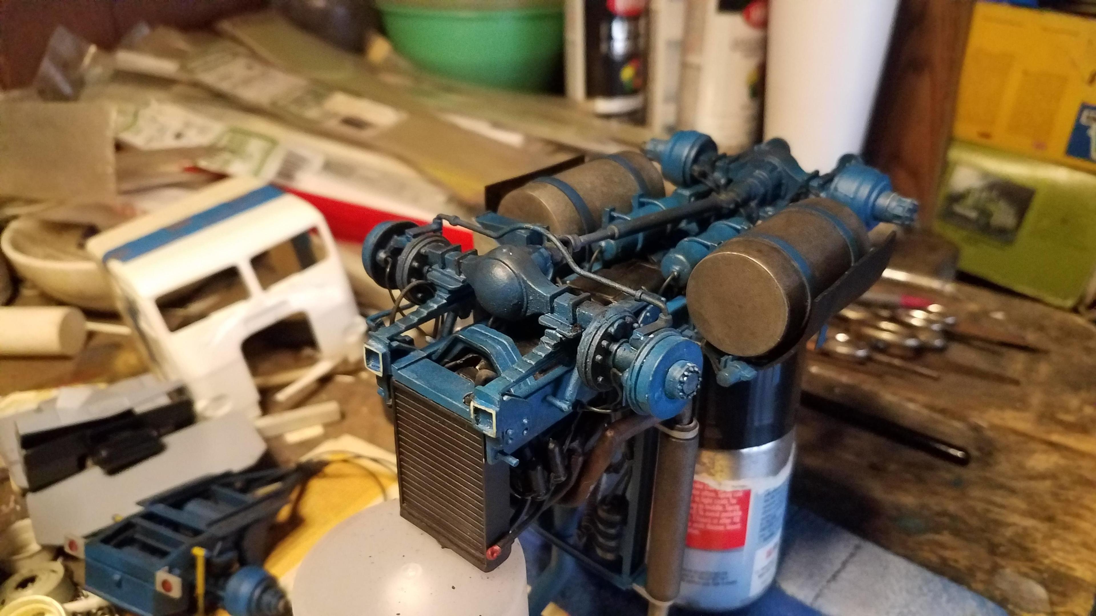

chuckyr Posted February 25, 2022 Posted February 25, 2022 How is the front drive connected to the transmission?

lwwoodss Posted February 25, 2022 Author Posted February 25, 2022 Both shafts from transmission and axle go directly to the rear diff which has a modified front gearcase.

Rockford Posted March 3, 2022 Posted March 3, 2022 That looks really life-like! I've never seen that AWD system before. Does the rear axle act as a transfer box? I'm assuming that the drive goes from the transmission to the rear diff then back out of the front of the diff into the front axle, the two driveshafts running alongside each other?
lwwoodss Posted March 4, 2022 Author Posted March 4, 2022 Both shafts go to the front of the rear diff.

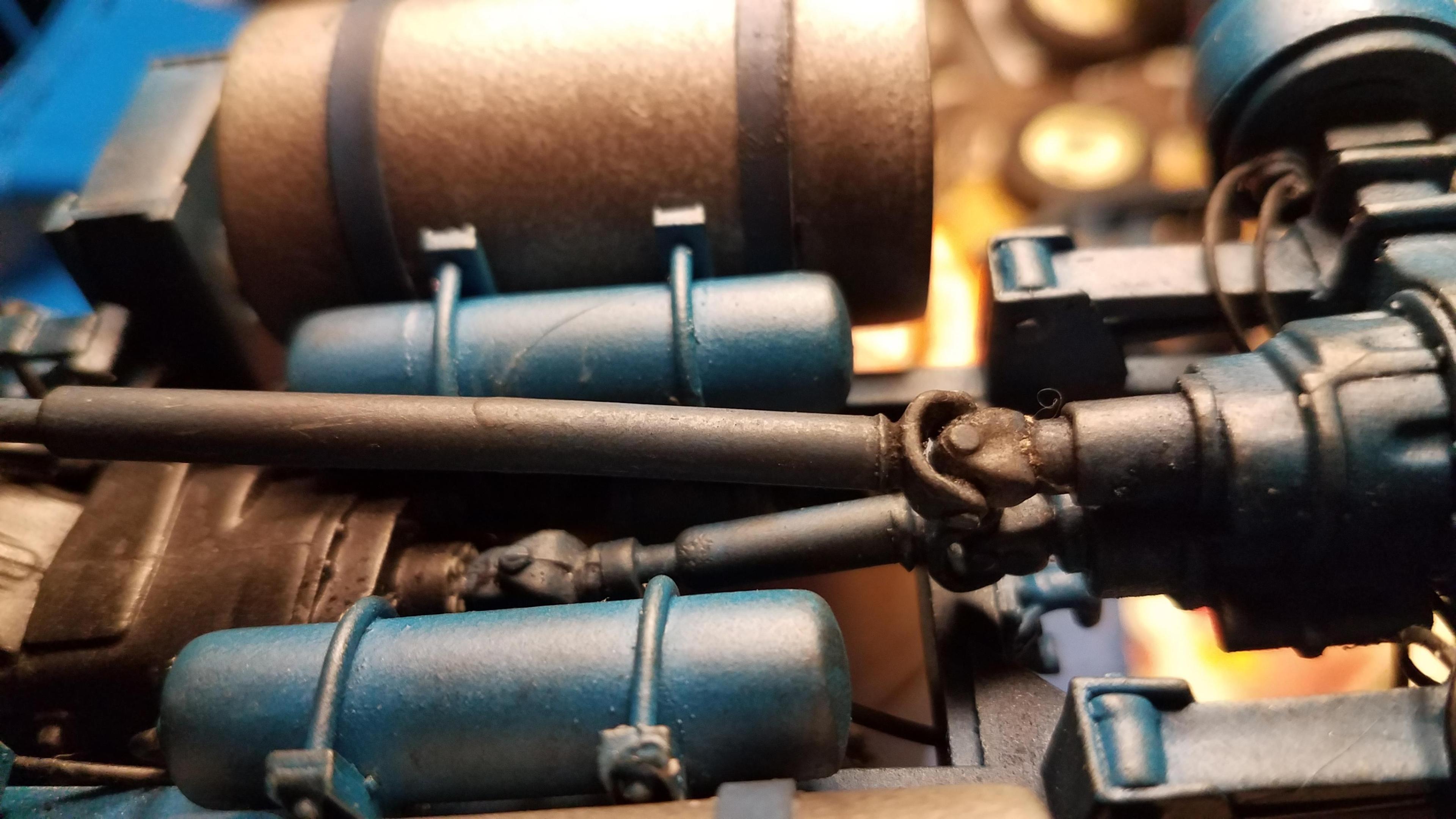

clayton Posted March 10, 2022 Posted March 10, 2022 A close up photo of the drive line would help a lot.
lwwoodss Posted March 12, 2022 Author Posted March 12, 2022 Photo of rear drive shafts. Jifflox connected to tractor
