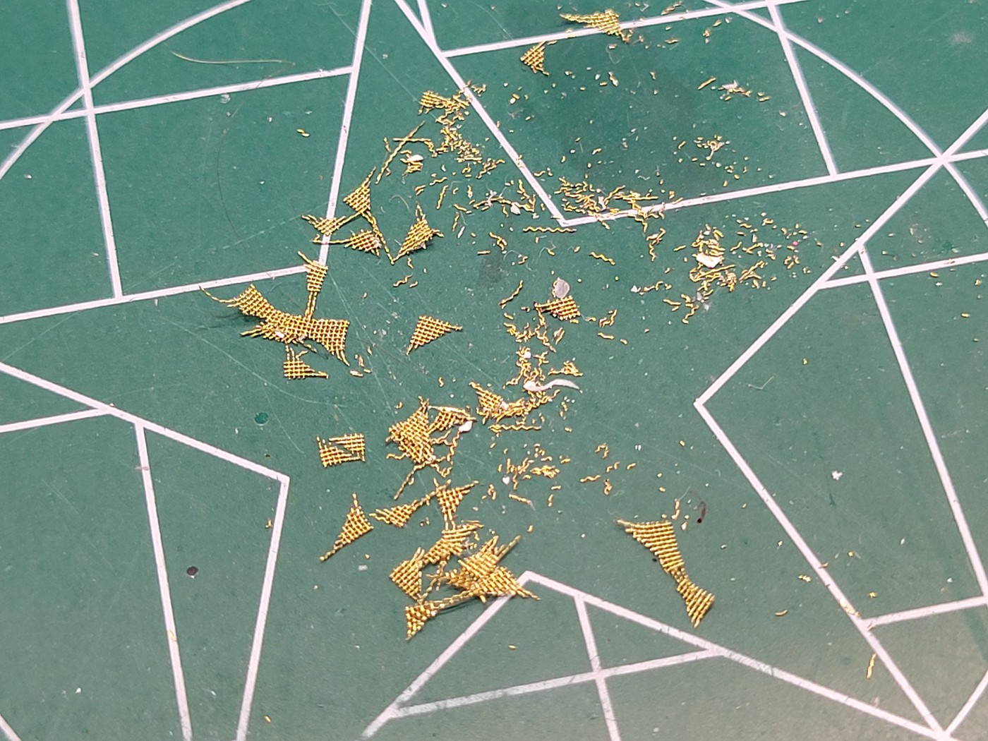

While working on the new injectors I also worked on trying to make a mesh air funnel cap.  I am fairly happy with the results.

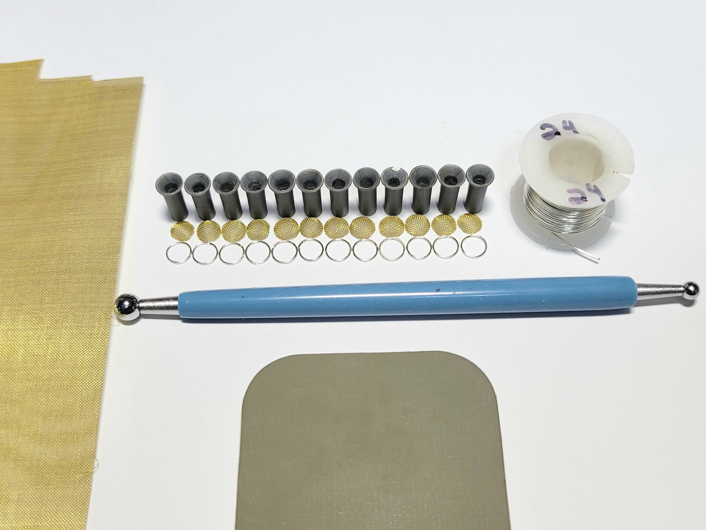

I had some fine mesh that I bought years ago.  I had these tools that I use to form parts when I build metal models.  The mesh pieces are not 100% uniform and I may have to do some tweaking on a few of them.  It is not really noticeable to the naked eye.  I do think they add a nice touch.  I will leave them brass.  I have seen plenty of photos of F1 cars from this era with both silver and brass.  I think the brass will add visual interest.
20220504 220312
I made the rings by wrapping 24 gauge wire around the appropriate sized drill bit.

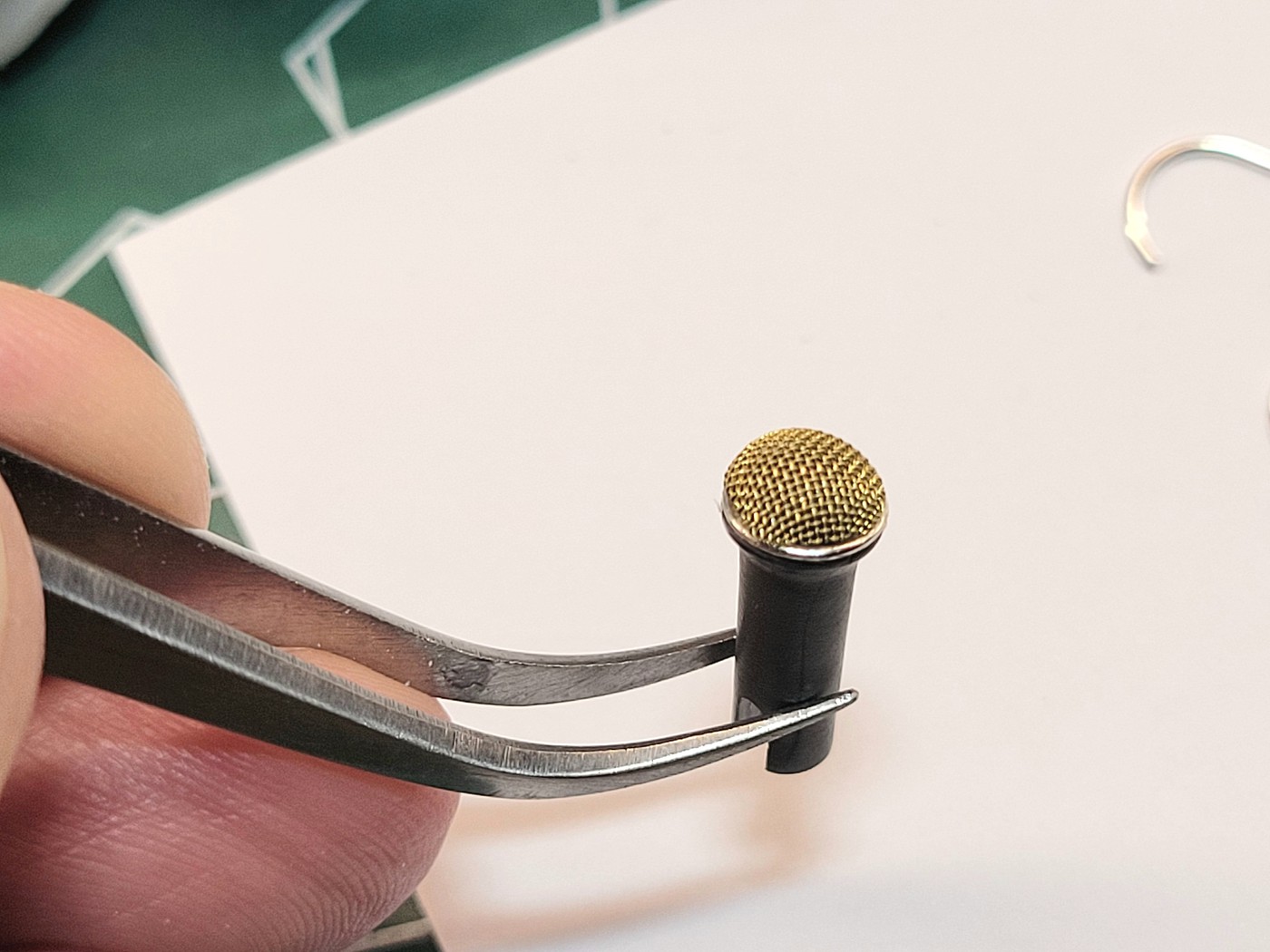

Just a mockup, nothing glued in place yet.  I like it!

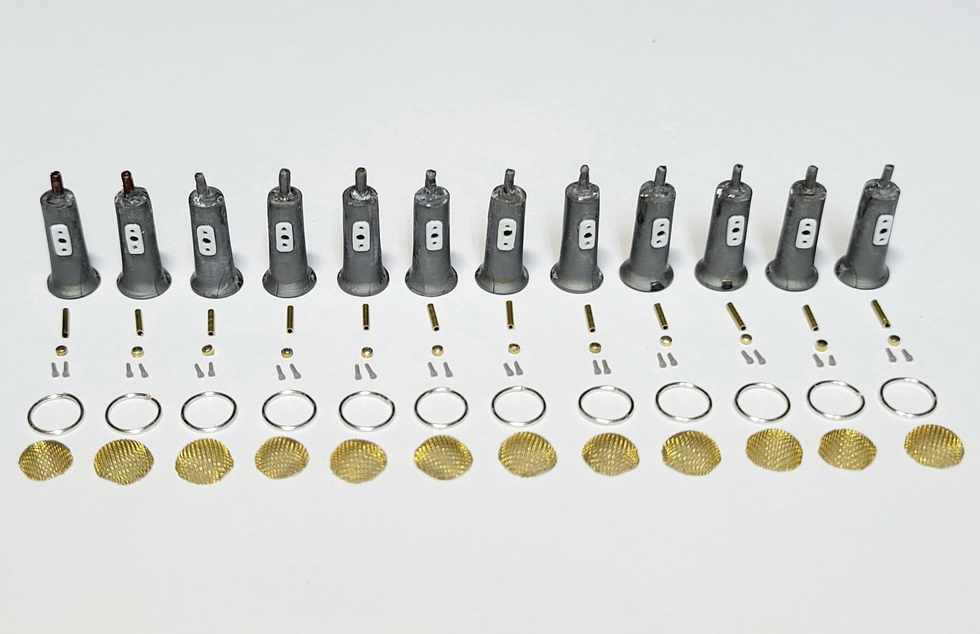

Here is a shot of all the pieces that will go into the air funnels and injectors.

Just a quick update this evening.  After more than a few hours of work the air funnels and injectors, all 12 of them ?, are complete and ready for installation.  Once all the parts were scratched built the air funnels were prepped, (all of this is in previous posts), I primed the air funnels with Gravity Paint Spain dark gray primer.  I fixed major issues and reprimed where necessary.  I then shot Alclad gloss black base and then Alclad Chrome.  I was torn on what type of finish to go for.  I've seen some highly polished funnels and I've seen some pretty dull ones.  In the end I am pleased with what I have.  I left the mesh caps and the injector nozzles brass.  I liked the colors against what will be a mostly aluminum colored engine.  The .7mm bolt heads were hit with a black Sharpie.
They are far from perfect but I have a real sense of accomplishment from making them.

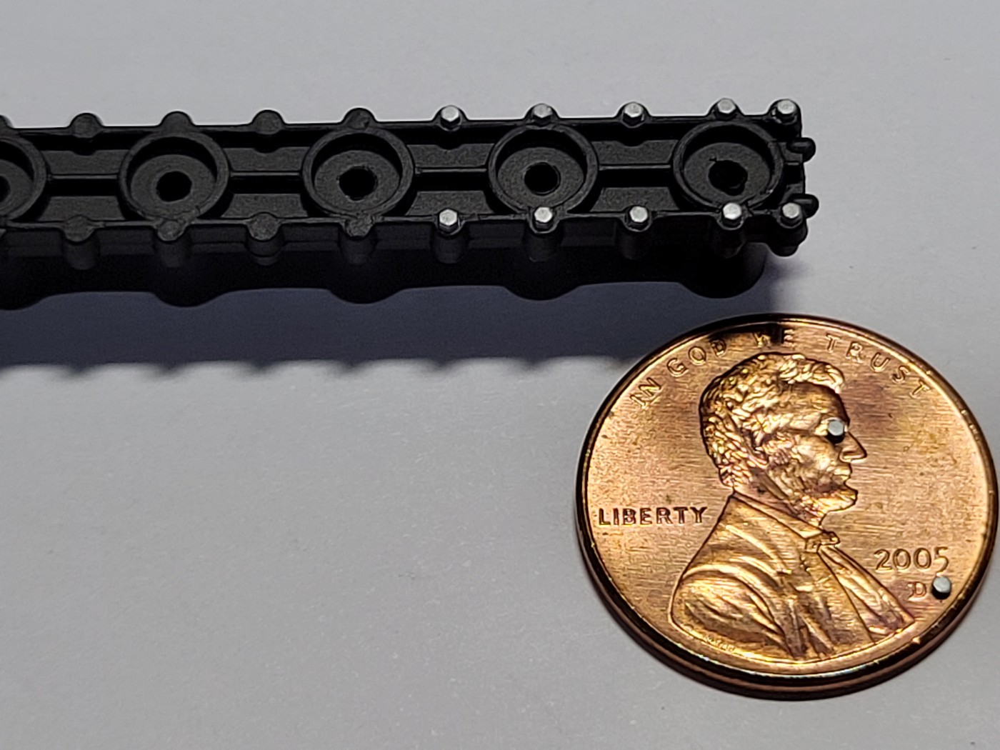

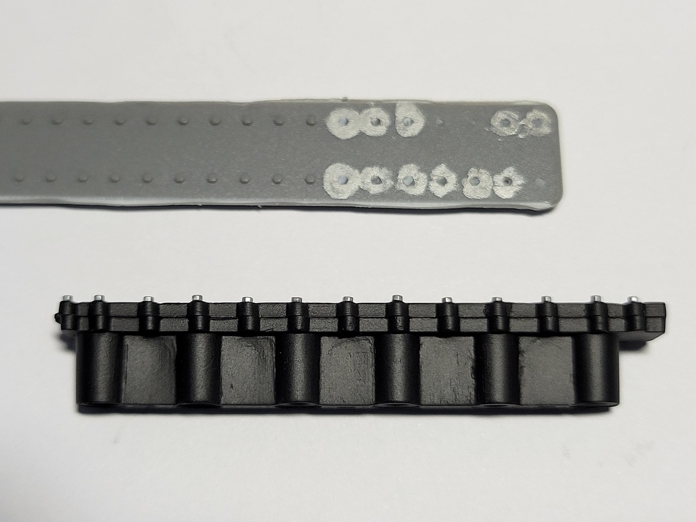

Here is another little update.  Pictured here are the throttle plates that the air funnels fit into.  The molded in bolt heads were really more of a cone.  They were more round than hex shaped.  Because they were easy to get to I decided to remove them and replace them with Meng bolt heads.  I used a Trumpeter 1mm chisel to remove the molded on ones.
Please keep in mind when viewing the photos that most of them are zoomed in views.  Not every bolt head is the exact same thickness.  This has to do with removing them from the plate they are molded to.  Also you may notice a small bit of glue that squished out when applying the bolt heads.  As much as humanly possible this all scraped away after the pictures were taken.
There are 52 individual bolt heads on the two throttle plates.

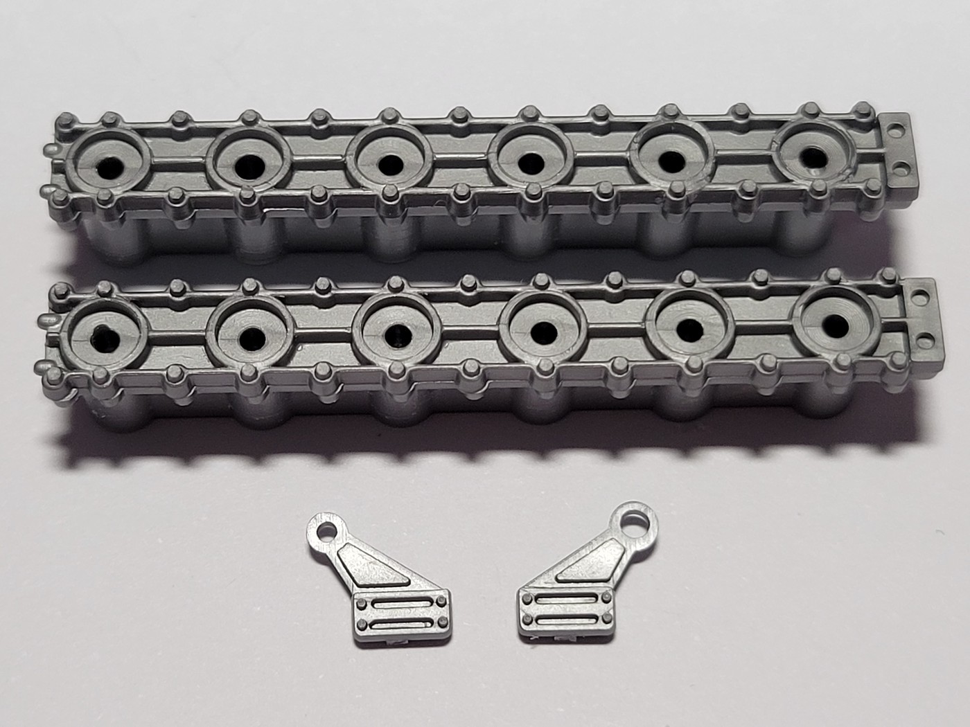

The original kit parts.
20220501 125802
With the molded in bolt heads removed.
20220501 185313
20220613 221716
20220614 220258
20220614 223658
