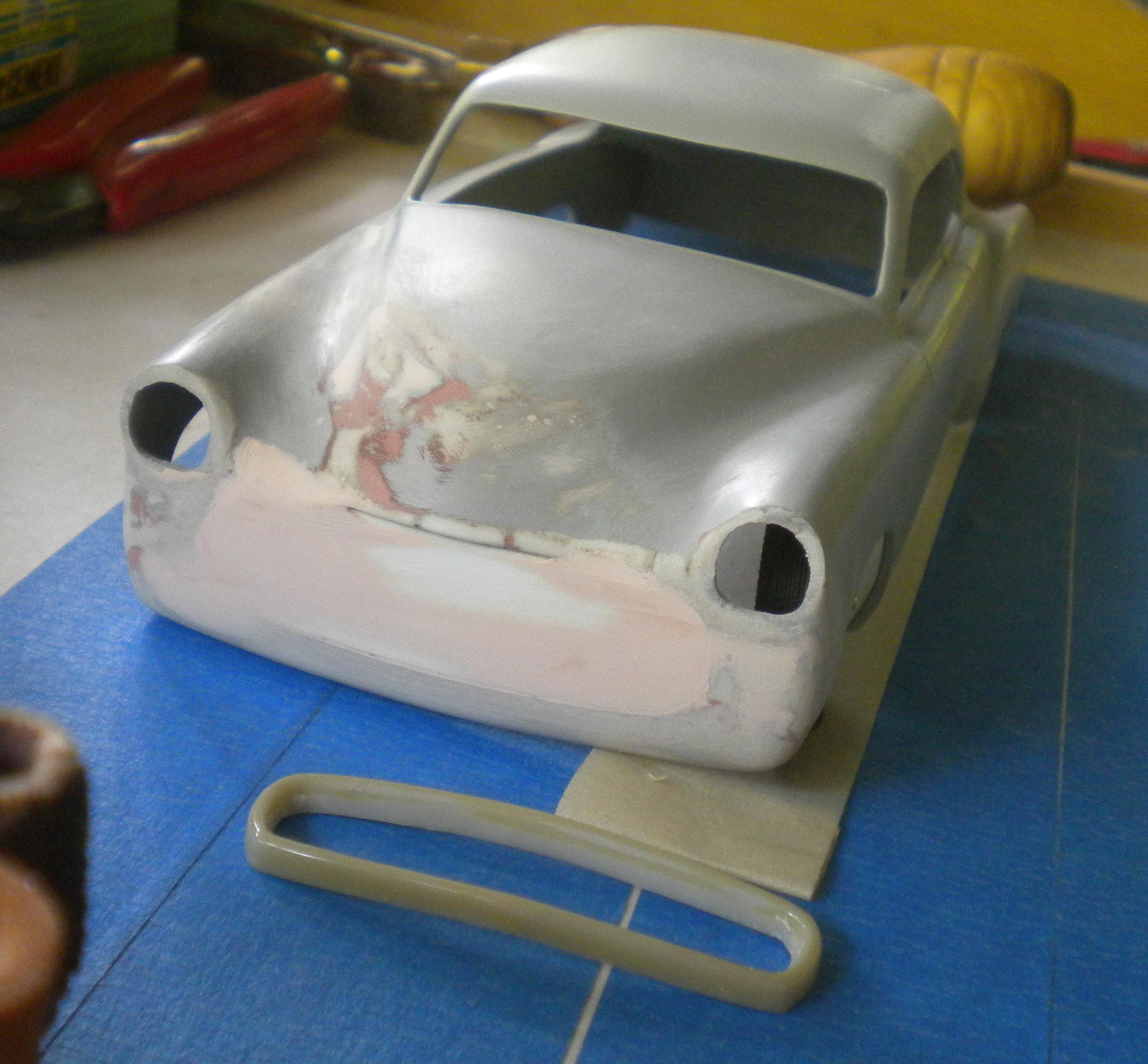

Ace-Garageguy Posted May 1, 2022 Posted May 1, 2022 (edited) 37 minutes ago, jaymcminn said: Interesting. Never heard of this technique, but I'm gonna have to try it. Does the cotton flock allow the epoxy to be sanded like filler? Yes...but it cures much harder than the surrounding material, so something like a Dremel has to be used to rough-shape it. Here's an application similar to what the OP is asking about. The blue hood surround section was bonded in with epoxy/flock, shaped, then the grille section was put in, and more epoxy/flock used to form the fender cheeks below the headlight sugar-scoops. Edited May 1, 2022 by Ace-Garageguy 1
