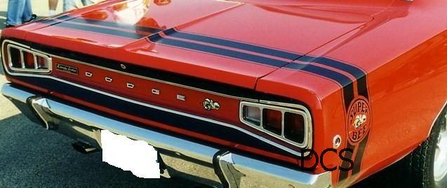

Carmak Posted April 23, 2024 Posted April 23, 2024 On 4/22/2024 at 12:12 PM, Mr mopar said: I only wish Round 2 would have made the Tail light panel separate so you can make a Super Bee . To anyone looking to make a correct 68 Super Bee - All 68 Super Bees were 2dr. post sedans with pop out rear qtr. windows and bench seats. The 2dr hard top and the 2dr post sedan shared the same roof and window opening shape but a post as shown below would need to be added. 1
