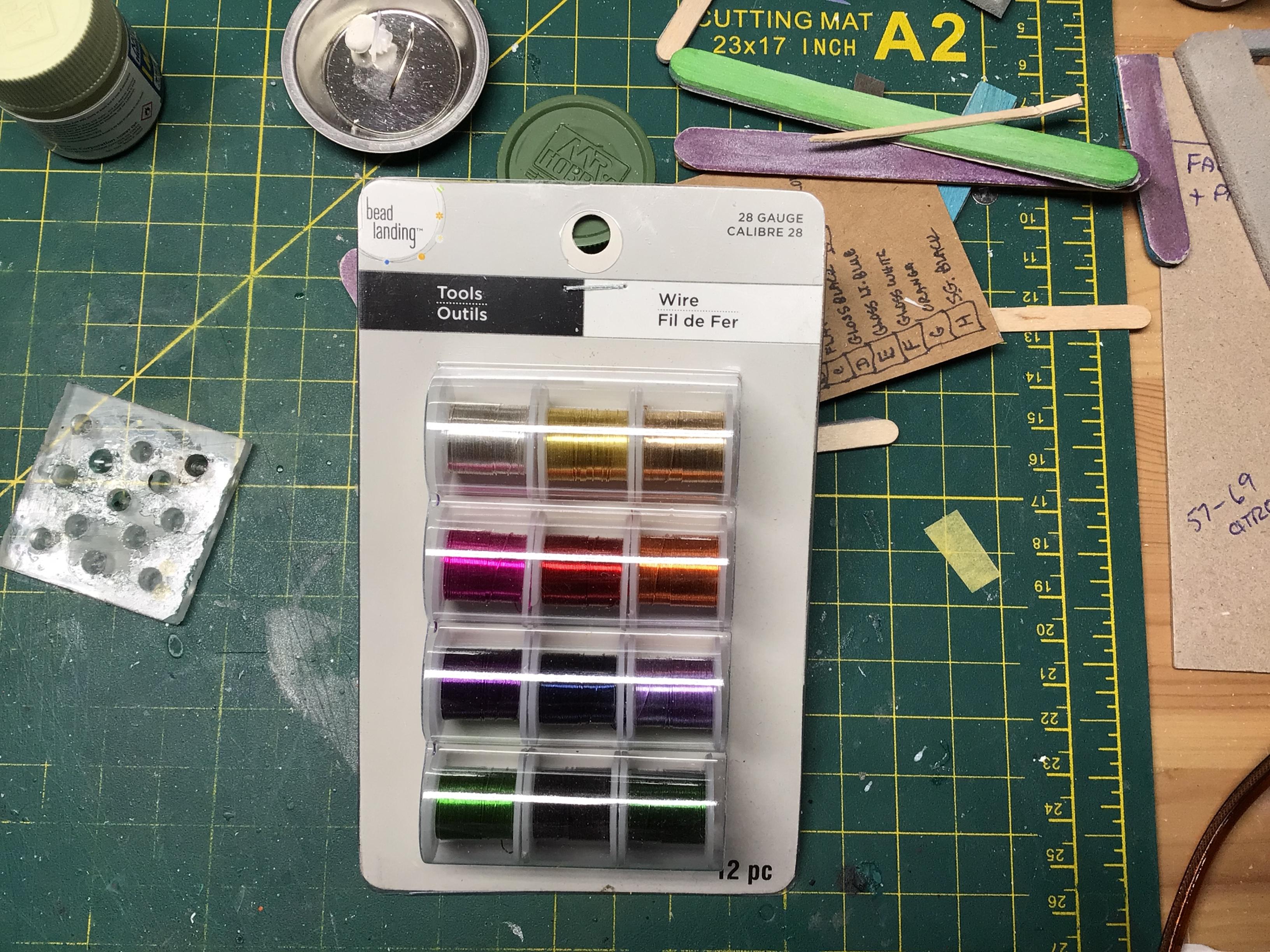

NOBLNG Posted May 26, 2022 Posted May 26, 2022 (edited) I haven’t done any wiring beyond plug wires and a few battery cables, so I’m no expert either. I did buy this 28 guage stuff at Michaels for such things….but haven’t used it yet. Edited May 26, 2022 by NOBLNG
