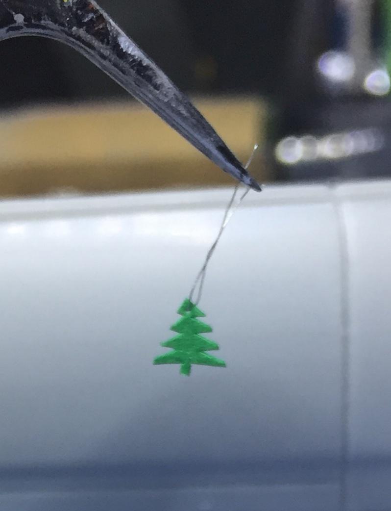

customline Posted July 14, 2023 Posted July 14, 2023 (edited) 33 minutes ago, StevenGuthmiller said: That’s not a bad idea! ? Steve I think my wife has a punch for that but I'm afraid to ask her. More on this later... Nope, all too big but I found some green paper. It's the string where the problem is. A hair perhaps? Edited July 14, 2023 by customline 1

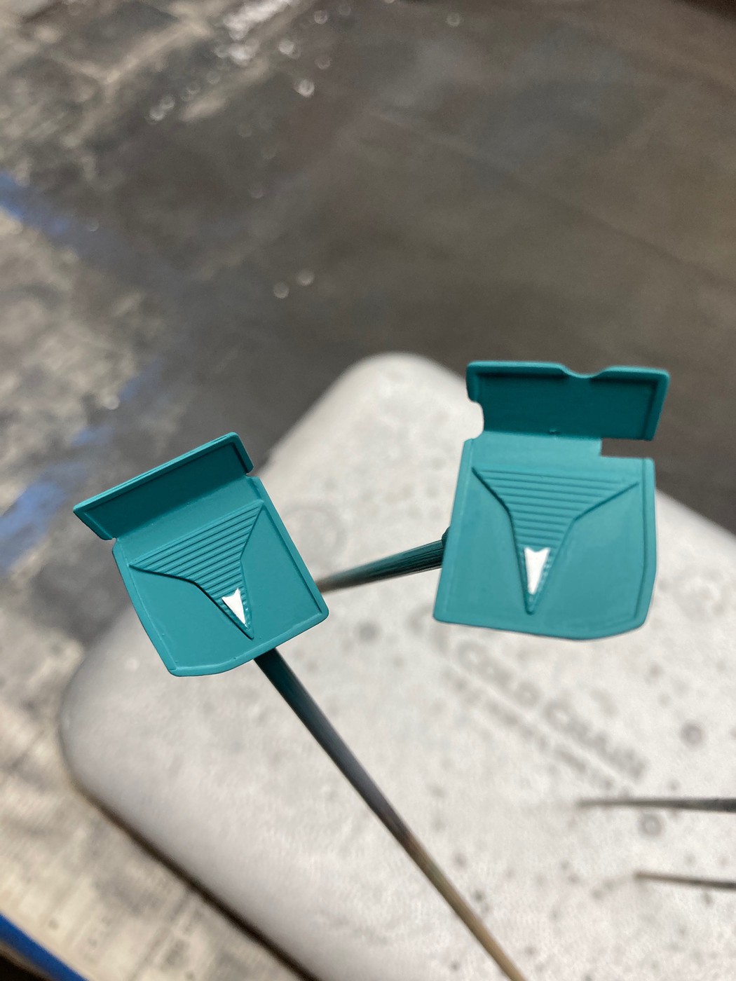

StevenGuthmiller Posted July 15, 2023 Author Posted July 15, 2023 Thanks guys!! I spent a little more time refining the floor mats, and I think they're looking pretty good. I added a perimeter "molding" around the mat using some thin styrene strip, plus I used some thinned down ridged styrene sheet for the 3 pointed star. I'll spray the whole thing with a color that matches the rest of the interior and leave the Pontiac crest white. Then I'll use a little bit darker embossing powder to carpet the background, leaving the 3 pointed star and the perimeter the interior color. Should look good. I figure it will add another level of detail to the interior, plus it will cover the majority of the seam between the floor plate and firewall. Steve 2

StevenGuthmiller Posted July 17, 2023 Author Posted July 17, 2023 Thanks guys! Got some paint on the floor mats. I think I'll give them a light coat of clear to seal them, and then the background will get some embossing powder. Steve 1

StevenGuthmiller Posted July 20, 2023 Author Posted July 20, 2023 6 hours ago, customline said: Yes indeed! ? Freaking AWESOME! Thanks Jim! Got the embossing powder down on the floors this afternoon, but I wasn't really satisfied with the coverage or color uniformity. I don't have any turquoise embossing powder, so I mixed some blue and green, but strangely, it appeared that the 2 powders were different weights, and they seemed to want to separate on me, affecting the color uniformity. Plus, I made the mistake of using a darker colored powder over a lighter substrate, so coverage wasn't great either. Luckily, it's an easy fix. A little flat enamel mixed up and sprayed on fixes the issues very well. Nice and even in all aspects now. Steve 3
customline Posted July 20, 2023 Posted July 20, 2023 Looks fantastic, Steve. The effect is amazing. I believe it's really carpeting...are you applying the embossing powder the same way you would apply flock? My wife has a ton of that stuff. I'm sure she wouldn't mind....?
StevenGuthmiller Posted July 20, 2023 Author Posted July 20, 2023 2 hours ago, customline said: Looks fantastic, Steve. The effect is amazing. I believe it's really carpeting...are you applying the embossing powder the same way you would apply flock? My wife has a ton of that stuff. I'm sure she wouldn't mind....? I just use slightly thinned white glue. Steve
