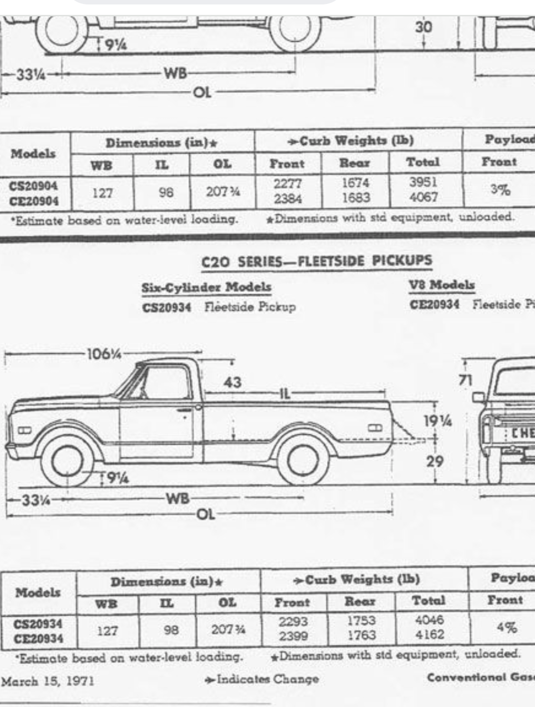

The discrepancies I have found....

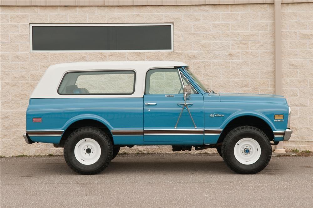

The blazer, according to 1:1 dimensions I found online, is too short. The wheel base is right on, but short front and rear.
The C10, from the bottom body line to the bottom of the panel appears different compared to 1:1pics. The bottom rear quarter angle is also different from 1:1pics. Let's not forget the engine bay is all wrong. As far as length, I haven't checked that yet.

When you measure, are you taking the actual measurements and dividing by 25 or using the 1"=1mm method? The 1"=1mm method is not accurate on measurements such as wheelbase or body length. It's OK on short measurements like a wheel. But, not on longer measurements.
I've never heard of the 1"=1mm method, of course that would be inaccurate. The mathematically correct way is to divide the measurement by the desired scale.
Something that needs to be taken into consideration concerning the C/10 is when the tooling was made originally. The C/10 was actually made from a GMC that was done over fifty years ago. I don't know if the Blazer came about in the same manner or not. Either way, it's old tooling.
Exactly how short are they front and rear?
Actual OL=180.5", =7.22"@1/25 scale.
The kit measures (without having it in front of me) 6 13/16- 6 7/8"

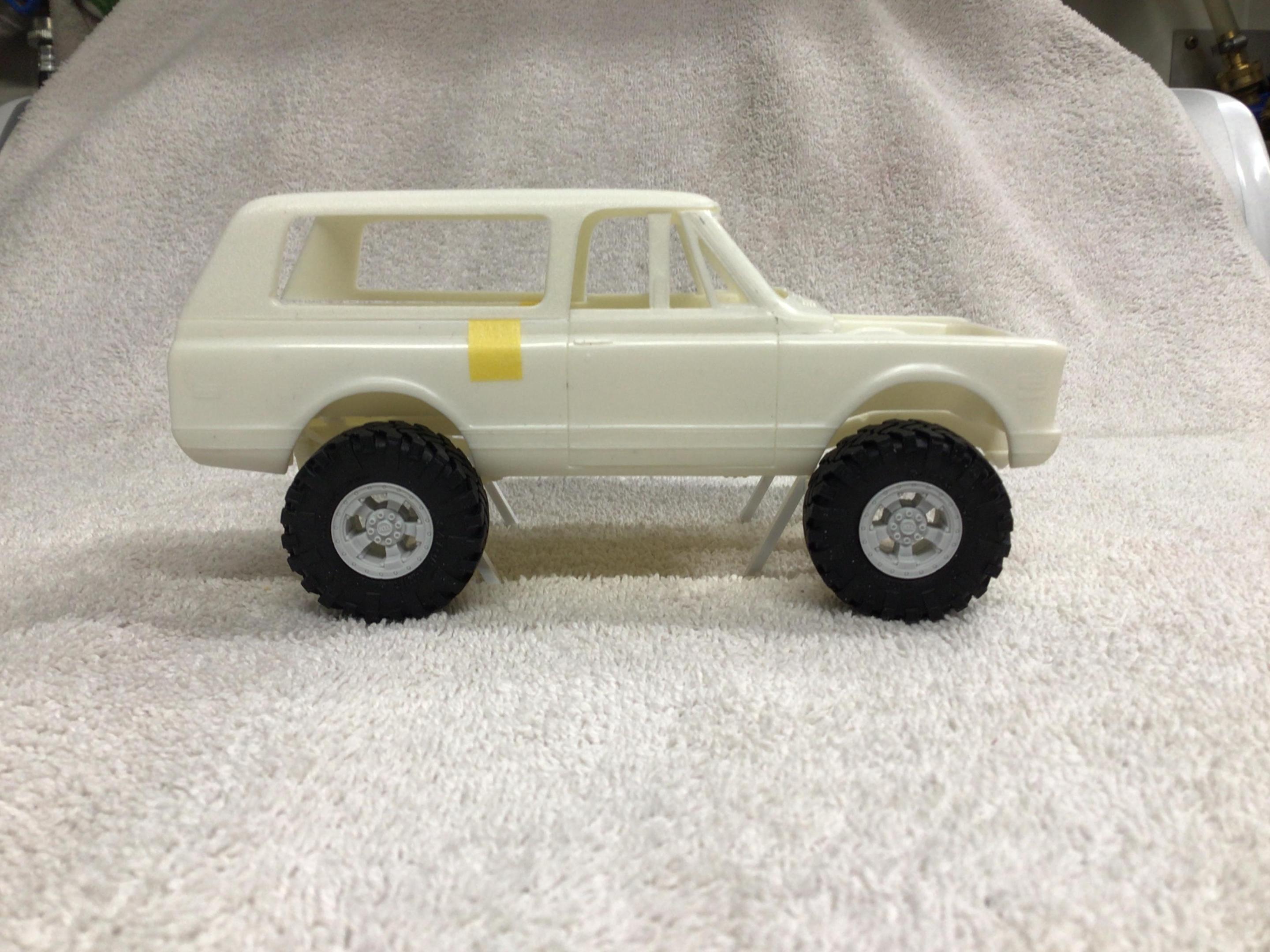

It looks like it maybe needs a little extra length between the door and the rear wheel opening? The size and shape of the rear side window is a little off, and the rear profile could be squared up a hair? ?‍♂️ All in all, the body looks fairly accurate to me. I have no idea about the C-10.
Edited by NOBLNG
I'm comparing 1:1 dimensions given to the kit itself. Just wanted to see how prevalent this is among other kits. Seen many posts and heard many conversations about kit incorrectness.
Thanks for the pictures, that helps a lot!
I too see the shortness between the door and the rear wheelhouse, but if the wheelbase is correct as he says, I can't see how to fix it.
Roof looks a little short in the back too. Possibly the window is too big.
Might just have to be a case for "eyeball engineering", if it looks like the 1:1 then that's close enough. It probably would take a little stretching and shrinking to get the desired look.
I do agree with him that the underhood details are lacking in both kits. Firewall openings are huge and the inner fenders are just plain wrong on the pickup and would require major surgery to correct.
