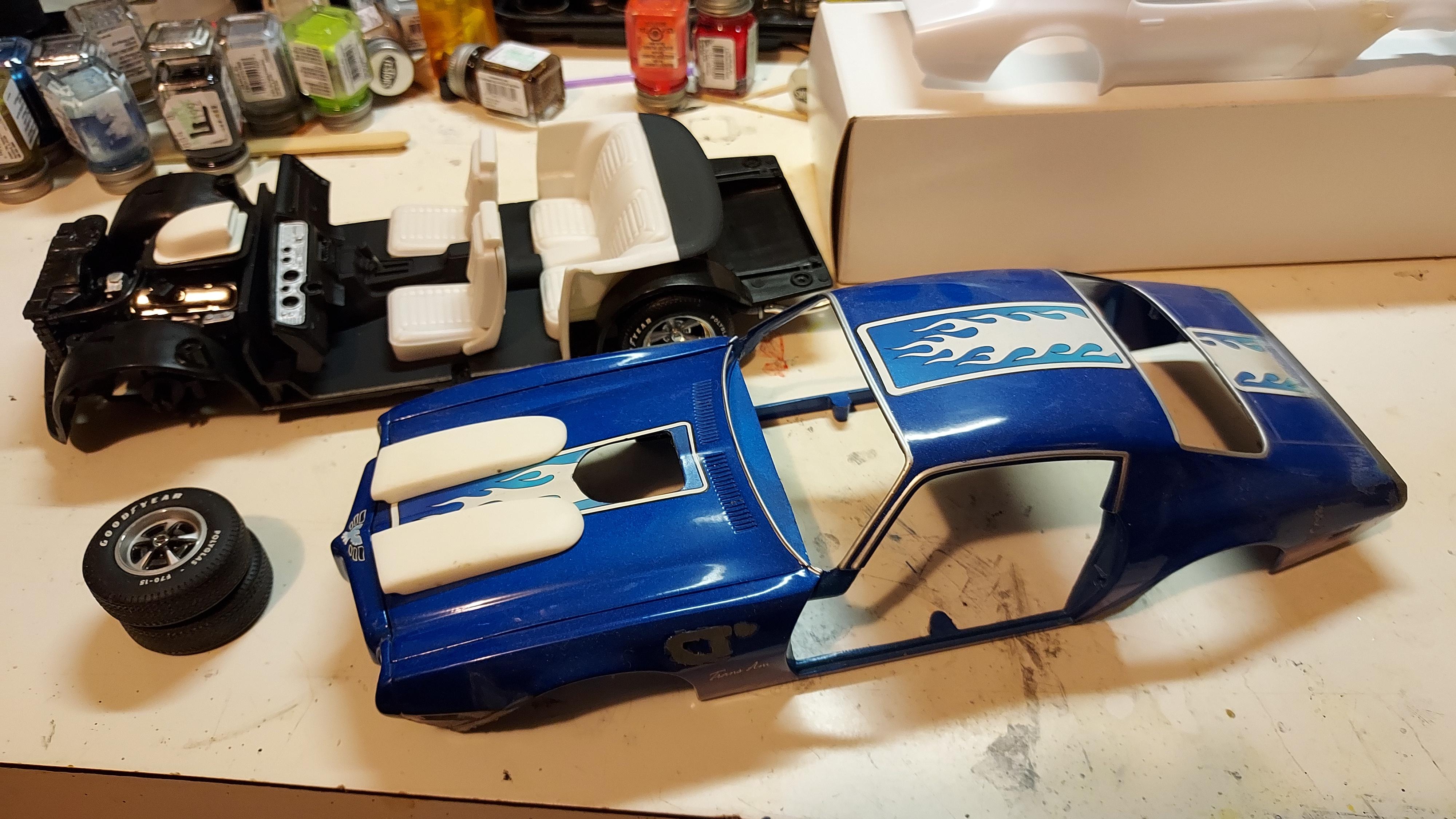

This is just the very beginning stages but you gotta start somewhere.  A slight touch with the Dremel and some light sanding with an emery board then a little dab of Tamiya filler Putty and the side scoops are a thing of the past.  I'll let that dry overnight. Next I'll have to make a Ram Air Air cleaner. For this I was able to trim the bottom half if the shaker scoop and the top half of an extra Deserter Air cleaner. The rally lls are soaking in Mr. Clean as they way too shiny chrome and need to be painted Argent. Revell did a pretty good job on these also. You just need a little paint detailing work. The Firestone Wide Ovals are really nice. I think I might just keep the front spoiler and the wheel well pices. I know the y were specific to the T/A , but I kinda like the look of those. The same for the engine turned instrument panel applique. I always liked the look of that over the boring, wood grain of the Formula. They give you a nice decal for that.   20220826_144804.thumb.jpg.e4e21b7f7b9ee9e5f4d7bb8bdcfaf8f4.jpg20220826_145652.thumb.jpg.52e8f1757f5013826c202900eba957e4.jpg

The front spoiler and wheel well pieces (we always called the rear ones wheel pants) were available through the dealer's parts department, and worked just fine on the non-Trans Am Firebirds. My friend with a brand spanking new 78 Firebird bought and installed them. It was a great looking car.
If you want to use them, they won't be incorrect except for a factory stock model. The factory parts were available for owner installation.

Thanks Jim. A customer could get most parts over the counter at the dealers back then. The hood tach was another item. Most of the time the dealership would even install the parts for you. Many people did this with the rear spoiler also, but I always felt that the Firebird looked right with no spoiler, so that's the way I'm going on this one. Taking a few "day 2" liberties with the engine turned instrument panel and a few things here and there.

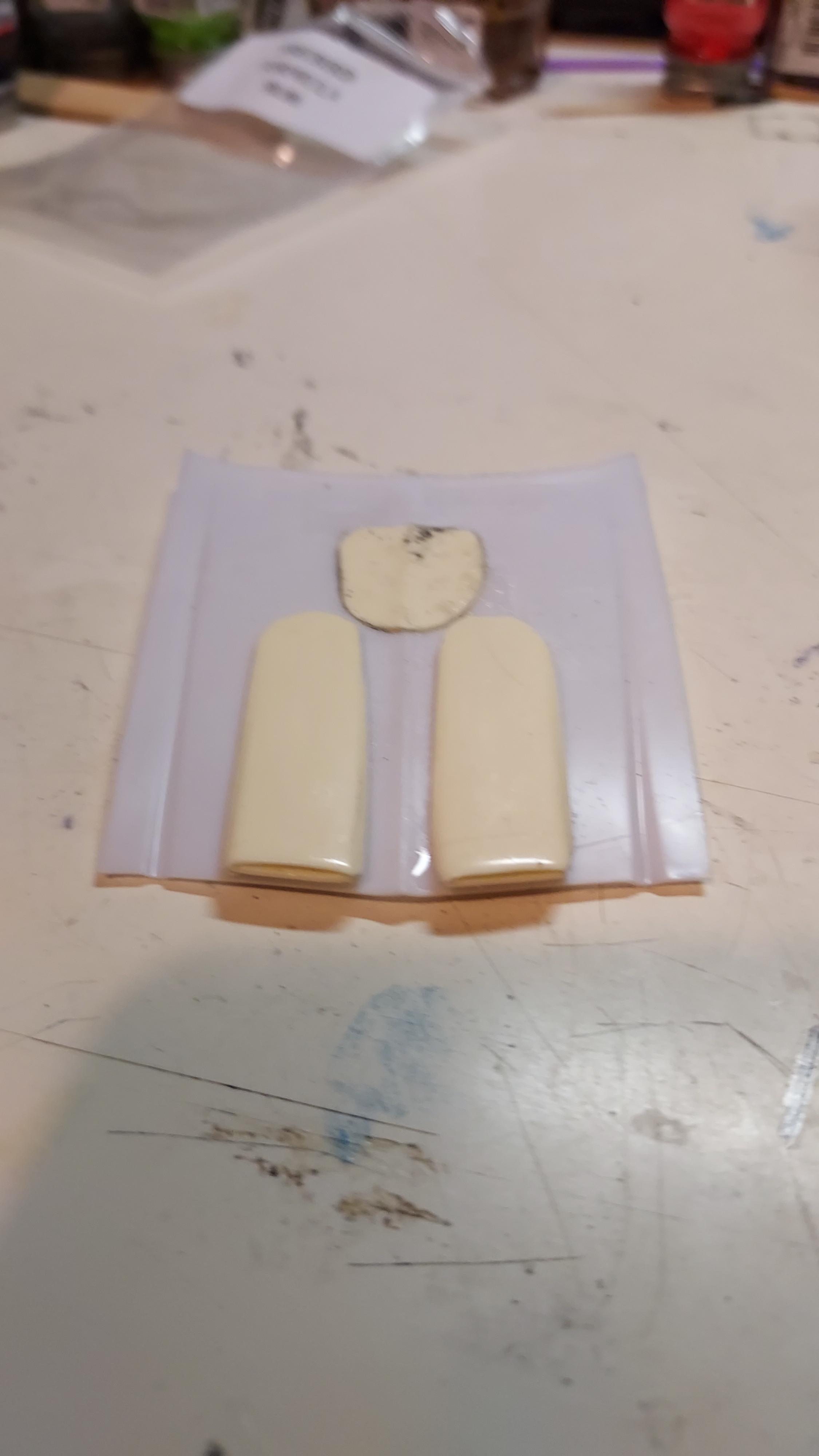

Thanks for the tip but I decided to go a different route. I first mad a sort of plug for the shaker hoke. Wile sanding, I constantly remembered to take off a little at a time and keep checking for fit. And remember that I only have one of these to screw up so I don't want to do that. The plug is not perfect but the rest I can correct with filler. I'm going to let that dry overnight.  As for the scoops, they were a little more involved than I expected they would be.  But there not glued in Place yet. I'll need to do the putty work first.

I was hoping to use the original hood to make things go smoother. I guess I pulled it off. A major hurdle in this build.
