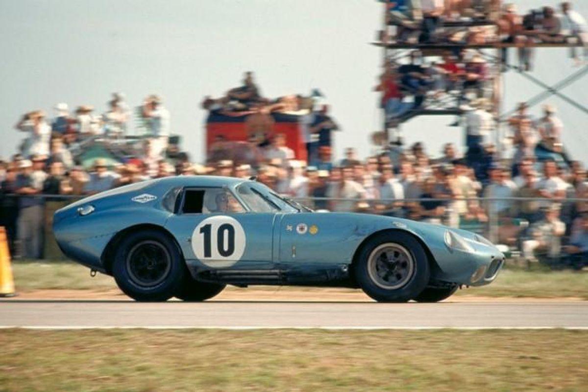

Gramps46 Posted December 13, 2022 Posted December 13, 2022 (edited) Ok, I have kept quiet but here goes. For sure CSX2287 was Viking blue in 1964 and Guardsman Blue in 1965 and stayed that way through adventures at Bonneville and on to rest at Simione. Now the rear fender flare issue. Cars racing at Le Mans were required to have the body extend downward to the center of the wheels. CSX 2287 had the larger flare in 1964 but you can see CSX 2299 had smaller tabs behind the wheels like many of the competitors did. Now say good night Gary. OK, "good night Mrs. Calabash, wherever you are". (Jimmy Durante) Edited December 13, 2022 by Gramps46 1
absmiami Posted December 14, 2022 Author Posted December 14, 2022 Stay tuned Gramps … got some more work for you … gonna post a mix of Model Master enamel paints tomorrow - and we’re gonna have a stare down of Model Master vs Zero ….
absmiami Posted December 14, 2022 Author Posted December 14, 2022 By the way G …. The finish on the wheels - appears to be titanium - ish - but maybe with aluminum rims - the whole thing looked dull and tired after a few hours at Sebring …. Agree ?
absmiami Posted December 14, 2022 Author Posted December 14, 2022 By the way - the Lemans shot you’ve posted is the best shot of the Shelby team Wheel jacks that exists …

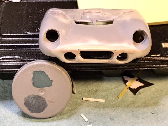

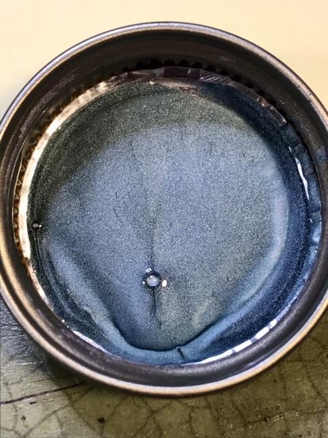

absmiami Posted December 15, 2022 Author Posted December 15, 2022 Model master enamel paint - had good fortune mixing a pale green metallic color on the Cooper FIII last yr - so lets see if i can cook up some Viking Blue - the interior metallic blue is too dark out if the bottle- per the bottle top photo - but with a little added aluminum I’m close - while wet - its a shade darker than the Zero Paints V blue - but it seems to be getting lighter as it dries - we’ll see what I’ve got in the morning - one thing for sure - the silver metal flake is much more scale accurate than the Zero …
Pierre Rivard Posted December 15, 2022 Posted December 15, 2022 Looks promising Andy. The metallic flakes of Testor's look much more in scale. You might need more silver. Different brands of course but when I did mine I started with silver and gradually added some blue. In the end about 60/40
Gramps46 Posted December 15, 2022 Posted December 15, 2022 Much better Andy. Your photo looks a little pale to me compared to other photos I have. This one is before the roof was cut out over the windshield to get some air to the drivers. But then when I compare it to my model looks more silver like Pierre said. 1

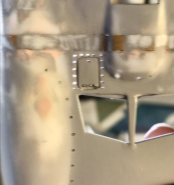

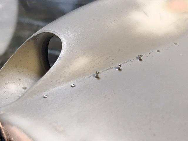

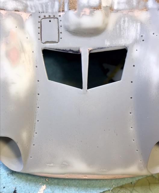

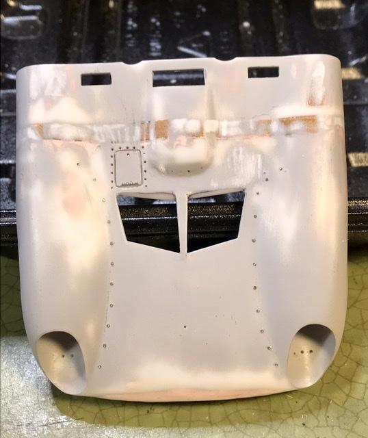

absmiami Posted December 17, 2022 Author Posted December 17, 2022 Top Studio rivets for the fenders - with dimples - these are barely visible on the Simeone Daytona Coupe - the hope is that a couple of coats of paint will have the same effect in scale …

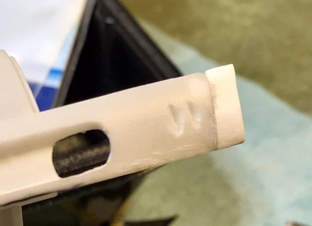

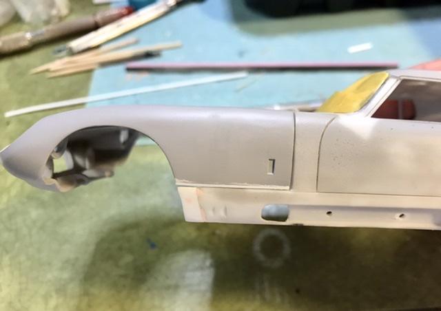

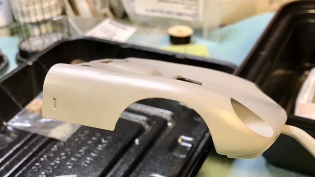

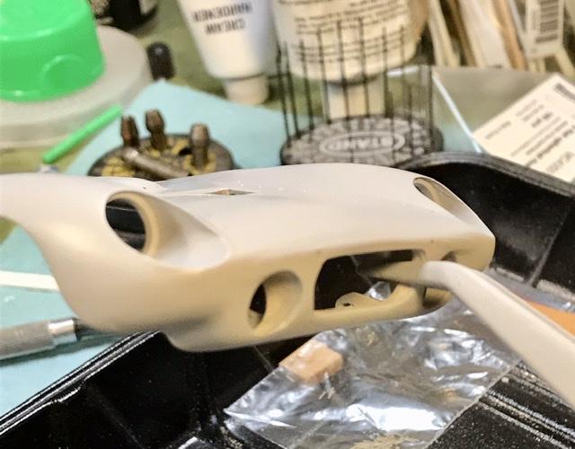

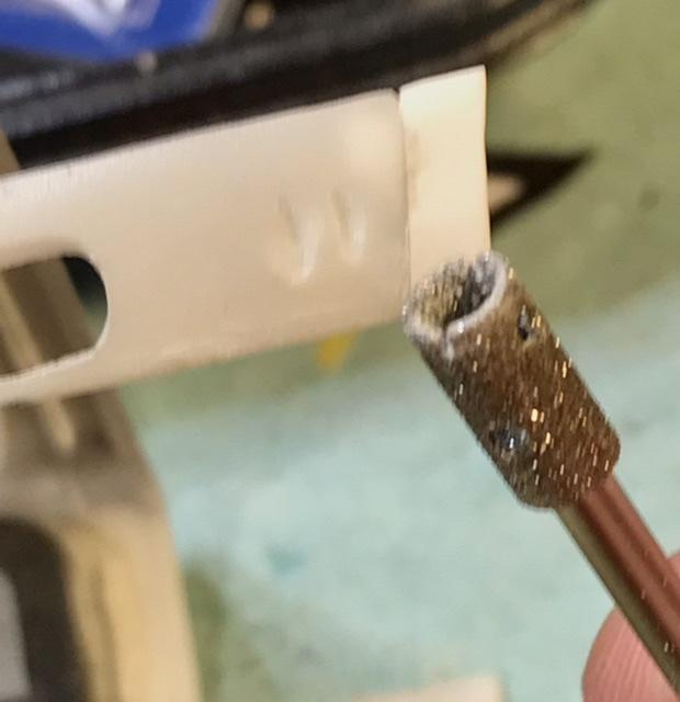

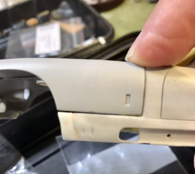

absmiami Posted December 17, 2022 Author Posted December 17, 2022 Lengthened the rocker panels to match the longer bonnett and added louvers that were unique to chass 2287 - i think - that diamond coated cutting bit is useful for gauging the louvers - i think they are made by Eurotool - which caters to jewelry makers …

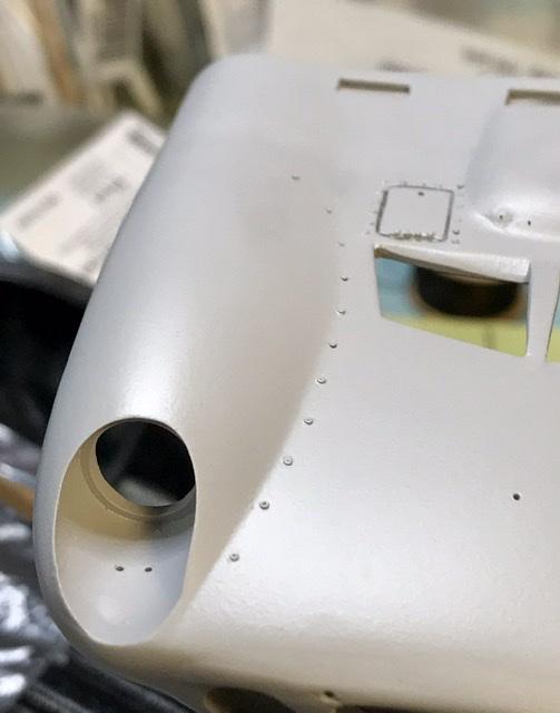

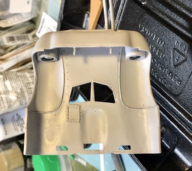

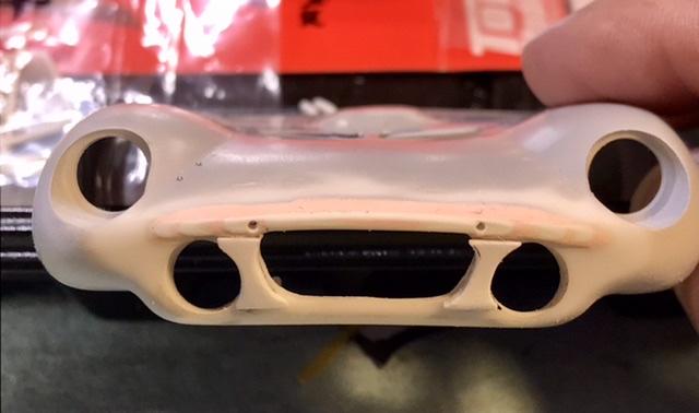

absmiami Posted December 17, 2022 Author Posted December 17, 2022 Once i re-profiled the beak - i realized that i had to follow the new shape down around the radiator opening - with some bits of Evergreen strip and putty - i wanted to get the correct shape - its a design feature that has been copied in Generations of sports cars since …

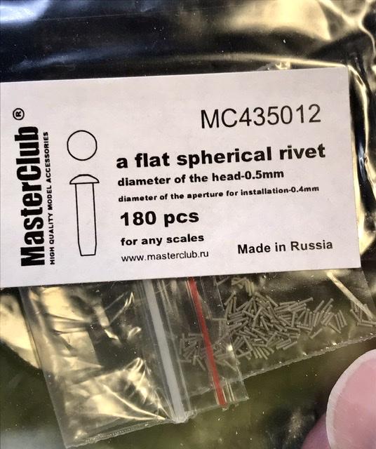

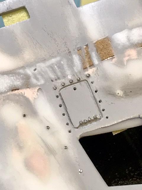

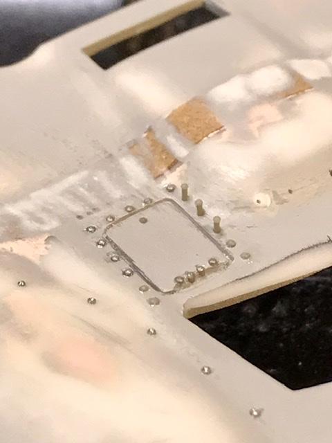

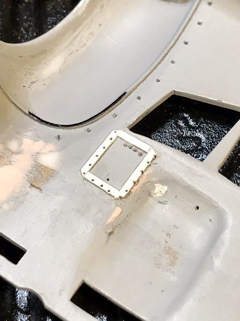

absmiami Posted December 17, 2022 Author Posted December 17, 2022 There is a small hinged hatch on the bonnett - for adding oil ? - this was riveted with some Master Club rivets … 1

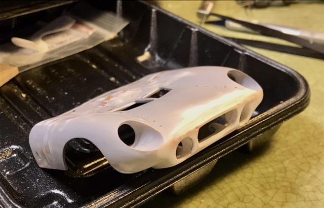

absmiami Posted December 17, 2022 Author Posted December 17, 2022 Now a third coat of Tamiya rattle can primer - probably the final primer coat - that strip of Renshape is finally well hidden ….
Pierre Rivard Posted December 17, 2022 Posted December 17, 2022 Lots of work but the bonnet looks really good. The rivets add a lot of realism. Very nice.
cobraman Posted December 17, 2022 Posted December 17, 2022 On 12/17/2022 at 12:43 PM, absmiami said: Now a third coat of Tamiya rattle can primer - probably the final primer coat - that strip of Renshape is finally well hidden …. Expand Love this project !
MarkJ Posted December 17, 2022 Posted December 17, 2022 On 12/17/2022 at 12:43 PM, absmiami said: Now a third coat of Tamiya rattle can primer - probably the final primer coat - that strip of Renshape is finally well hidden …. Expand Wow, Andrew. You have some real master modeling going on here. At first, I had my doubts about this project, but it's going to be through the roof Awesome for sure.
