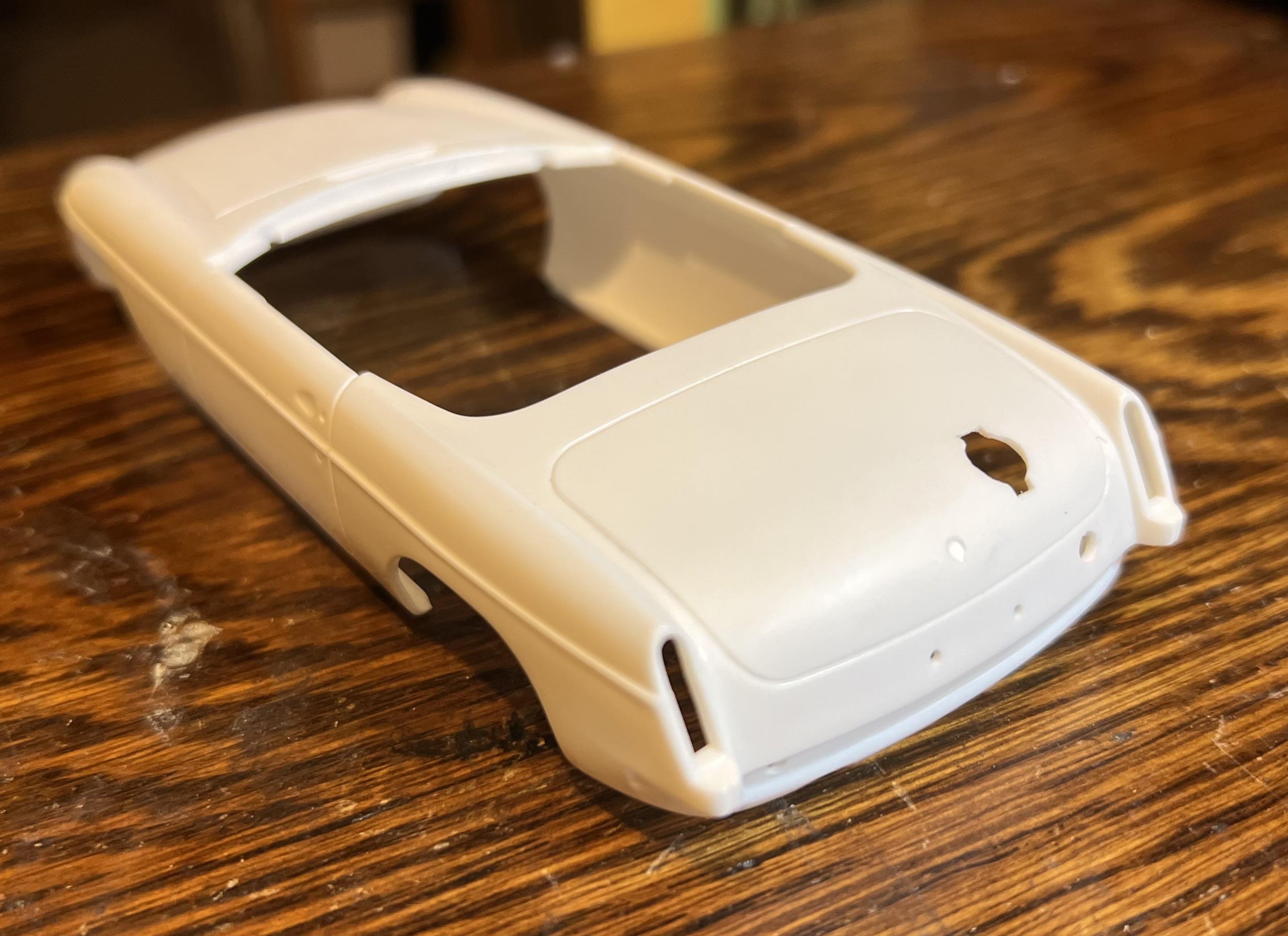

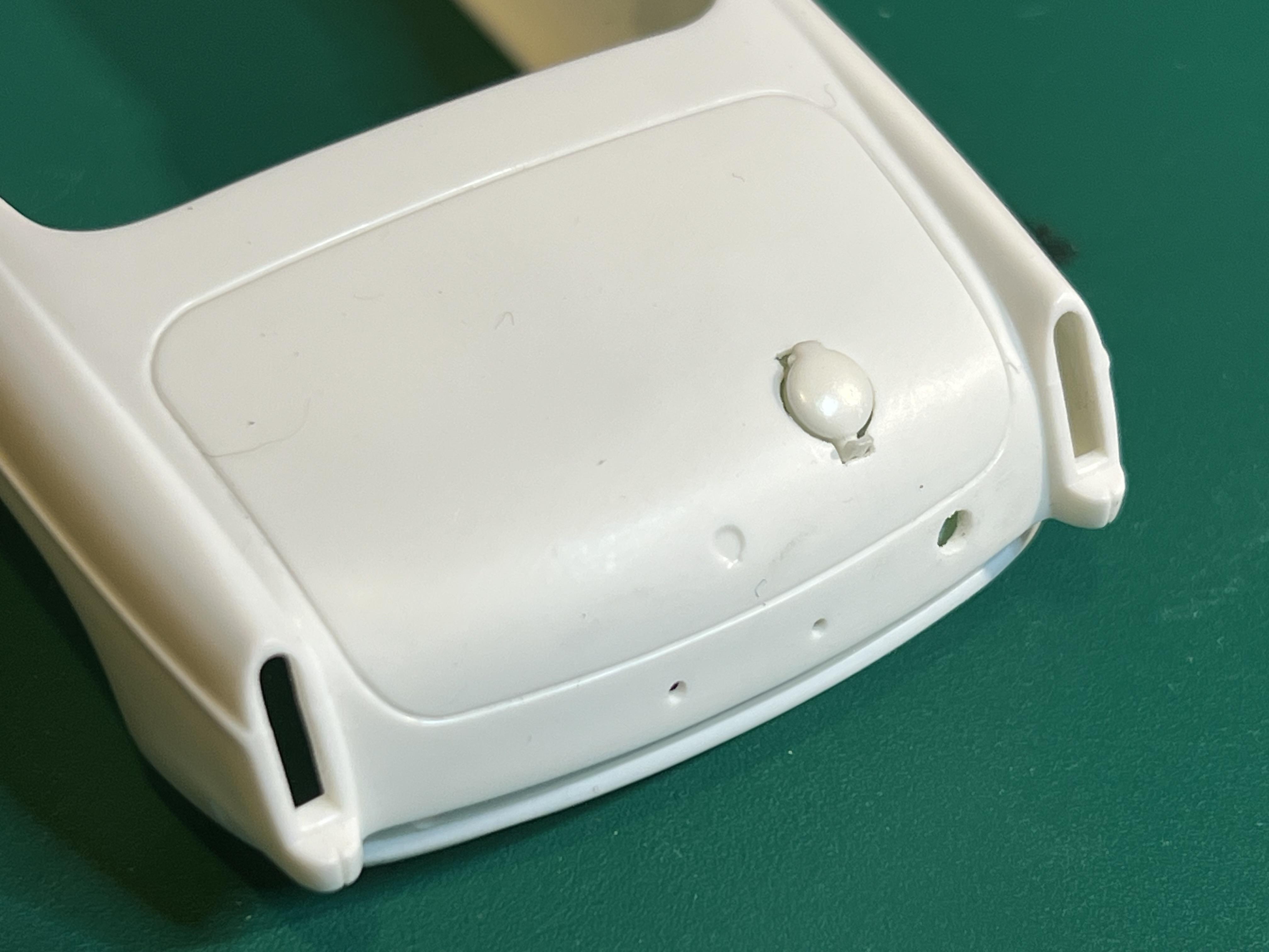

In building the blue #48 from the trio entered at Sebring I began with prepping the body for primer. To deepen the panel lines I used the Tamiya scriber with the fine edged inserts that has become my go to tool for this. Checking my photo references I made the cutout for the gas filler cap and closed off the stock opening.

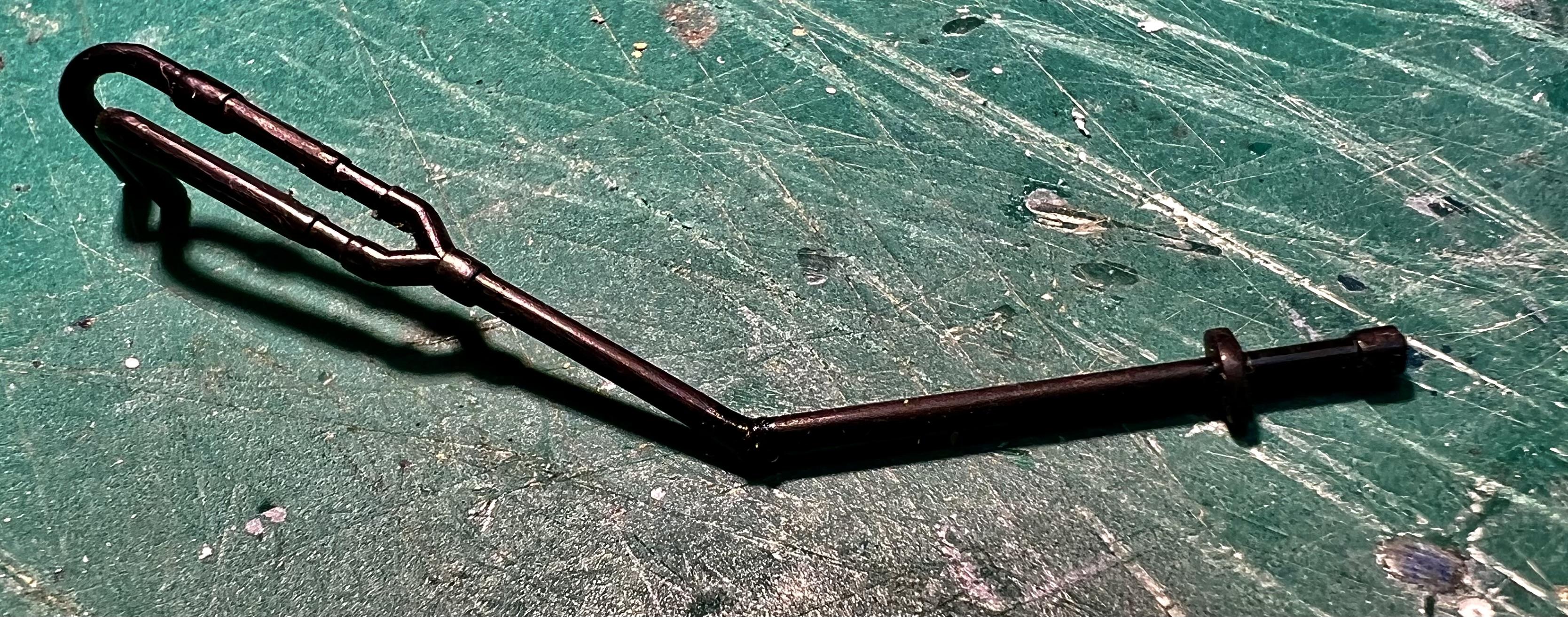

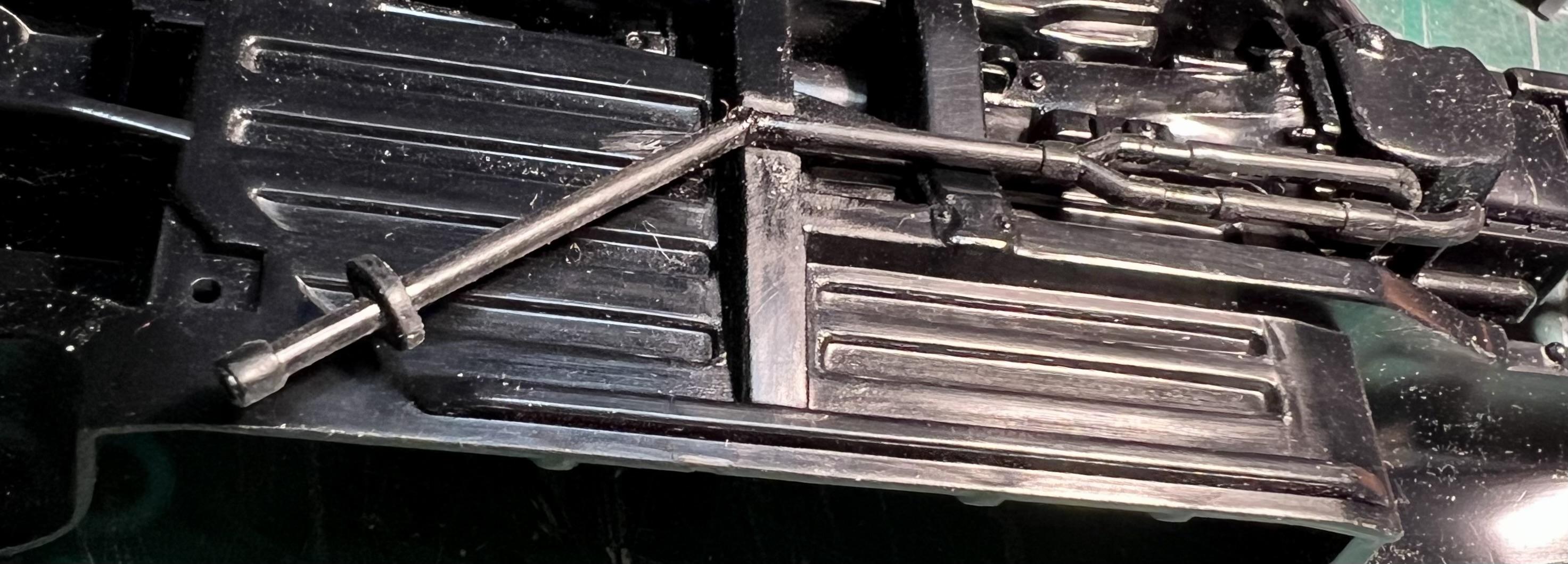

The exhaust pipe also required an alteration to have it exit in front of the rear wheel.

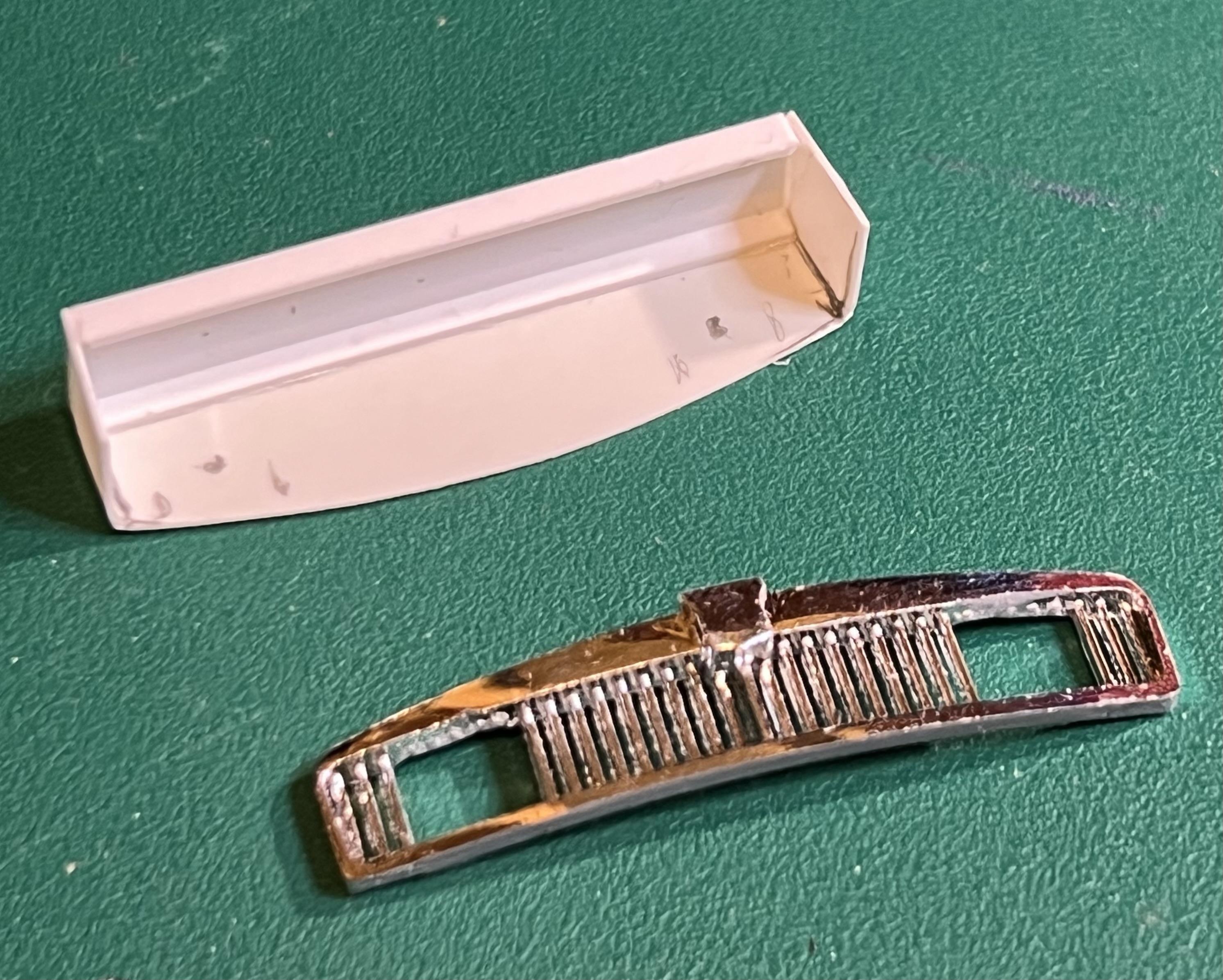

The grill is finely cast with open spaces between the vertical bars making it easy to alter to fit the driving lights. Being a curbside there isn’t an engine bay to speak of, so I scratch built an assembly to fit behind the grill to attach the lights and to install the prominent oil cooler.

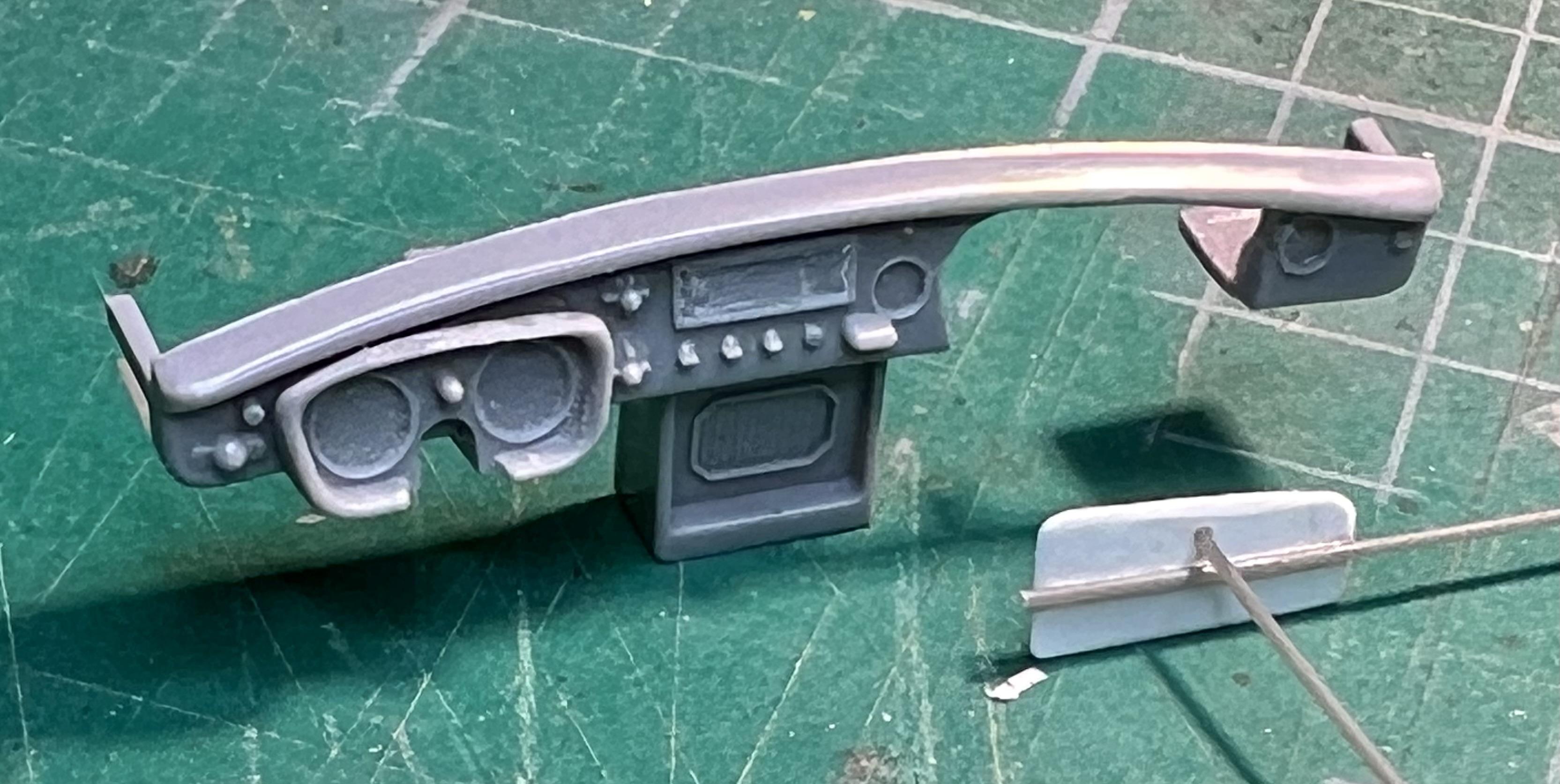

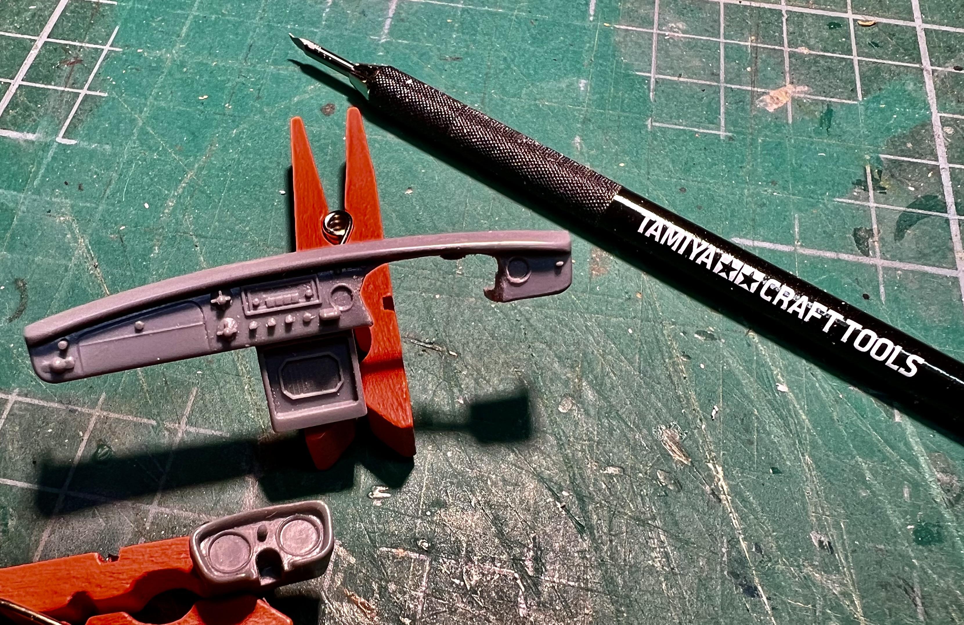

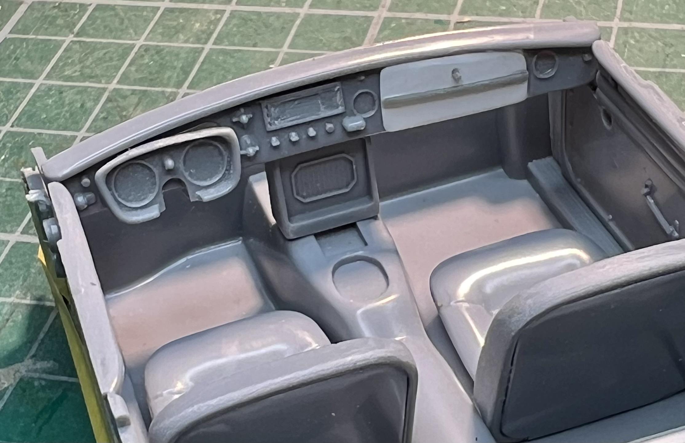

The biggest challenge so far was converting the MG to left hand drive as the three cars were North American versions. Using the same scriber the cut out the gauge cluster and installed it on the other side. A thin sheet of plastic was cut to fit the passenger side and detailed with the glovebox.
IMG_7453.thumb.jpeg.119689c7731bd65d68dd79d53d05f575.jpegIMG_7454.thumb.jpeg.9f5d226ecb10fa6f2e39f554f58b634d.jpeg

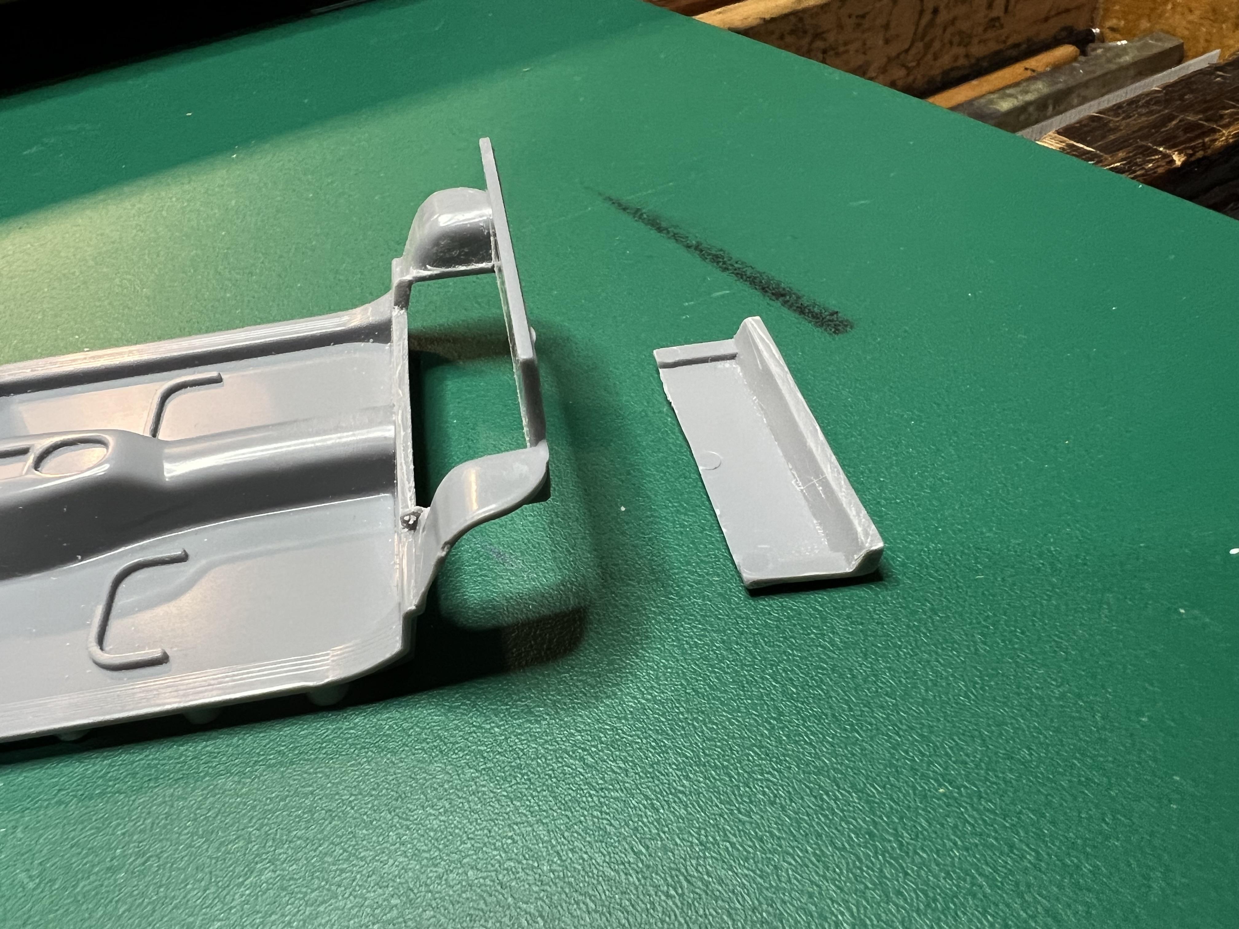

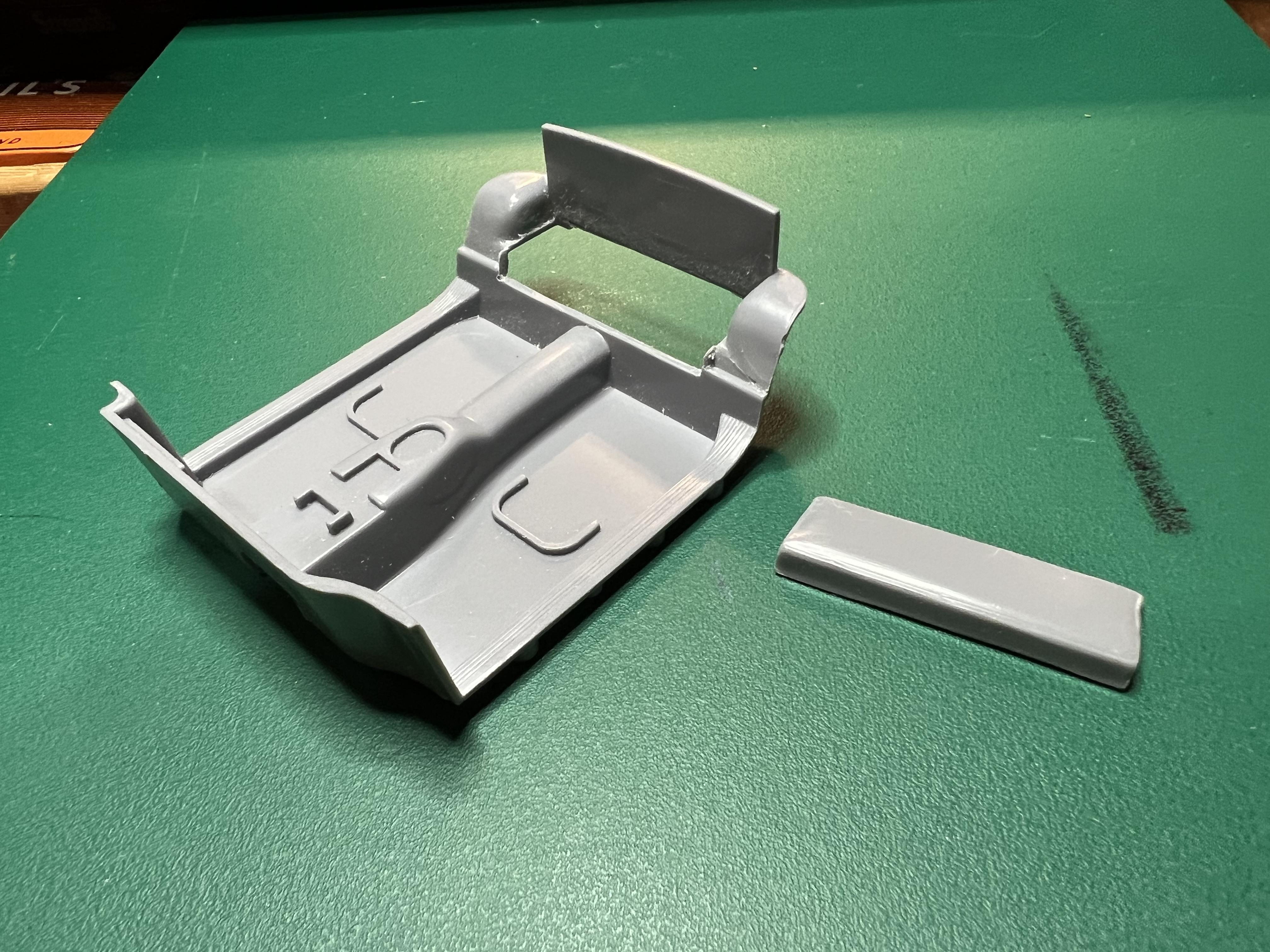

MG wanted the cars to appear as stock as possible and made few changes to the interior. Stock seats remained with the white car only being fitted with a race seat. Carpeting was removed as was the rear cushion behind the seats. This required the removal of the molded in cushion in the kit. By flipping the cutout cushion over and reattaching it I had a decent representation of the revealed metal work. This still required a lot of fiddling around to get the interior tub to fit the chassis plate.

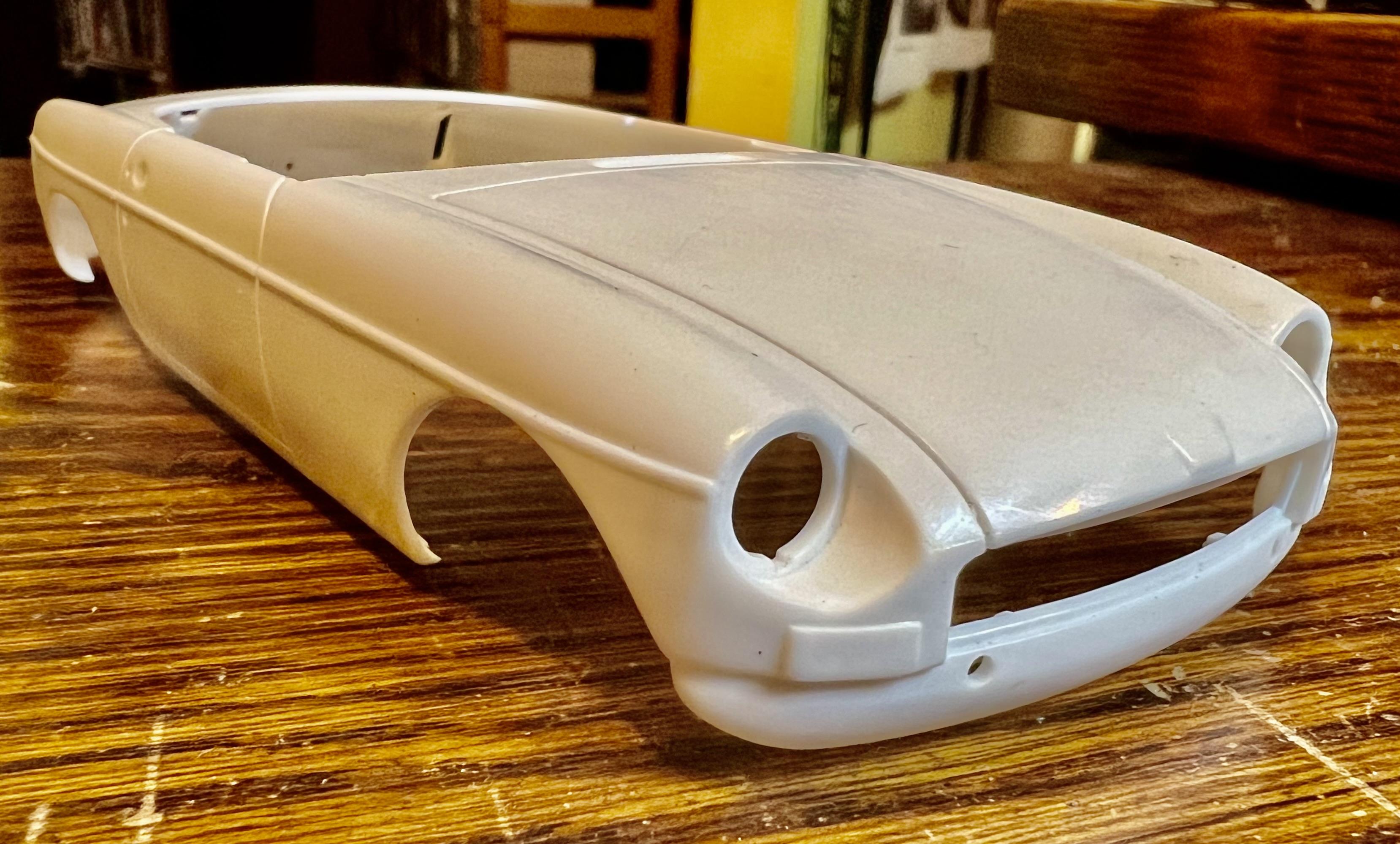

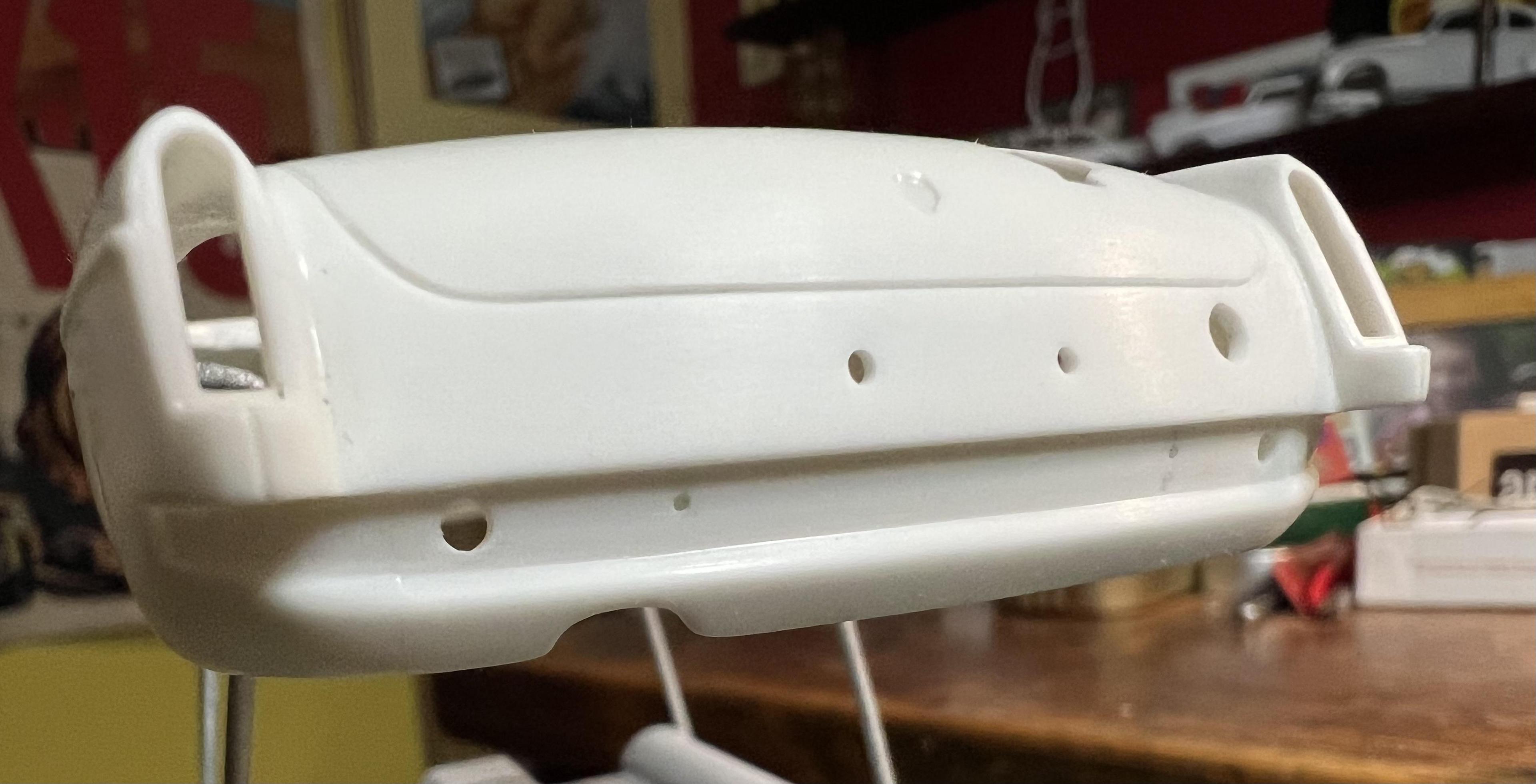

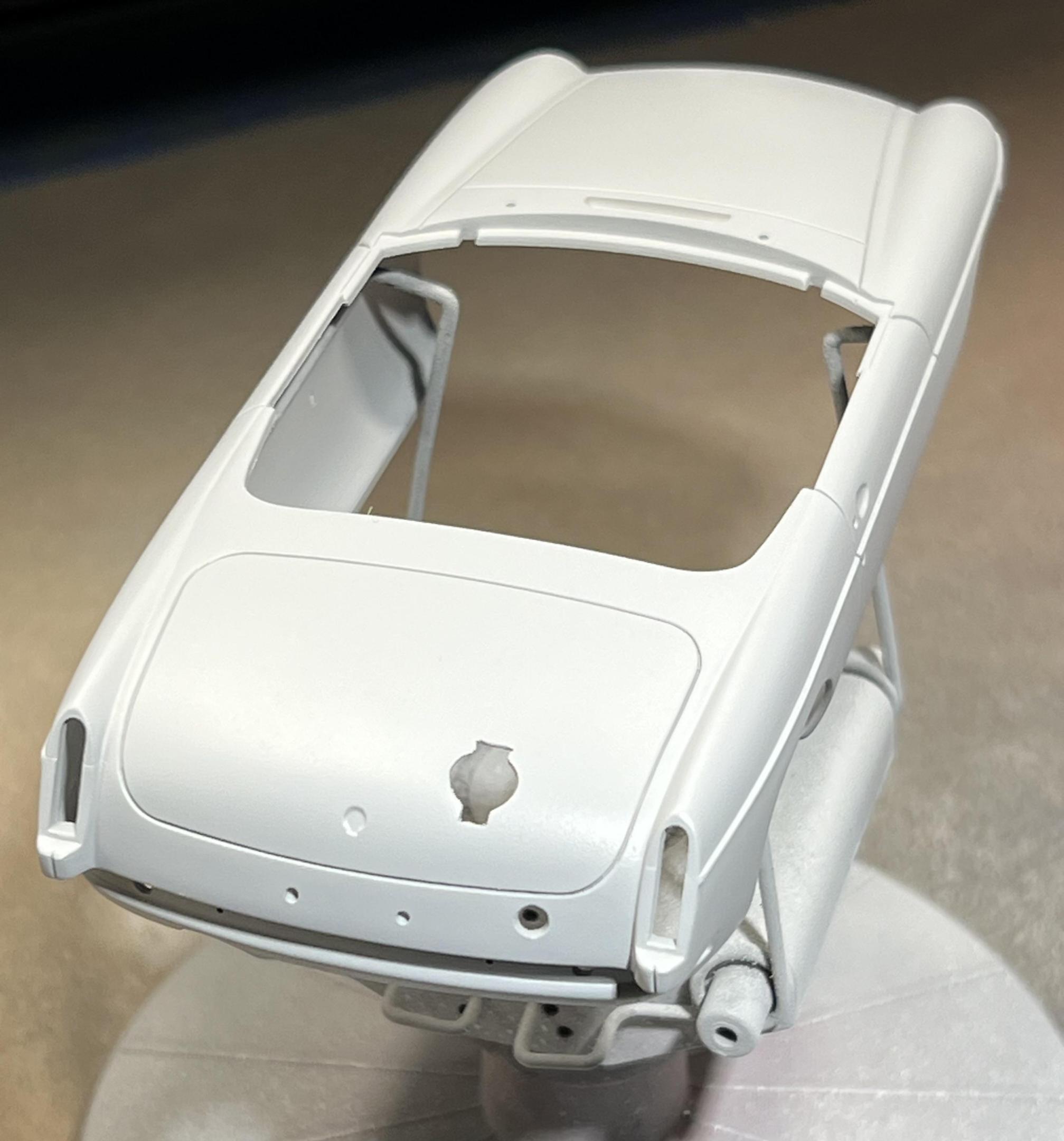

I was able to get back to the workbench over the weekend to get a bit further with the MGB build. I had a quick look at the body before priming it to discover I had missed openings in the front and rear valances. Referring to photos and using two small drill sizes they were added and two existing openings in front were modified to be rectangular.

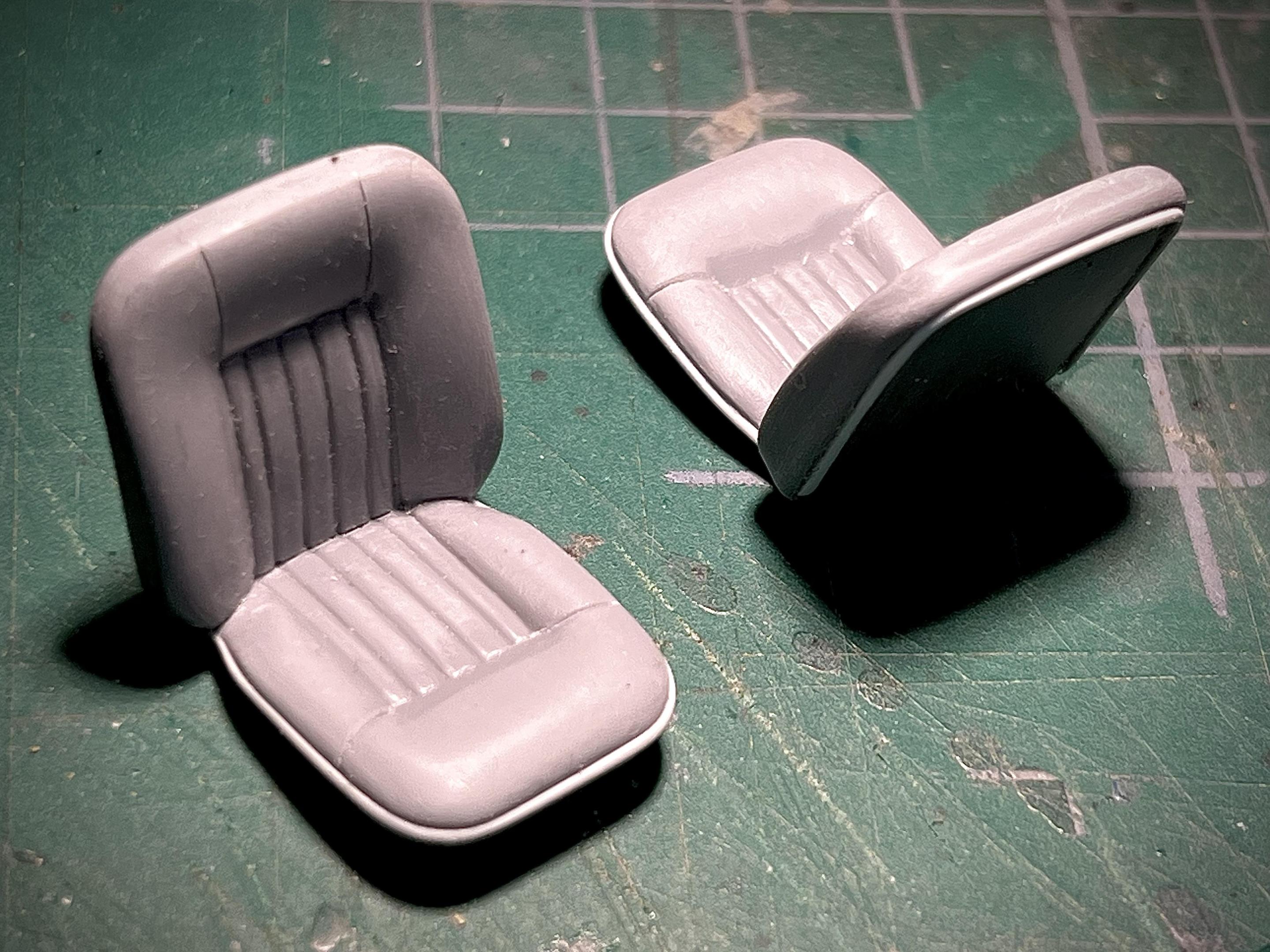

In assembling the stock bucket seats a rather unsightly seam in the back was covered with piping as well as around the seat cushion. The seats required a lot of attention due to prominent mold seams. Additional sanding was needed to soften hard ridges along the seat back. Small details that help the overall scale look.

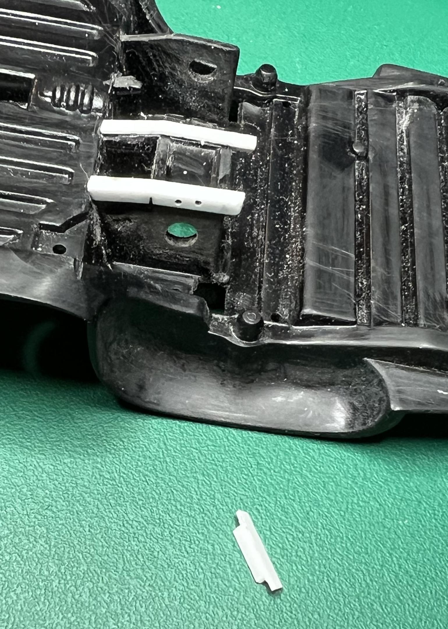

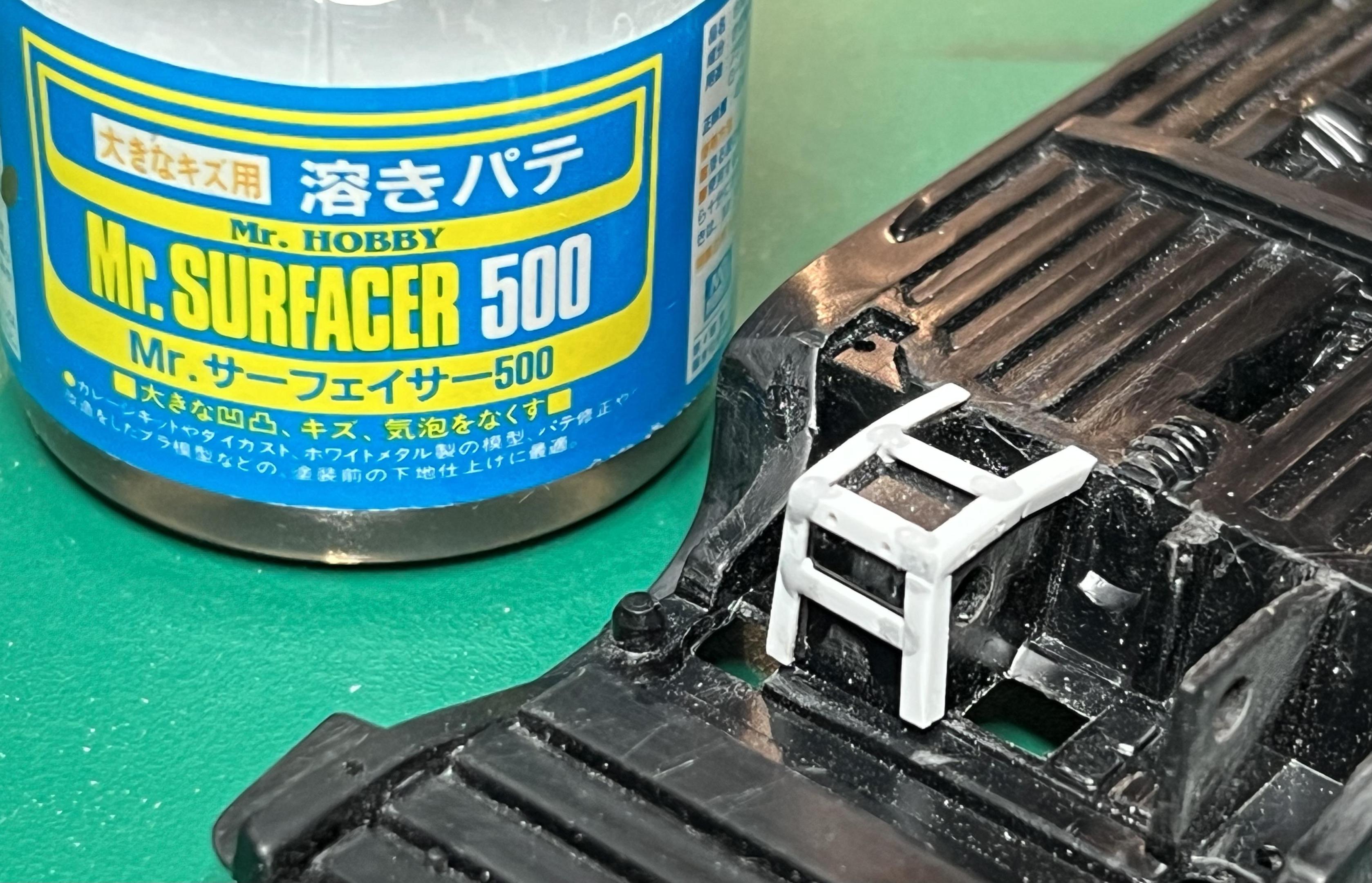

While looking at the photos and comparing the kit chassis I couldn’t help to notice some omissions on an otherwise great curbside chassis.
The most obvious were the two cage structures on either side of the rear end. The one housing the battery is a square blob and on the other side it is absent save for a slice of plastic. I decided to do a minimal fixup without attempting a complete rebuild. Using Plastistruct lengths of angle iron the blob has been outlined with greater definition. Not sure if I’ll tackle the empty cage on the other side.

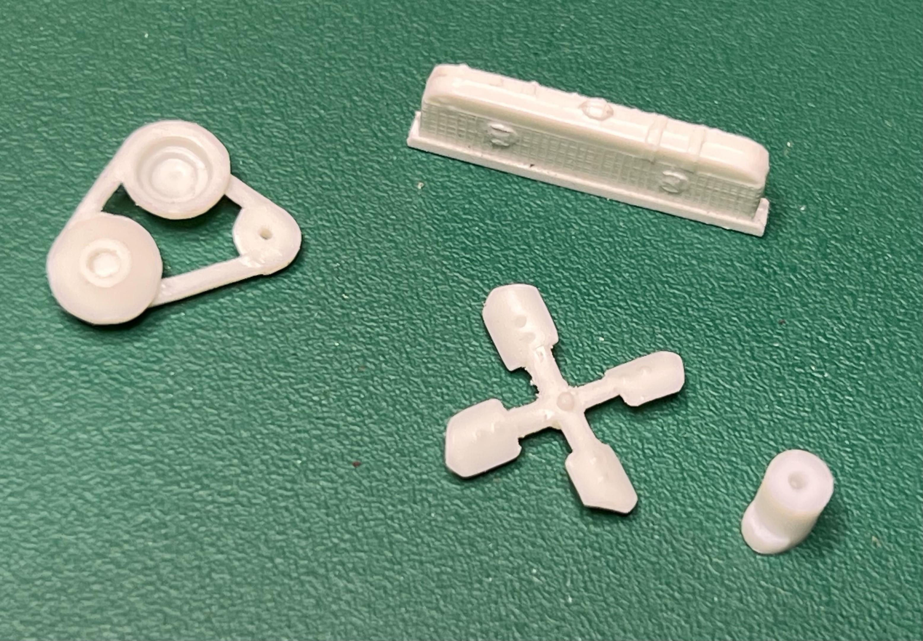

The other item is the void between the block and the bottom of the rad.
Searching thru the parts department I assembled the parts that will fill the gap and offer a refinement to the curbside look. The cut down rad from another project fits perfectly while the pulley/fanbelt assembly needed to be pulled in tighter to fit. Fortunately the generator will fit right into the stock position filling in a gap. The fan also needed a trim to fit the engine bay.

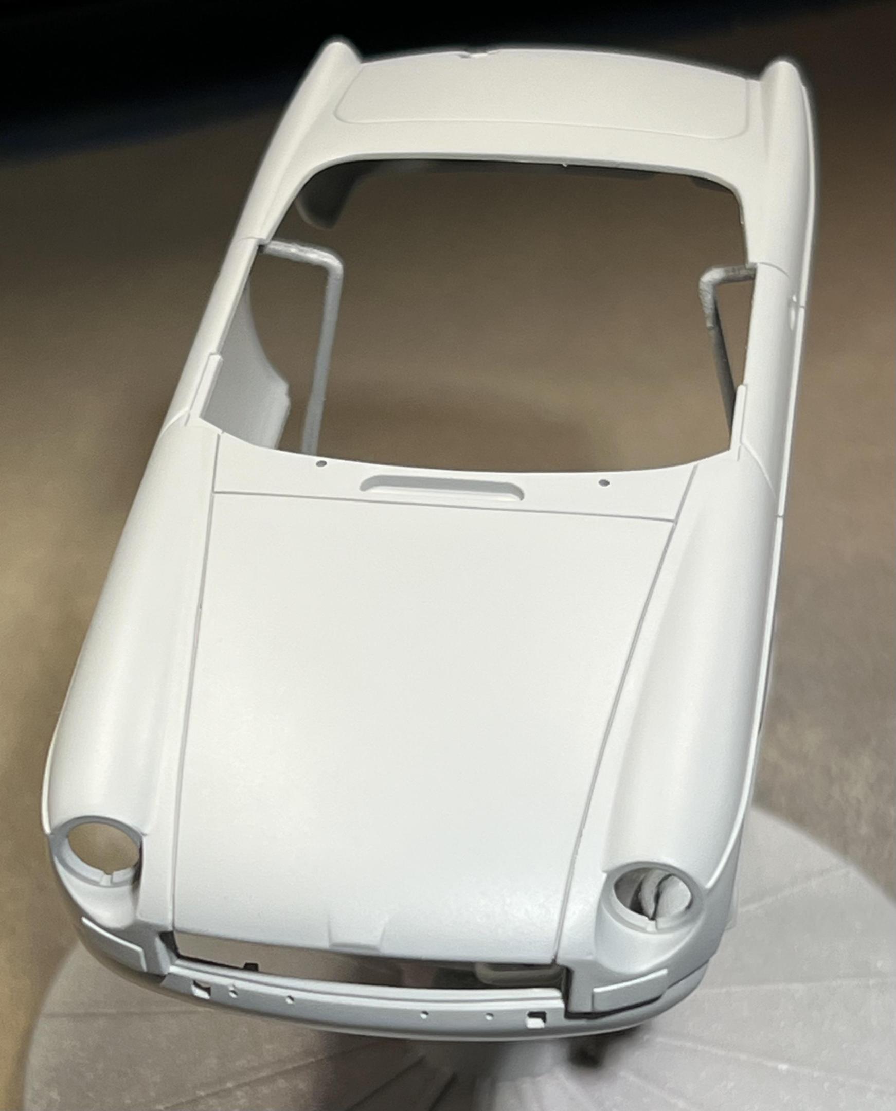

To finish off I primered the body after a through wet sanding with a  600 sponge, dry time and a dusting with an anti-static brush. Quite happy with the result so tempted to move onto the colour coats.

Donato, I hope you don't stop on the Cheetah if it's not allowed. I would have never thought you could make one from a Corvette but there it is. Do you have any photos of the Cheetah you are doing from the race?  Misha, the MGB is coming along very nicely. I especially like the seat work you have done.
