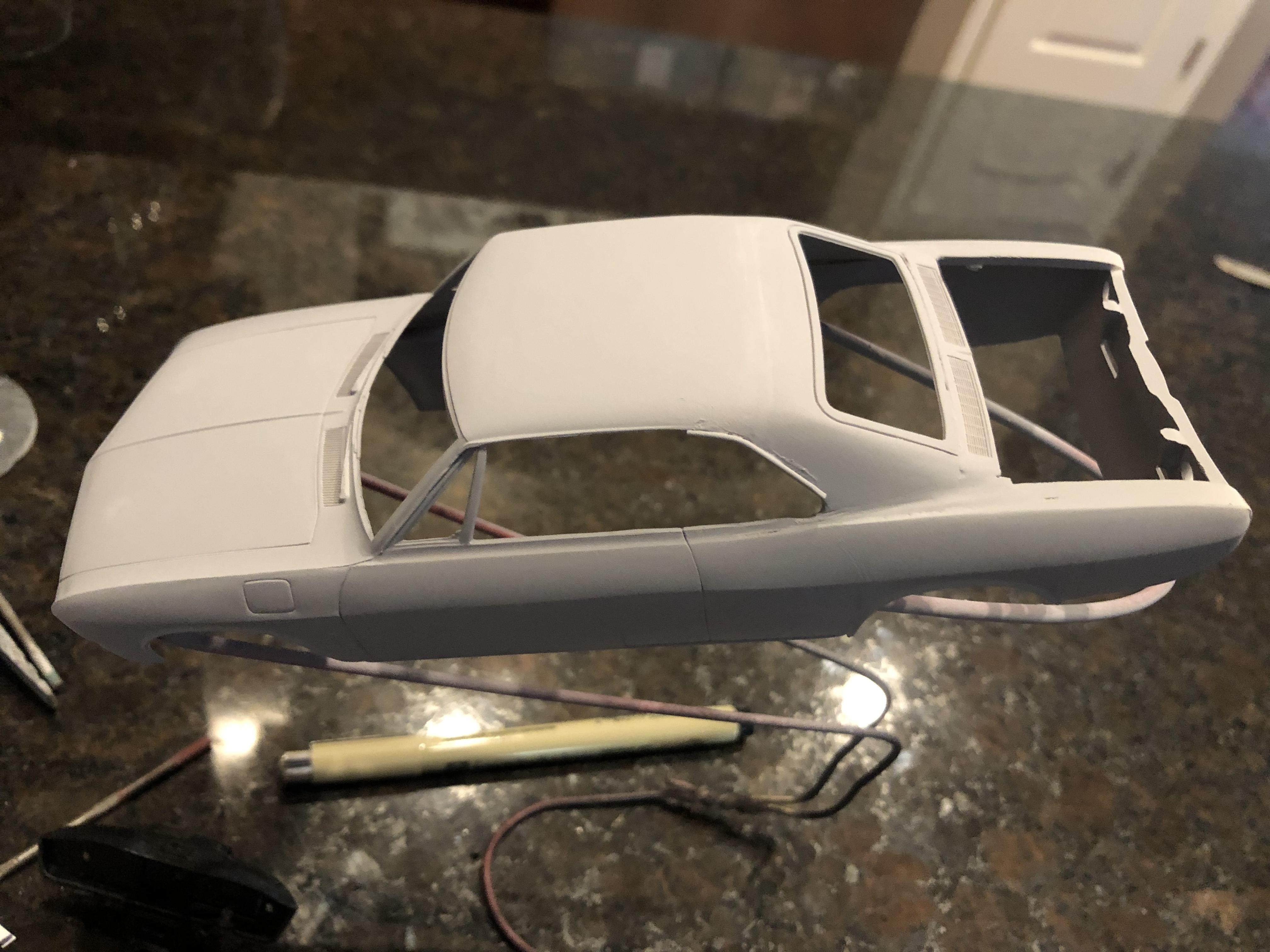

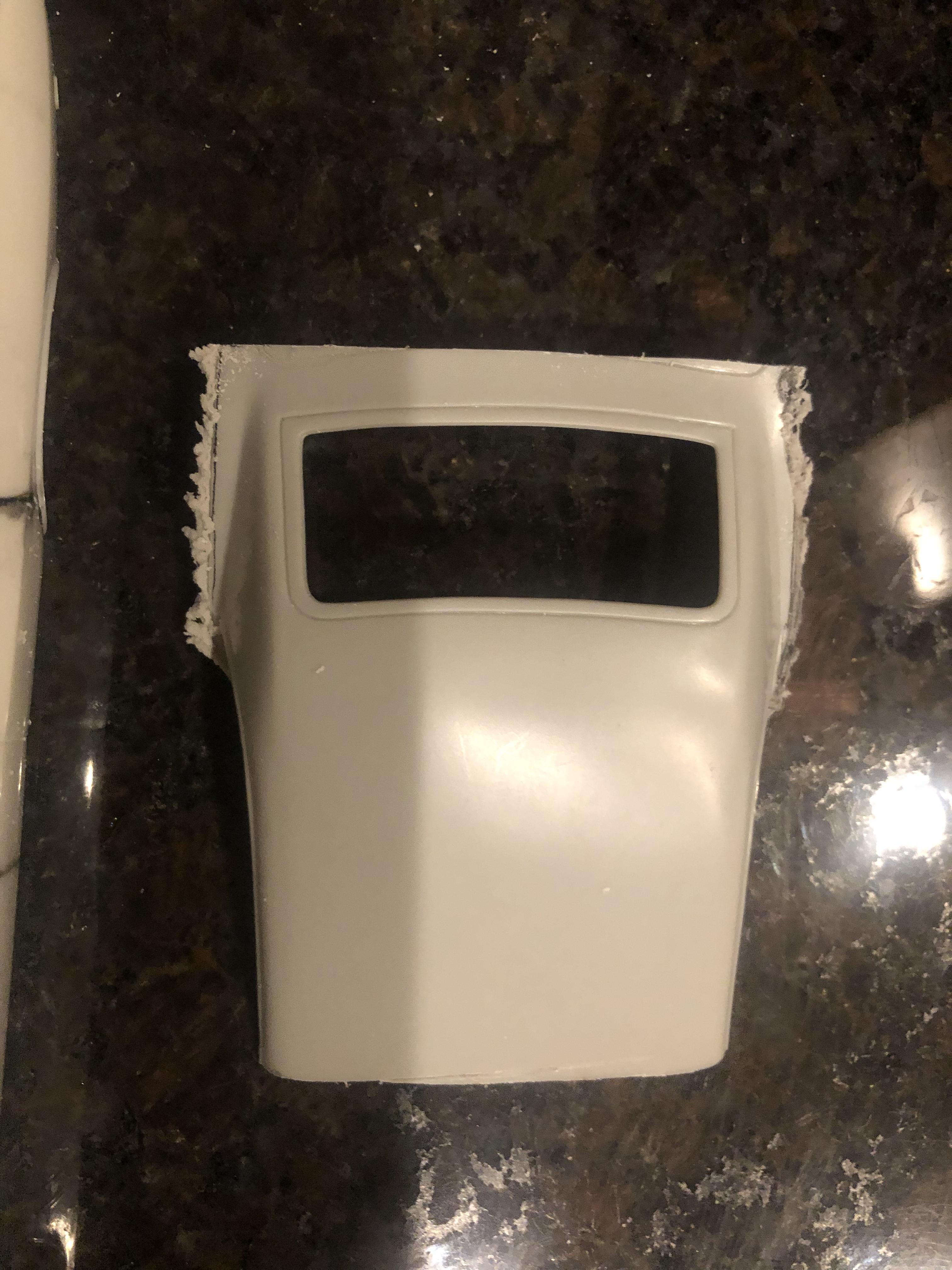

gbtr6 Posted September 18, 2022 Posted September 18, 2022 I am starting to try to build my first car, a 1965 Corvair Mona 4 door. I have one of the AMT Corvair kits, and an early Camaro body. The plan is to transplant the Camaro roof on the Corvair. It looks like the roof would fit fine. I plan on cutting the Corvair behind the windshield to use the stock Corvair windshield. At the C pillar it might be harder. I need to keep the lovers on th3 rear body work on the Corvair. Time to do some measuring. Any one that’s done this, please chime in with thoughts. Thanks, Perry 1

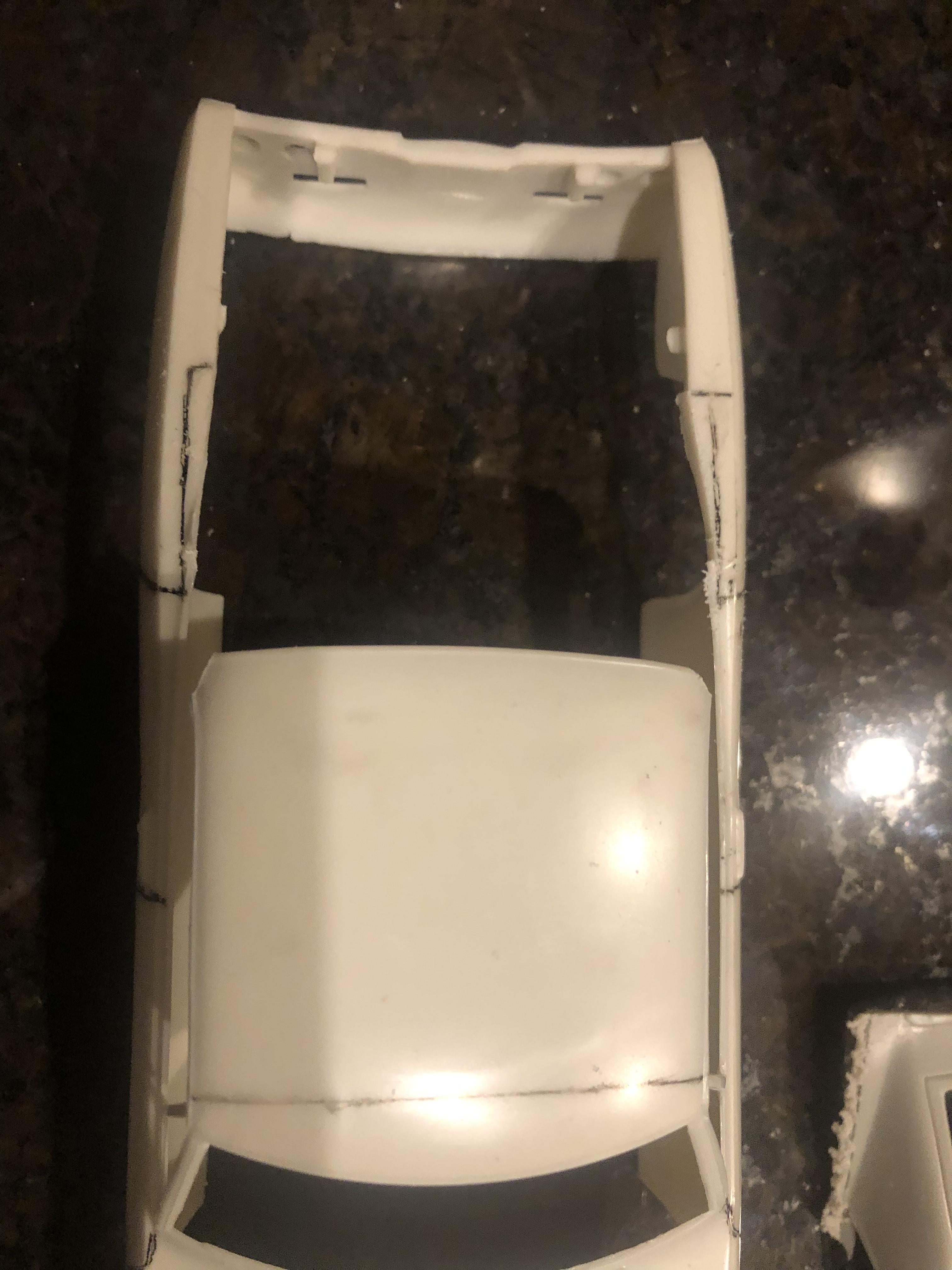

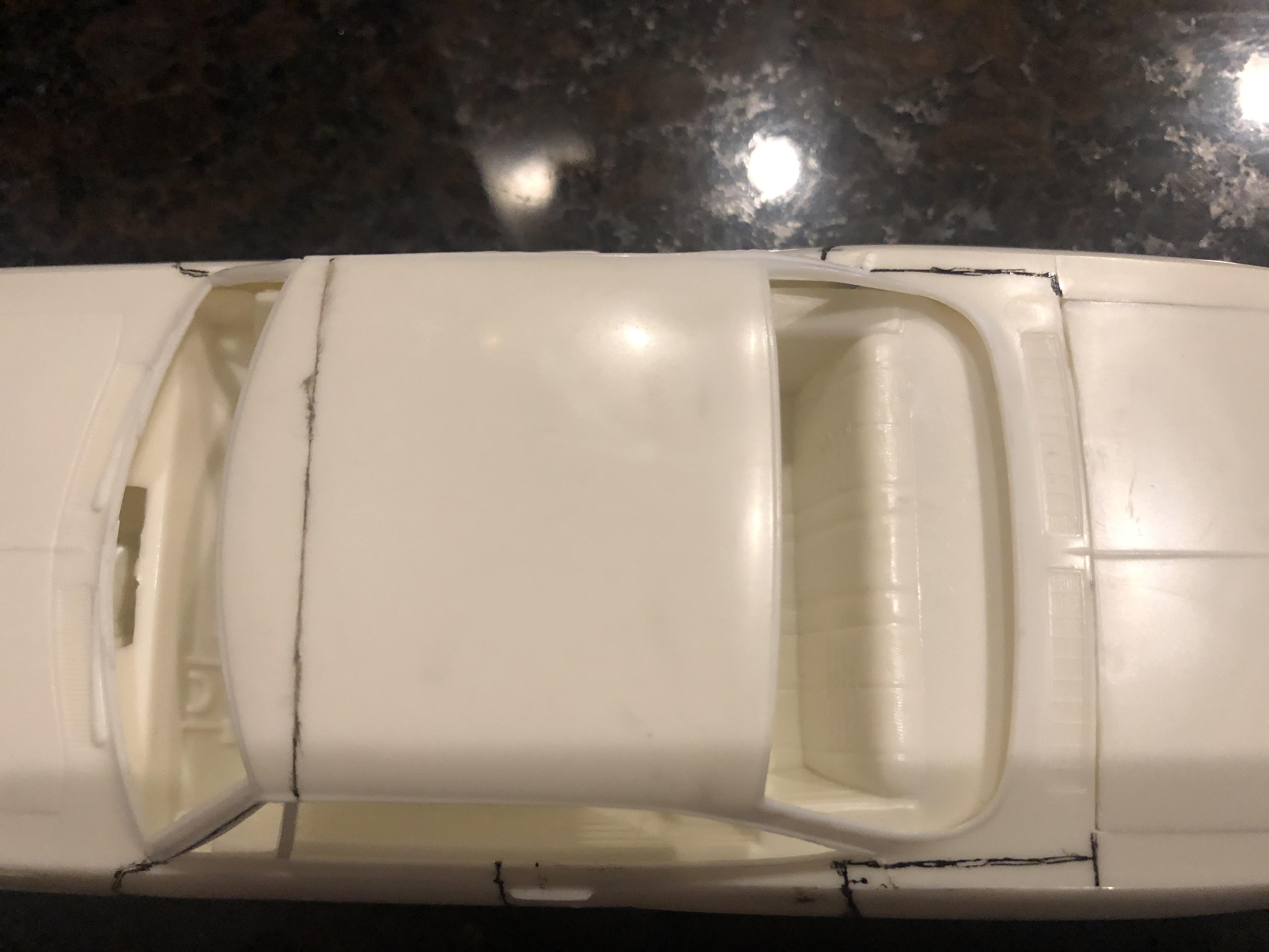

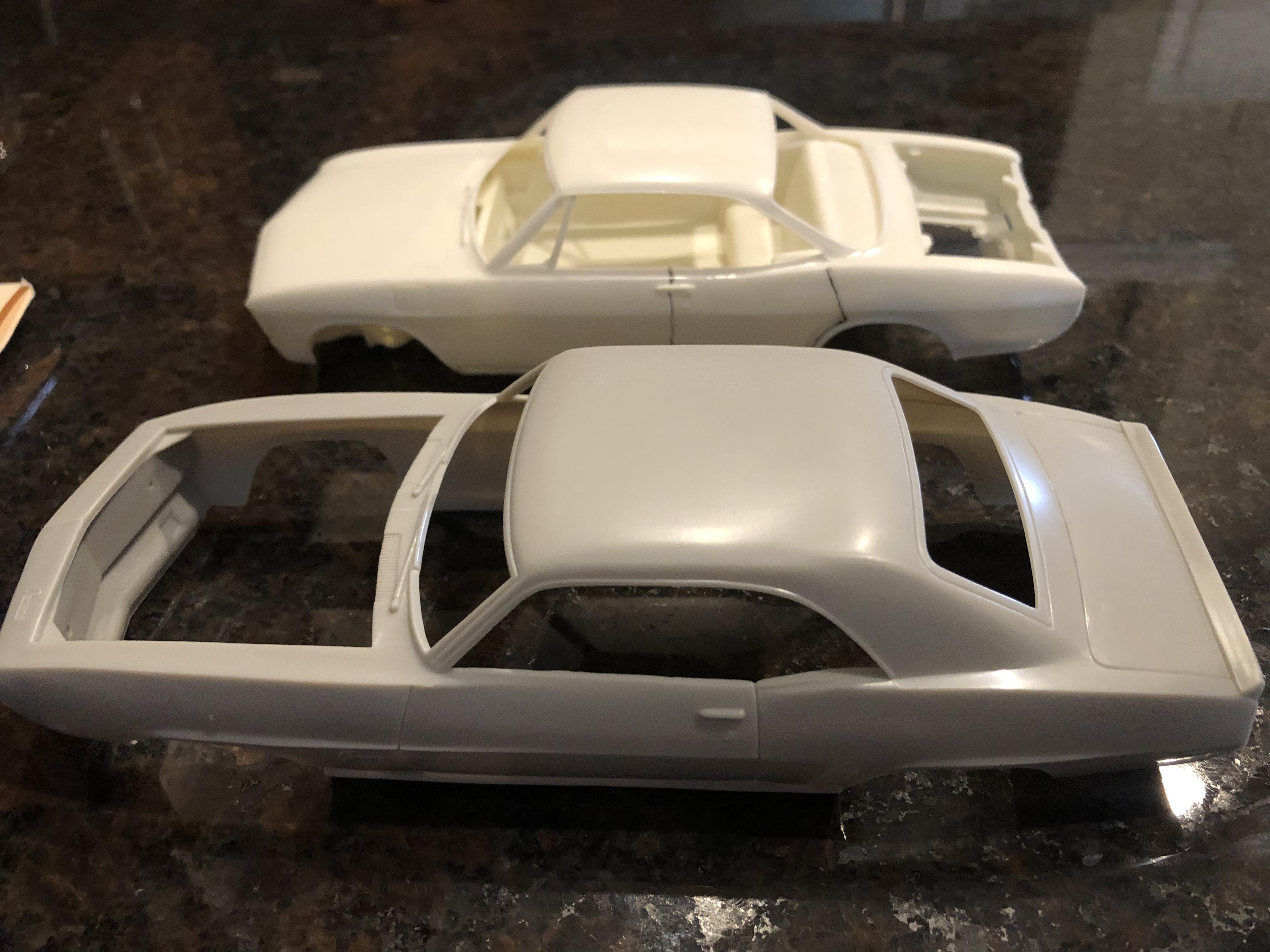

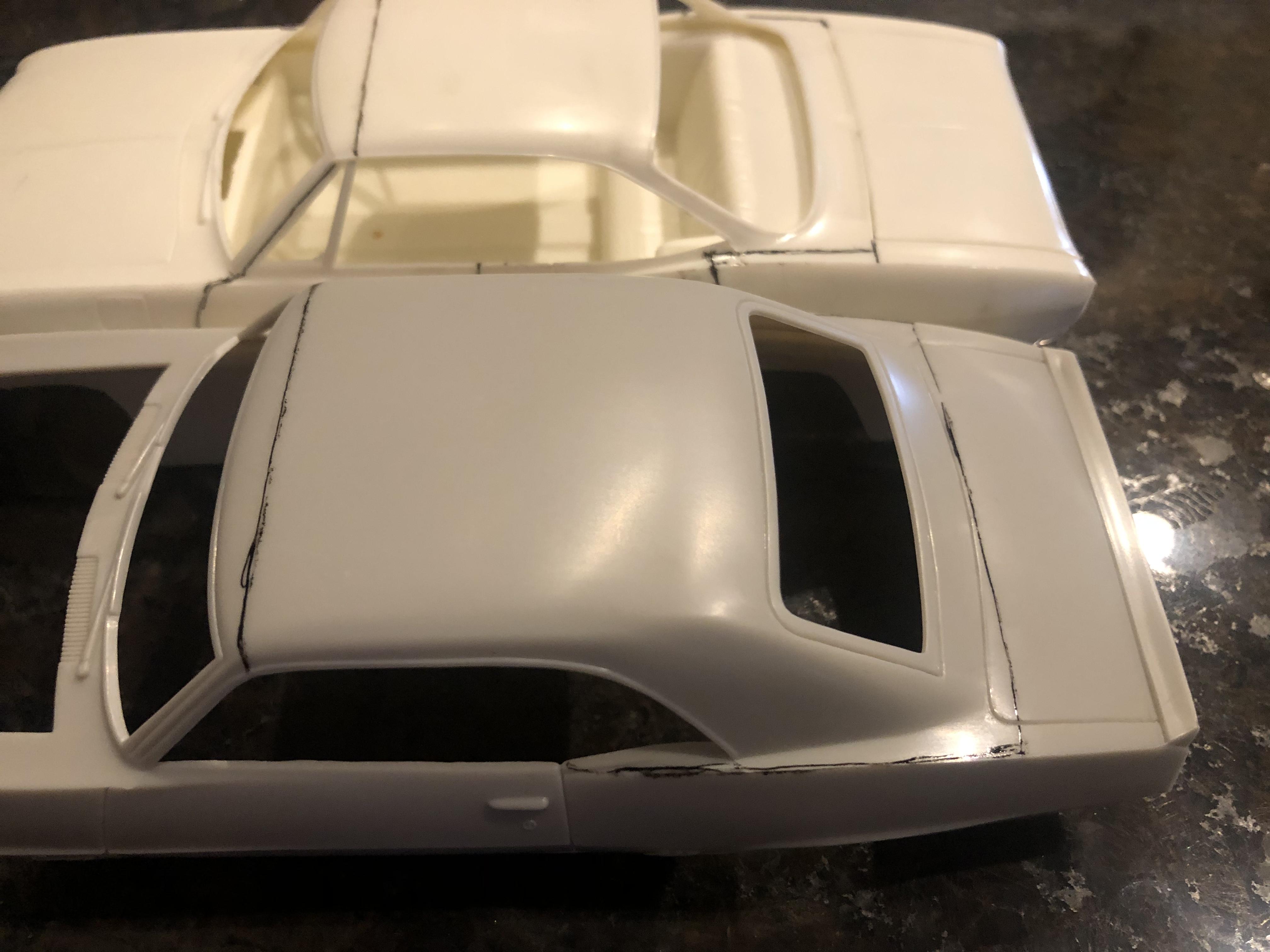

gbtr6 Posted September 18, 2022 Author Posted September 18, 2022 Couple of additional pictures. Seems to line up well. Camaro roof has a slope down on the sides to the rain gutters. The Corvair top is fairly flat to the gutters. I need to save and graft the pane l under the backlight into the Camaro top. Perry

RomanII Posted September 19, 2022 Posted September 19, 2022 I would suggest keeping much more of the Corvair roof. Move the cut line back to about where you are relocating the trailing edge of the front door. If you cut as close to the windshield as marked, the A-pillars are going to be very weak. 1
espo Posted September 19, 2022 Posted September 19, 2022 I agree with Romanll, saving as much of the Corvair roof as possible especially with the different crown in the Camaro roof. Do you have any pictures of your old car or a 4 door Corvair tro use as a guide?

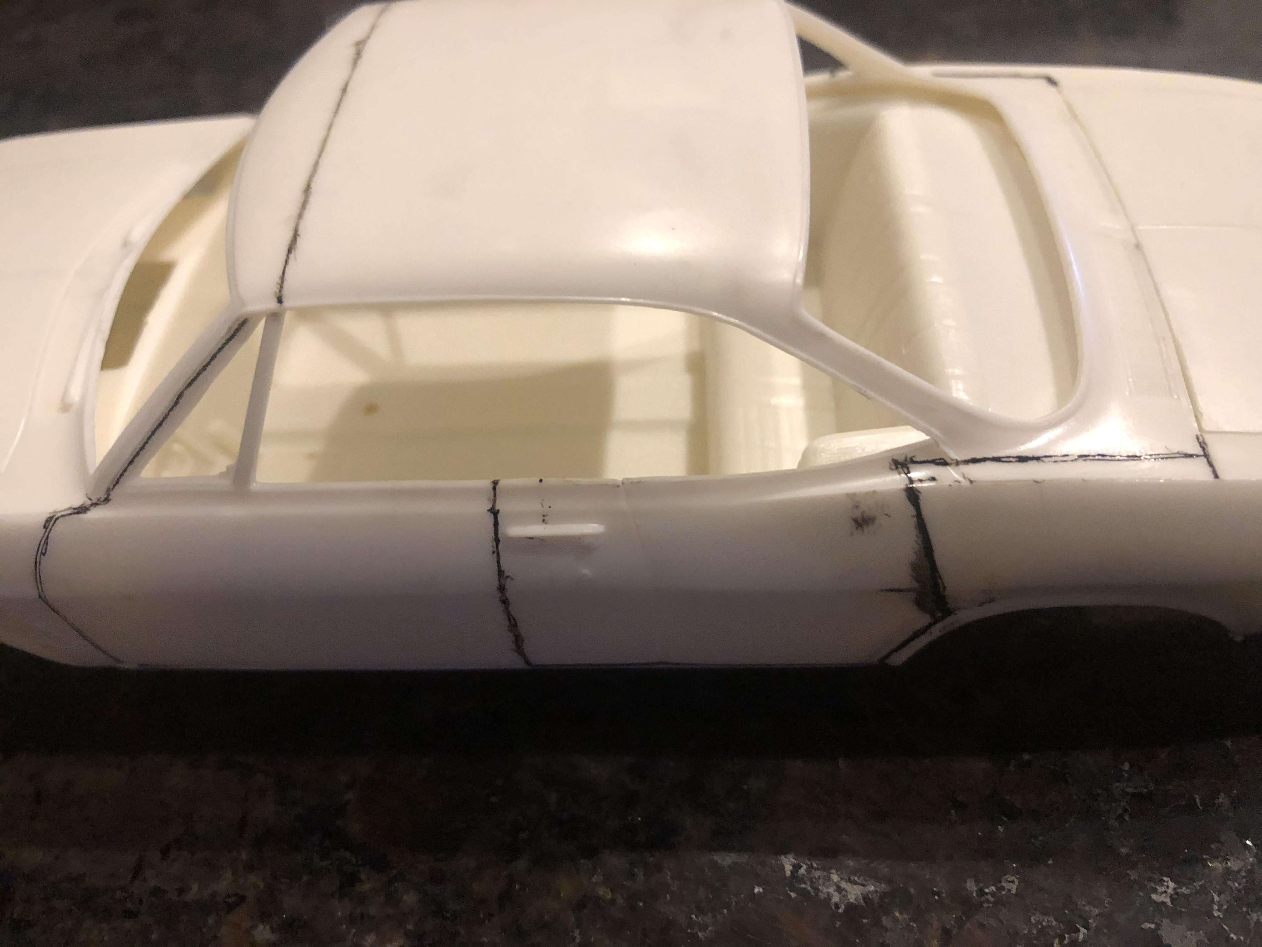

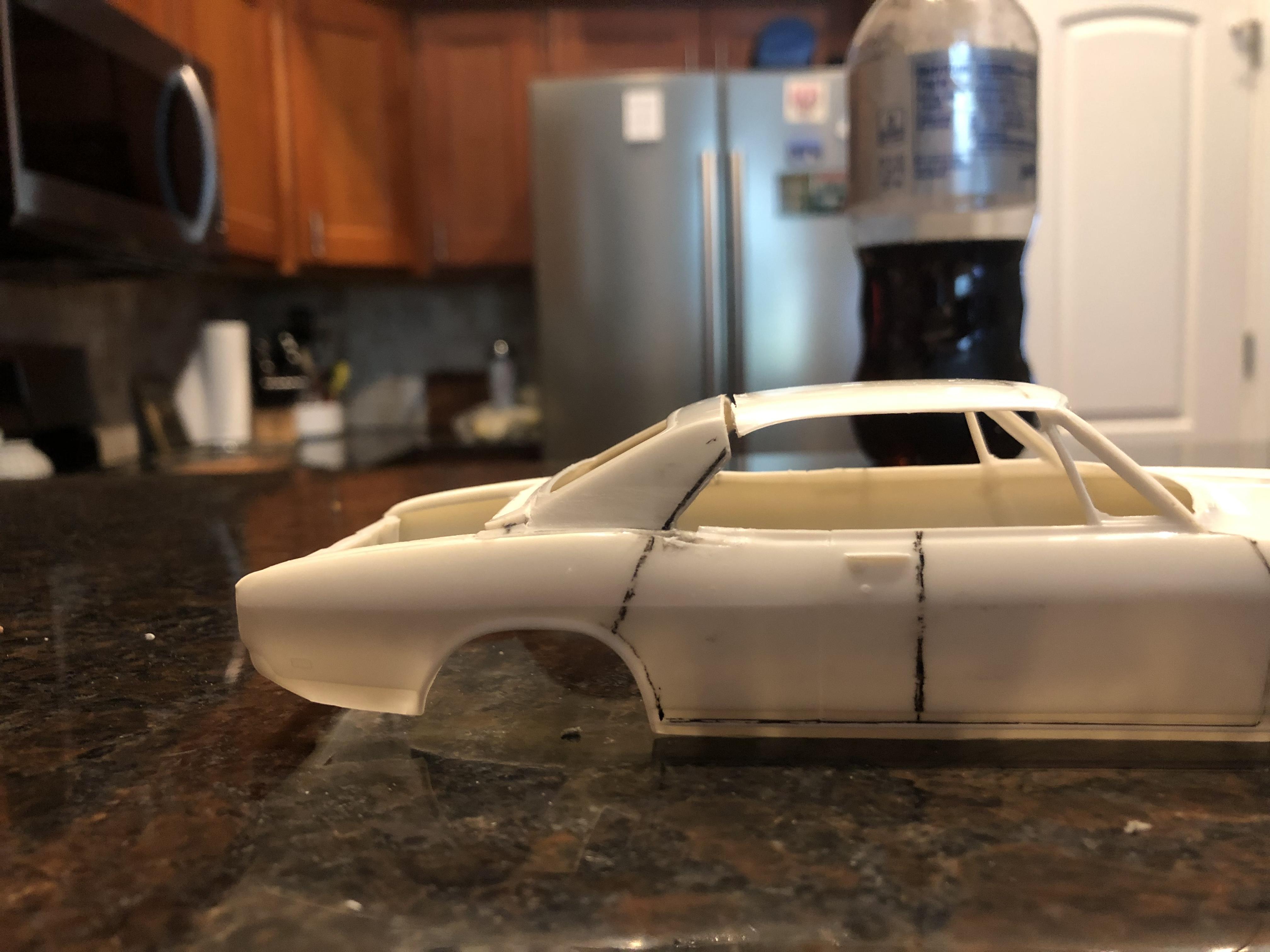

gbtr6 Posted September 21, 2022 Author Posted September 21, 2022 Performed surgery. Patient looks good. The fit should be good, but the Camaro top is just a little wider. May have to cut down the center and narrow it. Need to flatten the back by the hood in back and graft in the louvered panel from the Corvair. Doesn’t fit too bad. Will keep most of the Corvair top and trim the Camaro top just ahead of the C pillars. Perry
espo Posted September 21, 2022 Posted September 21, 2022 A suggestion on a reference picture for your sedan roof. Just looked at some pictures in the reference section on the forum. Howard Cohan has posted some pictures from Watkins Glen NY. On page 15 of his Watkins Glen photos there is a couple of good pictures of a Corvair sedan. Hope that may help.
gbtr6 Posted September 21, 2022 Author Posted September 21, 2022 Thanks Dave. Yes, any reference is good. i think I'll have to make the back window bigger too. Perry

gbtr6 Posted September 23, 2022 Author Posted September 23, 2022 More progress on the Corvair. Now I have to figure out how to glue it together. What do you guys use, and what technique do you use? Perry

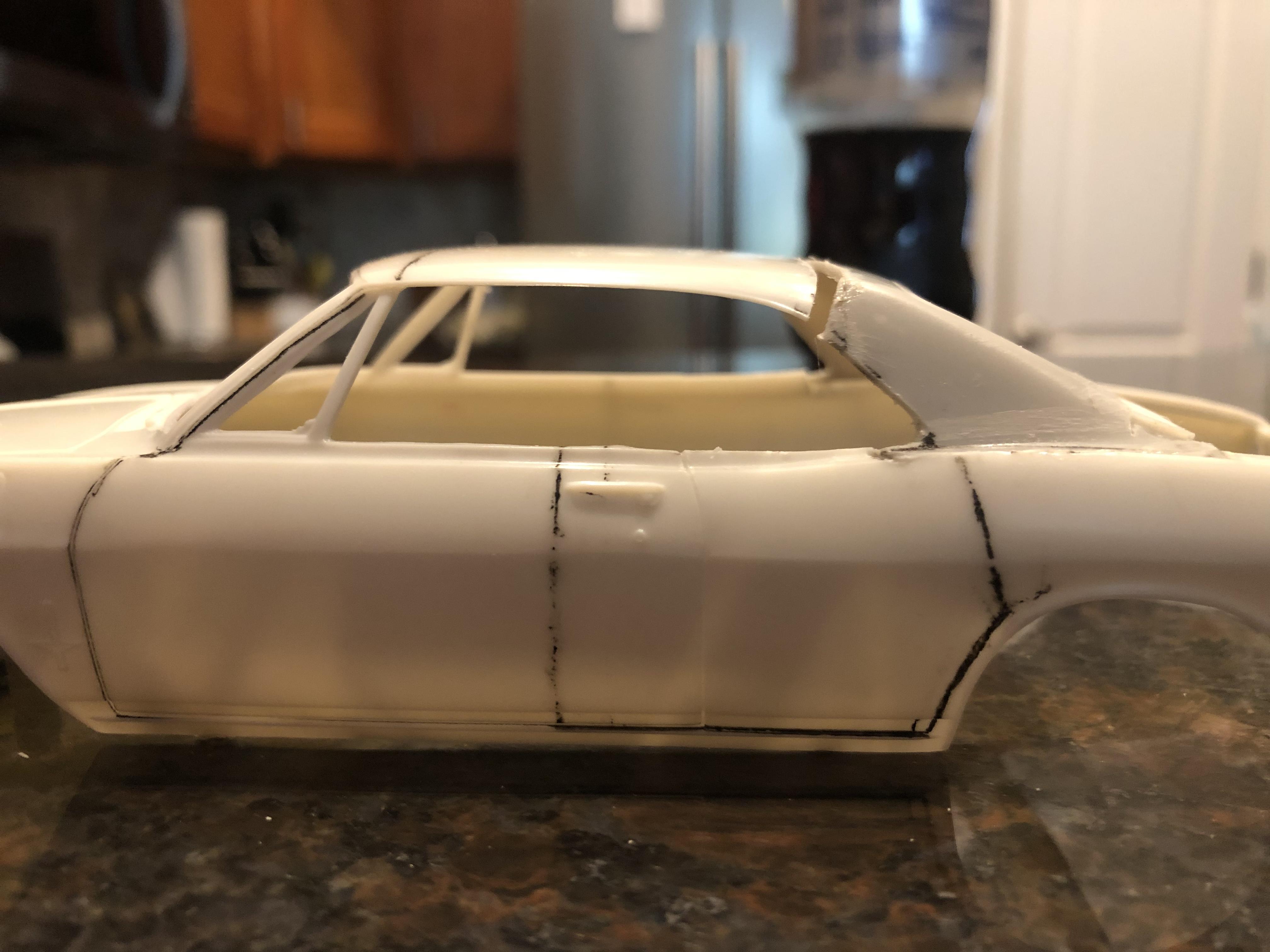

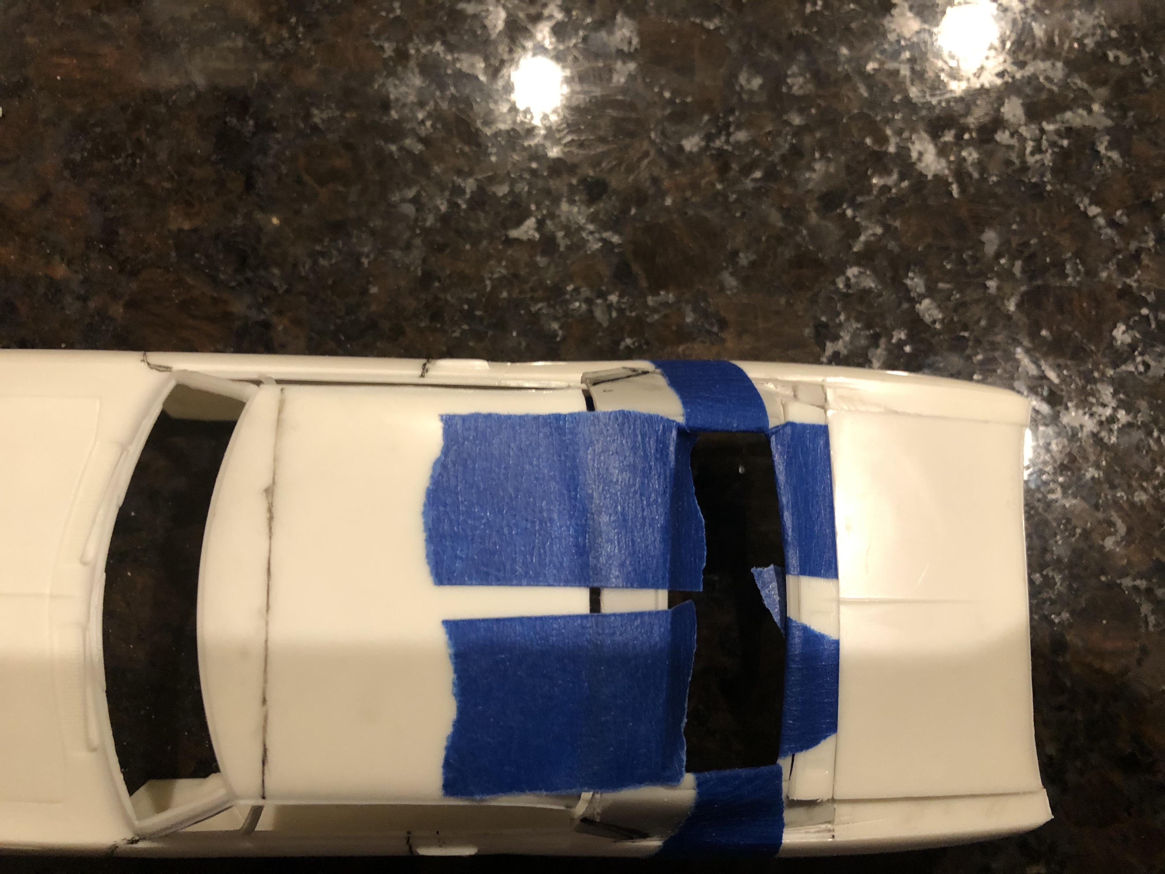

gbtr6 Posted September 25, 2022 Author Posted September 25, 2022 Using Testors solvent, I glued the top on. It lines up well in back and the sides, but I’ve come up short mating it to the Corvair roof. I plan on putting a thin strip of Evergreen inside the roof across the top. Then, fill in the gap. Not sure if I can fill it with some strips of Evergreen and use solvent. Any suggestions? Perry 1
Mattilacken Posted September 26, 2022 Posted September 26, 2022 Nice! Cool idea and it will look good when done! I would say, as you do, that such a big gap need to be filled with styrene. A idea would be to try the wood burner method, since they are low temp you can solder plastics with it. 2
stitchdup Posted September 26, 2022 Posted September 26, 2022 I would try using a piece from the leftover corvair roof parts. Its already the shape you need to fit the roof. 1
gbtr6 Posted September 27, 2022 Author Posted September 27, 2022 Good idea, but when I put a strip on the under side, the gap is just right to fill with a strip of Evergreen. Almost done with the filling and then will put some putty on. Perry
gbtr6 Posted September 28, 2022 Author Posted September 28, 2022 Made progress filling in. Almost ready for putty. Need to add rain gutter and clean up a bit. Perry 3

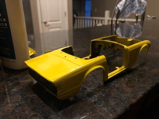

gbtr6 Posted November 9, 2022 Author Posted November 9, 2022 Got some color on it. Will clear over the weekend. Color represents Madeira Maroon. Will have a Fawn interior. Also working on my TR6. Is a diecast, making it into my 1:1 car. Perry 1
