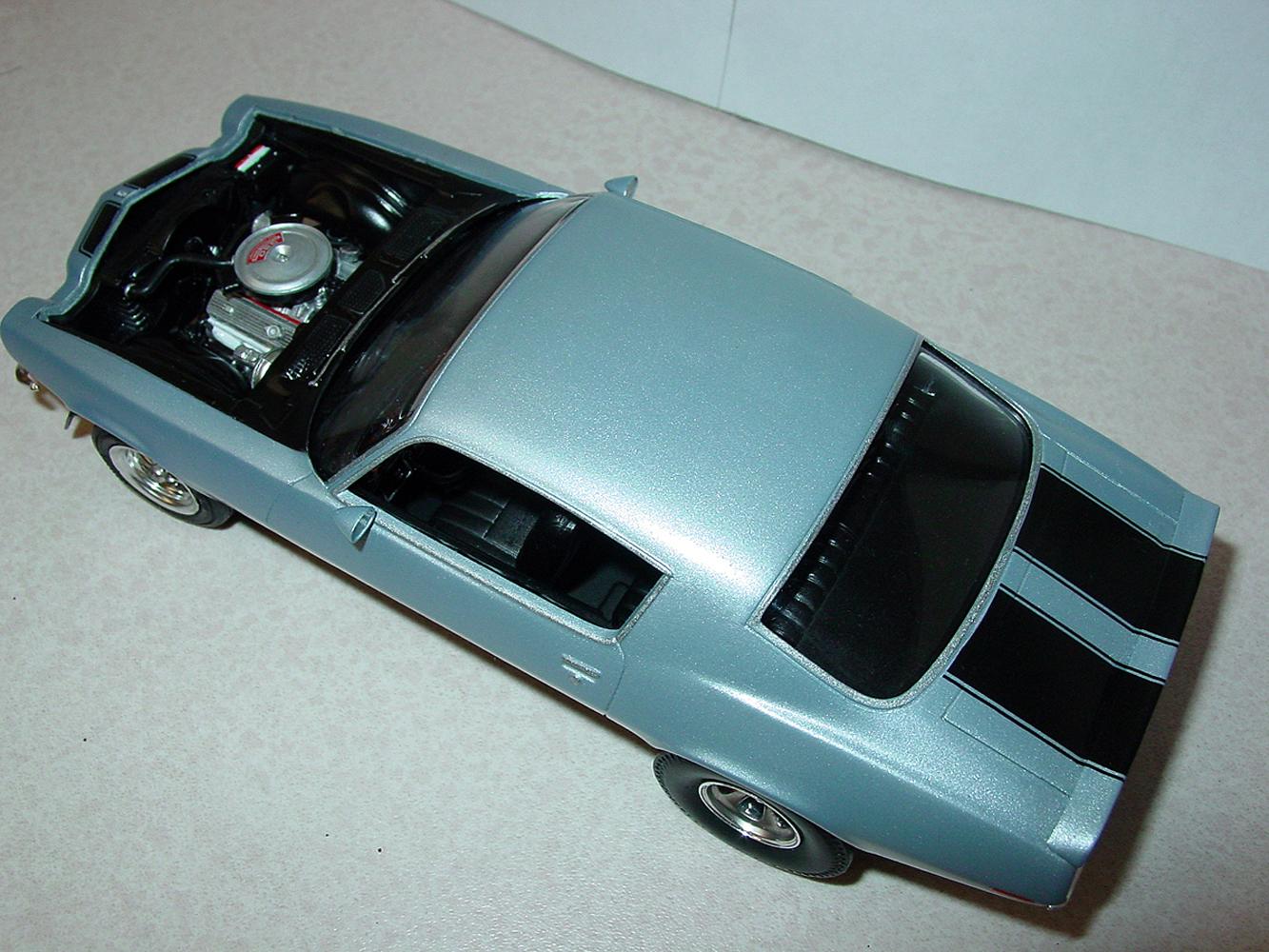

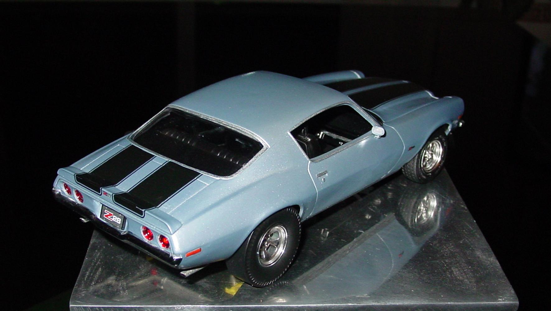

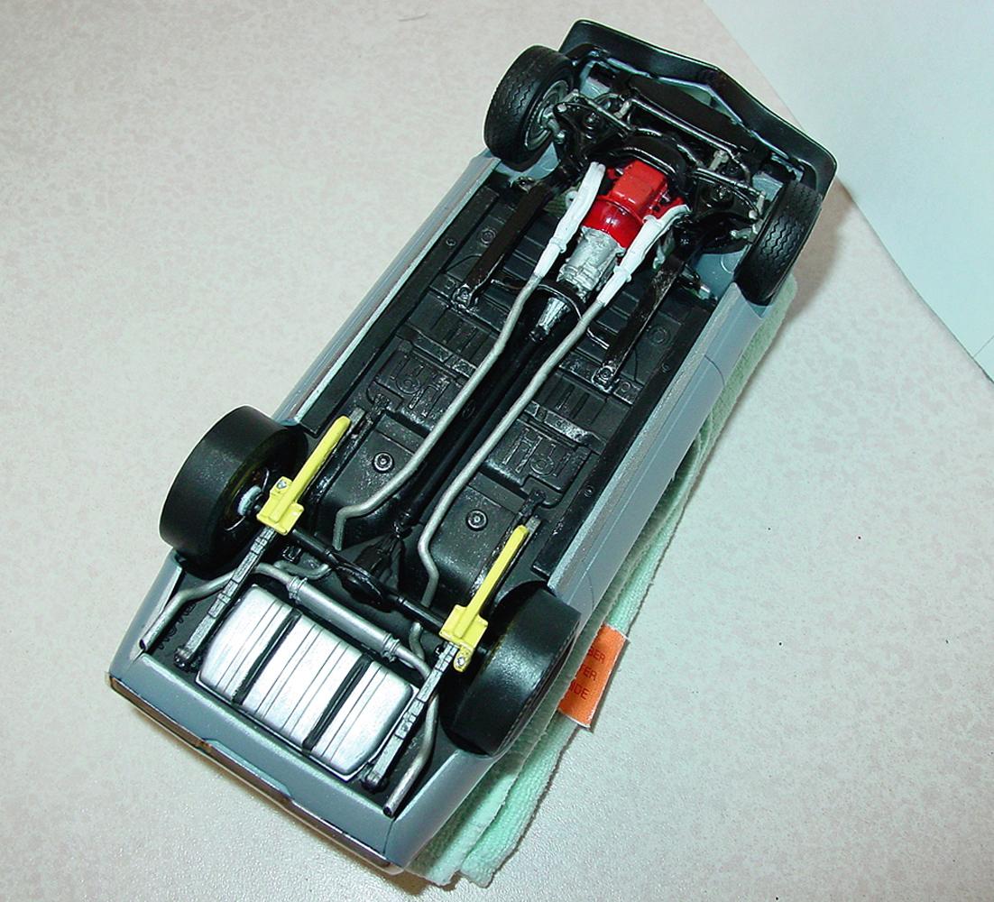

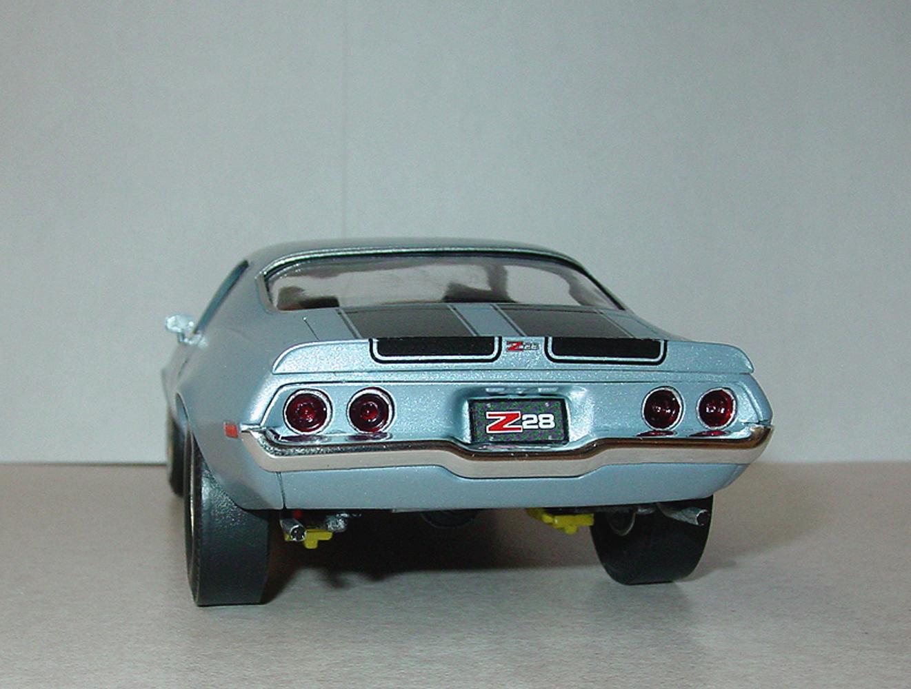

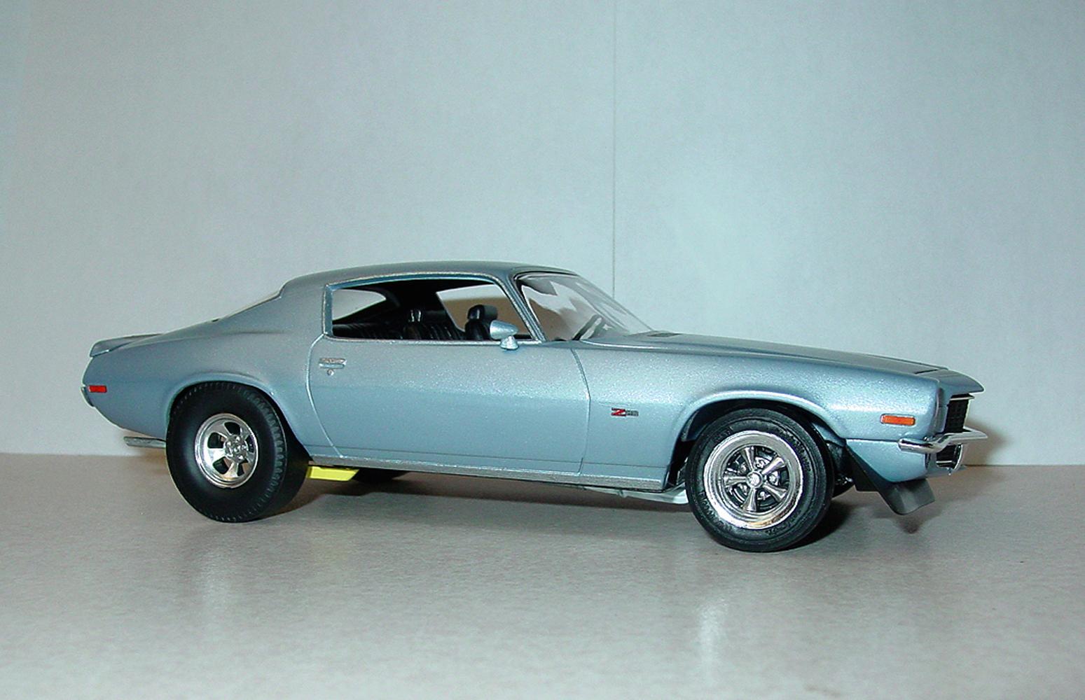

DanL Posted October 10, 2022 Posted October 10, 2022 Used the AMT full bumper 1970 1/2 Z-28 to replicate the car I owned in the early 70's. I replaced the standard LT-1 exhaust manifolds with headers from the AMT Baldwin Camaro and also used the yellow traction bars. The rear street slicks and slotted mags came from the Moebius Chevy II gasser. I had the car repainted in 1974 in Volkswagen Silver Blue so I used Tamiya TS-58 Pearl light blue on a silver base coat to try and replicate the shade. It's close but not perfect. I managed to lower the front by 2 mm and raise the rear about the same to get a 70's stance to it. 9

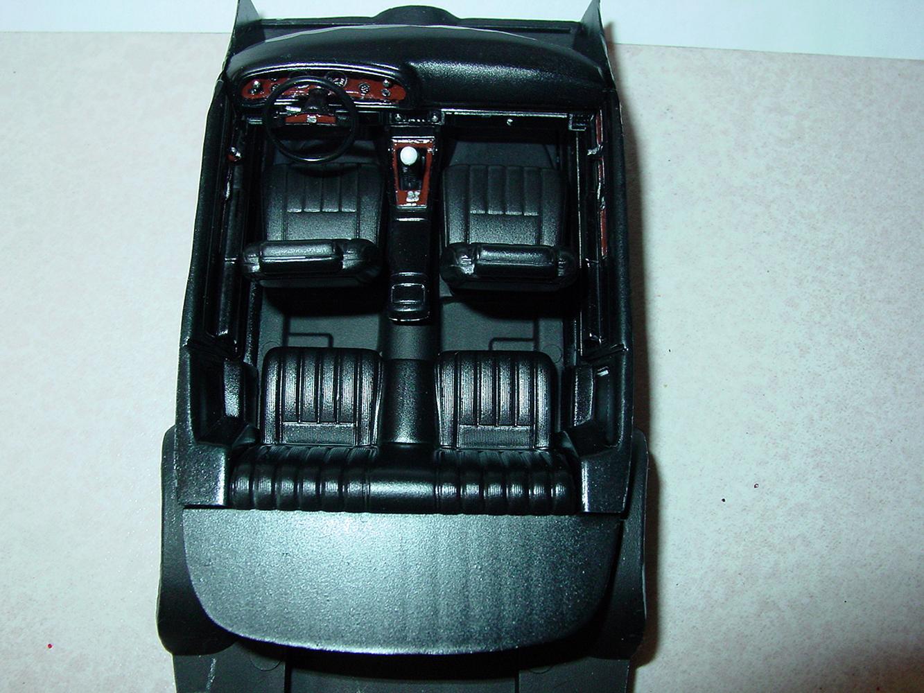

espo Posted October 10, 2022 Posted October 10, 2022 I like the look of the soft blue color and the finish looks great. Always thought the lower rear spoiler looked better on the second gen Camaros. The interior is very realistic looking with the way the dash is trimmed.

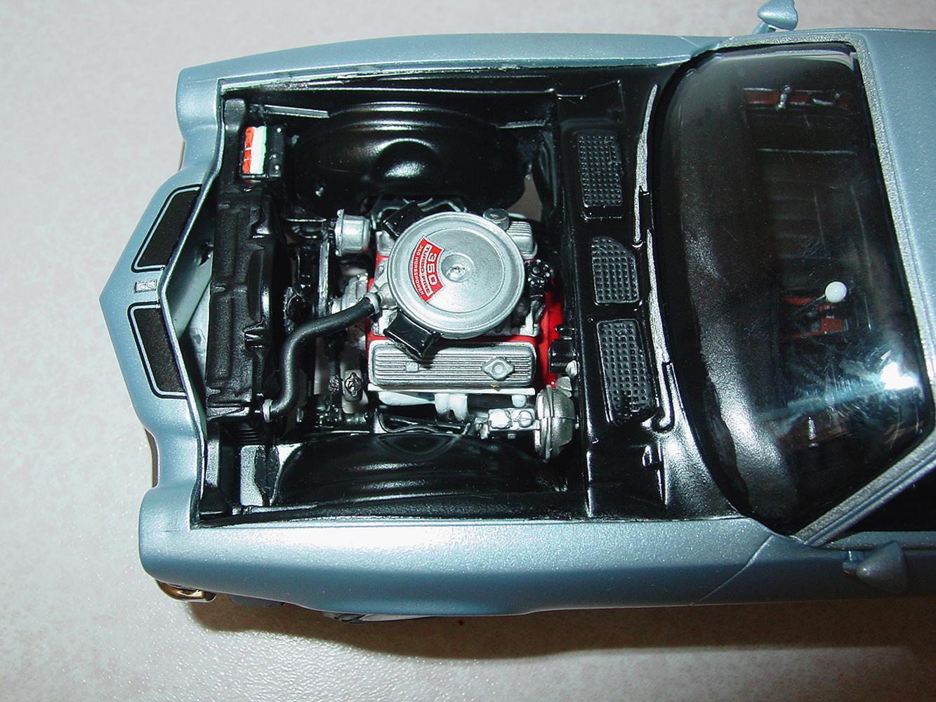

DanL Posted October 10, 2022 Author Posted October 10, 2022 For those of you considering building this AMT kit. It is not a properly designed kit... it does not go together well. The initial build up , painting and detail goes OK but when you attempt to fit it all together the pins don't fit the holes and the worst is the dash, windshield and windshield surround all want to occupy the same space. This is not a simple fix either. It requires major modifications to get it even close to fitting. Of course you have to do all this modification with painted and detailed pieces which just destroys them. It fought me to the very end, even the rear license plate holder didn't fit. Two bits of advice... Lower the entire dash in the interior tub before you start cutting the windshield and secondly, do not attach the two pieces of the chassis together until the very end. This is the first AMT kit I have built and it probably will be the last one, but I really did want to build the old Z-28. Here's a few more pictures.... 3

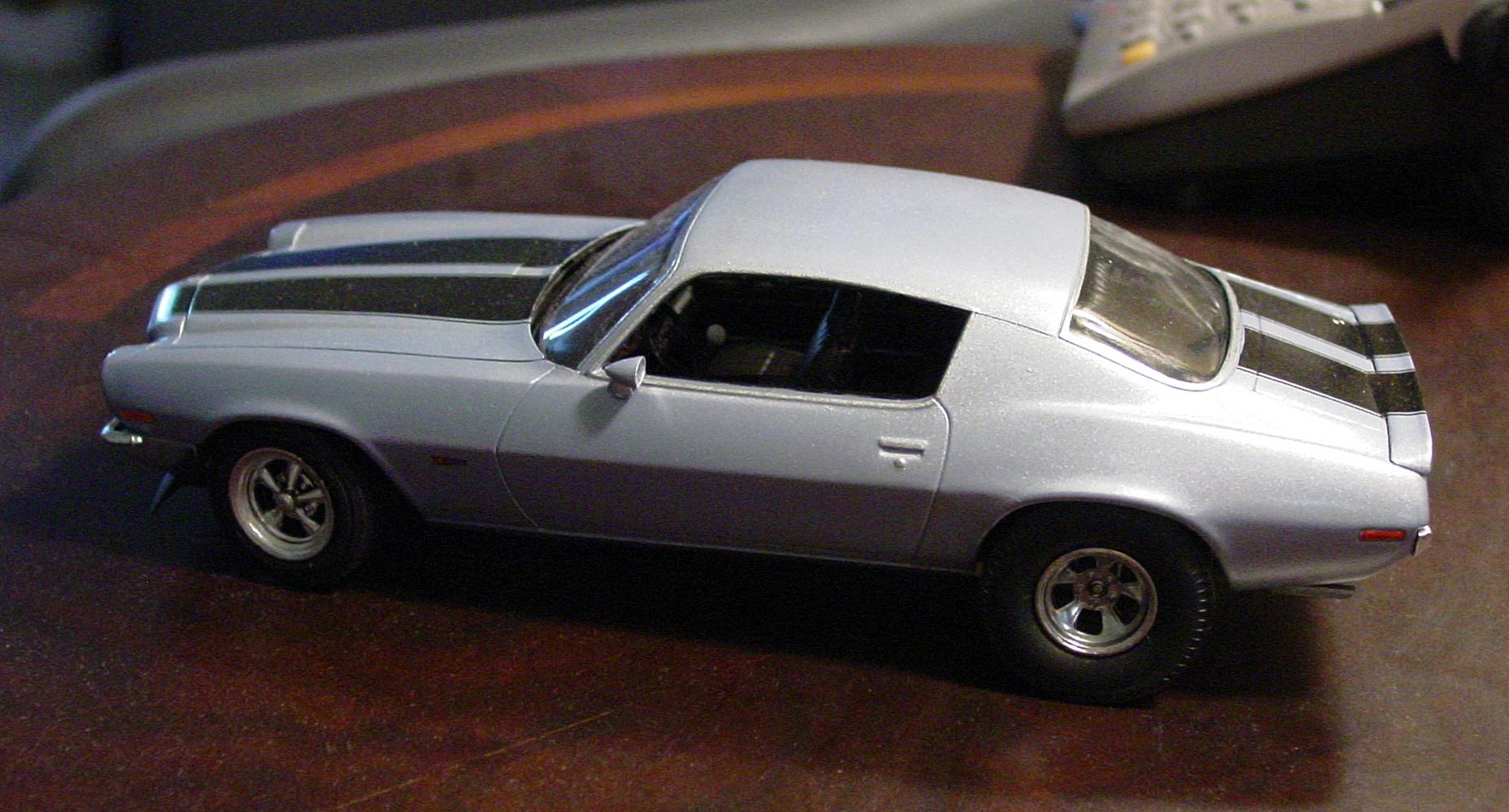

DanL Posted October 21, 2022 Author Posted October 21, 2022 19701/2 Z-28's seem to be quite popular... so I added a few more pics of my recent build. It does bring back fond memories of my old street car Cheers DanL
