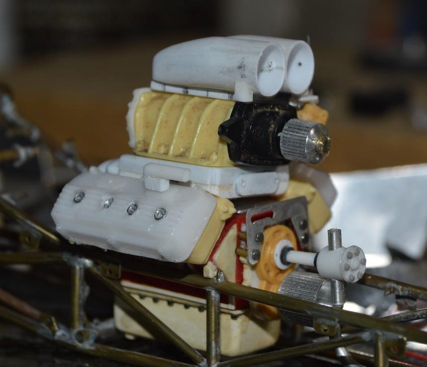

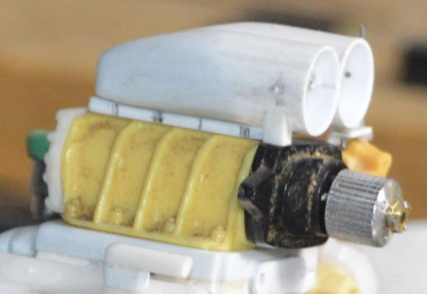

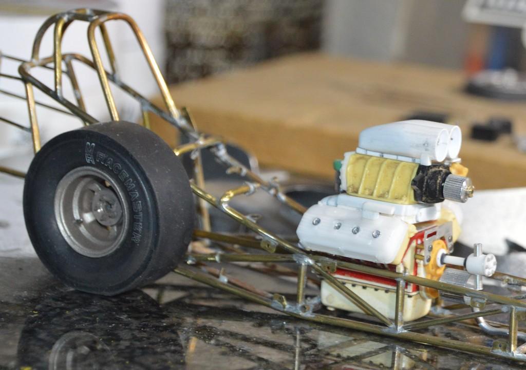

More work on the blower drive...I made the pulley for the blower, along with the starter dog. I also made an idler pulley. The belt will be 3.25", which matches the one on the wall in my shop. I made the fittings for the puke hoses. I do believe I can live with this!?

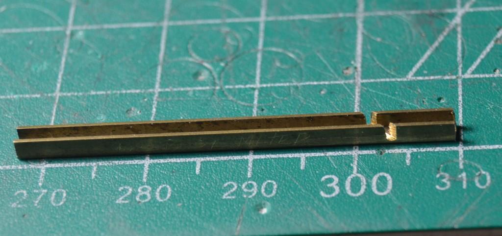

Marcos, I've attached a photo of a tiny, 45-degree miter box I made from brass channel. I just tape a stop into it, so that my cuts are all the same length, and cut the material with a scalpel. Using the lathe, and carbide PC board bits, I bore .020" through .030" plastic rod to use for boots. Before I had the lathe, I used wire insulation, cut and superglued together. Gluing on wax paper helps release the boots. If it's cheapo wax paper, rub a little beeswax on it.

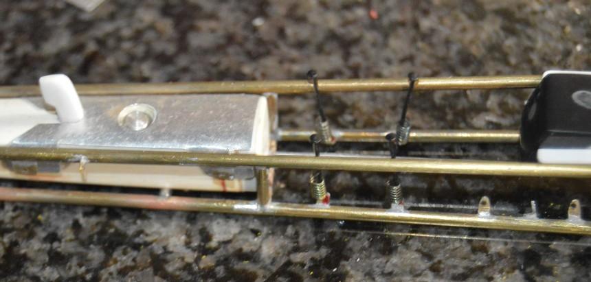

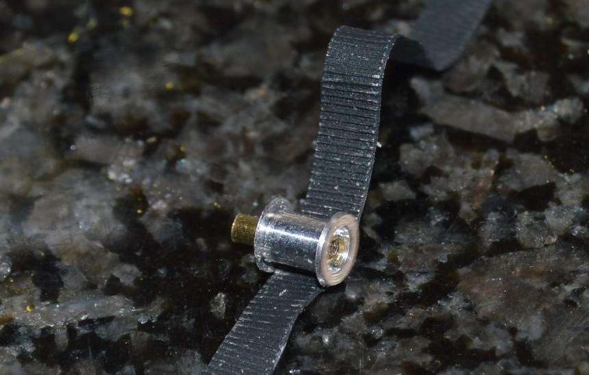

I got some .2 mm thick lead foil, to try for the blower belt. It's a little thicker, and, maybe a little softer. It took to the embossing...well...like a boss!? I've been fitting the 'chutes to the tail section. They're pretty close, now. I've fed the actuator cables just for effect. I cut and gathered the shroud lines. I need to cut off the "push bar" and make the bracket that mounts the shroud lines. That will attach to the newly-shortened bar. As always, questions, comments and critiques are always welcomed. Thanks for looking!

Thanks, my friend! I've tried so many things for blower belts, over the years. Textured ribbon, masking tape with individual teeth of plastic strip...nothing ever looked right. This is small enough, and the teeth match! It should look great, once it's painted and installed!

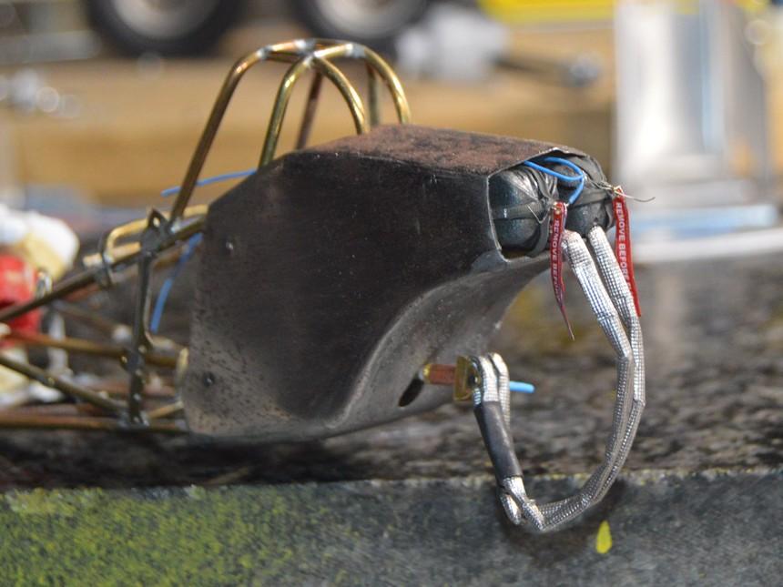

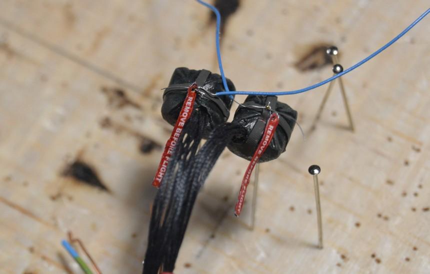

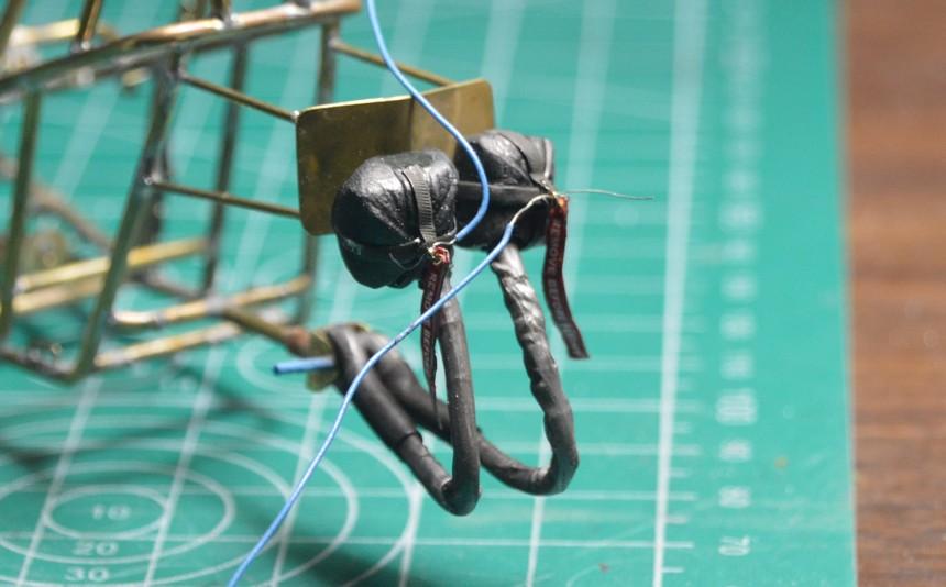

I got the chute packs done. I have a little bit of weathering to do. I want to get photos of them, in the car, but I need the paint to cure out, a bit. The chutes came from a Swamp Rat XXX kit. I used a needle, to hold the tags, and release cable. I made the straps on them with wine bottle foil that I laid atop my anvil, then laid a fine, straight mini file on top of that, and tapped it with a rubber mallet, to create a woven texture. The "Remove Before Flight" tags are decals I printed that I applied to wine bottle foil. That allows it to be posed to look more natural. The chute release cables are old MSC blue plug wire. As always, your questions, comments and critiques are welcomed. Thanks for looking!

Thanks again, Francis. I decided to change the shroud/canopy lines with a casing, which is more correct. I used the foil from a cigarette package, and rolled it, and worked it until I got it roughly to shape. Then, I shot it with matte clear coat. Once that had set for a few minutes, I dusted it with pastels. I think it looks much better!

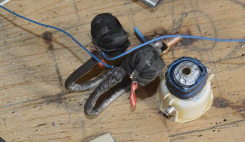

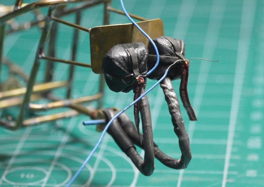

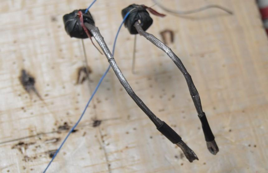

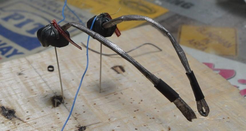

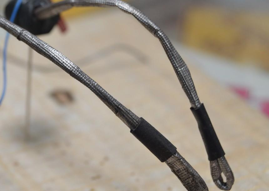

I've been working and reworking a couple of things. I think I have finally decided on the sheathing for the parachute cords: I made a new set using cheap duct tape, rolled around a length of wire. The wire makes it more poseable, and the color is good. The paper lining from a cigarette pack looked nice, but, was simply too fragile.

Here are a couple of photos that better illustrate the new 'chute line sheathing. While I did like the look of the embossed paper (while I used the liner of a cigarette package, very similarly textured foiled paper is available by the roll at craft stores), I just didn't feel like it would be anywhere near durable enough for a creation that I hope will be around for longer than I! In that light, I just kind of kept thinking about what other material might work. I bought a roll of the cheapest "Duck" brand tape Walmart had, to experiment with. It's very thin, and flexible, thus was easily rolled around the wire core (insulated, single-strand copper, I'm guessing around 24-26ga.). When I wrapped the wire, I left one end of the tape "long", so that the end of the sheath would be sans wire. That made it easier to loop the end, and still have it fit into the heat-shrink I used as a collar. It also facilitated the canopy lines fitting through the mounting bracket. Once the sheaths were made, I brushed them with an acrylic matte clear. They were then dusted with pastels. Finally, I set the pastels with some good-old cheapo Aqua Net hair spray! Thank you all for your comments, and for looking in!

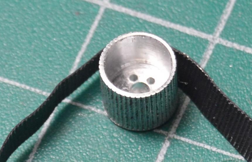

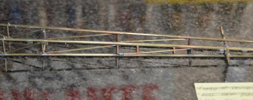

The knurls have been handy, lately! I used them on some 3/32" aluminum tubing, to make a pair of breathers for the puke tank. I punched the tops from tooling aluminum, and used a straight punch to roll/fold the edges. I also ruined a Sticky Notes pad, in the process--but it worked! I will polish those with a 4-way polishing stick. I also added two pairs of side frame diagonals. I still need to clean those up. Thanks for looking!
