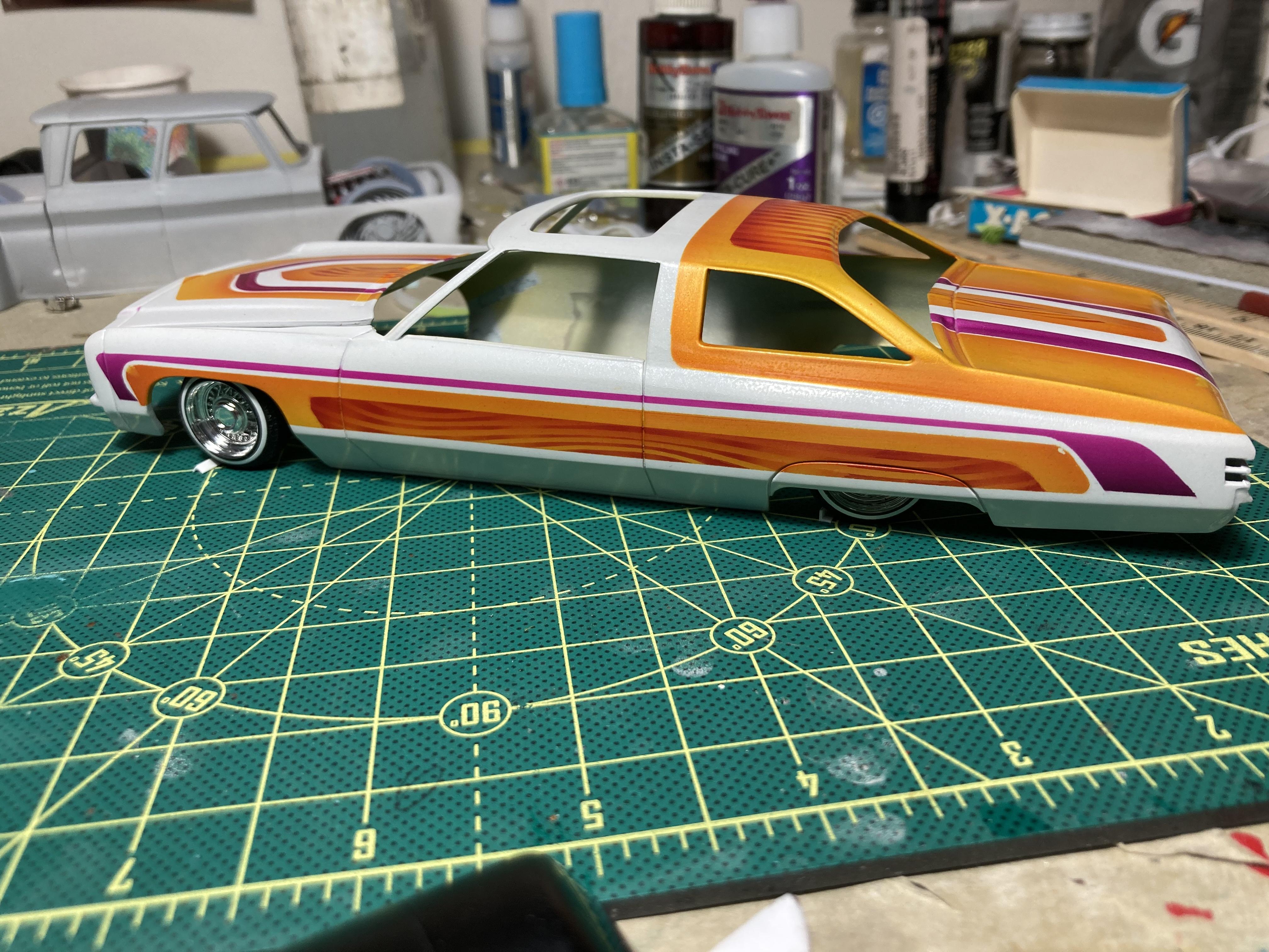

gseeds Posted December 8, 2022 Posted December 8, 2022 You learn something new every day, for years I've been stripping paint off my models with easy off, break fluid, and even purple power, a couple weeks ago I painted this 76 caprice with automotive paint, pearl white base, topped with a 2K clear, sanded it with 800 grit sand paper, then useing houses of kolor added multi candys , it looked fairly good, to finish it off I added candy blue and re cleared it , and right away I hated it !! So after a couple days walking around it , off to the strip tank it went , My buddy Tim told that rubbing alcohol would strip it, I didn't believe it but tried it anyway and sure enough after a week of sitting in the tank it with only rubbing alcohol it stripped it all the way down to the primer ! I had no idea, not sure if it will work on all paints buy it worked on automotive paint and 2K clear .
