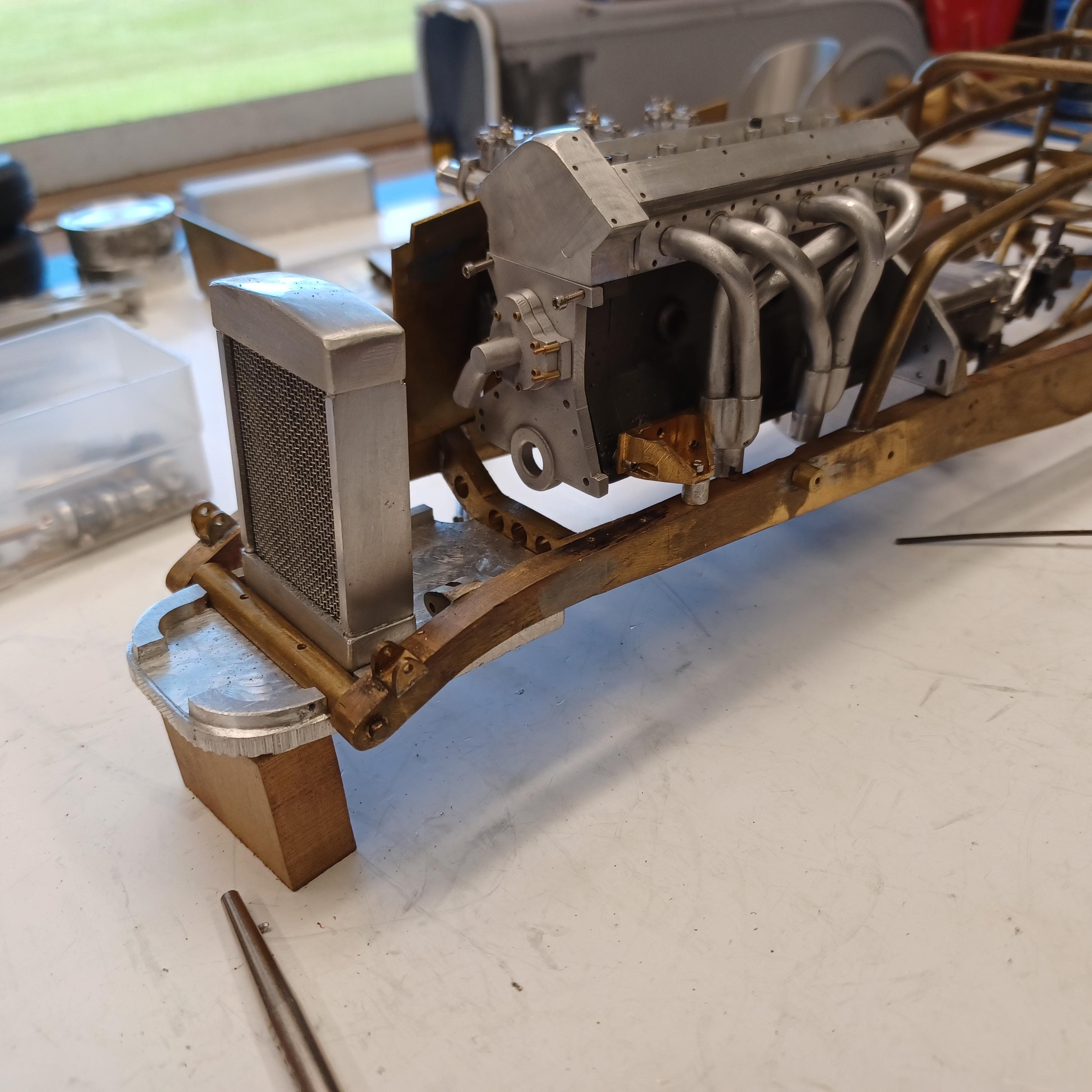

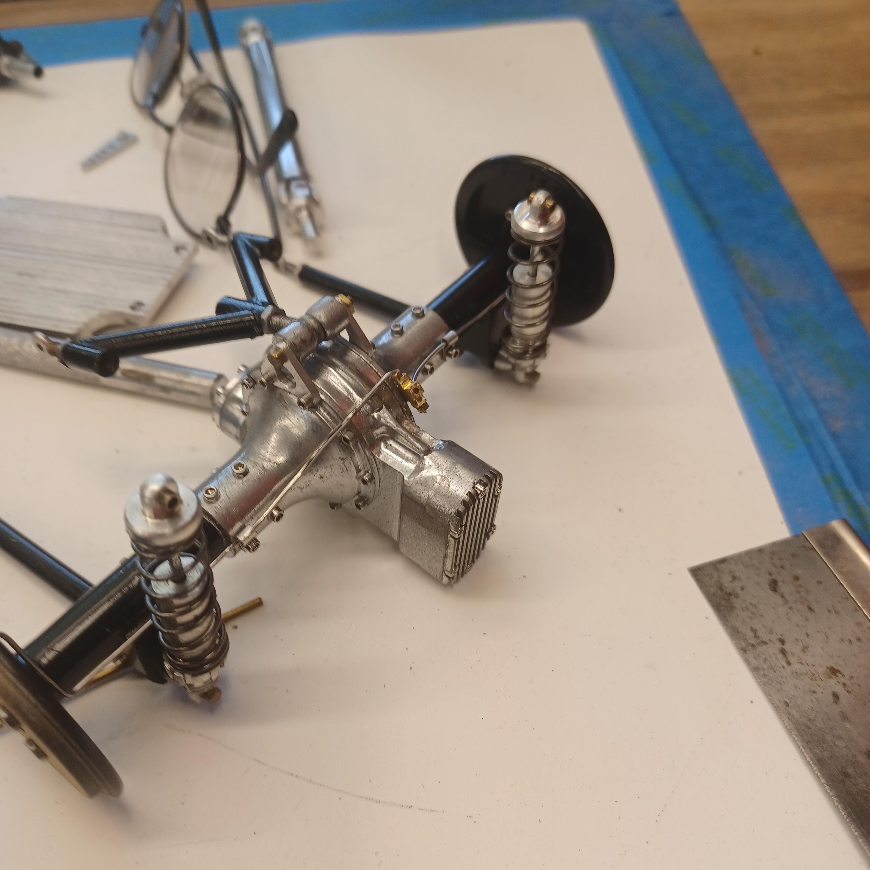

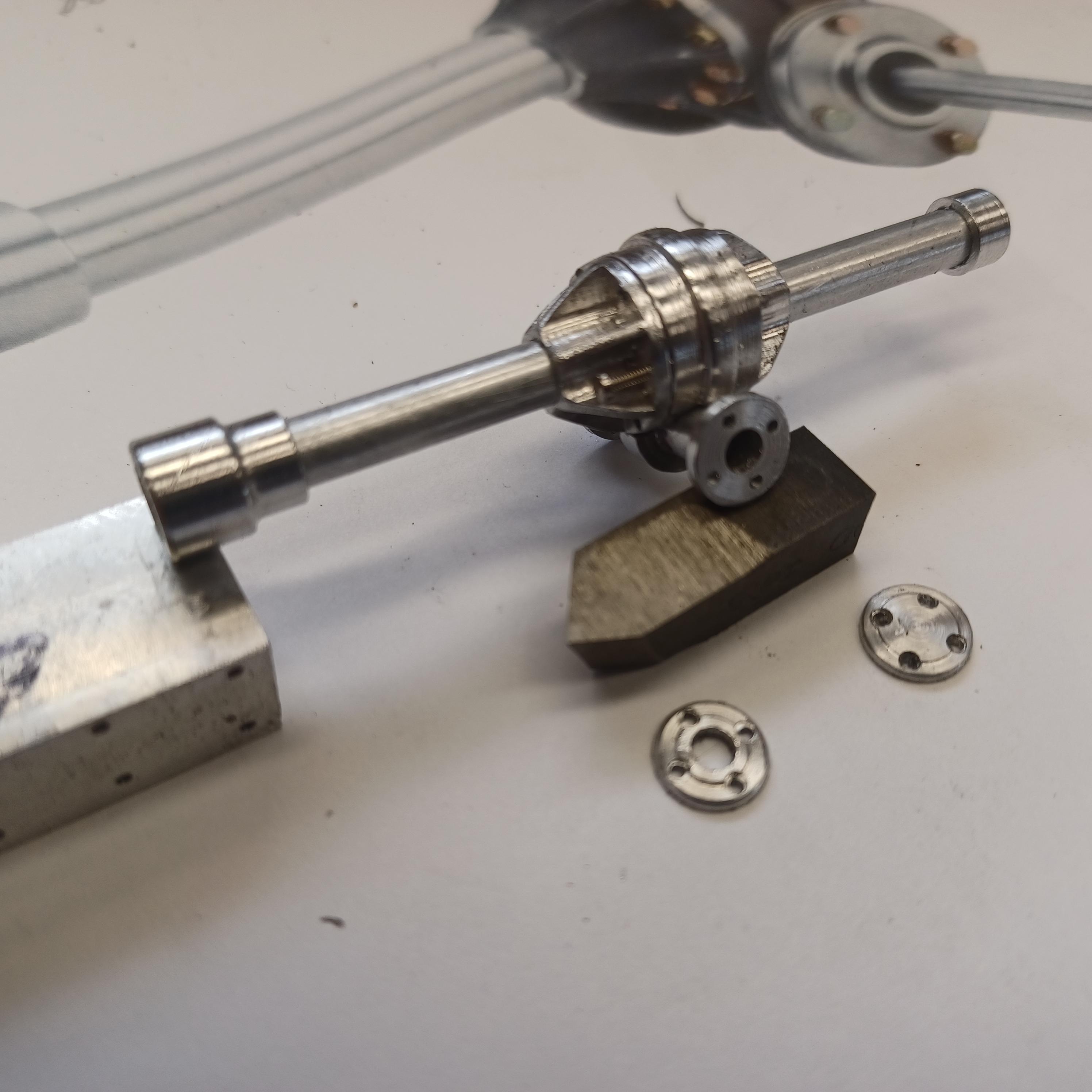

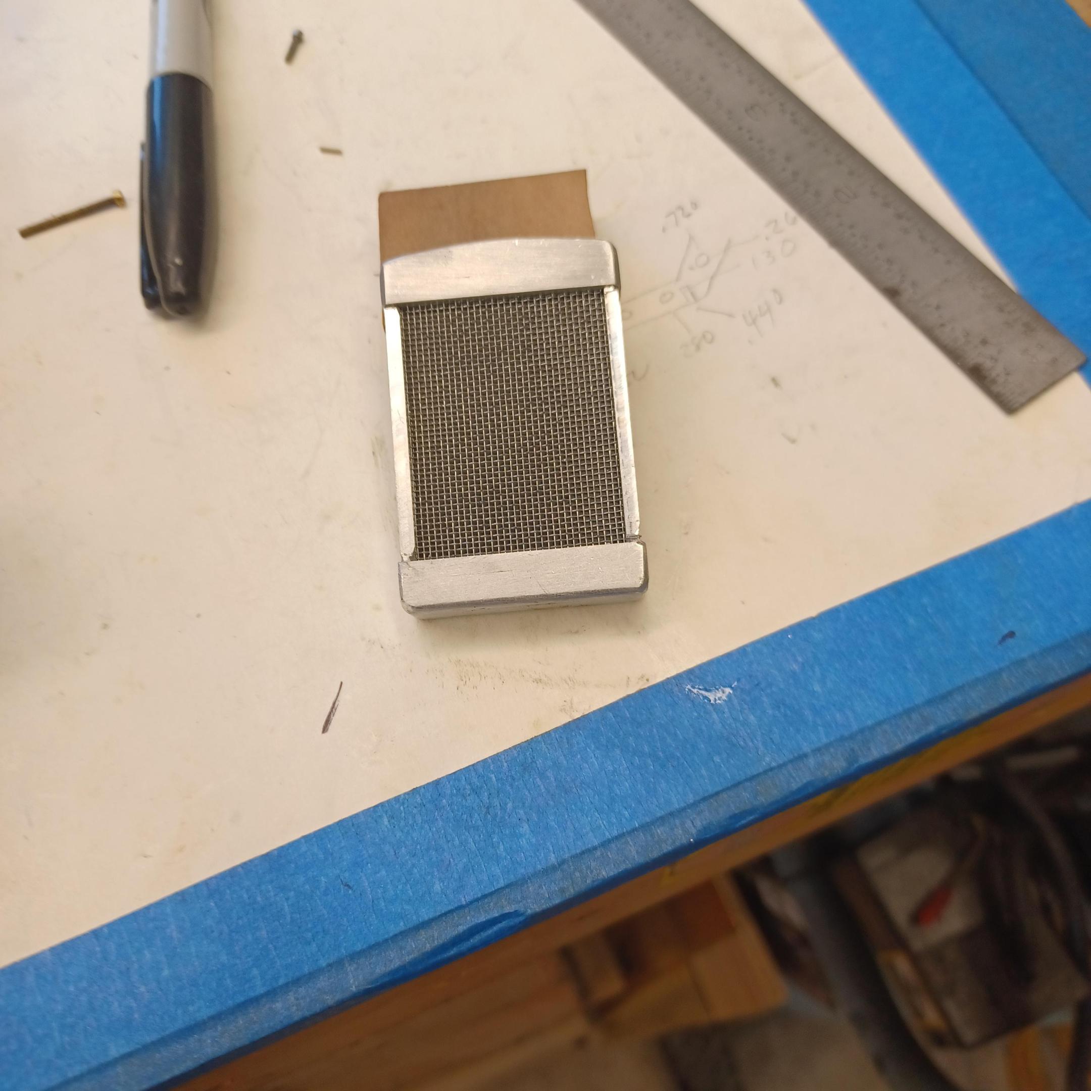

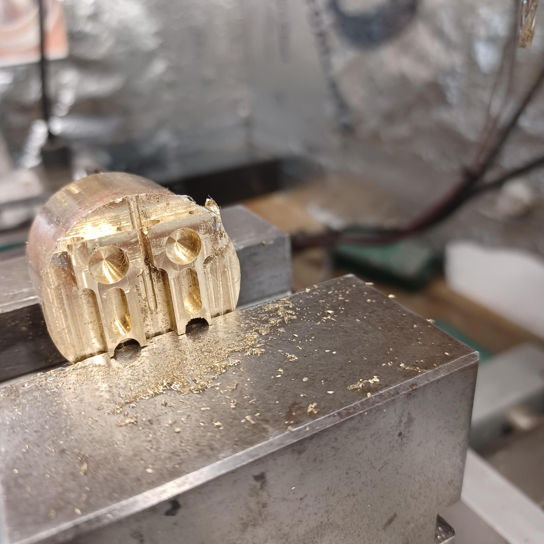

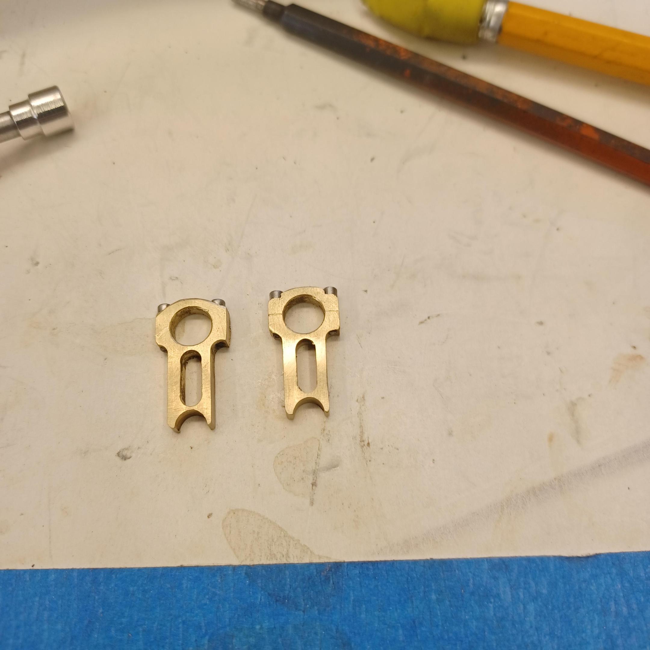

first time back. i have still been working on my project. i think i have my computer back to normal. we will find out, if i can include pictures. it worked ! ok, this is the center steer box. i have used it on several 1 to 1 cars. very common in sprint cars. the 2 brass pcs. are the mounts for it. just got started on the radiator.  i have been working on the rear floor pans. not quite done yet.glad this is working again. i know nothing about computers. if they don't do what they are suppose to do i am lost20230422_091456.thumb.jpg.57e68a0181abbfd10cf905cec406f749.jpg

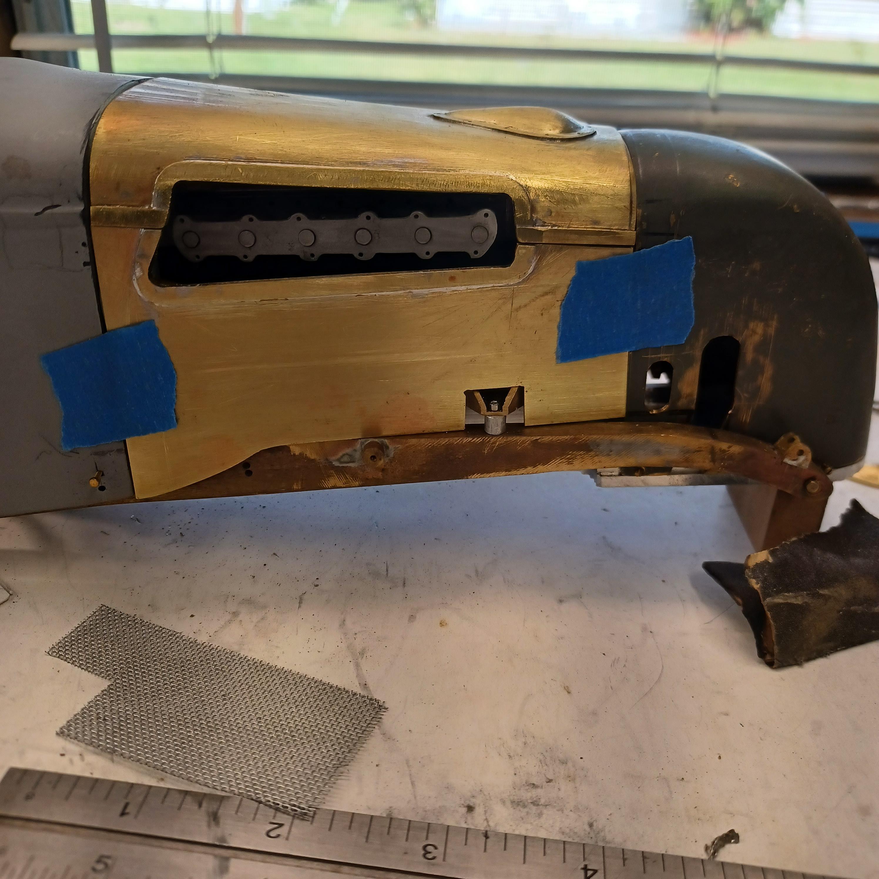

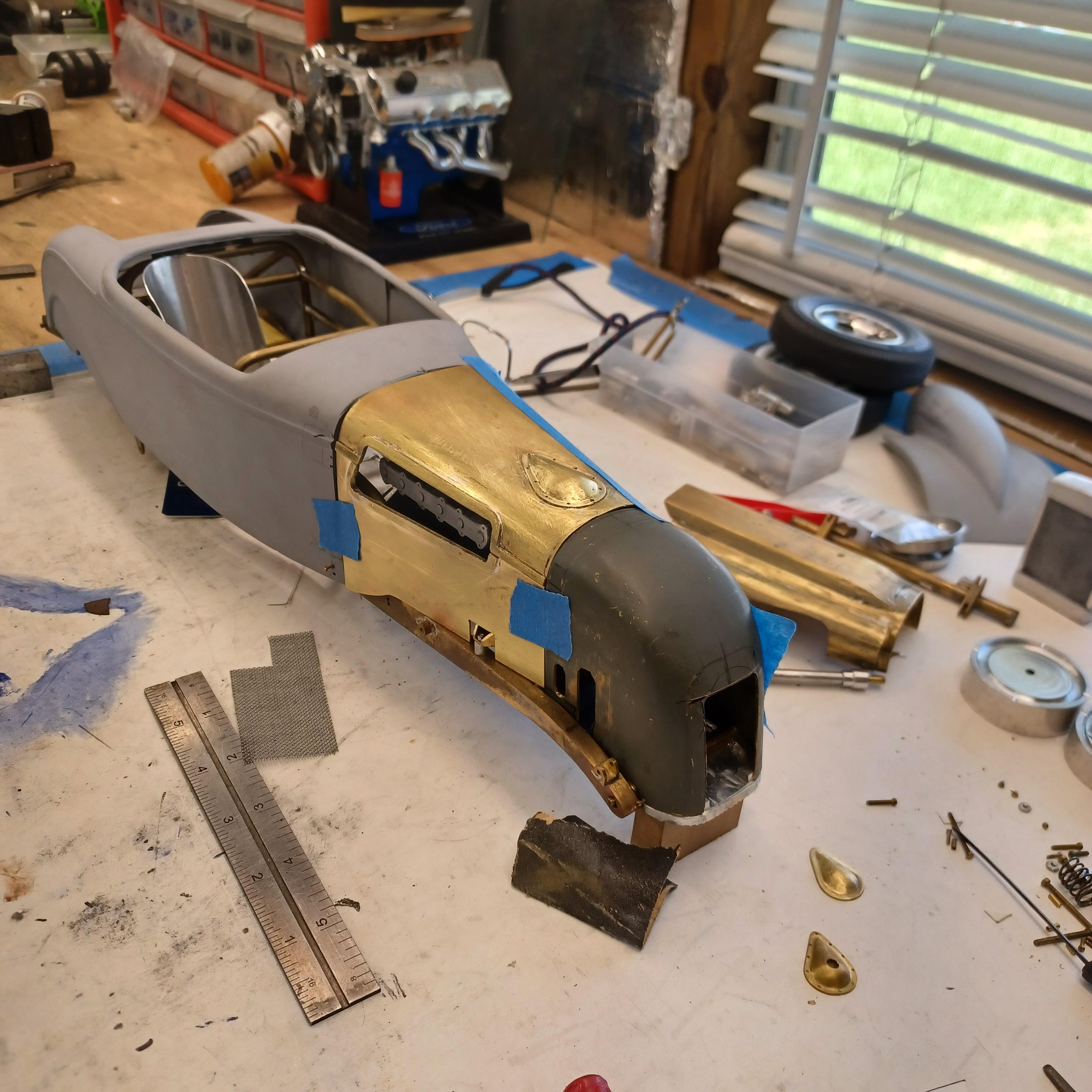

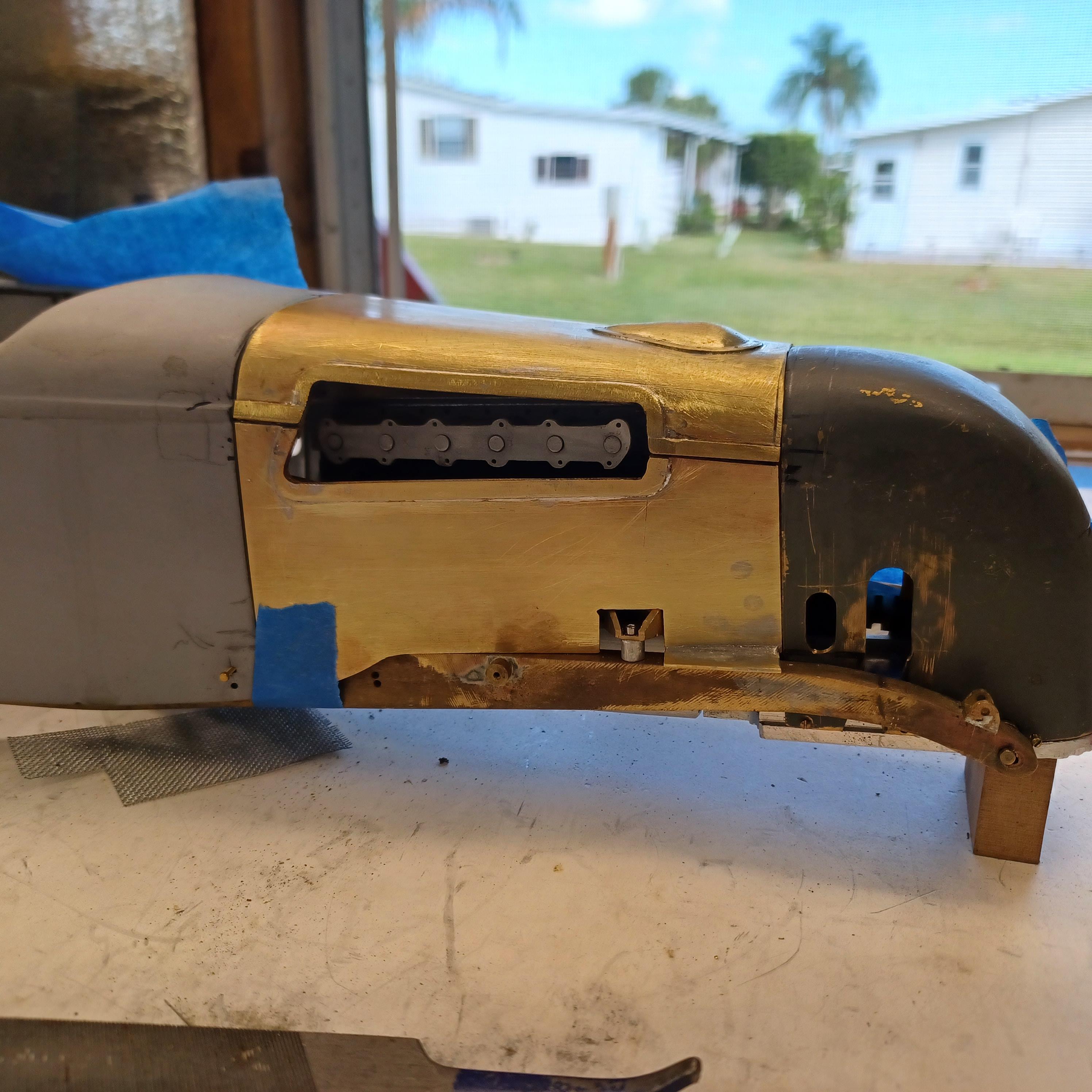

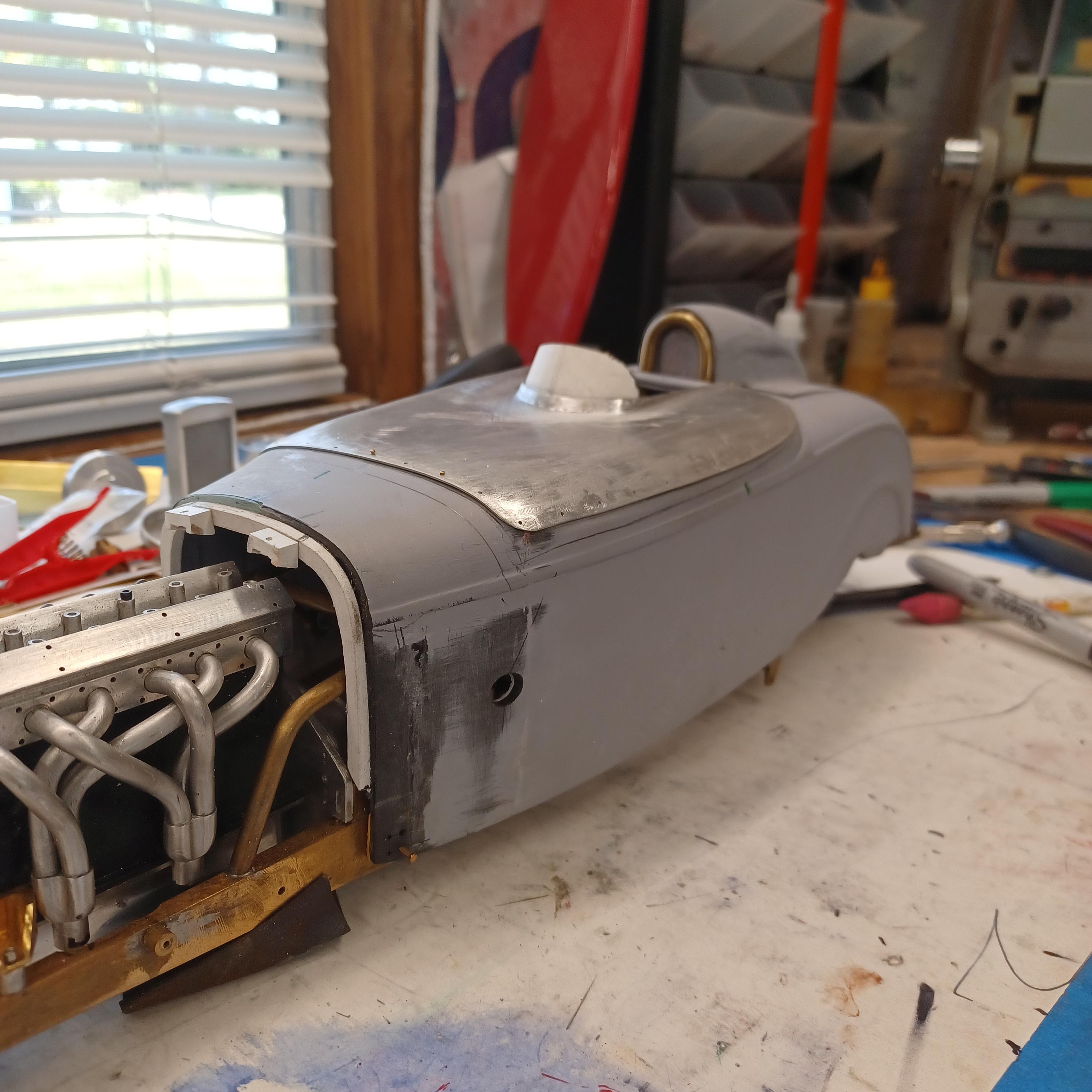

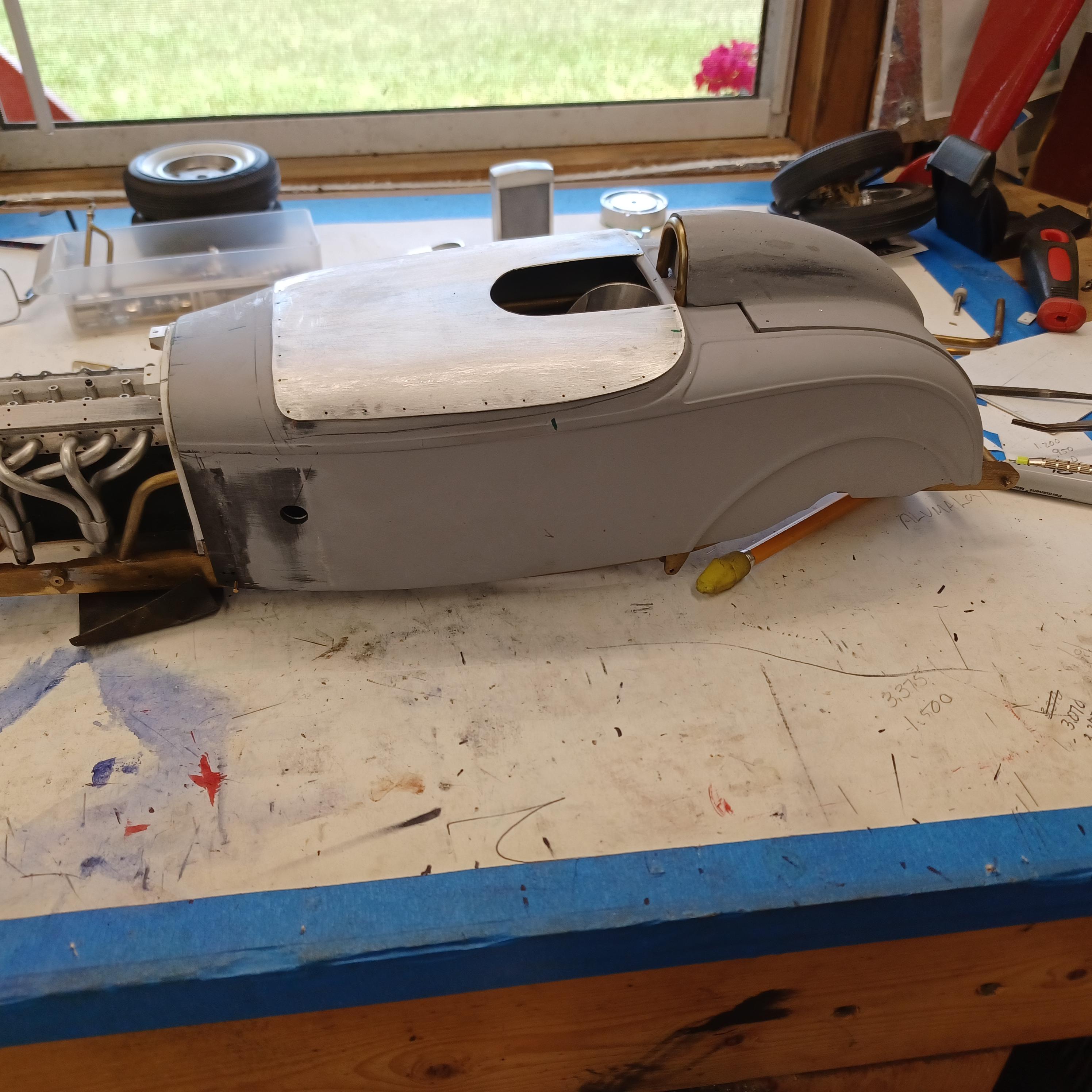

decided to build a new hood an d hood sides but the pictures don't come up. this is the aluminum top and soon to be windshield. i like the new hood and sides  better . as soon as i can i will get the pictures up
  • Like 4

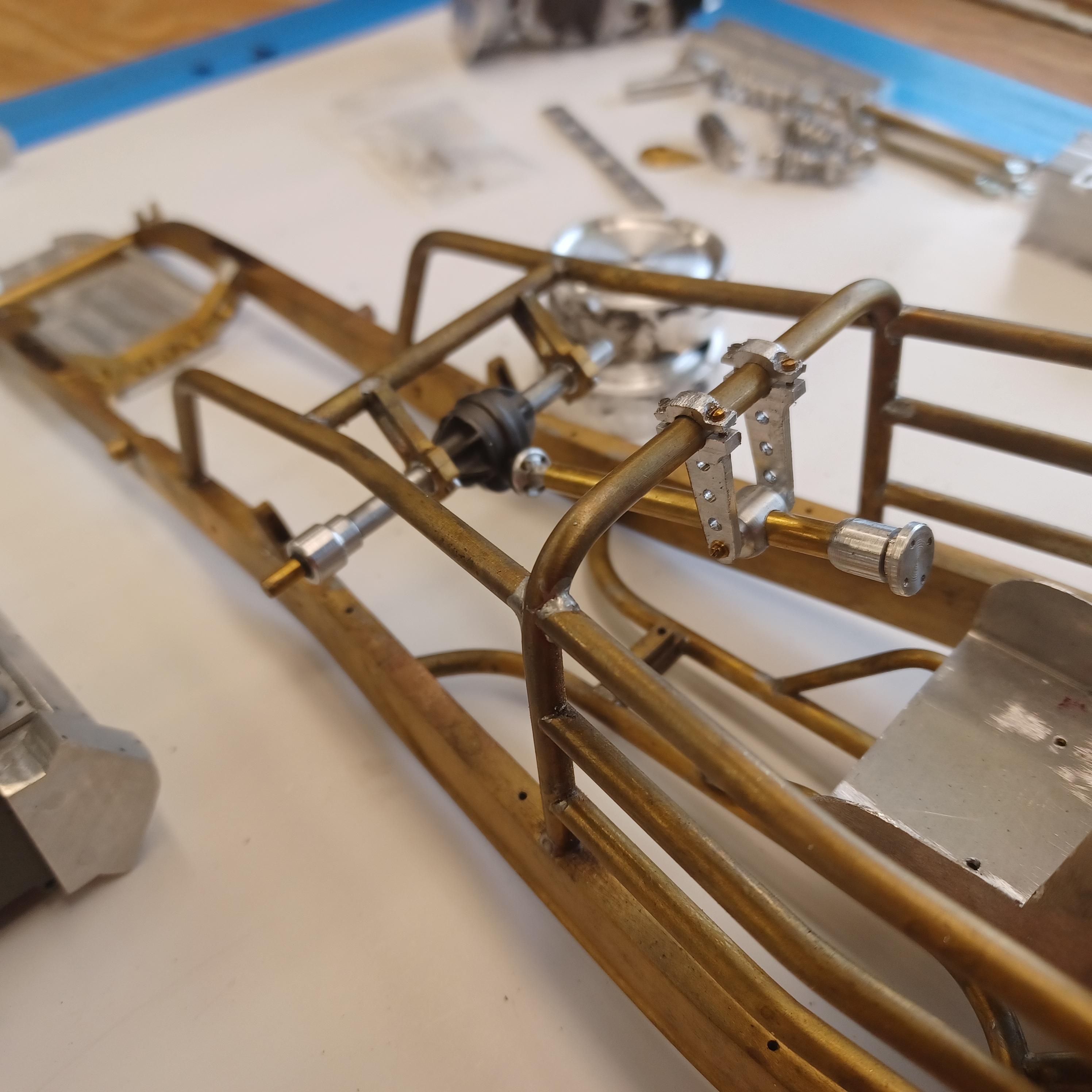

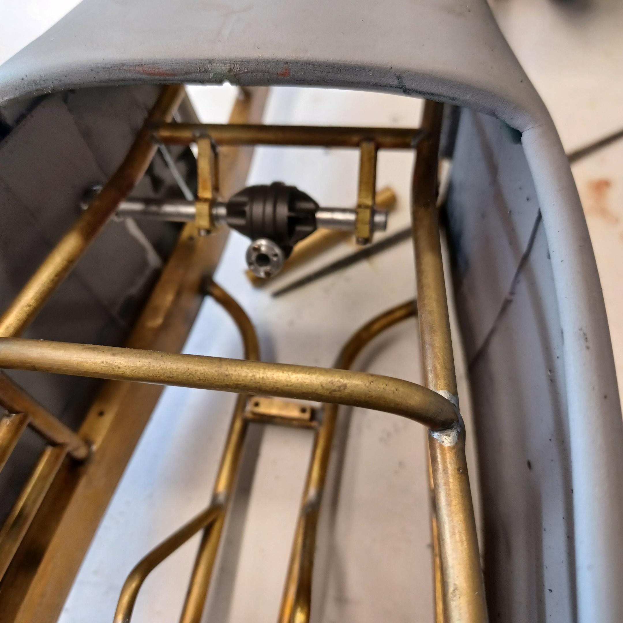

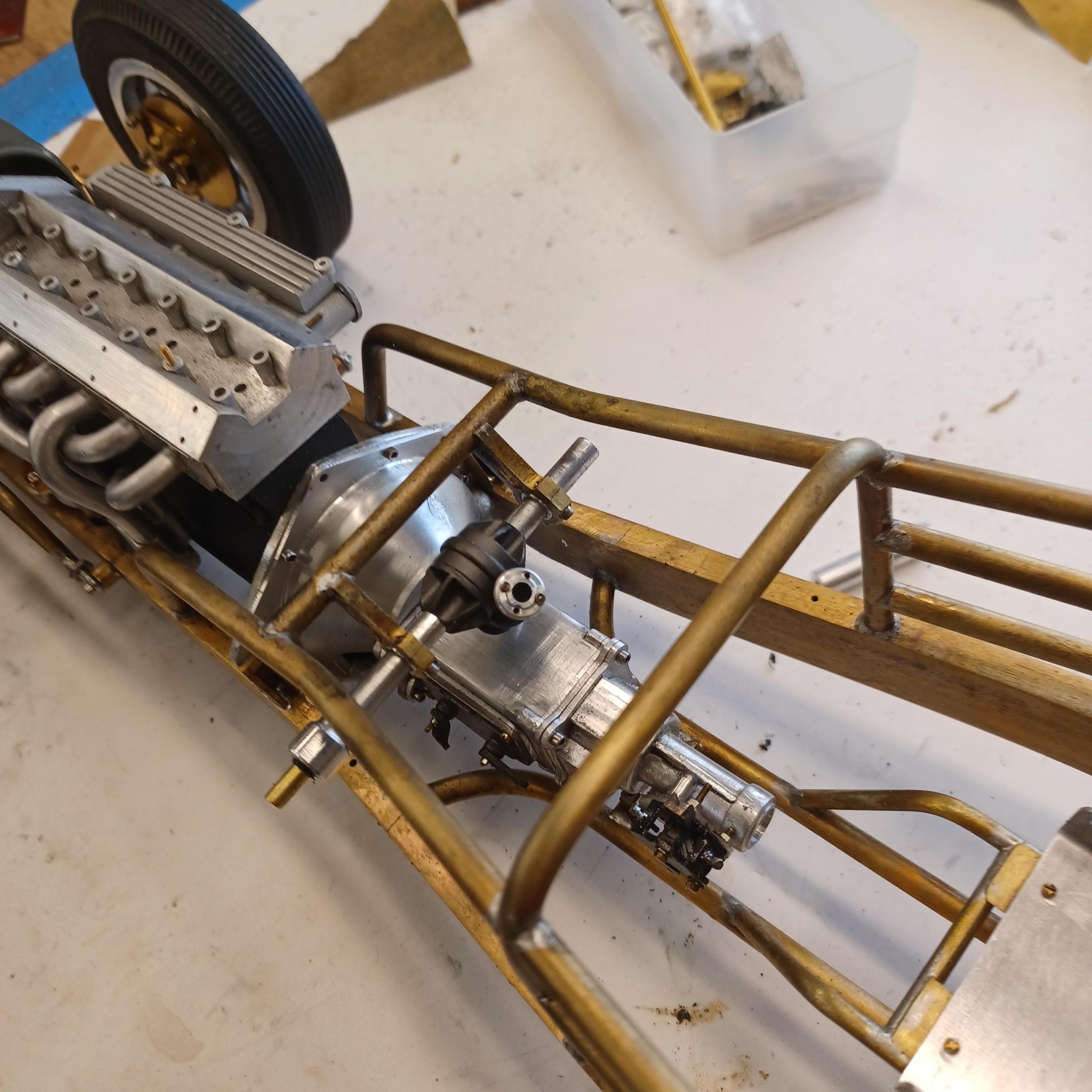

finishing the adjustable steering column support . just need to wire the distributor. getting started on the carb linkage on the bottom side to help with my new hood configuration. hi francis here is a picture of a diesel powered hot rod i built a few years ago for a customer in charleston ,sc. has a turbo 4 cyl diesel from a bread delivery truck. still cant find the hood pictures .one drive is new to me and am having some technical problems. found them

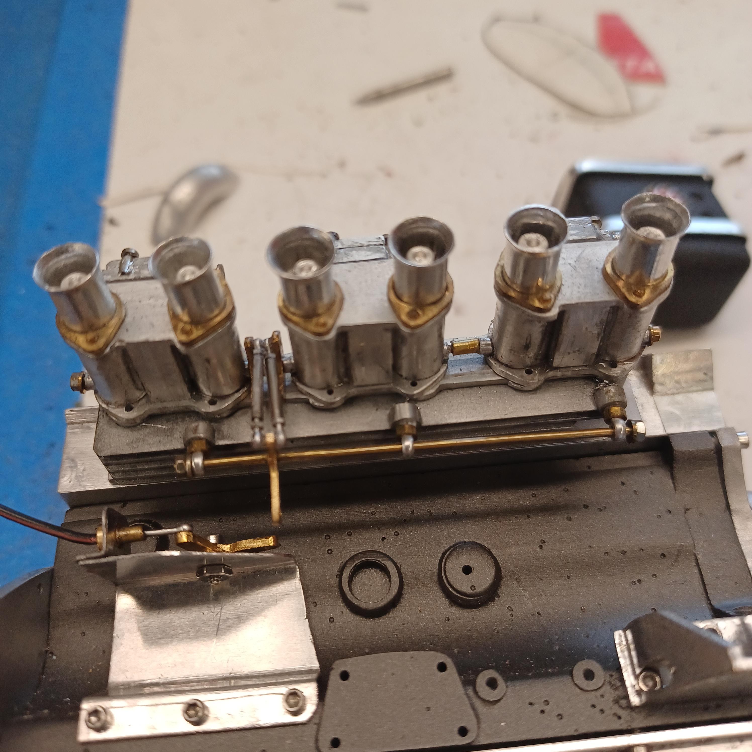

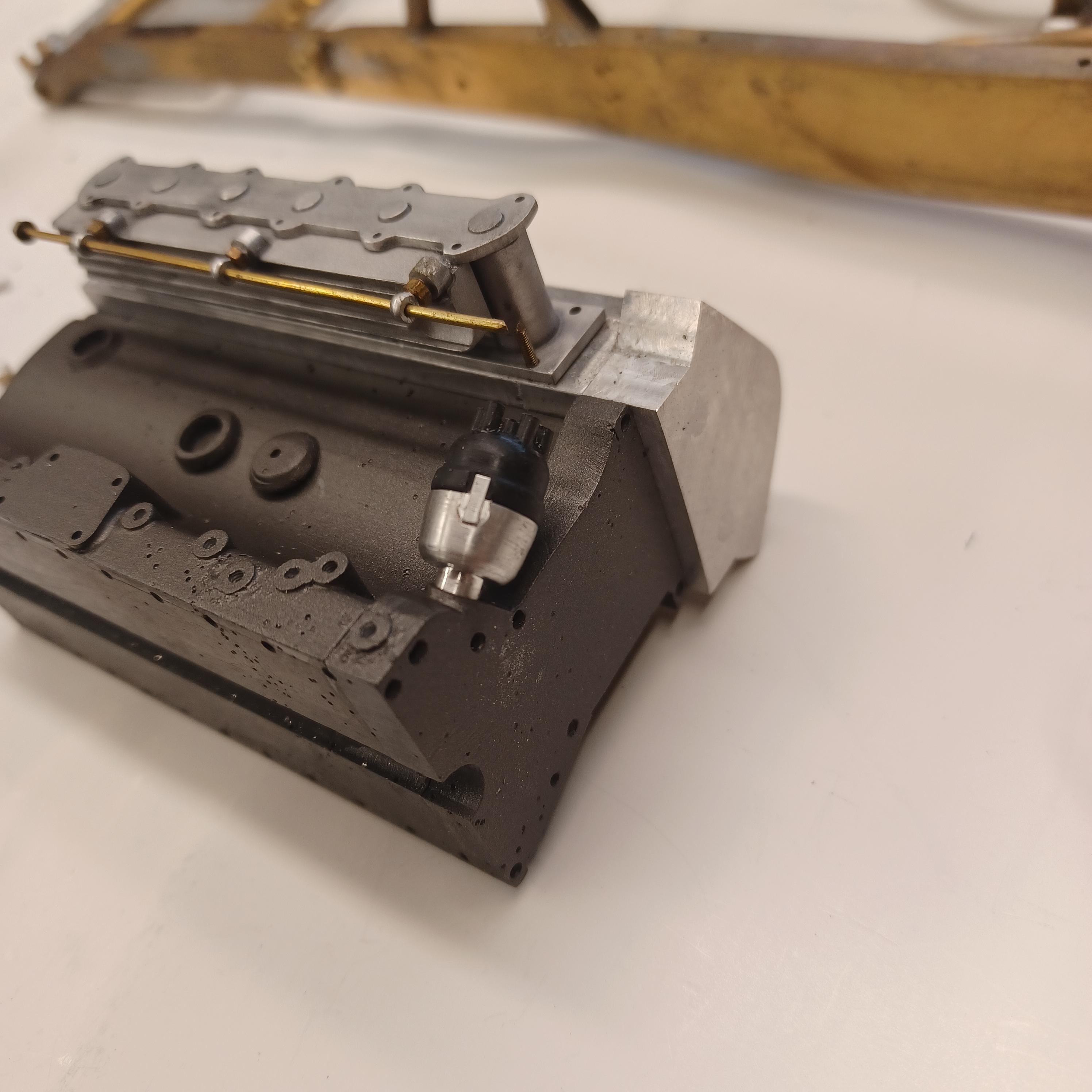

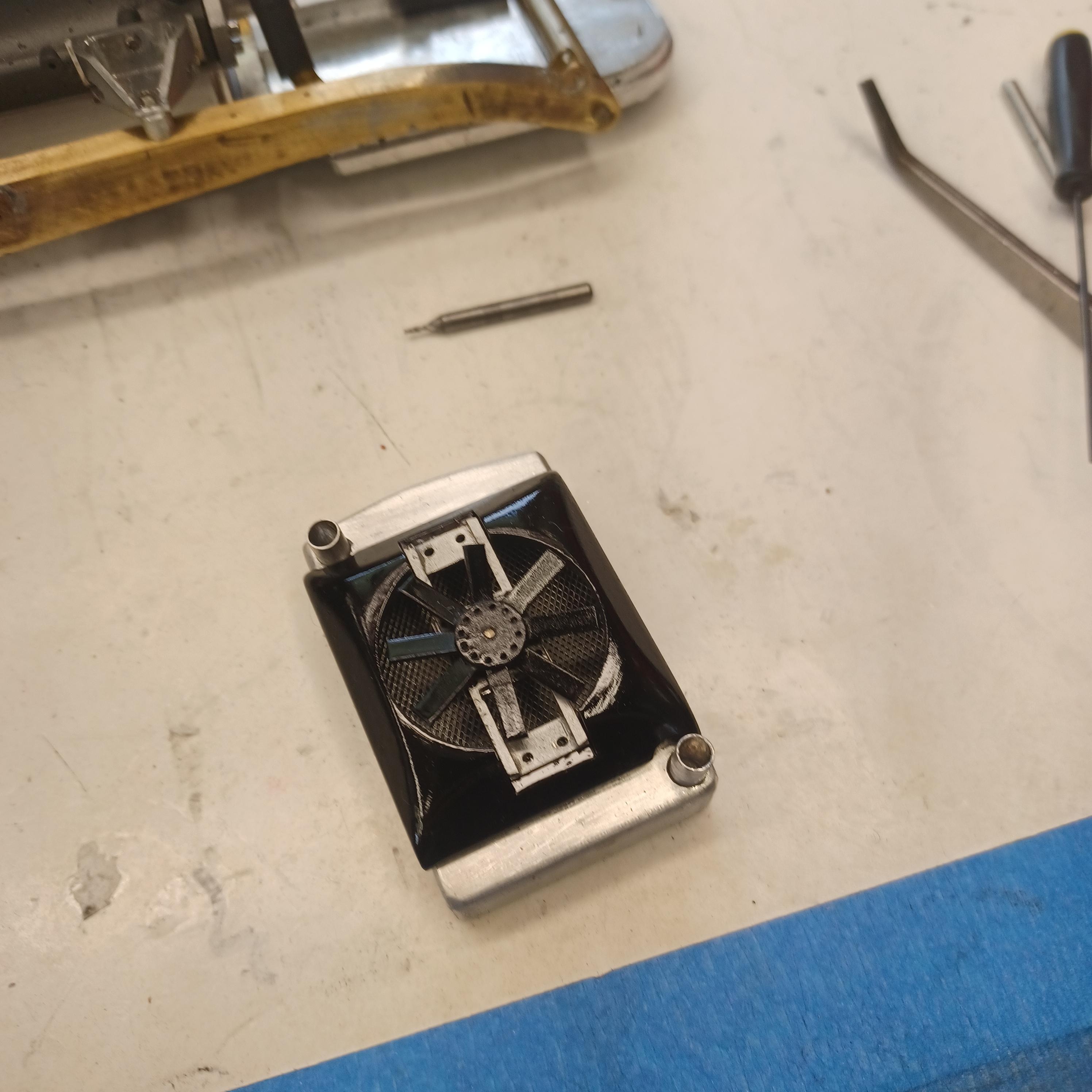

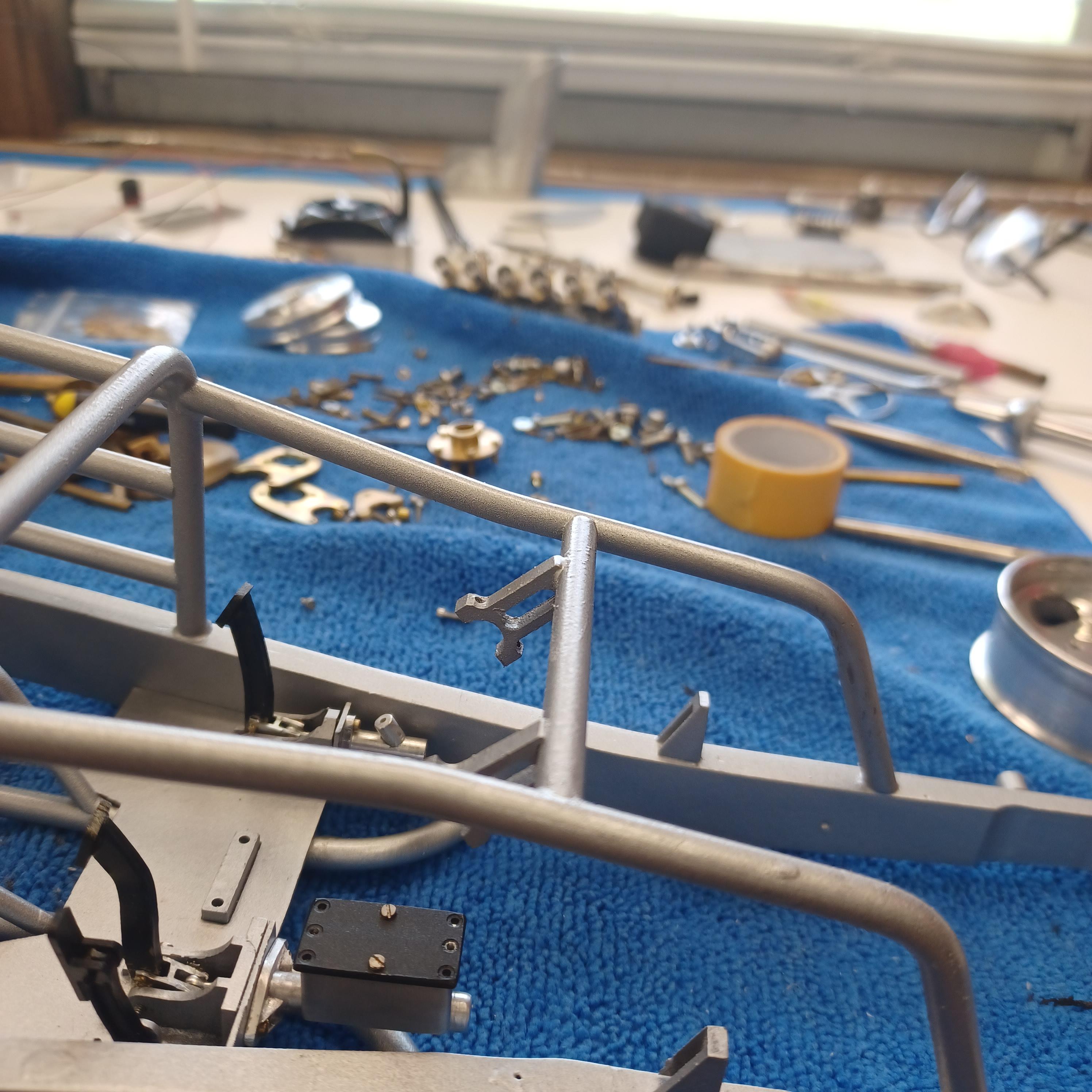

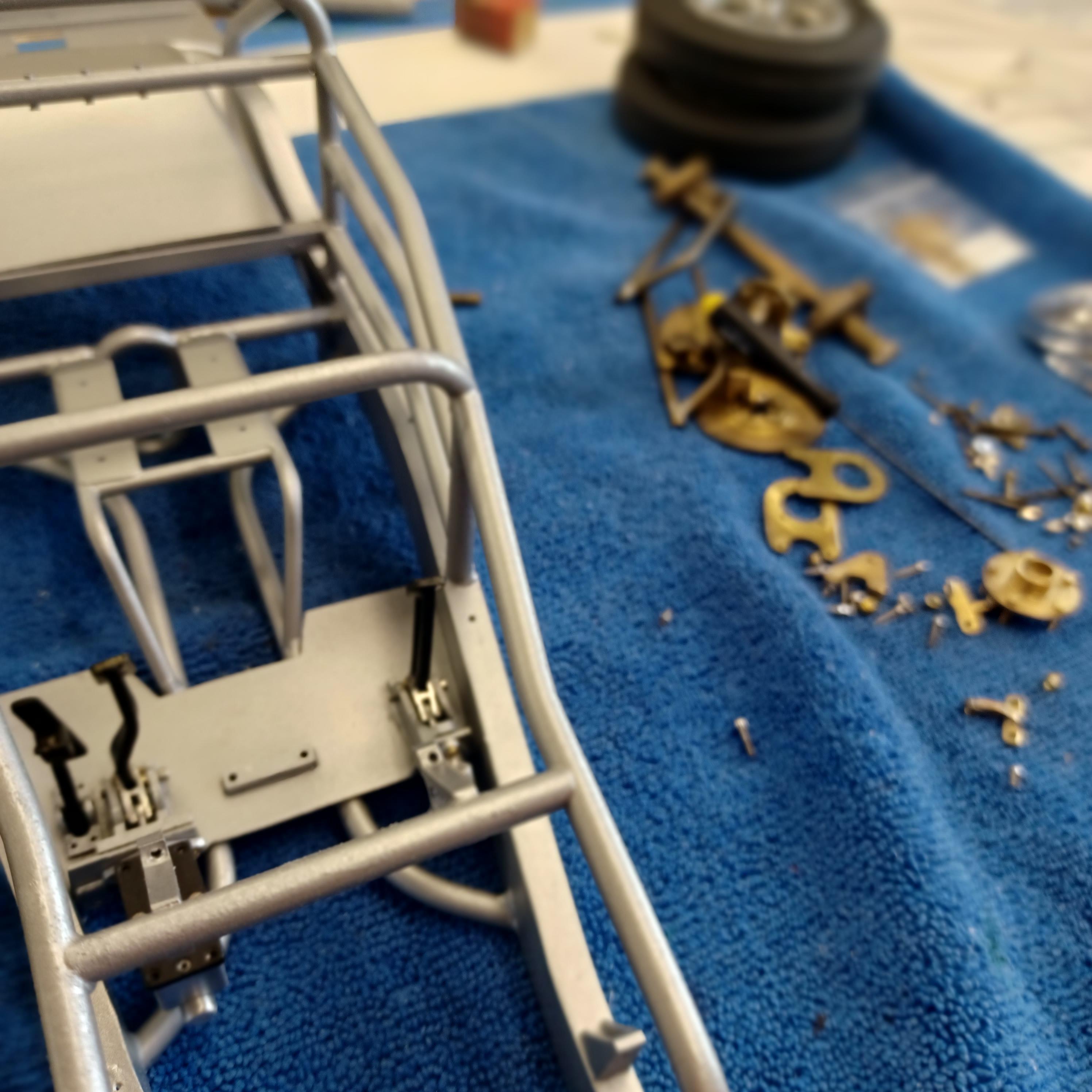

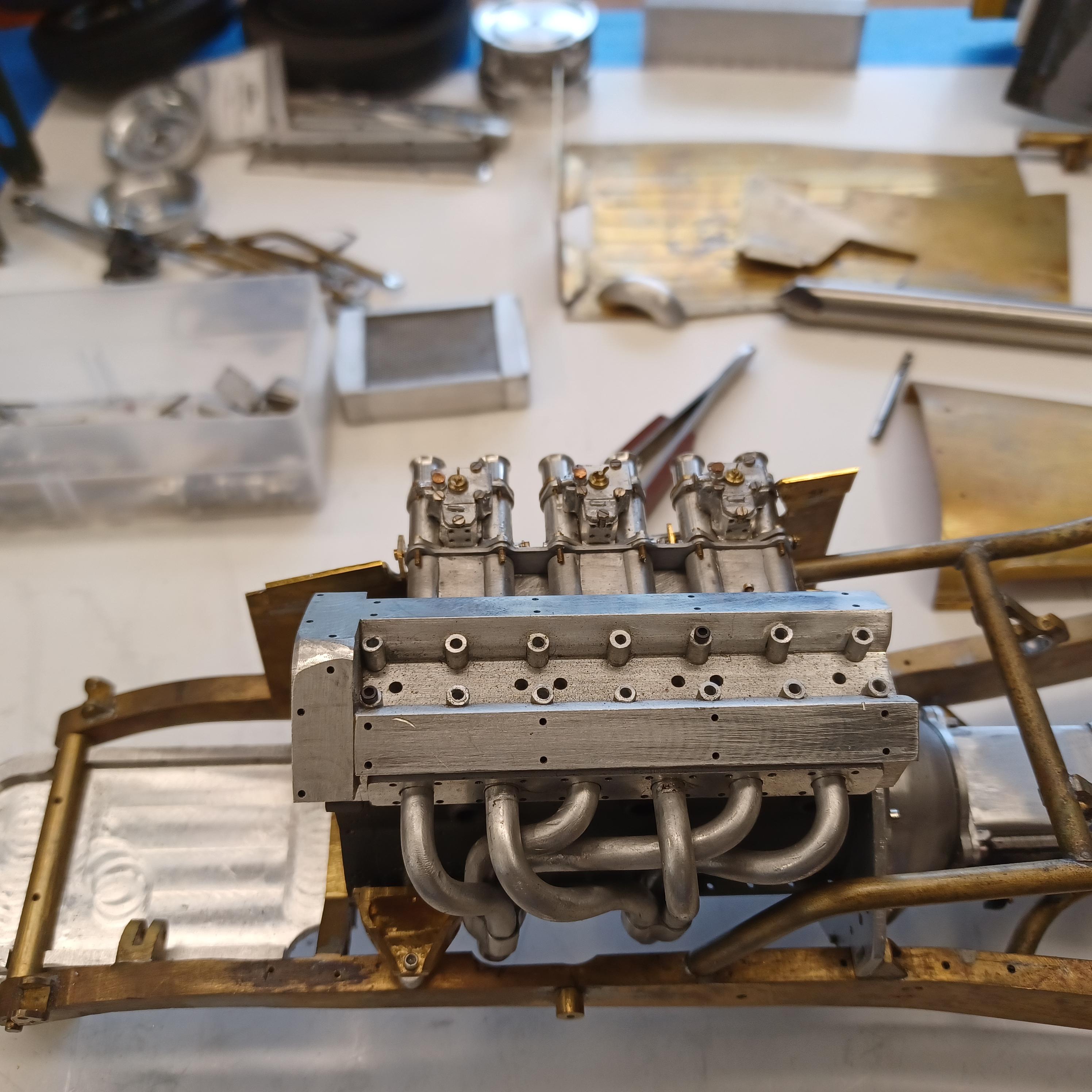

first time attaching the carbs to the manifold all the holes lined up . working on the radiator and water pump. got a good start on the brake clutch and gas pedal. i have to order some rod ends from RB to finish the carb linkage. i am almost ready to start the final finish of each part check the fit and paint or anodize them. i guess i do it different . i make my parts make sure they fit and then finish them  for paint. might be backwards .but it works for me. more later,charlie

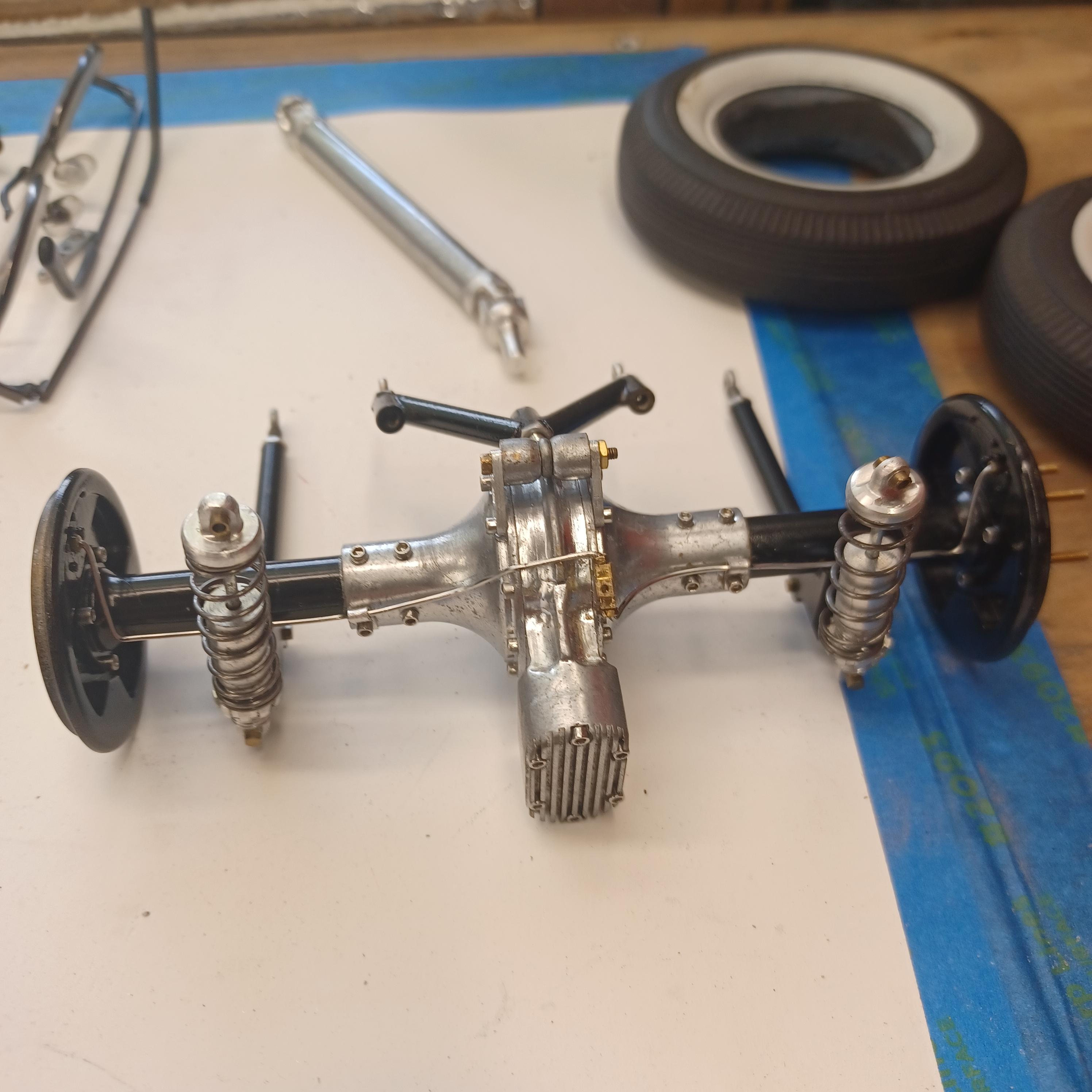

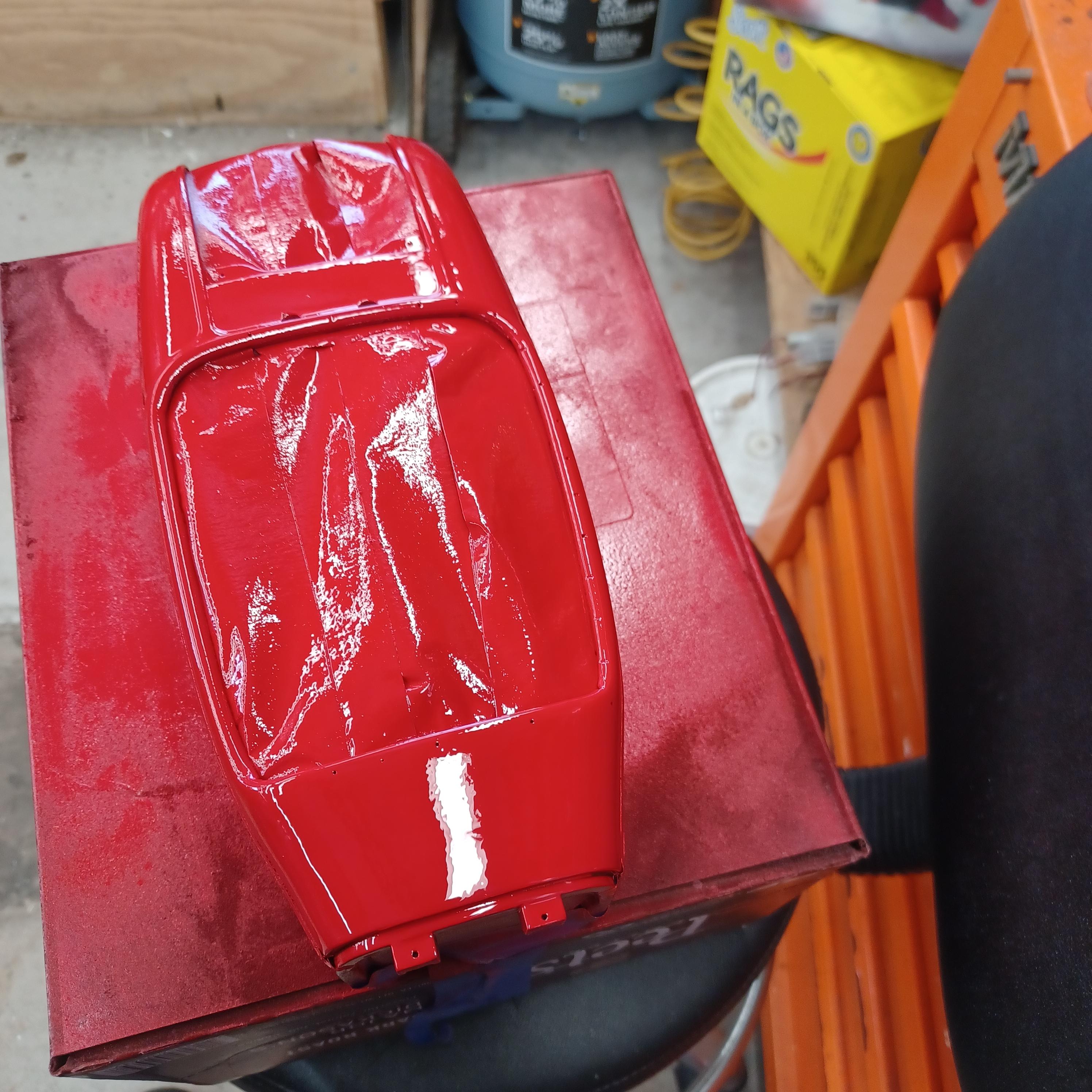

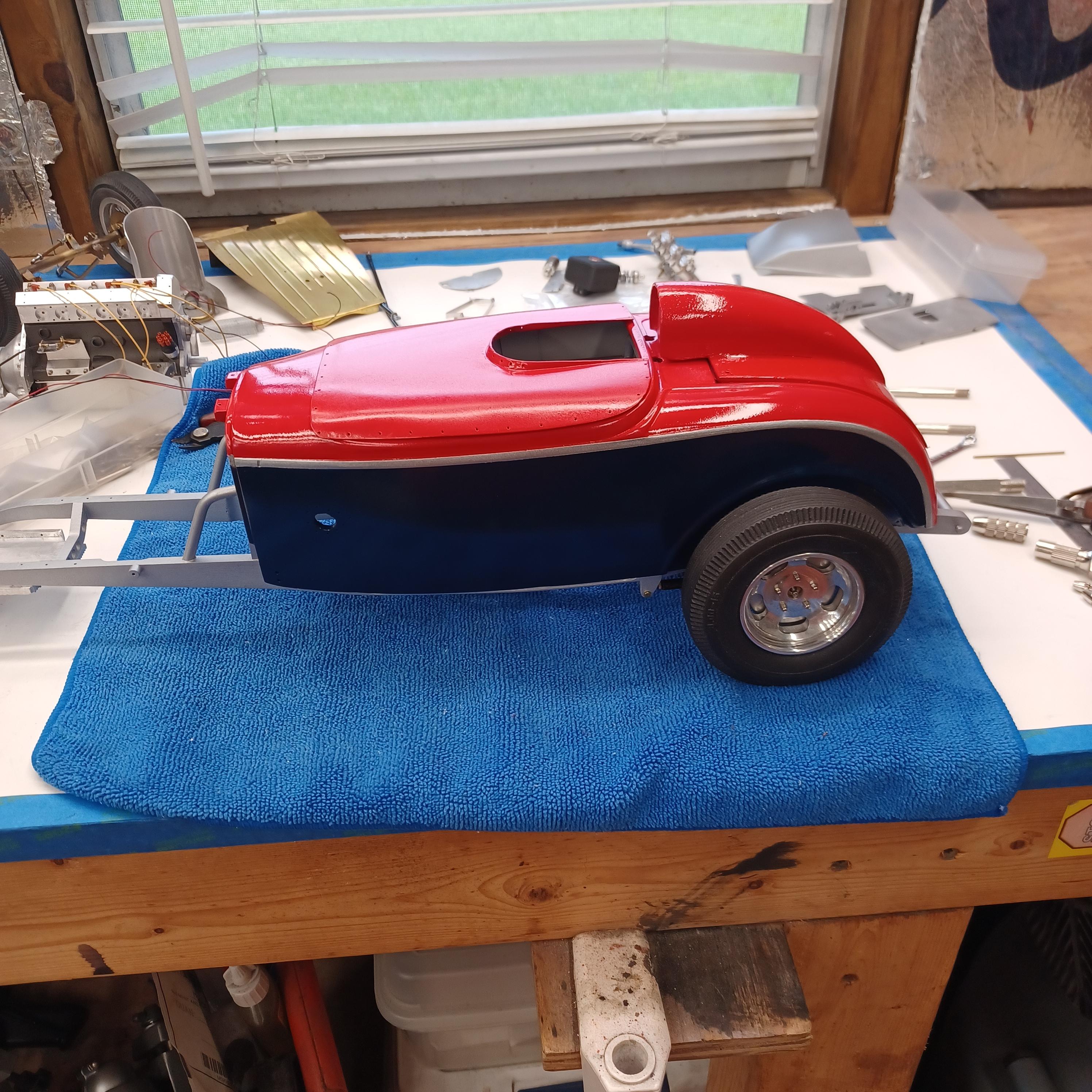

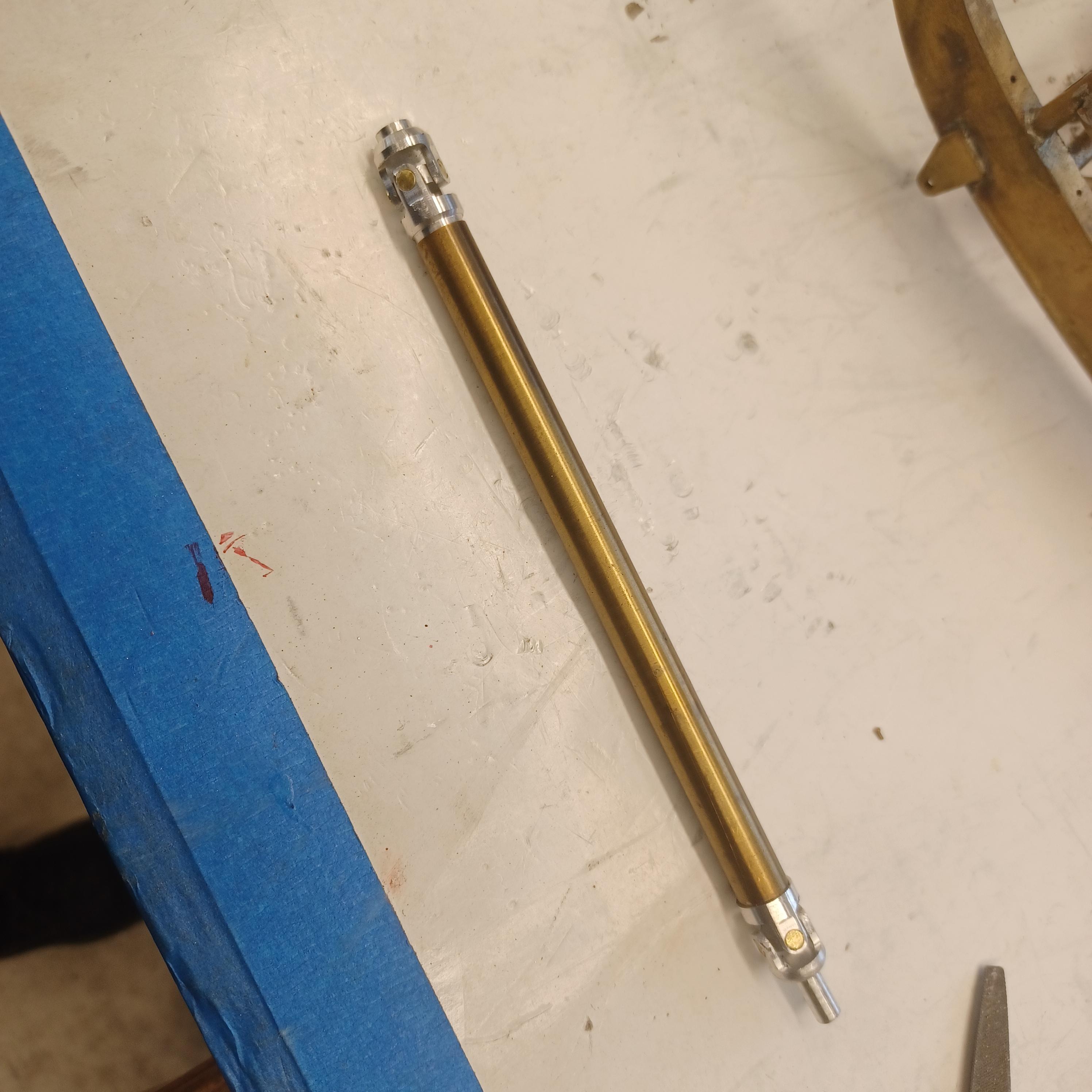

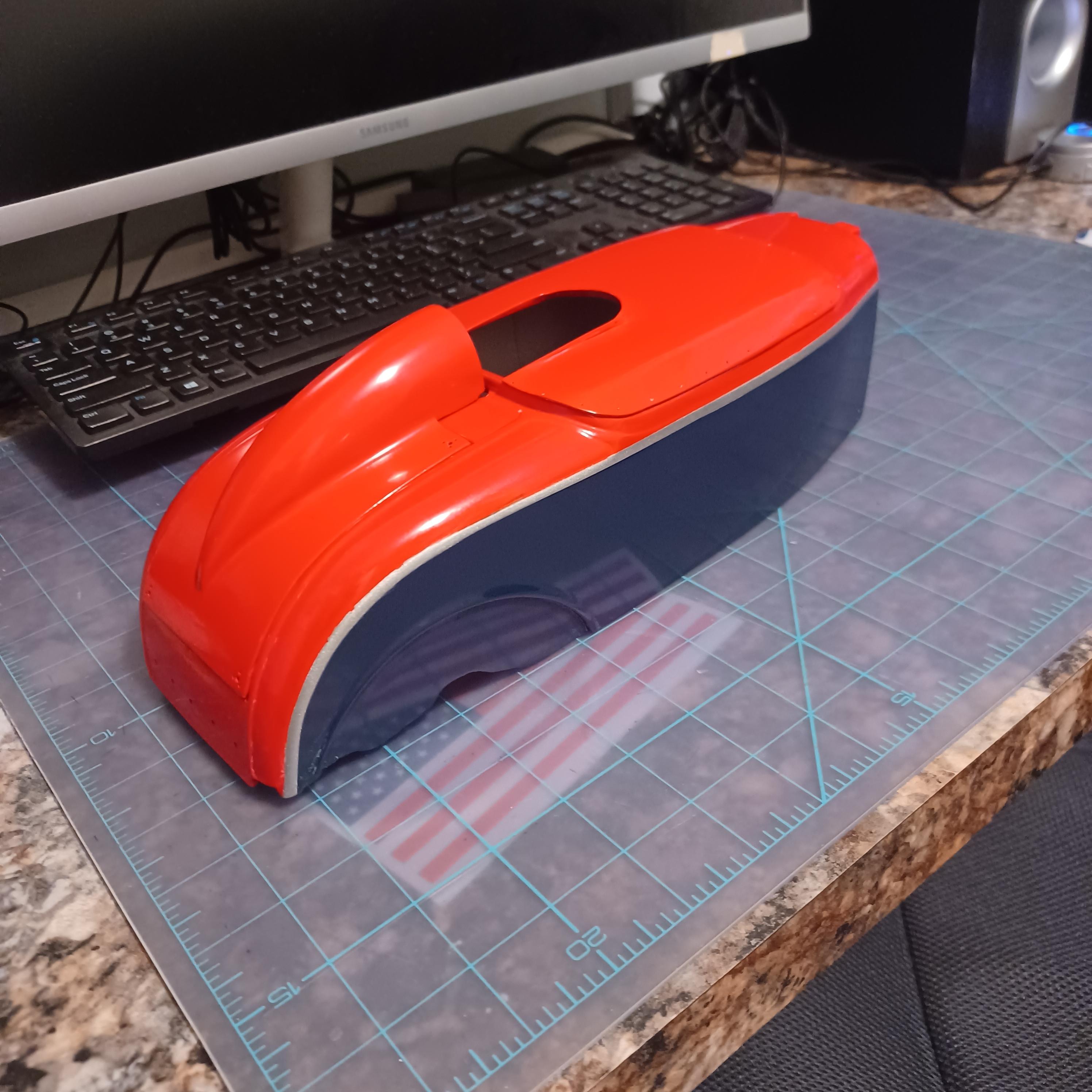

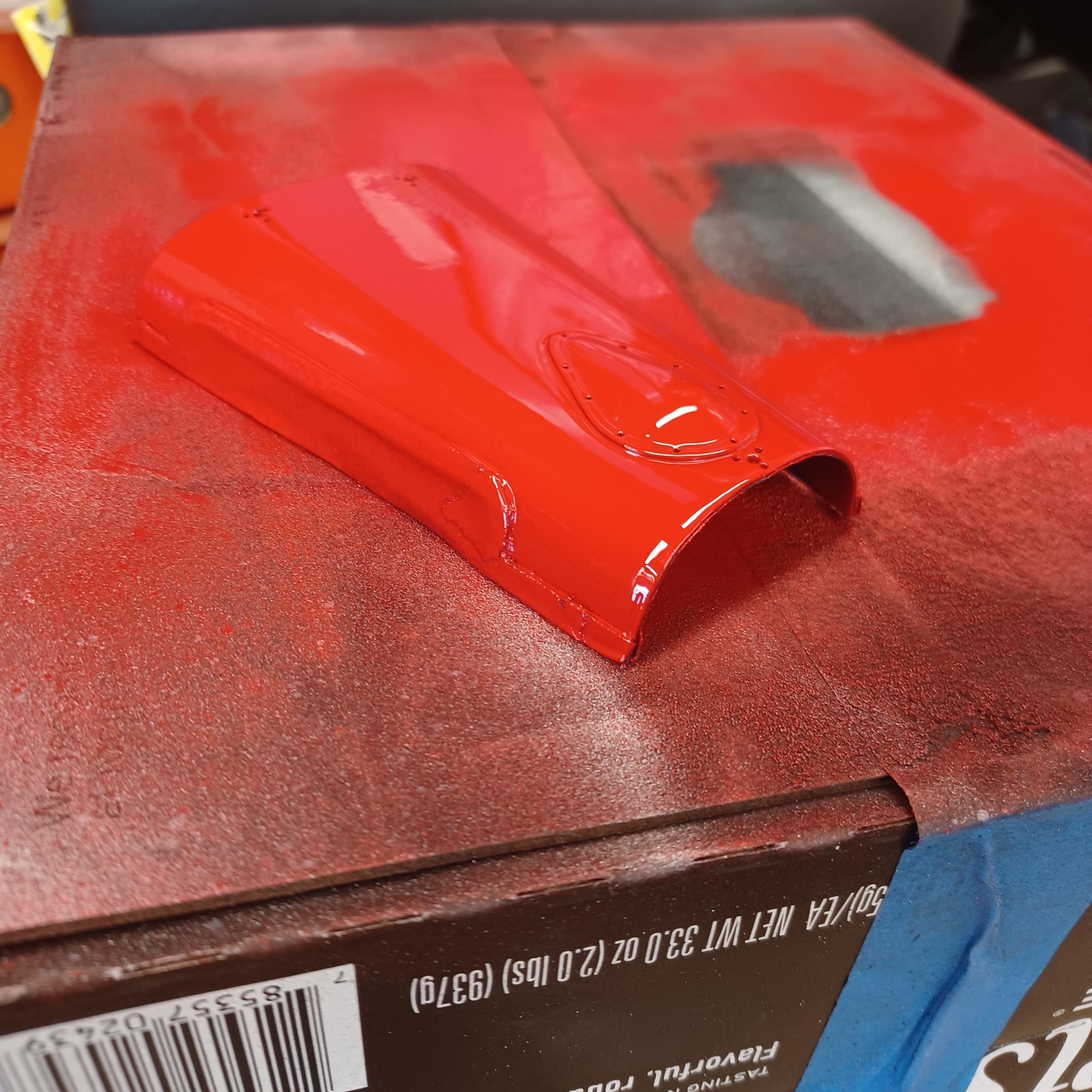

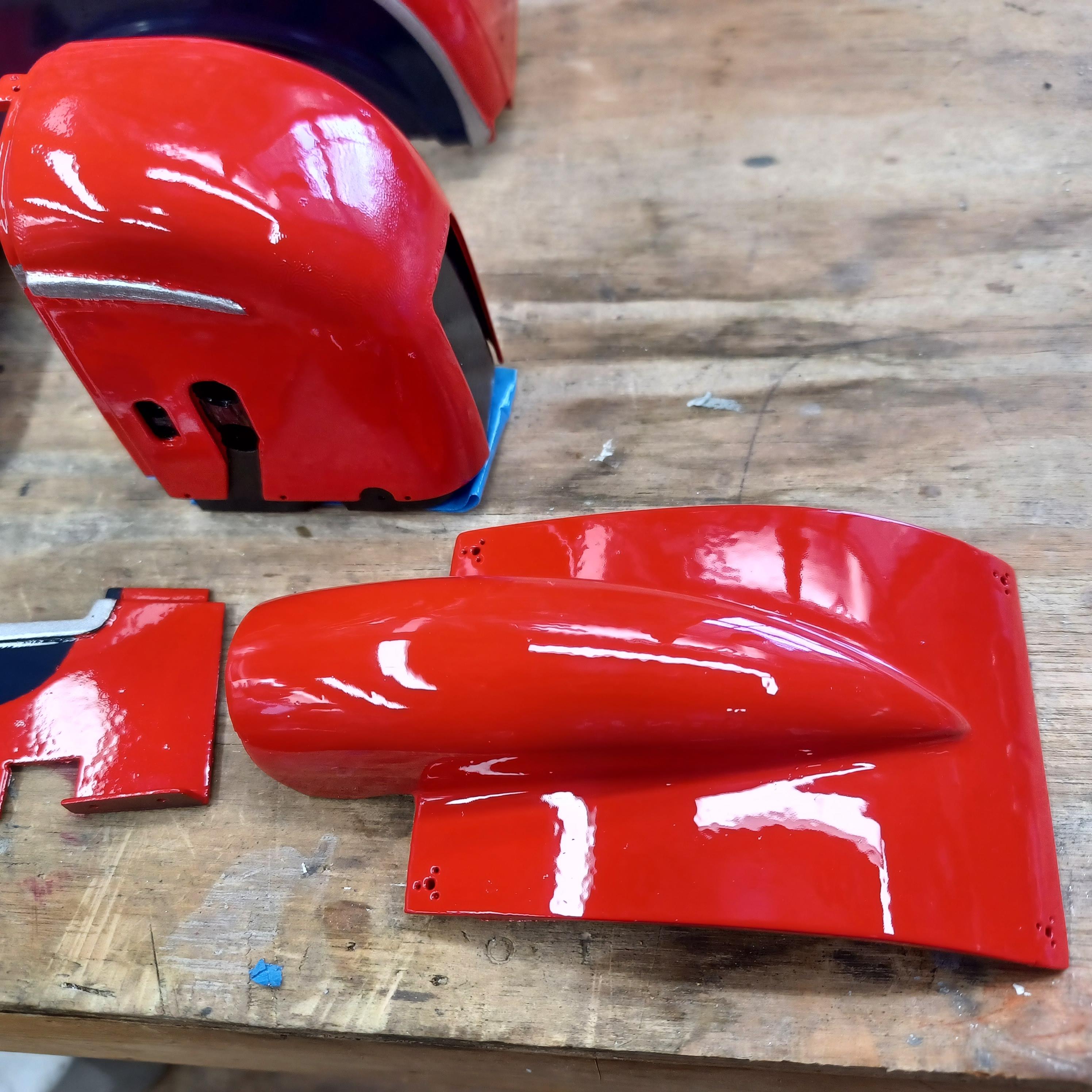

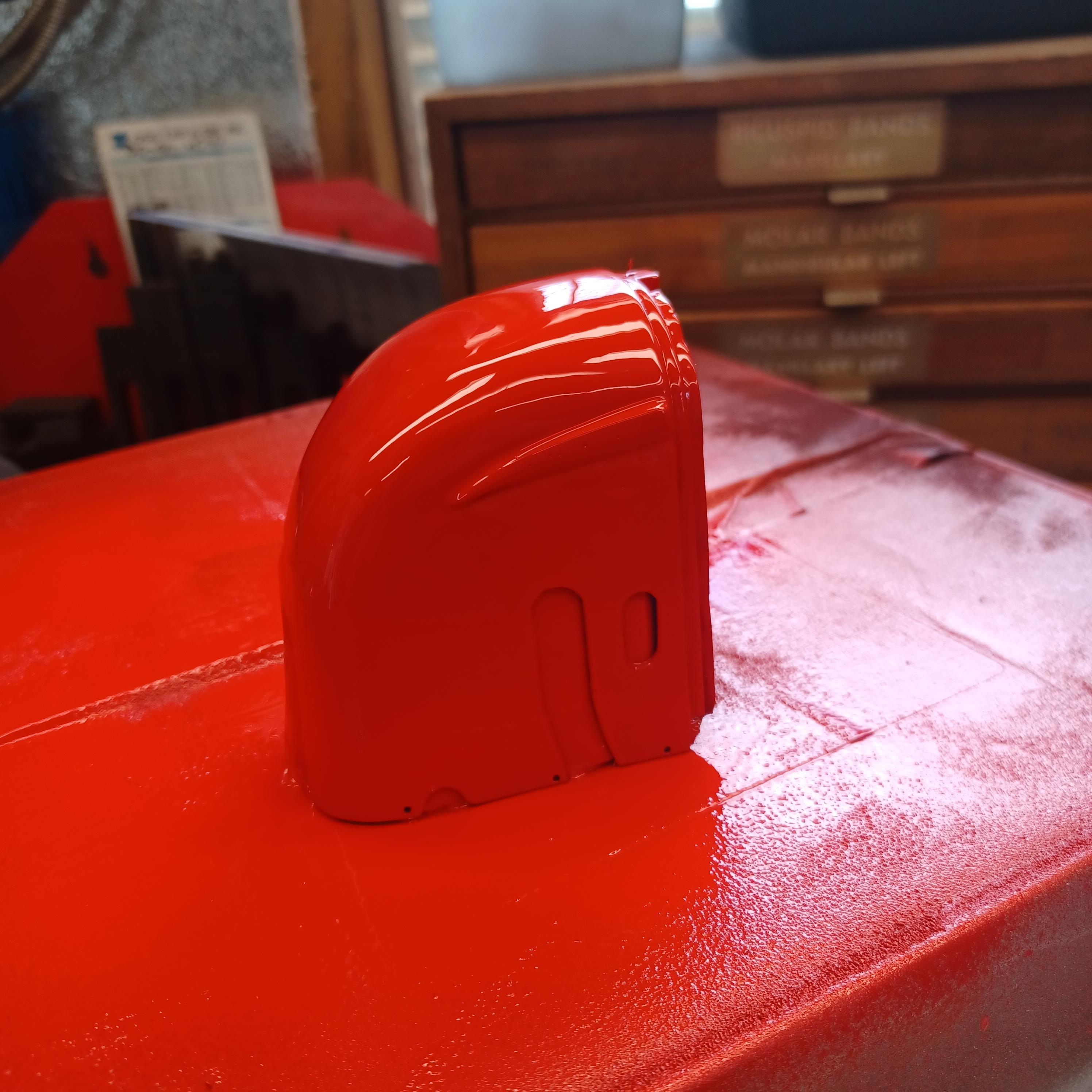

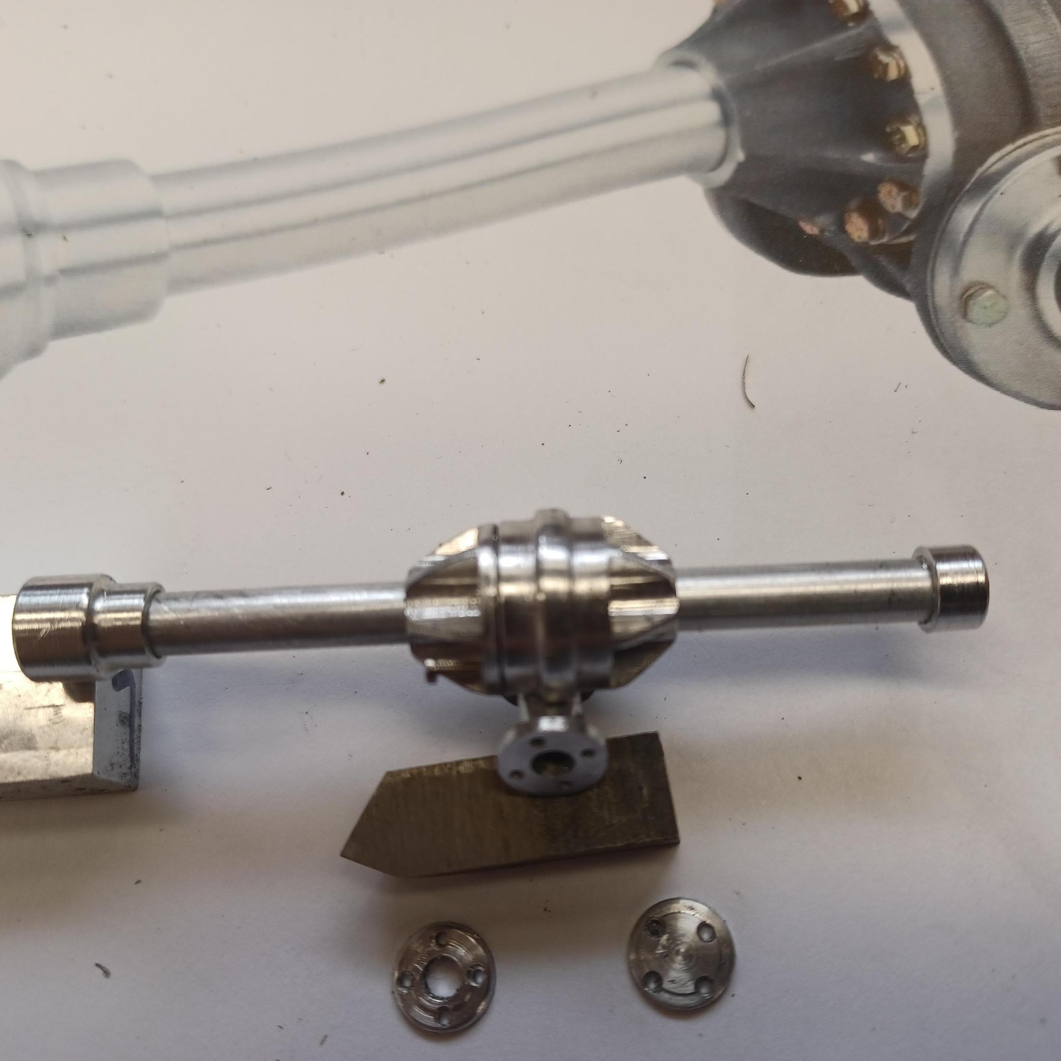

got a little behind on updates.working alot on the hydreds of details,also on the paint. the top above the body line is as you can see bright red,a silver stripe at the body line and dark navy blue below the line.i am waiting for the red to make sure the tape wont affect it.later this week will be 7 days,that should be enough. made the drive shaft and electric radiator fan and shroud. i think the red came out well,a little wet sanding after all the colors are on and 3 coats of clear. i have the carb linkage all most done thanks to RB motions hiem joints. thanks for looking and thank you for your nice comments.

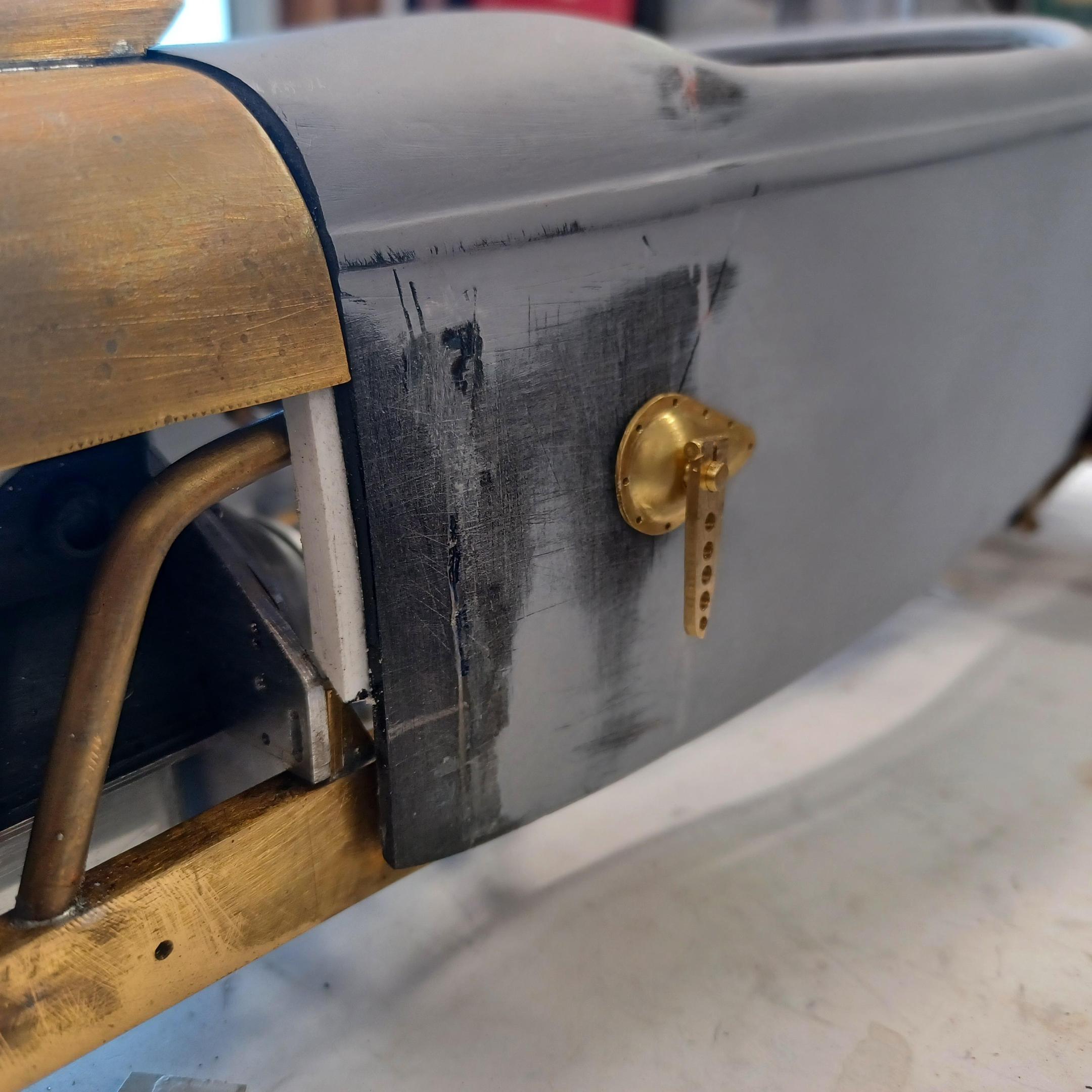

hi andrew nice to hear from. hey noel ,i think you will like my next project. i am trying to design a small english wheel mostly for finish work after hammering a shape. i want to build a body the same as the 1 to 1 car that i did . francis so happy to hear from you, glad all is well.here are a few more pictures of paint and i am in the process of doing finish work and finding things i forgot or missed. the paint looks pretty good after sanding and polishing the clear coat. i have striped the nose to refinish because the sides were not looking as good as the rest of the parts. i have painted the frame argent silver but i have not taken pictures.

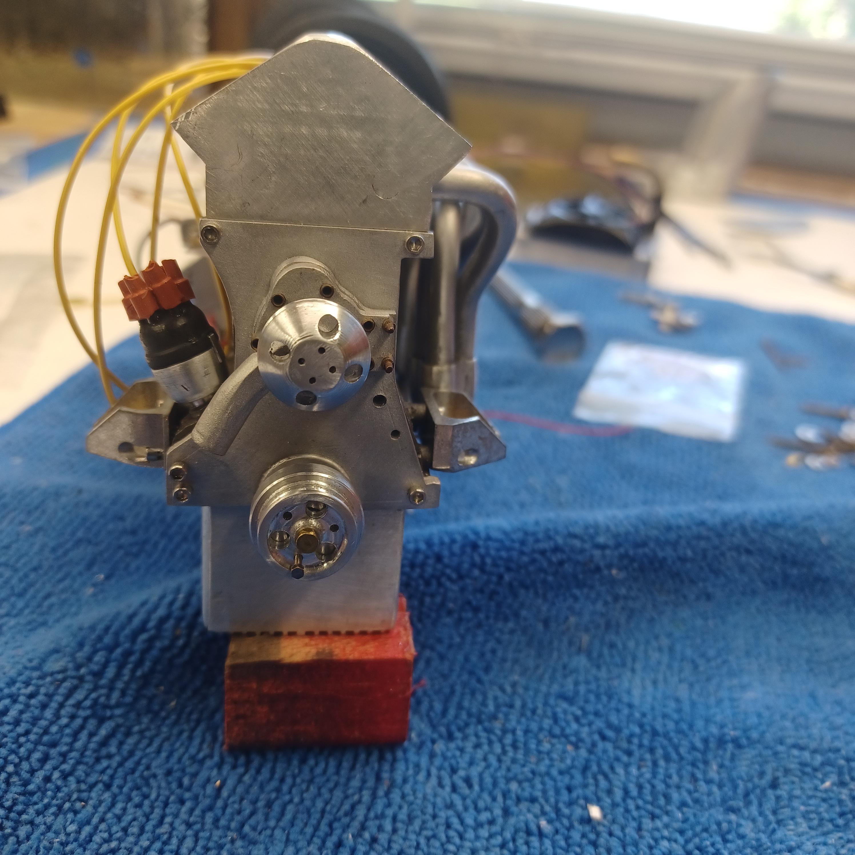

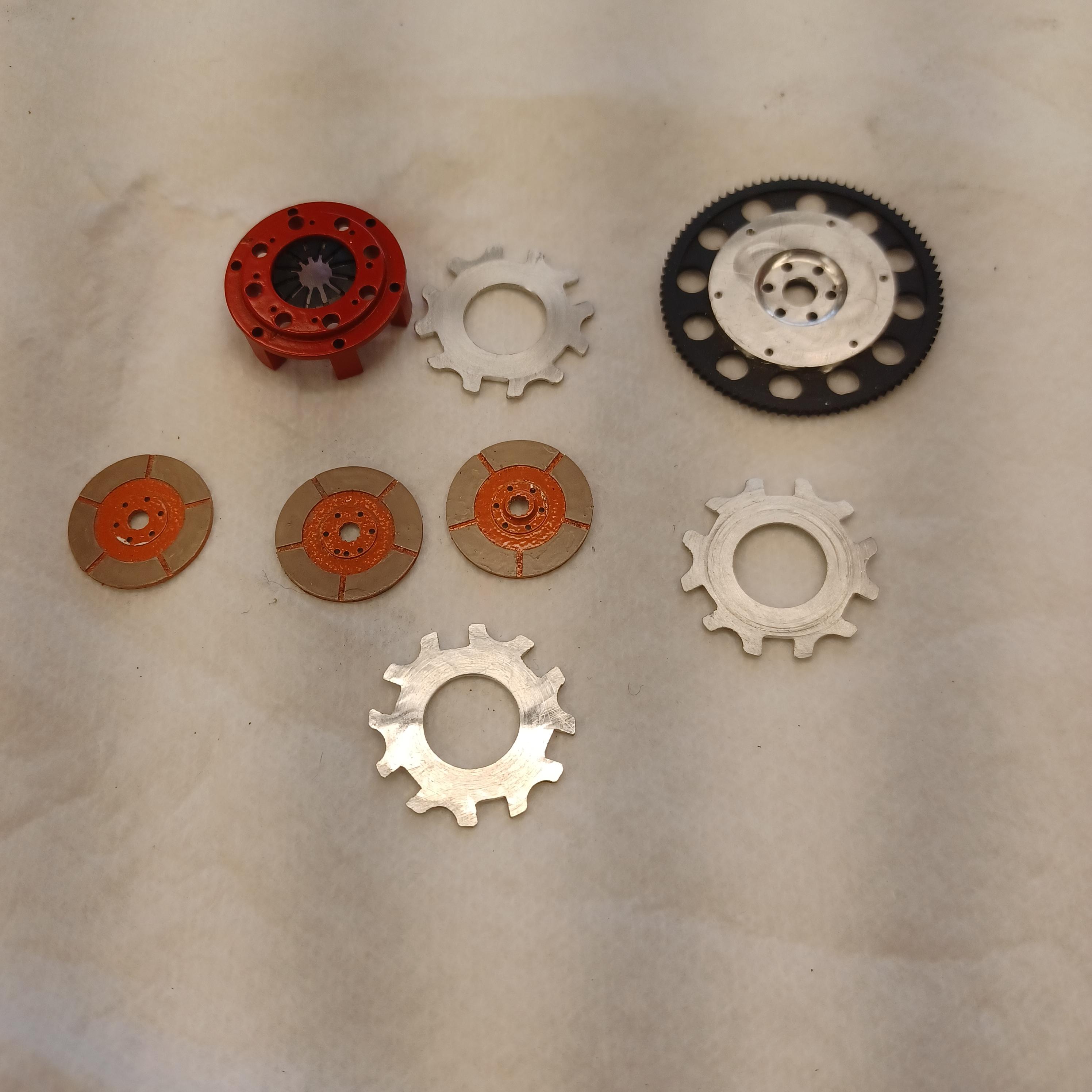

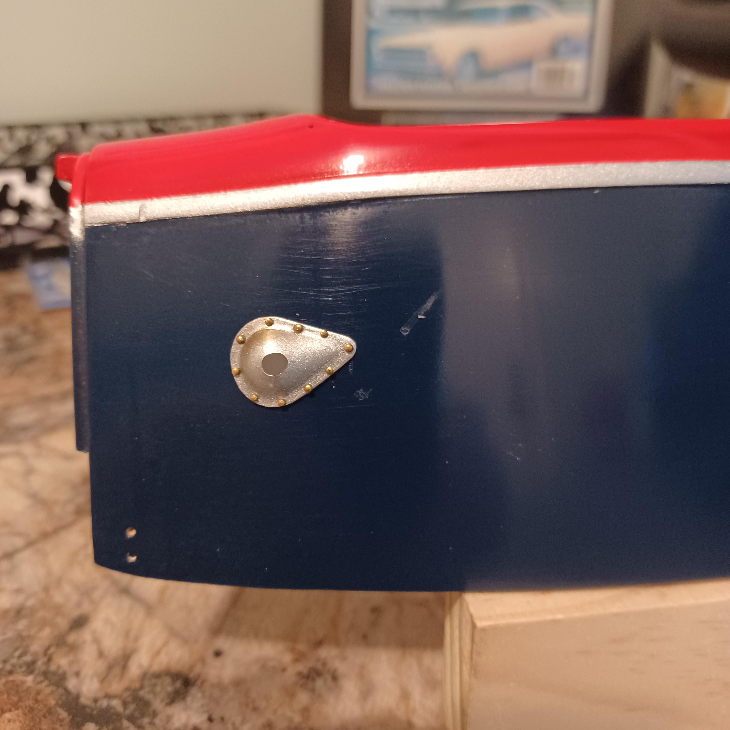

no air just sweat. ok till about 2:00 . hi bryan thanks for your comments. working on final parts and assembly ,got brakelines on the rear. got the pedals installed. made pullies and balancer for the engine. i have been sanding and polishing the paint. the main body is sanded to 12,00 and is ready polishing. waiting for real screws and fake allen bolts.

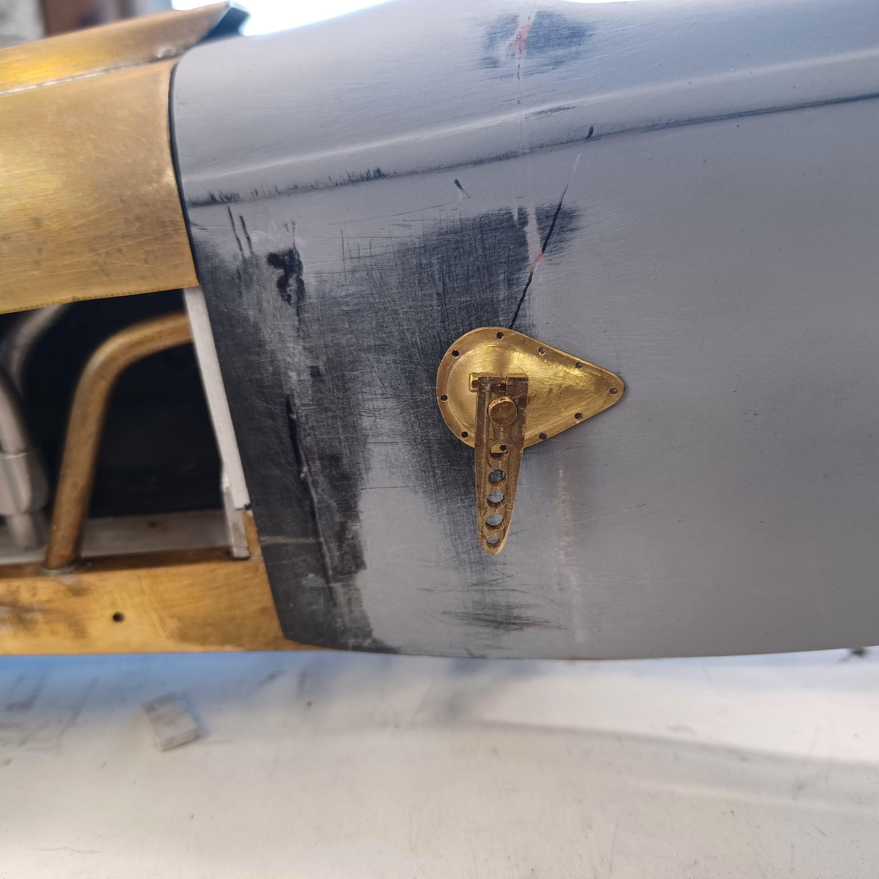

got a little sanding and buffing done . did some rivets as well.working on carbs and fuel lines.anyboby got a good place to buy smaller braided hose , like .045 and .060? would appreciate the help. thank you
