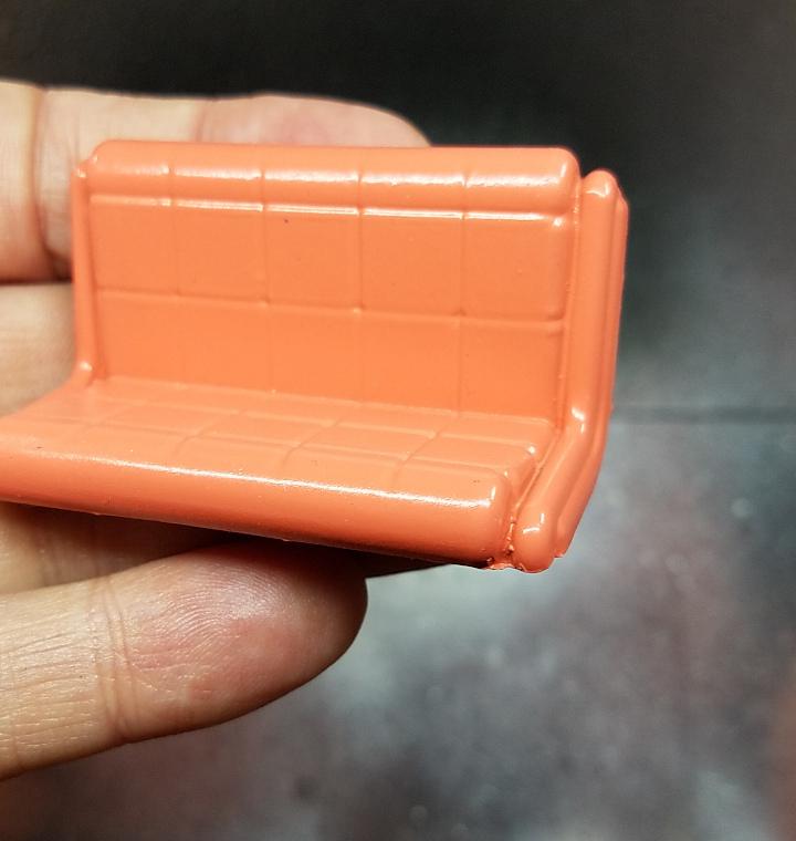

This end sections of this seat...
To match this...
Because the surface is deeply indented there, using tape is very difficult. That's why I'm trying the liquid mask.

try blutack or something like that maybe
I thought you originally mentioned that the paint had a flat finish.  Liquid mask in theory should stick to that finish which has some glossiness to it.
Anyways, why go the liquid mask route?  All you need is a simple straight-line mask. Why not use some Tamiya tape (or any Washi tape from hardware store).  It should  conform to the shape of the cushion just fine. Just burnish it with a toothpick.  You could probably just use the tapes edge (no cutting required).
Or if that curve on the top of the seat is too sharp, just cut a thin strip of tape and place it right at the color demarcation line, then fill the rest of the masked-off area with wider strips of tape, and if there are still some voids left, just fill those with liquid mask.  That way there will be no cutting.
The other option is Parafilm-M but I don't think it will work all that well (it does not adhere to surfaces well, since it has no adhesive).
Edited by peteski
Yup, I would use tape, too. Apply carefully and burnish well. If not happy with the ‘lay’, pull it up and re-lay it. May take several tries. Once the lay is good, burnish the deepest part of the groove first, then work your way up the sides.
Good tape is a must, Tamiya etc. no household painters tape. BMF is an alternative masking medium for irregular surfaces. Be aware that liquid masks can stain some non-glossy surfaces. If considering a putty for masking, such as the blue tac mentioned above, another option is silly putty, which can be quite versatile also.

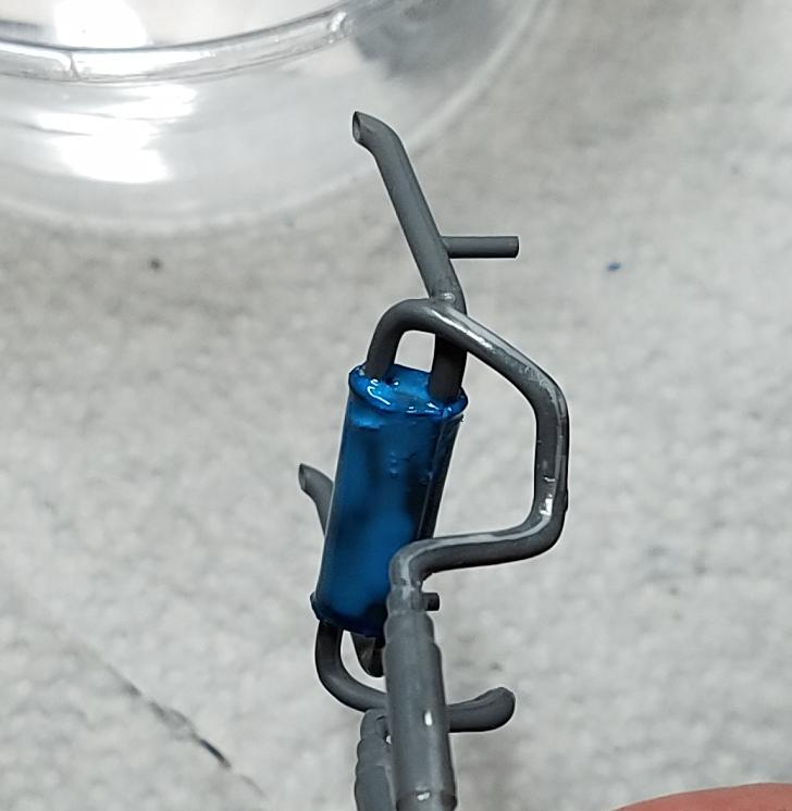

Ended up hand painting the seats and they came out pretty good. Got a decent result applying the Abteilung 502 liquid mask to the ends of this muffler with a toothpick. That allows me to be accurate enough so that trimming with a knife isn't needed, and the stuff comes off very easily. Only remaining problem is that if I use a brush for larger areas I can't clean the stuff off the brush. I emailed Abteilung 502 and they said to use acetone. That doesn't work at all. Neither does laquer thinner. Two brushes in the trash so far. I'm using q-tips until I find out what will clean the stuff from a brush. Anyone know?
Last time i used a brush with it i got it out the brush by using back end of xacto blade, and pulling through the hairs, but it will still mess up the brush.  Either use disposable brushes that are cheap or disposable micro brushes or silicone brushes < comes off super easy on those.
I dont have any experience with Abteilung, but I have been using Ammo Ultra liquid mask. I also lost a couple of brushes when I tried to paint it on. But I have been using a toothpick. I just push it up to where I need it. Clean the toothpick off every once and a while. Ive had pretty good success with this method.
But my first efforts are always tape, then fill in hard places or really small places with the mask
Same here. It's good to have the liquid stuff as a backup method. I'll stick with the toothpick/q-tip method so as not to waste any more brushes.
Does "Abteilung 502" smell like ammonia?  If yes, then it is latex (natural rubber).  I'm nor sure what would remove it from brushes.  I use latex-based liquid masks, and I apply them using toothpick (but I never mask large areas - I do those with masking tape).
