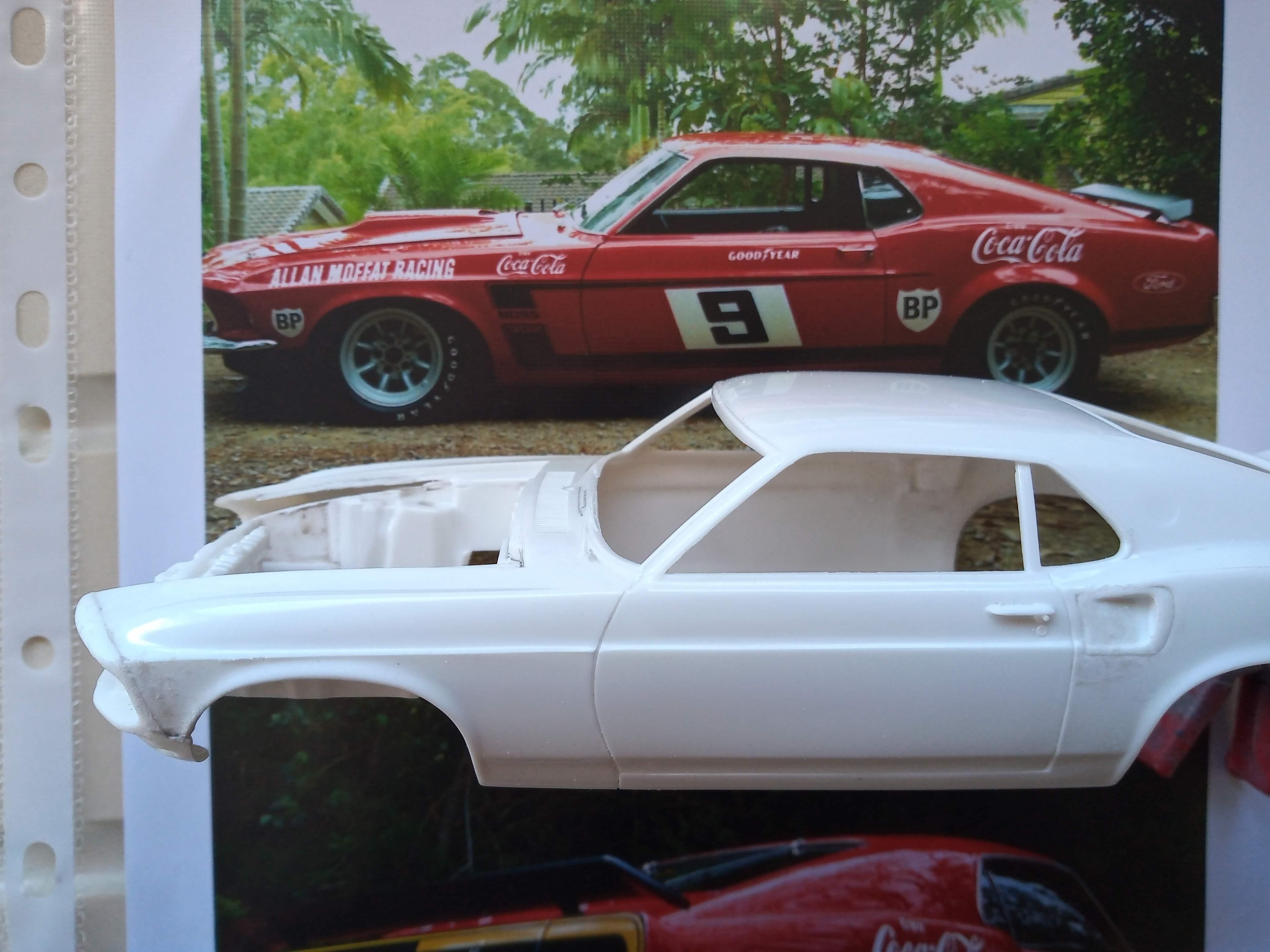

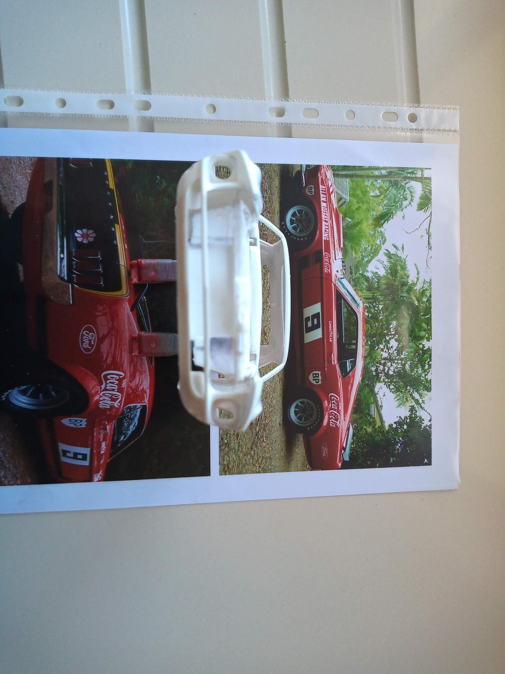

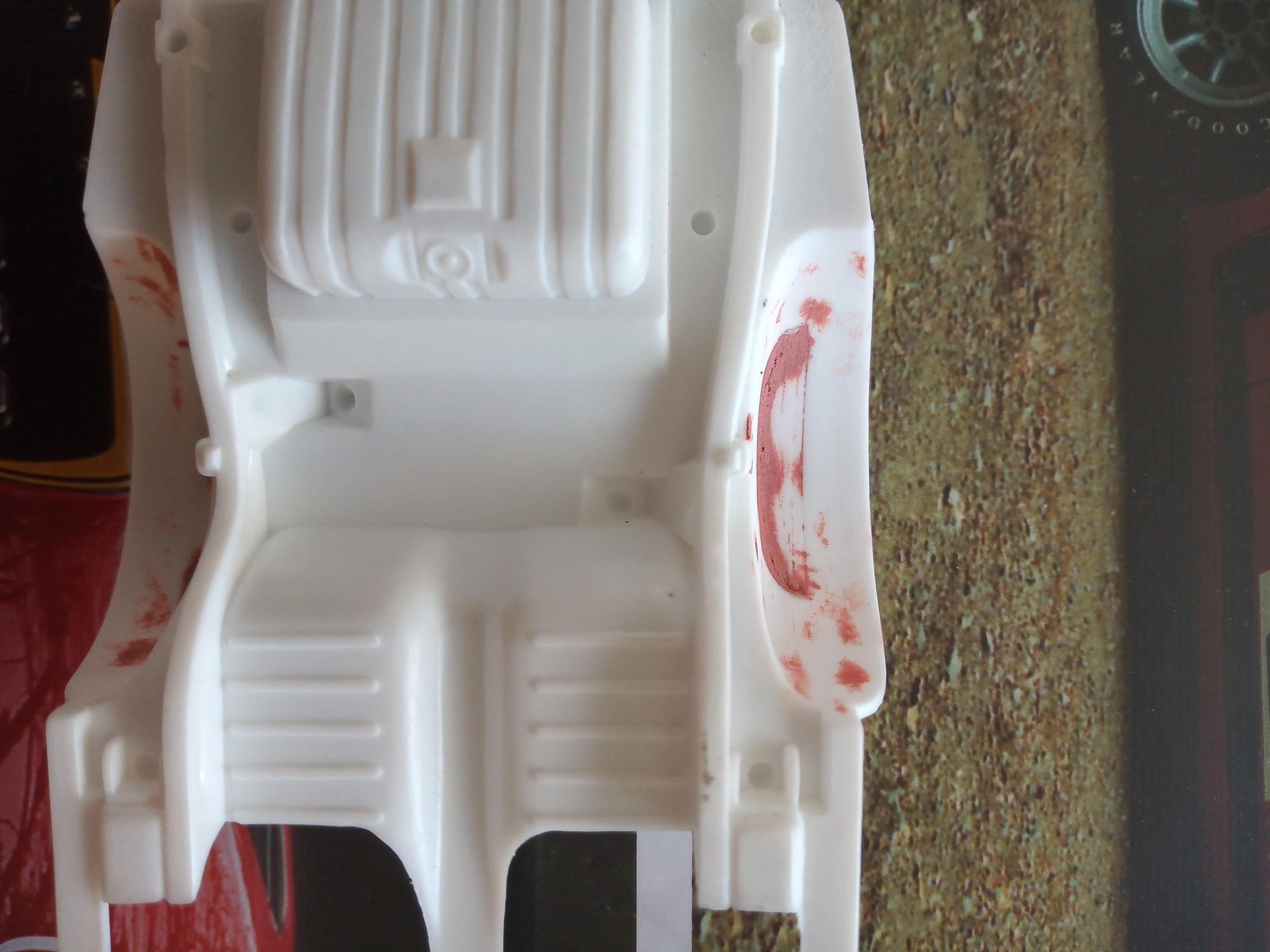

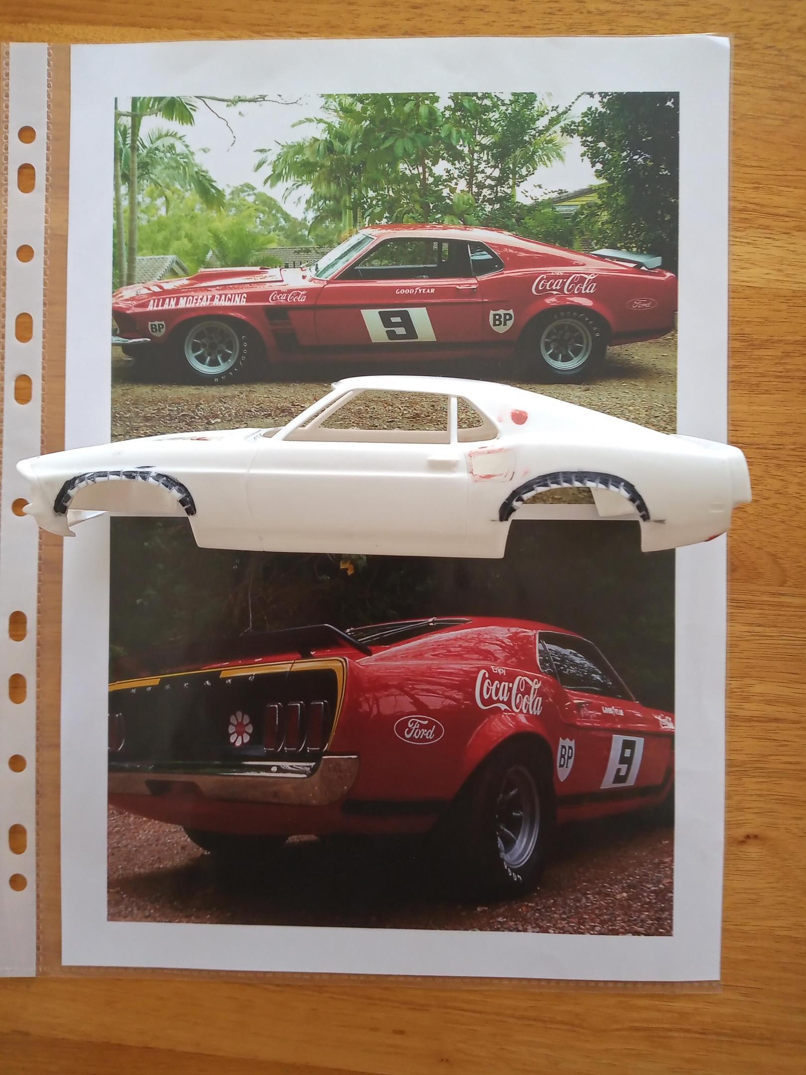

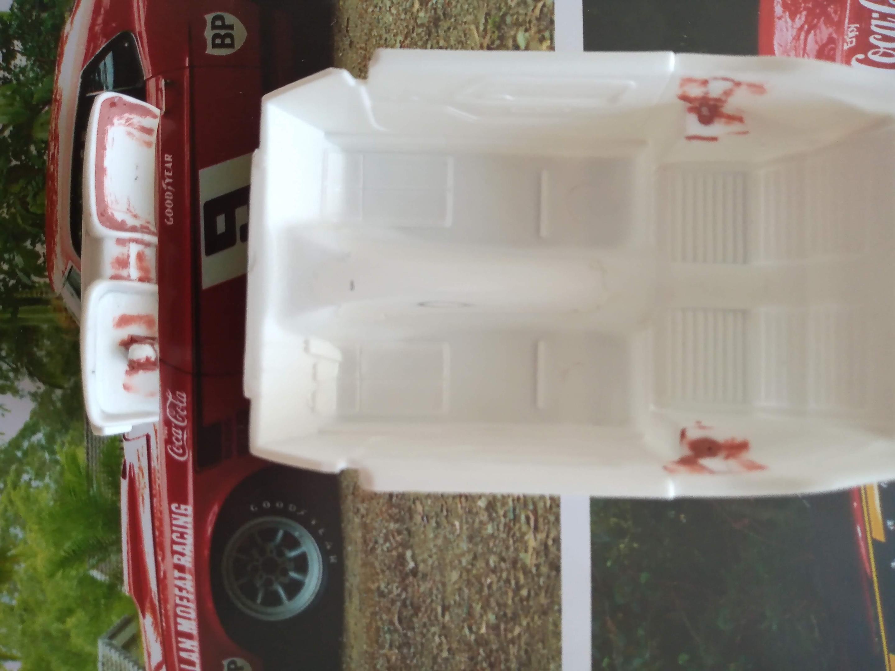

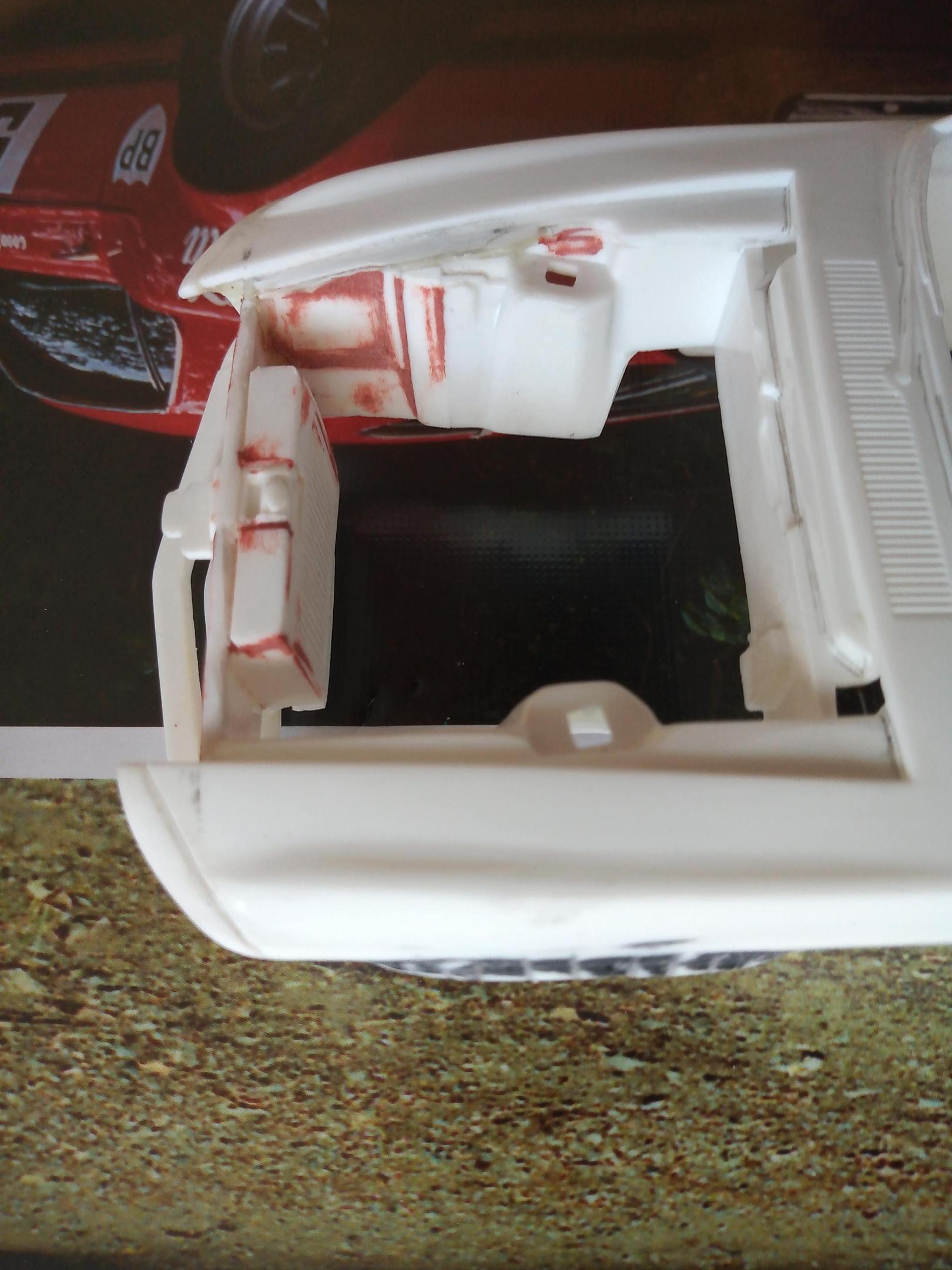

Dave B Posted January 30, 2023 Author Share Posted January 30, 2023 Just an update. Body Pie cut scale 2" from radiator support panel to shock tower and using a hairdryer pulled the body down. Replaced front inner guard passenger side Replaced radiator support panel passenger side Cut each wheel arch 14 times with razor saw and gently bent out and superglued Modified radiator to reflect Kar Kraft design Removed fake brake scoops Chassis Inner halves of rear wheel wells moved inboard Lower subframe shaved to allow chassis to sit higher (front suspension subframe notched 20mm on actual car) Interior Removed centre console Sectioned dashboard and prepared for new dash Interior panels and rear seat left as required for the Australian Series Production rules. All the hard work is now done!! Tks for looking. Dave B 2 Quote Link to comment Share on other sites More sharing options...

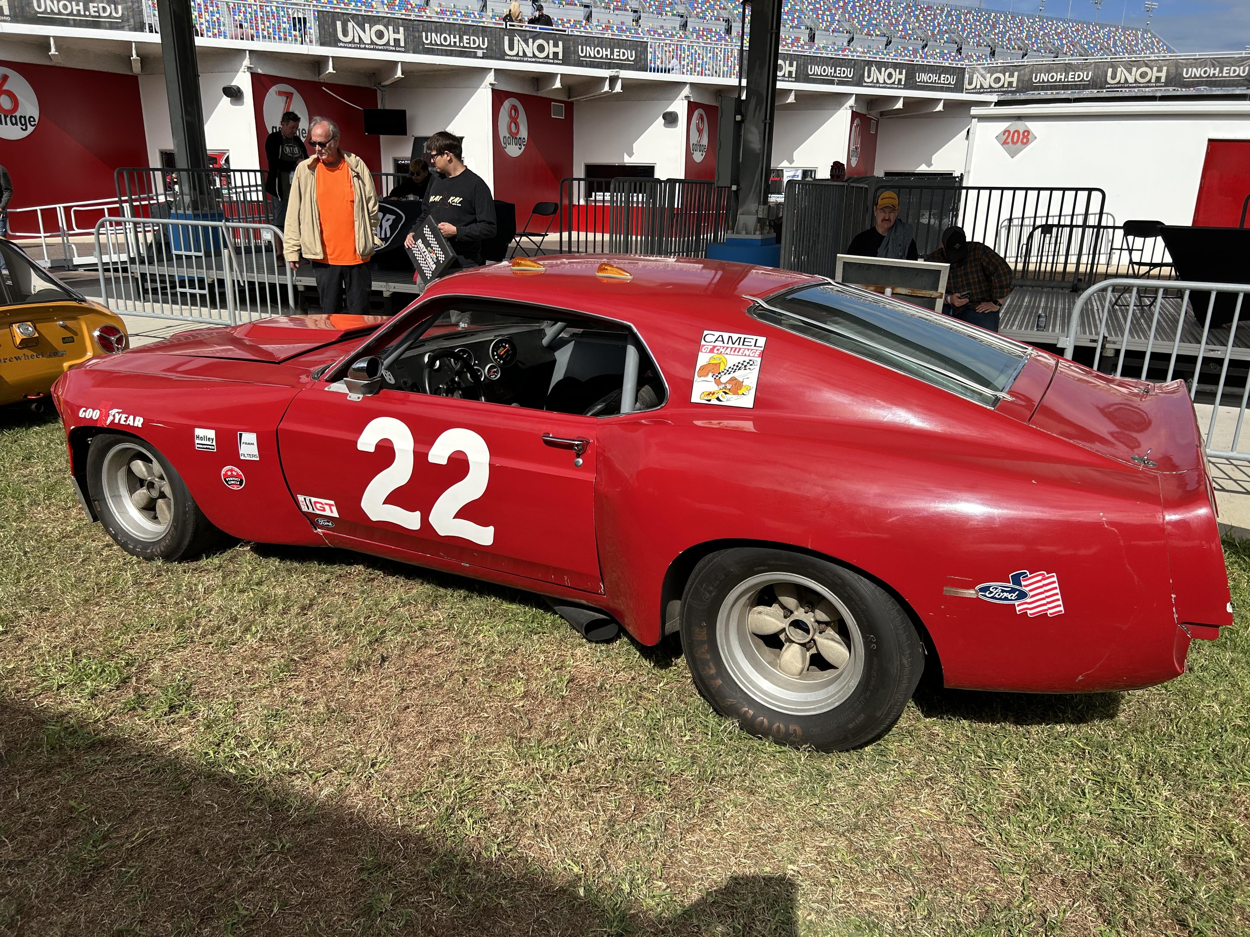

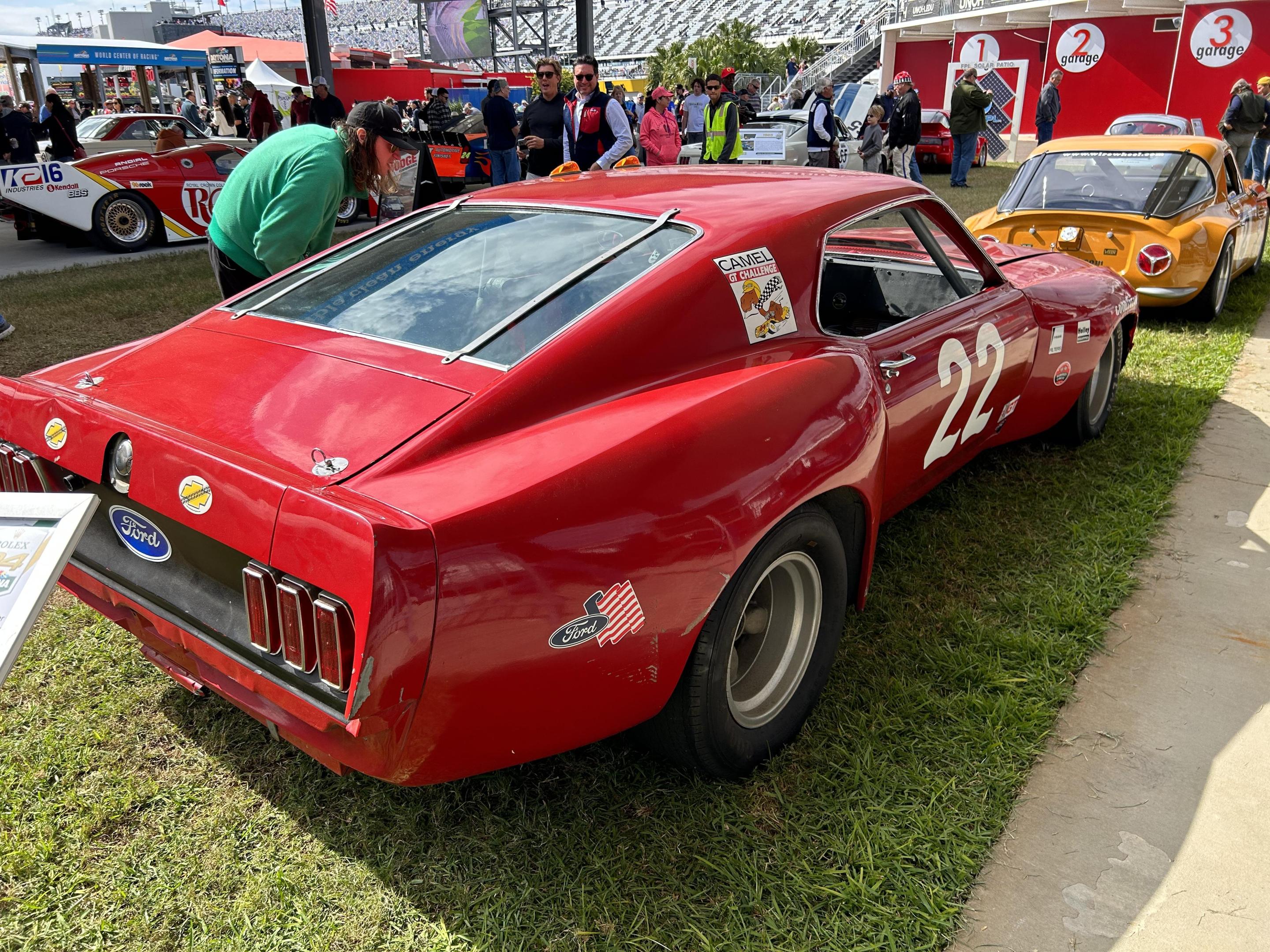

vamach1 Posted January 30, 2023 Share Posted January 30, 2023 Not the same car but I saw this one at Daytona this weekend. Quote Link to comment Share on other sites More sharing options...

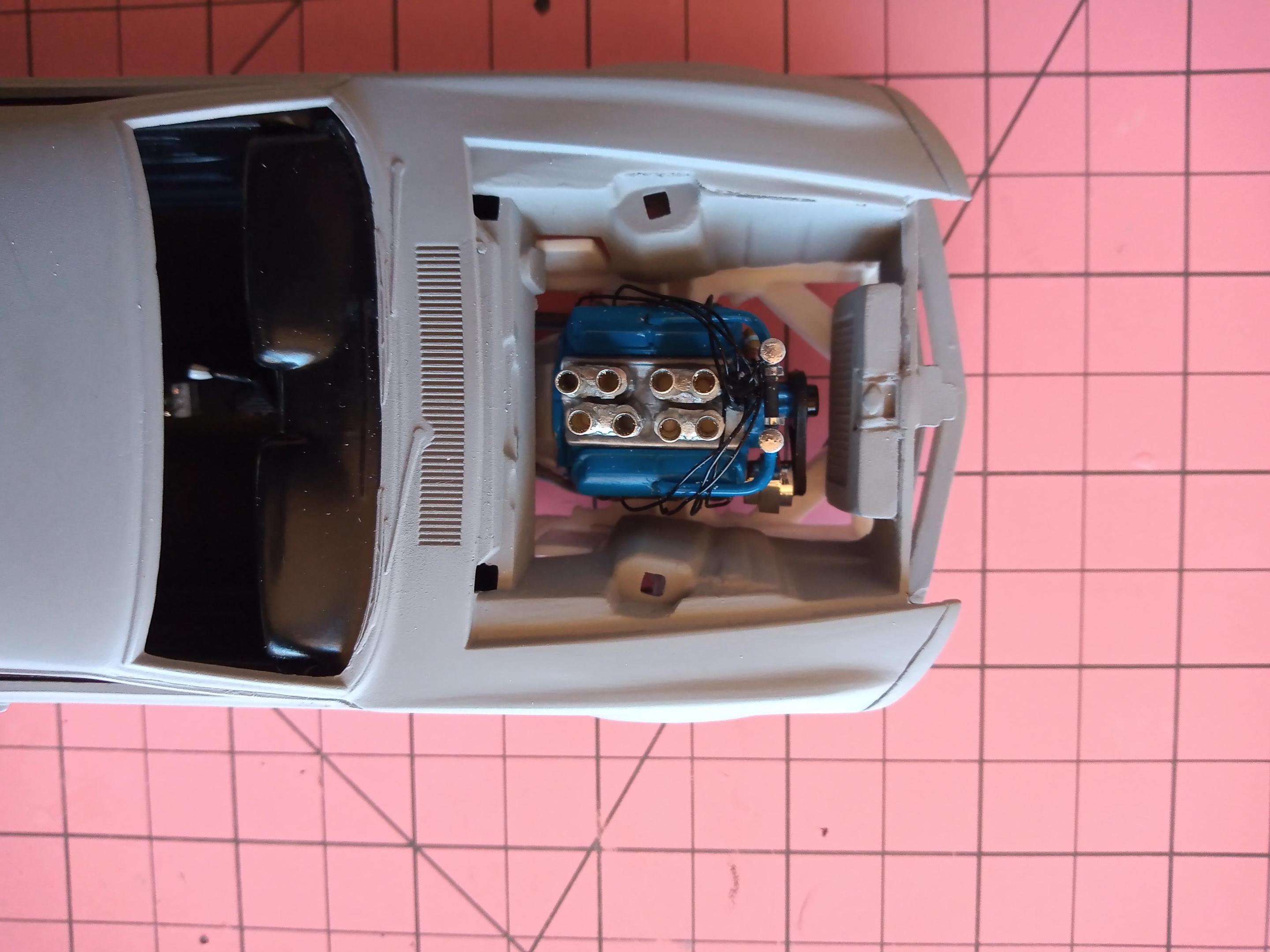

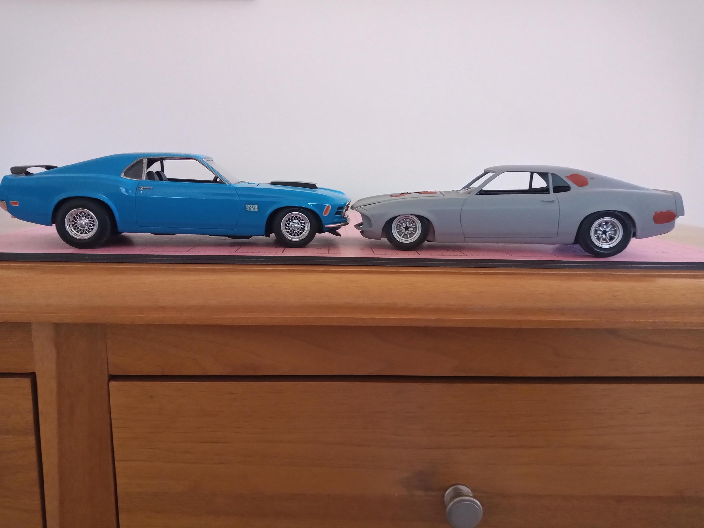

Dave B Posted February 22, 2023 Author Share Posted February 22, 2023 Finally got the Kar Kraft rake how I want it and have finished the webered 302. Dave B 3 Quote Link to comment Share on other sites More sharing options...
Pierre Rivard Posted February 22, 2023 Share Posted February 22, 2023 Your work on the fender flares looks very smooth. I tried the method once and did not achieve as nice a result. Did you make your own Webbers? Quote Link to comment Share on other sites More sharing options...
Smilesperhour Posted February 22, 2023 Share Posted February 22, 2023 Those arches and front wings look great! Quote Link to comment Share on other sites More sharing options...
Dave B Posted February 23, 2023 Author Share Posted February 23, 2023 11 hours ago, Pierre Rivard said: Your work on the fender flares looks very smooth. I tried the method once and did not achieve as nice a result. Did you make your own Webbers? Hi Pierre, yes, have some resin DCOE's and removed the fuel bowl. Pretty ordinary but it works when looking down, the trumpets are ferrules. Dave B Quote Link to comment Share on other sites More sharing options...

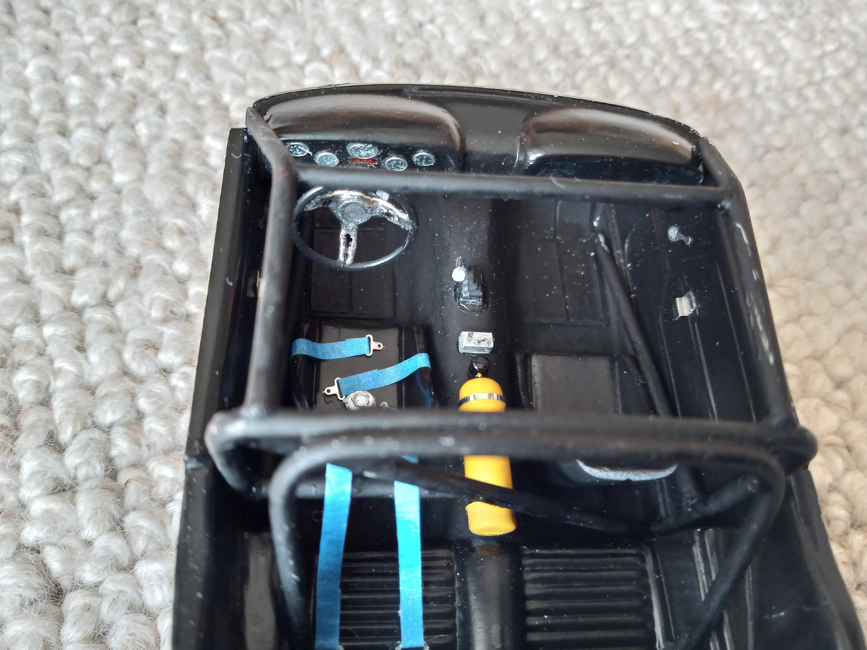

Dave B Posted March 6, 2023 Author Share Posted March 6, 2023 Finished the interior. Scratch built roll cage similar to the Moffat/KarKraft cars, photo etched window winders and home made photo etch door pulls and switch box. Body has had a couple of initial coats of paint. Will be posted "under glass" within a couple of weeks, all going to plan. Tks for looking. Dave B Quote Link to comment Share on other sites More sharing options...
