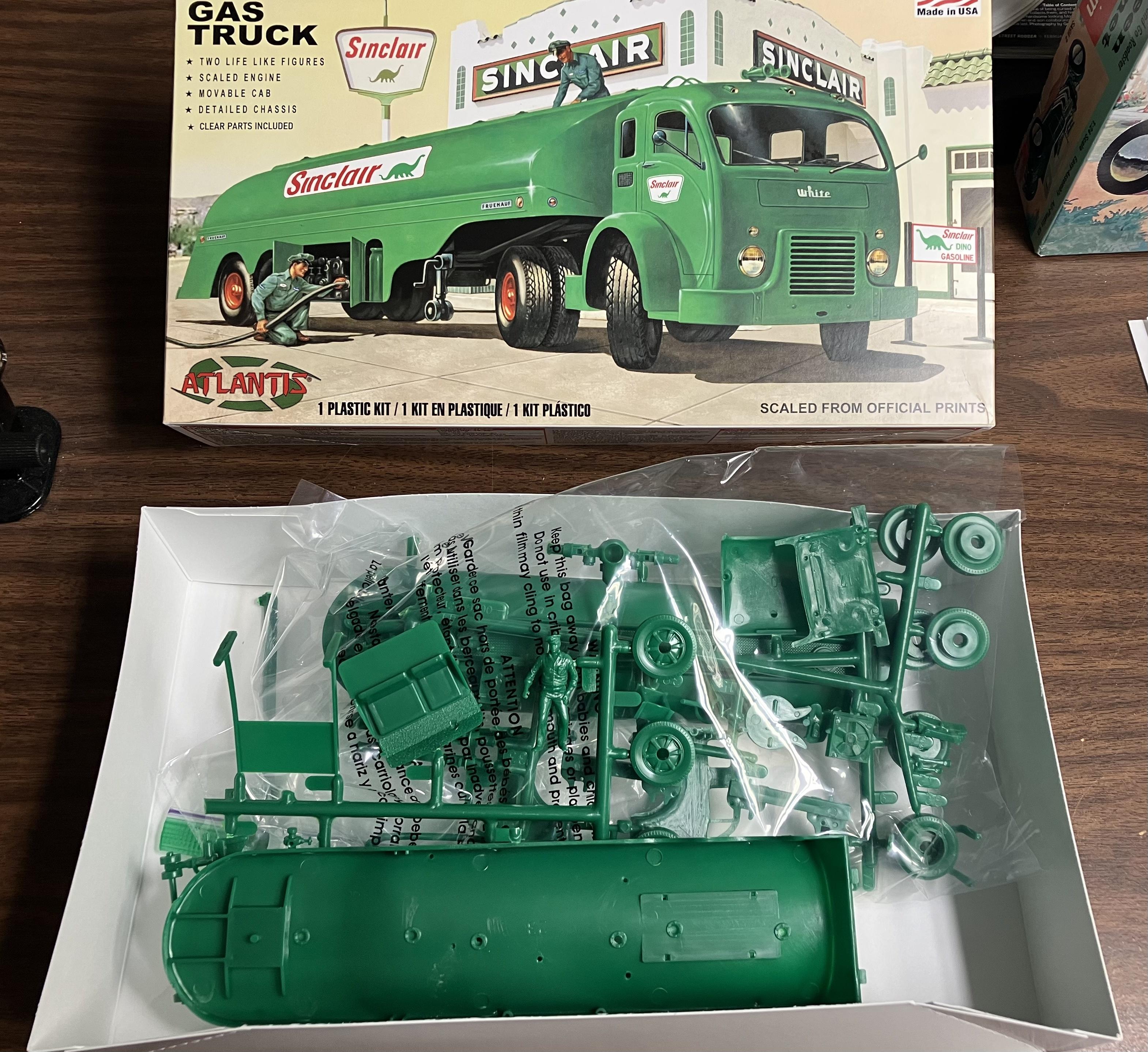

Joe Nunes Posted February 12, 2023 Posted February 12, 2023 Being one to not leave well enough alone Joyce and I went to the local model club meeting yesterday afternoon. And, of course, we rejoined the club. And, of course, I was immediately handed a printed sheet with the upcoming monthly build themes. The theme for March is Big Rigs and, of course, even with all the different big rigs I have driven over the years there wasn’t a big rig kit to be found in my model room. No problem ?, I would get a theme model at HL at 40% off and be good to go. Trouble was the only “big rig” model kit on the shelves was this Atlantis Gas Tanker kit and it is certainly not a very big model, being cast in 1/48 scale. Nevertheless, I like the style and here we are. ? Normally it takes me at least a week to open the kit box, another week to get the instructions out of the box, another week to get the bag of parts out of the box….well, that’s usually how it goes with me. I surprised myself last evening by actually opening the kit box, putting the decals in a protective plastic bag, and then starting the parts cleanup process. Stopped this morning around 2AM (???) and even cleaned one part! Thought it would be a good idea to get some sleep…? My thoughts: very nice box art, nice decals for either the Sinclair or the military tanker version, the instruction sheet is nicely drawn albeit without written instructions, and last but not least the parts look quite nice for the most part considering the age of the kit. All in all the kit looks to be a fun build. Anyone having built this particular kit, or who may be working on one of the gas tanker kits presently is welcome to join in with your thoughts, comments and photos if you would like to share them with us. So, I am looking at building this gas tanker model OOB per the box art with additional paint detailing as the build progresses. Hopefully the model will be completed by the next model club meeting…which, for me at least, is comparable to thinking Santa is going to come early this year! ?? Joe 2

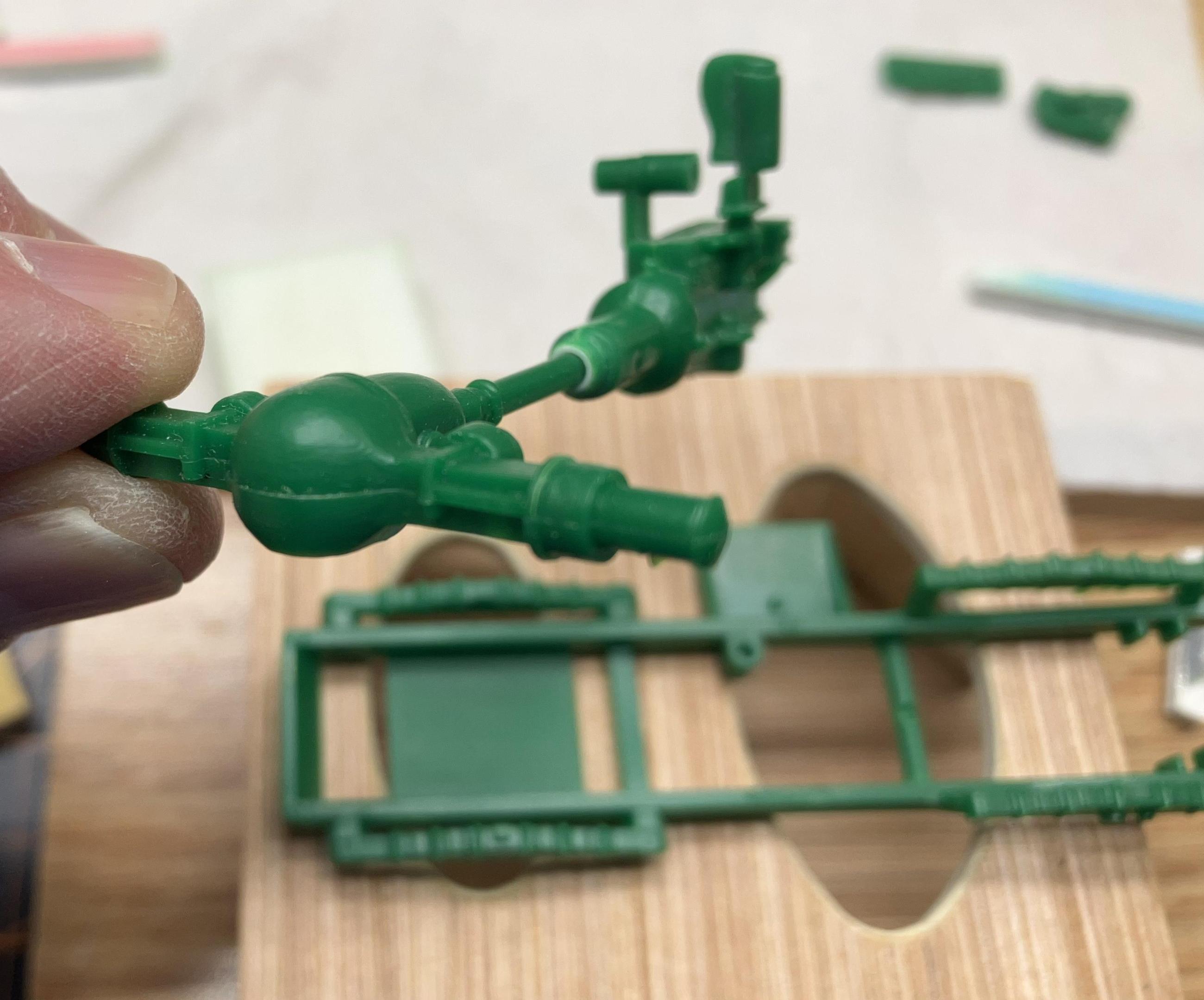

Joe Nunes Posted February 13, 2023 Author Posted February 13, 2023 Spending time at the bench doing some additional cleanup work on the parts. This is a cool model folks with a lot more detail than I initially thought would be on a kit issued many, many, moons ago. I think it deserves some extra TLC, and that should reward me with a good looking, and darn cute if nothing else, model gas tanker. ? Joe

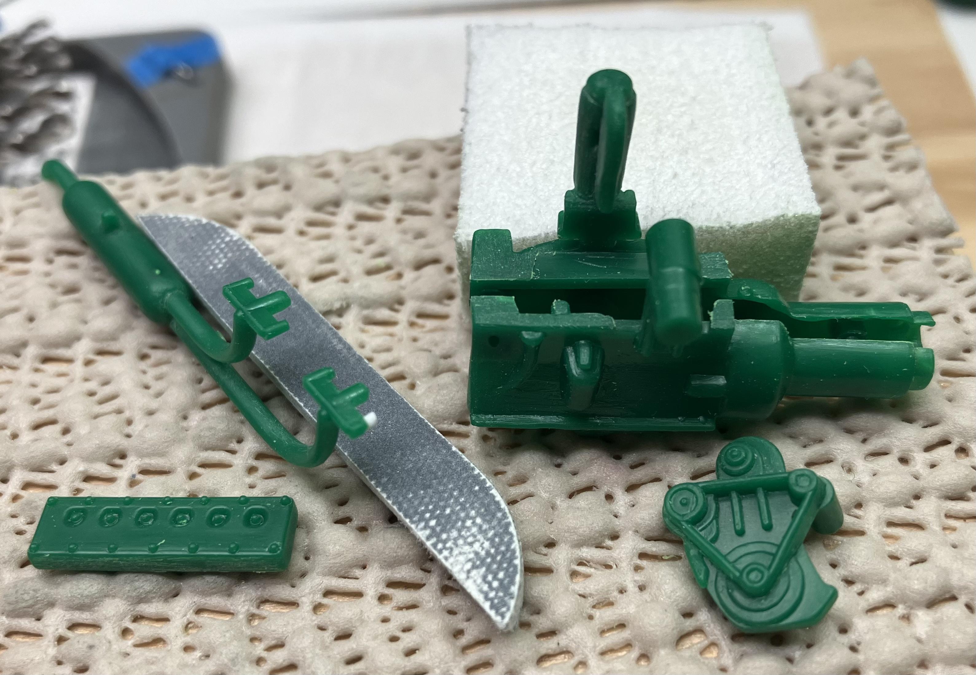

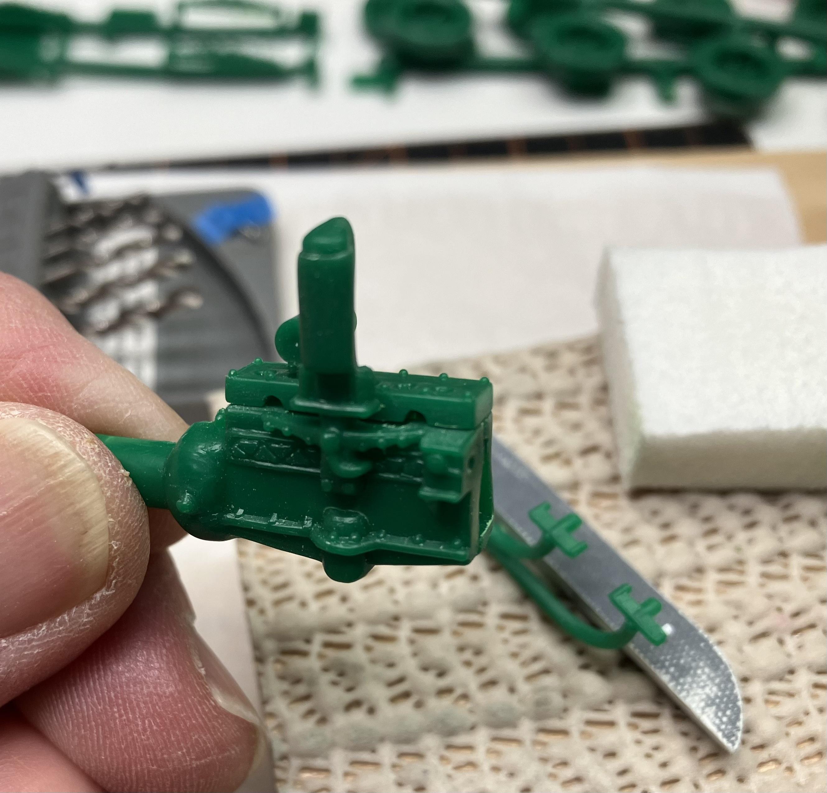

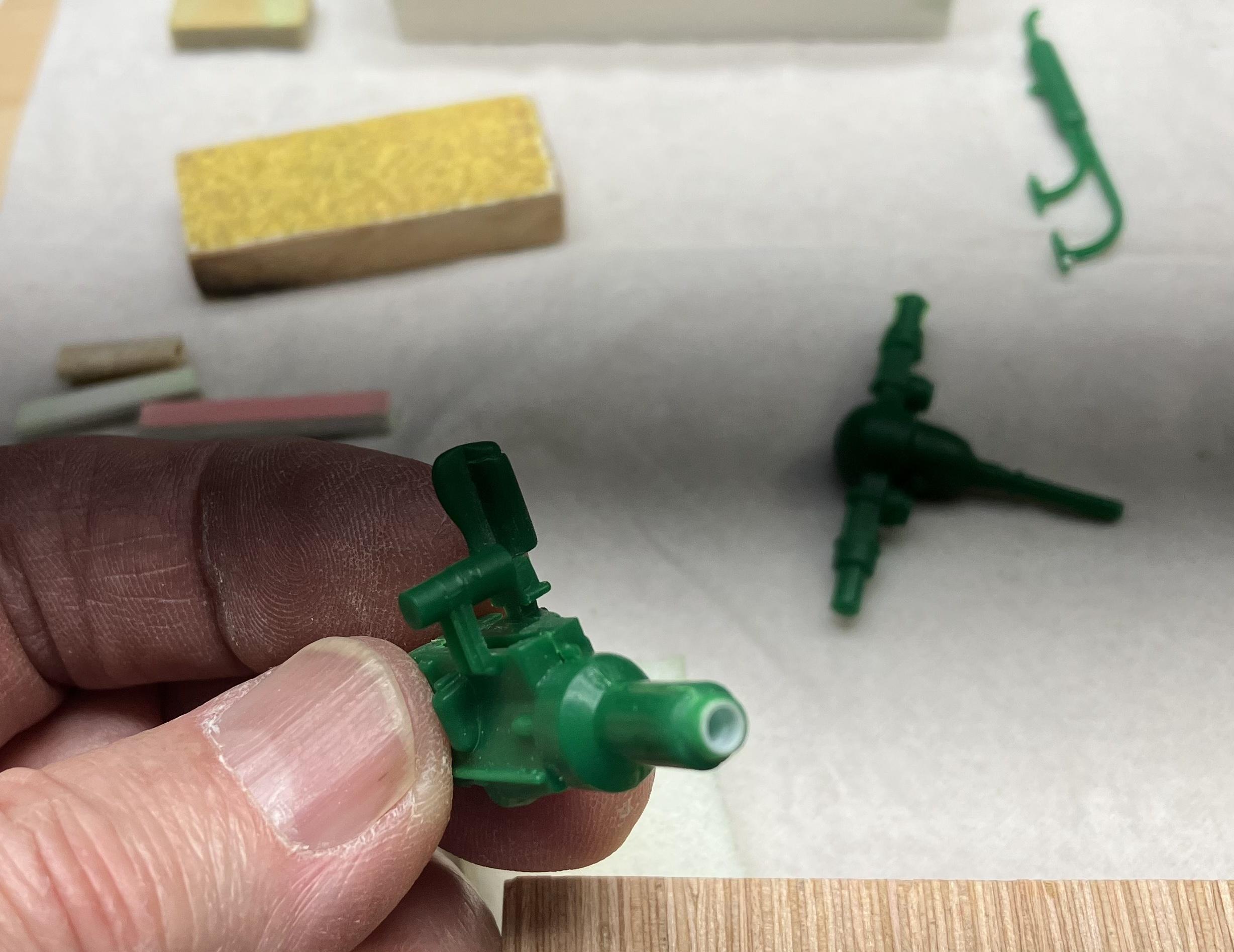

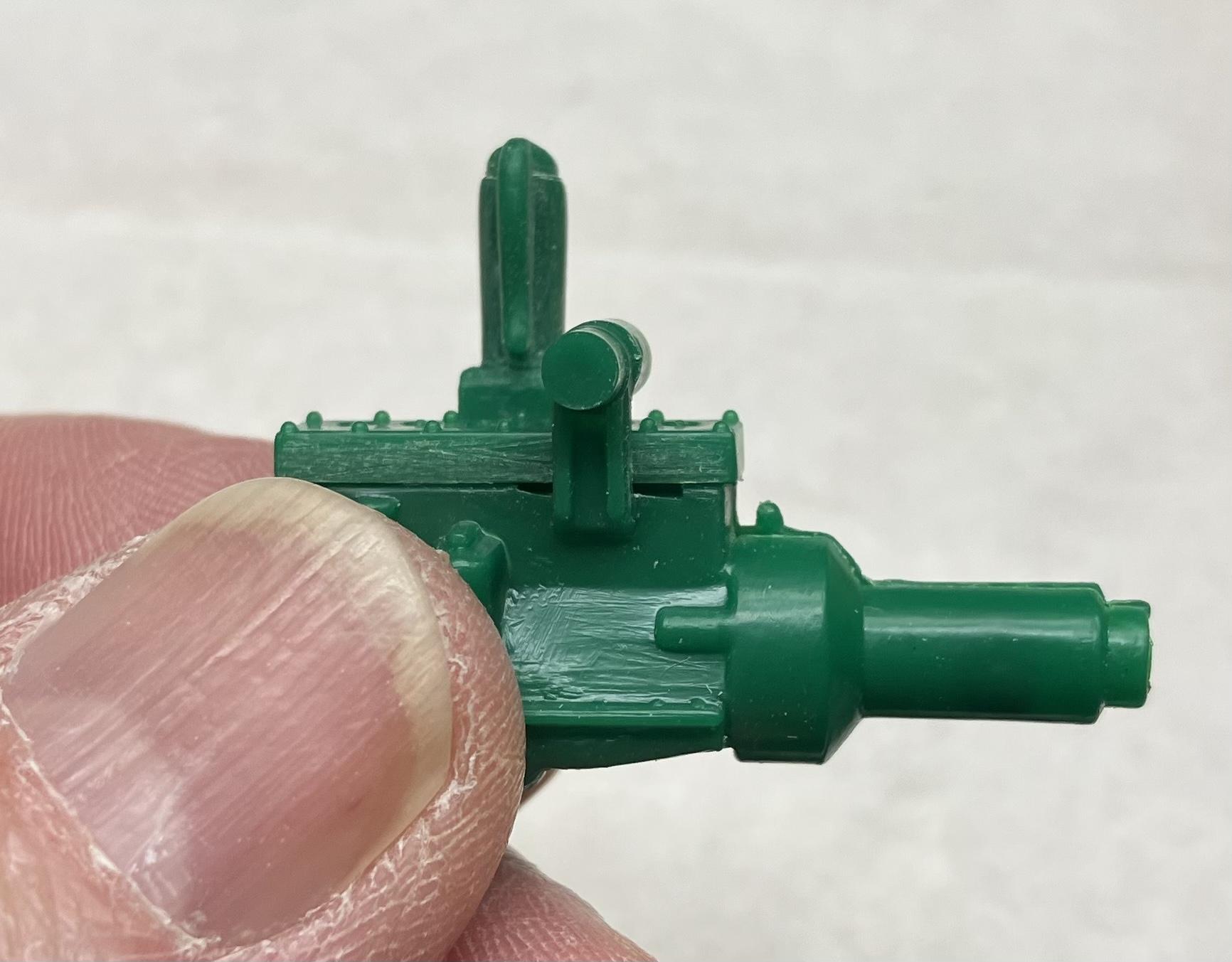

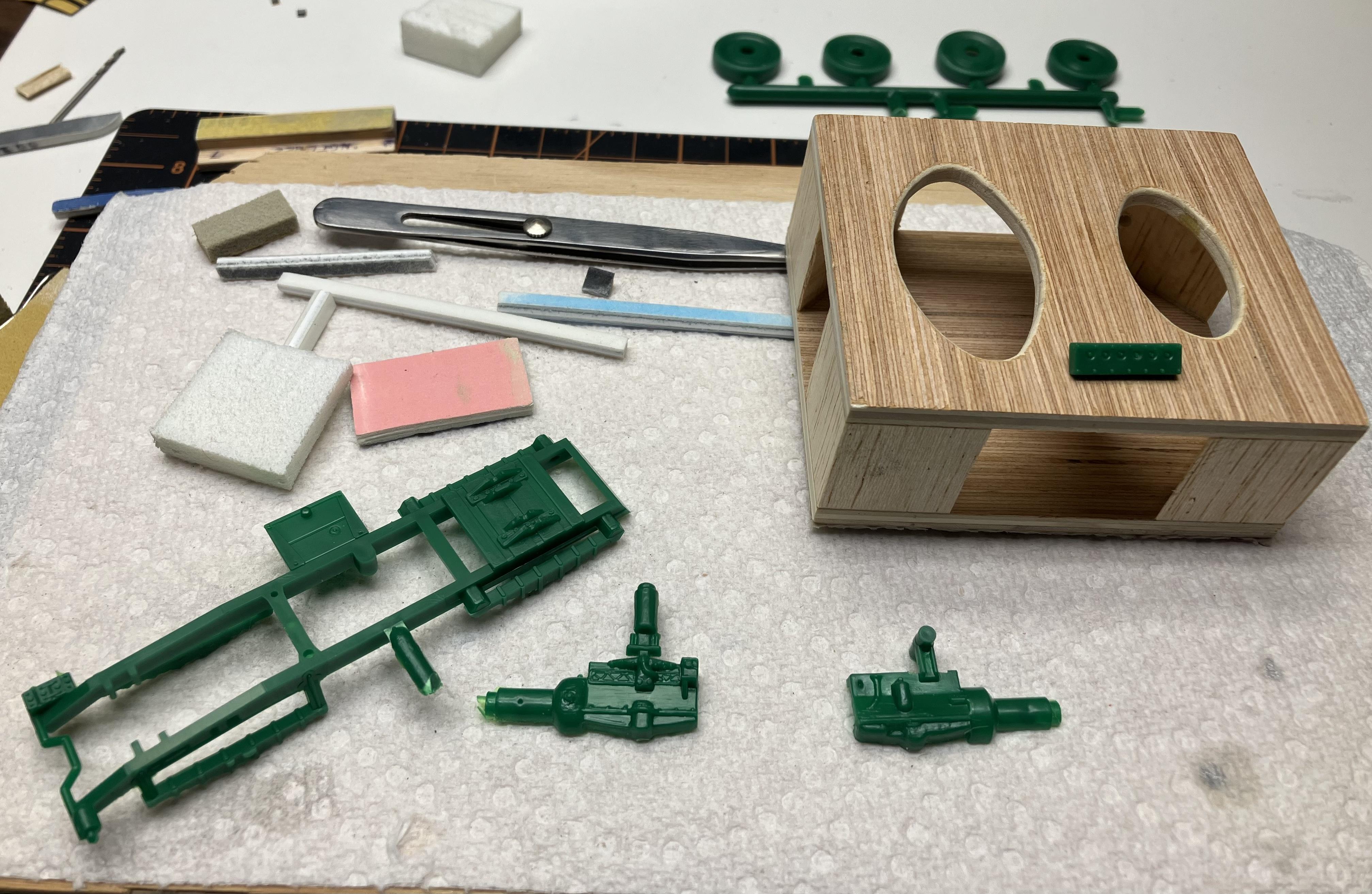

Joe Nunes Posted February 16, 2023 Author Posted February 16, 2023 Well, the honeymoon is over on this kit. ? Tonight I thought I would fit the five engine parts together to check out the fit seeing as the engine parts are now cleaned up. Only five parts here so should not take too long..; nothing fit correctly...not one engine part. The engine halves didn't fit together and I ended up drilling the receptor holes larger for the mounting pins and then fiddled around with adjusting the three location pins to line up with the pin holes. Finally got the two halves to fit properly though the detail on one half doesn't necessarily match up with the detail on the other half. More match sanding tomorrow. The head didn't fit the location openings, and, didn't sit flat on top of the engine block. Ended up sanding the top of the engine surface flat, adjusted the locating "pins" on the bottom of the head and then sanded the port side of the head so it would not touch the upright part on the port side of the engine. Now the head lays flat on top of the engine. Oh, there is an opening under the head, on the port side, that will need to be filled with a small piece of plastic...tomorrow. Then there's the front piece for the engine that wobbled from side to side until that problem was addressed. Got the exhaust piece into position and realized I needed to add a small piece of round plastic stock to one of the mounting locations in order to make it look right. Gosh...this was only five parts. It is definitely going to take a wee bit more time to build this gas tanker than I originally thought. Just thought you might want to know what I have run into thus far at the workbench. However, I am enjoying the challenge and having fun. ? Joe 1

Straightliner59 Posted February 16, 2023 Posted February 16, 2023 (edited) 5 hours ago, Joe Nunes said: The engine halves didn't fit together and I ended up drilling the receptor holes larger for the mounting pins and then fiddled around with adjusting the three location pins to line up with the pin holes. Generally, with engine halves, I sand the mating surfaces with sandpaper, on a flat surface, then align them manually. It's the easiest way to go about that particular task!? Edited February 16, 2023 by Straightliner59 1
Joe Nunes Posted February 16, 2023 Author Posted February 16, 2023 That's exactly what I did, my friend, once when the halves were originally cleaned up...and again and again when the halves were placed together with the other engine parts. ? What fun! It's all good now so onwards we go! ? Joe

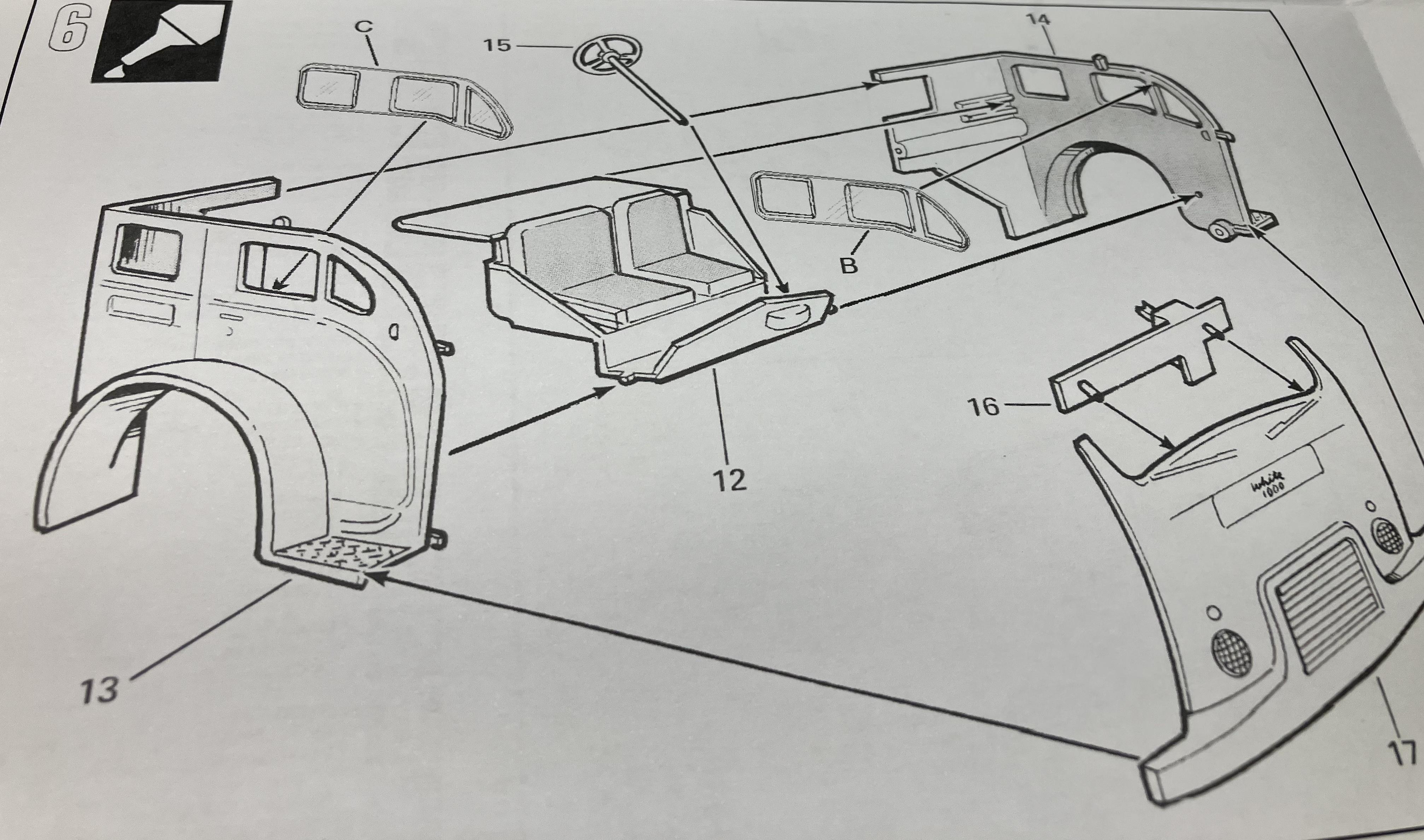

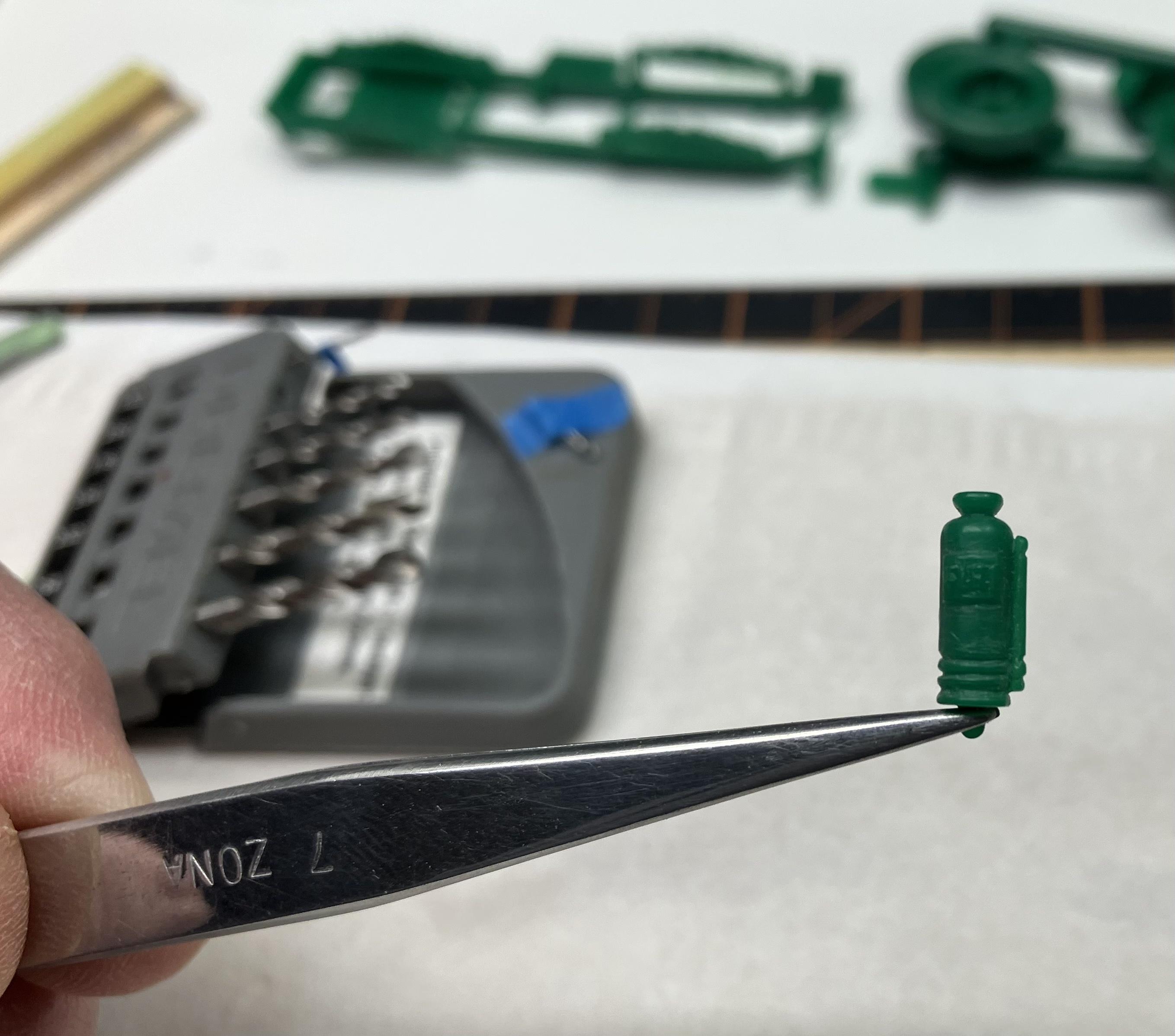

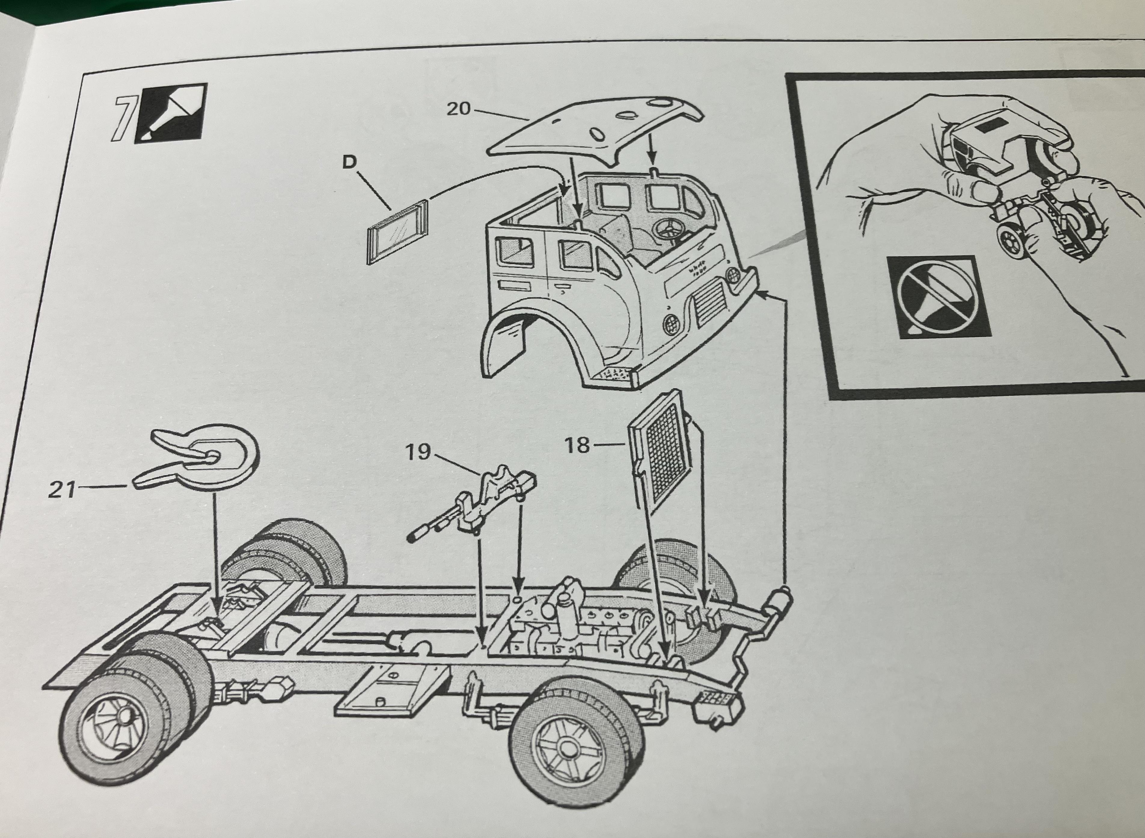

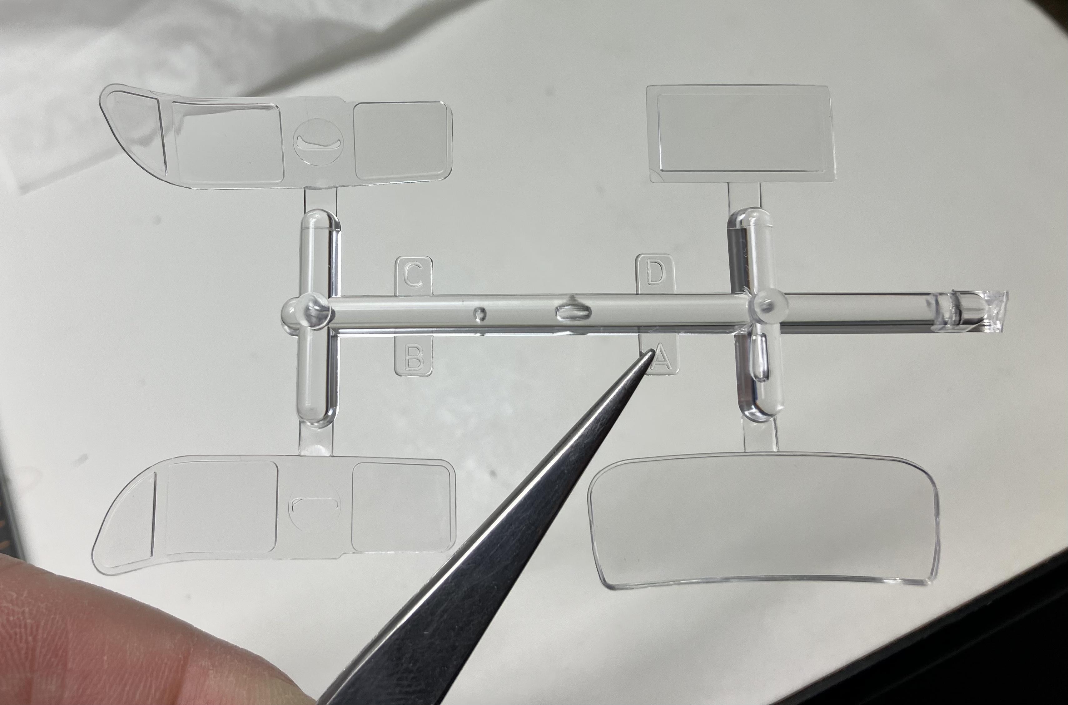

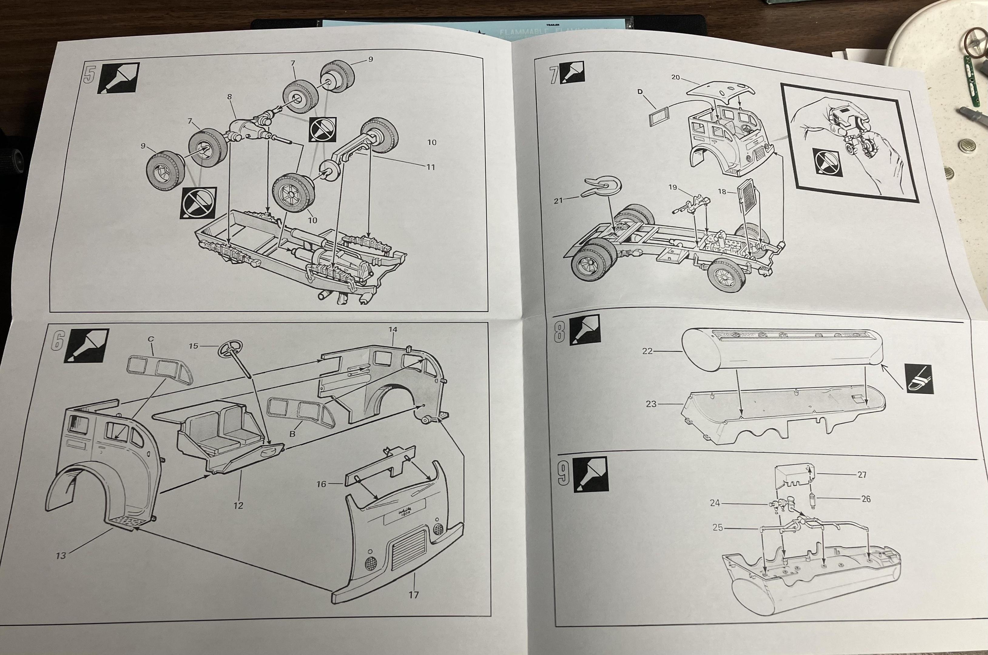

Joe Nunes Posted February 16, 2023 Author Posted February 16, 2023 Yes, my kit has the “glass” tree included which is a nice touch for the model. I took photos of the glass and instructions. You may want to check with Atlantis and see if they sell the glass tree separately if so inclined. I also took a few photos of the engine items so you can see how small the parts are, and a photo of the small fire extinguisher too, all before final sanding and paint work. ? Joe 2
Tcoat Posted February 16, 2023 Posted February 16, 2023 40 minutes ago, Joe Nunes said: Yes, my kit has the “glass” tree included which is a nice touch for the model. I took photos of the glass and instructions. You may want to check with Atlantis and see if they sell the glass tree separately if so inclined. I also took a few photos of the engine items so you can see how small the parts are, and a photo of the small fire extinguisher too, all before final sanding and paint work. ? Joe Looks like the windshield has a bit of a compound curve to it but should be able to get a flat piece to work. It will be years before I ever get to it though. That looks like some beautifully molded glass and it is obvious it is much newer than the old parts. Do your figures have big gapping holes in their torsos? Mine look like the truck exploded and there were fatalities. As much of what I have done in the past is aircraft I am used to working in the 1/48th scale. In fact I bought this kit specifically because it was 1/48 and would work with the early jets.

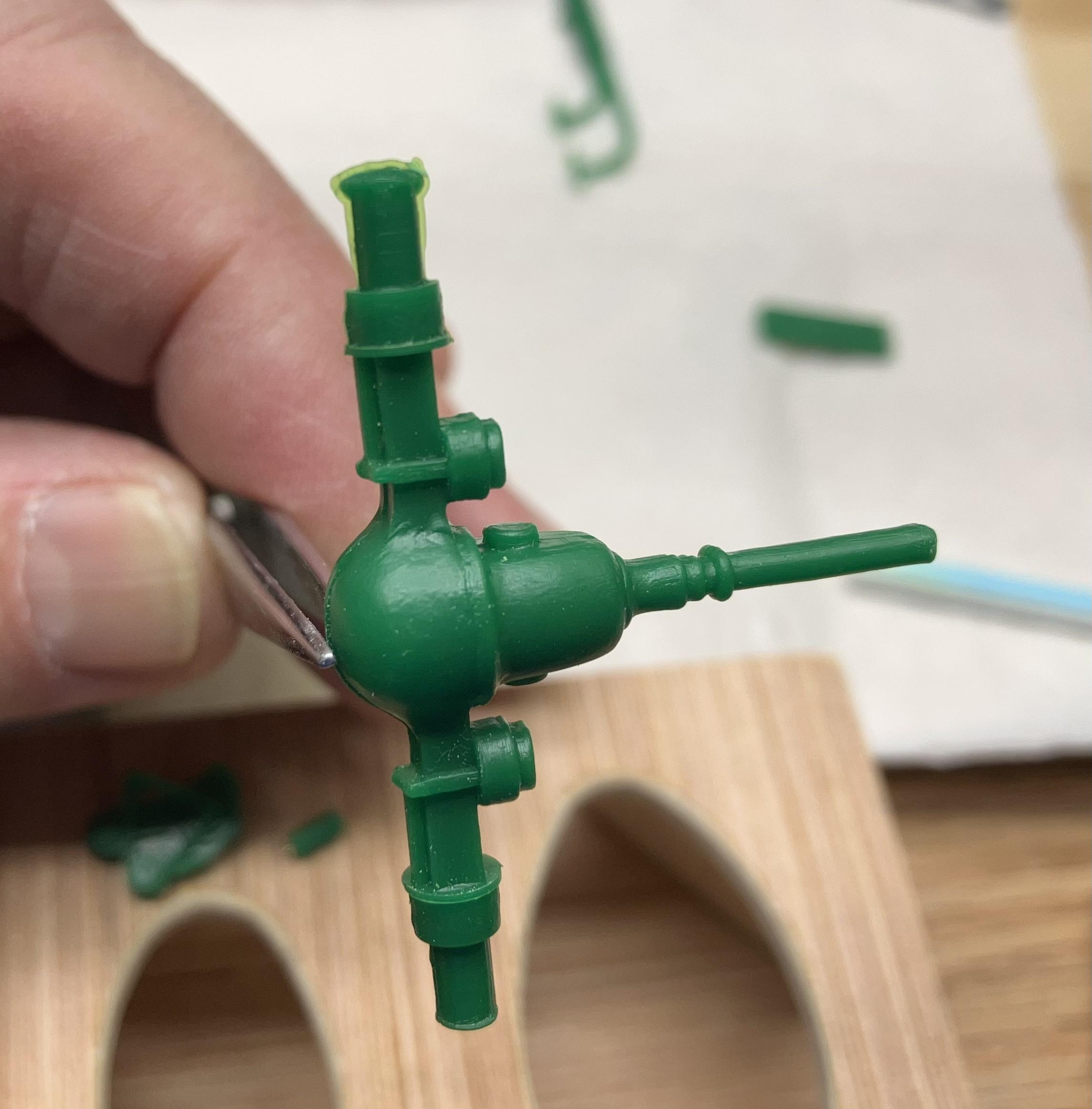

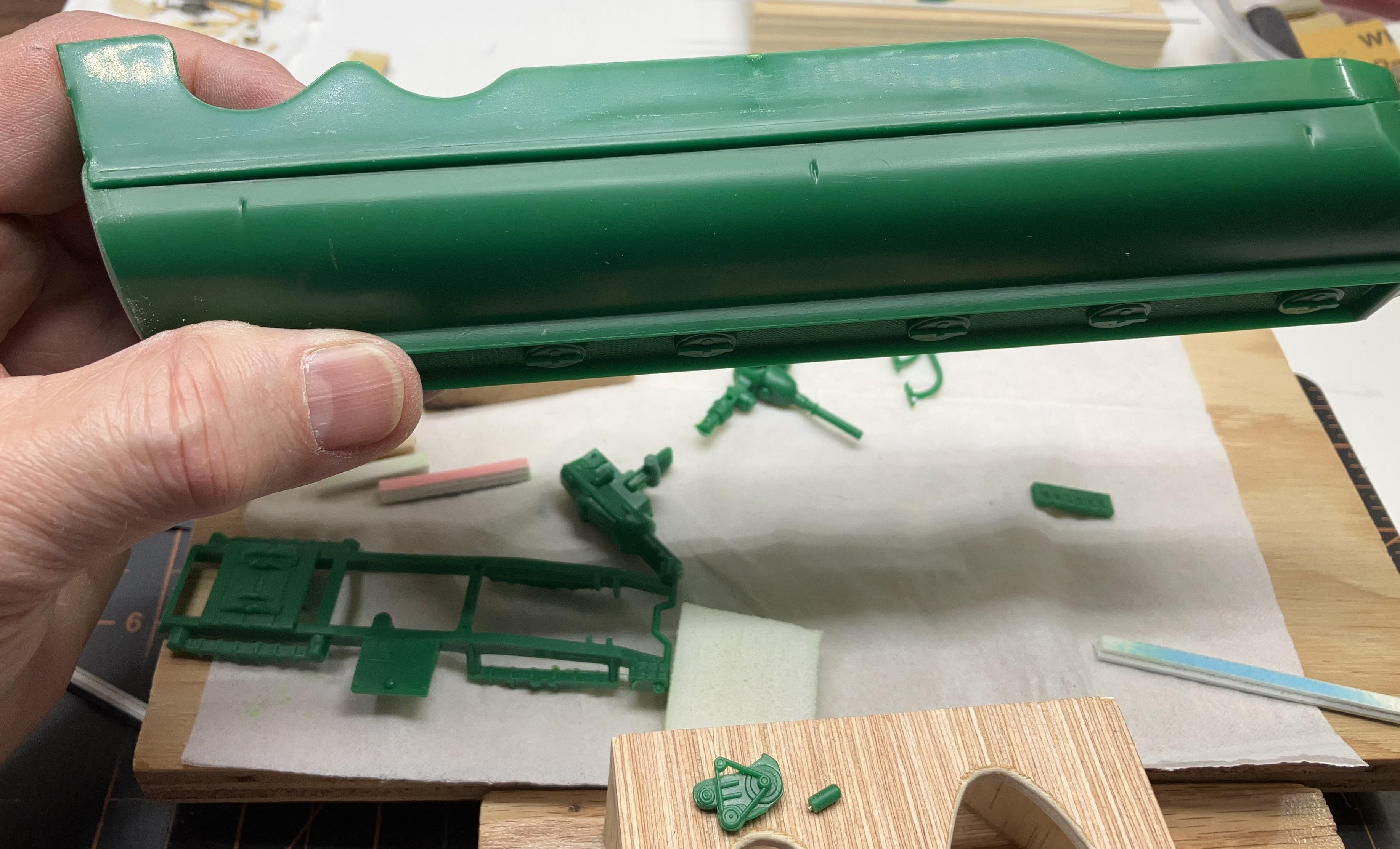

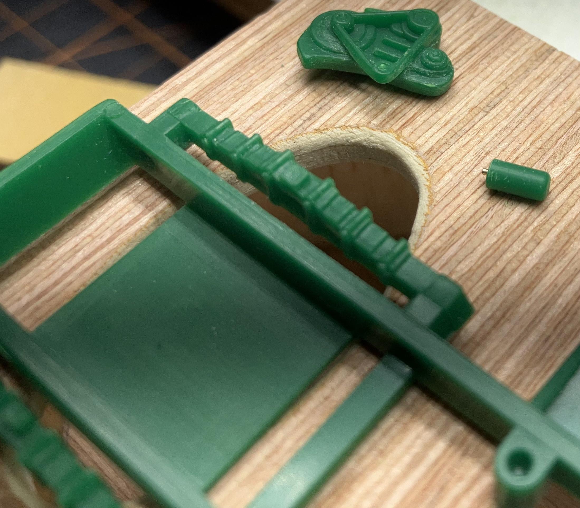

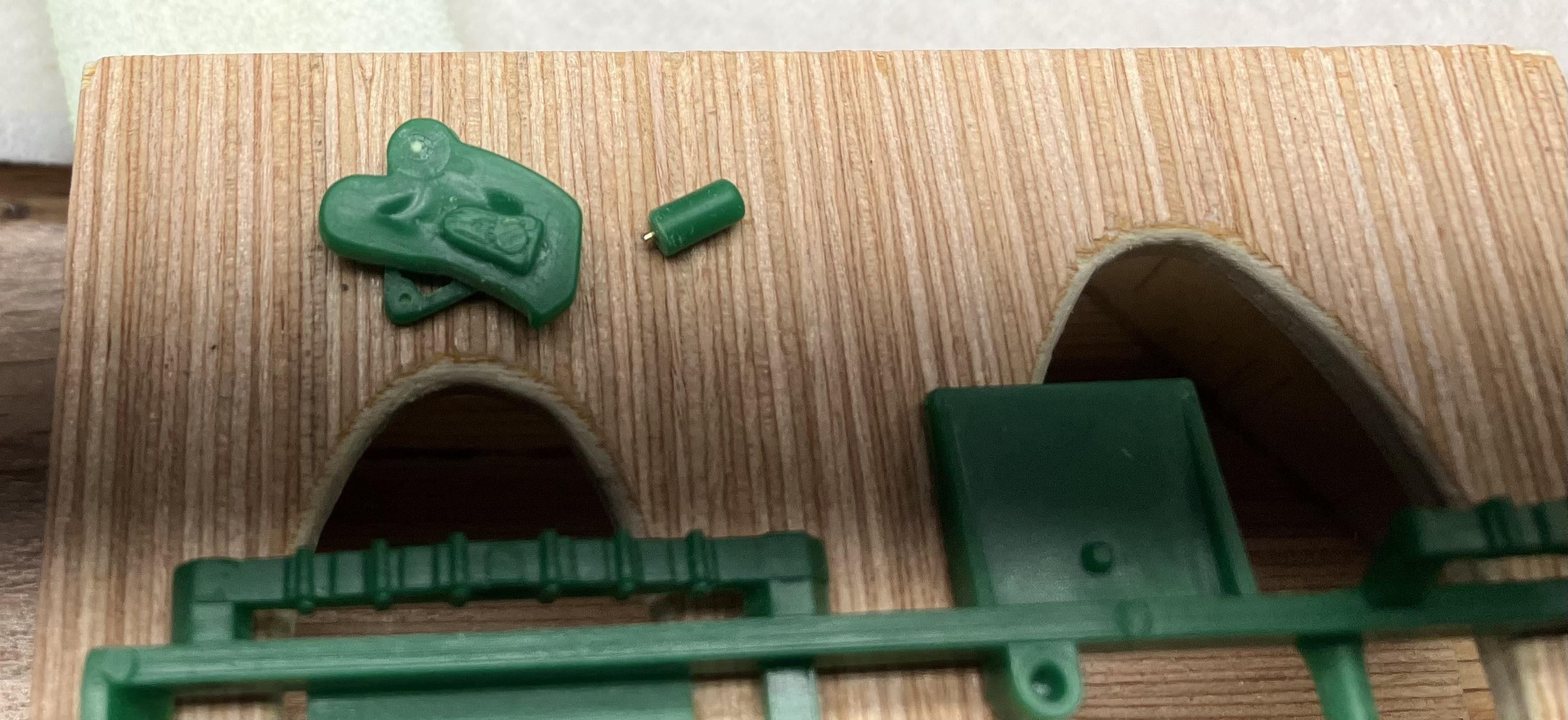

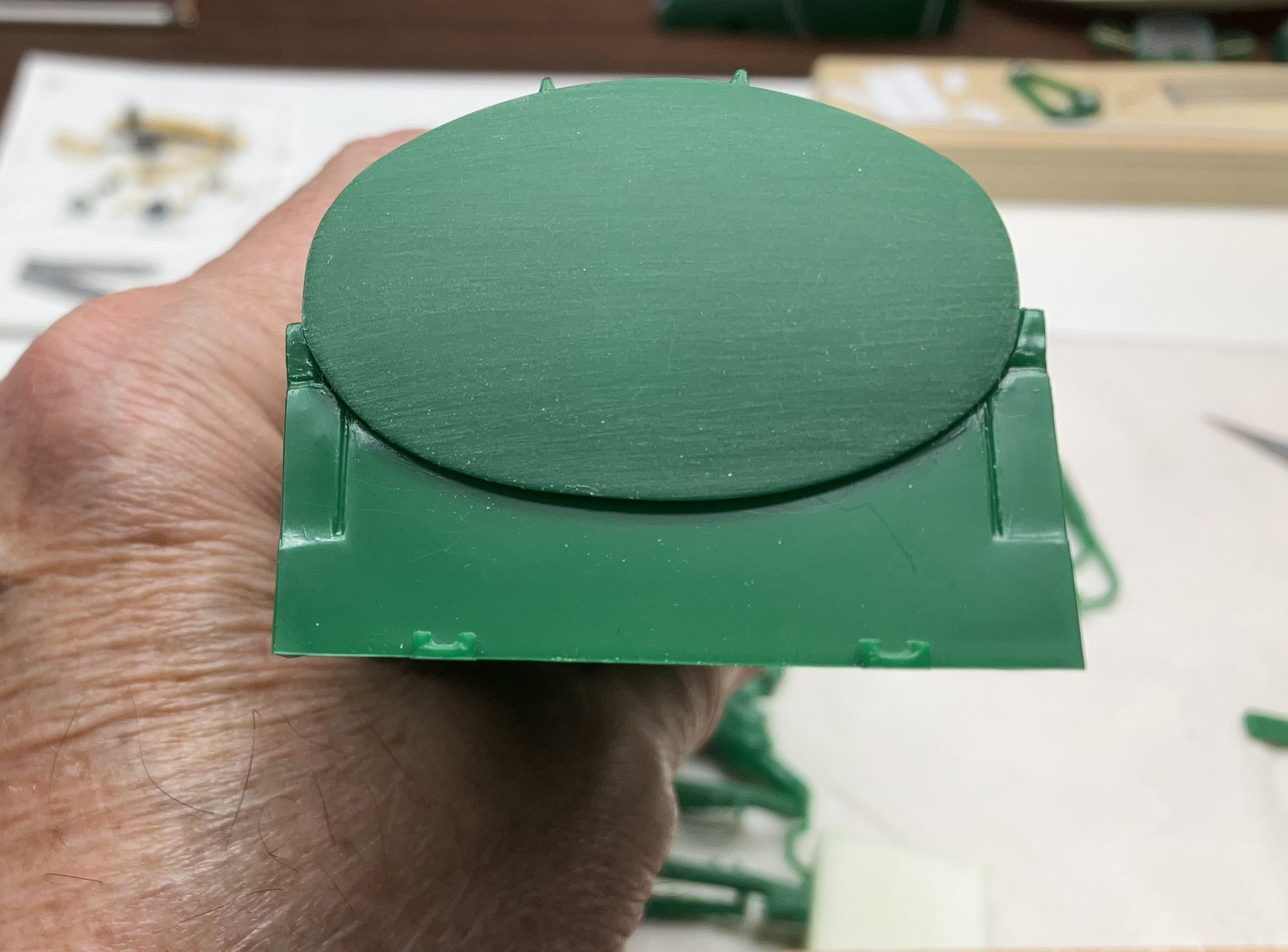

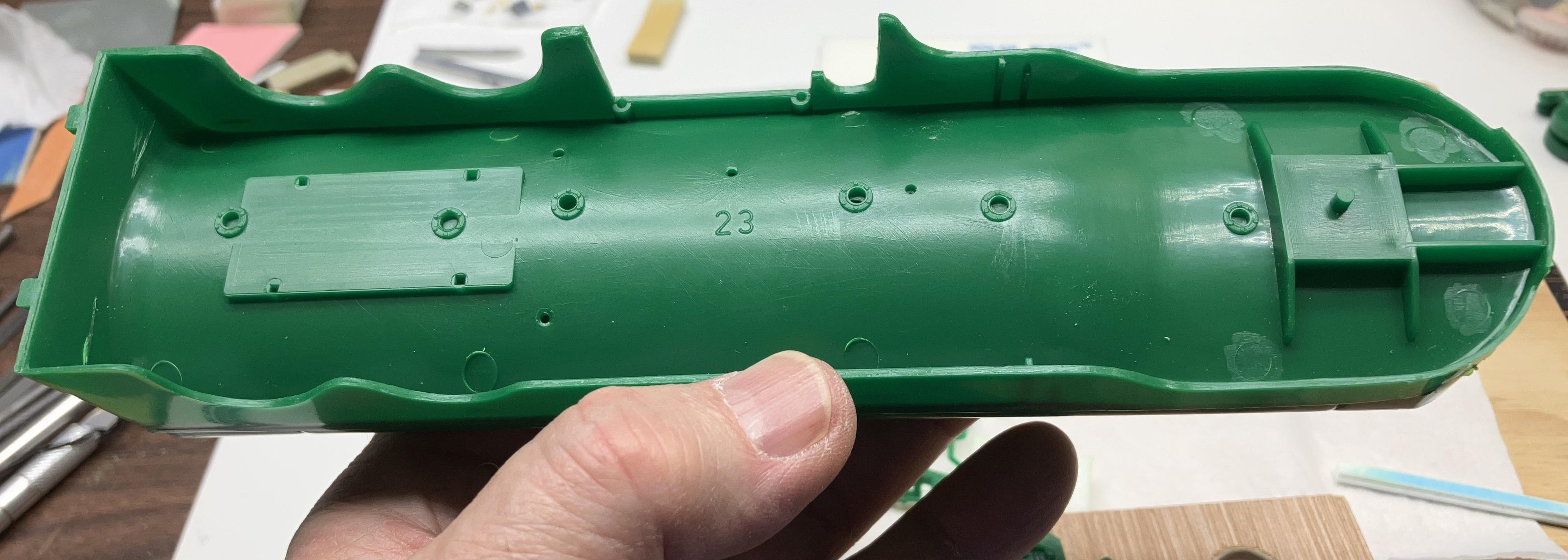

Joe Nunes Posted February 21, 2023 Author Posted February 21, 2023 Have been continuing the cleanup task on the model parts. Added a bushing piece to the back of the engine because the opening was too large for the driveshaft. Cut off the mismatched generator from the engine frontal piece, redefined the generator location, added a pin locator to the generator and carved the thick engine belt down to a more realistic size. Got the engine front piece to fit square to the engine block and now the generator fits in there correctly. There’s another cylindrical piece on top of the engine that is also mismatched and I will address that situation in the same way. Have been cleaning up the cab frame and axles and they’re starting to look better. Started on the tank, which is two large pieces and it has a lot of short shot/sunken areas that will require attention. The rear elliptical panel was low all the way around the perimeter and I worked on it until I sanded the rear surface to a uniform surface. Still having fun with the kit though so onward I go…? Joe 3
