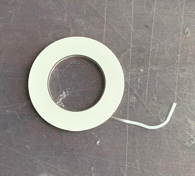

Gramps46 Posted March 31, 2023 Author Posted March 31, 2023 Trying again to paint and mask and paint the front bonnet and top of door sides. Bought a fresh jug of the purple Super Clean and took the rest of the paint off. Got out the scribe to clean out the panel lines. I am using the newly found clear front piece. Will paint the body parts with Tamiya X-2 white. Using the narrow Tamiya tape again except this time seal the mask edge with X-22 clear before painting the front panel with a 50-50 mix of X-14 and X-4 blue with my Badger 200. Forgot the Tamiya fine white primer to get a consistent base color with the tail. Let me know if you see any flaws with this plan.
Pierre Rivard Posted April 1, 2023 Posted April 1, 2023 Might I suggest taping the edge with Tamiya 2mm tape for curves 87177, if you are not already doing it. It's a plastic tape that stretches so curves are very easy to do, and thin so no bleed through. I've has good success with it.
Gramps46 Posted April 1, 2023 Author Posted April 1, 2023 I do have the Tamiya 2mm tape for curves and tried a test run and it seems to work pretty well. I also tired the 3M Fine Line tape 218 and it did not take to the curves as well I thought so once the white body color is dry I'll use the tape for curves and see how that goes. Thanks for your input.

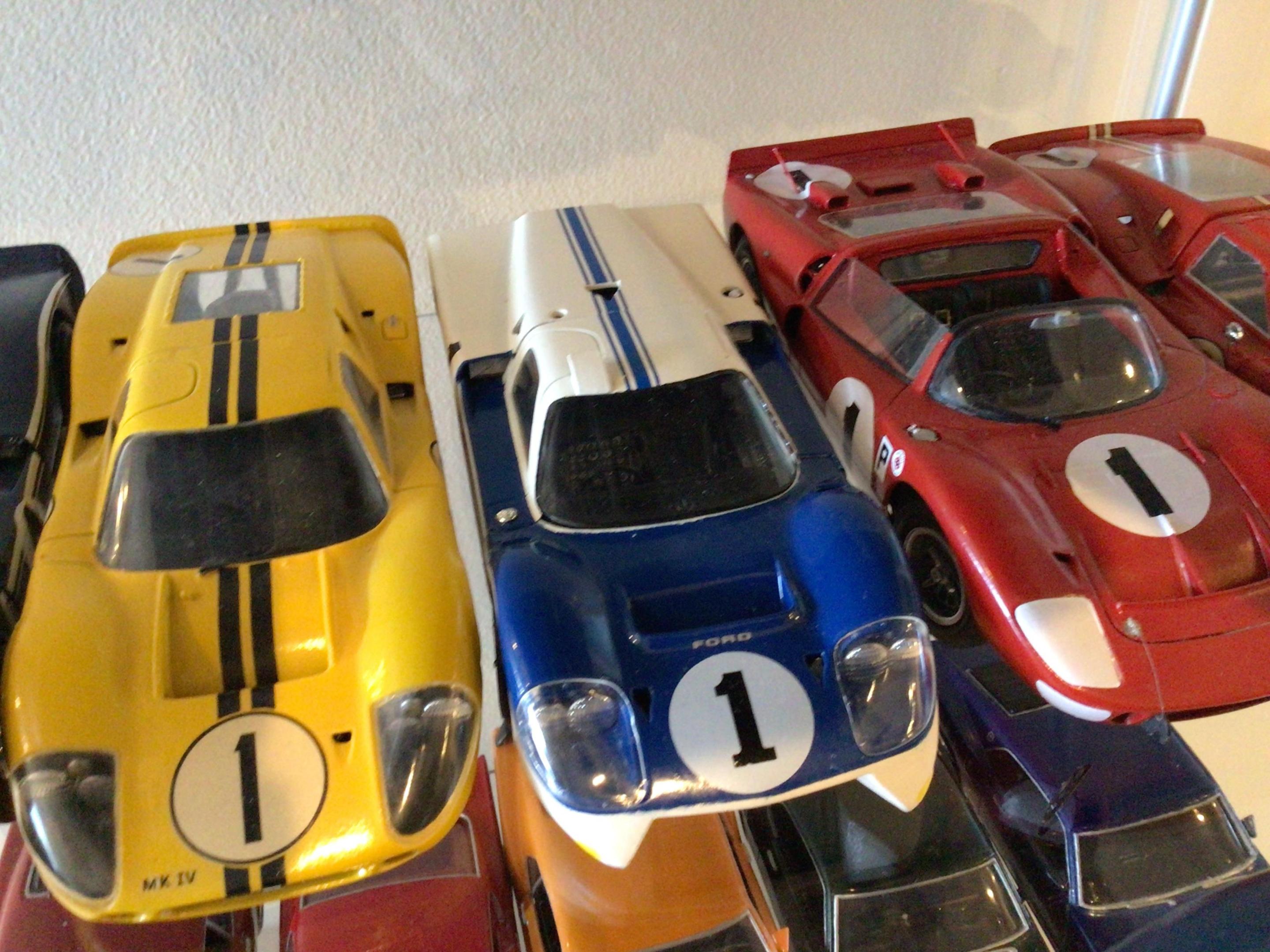

Gramps46 Posted April 9, 2023 Author Posted April 9, 2023 Finally, a paint job I can live with. I was very close to mailing the body to Montreal. ? 1 1
Pierre Rivard Posted April 9, 2023 Posted April 9, 2023 Paint looks good Gary. Now we'll start working on your photography. ?
Gramps46 Posted May 11, 2023 Author Posted May 11, 2023 Well once again I screwed up. The center stripe should be black like the sill strips, not blue. Fortunately I have a Cady decal sheet with the right size stripes. 2
vamach1 Posted May 11, 2023 Posted May 11, 2023 17 minutes ago, Gramps46 said: Well once again I screwed up. The center stripe should be black like the sill strips, not blue. Fortunately I have a Cady decal sheet with the right size stripes. Looking good. I had not noticed the black strip unti you pointed it out. I may have to go back and fix mine. 2

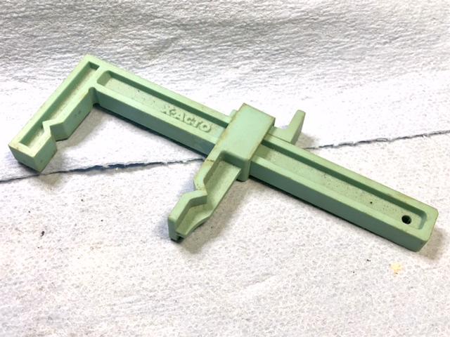

Gramps46 Posted July 25, 2023 Author Posted July 25, 2023 (edited) After over a month of searching I finally figured why the spoiler would not fit. The middle opening in the tail was too high! Fixed that and here is the spoiler mounted. Here is a mock up before gluing the body in place. And now gluing the body to the chassis using the world's oldest XACTO clamps. The next photos will be in the Under Glass section. Thank you all for watching this long project. Edited July 26, 2023 by Gramps46 4
absmiami Posted July 26, 2023 Posted July 26, 2023 My clamp says hi to your clamps - didnt these come in sets of 2? Can’t find my other clamp …. These things get Social Security … 1
