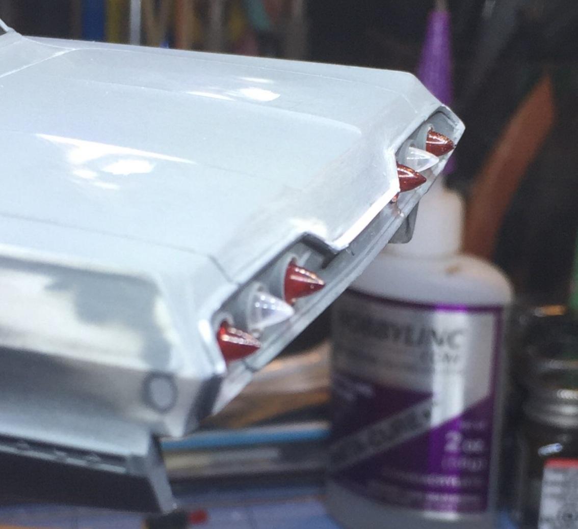

rickcaps55 Posted May 20, 2023 Posted May 20, 2023 Those look perfect nice. I keep the clear red and white trees that come in a lot of kits just for making custom lights and with the plastic tints you can make some good looking lights.
customline Posted May 20, 2023 Author Posted May 20, 2023 2 hours ago, rickcaps55 said: Those look perfect nice. I keep the clear red and white trees that come in a lot of kits just for making custom lights and with the plastic tints you can make some good looking lights. I found it difficult to shape this type of material. I thought it would be easier ? but with some practice and the use of better ("rounder") material, I might be able to make all 6 bullets closer in contour. These are a bit too random in shape. Uniformity is a problem. They are pretty small and are therefore hard to handle. I may need to try again but I think when these are in place they may be good enough. I have glued a "base" to each one so I can install them from the back side after everything else is done. 1

customline Posted May 22, 2023 Author Posted May 22, 2023 All righty then....I finally got the point. ?? If you put a monkey in front of a typewriter and wait long enough..... Anyway, I found it very difficult (pay attention, Michael) to get a proper point on the clear red sprue. It was either too rounded or the point would just not form. What I finally did was chuck the sprue in a pin vise and grind a rough shape with the big sanding drum on the Micro at low speed. Once I had a fairly decent shape, I chucked the sprue in the Micro and smoothed it out with 220 followed by 400, then 600, then 1000. ? YAY! a point! Getting that point meant a light touch and good (in my case, magnification assisted) eyes. I guess it's just a matter of using the finer grits very carefully to get a nice sharp point. Not all sprue is good for this. My bullet (left) is actually better than the kit piece, ? which has a nice bubble ?. Behold! mine is a bit slimmer though ? (oh well.) Now I just need to make another one just like it but I think I'm going to take the advice of "Ace-Garageguy" and make a pair of clear ones to see how it looks both ways. 2

customline Posted May 23, 2023 Author Posted May 23, 2023 Seriously, I think I got it straight. Thank you Mr. Ace-garageguy! (Well, I was on this...I was....really ☺️. ) And the winner is..... 7

H.A.K Posted June 4, 2023 Posted June 4, 2023 On 5/22/2023 at 10:58 PM, customline said: Seriously, I think I got it straight. Thank you Mr. Ace-garageguy! (Well, I was on this...I was....really ☺️. ) And the winner is..... Those turned out great looking.
customline Posted June 4, 2023 Author Posted June 4, 2023 (edited) 14 minutes ago, H.A.K said: Those turned out great looking. Thanks, Sam. The end result is credited to Bill for what should have been, for me, a no-brainer. I got a lot of practice, though, for making tail lights from sprue. The big take-away here is those red bullets from the AMT '57 Fairlane kit are a real good fit for this application so add it to your data base ?. Thanks for your interest, Sam. P.S.....I kept the red bullets that I made for some future project. You never know.?♂️ Edited June 4, 2023 by customline P.S. 1
