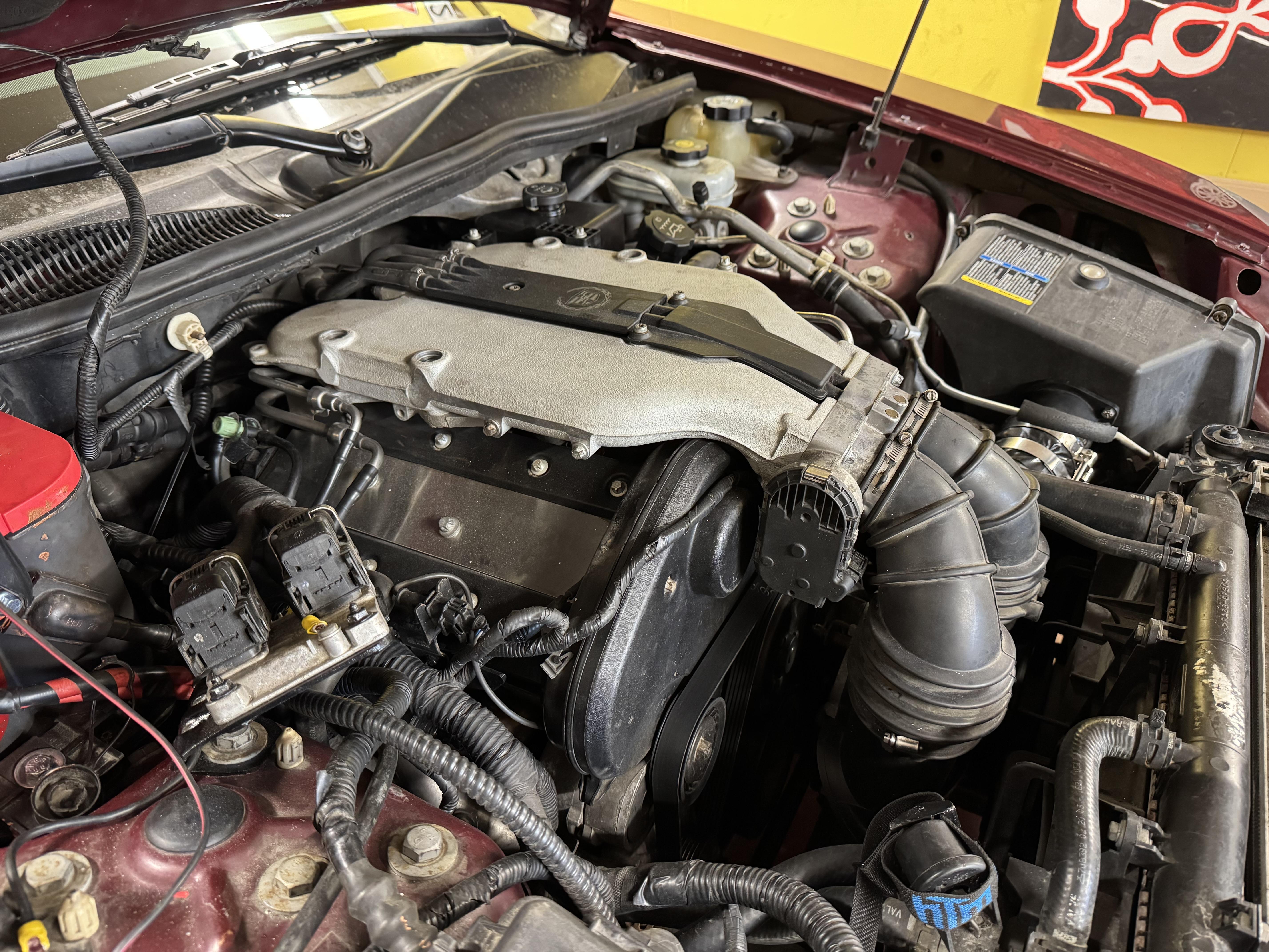

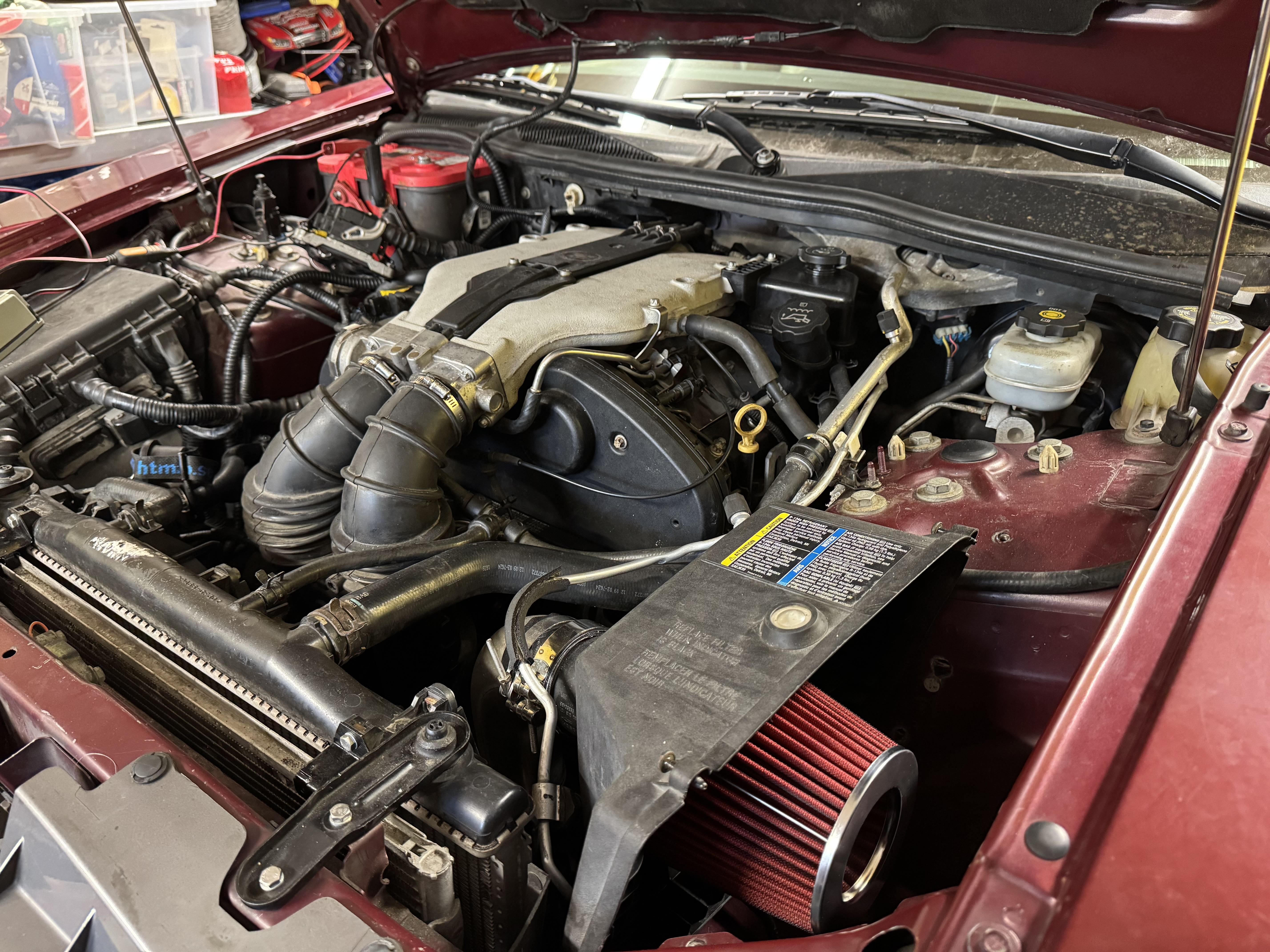

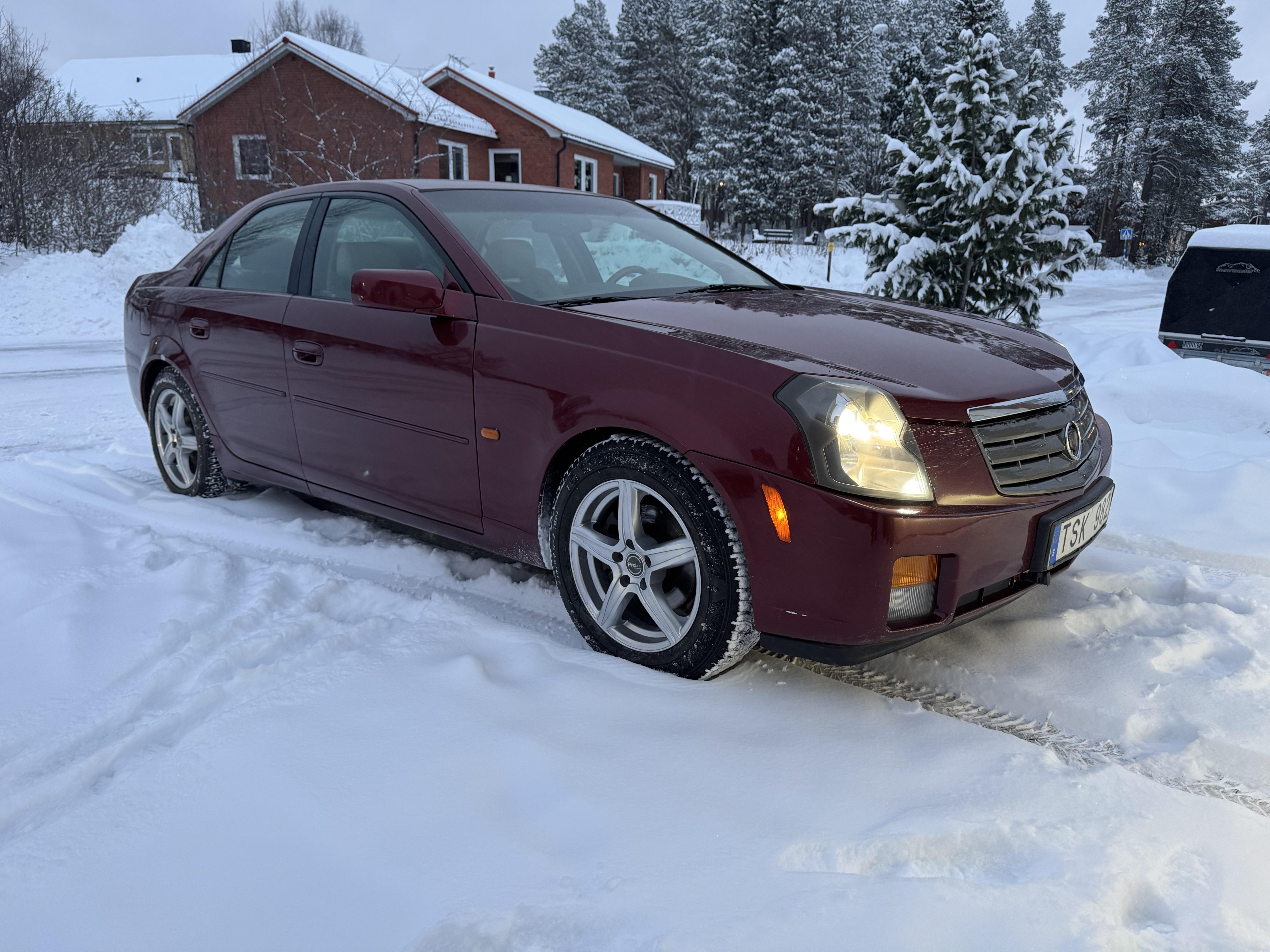

I got my Caddi out on the road and it psssed inspection with flying colors. Only thing that have happened since is that the ecm have acted up so I can’t start the car with the key. Wired a start button but was ceaping out on buying a ugly black starter button for 25usd so I used a one this to have… well that fried something between the starter and generator so I have to dissasemble the harness and go through it.
Some pics when I had got it together.
IMG_0664.jpeg.d0516200b55b6847fc937b695833e714.jpegIMG_0662.jpeg.1e916a7655b54c33fa29813bd3ae0718.jpegIMG_0623.jpeg.386d54942fb213631f86c964daab8e05.jpeg

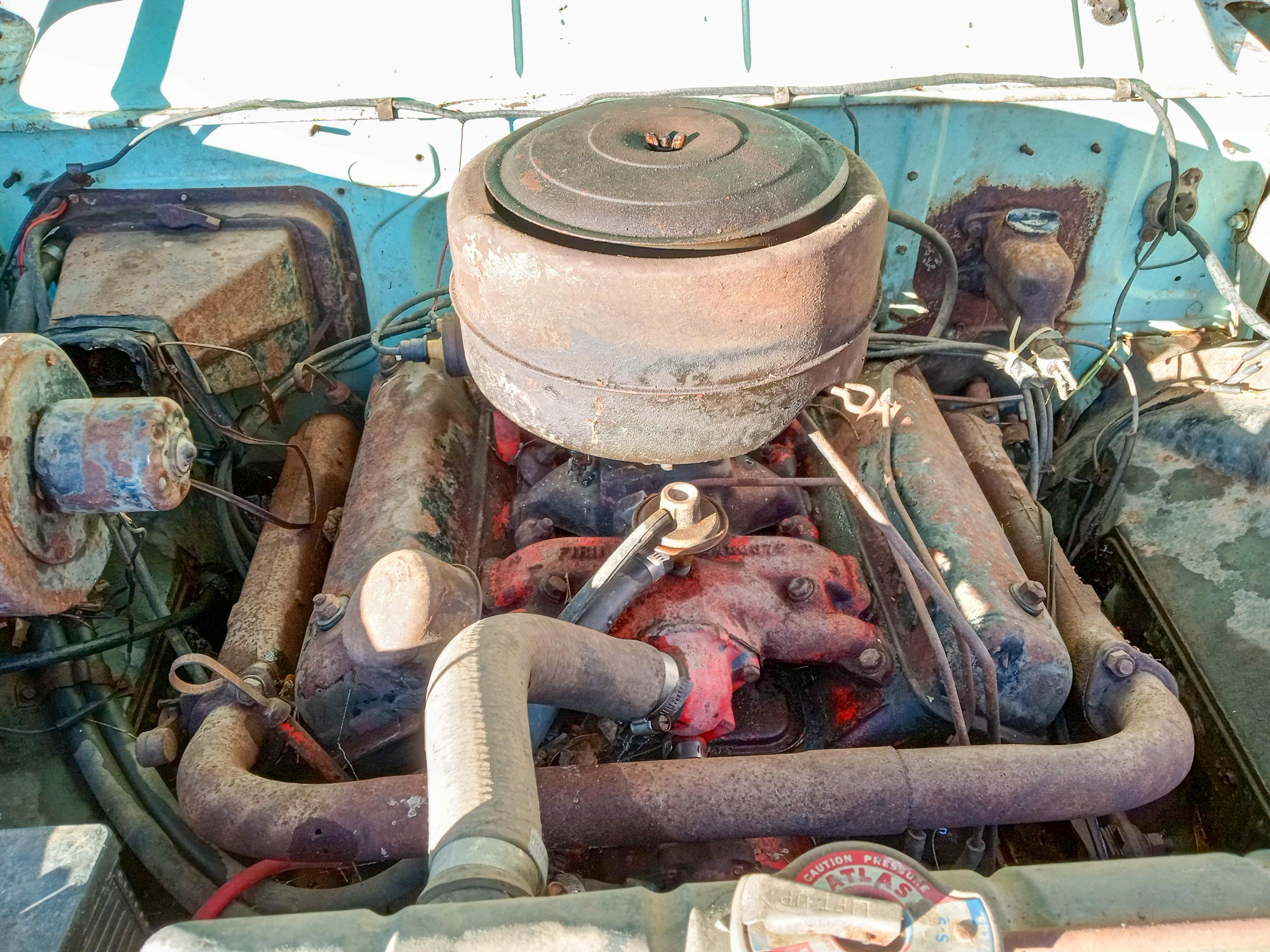

I see red paint. Do you know what engine / year it is? I would expect some yellow paint somewhere if it is a '55 272, but I don't know a lot about these.
I'm pretty sure it's the original 272 the came in the car. Ford trucks used yellow paint, Mercury used green in '54 and a cream/yellow in 55-56. Ford stuck with Red for passenger car & T-bird from '55-58 or so.

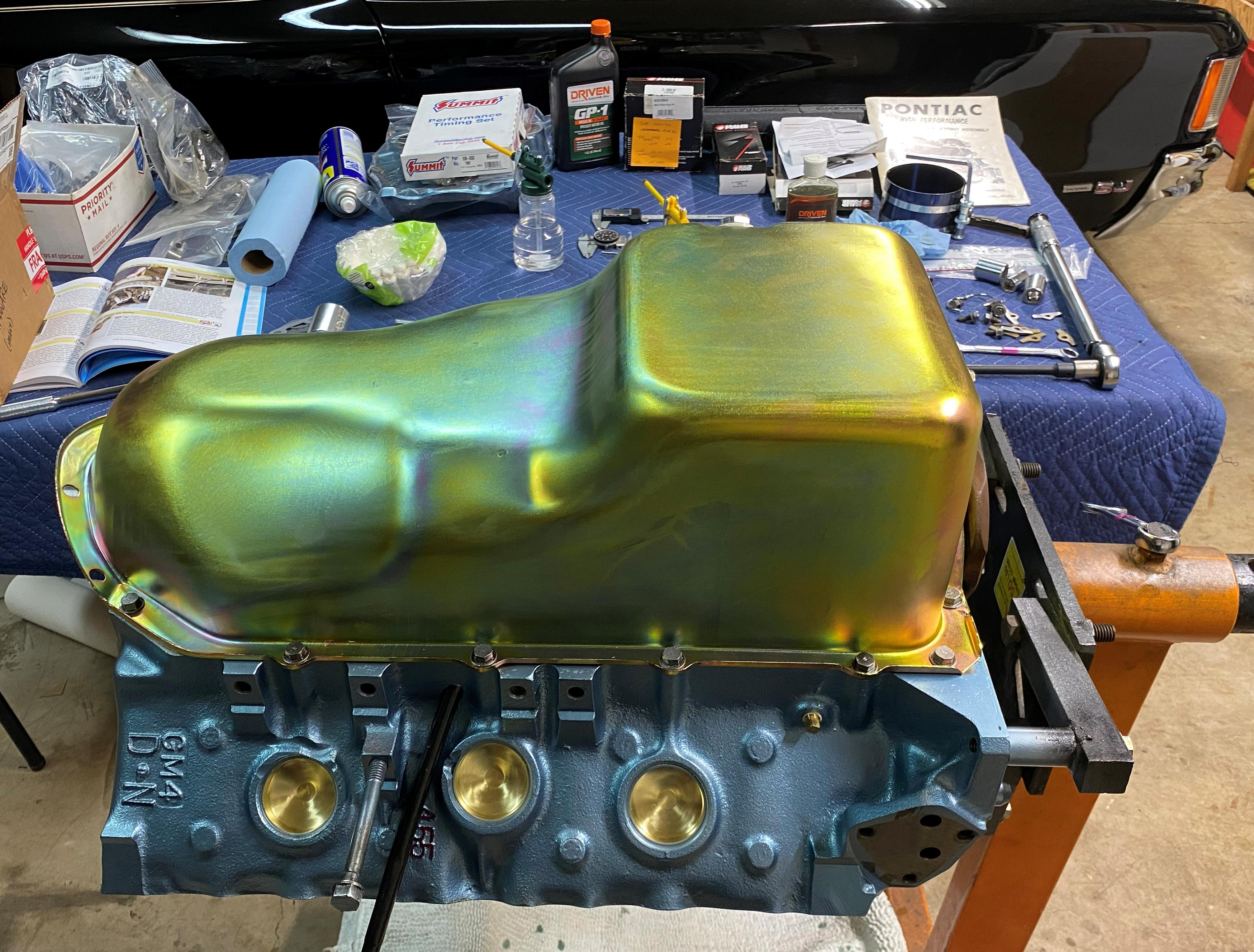

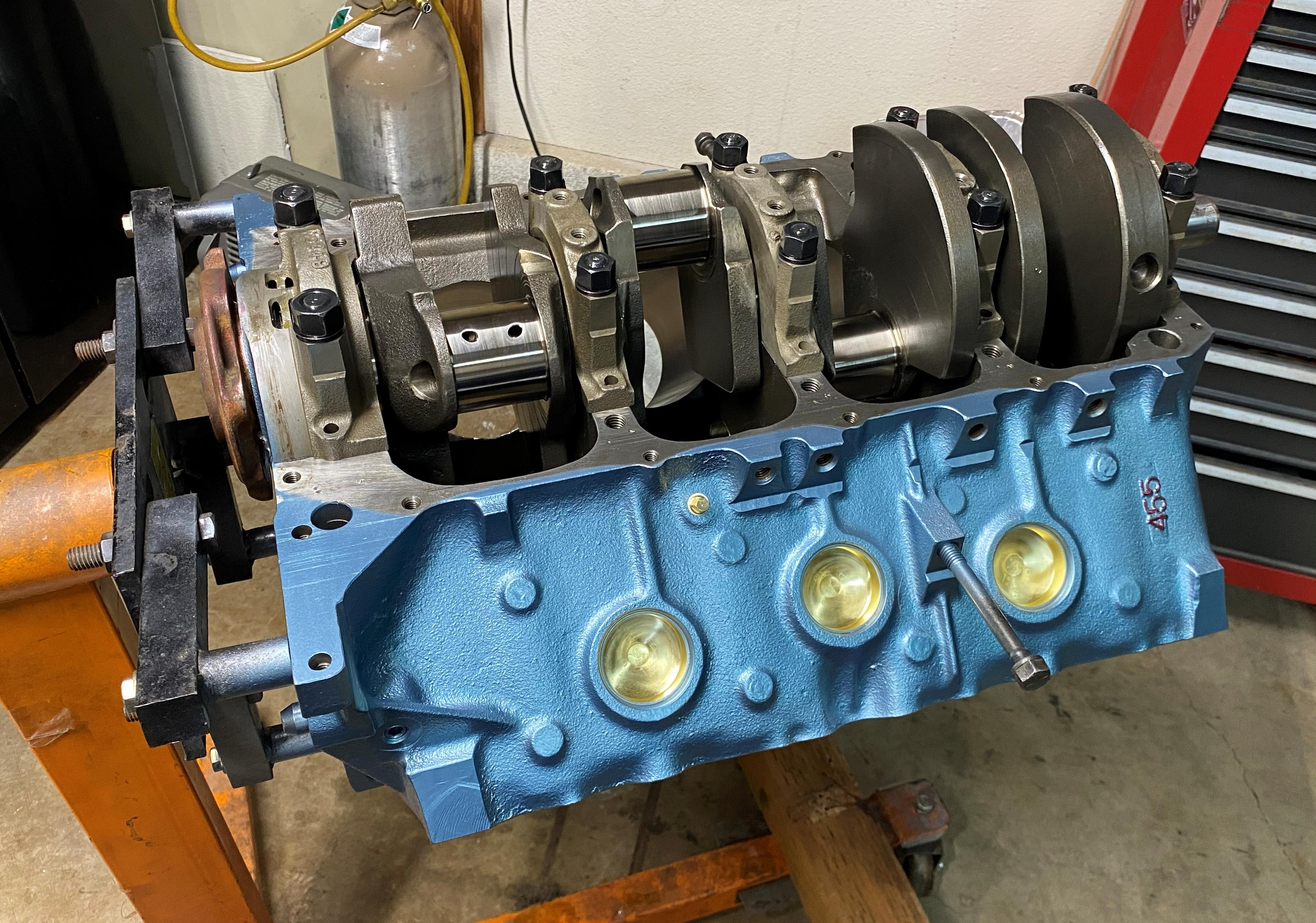

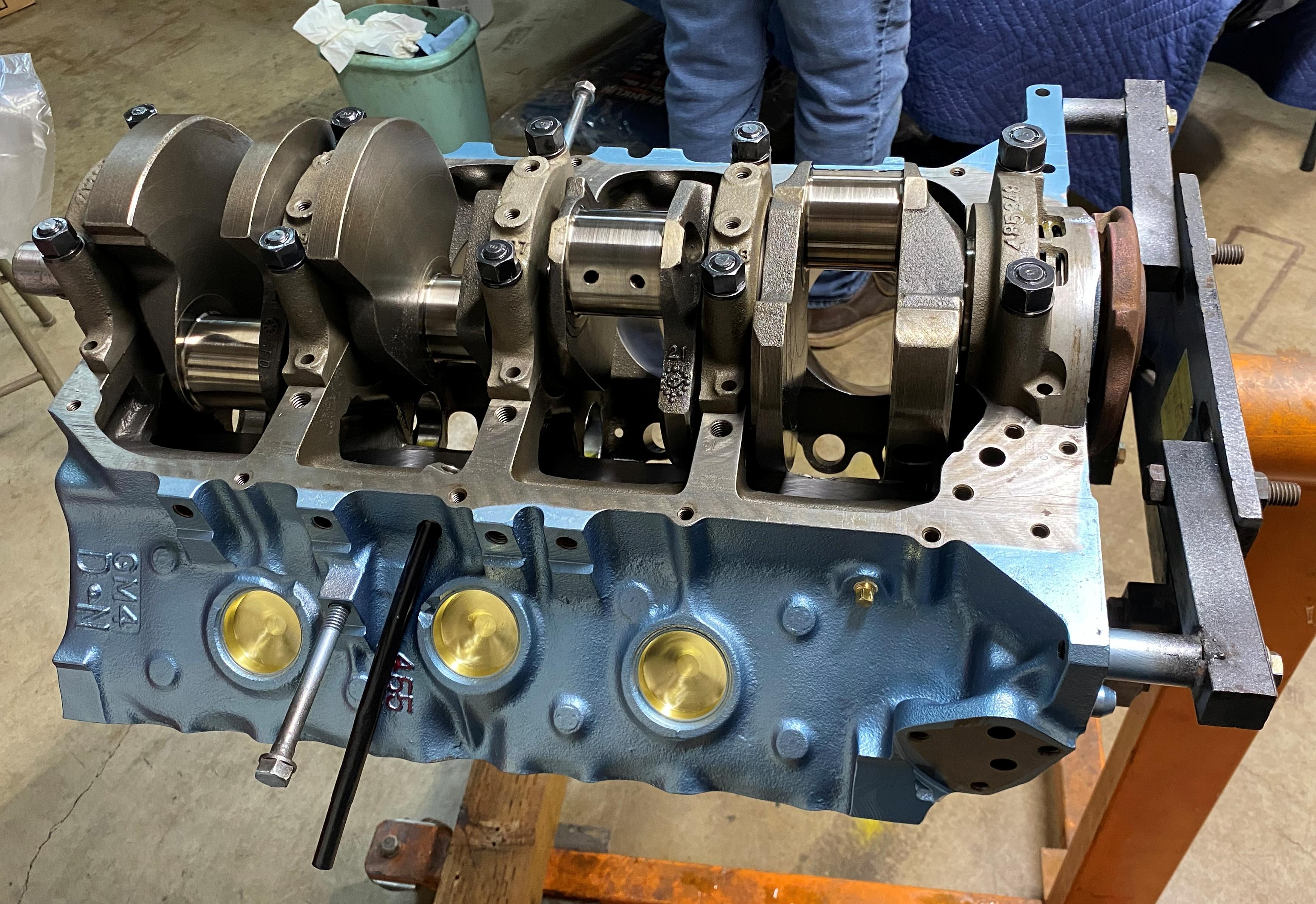

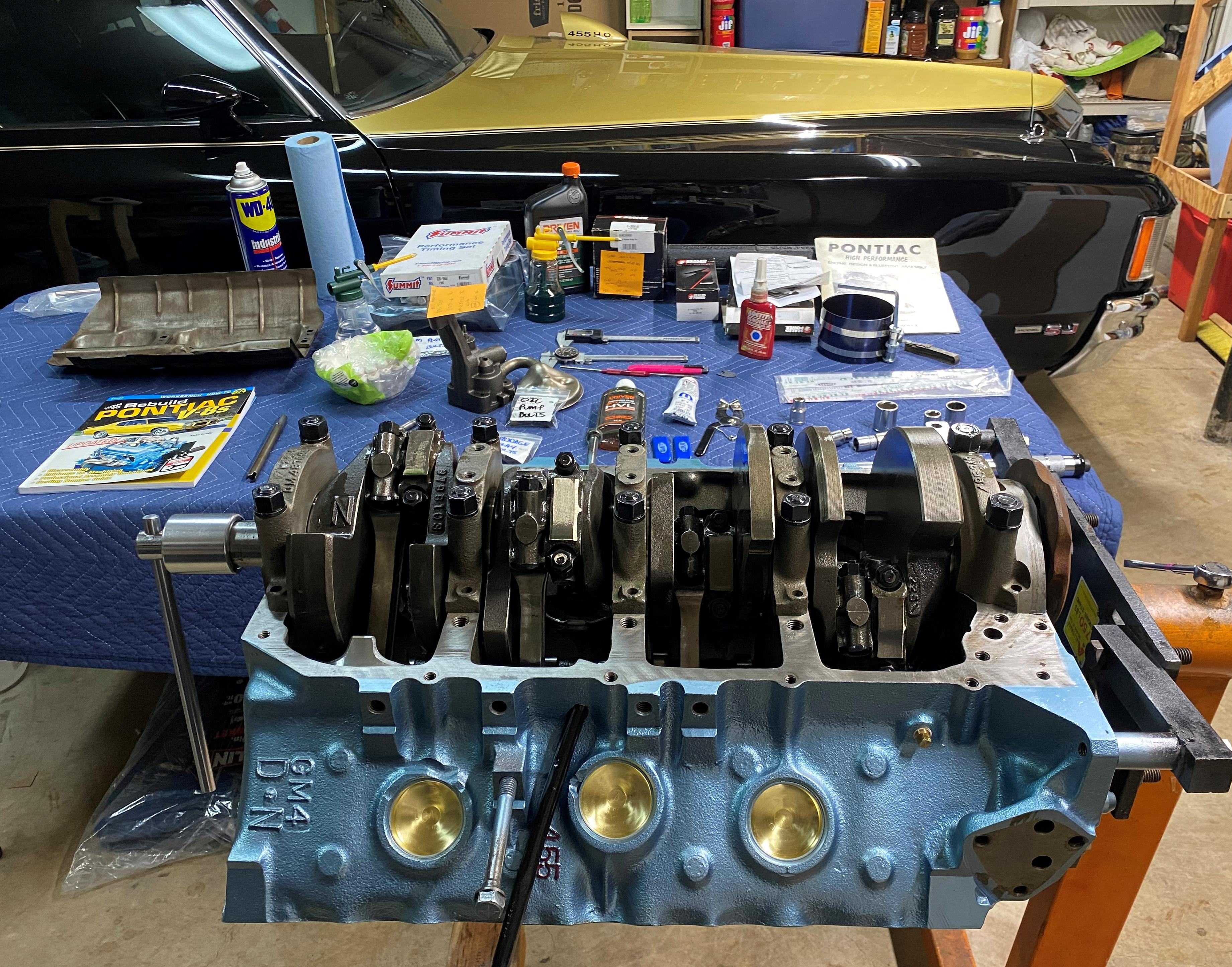

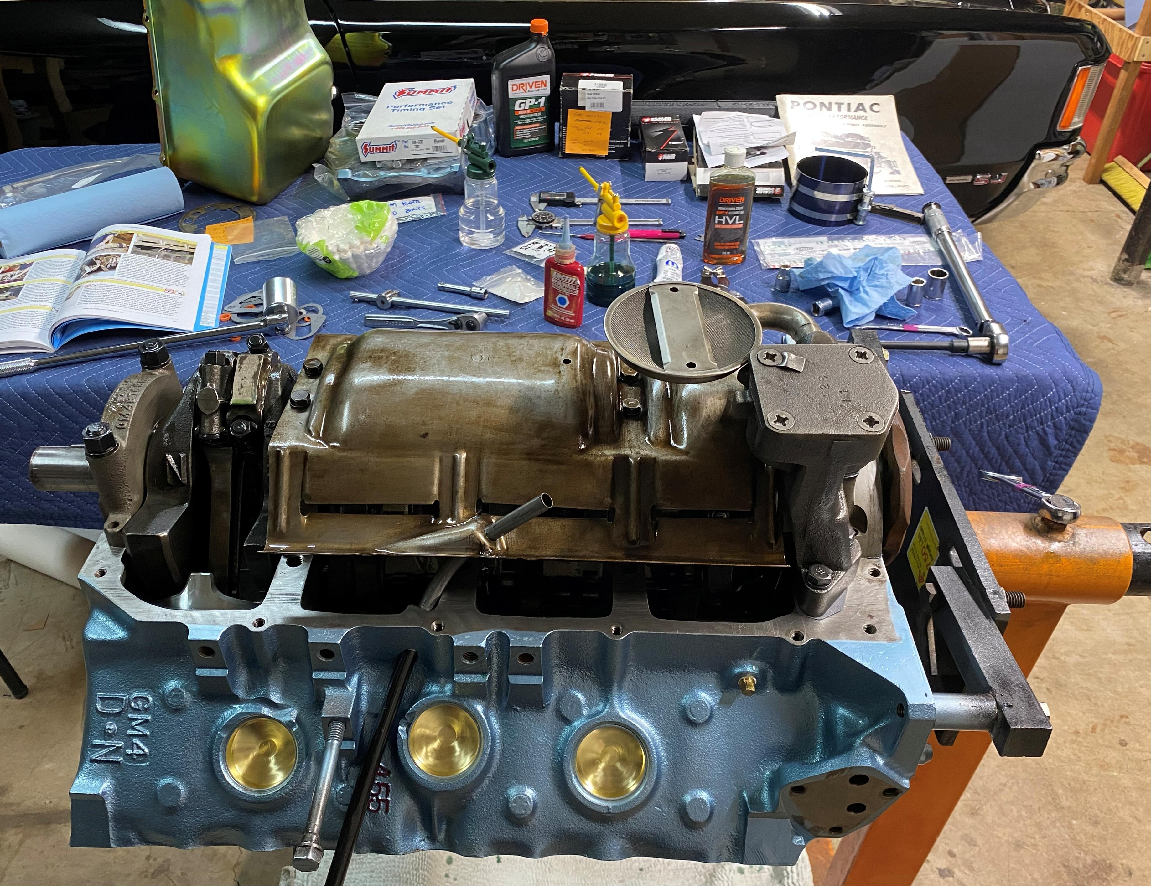

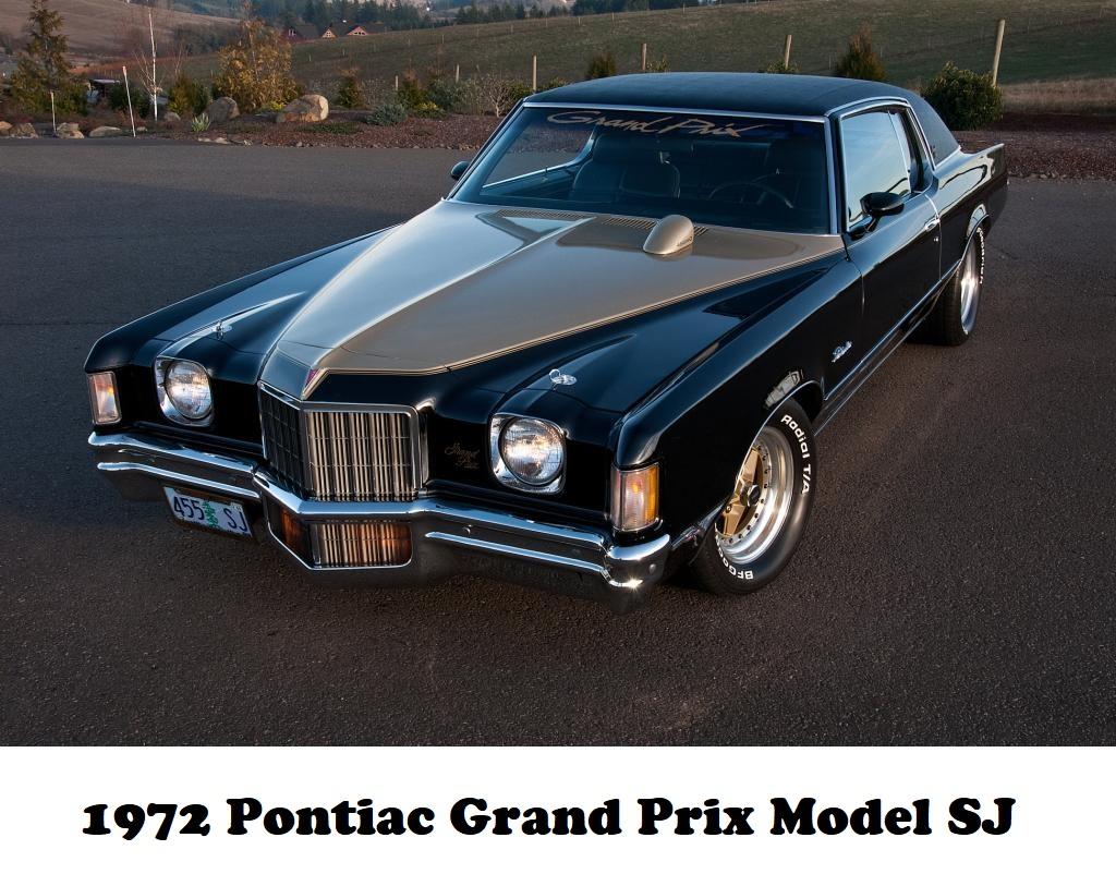

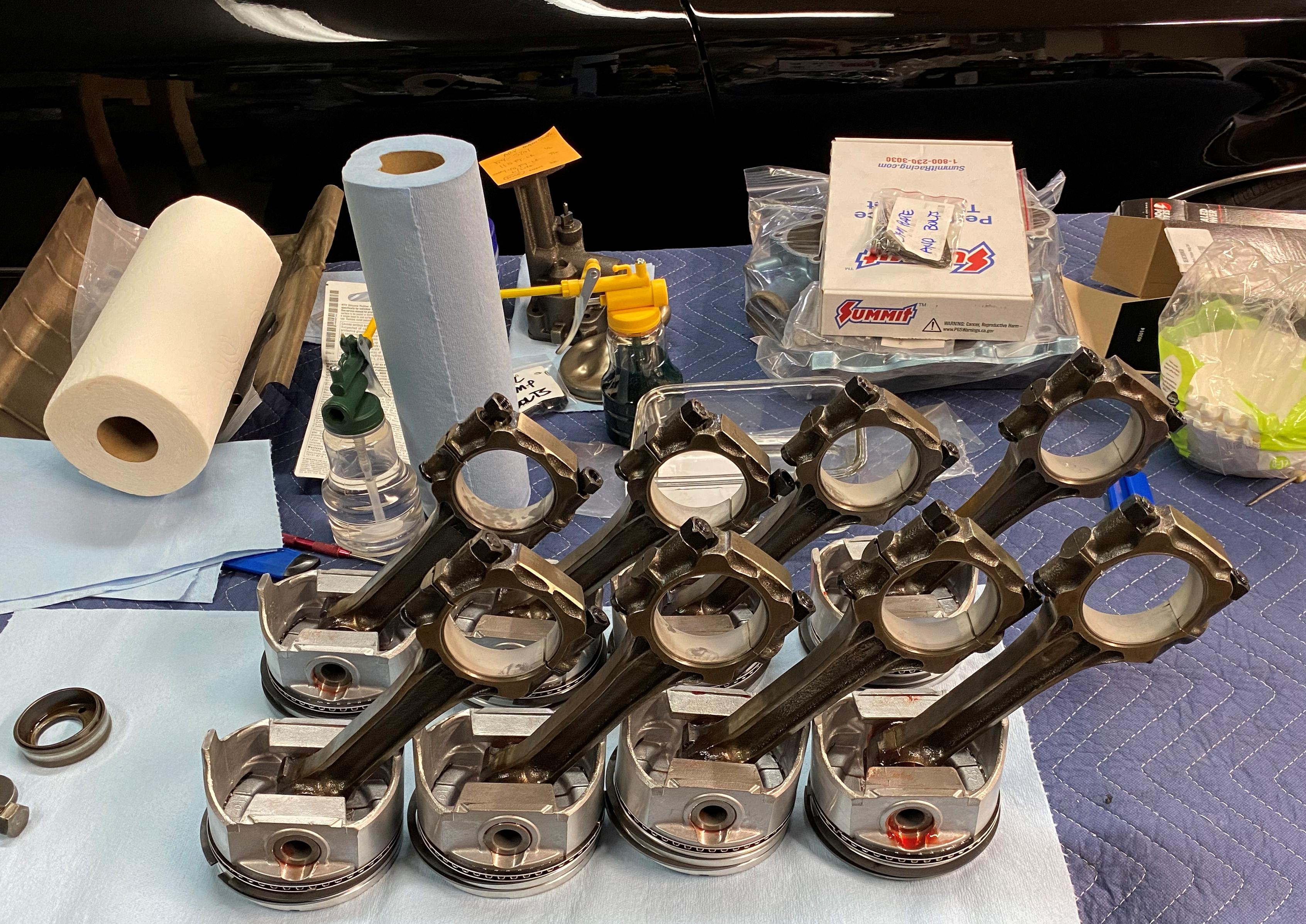

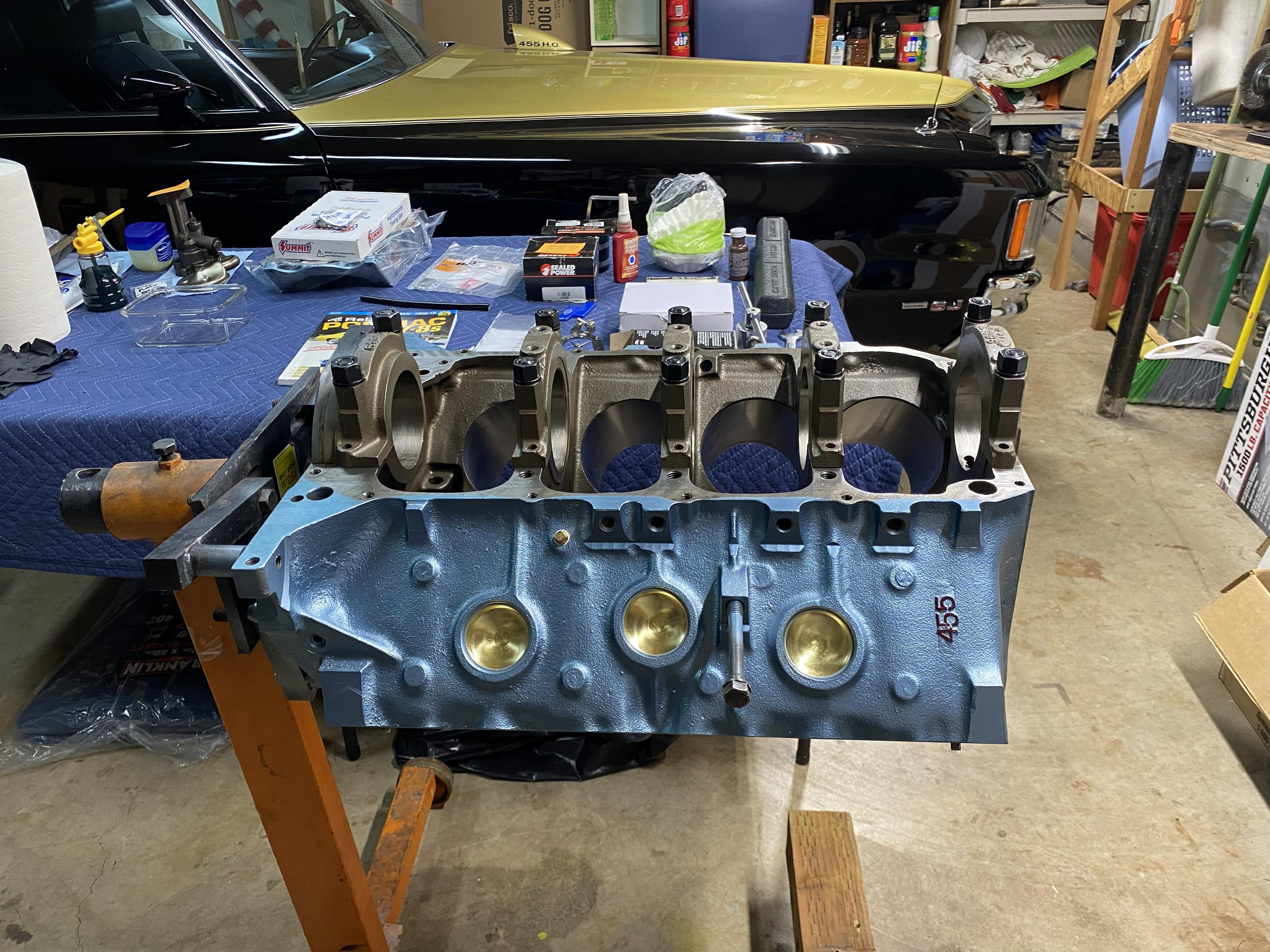

My 72 Grand Prix is still running on the original 455. Q-jet, points and R-12 in the A/C. After only 133,000 original miles, it still runs very well but has some ring blowby. I have been crutching it with an oil separator system plumbed to keep the crankcase evacuated but it only works if there is always manifold vacuum. I can no longer open the secondaries unless I want to bathe the engine in oil via the dipstick tube. My solution is to do a low budget rebuild of my spare 455 I have been lugging around since the late 90's. The engine only had 20K on the last rebuild before it suffered an engine fire which totaled that car. Unbeknownst to me, there was two cylinders that had water in them from the fire dept. Anyway, two sleeves and 8 new pistons later, I now have a shortblock. I did not need to touch the crank and I am reusing the Crower RA IV hydraulic flat tappet cam as they are both in excellent condition. I did the obligatory new bearings throughout and all the clearances are actually on the tight side of the acceptable range. I still need to determine which set of heads are going on it. Anyway here are some pics of the car and the shortblock.
  • Like 4

Did you take the opportunity to dial in the heads or were the doner heads all good?
13 hours ago, espo said:
Did you take the opportunity to dial in the heads or were the donor heads all good?
I have a set of #96 heads from a '71 400. They were on this engine after the first time I rebuilt it. They had 96cc chambers which on a 455 bumps the compression from 8.2-8.4:1 to supposedly 9.5:1 or so. Well since the block was bored .060" over, the increase of cubic inches from 455 to 469 calculated the C.R. to around 9.8:1. The ONLY gas it liked was AMOCO 93 octane premium. I was ok with feeding it that at the time.
So this go around, I removed the "eyebrows' from the combustion chambers and polished them as well to both decrease the C.R and reduce the ability for carbon build up to have a purchase on the surfaces. I recently measured them to be 99-100cc each. While I was at it, I gasket matched the intake ports and cleaned up any roughness inside both the intake and exhaust. I improved on the oil drain back as well. The heads have new stainless valves, exhaust seats  and dual springs. The screw in rocker studs were upgraded from 3/8" "bottle neck" to 1/2" ones. The stamped steel 1.5 rockers have been upgraded to 1.52 stainless roller tip rockers.
With all that done, I am actually desiring to AVOID installing them on this engine. I have two goals. The long term one is to pull and rebuild the numbers matching 455 at my leisure with the #96 heads and step up to a roller cam. My short term goal is to install the short block above and reuse the stock 7M5, 114cc heads from the running engine. This assumes they are in good enough shape to keep the car on the road for a couple more years. I want to be able to run cheap in either engine. If that does not look like it will work out, I will put the #96 heads on this engine and hope the compression has dropped enough to run today's gasohol formula.

Thank you, I get compliments on it every time I drive it. While it looks great and runs well, my most enjoyable part is the sound system. 15 speakers (though I only use 9), 11,000+ watts (if you are foolish enough to believe the written spec) now being powered by a 330Ah LiFePo4 battery which gives me HOURS of engine off play time. I could share the details if anyone is interested.

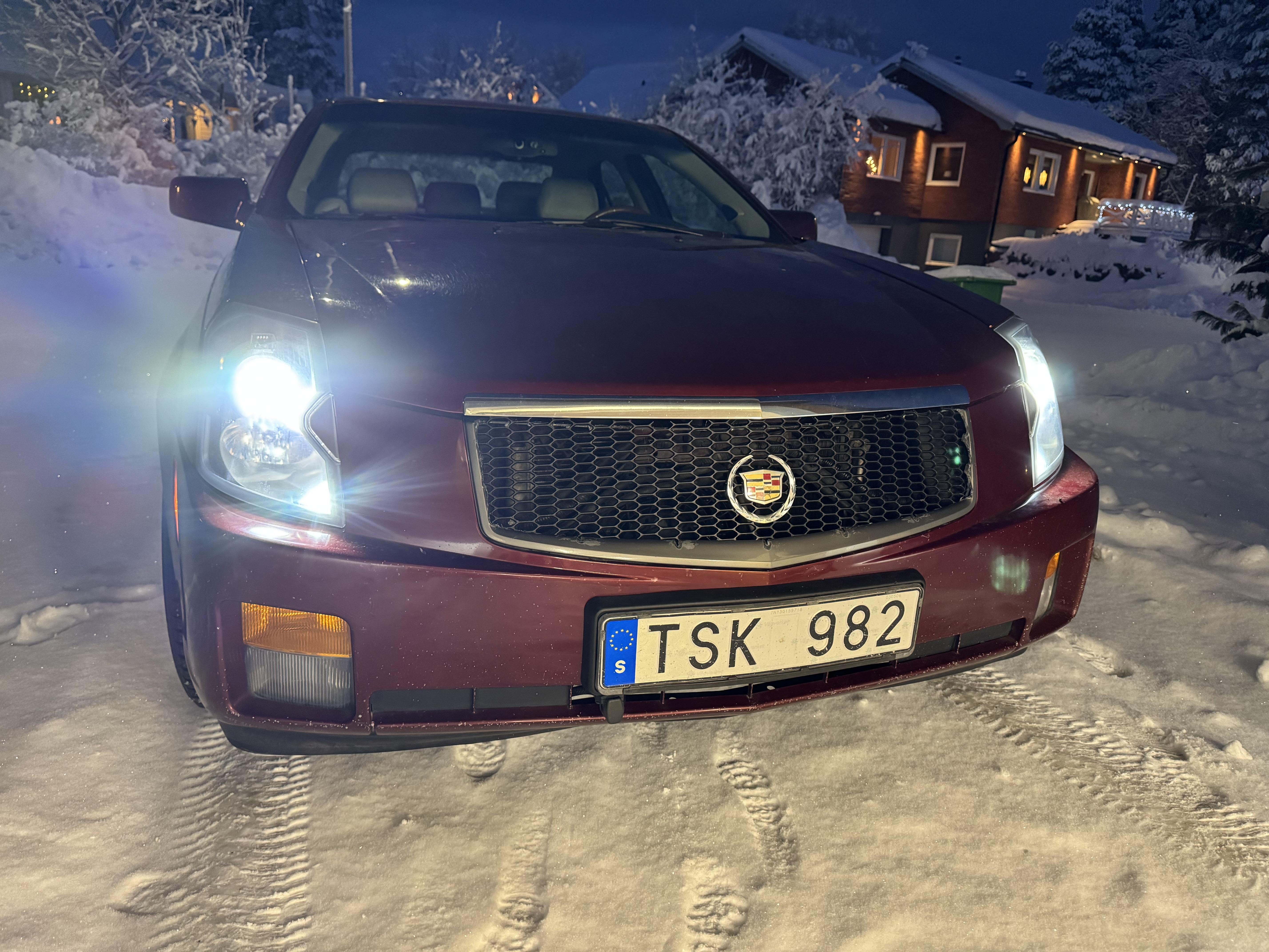

I started on a custom grill for the CTS earlier and got it a step further yesterday. Still need to take it off and glue it with an other glue and also close of some holes in the border and then paint both this and the upper part in a gray tone.
like this more than the stock CTS-V grill since it’s a bit deeper and this mesh I believe to be good looking.
