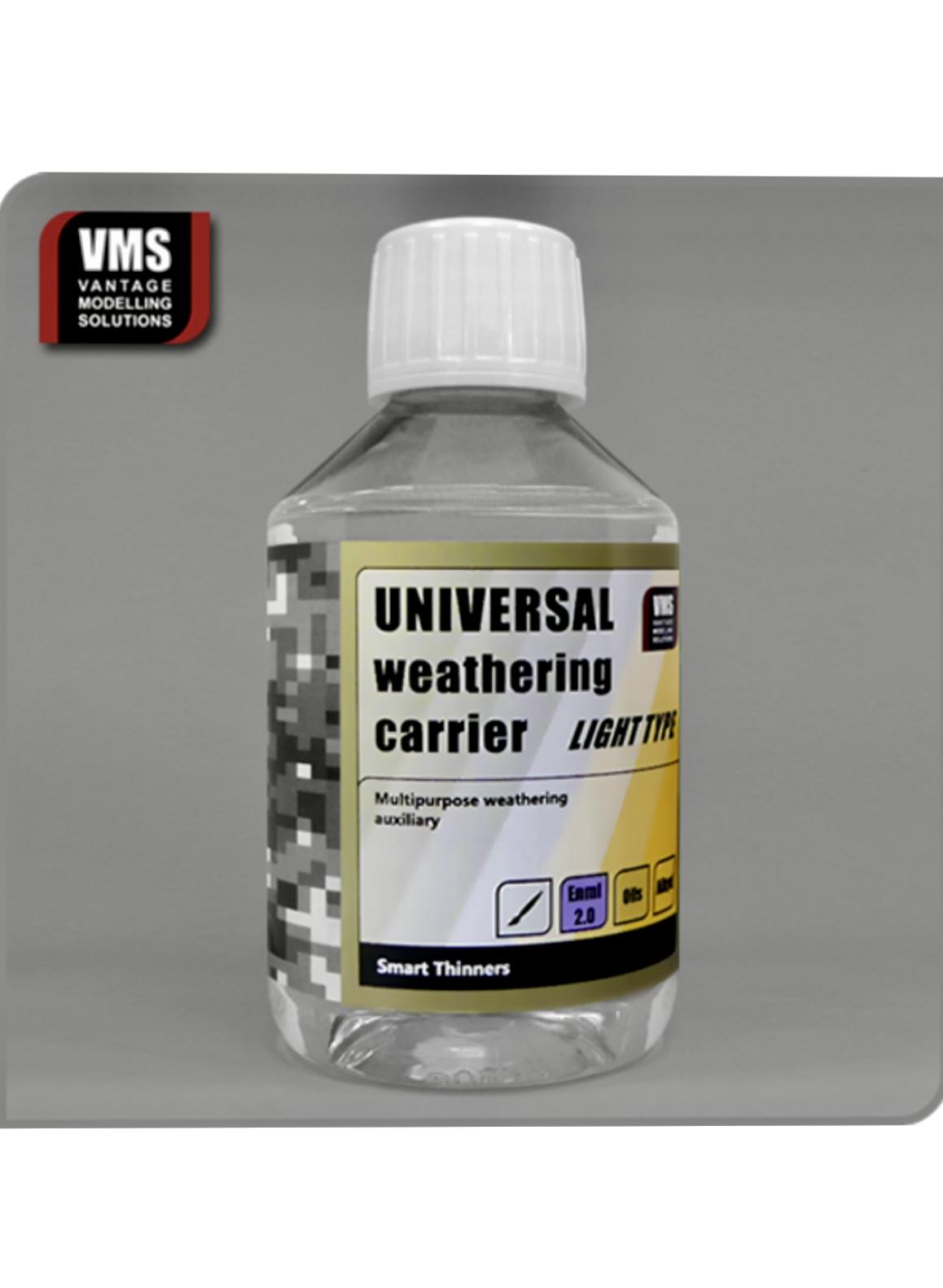

Dpate Posted May 25, 2023 Posted May 25, 2023 Never used it as a mask as I use Tamiya tape for that. But to remove the residue I use this product, and works perfect on clear parts as well to remove residue. This one bottle will last a life time lol.
