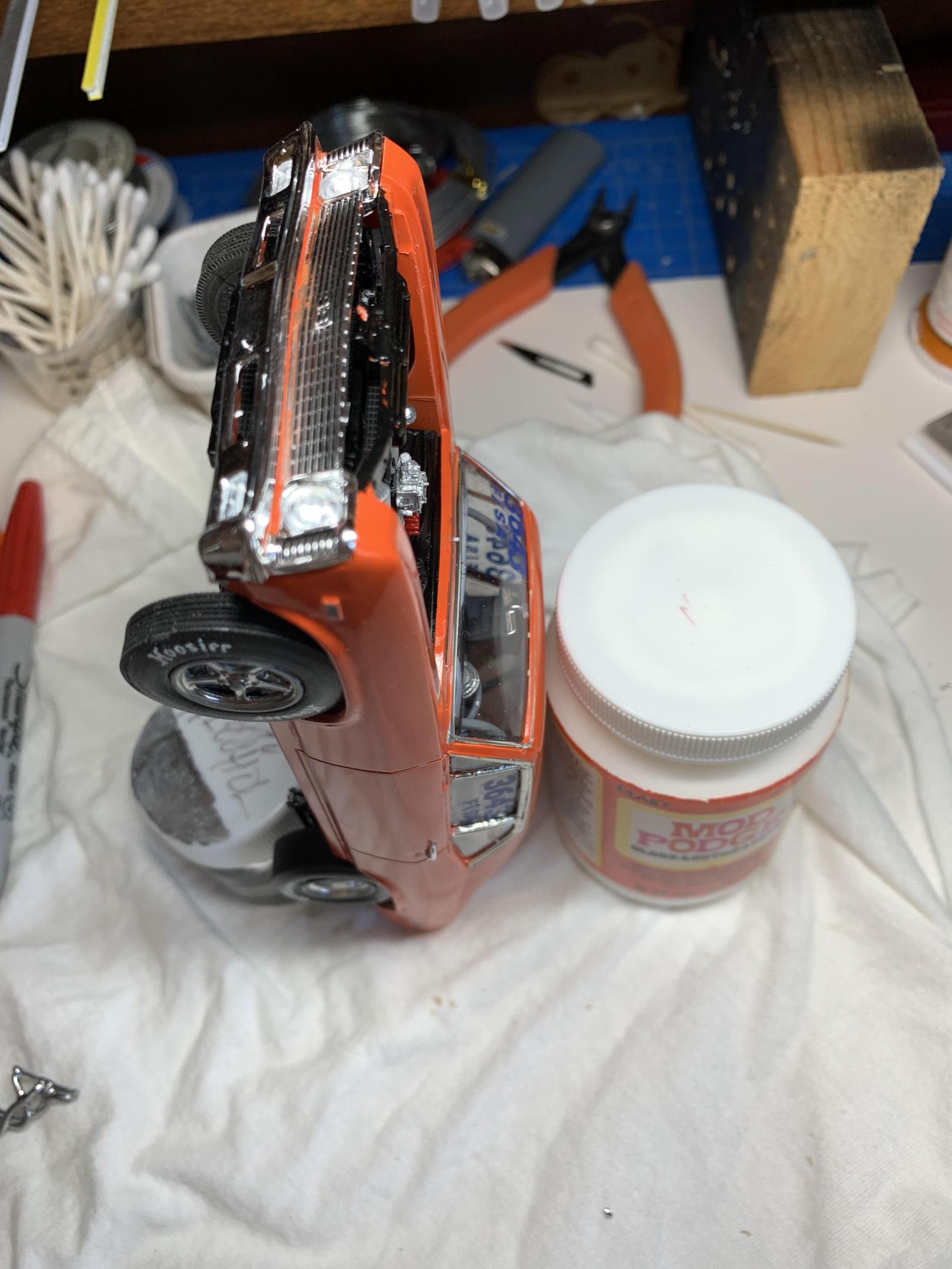

Got the driver and passengers side windows in with Mod Podge, ca glue on the front rims to chassis with testors bottles for alignment.  Painted a helmet and glued it on.  Gonna let stuff sit over nite , then trial fit chassis and more detail work tomorrow.

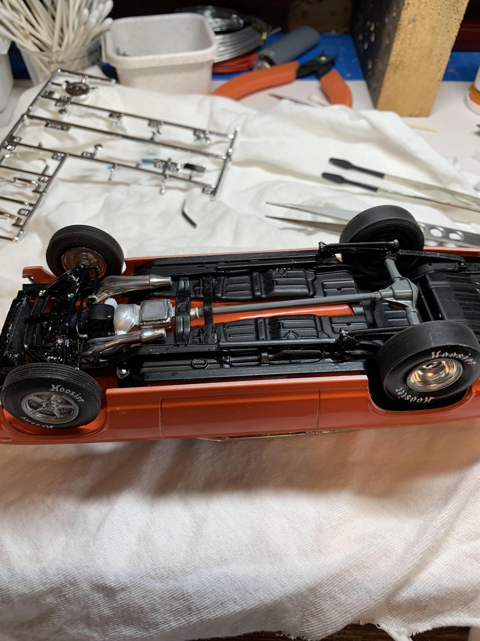

Couple of chassis shots with wheels glued on.  Also, the making of a rear license plate.  Some scrap thin styrene sheet, some double back tape to hold it for individual decal application (thanks to Slixx for 1/8” letter sheet), and some semi steady hands and water.  Oh, and a blue jel type pen I am going to experiment with to make blue class numbers tomorrow.

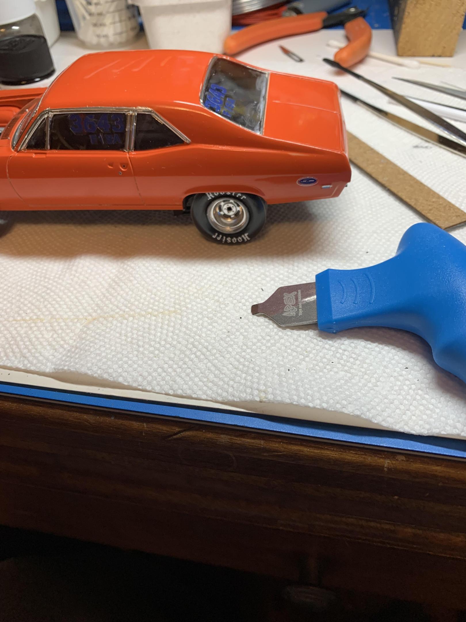

Thanks, Mark.  I am always experimenting, sometimes with less than optimum results. Finished up the numbers and bare metal foil today.  Two of my most helpful tools when it comes to bare metal foil:  my fingernail and a #15 scalpel blade.  It cuts better than the pointed end of a #11 type blade.
  • Like 1
Daniel, what I like about those blades is you can “rock” or pivot them around corners without fear of slipping out of the groove or channel.  Also, you can push or pull (like slicing tomatoes) as you proceed down the panel.

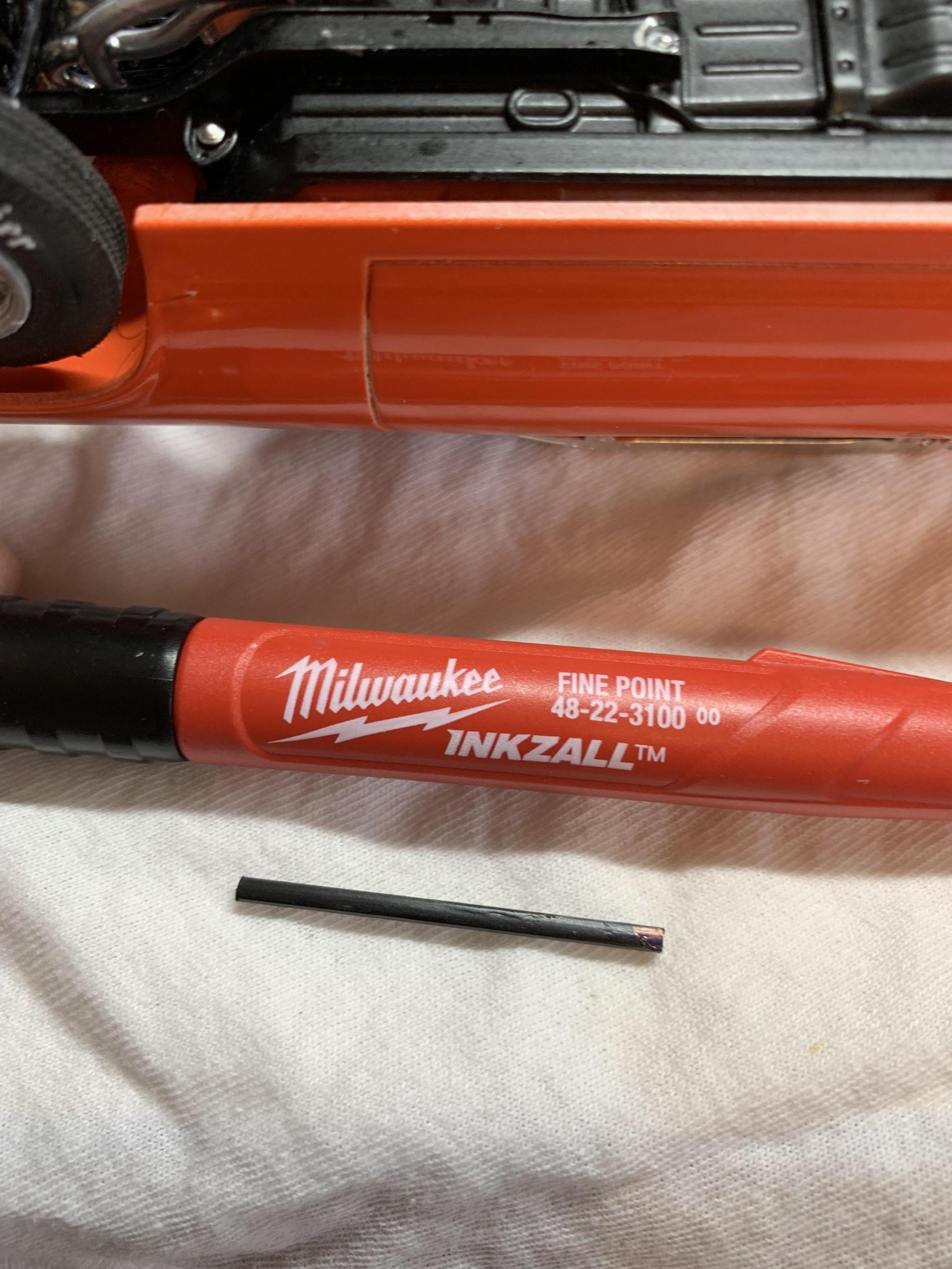

Should finish tonight.  Made subframe connectors from 2mm square stock and driveshaft loop from .010” styrene.  Yes, I know the driveshaft loop is supposed to be 360 degrees, but not this time.  Not my best work, but I guess I’m really getting tired of looking at this and am antsy to move on.  Trial fit of body on frame.  The stance is not perfect (should sit a little lower in the rear).  The Milwaukee marker is not quite as “purply “ as the Sharpie version.  The spreader tool really helps stretch the body for installation.

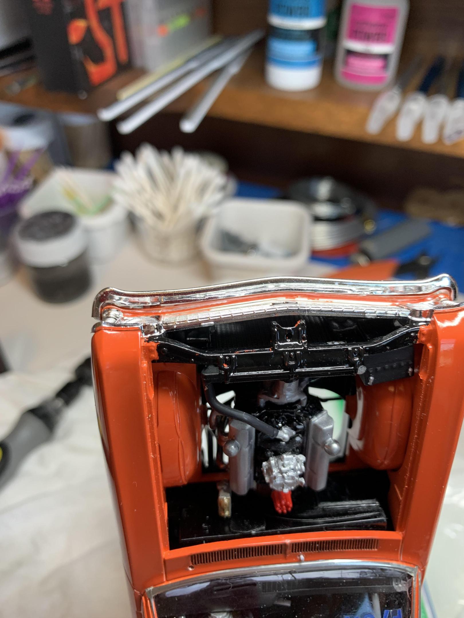

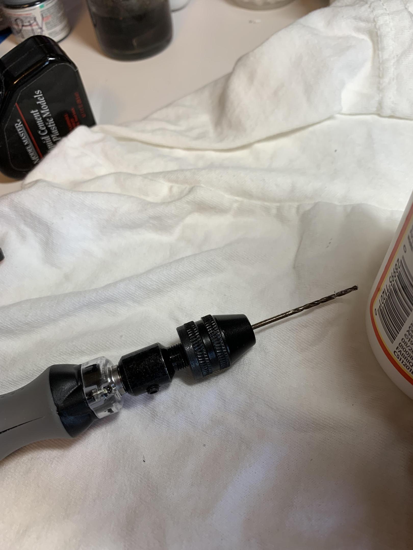

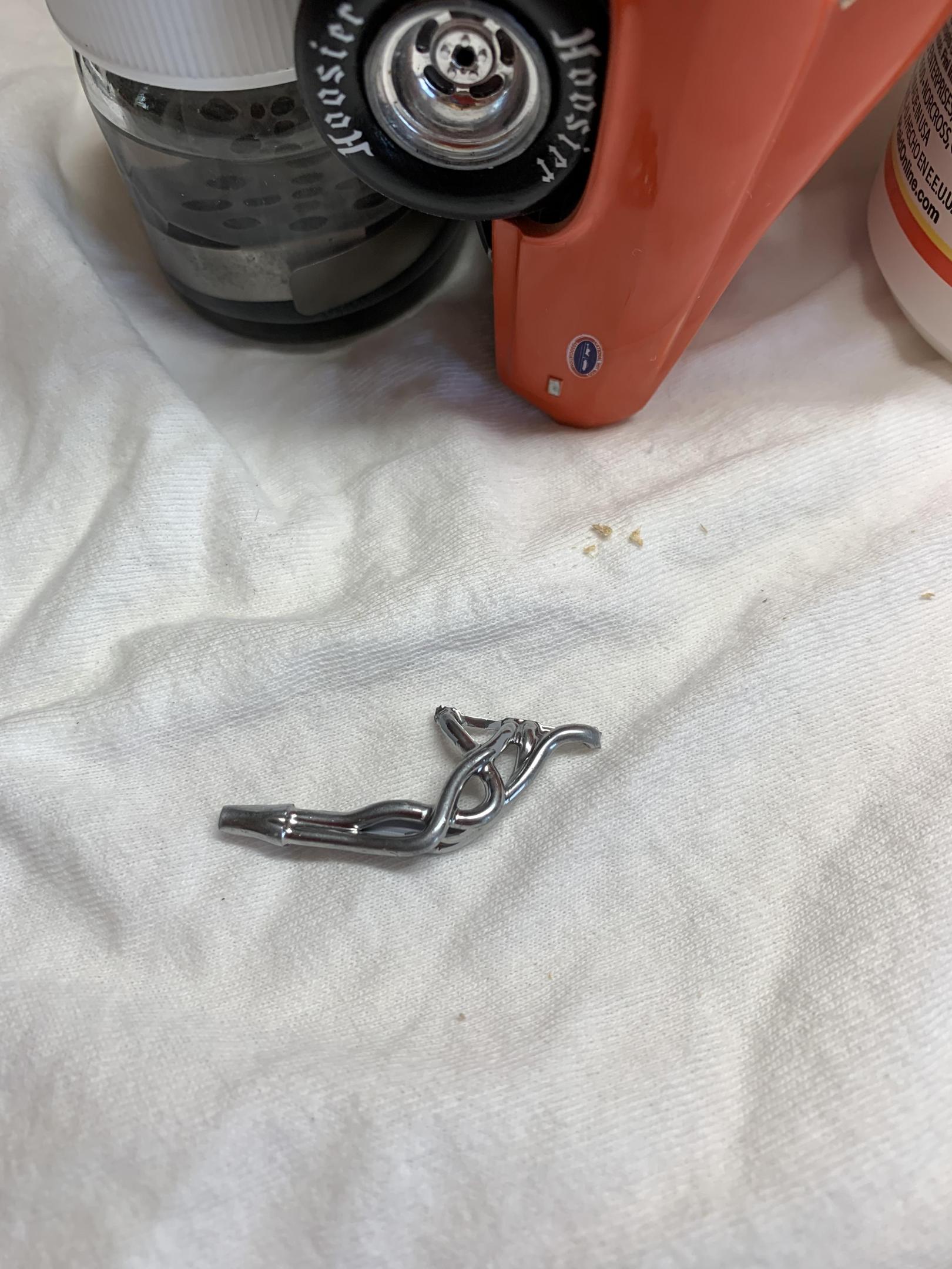

Sometimes it’s 2 steps forward and 1 step backward.  In the process of installing the front bumper/grille assembly, the right side header fell off.  Then, forgot to drill the hole for the master cylinder (as no booster is used).  My low speed drill saved me there.  Got the top radiator hose on, next is the coil on the firewall.
Put rear bumper on, then looked for hood and remembered it was still in the alcohol tank.  Cleaned both hoods up, ran the sander over them.  Now they’re ready for primer.
