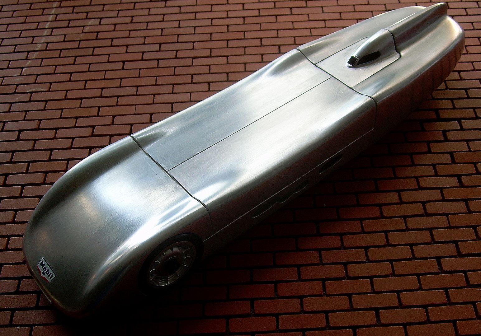

Ace-Garageguy Posted June 11, 2023 Posted June 11, 2023 (edited) I've used Rub 'n Buff materials to good effect on occasion. After buffing, it's not sparkly like metallic paint. Real brass isn't either. Here's some samples... Edited June 11, 2023 by Ace-Garageguy

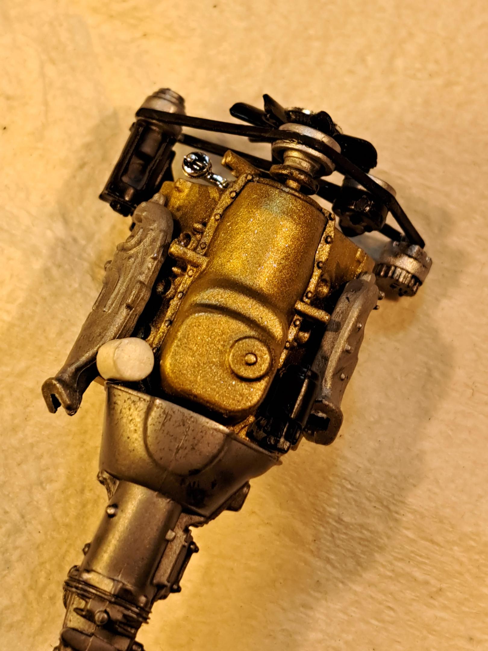

stitchdup Posted June 11, 2023 Posted June 11, 2023 if its not going to be handled too often montana gold spray cans. its is similar to molotowe in needing about a week to set hard and cannot be cleared but it gives a nice brassey finish. This is straight from the can, over a brush painted resin print

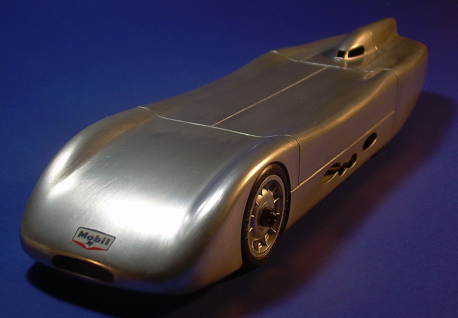

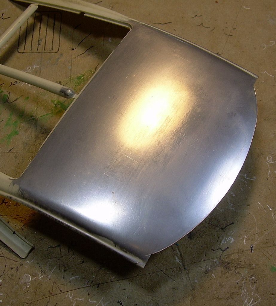

Ace-Garageguy Posted June 20, 2023 Posted June 20, 2023 (edited) 1 hour ago, ctruss53 said: Ace, I just did a search for that stuff. But I didn't find anything about proper use. What can you tell me about that stuff? And how to use it? It's a waxy paste you rub on and then buff out with a soft cloth. This was a Q&D test panel I did with the silver leaf while experimenting how to achieve a bare aluminum effect... Below is the finished model. It represents Mickey Thompson's Challenger I before it was painted, when it was introduced to the press in its original non-supercharged form, fresh from the body builder. Rub 'n Buff is thin enough to let any imperfections in the surface show through, so I applied it over a surface that had been lightly sanded, to look like finished alloy skins pre-primer. EDIT: It's probably not as permanent as the Alclad. Ten years after I built the thing, it's dulled noticeably...but it hasn't been in a case either. There's a good chance a light buffing would bring it back. Real bare aluminum would have lightly oxidized somewhat too in 10 years, so I'm not too disappointed. Edited June 20, 2023 by Ace-Garageguy 2
ctruss53 Posted June 20, 2023 Posted June 20, 2023 1 hour ago, Ace-Garageguy said: It's a waxy paste you rub on and then buff out with a soft cloth. This was a Q&D test panel I did with the silver leaf while experimenting how to achieve a bare aluminum effect... Below is the finished model. It represents Mickey Thompson's Challenger I before it was painted, when it was introduced to the press in its original non-supercharged form, fresh from the body builder. Rub 'n Buff is thin enough to let any imperfections in the surface show through, so I applied it over a surface that had been lightly sanded, to look like finished alloy skins pre-primer. EDIT: It's probably not as permanent as the Alclad. Ten years after I built the thing, it's dulled noticeably...but it hasn't been in a case either. There's a good chance a light buffing would bring it back. Real bare aluminum would have lightly oxidized somewhat too in 10 years, so I'm not too disappointed. Thanks for the info. So can you apply it over bare plastic? Or does it need to have paint on it?

oldcarfan Posted June 25, 2023 Posted June 25, 2023 On 6/11/2023 at 6:03 PM, stitchdup said: if its not going to be handled too often montana gold spray cans. its is similar to molotowe in needing about a week to set hard and cannot be cleared but it gives a nice brassey finish. This is straight from the can, over a brush painted resin print Does this paint eventually harden to the touch or will it always stay soft or tacky? I remember how old Testor's silver, brass, and gold would stick to me even a year later.
stitchdup Posted June 25, 2023 Posted June 25, 2023 3 hours ago, oldcarfan said: Does this paint eventually harden to the touch or will it always stay soft or tacky? I remember how old Testor's silver, brass, and gold would stick to me even a year later. i painted it over a month ago and it seem fairly robust. I've pushed my finger in pretty hard and it didn't leave a mark either on my skin or the paint. it doesn't take clear though, it turns it a dirty splotchy brown
