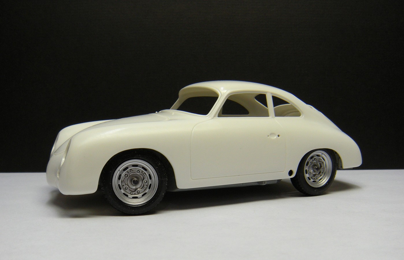

I do really like the wheels but they are difficult to do mockups with.:)

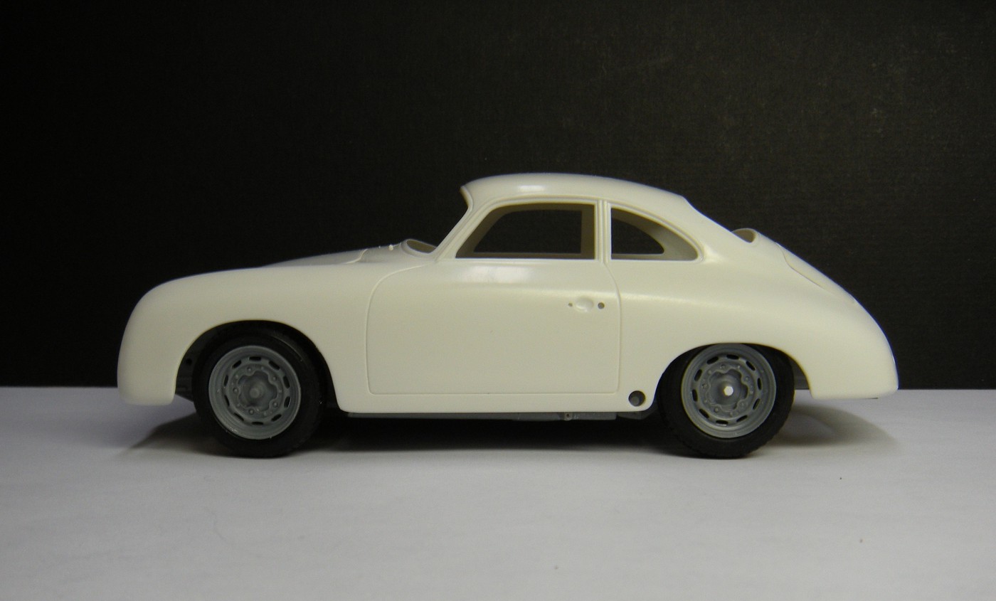

Final stance for the 356B.  Looks a little wonky because the wheels don't want to stay on.:)
DSCN9297

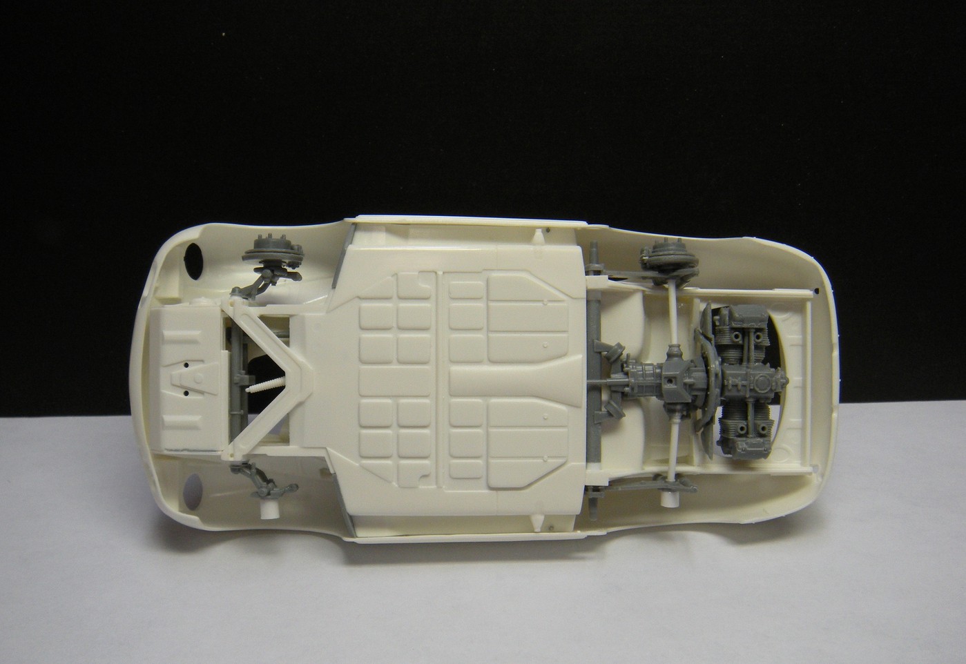

With the rear suspension lowered the axles become too short so I replaced them with styrene rod.
DSCN9300
  • Like 1

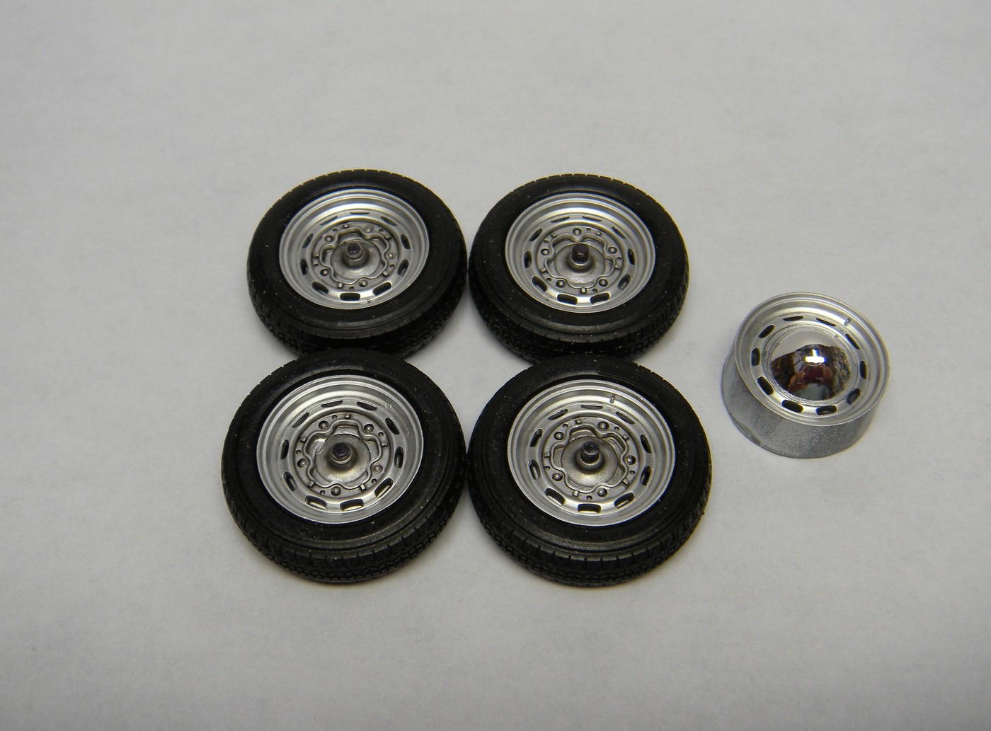

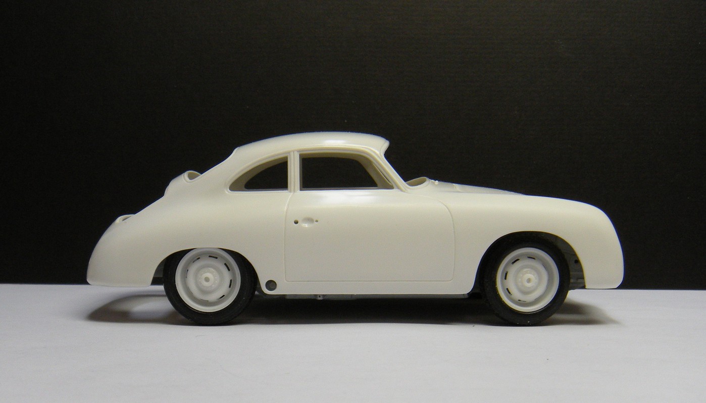

The B mocked up with Mercedes Rudge wheels, working on a Porsche Rudge wheel - stay tuned.
DSCN9303
  • Like 2

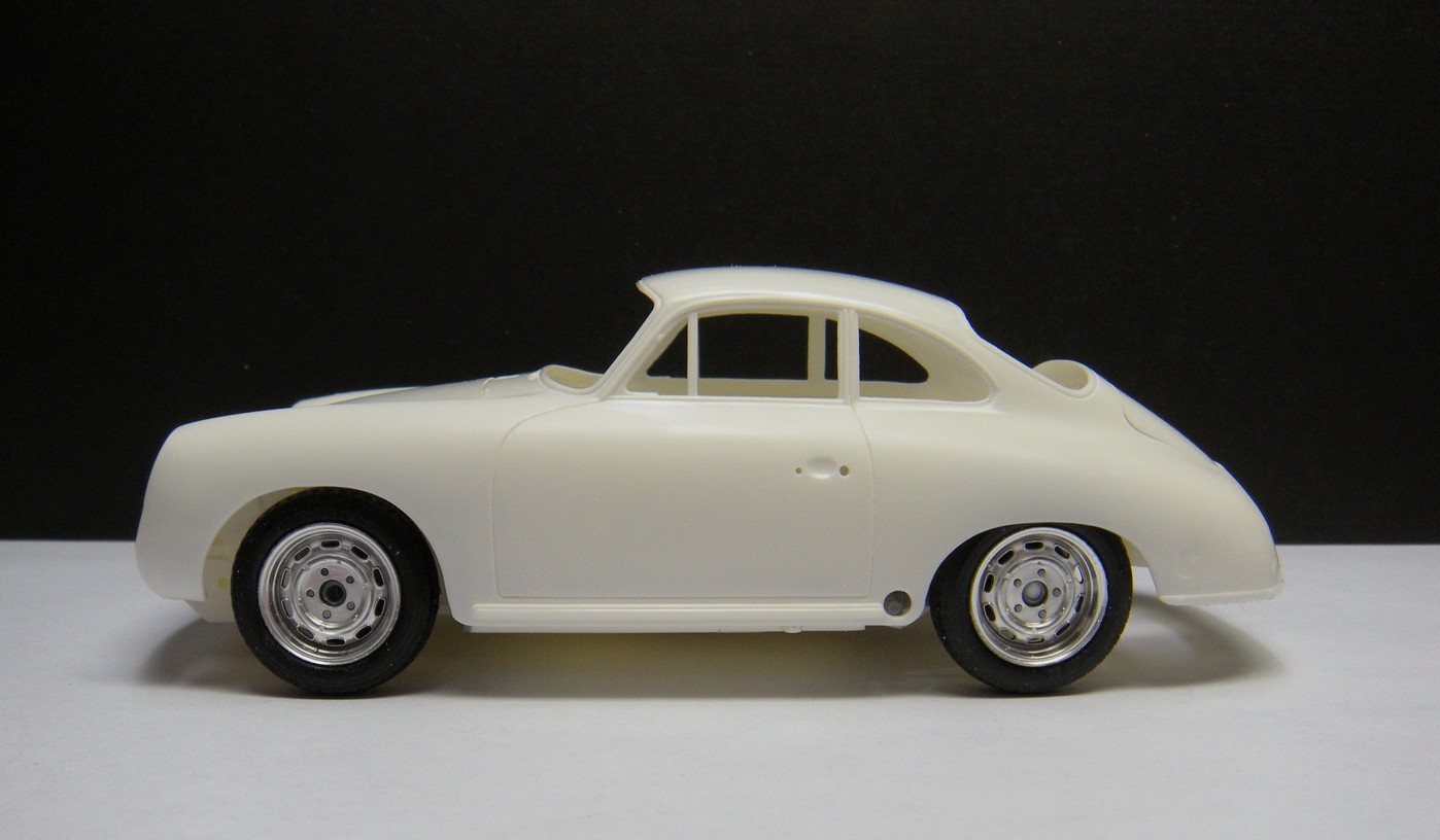

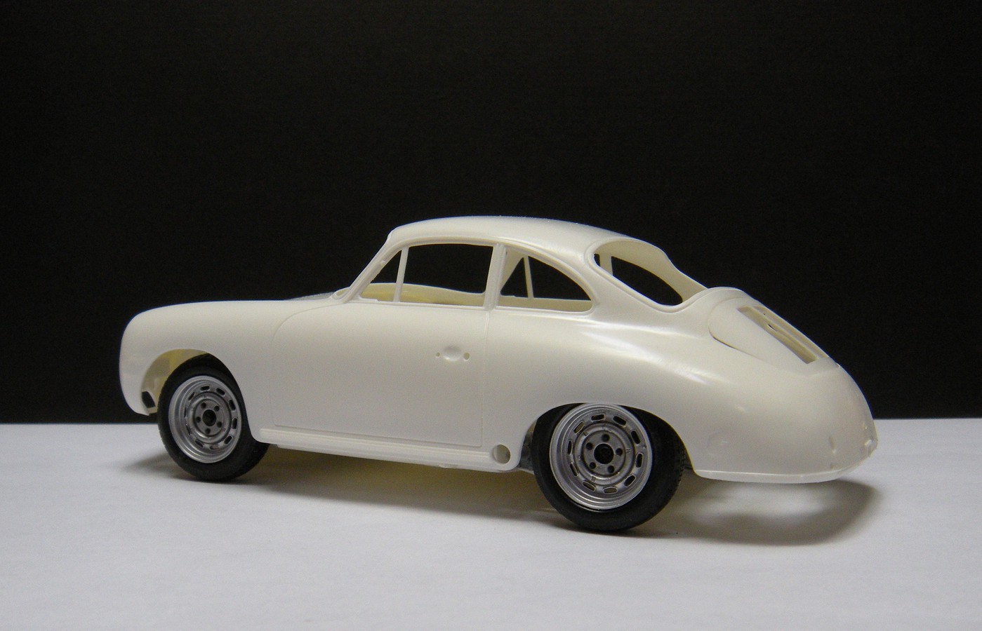

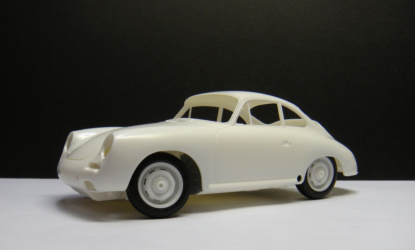

Stance on the A, not using these wheels but they make mocking up easier.
Removed the body trim on the door sill
DSCN9306
  • Like 1
Stance on both cars look very good. Doing these mock ups at the very first stage is the way I also do it. You miss on that and the build is ruined.
Always a pleasure to follow your build process. Thanks for sharing it.
Thanks Pierre and I agree stance and wheel/tire combination is critical to a successful build.

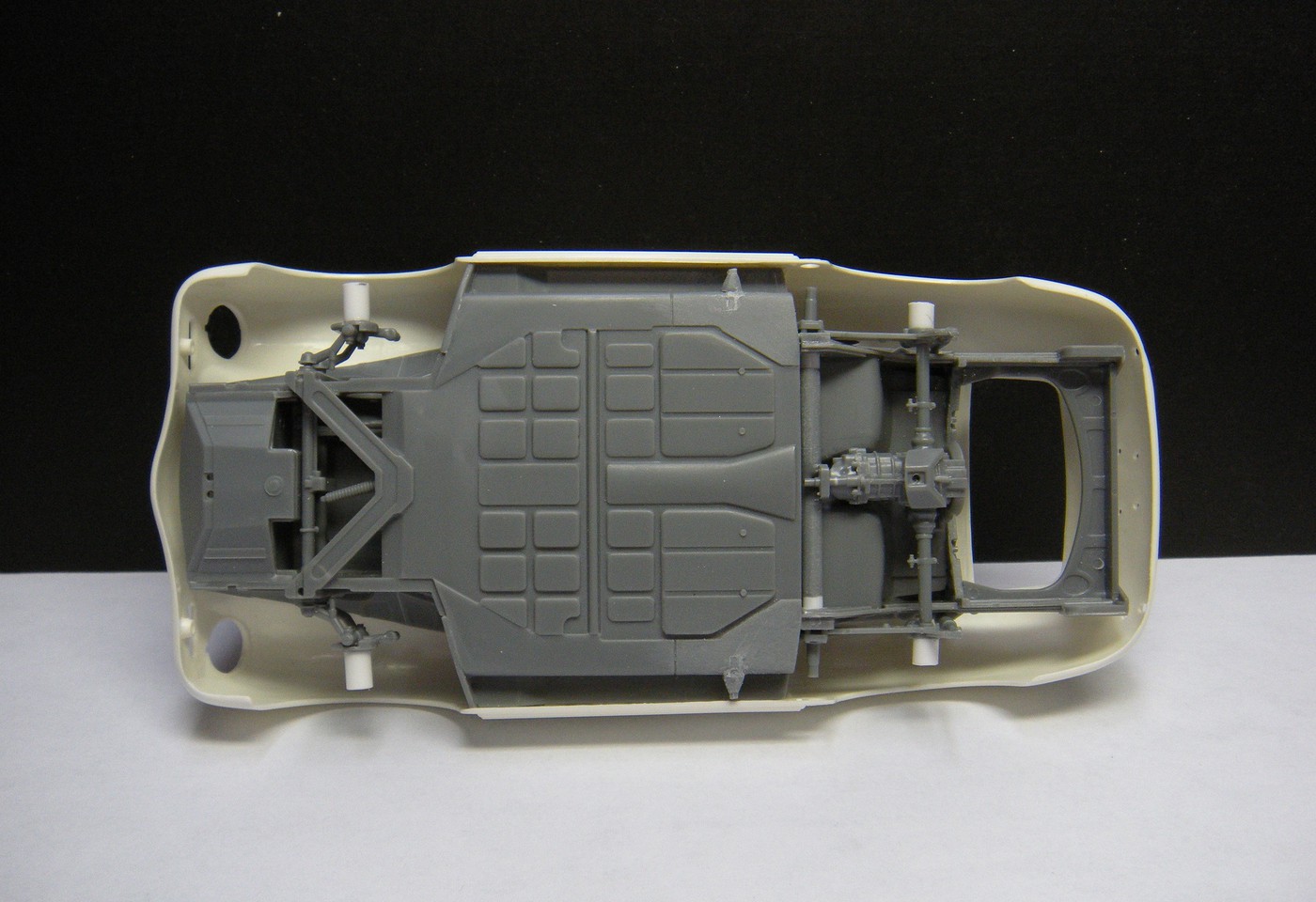

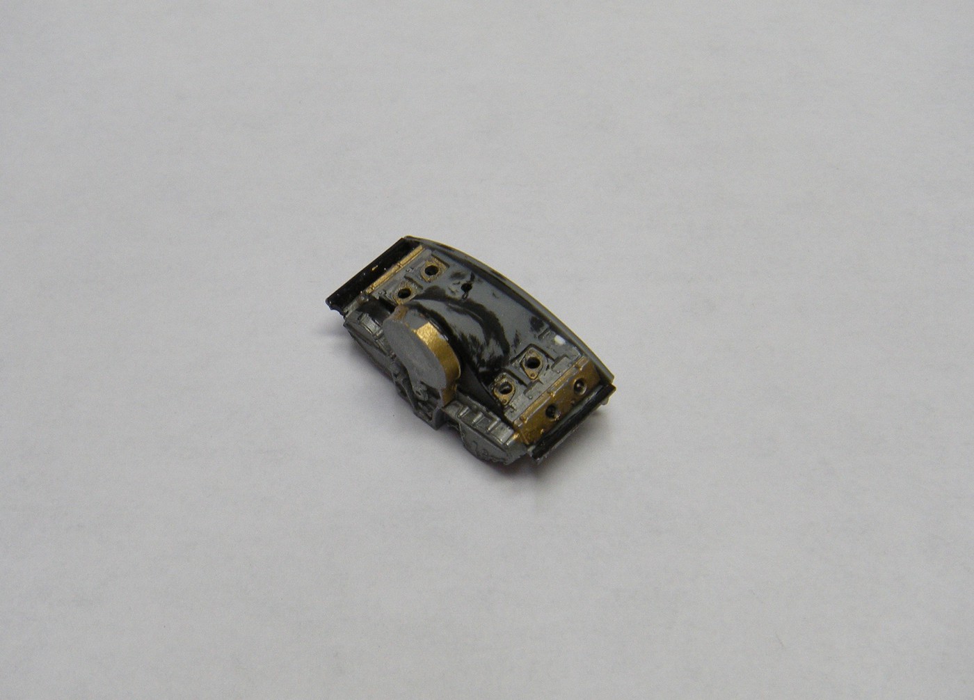

Had a junk 911 engine in the parts box so I though I would take a shot at converting it to a flat four.  Turned out okay so I will toss it in some paint stripper.
DSCN9314DSCN9316

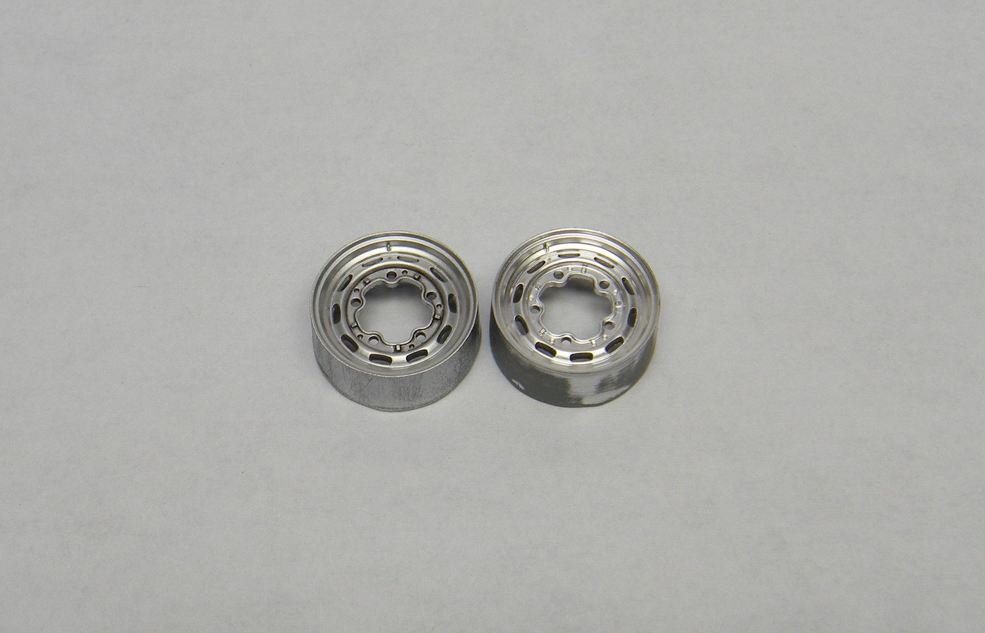

I'll be using the kit wheels on the A.  I stripped the chrome finish and will paint them silver.

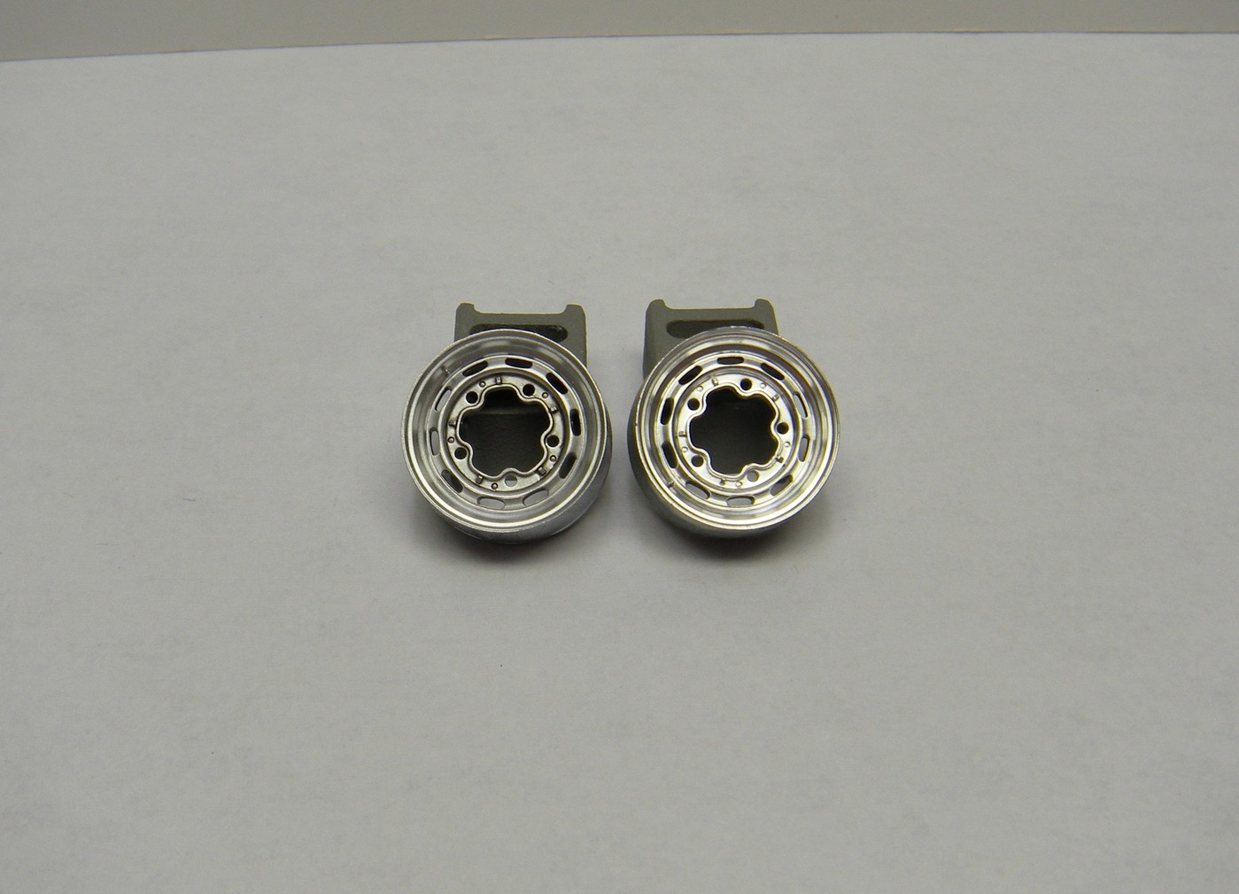

My painted wheel on the left (Tamiya TS-30 Silver Leaf) with a wash of black Tamiya Panel Line Accent on the inner rim.
Kit finish on the right.
DSCN9318DSCN9319
  • Like 4

I have never used Tamiya leaf, but it’s a really convincing finish!  Is this the rattlecan version or something airbrushed?
I really enjoy your projects, and this one’s no exception - clean, methodical building and plenty to learn from your work ??
Thanks Jim.  It was TS-30 straight out of the can.  The best silver paint I have found - zero grain.
