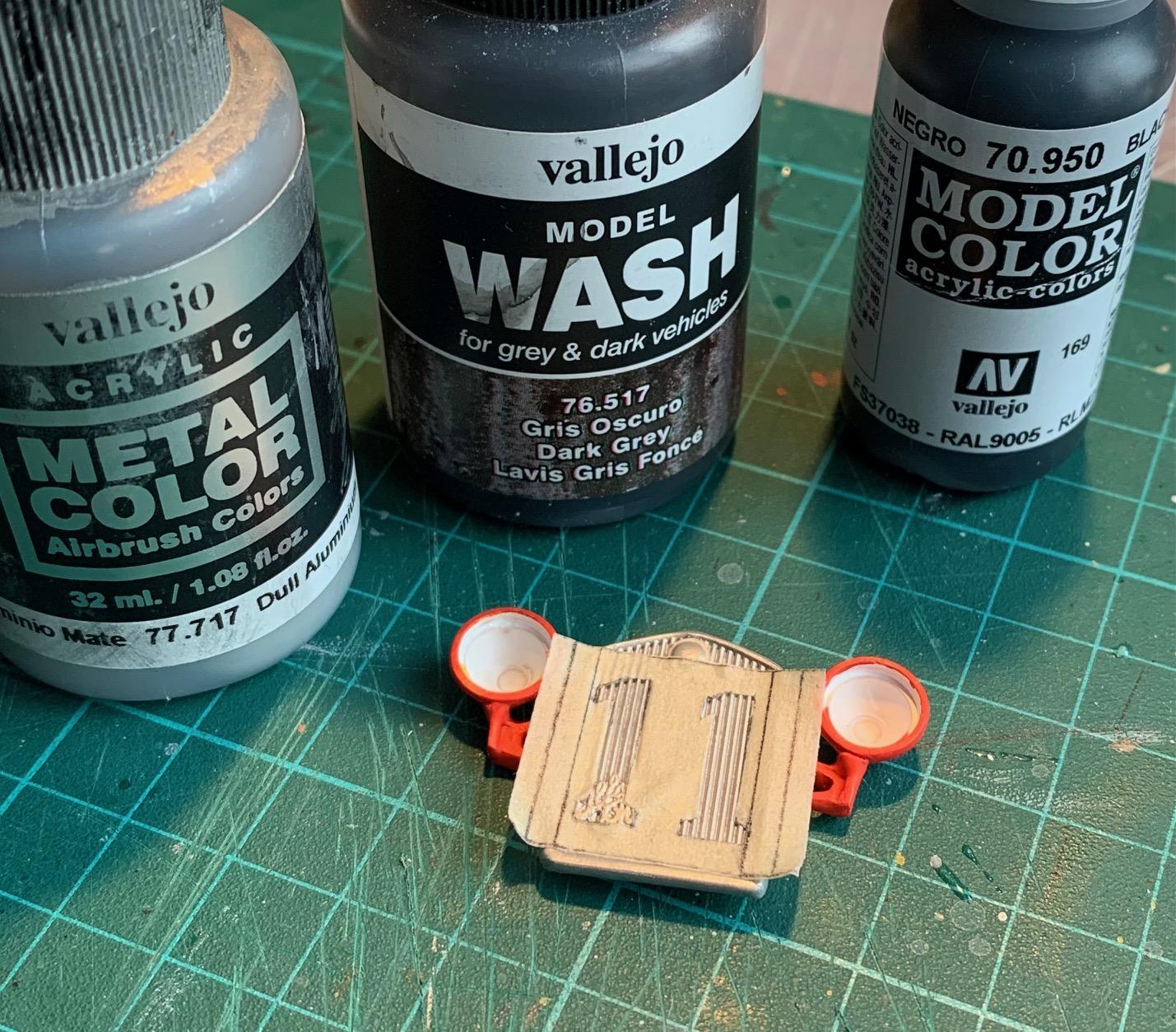

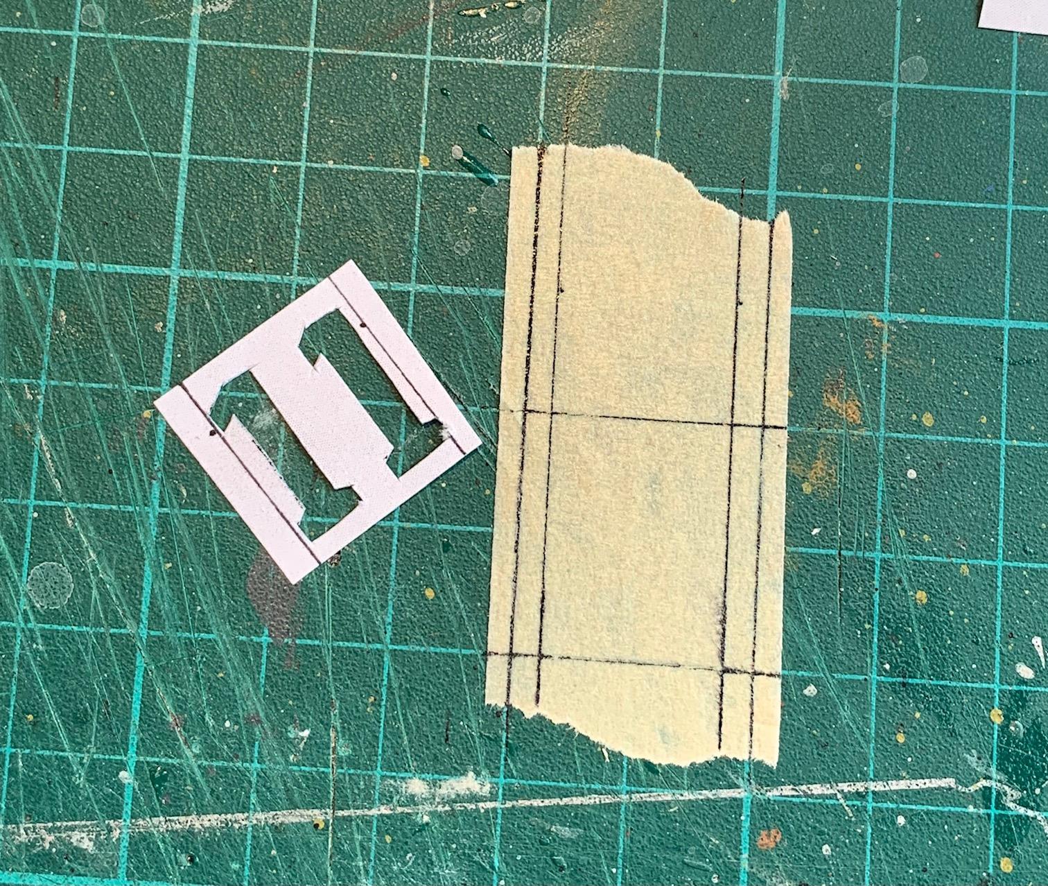

Pierre Rivard Posted October 11, 2023 Author Posted October 11, 2023 (edited) Work on the front grill and headlamp assembly. The kit has a race number decal for the grille but I don't trust it can be made to conform so I decided to paint the number instead. I photocopied the decal and used that as a template to cut the number on masking tape, painted the number & black washed the grille after that. The headlamp covers are solid resin pieces and I wanted to imitate the clear red covers used by the period race Alfas. After primer I coated a mix of Vallejo cooper and dark red, then later a thick coat of Tamiya clear red. Edited October 11, 2023 by Pierre Rivard 4
MarkJ Posted October 11, 2023 Posted October 11, 2023 Body paint looks flawless, Pierre, and I think you were wise to paint the radiator number. No way a decal was going to adhere and look right on that surface. Great job on the Alfa Romeo script on the radiator as well.

1959scudetto Posted October 12, 2023 Posted October 12, 2023 This is definitely the way to go, Pierre - painting the grille number and then treat the grille accordingly - looks very convincing! A decal on fine mesh or fine ribs like here certainly would not work. I'm always amazed how you manage to achieve a fine surface with brush painting (smoother than I do with spray cans)

Pierre Rivard Posted October 13, 2023 Author Posted October 13, 2023 On 10/12/2023 at 5:39 AM, Straightliner59 said: Beautiful work, Pierre! Grille looks excellent. Thanks Daniel. I'm happy with the direction I took with the rad grille. This resin kit is a big challenge (for me) so any little win adds up. 1
Pierre Rivard Posted October 13, 2023 Author Posted October 13, 2023 23 hours ago, MarkJ said: Pierre, you can tell from the second to the bottom photo that Hanjo posted on the first page of the thread that the paint was not glossy at all. And it looks like you nailed the grille as well. We can expect nothing but greatness from your bench. Thanks Mark. Early in the planning stage I decided to go the low/no gloss route as it appearrs more period correct to me. I want to add a bit of race weathering as tracks of the era were not pristine clean as today and cars spitted oil all over. How to achieve that is the big question...

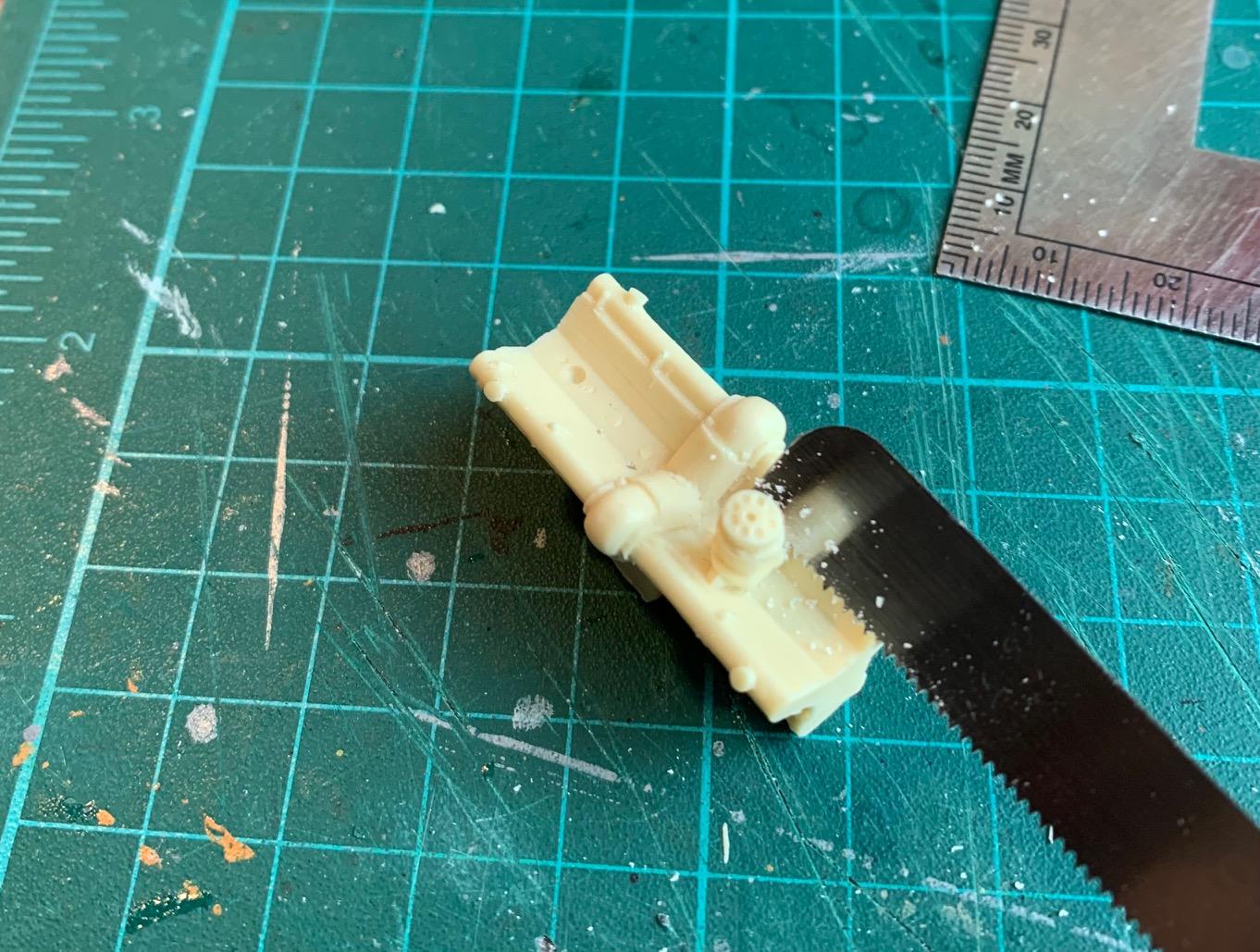

absmiami Posted October 13, 2023 Posted October 13, 2023 strangely enough - the distributor on the cyl head casting is exactly where it is supposed to be ... post a closeup of the cyl head casting and the supercharger casting and I'll make some suggestions ...
Pierre Rivard Posted October 13, 2023 Author Posted October 13, 2023 4 hours ago, absmiami said: strangely enough - the distributor on the cyl head casting is exactly where it is supposed to be ... post a closeup of the cyl head casting and the supercharger casting and I'll make some suggestions ... Thanks Andy, here's one more ref pic and 2 of my parts. The distributor is molded into the upper engine and sits in the middle of the head (lateral) where it should more to the right side. Unless I got something wrong distributor surgery will be needed.

absmiami Posted October 14, 2023 Posted October 14, 2023 Yup - i see - gotta carefully remove the distr to the side of the V in order to place the plug loom - worth doing - plug wires no larger than .013 - and you could add some cam cover bolts - drill and place some .06 aluminum tube to house the bolts and maybe try some .04 mm solder balls to depict the cam cover bolts ? Cheaper than the metal or 3d bolts I’m using in the tipo B engine - gotta get me a jar of those tiny balls / insert joke here / Amazon ??

Pierre Rivard Posted October 16, 2023 Author Posted October 16, 2023 (edited) Taking the plunge on engine work...always something I am not comfortable doing. The kit part limited to start with. The cam covers ave very narrow relative to reference pictures so there is no room to add the fasteners. I'll try to imbed posts on the sides on which PE fasteners will eventually sit on. This will in no way be accurate but hopefully more presentable. Other fixes & adds? Relocating the distributor, ignition wires, coil, engine coolant take off and possibly a bit more detailing if phase one works out. If phase 1 fails? that's it for the little engine...⚰️ Edited October 17, 2023 by Pierre Rivard
