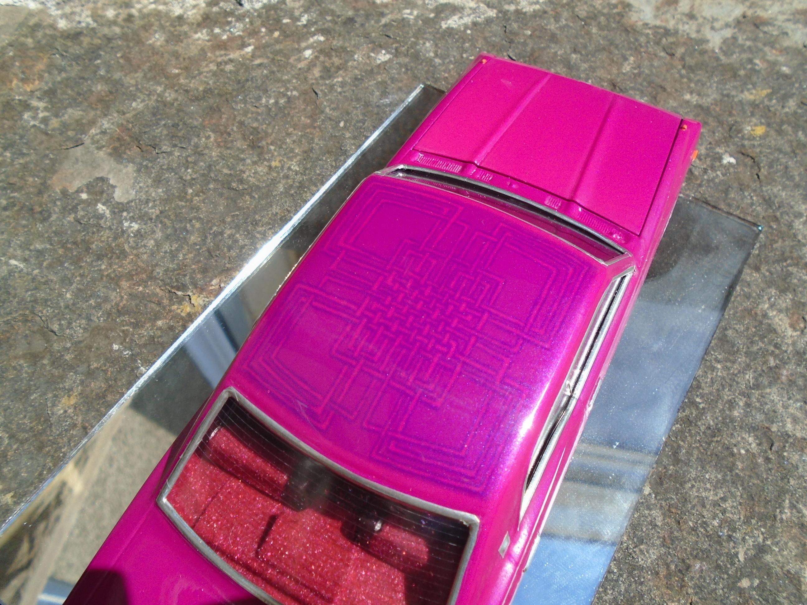

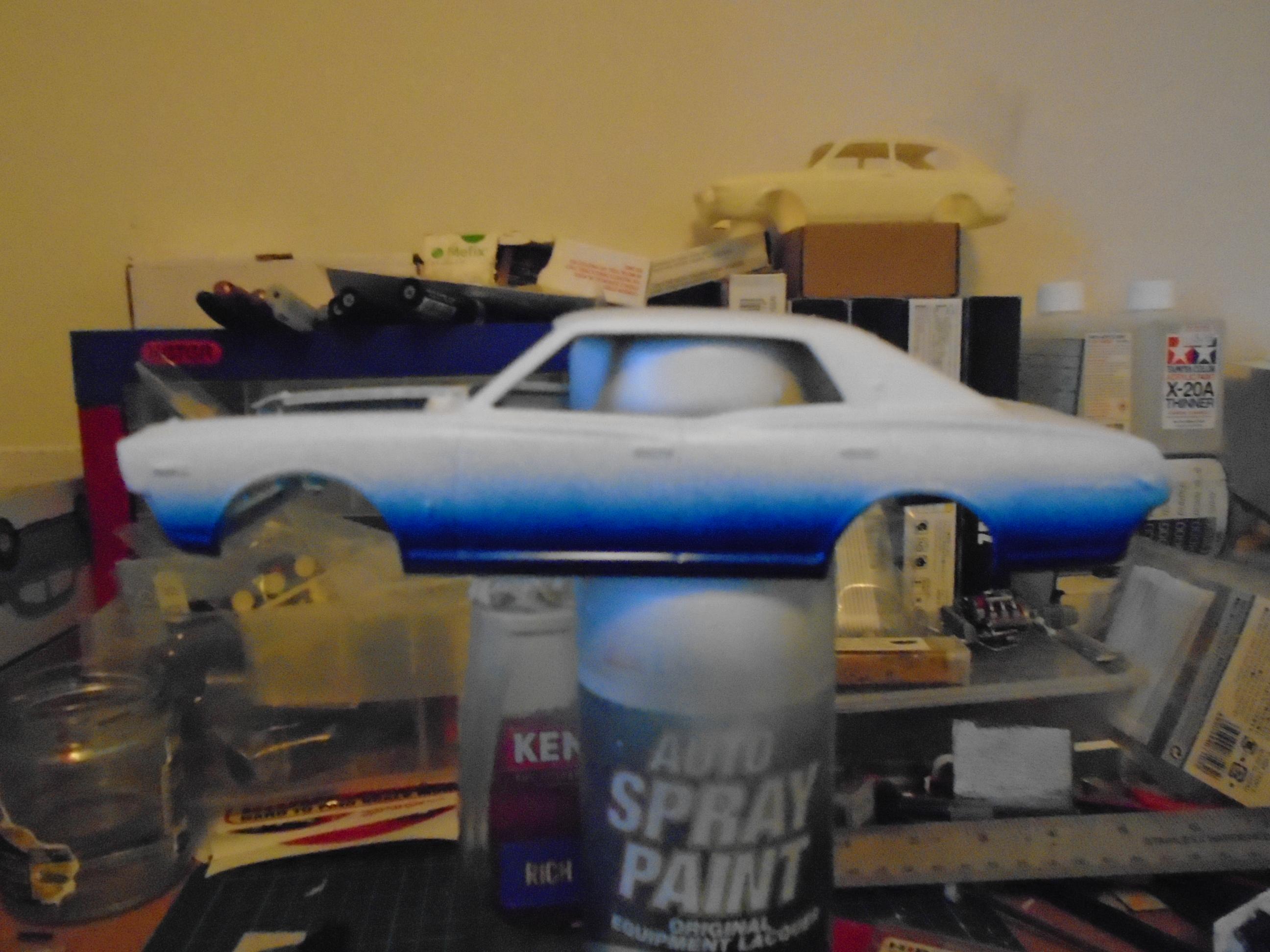

stitchdup Posted November 22, 2023 Posted November 22, 2023 You dont need to mask if its a simple fade, and it can be easily achieved with rattle tins if you do the fade first. This was done with hok hot pink as the final colour but the first colour was white primer (I wanted a brighter pink than silver or gold would give) then I did the fade along the bottom of the body. I find it easier to lift the body up so the paint dusts under it instead of over the top while painting. I used blue for the fade and i only really hit the body bottom edge with paint, the rest is just the fog from spraying the blue. Then it was onto the final colour over the top of it all. The bright blue bottom edge wasn't planned, just a bit of luck after i lowered the body down to paint the pearls and clears. The only masking done on this was for the roof. If you are using solid/opaque colours it can be done the same way but you would do the top colour before the fade 2
