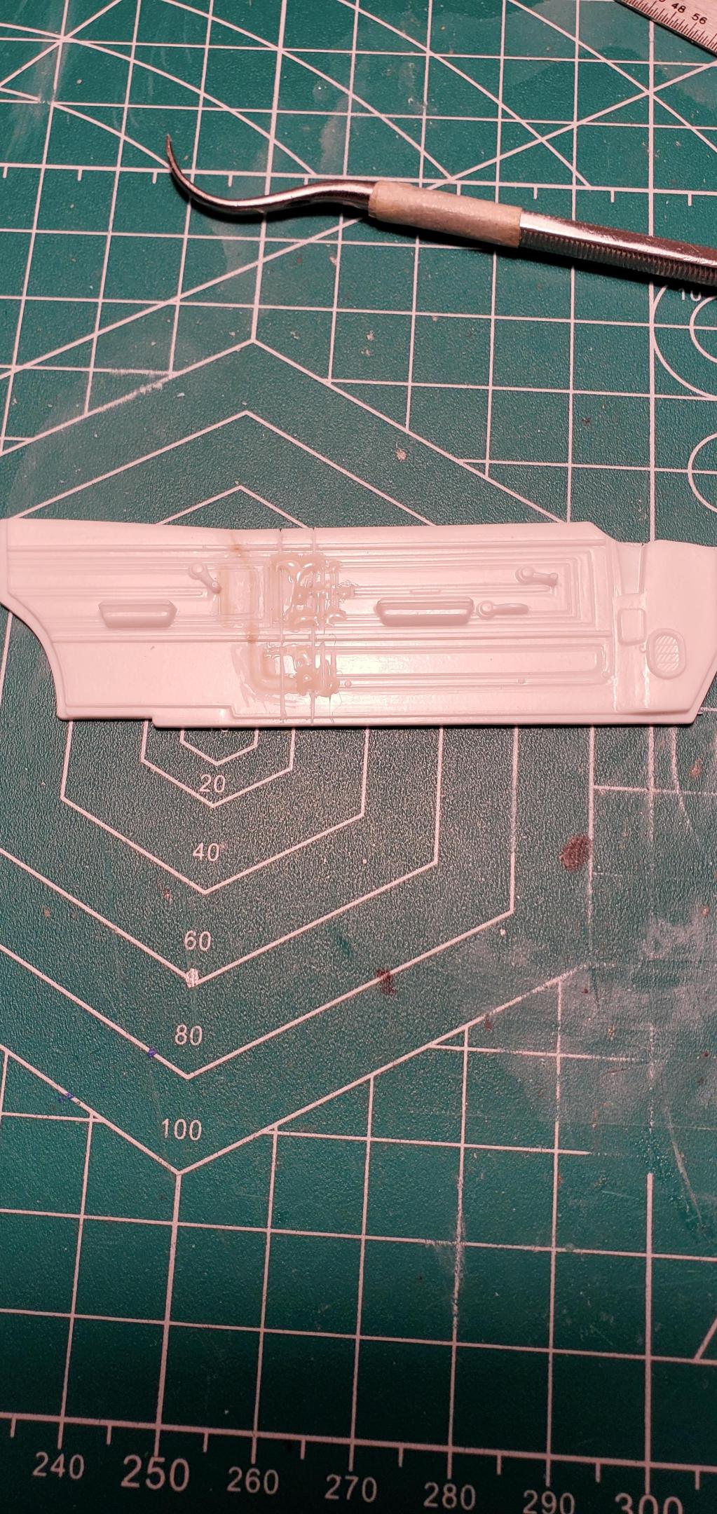

Steamboat Posted December 24, 2024 Author Posted December 24, 2024 Interior door trim that no one will ever see has been filled with sprue glue... 1

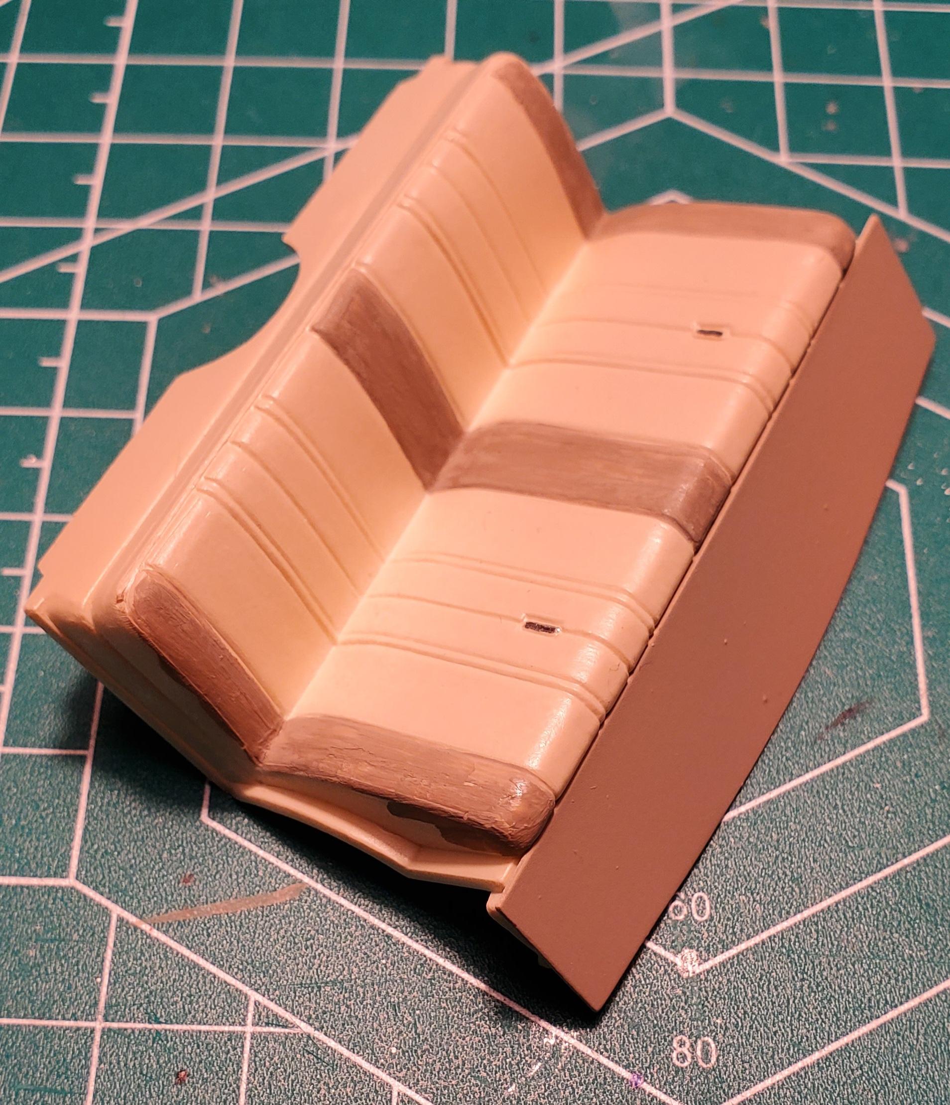

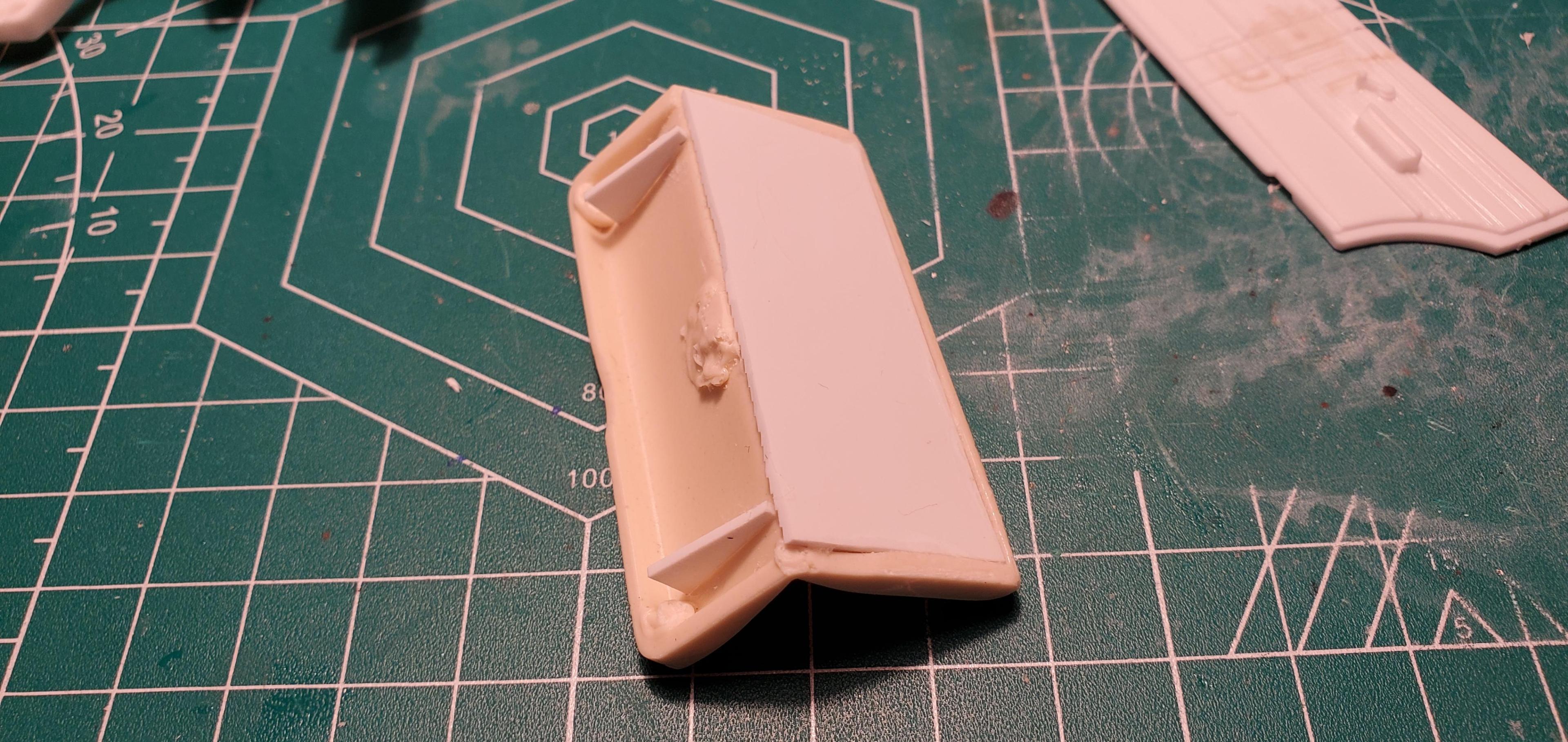

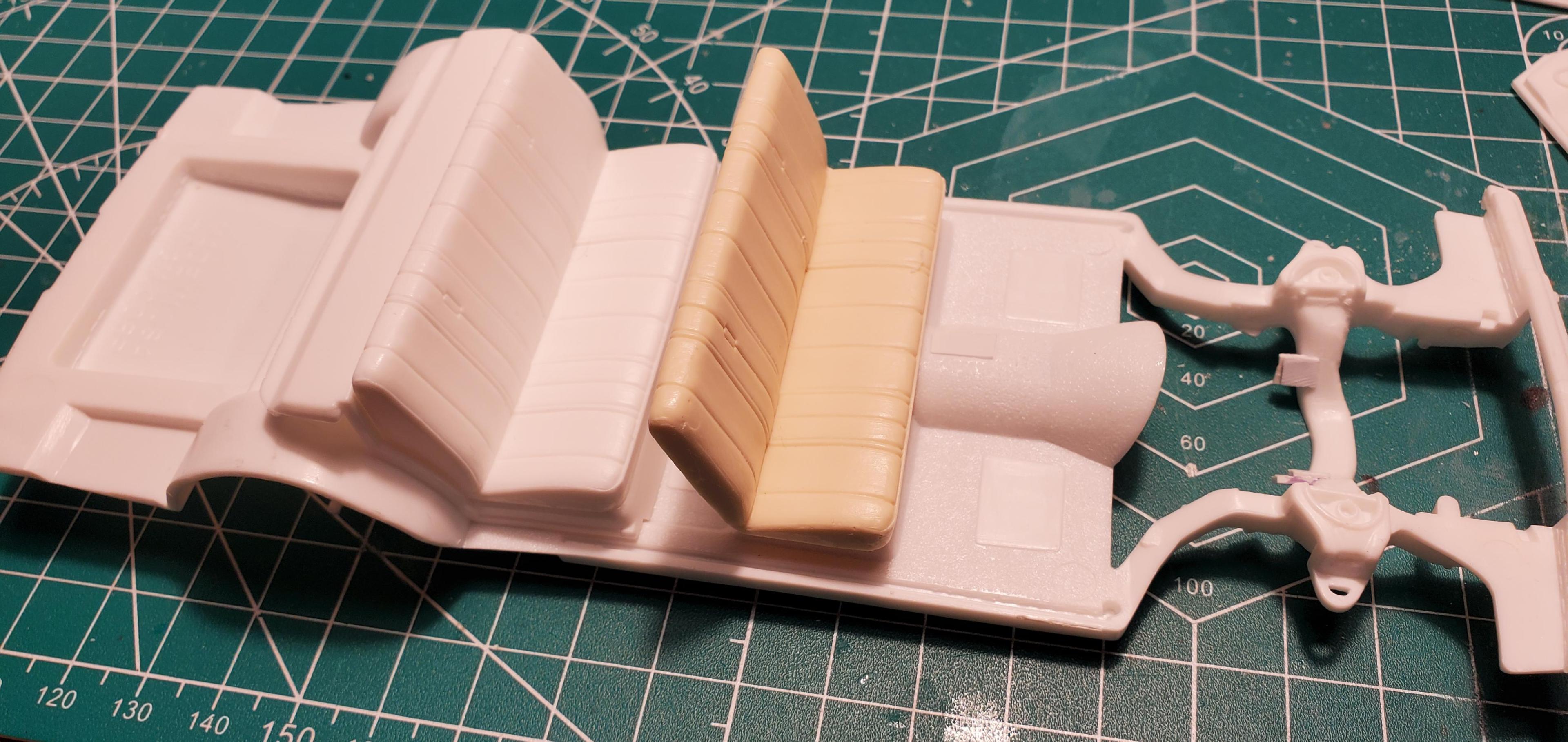

Steamboat Posted December 27, 2024 Author Posted December 27, 2024 The front bench seat is a home made resin copy of the rear seat. I added a piece of styrene for the seat back and some styrene supports underneath. 3

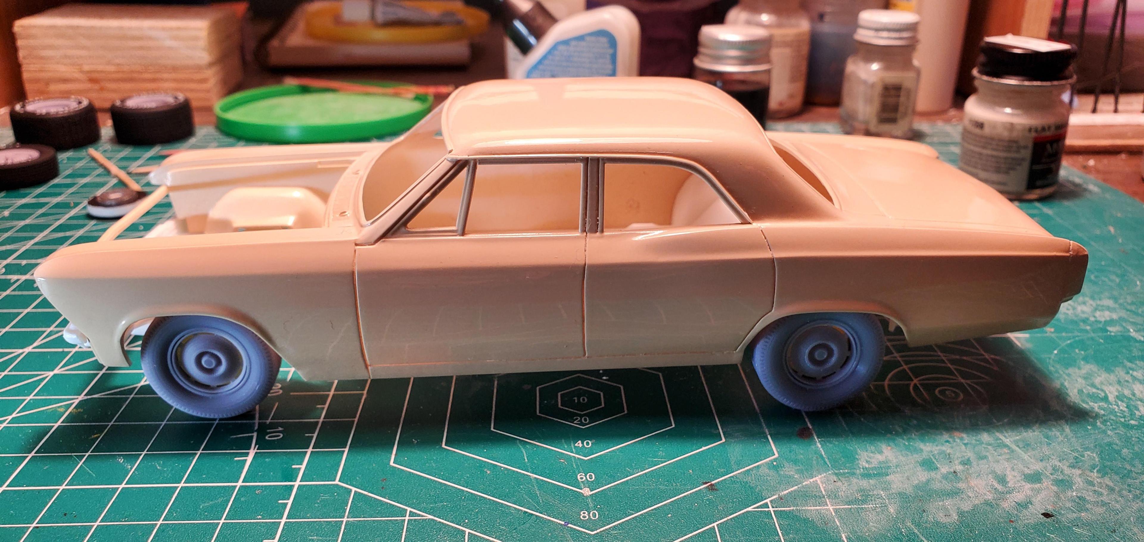

Steamboat Posted January 13 Author Posted January 13 The body is now cleared and polished. I went with Boyd's (Testors) enamel clear, airbrushed, then put in the dehydrator for 4 hours. After that it was polished and put back in the dehydrator for another 4 hours. Polishing while the coating was still soft was really easy. It only took polishing compound, no wet sanding needed at all. Model shown here mocked up with my own 3d printed tires and deluxe hub caps. 4

Steamboat Posted January 22 Author Posted January 22 Here's the interior nearing completion. After reworking the roof, the rear package shelf was too short. I suppose that in the 1:1 car, the rear seat may have been further rearward, but in this case, it was easier just to make a filler piece from sheet styrene. The door trim has been rescribed for the 4 door version. Not sure if the color scheme is 100% correct, but it works! Removed the Millennial anti-theft Device and scratched an automatic transmission brake pedal! 2
